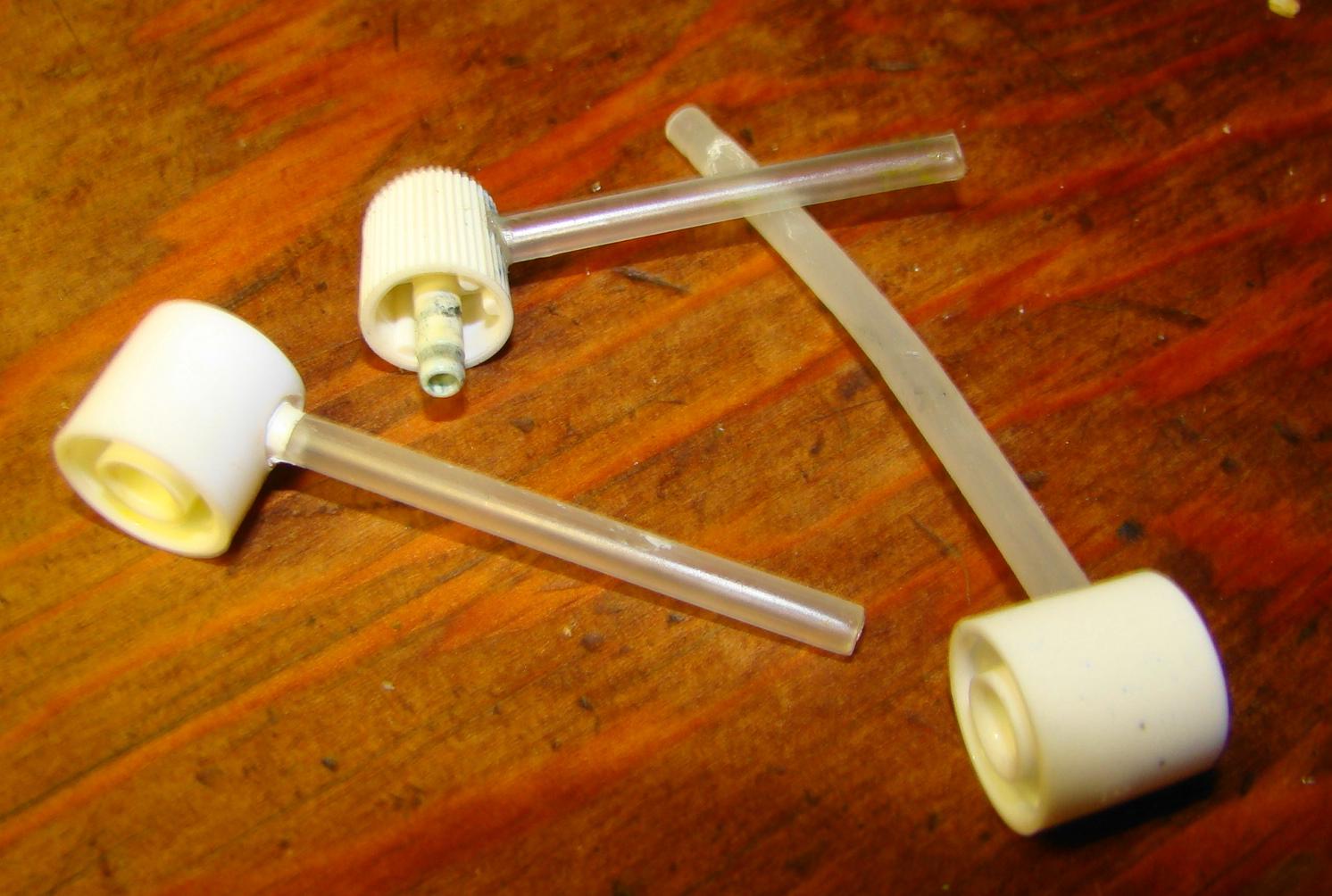

Rich Chernosky Posted November 13, 2020 Posted November 13, 2020 If you like to decant here is another way. I made these by taking the spray nozzle out of the spray head. The tubing comes from most any spray bottle. A little plumber teflon tape around the tube and jam it in the hole left by the nozzle. Shown are a Testors and Tamiya spray heads. Savogram Brush and roller cleaner works better than laquer thinner. These have been cleaned many times.

Deuces ll Posted November 16, 2020 Posted November 16, 2020 On 11/13/2020 at 10:12 AM, Rich Chernosky said: If you like to decant here is another way. I made these by taking the spray nozzle out of the spray head. The tubing comes from most any spray bottle. A little plumber teflon tape around the tube and jam it in the hole left by the nozzle. Shown are a Testors and Tamiya spray heads. Savogram Brush and roller cleaner works better than laquer thinner. These have been cleaned many times. I like this idea.... I've used w-40 straws cut too 3" lengths and get 3 pieces out of it.....
