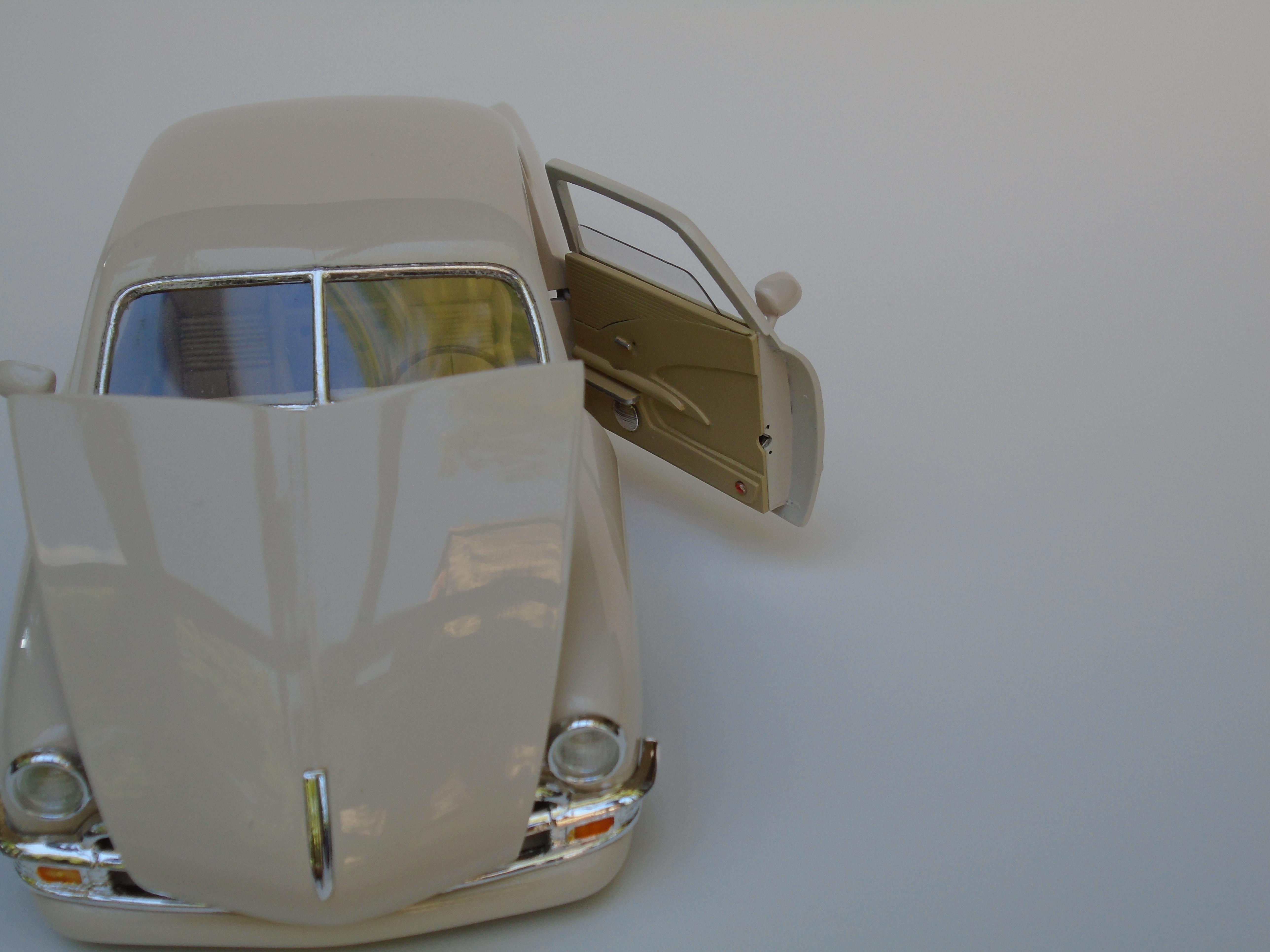

Dave72 Posted January 26, 2021 Author Share Posted January 26, 2021 2 hours ago, Claude Thibodeau said: Hi Dave! Thank for the detailed reply, Just what I wanted. Actually, my technique is the same as yours, except I never used the Duplicolor clear. And I use Farecla rapid cut compound. But, you are the second person I know who achieves great results with it, the other being a friend here in the Great White North. So, I guess I'll give it a try on my next model. I am a fan of Testor's Wet Look clear: easy to apply, virtually never runs, and the perfect viscosity to achieve a glass look even before polishing (at least, in my experience!). Alas, Testor's is going out of the paint market, and my reserve is drying up slowly... Tamya's TS-13 is fine, but much thinner, hence more coats (hello orange peel) and even at that, sometimes prone to rub-trough at polishing time (don't ask me how I know...). The new Revell line is good, but somehow, it is even more "thin" than TS-13. So, Duplicolor experiment, here I come. Here's a pic of Wet Look on one of my built... CT Very nice! I have heard of the Testors Wet Look Clear. Seems like quite a few people like it. That’s a lacquer correct? The Duplicolor does go on a little dry if the coats are light. Ugh orange peel. It does take some practice to spray on a nice wet coat without the dreaded run. My next go to for paint is House of Kolor but that gets expensive! I do like the Duplicolor because it seams to agree with a lot of other paint. I’ve used it over everything from Tamiya to Rustolium Camo green! And it is easy to get. Most auto parts stores have it. Bad thing is it takes just the right thickness of coats and a fair amount of polishing work. I wish it looked as good as the Testers. I have been thinking of looking for a different clear though. Quote Link to comment Share on other sites More sharing options...
Claude Thibodeau Posted January 26, 2021 Share Posted January 26, 2021 6 minutes ago, Dave72 said: Very nice! I have heard of the Testors Wet Look Clear. Seems like quite a few people like it. That’s a lacquer correct? The Duplicolor does go on a little dry if the coats are light. Ugh orange peel. It does take some practice to spray on a nice wet coat without the dreaded run. My next go to for paint is House of Kolor but that gets expensive! I do like the Duplicolor because it seams to agree with a lot of other paint. I’ve used it over everything from Tamiya to Rustolium Camo green! And it is easy to get. Most auto parts stores have it. Bad thing is it takes just the right thickness of coats and a fair amount of polishing work. I wish it looked as good as the Testers. I have been thinking of looking for a different clear though. HI Dave! You are right about HOK Show Klear Urethane: I use it on my 1/1 cars, and it is world class: medium thickness, great flow, extreme shine, but... Once catalized and fully cured, mucho difficulto to polish to perfection. On a steel body, no problem, you just rub or polish harder. On a flimsy styrene scale body... a gentle approachj is needed. Ultimately, I guess we are a bunch of hard to satisfy fellas... LOL. CT Quote Link to comment Share on other sites More sharing options...
