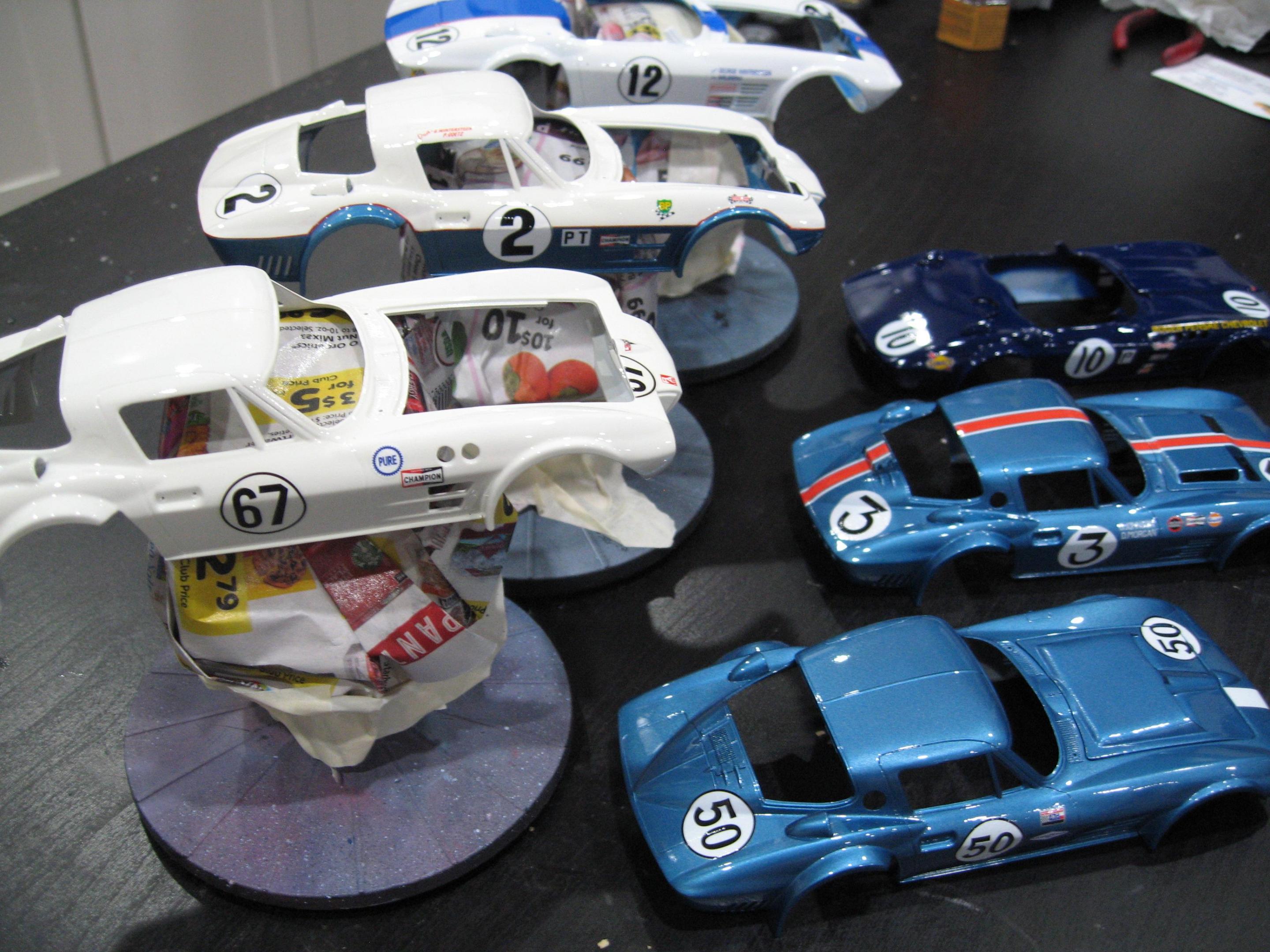

Mcpesq817 Posted January 21, 2021 Author Posted January 21, 2021 Thanks Geoff, those look fantastic! Can I ask what you use as a primer under the Zero paint? And when you shoot Zero paints, are you just applying a fine mist coat?
Dave G. Posted January 21, 2021 Posted January 21, 2021 You could put down a single coat or even two of acrylic over the primer before shooting the Zero. That should form a barrier. Vallejo Model Air should be fine. Myself having nearly 100 craft paint colors in stock would just use that but that's another matter. What I mean is I wouldn't go buy something specifically is all. As to other paints, I'm presently messing with MCW lacquer. It seems ok, colors are accurate. They sell enamel too and Mike can mix any color so don't be afraid to ask questions ( even about how hot the paints are).
GeeBee Posted January 21, 2021 Posted January 21, 2021 4 hours ago, Mcpesq817 said: Thanks Geoff, those look fantastic! Can I ask what you use as a primer under the Zero paint? And when you shoot Zero paints, are you just applying a fine mist coat? I use Hycote plastic primer, I buy there grey and white primer, decanted from the aerosol and mix them 50:50 so I end up with a very light grey primer. I found using Zero and Gravity paints, I set the airbrush at around 15 psi, and use the #3 needle and tip on my Paasche VL, put on a light coat to just hide the primer, leave it around 10 minutes and come back and do another light coat, and keep doing that until I've covered the primer completely, once I've got a good uniform covering I leave it to dry for at least 24 hours, then put on the acrylic clearcoat, again made by Hycote.

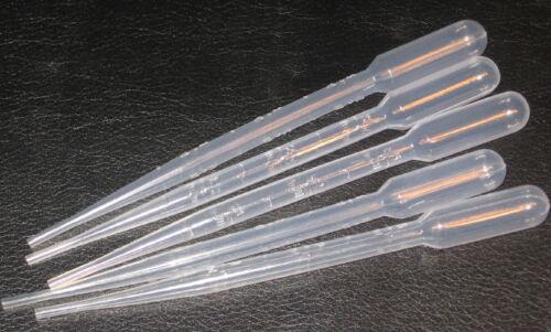

Mcpesq817 Posted January 24, 2021 Author Posted January 24, 2021 Bill, really appreciate you taking the time to help me on all this. You and others here have been incredible. Hope I can repay the favor in the future. After watching the videos, those pipettes were exactly what I thought I needed to get. I've been pouring from the paint container into the airbrush cup which can get messy and wasteful as you can imagine.
