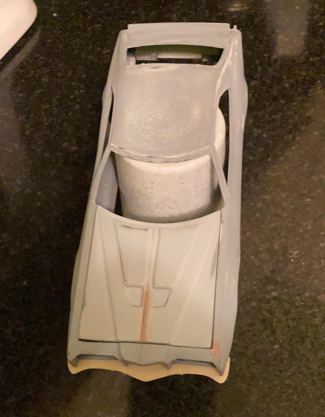

gks1964 Posted March 14, 2021 Posted March 14, 2021 (edited) I've been work in partnership with Tim Stevens for about the last 6 months on trying to build a master of this car. Well we think it's done. The 76 Montego went on the back burner for this project. Edited March 14, 2021 by gks1964

gks1964 Posted March 16, 2021 Author Posted March 16, 2021 Quick mock up with all the parts in place!

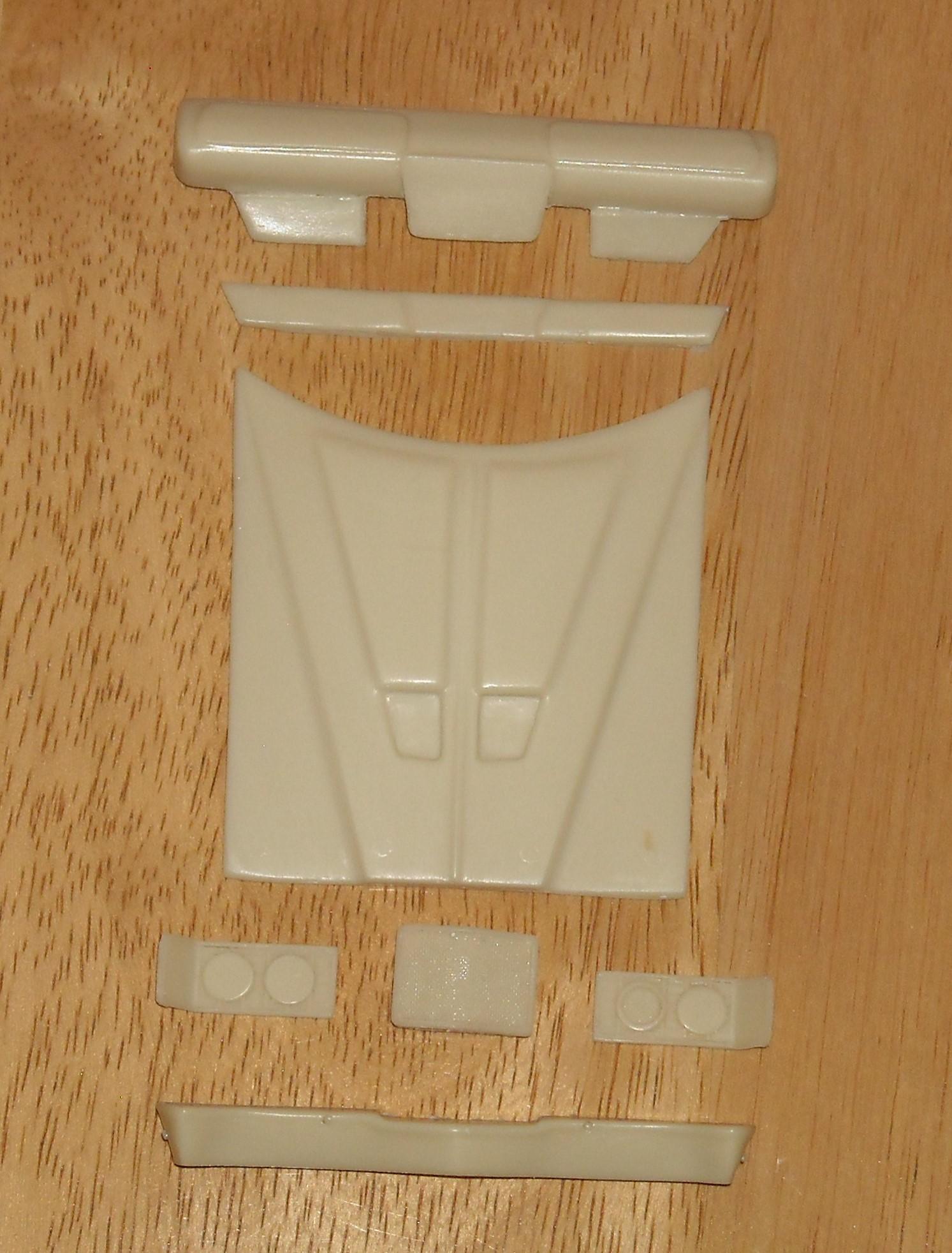

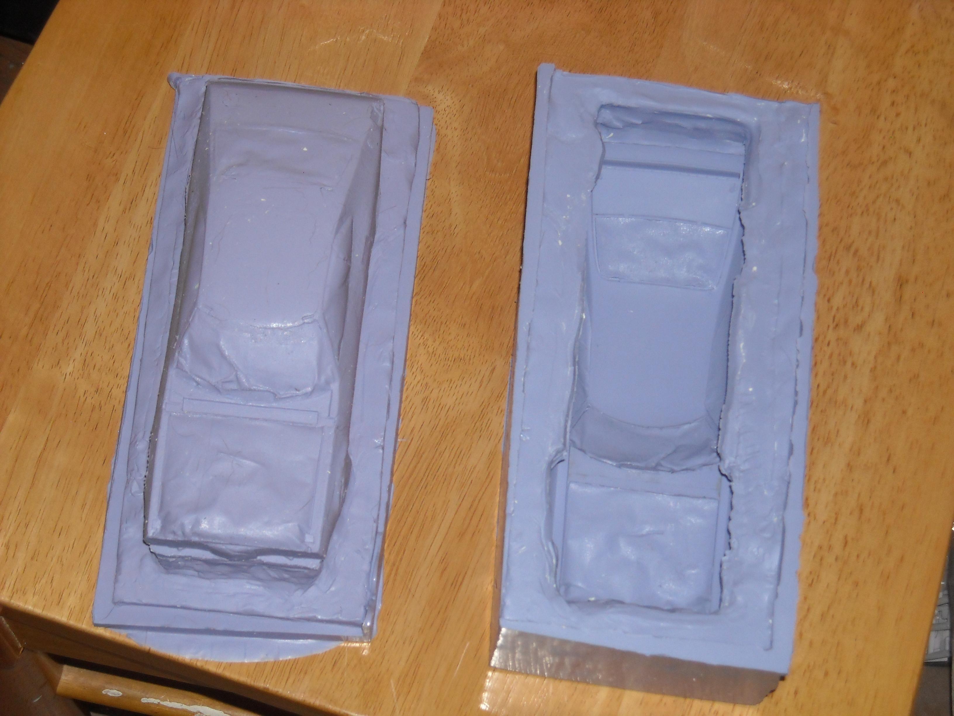

gks1964 Posted March 22, 2021 Author Posted March 22, 2021 Got 7 of the 8 molds made and samples cast. Tim did an outstanding job with the rear bumper and valance. Now to do the major mold of the body!
DoctorLarry Posted March 22, 2021 Posted March 22, 2021 I need to build a pot to do that in. Did you vacuum the mold rubber first?
gks1964 Posted March 22, 2021 Author Posted March 22, 2021 2 minutes ago, DoctorLarry said: I need to build a pot to do that in. Did you vacuum the mold rubber first? I pressurize the rubber before I pour it and then pressurize the molds for 6 hour cure time.

Sledsel Posted March 24, 2021 Posted March 24, 2021 (edited) Very cool, one of my favorite stock cars and street car too. Little rivet counting for you, the hood is incorrect. The center has a peak and the scoops are too short and narrow. Edited March 24, 2021 by Sledsel
gks1964 Posted March 25, 2021 Author Posted March 25, 2021 On 3/24/2021 at 12:15 PM, Sledsel said: Very cool, one of my favorite stock cars and street car too. Little rivet counting for you, the hood is incorrect. The center has a peak and the scoops are too short and narrow. I think you are correct on both points!!
Repstock Posted March 26, 2021 Posted March 26, 2021 On 3/22/2021 at 2:03 PM, gks1964 said: I pressurize the rubber before I pour it and then pressurize the molds for 6 hour cure time. I'm not a caster, I just may be confused, but I thought rubber was gassed in a vacuum pot, and as you said, resin is pressurized.
gks1964 Posted March 26, 2021 Author Posted March 26, 2021 14 minutes ago, Repstock said: I'm not a caster, I just may be confused, but I thought rubber was gassed in a vacuum pot, and as you said, resin is pressurized. Air pressure can also be used to force air out of the rubber. The reason I pressurize the mold while it curing is to force the rubber on to the master to pick the details. The resin is force into the mold with air pressure to also remove air that cause voids in the casting. Hope is understandable.
