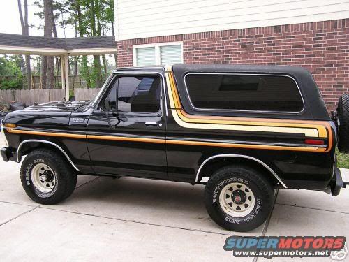

youpey Posted May 24, 2021 Posted May 24, 2021 (edited) i am working on my amt 1/25 1978 ford bronco, and i would like to make it look like the free wheelin style. I tried to draw them myself thinking it would be simple, but boy was i wrong. my lack of skills are astounding. plus, i tried printing what i did have and it looked terrible, fuzzy and like garbage. i would rather not use the stripes at all vs using ones that look bad. any help is greatly appreciated Edited May 24, 2021 by youpey

youpey Posted May 26, 2021 Author Posted May 26, 2021 (edited) I tried for a few hours to draw the lines without any luck. Unfortunately I haven't been blessed with even basic drawing skills. I Think what i will try to do is mess with an image that i find online. Im going to try to primt it to white decal paper and just cut along the lines to make it so the white isn't seen. I Had found a picture of the sunburst version thai i was able to get to the right size my printer is not good enough. Im going to try to go to staples and see if they will let me print on my decal paper with their image printer. I really prefer this version over the sunburst one, and honestly worst case i will just paint the bronco blue and not use decals. If i can get the decals right, it will be black... or maybe one of each. I have 2 of the amt kits Edited May 26, 2021 by youpey
peteski Posted May 26, 2021 Posted May 26, 2021 (edited) For this type of decal the best is to put some masking tape over the side of the model, then roughly sketch the stripes on the tape. Then scan the sketch on the masking tape into the computer, then use a graphic program (like Adobe Illustrator, Corel Draw, or Inkscape) which is capable of layers to put the scanned image on a locked layer, then draw the actual stripes over the scan. That will assure that the decal will fit over the body correctly. The other way would be to place the body on a scanner, and scan the side. Then use that scanned image instead of the masking tape sketch to draw the correctly sized stripes. But it sounds like you don't have that capability. Edited May 26, 2021 by peteski
youpey Posted May 26, 2021 Author Posted May 26, 2021 On 5/26/2021 at 4:11 AM, peteski said: For this type of decal the best is to put some masking tape over the side of the model, then roughly sketch the stripes on the tape. Then scan the sketch on the masking tape into the computer, then use a graphic program (like Adobe Illustrator, Corel Draw, or Inkscape) which is capable of layers to put the scanned image on a locked layer, then draw the actual stripes over the scan. That will assure that the decal will fit over the body correctly. The other way would be to place the shell on a scanner, and scan the side. Then use that scanned image instead of the masking tape sketch to draw the correctly sized stripes. But it sounds like you don't have that capability. Expand I had not thought of using masking tape on the model. That might work for me. I cant freehand draw, but i should be able to get it with the tape. I only need to do one side, the other will just be flipped Thanks for the great idea.
