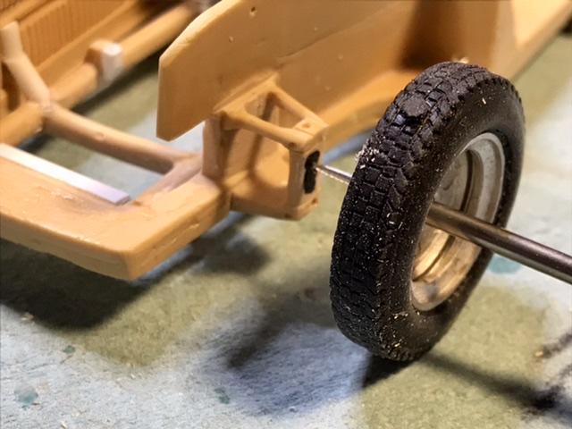

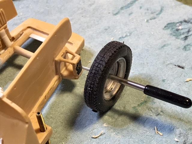

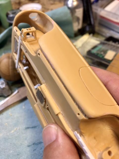

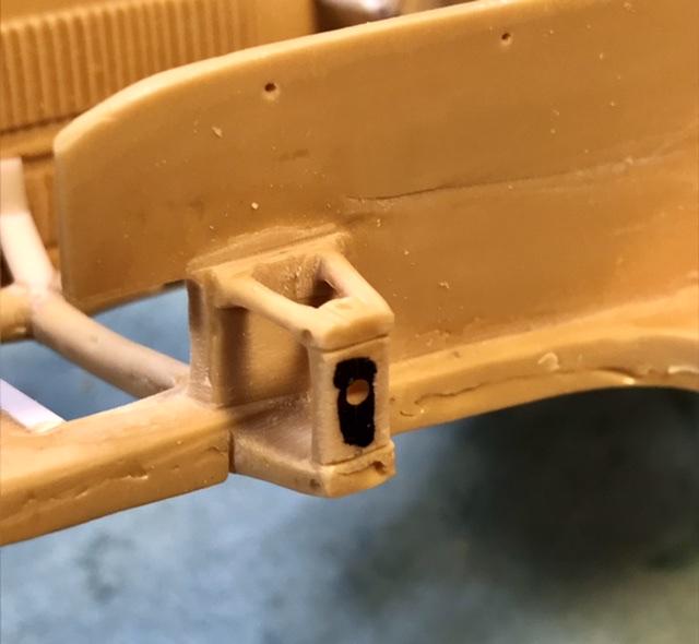

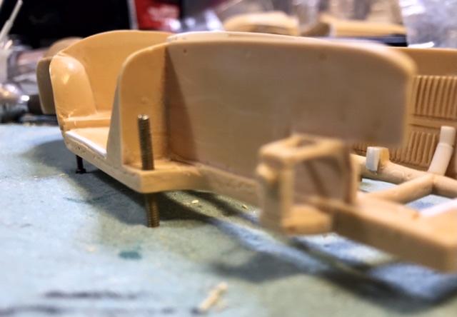

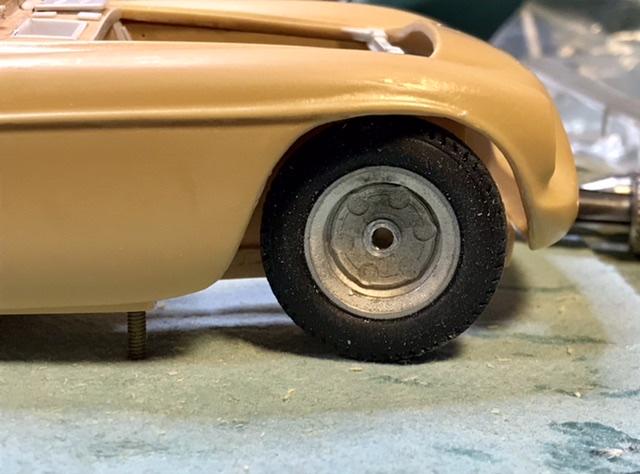

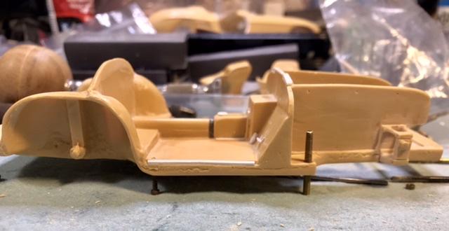

absmiami Posted June 7, 2023 Author Posted June 7, 2023 Drilled and tapped four holes on the base plate for screws and set the base to give a bit more than 6 scale inches of ground clearance - and the screws enable me to locate reasonably accurate holes for the axle stubs front and back …

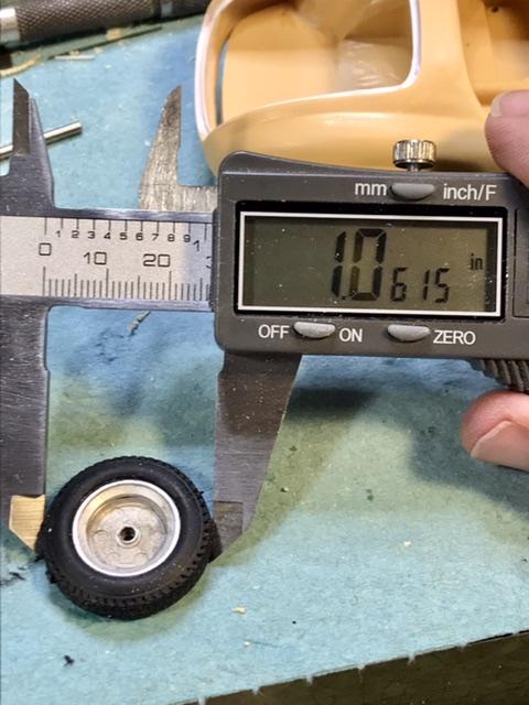

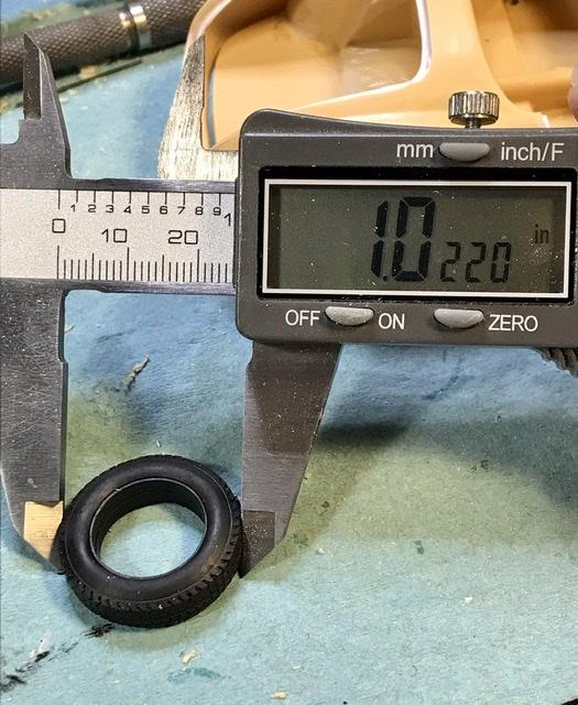

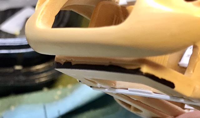

absmiami Posted June 7, 2023 Author Posted June 7, 2023 The kit tires are soft rubber - they appear to be be too small - but …
absmiami Posted June 7, 2023 Author Posted June 7, 2023 (edited) When stretched over the wheel rim - they appear to have the correct diameter … Edited June 7, 2023 by absmiami
absmiami Posted June 7, 2023 Author Posted June 7, 2023 So now i can mark the holes to drill for the stubs - and i should end up with a nice stance once everything is assembled … 1
Ian McLaren Posted June 7, 2023 Posted June 7, 2023 Great work Andrew, your solution for the front suspension is an inspired approach, as are your adjustable ride height supports.

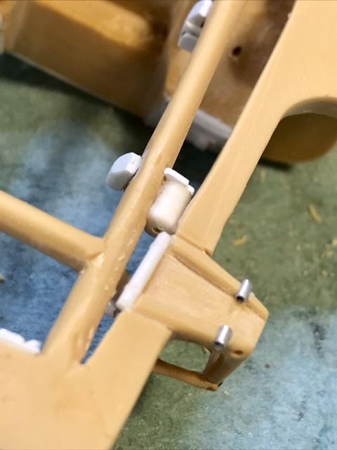

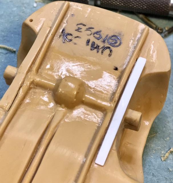

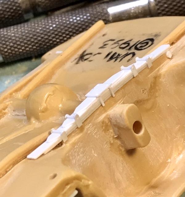

absmiami Posted June 8, 2023 Author Posted June 8, 2023 I Commited to using the base plate w/out major mods - but i decided to make the rear leaf springs - fr Evergreen .015 x .100 strip and Plastruct .015 rod … 2

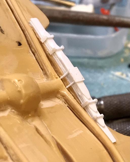

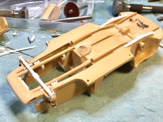

absmiami Posted June 11, 2023 Author Posted June 11, 2023 Made some Houdaile dampers - these link to the lower susp arms - and braces for the radiator …

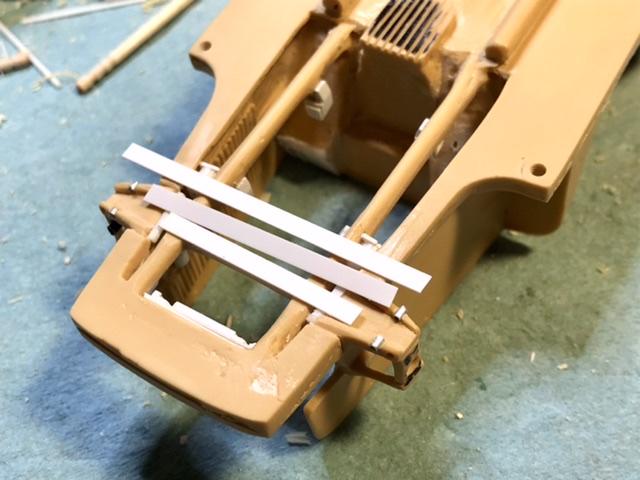

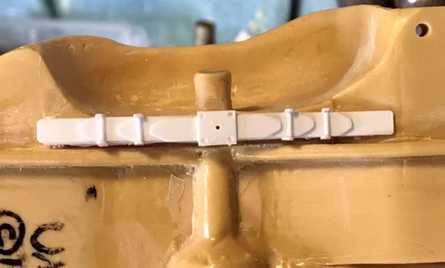

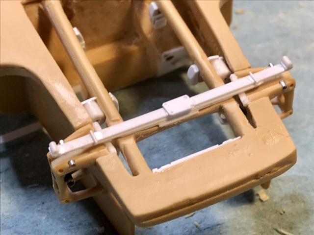

absmiami Posted June 11, 2023 Author Posted June 11, 2023 While laying out strips of Evergreen for the front suspension transverse leaf spring - i realized that that the strips were too wide …
absmiami Posted June 11, 2023 Author Posted June 11, 2023 So those went back into the package and i reached for some .080 x .015 strips - actually should use .010 - but using the thicker strips for ease of assembly …

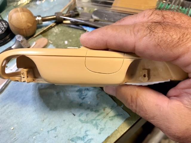

absmiami Posted June 12, 2023 Author Posted June 12, 2023 Sanded back the thick base plate - so it won’t be visible once the body is on … 1
absmiami Posted June 12, 2023 Author Posted June 12, 2023 And made 2 shackles to locate the pins on the transverse leaf spring … think its time to do some hinges … is Monday a national Holiday in Italy ? - or does everyone go to work with a hangover ??

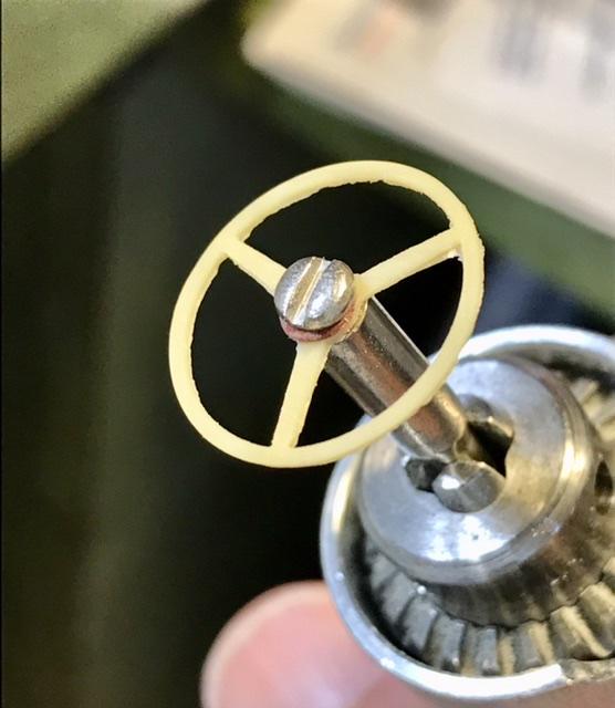

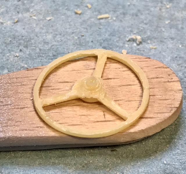

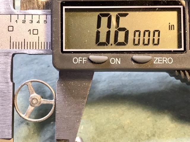

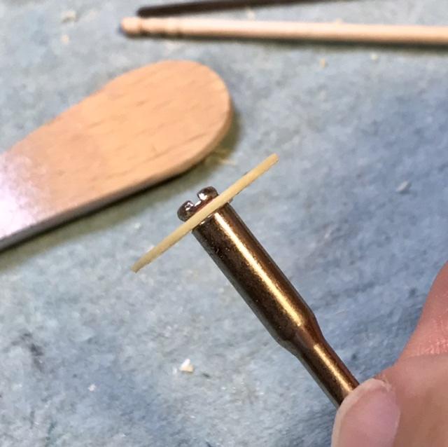

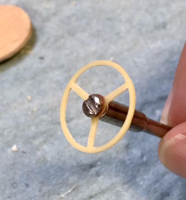

absmiami Posted June 13, 2023 Author Posted June 13, 2023 Gracias - before the hinges there is the matter of the steering wheel - the kit wheel is white metal and measures 15 scale inches across - that’s a problem …
absmiami Posted June 13, 2023 Author Posted June 13, 2023 Most sports cars of this era had larger steering wheels - 16 or maybe 17 inches … barchettas included

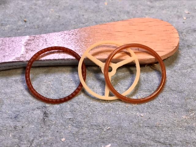

absmiami Posted June 13, 2023 Author Posted June 13, 2023 Profil24 makes a nice photo-etched sports car wheel that is the correct size - but the spokes aren’t quite right for the Ferrari …
absmiami Posted June 13, 2023 Author Posted June 13, 2023 Fernando Pinto has a resin cast wheel in his early Ferrari kits that has the correct 12 - 4 - 8 shape and the right size …
absmiami Posted June 13, 2023 Author Posted June 13, 2023 But - the casting is not super crisp - i’m shaping it using my Fordom drill to sand it as thin as I dare - got the rim under .030 - so its fragile …
absmiami Posted June 13, 2023 Author Posted June 13, 2023 But the Profil24 wheel kit surrenders its wheel grips - which are a perfect size - and feature the finger grips on the back side - once glued together - the assembly will be reasonably strong …

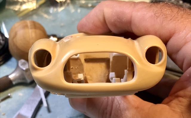

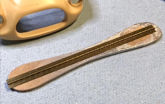

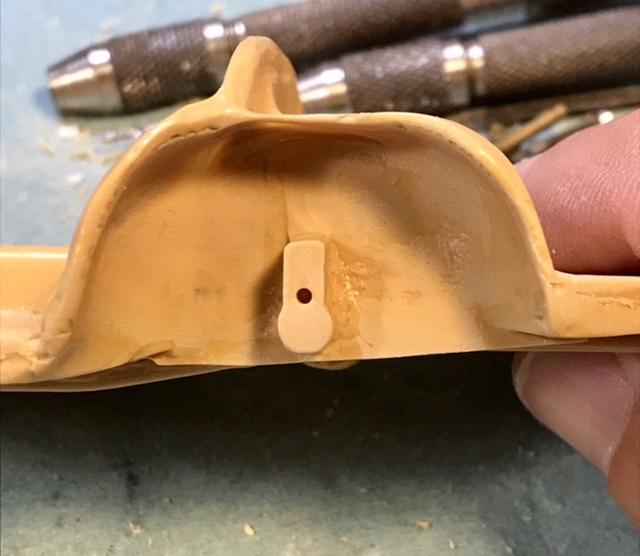

absmiami Posted June 17, 2023 Author Posted June 17, 2023 (edited) Now to the bonnet hinges - this is a doll house accessory brass hinge that I’ve had for years - haven’t searched for one recently - mite find one in ETSY ?? Dunno … Edited June 17, 2023 by absmiami
