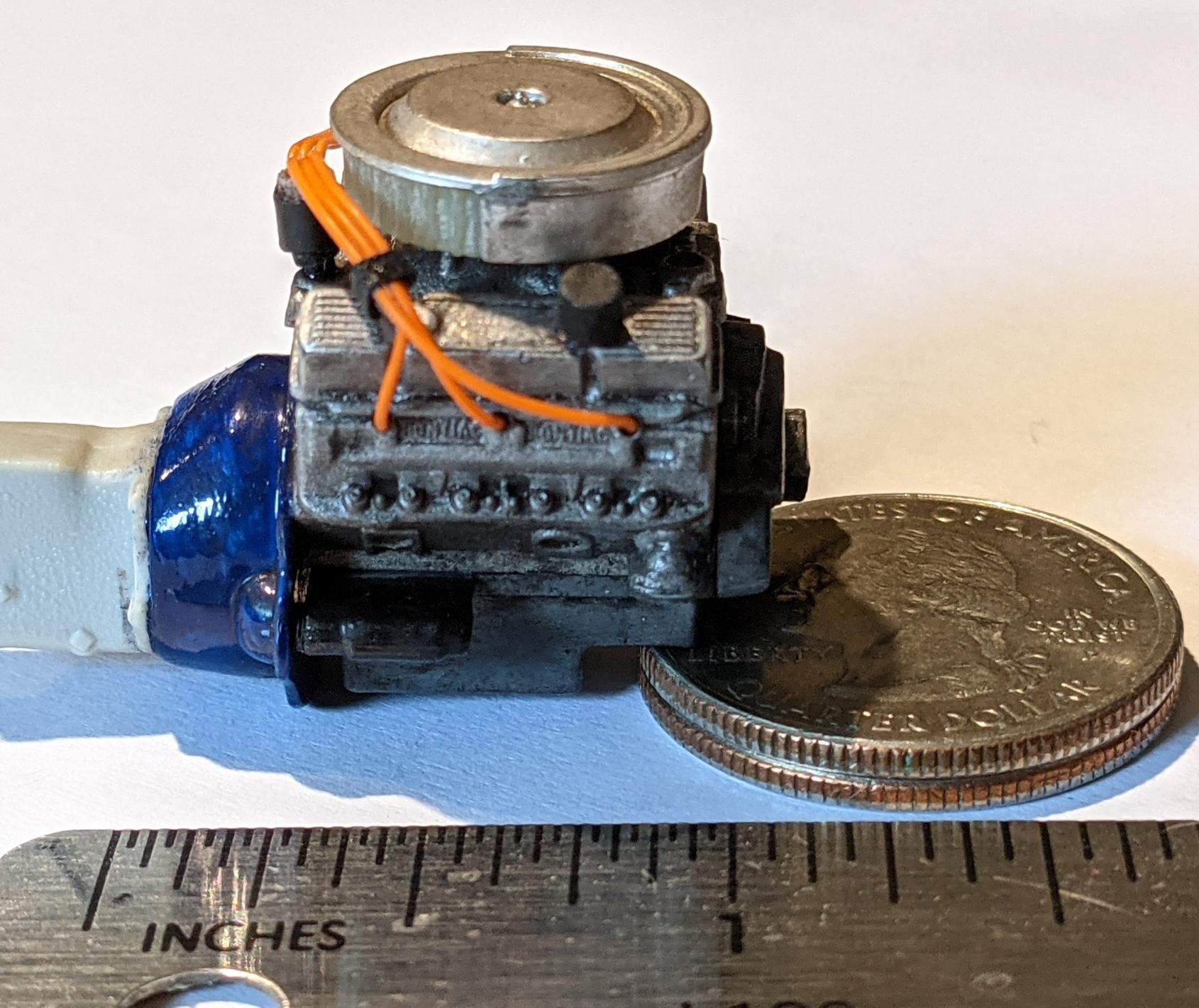

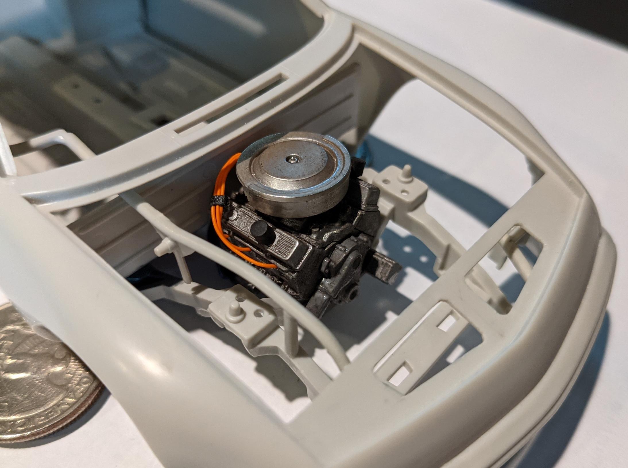

'70 Grande Posted November 12, 2021 Posted November 12, 2021 (edited) Vince, Hopeful these pics might help you some. I started the same 1990 BGN Pontiac project a few years ago and the following pics will show you just how far I got. I am using the 1/25 AMT/Ertl 1990 Pontiac Grand Pix Nascar kit for this build... here's a brief description of how I downsized that kit's Nascar V8 to a BGN V6. I started by gluing together the engine block halves, and then I cut the engine block at the centerline on the side. I did this same cut for the heads and valve covers, too. I wish I could remember how much I cut-out to equal one bank of cylinders, but I'm hopeful the ruler showing in these pics will guide you to where I ended-up at length-wise. I cut/shortened the oil pan just ahead of it's deeper section; if you look closely at the 2nd pic, you can see a small nick in the edge of the oil pan which is the cutline's location. I also planned my build to be an after-the-race, short-track race car, so I've weathered the engine to represent that. Edited November 12, 2021 by '70 Grande 1
'70 Grande Posted November 12, 2021 Posted November 12, 2021 Next, I glued the cut-down/reassembled heads and valve covers to the block. I modified the intake manifold by cutting it down in two places, (1st: taking-out a small-section between the radiator hose hole-opening and the front of the intakes and a 2nd: in the same location right in front of the distributor mounting hole). These 2 cuts kept the intakes into the heads pretty-much "as is" from the V8... probably not correct for the 1:1 world, but the air cleaner covers-up so much of that intake manifold anyway that I don't think it really matters. By weathering this engine, I think it'll hide some of the imperfections in this cut-down V8. The following pics will show you how it will look from the front view and also inside the kit's frame/body.
