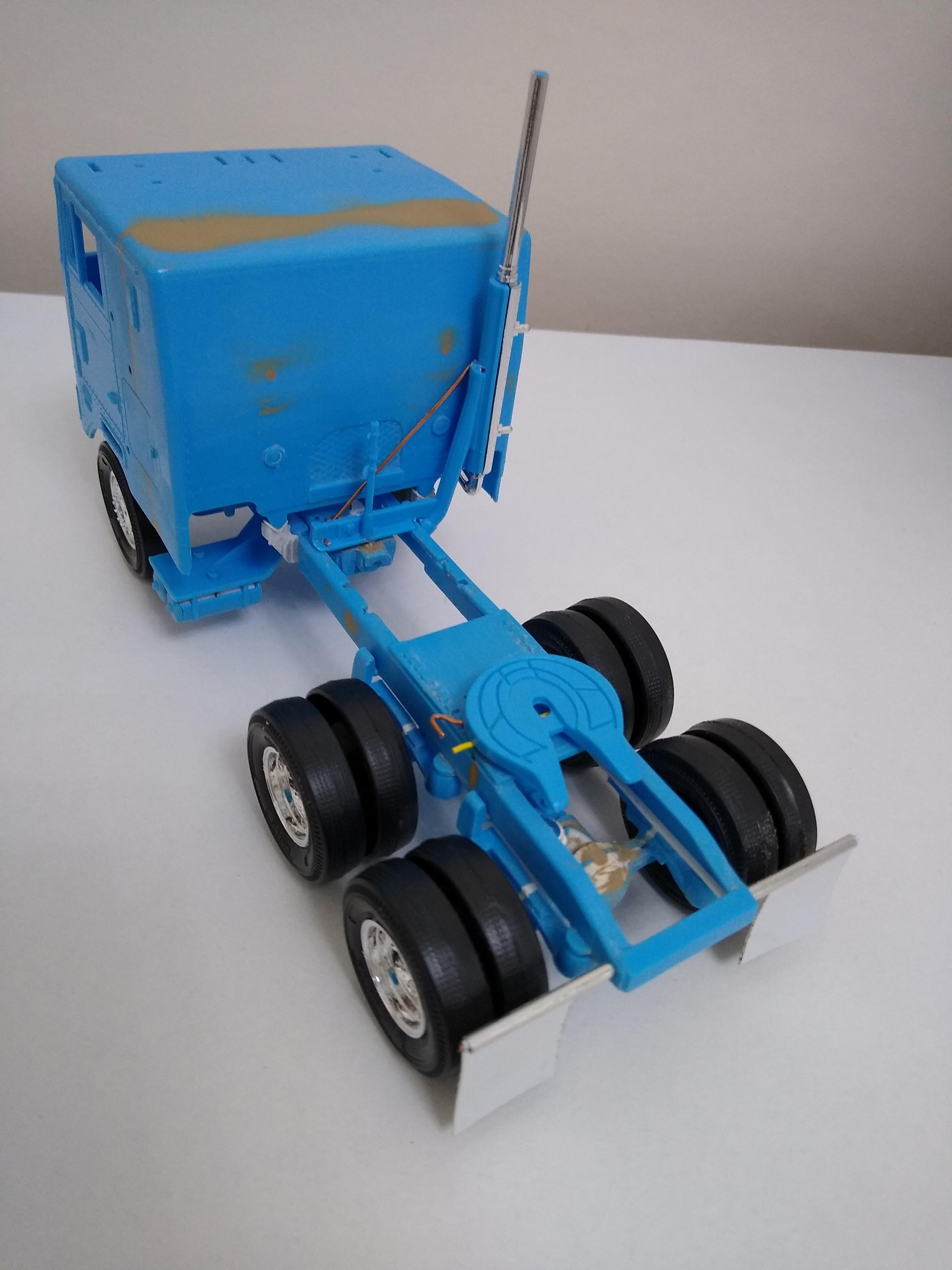

Rockford Posted November 15, 2021 Author Posted November 15, 2021 Did a little bit more yesterday. The first time I built this kit was in full lockdown in the first wave so I could only work with what I had, and that was one rattle can of white about 10 years old. Tried improving things over that build. The steps are shallow depressions so I opened them up and put a piece of offcut behind them, just to add depth. Looks a bit better. Moved the fifth wheel back a little. Then I removed the deck plating from behind the fifth wheel and cut 33mm out of the frame. My brain was screaming WHAT ARE YOU DOING!? but it was right according to the sums I did so hopefully it will work out.
Rockford Posted November 15, 2021 Author Posted November 15, 2021 Glued the two chassis pieces together, always a worry making sure that the thing is straight. Took the saw to the driver's side exhaust mount and rigged a new diagonal brace out of copper wire. I've got about three weeks of filling and sanding on the cab and the chassis now. This is going to be a real chunky monkey. 1

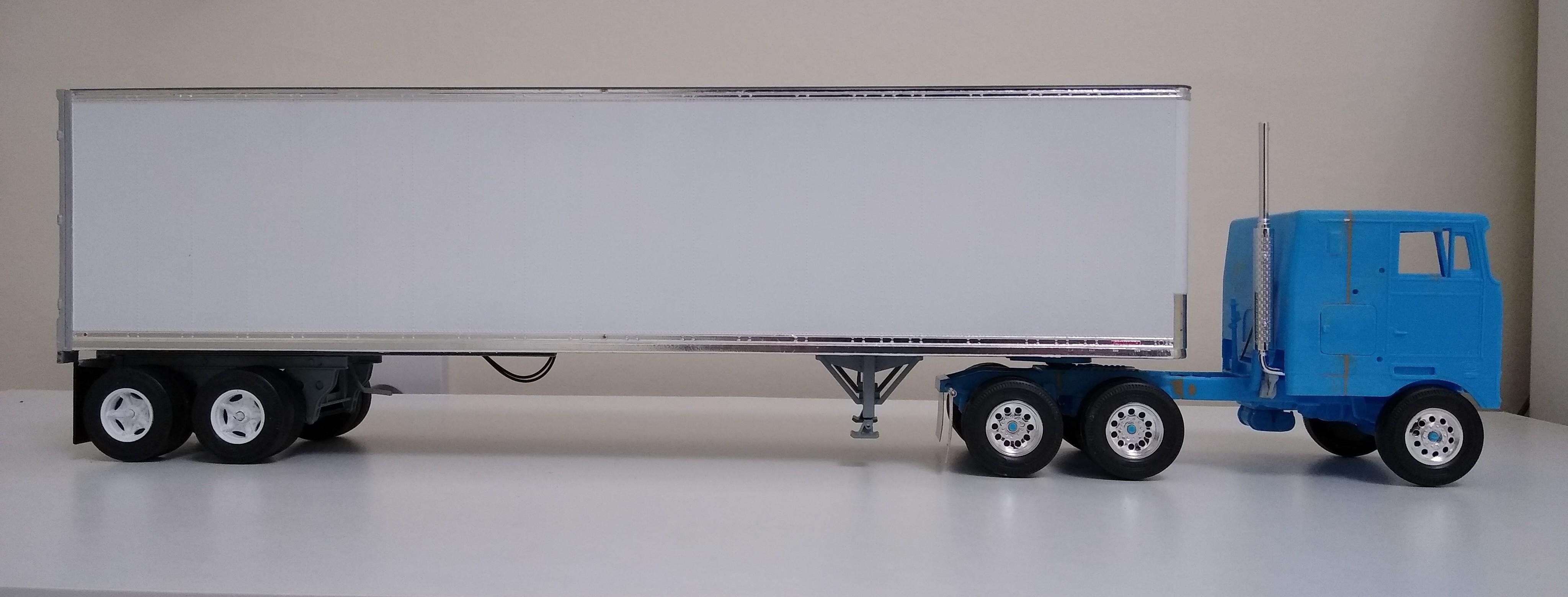

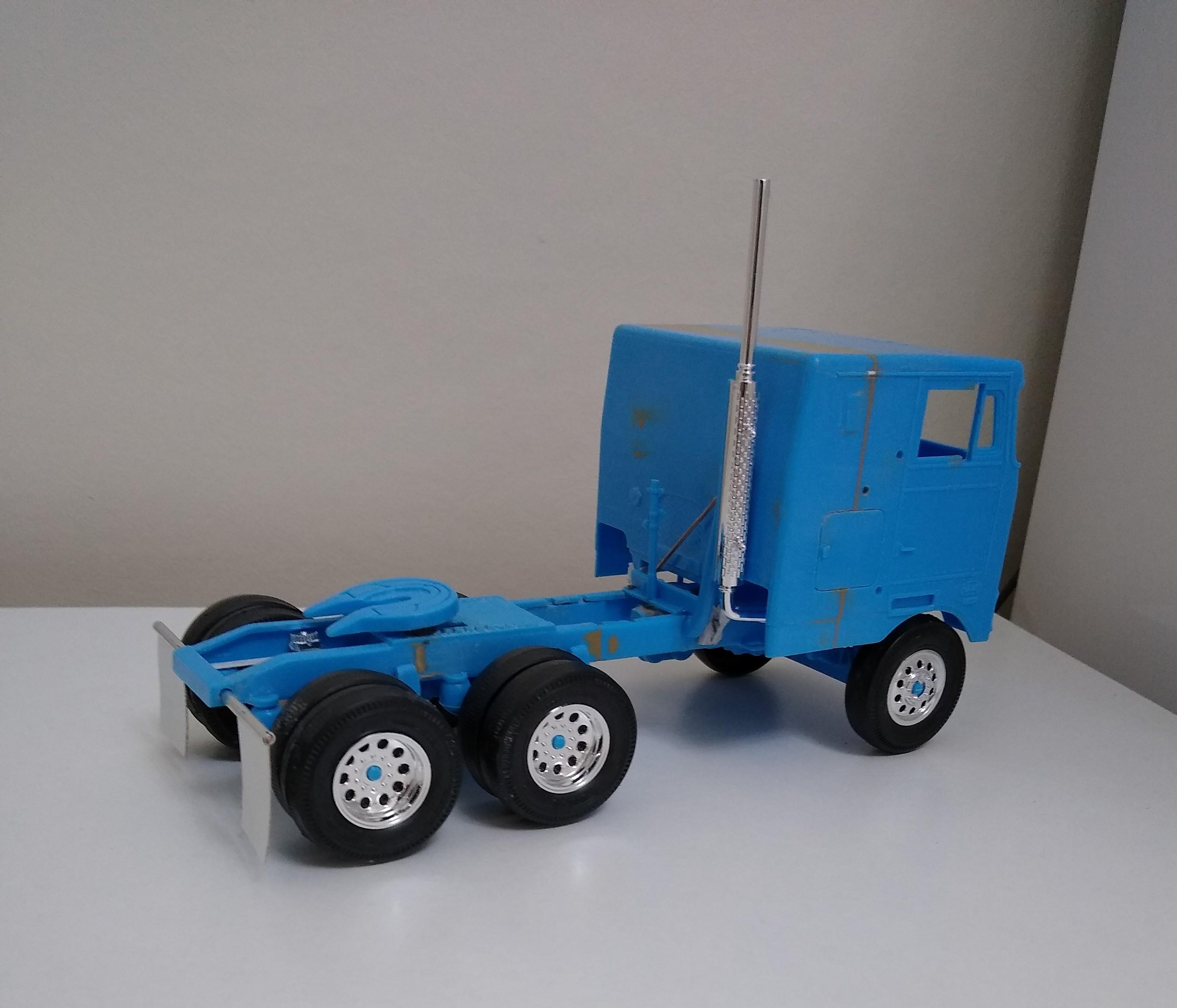

Rockford Posted November 16, 2021 Author Posted November 16, 2021 I can't resist a mock-up but I felt I had to this time to determine trailer clearance. I popped the axles and wheels on. Couldn't resist making my mudflaps too. Sat her next to her bigger sister for comparison.
gotnitro? Posted November 16, 2021 Posted November 16, 2021 This is a really sharp truck ! Very clean work Love the side by side shot w big sis

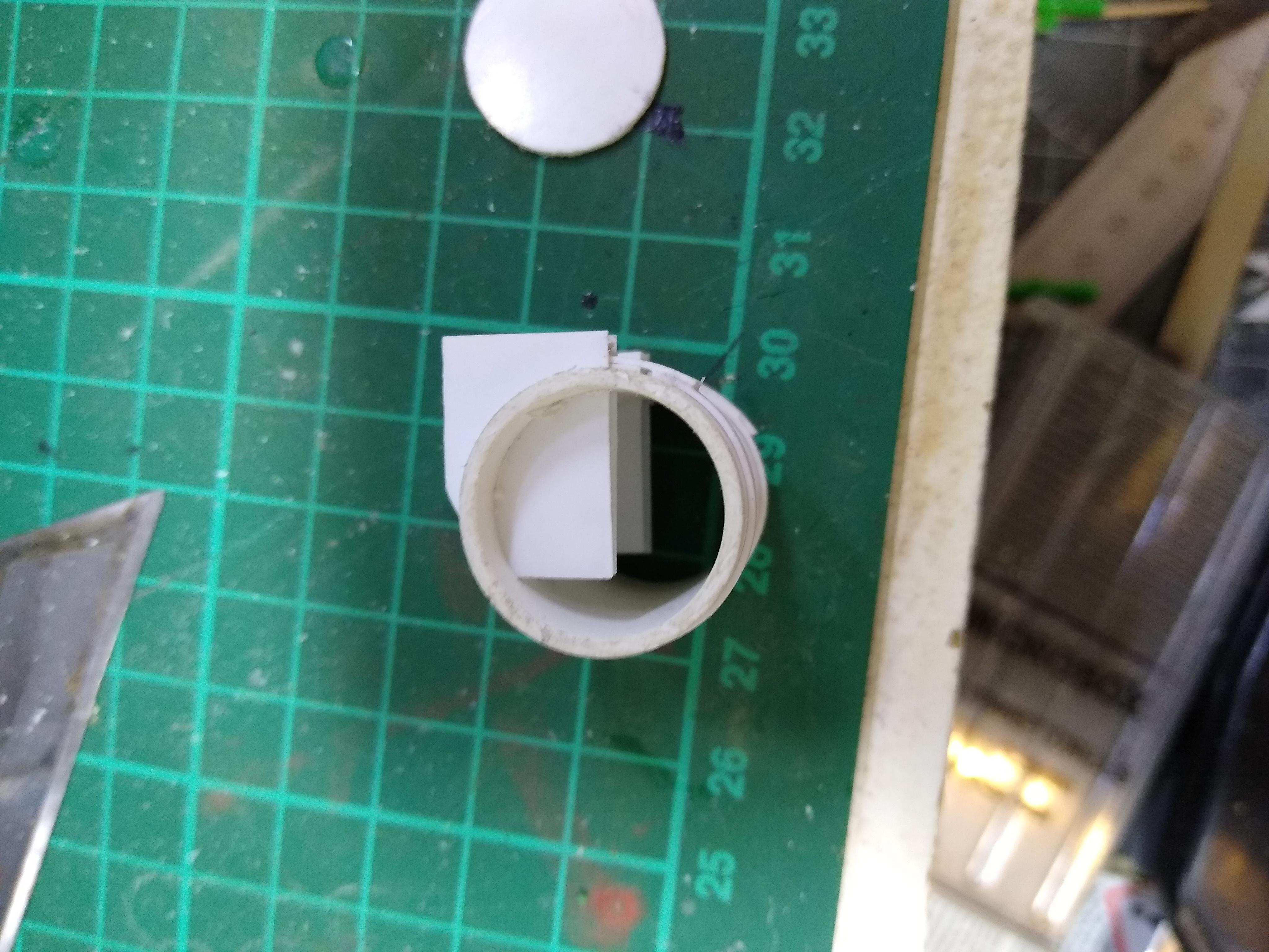

Rockford Posted December 4, 2021 Author Posted December 4, 2021 I'm plodding on with this. Added slack adjusters and S-cams for the rear brakes, also turned some brake chambers to install later. Cut out and shaped some brackets for the rear suspension mounts on the chassis. Fitted rear shock mounts and made shocks out of aluminium tube that telescope like a real shock. I'll mount after paint. Bought some 20mm round electrical conduit to use for fuel tanks and made two up. Now drawing up brackets to cut out to support them. Filled the join on the cab and left it for a week before sanding it because it seems to shrink over a few days. Seems to be better this time.

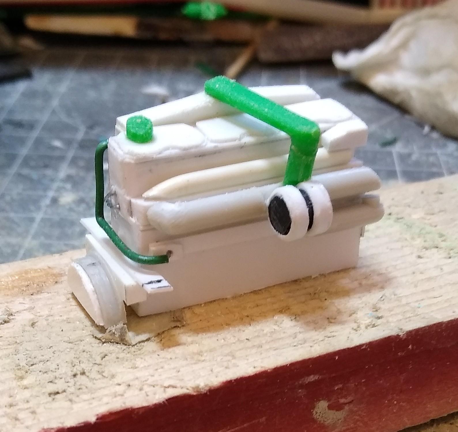

Rockford Posted December 11, 2021 Author Posted December 11, 2021 (edited) As you'll see in other pictures the cab of this kit has a solid "mesh" in the doghouse opening to hide the empty engine bay. I wanted this gone to give a more realistic appearance but this left me with a dilemma. How to solve the problem of the empty "powerbarn". So, I made my own Cummins. Two plastic card boxes on top of each other to imitate the block, heads and narrower rocker boxes. Then I made an aftercooler from square rod and sprue. Rocker covers and timing cover from card. Then assorted sprue and rod to make the oil cooler, compressor, fuel pump, exhaust manifold, turbo, charge air cross over pipe, thermostat housing, breather and added some plumbing for coolant, fuel and air and it looks great. I'll use my old friend Chubby Sprue to make some trunking from the airfilter and to the exhaust. I know some of the scratch building on here would put me to shame but I don't think this is too bad for a few hours' work. Edited December 11, 2021 by Rockford Added pics
Jim B Posted December 11, 2021 Posted December 11, 2021 Looks pretty good, Stephen. It fills the void under the cab.
Rockford Posted December 11, 2021 Author Posted December 11, 2021 (edited) Thanks mate, I think it will look good with a coat of Cummins beige. I've not done the front end details because you're never going to see them. Just the back end. Edited December 11, 2021 by Rockford

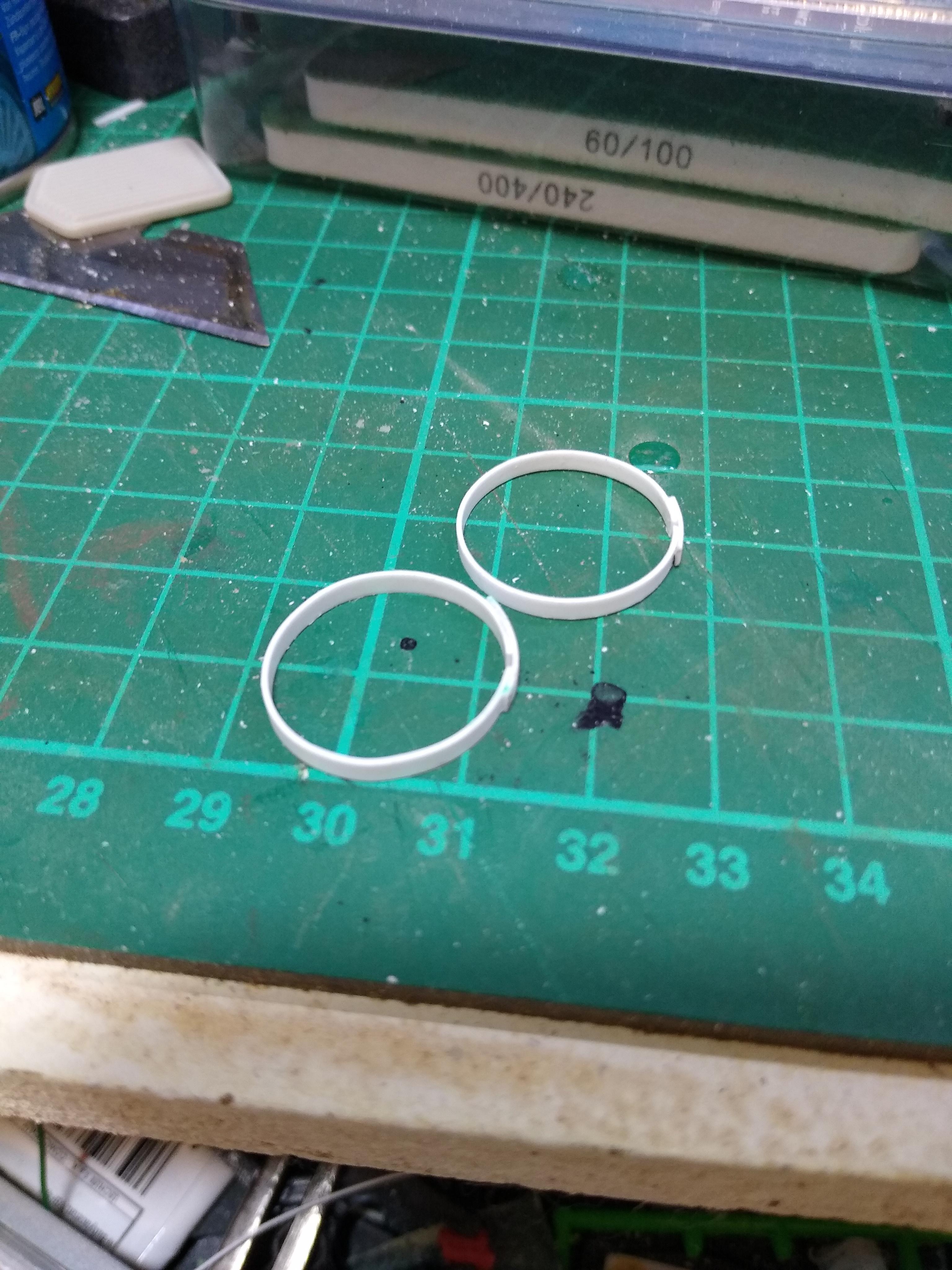

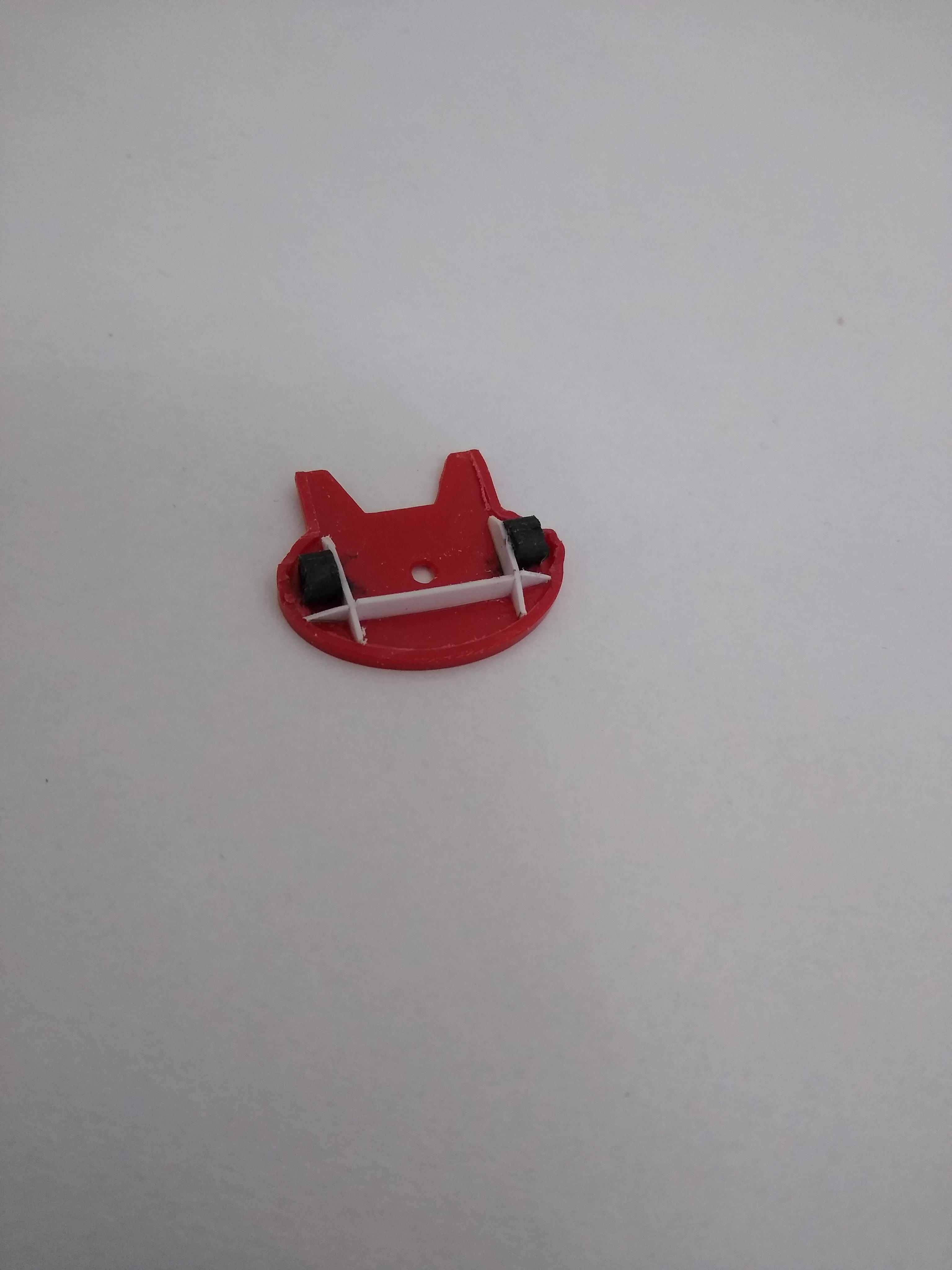

Rockford Posted December 18, 2021 Author Posted December 18, 2021 I intended to work on my fuel tanks today but when I looked at the brackets I'd drawn up out of plastic card I thought they'd be very fragile once I'd cut them out. I needed a sturdier solution. Then I had a moment of brilliance! I carefully cut out slots in the tank where the brackets would meet the tank. Then I fashioned tank straps out of plastic card. I glued a bracket each side of some 2.5mm square rod to form a hollow bracket, then slid the brackets into the slots either side of the installed straps. I think they look great. Need to fill the ends and tidy up, then fashion some tank caps. I mocked them up and they look right. I also wanted to use the Holland fifth wheel from an AMT kit. It's very bland and too thick so I filed it down and added some of the bracing underneath for a better appearance.
Jim B Posted December 18, 2021 Posted December 18, 2021 Great job on the fuel tanks & 5th wheel. Are you planning on filling the holes in the 5th wheel plate?
Rockford Posted December 18, 2021 Author Posted December 18, 2021 It's on the list Jim. A rather long list at the moment but it's all interesting stuff. I had to remove the exhaust support and rework it so that it will fit inside the tank bracket. I'll get there.
