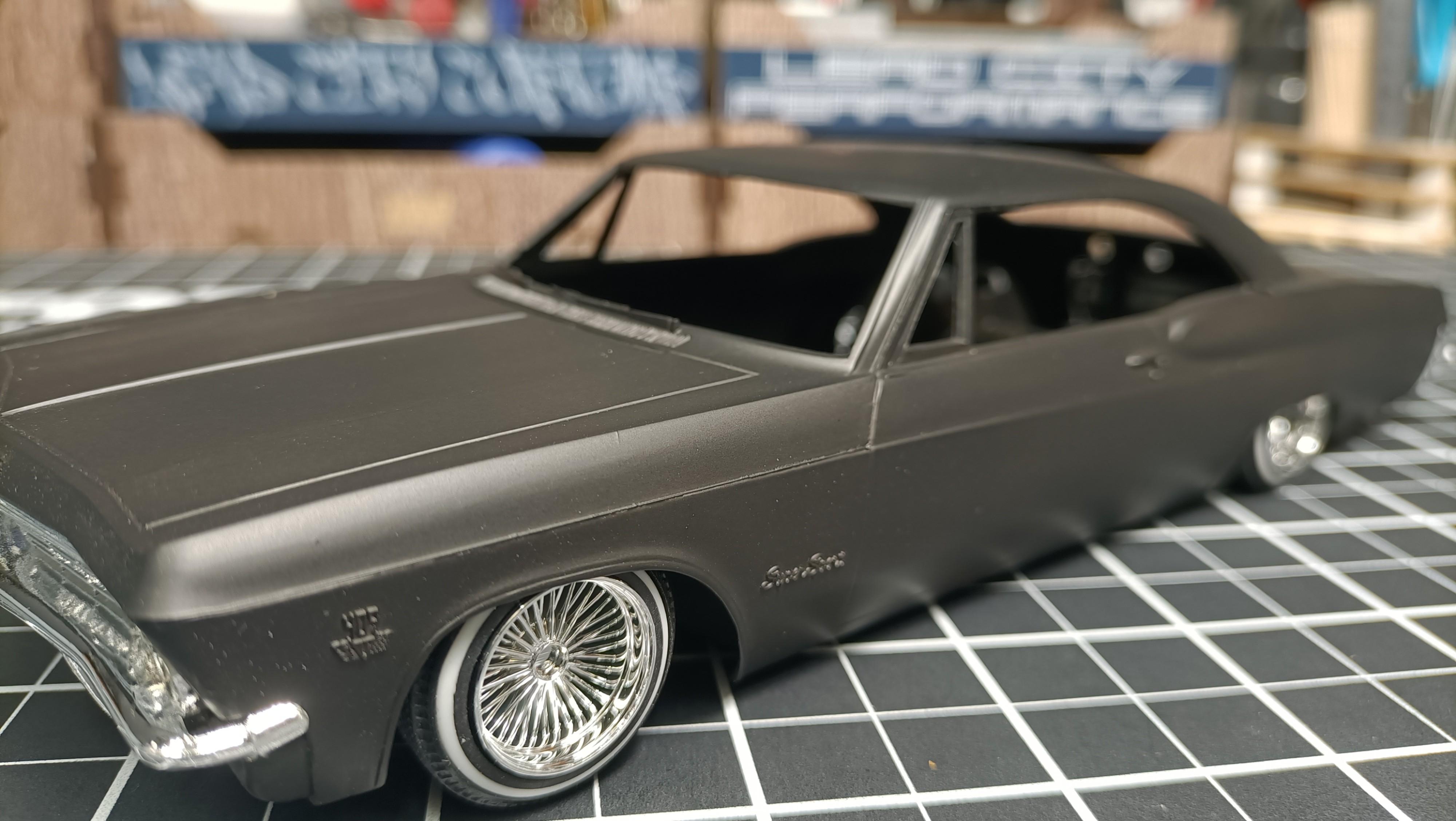

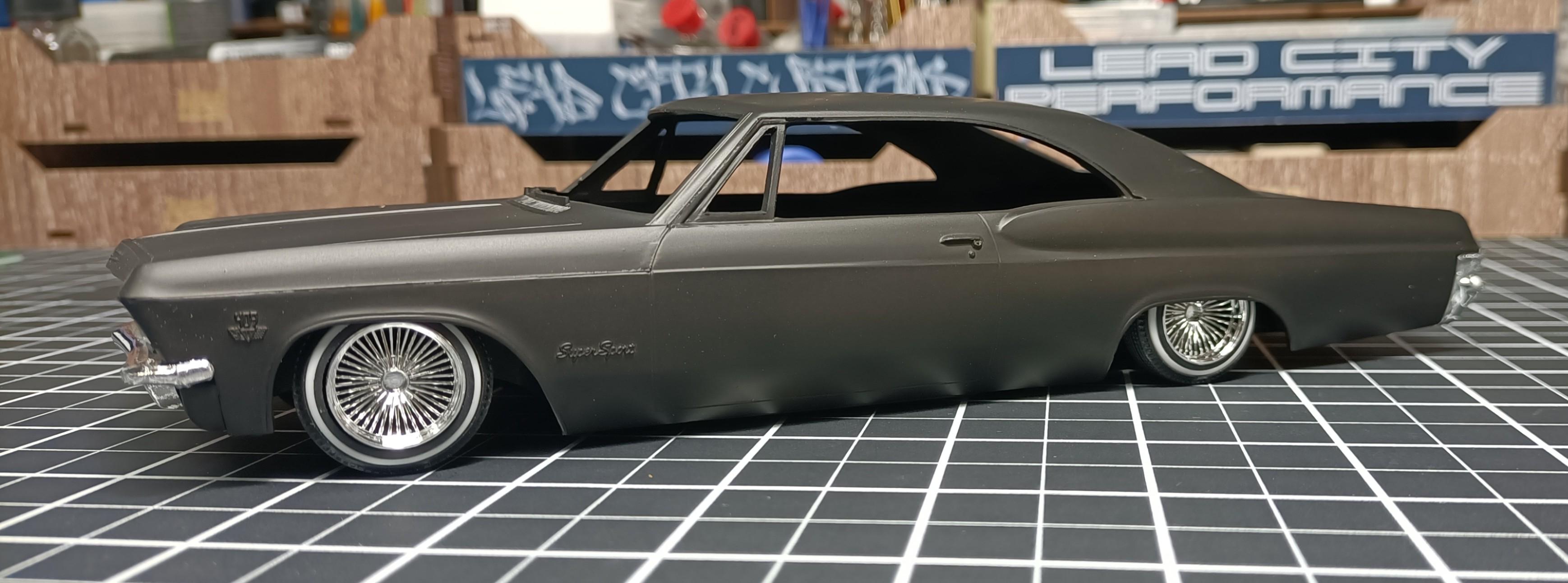

While I wait for the surfacer to dry/cure on the Skyline, I got the 64 Malibu back on the bench to see if I can get it completed, not much to do just BMF and final exterior detail work.
  • Like 2
