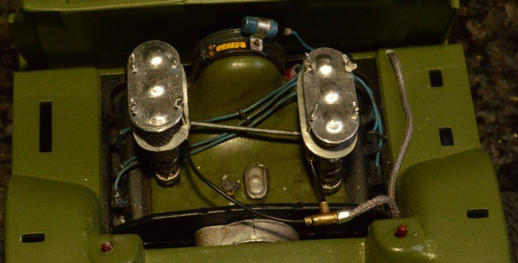

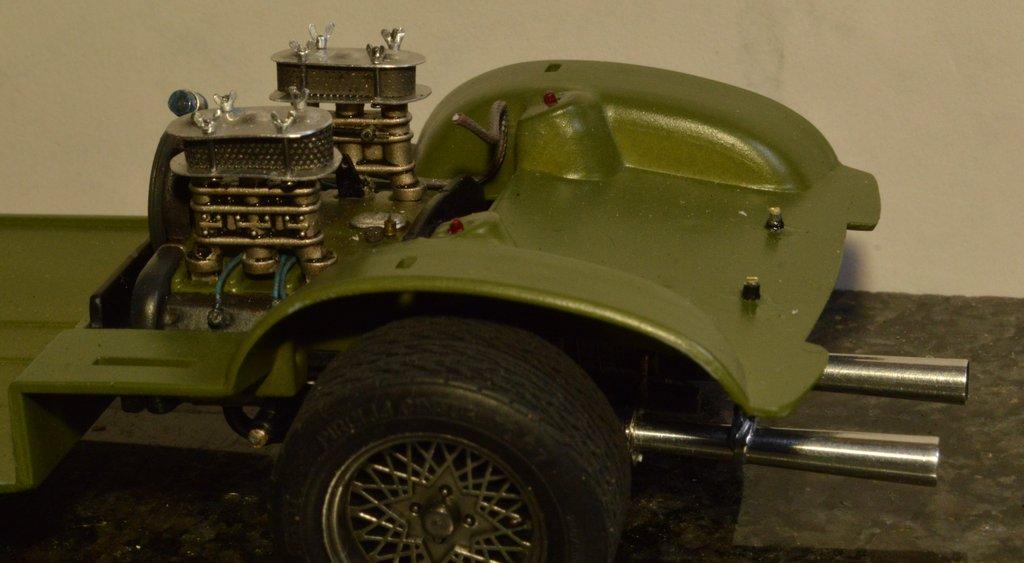

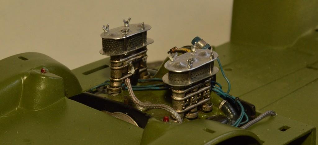

Straightliner59 Posted September 28 Author Posted September 28 I got the other air filter unit assembled. Not much done, beyond that. Work is proceeding on...Thanks for looking! 1

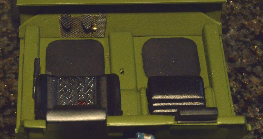

Straightliner59 Posted October 1 Author Posted October 1 The interior floor unit is painted. I got the fuel lines installed. They're not close to perfect, but, they'll be tucked behind the rear bulkhead area thingie, never to be seen again! Next, after the seat's painted, I have to scratch up one of these harnesses. The friend I'm building this for has a little dog, and, she's gonna be riding along, I would assume. She might as well look like a racer. It doesn't look particularly comfortable, but, it looks about as safe as it could be. These pooches don't look thrilled!😂 Anyway...Thanks for looking! 2

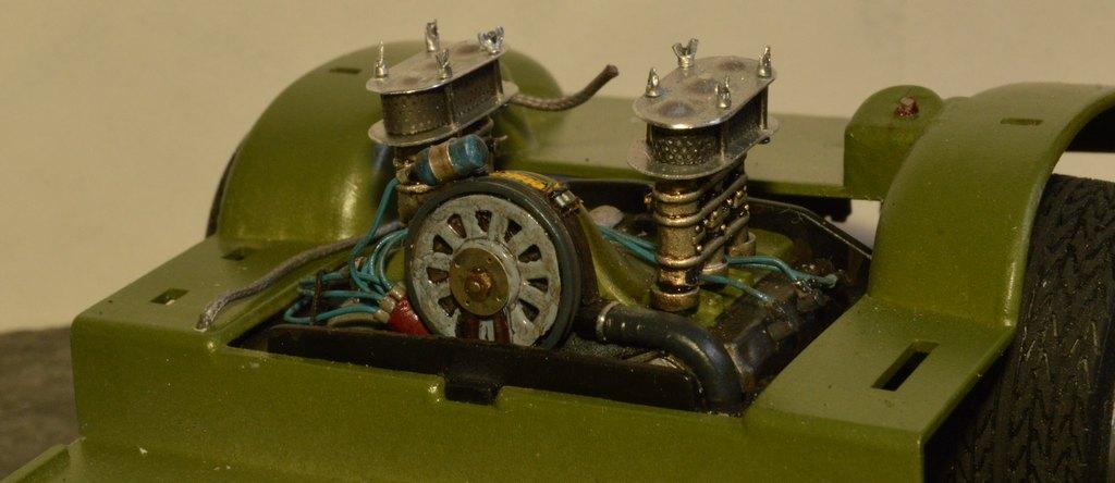

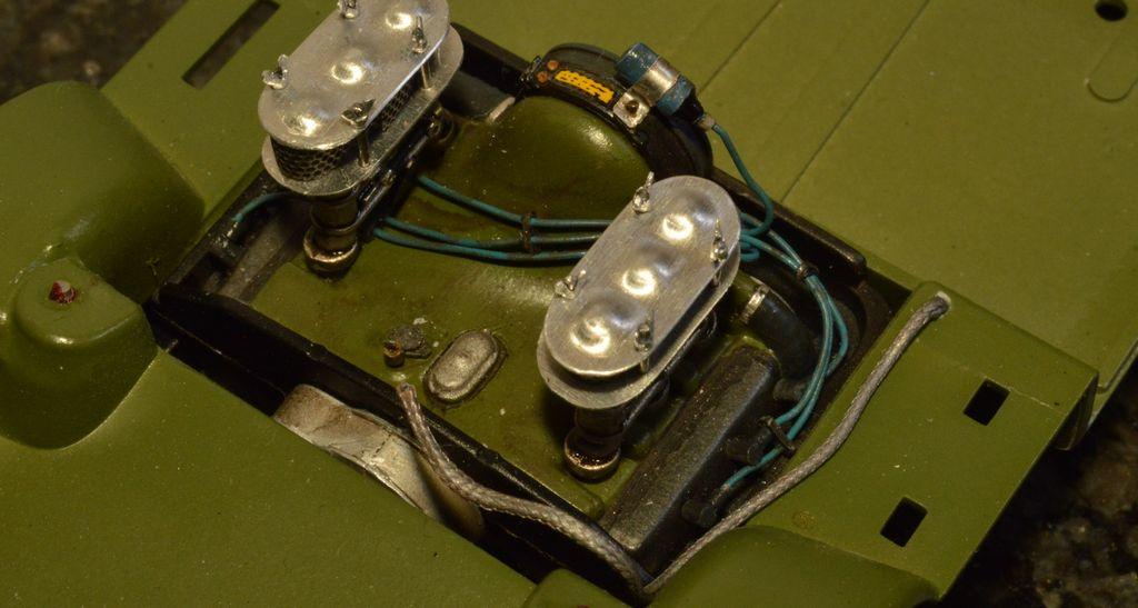

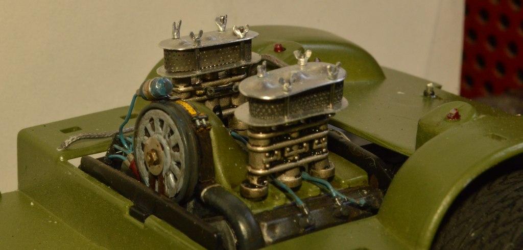

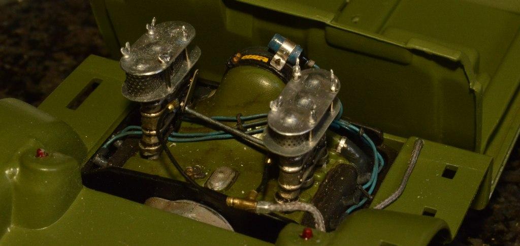

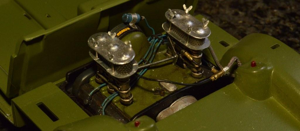

Straightliner59 Posted October 7 Author Posted October 7 (edited) I discovered that the air cleaners were too tall for the engine cover to shut. I remembered watching Doug Whyte building his Monogram 904 for the 24 Hour Build, one year, and topping the carbs with screens he punched and domed. I had tried it with woven screen, but didn't care for the result, so, I went with this auto-trans screen. Not too shabby, and the lid will close, now! Next, I dealt with the battery. I found a kit battery (because it already fit, just needing a bit of cleanup, I opted to use it, rather than scratch one), then cleaned it up and added the top details from Evergreen strip. The terminal posts are .030 fly-tying wire (lead free, of course!😀). I made the terminals from 1mm aluminum tube. Cables are from a roll of something I bought, online. I made the tray from flashing, the hold-down post from a .023" brad, and the hold-down "strap" from wire. I was determined to use at least one wing nut, on this thing, so, here we are! Thanks for looking! Edited October 11 by Straightliner59 5
BK9300 Posted October 7 Posted October 7 Not fun, with your air cleaners and all that work! Hope you get to recycle your wingnuts - they were a good part of that work. Really like the battery detail workup, too.
Straightliner59 Posted October 8 Author Posted October 8 18 hours ago, Mark W said: Great detail……getting ideas for my 911 project. Thanks, Mark! Looking forward to seeing that! 14 hours ago, BK9300 said: Not fun, with your air cleaners and all that work! Hope you get to recycle your wingnuts - they were a good part of that work. Really like the battery detail workup, too. Thanks, Brian. Both of the air filter assemblies are in my display case, currently. Hmmm...they'd work out, nicely for a Porsche-powered Bug. The clearance could likely be found, there. 1

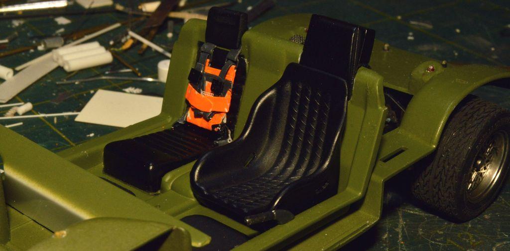

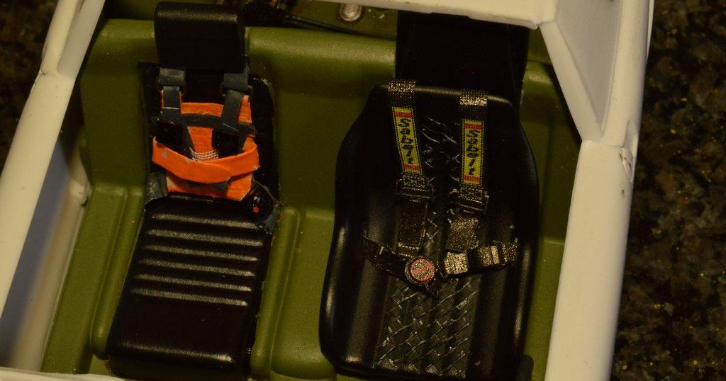

Straightliner59 Posted October 12 Author Posted October 12 Except for a bit of touchup, although it isn't a perfect replica of the one above, the pooch pouch is done! Not too bad, I reckon. I used kitchen parchment soaked in diluted white glue, for the main part of the assembly. The straps are my typical wine bottle foil, as are the lap belts. The mesh carrier is a tiny bit of a bag that must have come from some long-ago wedding. It appears to be one of those they put rice or bird seed in. I dry brushed the mesh withsome Humbrol off-white naval color. Thanks for looking! 3

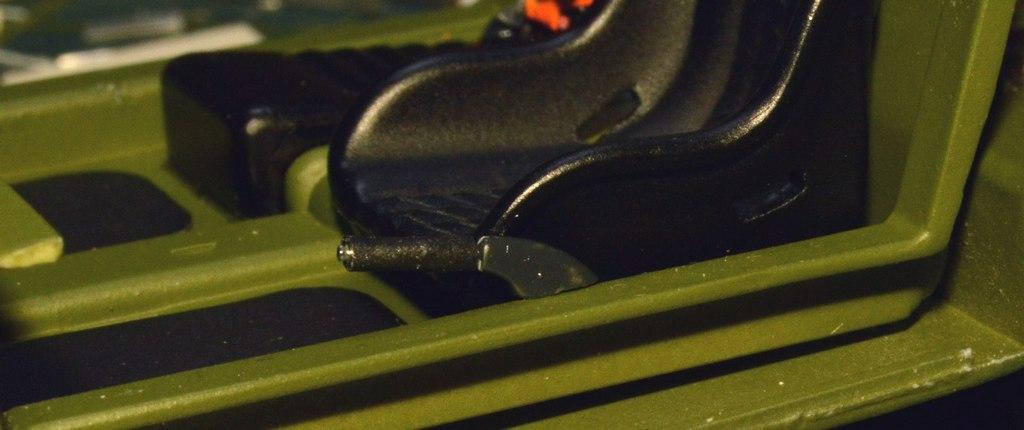

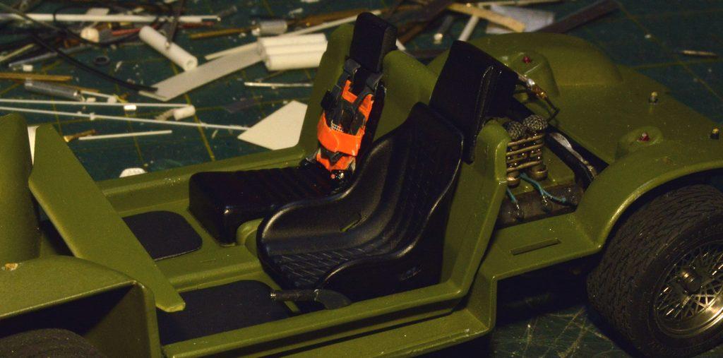

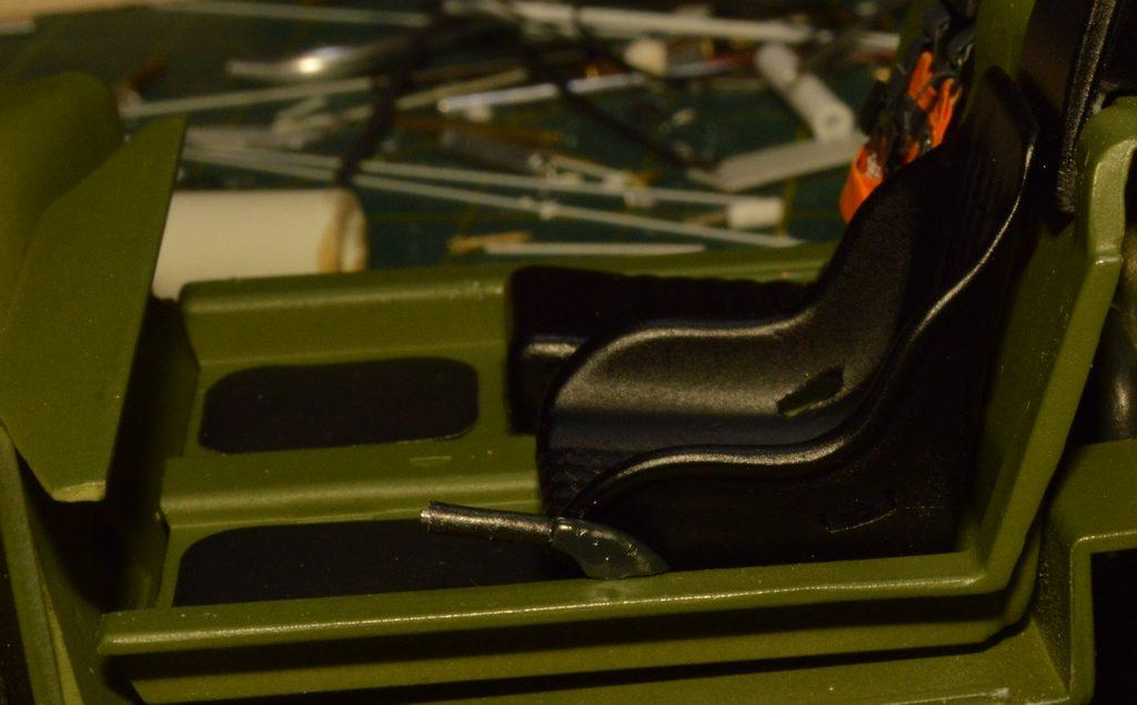

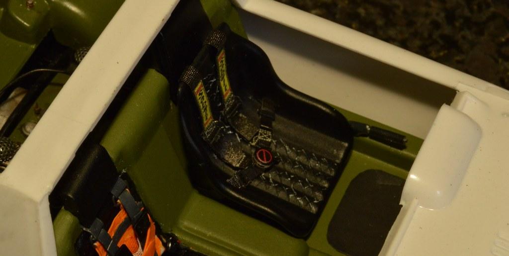

Straightliner59 Posted October 19 Author Posted October 19 I got the driver's side headrest installed. I don't even see it, in the instruction sheet. Also, I couldn't find a back, for it, even though it has receivers for pins, for one. I made that from Evergreen strip, then cleaned it up, and sanded the headrest, so that it would fit into the space it's supposed to. Finally, I shot it with Krylon Satin Black. I drilled and filed openings in the seat bucket, for the harness, and painted that the same. I'll be using a set of Eduard Sabelt harnesses. Also, I carved and sanded a base for the hand brake from Evergreen. The handle is wire insulation, while the shaft is some Christmas tree ornament hanger wire. Revell mounted it in the wrong place, compared to the real world item. Since there's not enough room on the floor, where it belongs, anyway, I glued a tab to the base of mine, and cemented it in Revell's location. I made a pair of floormats from some slightly textured paper, and painted them Krylon Utra Flat Black. As always, your comments, questions and critiques are welcomed. Thanks for looking!
BK9300 Posted October 19 Posted October 19 Zooming in on your pics is always revealing, Daniel - I find things like the ‘button’ on the end of your hand brake! Wonderful detailing. 1
Straightliner59 Posted October 20 Author Posted October 20 17 hours ago, Kanada Kustoms said: Great details! Thanks, Jon! I appreciate your kind words. 14 hours ago, BK9300 said: Zooming in on your pics is always revealing, Daniel - I find things like the ‘button’ on the end of your hand brake! Wonderful detailing. Thank you, Brian! That's the kind of stuff I've always appreciated on other people's models--just little, fun stuff to look at, that I don't notice, right away. Those release buttons are easy! I just drill the handle, and run the shaft through, and finish the end. I'm still considering a new brake handle, at this point--maybe one with a hand grip. I'm also in the process of working out what I am going to do with the pedal cluster. 1

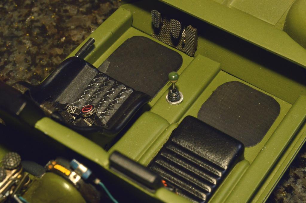

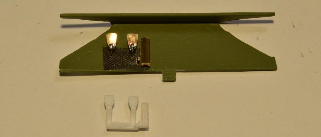

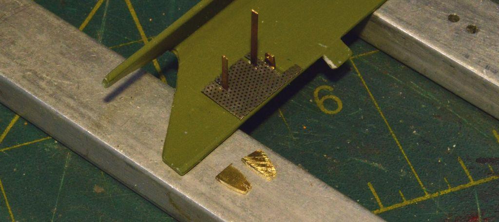

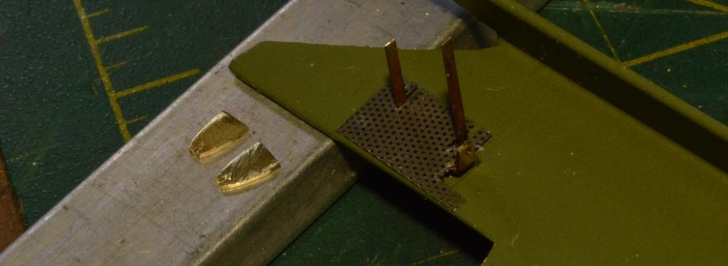

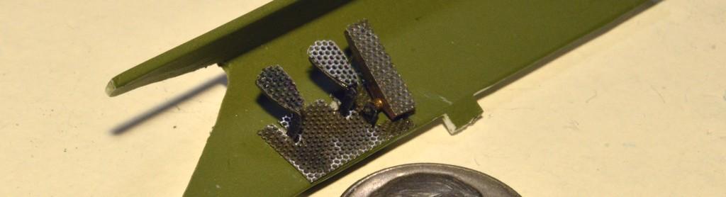

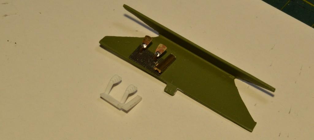

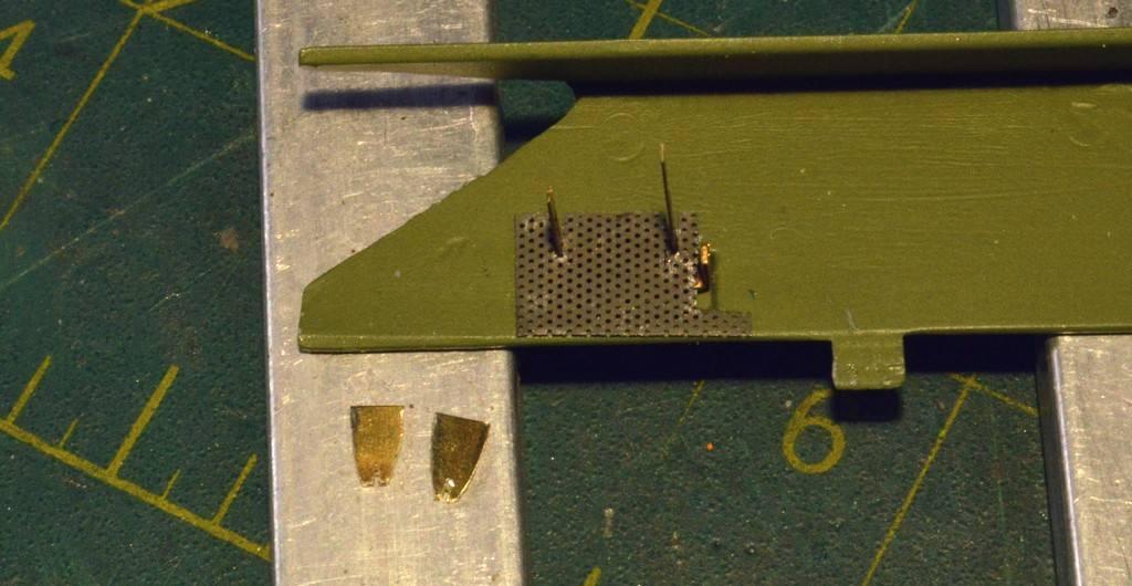

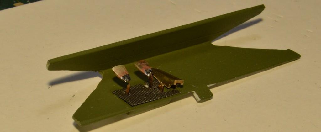

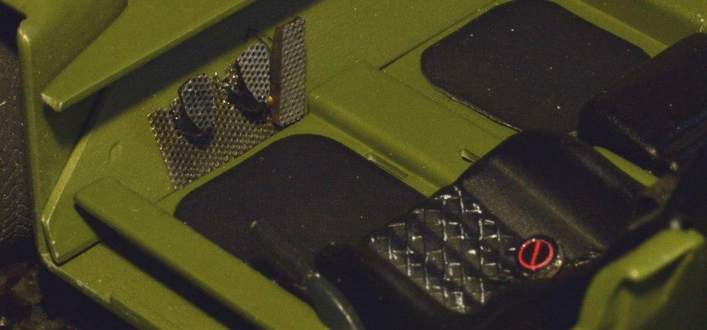

Straightliner59 Posted October 22 Author Posted October 22 19 hours ago, Technics said: Lovely detailing 👌 Thanks, kindly! I've made some progress with the pedal assembly. The brake and clutch pedals are the brass pieces on the aluminum bar. I still need to build the throttle pedal. I found some photos of the perforated plate, beneath them, and liked the look of it, so, I cut up some more of the automatic transmission screen. I am mixed, as to the Eduard harnesses. They're easy to assemble, and, other than their heavy texture, they look nice--I esecially like the stitching. I'm not real keen on their texture/malleability when it comes to posing them--they're stiff, and they feel a tad brittle. I feel like their assembly method will make other harness kits more easy to put together, although that may just be due to their instructions more clearly indicating how to assemble them. Anyway, I still favor my wine bottle foil, for making belts. Questions, comments and critiques are always welcomed. Thanks for looking! 3
Straightliner59 Posted October 24 Author Posted October 24 Pedal assembly coming along. I need to finish the throttle pedal/mount, then clean it all up. Thanks for looking! 1

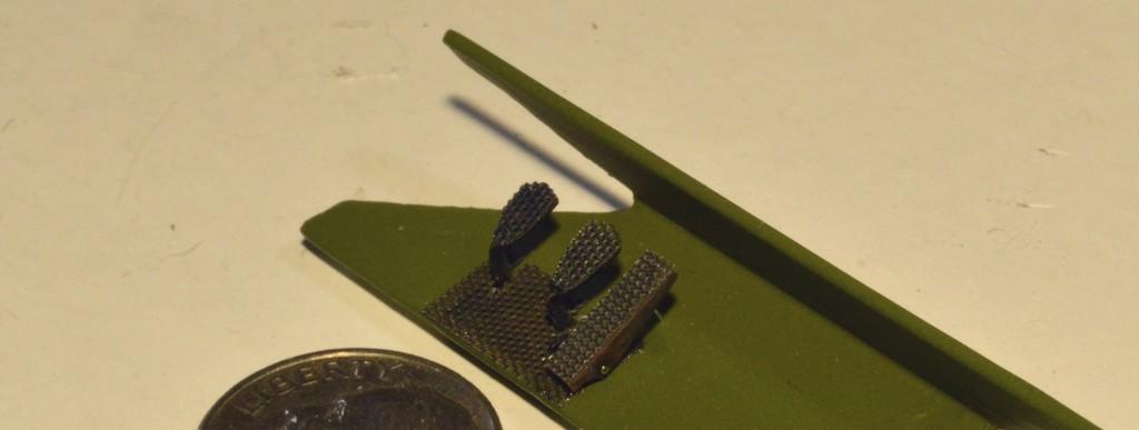

Straightliner59 Posted October 25 Author Posted October 25 18 hours ago, Mark W said: Who needs photo-etched? Nice work Daniel! Thanks, Mark! It's a tad further along, now. Looks like it's gonna work out, okay! 3 hours ago, absmiami said: Yup Thanks, Andy. 1

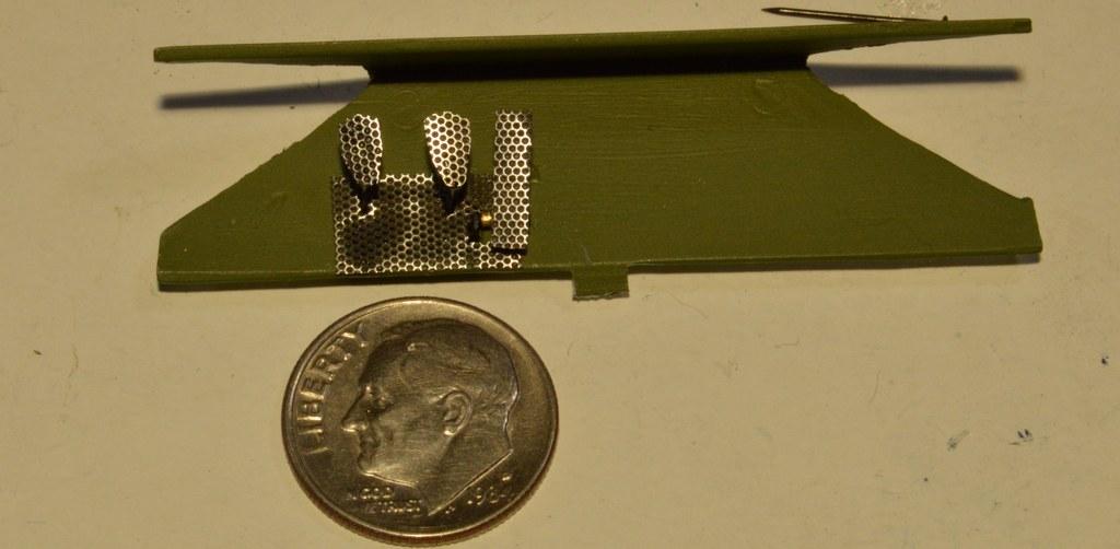

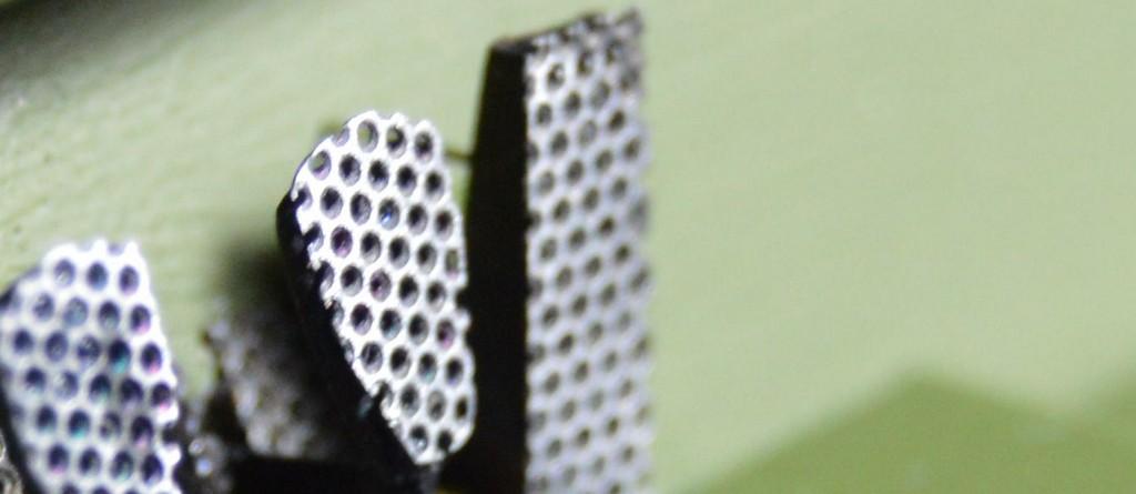

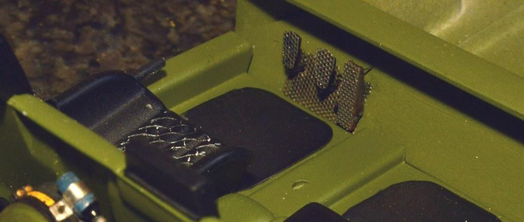

Straightliner59 Posted October 25 Author Posted October 25 I decided to go with perforated pedals, by applying the automatic transmission filter mesh (henceforth to be called "transmesh", for all projects, because "automatic transmission filter mesh" is entirely too cumbersome!). I also just now noticed that sanding/polishing the mesh produces a different look, dependent on which side I do. It all looks a tad sharper than the kit's part, I think! Comments, questions and critiques are always welcomed. Thanks for looking! 1

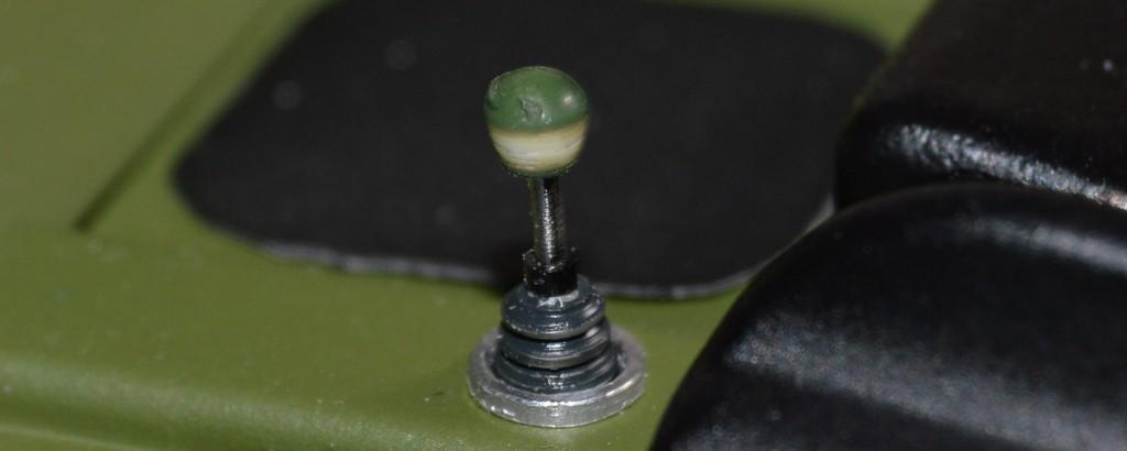

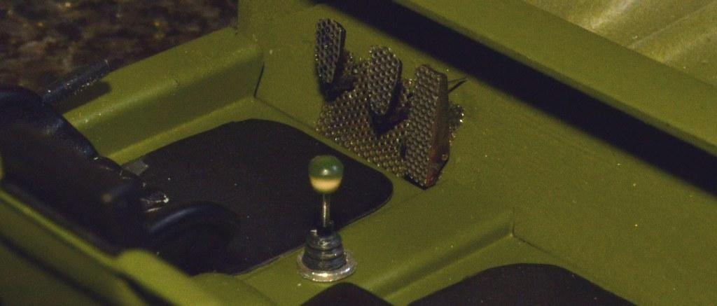

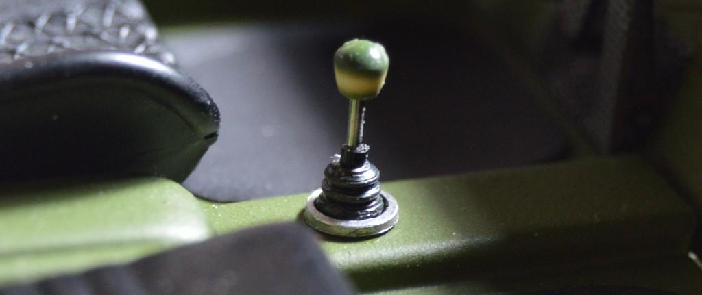

Straightliner59 Posted October 26 Author Posted October 26 (edited) Today's project. I turned the boot on the lathe. The aluminum tube base was just cut, and cleaned up. I found the dark green-headed pin in my selection, and sanded it to shape on the lathe. Next up will be the fire bottle. I had never noticed that the screen had stepped holes, in it. This stuff's pretty cool. Edited October 26 by Straightliner59 4
Mark W Posted October 27 Posted October 27 12 hours ago, Straightliner59 said: Today's project. I turned the boot on the lathe. The aluminum tube base was just cut, and cleaned up. I found the dark green-headed pin in my selection, and sanded it to shape on the lathe. Next up will be the fire bottle. I had never noticed that the screen had stepped holes, in it. This stuff's pretty cool. Wow, the shifter is a model in itself! Nice!
