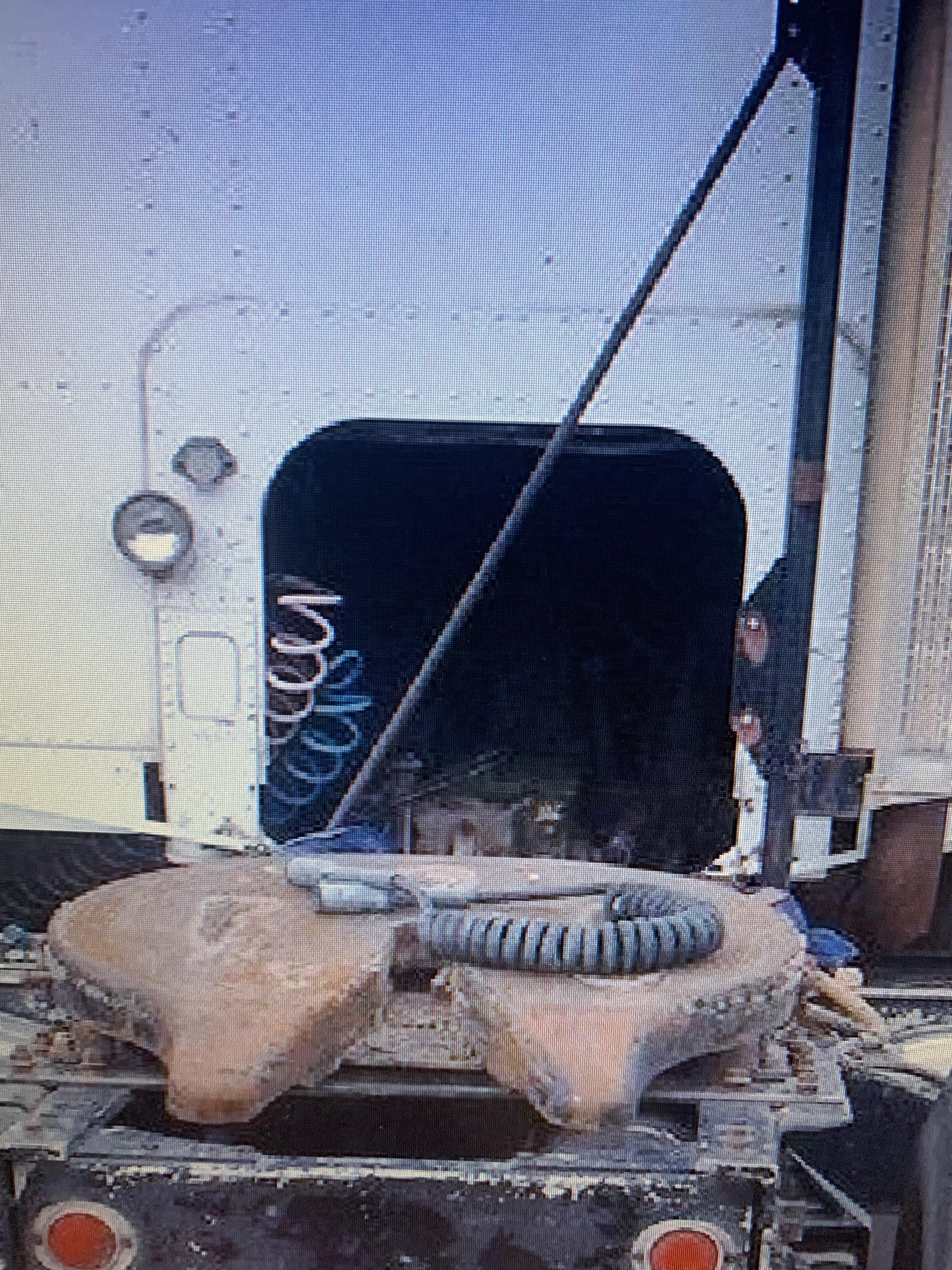

DRIPTROIT 71 Posted March 1, 2022 Posted March 1, 2022 (edited) As has already been said it varied per truck specs. Every old cabover Freightliner that I remember dealing with had the electrical plug in the back of the cab. Here is a picture of the two airlines at the frame. The green electric cord is just lying there. This one feeds out under the pogo stick. Possibly not original. Edited March 1, 2022 by DRIPTROIT 71
