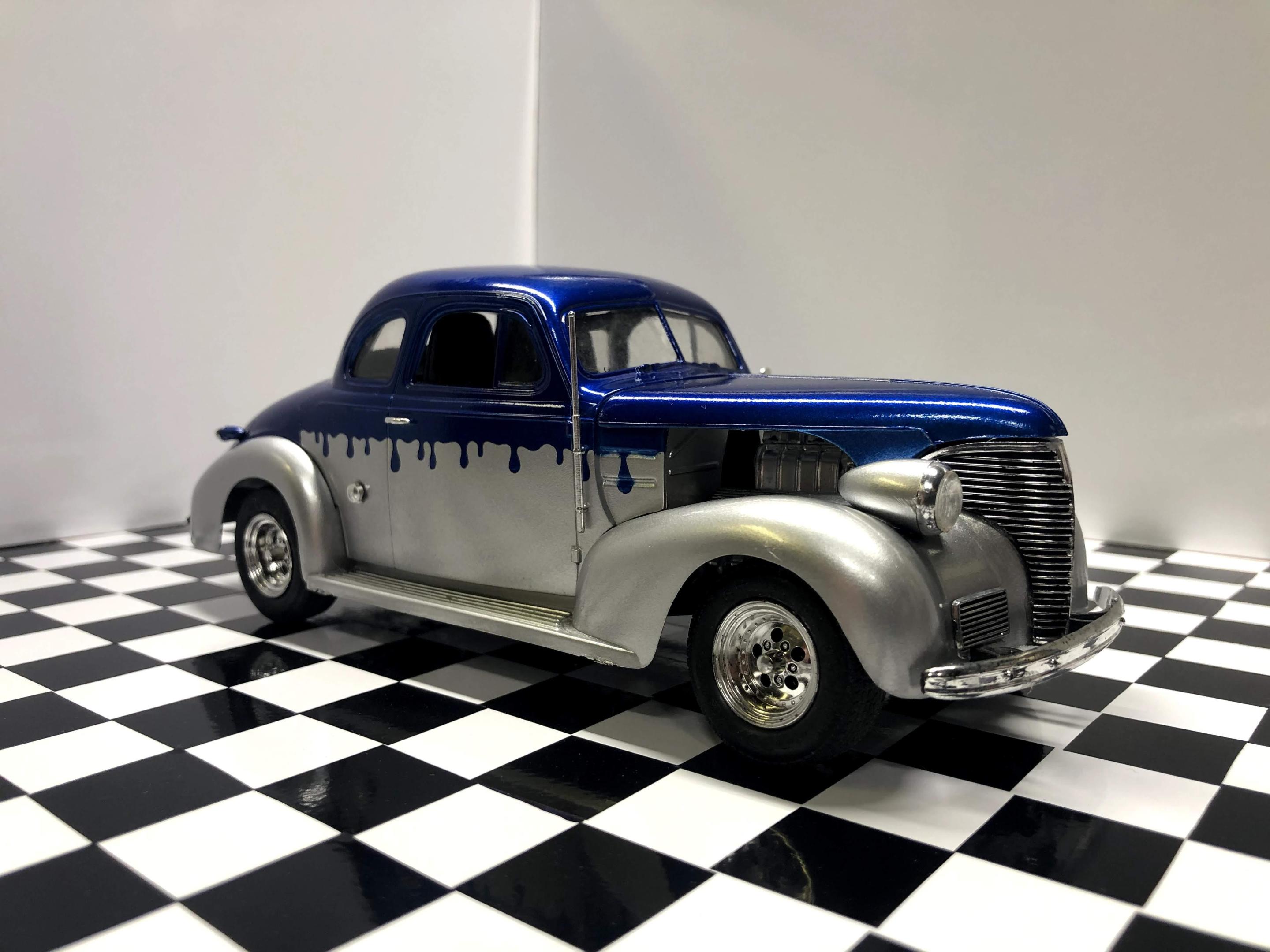

I used a cutter like that for my stencil for my 39, I have a build in the worked I plan to use it for lettering for my first time...

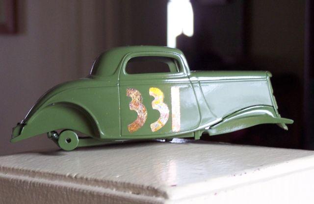

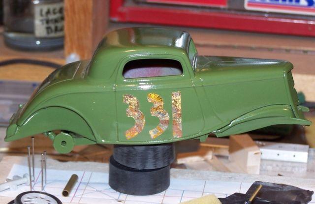

I did this, back in the '00s.Ā I hand cut the stencil from contact paper, and brushed on the adhesive ("size" is apparently the technical term). Mine is Speedball "Mona Lisa" brand. I don't have a photo of the bottle of flakes--they're in an old plastic sandwich picks bottle--so, I reckon one of my friends gave them to me. Anyway, here is the metal flake over the size, on a Revell '34 Ford snapper (it's one of my favorite kits!). I'll use One-Shot to outline the numbers. Next time I use it, I will try to reduce the flakes, in size...
