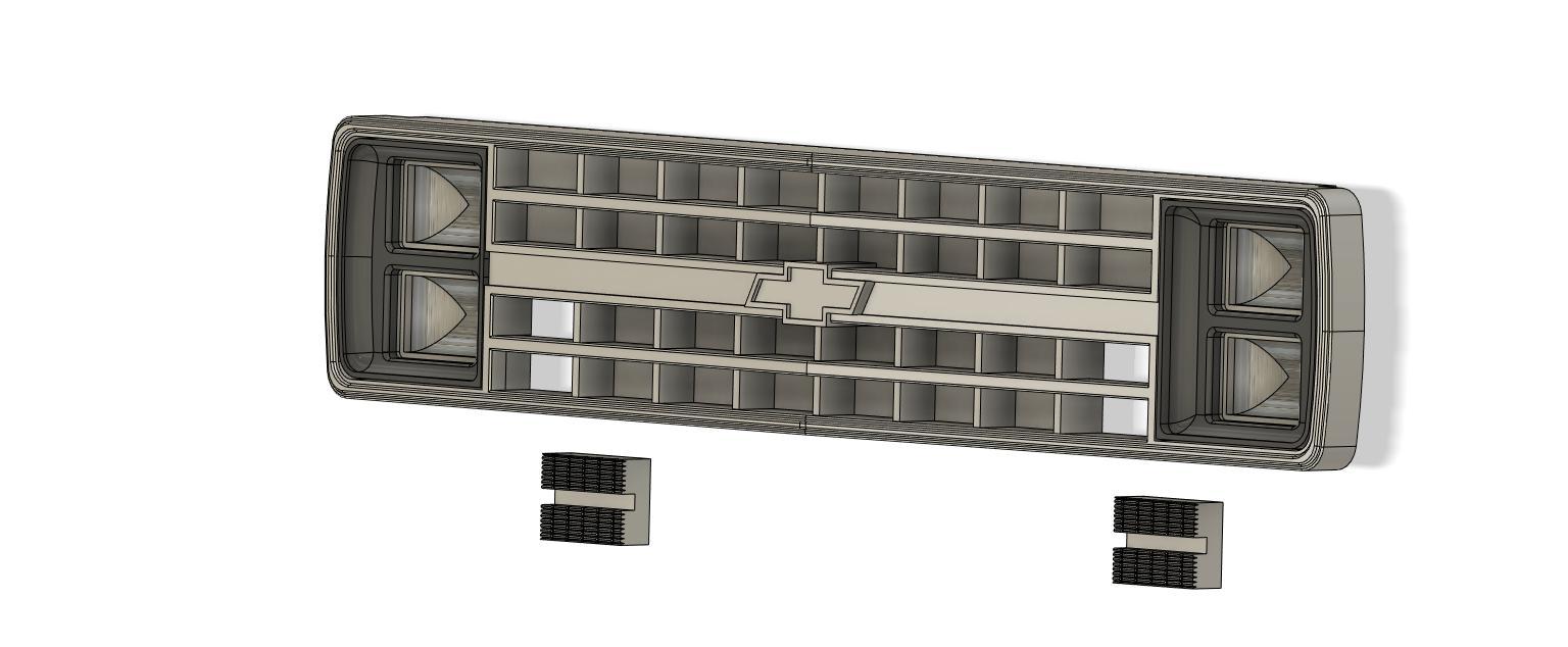

Oldmopars Posted July 20, 2022 Author Posted July 20, 2022 (edited) I promised I had not forgotten about the G10-G20 Chevy grills. So, here is a rendering of the first one. I promise it is not flat like it appears, it has a peak in the middle just like the real things, but it just does not show up very well when rendered in 2D. There will still need to be a bumper and valance made. The lenses would be separate parts (4) printed in clear resin. Turn signals will be molded in. Edited July 20, 2022 by Oldmopars

Oldmopars Posted July 21, 2022 Author Posted July 21, 2022 I added a bumper and valence panel. The bumper and valance are fit together but separate part for painting ease. I think the grill is an 85, but it gets kind of hard to tell with all the options they had back then. If you know for sure, please let me know. It is modeled after a real grill, just not positive on the year.
peteski Posted July 21, 2022 Posted July 21, 2022 While I'm not interested in this particular grill, I like to make a general observation. Since you are planning on making separate clear headlight lenses, why not also do the same for the turn signal lenses? As they are recessed deep inside the grill, they would be difficult to paint cleanly. Plus having clear lenses greatly improves realism of any model. Chromed, painted white, amber, or red opaque "lenses" never look very good or realistic. Yes, someone can take a mold of their grill then cast and trim their own clear lenses, then cut out and replace the solid ones with clear. But that is a lot of extra work (that I sometimes I end up doing in the name of realism). It is much, much easier to separate the turn signal lenses in your CAD all, and print them separately. Why not do it?
Texas_3D_Customs Posted July 21, 2022 Posted July 21, 2022 4 minutes ago, peteski said: While I'm not interested in this particular grill, I like to make a general observation. Since you are planning on making separate clear headlight lenses, why not also do the same for the turn signal lenses? As they are recessed deep inside the grill, they would be difficult to paint cleanly. Plus having clear lenses greatly improves realism of any model. Chromed, painted white, amber, or red opaque "lenses" never look very good or realistic. Yes, someone can take a mold of their grill then cast and trim their own clear lenses, then cut out and replace the solid ones with clear. But that is a lot of extra work (that I sometimes I end up doing in the name of realism). It is much, much easier to separate the turn signal lenses in your CAD all, and print them separately. Why not do it? Because printing really small objects in clear never really turn out clear and small parts are never fun anyways. Then there's the clearance issues. It's completely possible though.
Tabbysdaddy Posted July 21, 2022 Posted July 21, 2022 That grill is the same as the mid 80s pickup, on the real thing the only difference is the mounting tabs. There are two square turn signals, one for each side, mounted behind the grill. That being said, molded in or separate, I think either way is fine. The turn signal lens would only be slightly smaller than the headlight, and it wouldn't be painted as it's clear with an amber bulb.

peteski Posted July 21, 2022 Posted July 21, 2022 10 hours ago, Texas_3D_Customs said: Because printing really small objects in clear never really turn out clear and small parts are never fun anyways. Then there's the clearance issues. It's completely possible though. If the clear 3D printing is good enough for headlight lenses, it should be good enough for turn signals (which are usually not as crystal-clear as headlights. I was hoping not to hear an excuse, but . . . How about offering the lenses printed in regular resin (included when buying the grille)? That way modelers who really strive for realism could use them as masters and cast their own clear resin lenses. That would sure make it easier than trying to make a mold from the turn signals embedded in the grille.

Oldmopars Posted July 22, 2022 Author Posted July 22, 2022 On 7/21/2022 at 5:55 AM, peteski said: If the clear 3D printing is good enough for headlight lenses, it should be good enough for turn signals (which are usually not as crystal-clear as headlights. I was hoping not to hear an excuse, but . . . How about offering the lenses printed in regular resin (included when buying the grille)? That way modelers who really strive for realism could use them as masters and cast their own clear resin lenses. That would sure make it easier than trying to make a mold from the turn signals embedded in the grille. To be clear (no pun intended) I had yet to respond and say yes or no. My plan is never to print these, but to offer the file to someone that can. I can make the lenses a separate part, it will be up to the printer to decide if they want to offer it that way or not. I have a bottle of clear resin, I've yet to play with it at all. So, I have no experience with clear.
Oldmopars Posted July 22, 2022 Author Posted July 22, 2022 On 7/21/2022 at 5:55 AM, peteski said: If the clear 3D printing is good enough for headlight lenses, it should be good enough for turn signals (which are usually not as crystal-clear as headlights. I was hoping not to hear an excuse, but . . . How about offering the lenses printed in regular resin (included when buying the grille)? That way modelers who really strive for realism could use them as masters and cast their own clear resin lenses. That would sure make it easier than trying to make a mold from the turn signals embedded in the grille. Ask, and you shall receive. Now they are separate parts. It will still be up to the printer (not me) to decide if they want to do it that way.
Texas_3D_Customs Posted July 22, 2022 Posted July 22, 2022 On 7/21/2022 at 7:55 AM, peteski said: If the clear 3D printing is good enough for headlight lenses, it should be good enough for turn signals (which are usually not as crystal-clear as headlights. I was hoping not to hear an excuse, but . . . How about offering the lenses printed in regular resin (included when buying the grille)? That way modelers who really strive for realism could use them as masters and cast their own clear resin lenses. That would sure make it easier than trying to make a mold from the turn signals embedded in the grille. Look I will be as honest as I can, I don't want to dedicate a printer to clear parts, I also think that your attitude is piss poor. As a general rule I am pretty easy going but your comments are rude at best. I don't due this to get insulted so... 1
Tabbysdaddy Posted July 22, 2022 Posted July 22, 2022 6 hours ago, Oldmopars said: Ask, and you shall receive. Now they are separate parts. It will still be up to the printer (not me) to decide if they want to do it that way. Those aren't correct. They're supposed to be square without the grill cutouts.
Oldmopars Posted July 23, 2022 Author Posted July 23, 2022 2 hours ago, Tabbysdaddy said: Those aren't correct. They're supposed to be square without the grill cutouts. I am very aware of that. However in order for them to print, the grill has to be thicker in depth. So, to get the lights to have the right "Look" once installed, they have to be notched like that. If I did not put the notch in them, they would be recessed into the grill way too far and look silly. See below, with them installed, they look correct. One issue with scale models is that you can't always copy the real thing. Styrene or resin, you have to give up some things, or make changes to create the right look, in scale. In real life the grill is shelled out hollow on the back side, I could draw it that way, and probably even print it. However it would be so thin and fragile that you would snap it apart just getting it off the supports, let alone trying to handle it and install it in a car. 1
Can-Con Posted July 23, 2022 Posted July 23, 2022 2 hours ago, Tabbysdaddy said: Those aren't correct. They're supposed to be square without the grill cutouts. Looks pretty close to a '85-'90 to me. I'd imagine the grille cutouts on the lights are so they fit up into the grille to the right depth.
Oldmopars Posted July 23, 2022 Author Posted July 23, 2022 Just now, Can-Con said: Looks pretty close to a '85-'90 to me. I'd imagine the grille cutouts on the lights are so they fit up into the grille to the right depth. Yes, you are correct, see my post above.

Tabbysdaddy Posted July 23, 2022 Posted July 23, 2022 Wasn't trying to be a pain, I'm just a big fan of these vans. I forget the parts have to work in scale. Probably best molded in like the GMC pickup has them.
