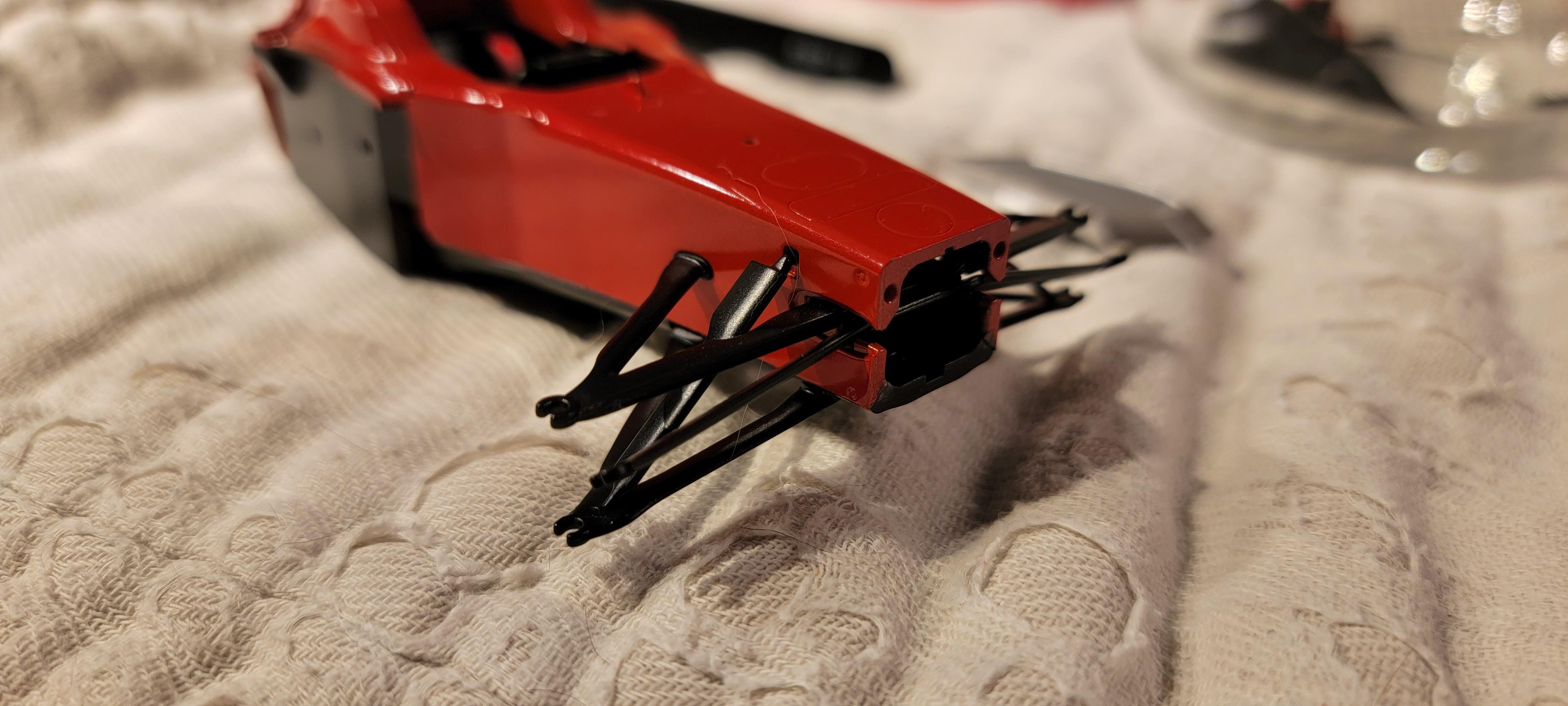

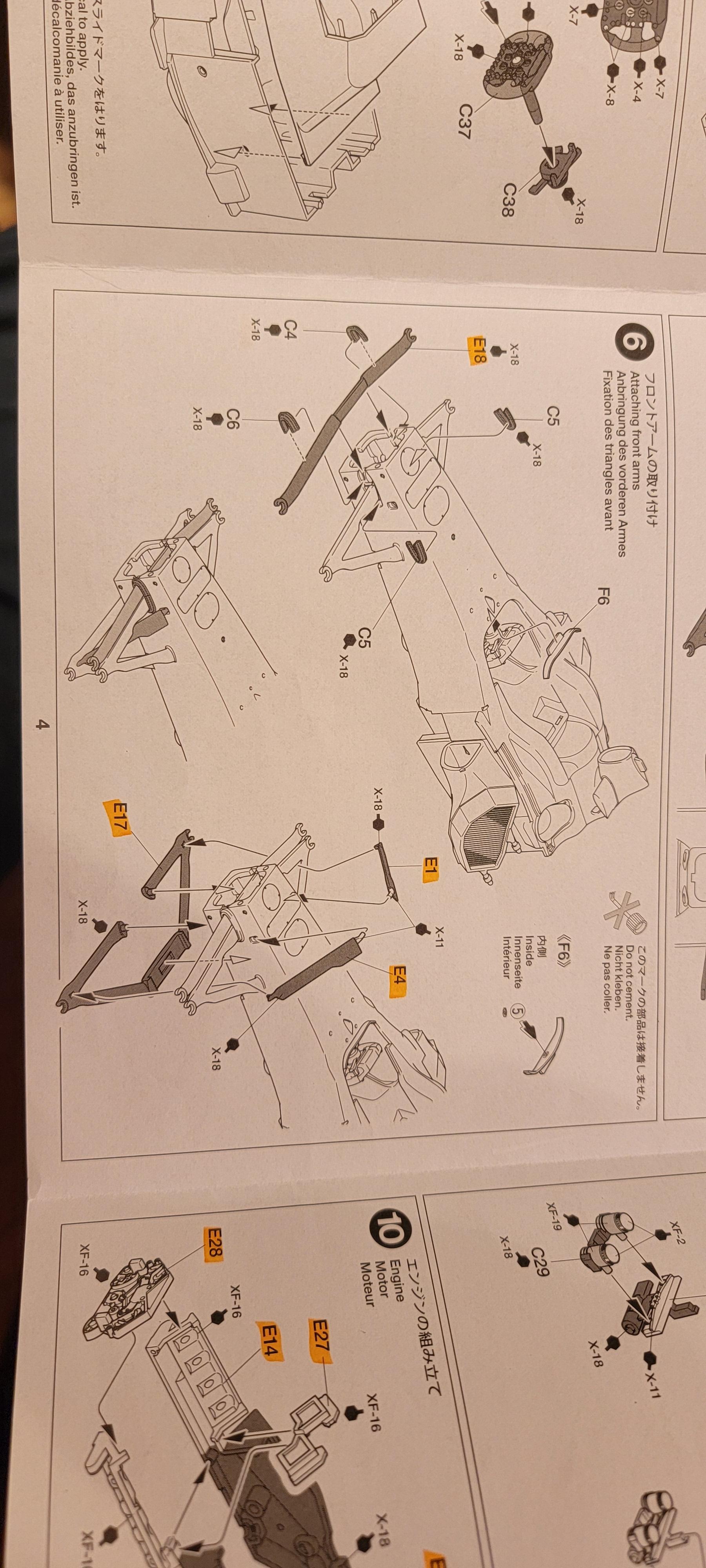

Is the front arms suppose to be able to move up and down? I think that's what its talking about is not gluing E1,E4,E17, and E18.  That is confusing to me too, but i could be wrong.  What ever goes in front might actually hold C4,and C6, and E18 in place.

I don't know the answer. I guess I can proceed with no glue and see what happens. I haven't yet glued the other part of the control arms that were part of step 5.
Usually its just the steering part that links the wheels that dont get glued, i would expect everything else to be glued as the suspension itself doesn't look like it moves. It could be worth looking at other builds of the same kit to see how they did it. If its an older tamiya kit sometimes they had postcard size sheets included to amend steps in the instructions so there is the chance it may be missing
  • Like 1
It's a instruction key advisement. Eg this symbol means don't glue. It's for the next step I'm which will have that symbol attached to the wheel assembly.  It's not any sort of instruction pertaining to Step 6 itself at all, but refers to the next step and not gluing the polycaps into the front wheel backs. In Step 7 there's just the symbol, but not what it means.
  • Like 1
I just looked, and I think you're right.  Thank you, and thanks to others that replied.  (That's not a very good way to convey the information in the instruction, I have to say.)

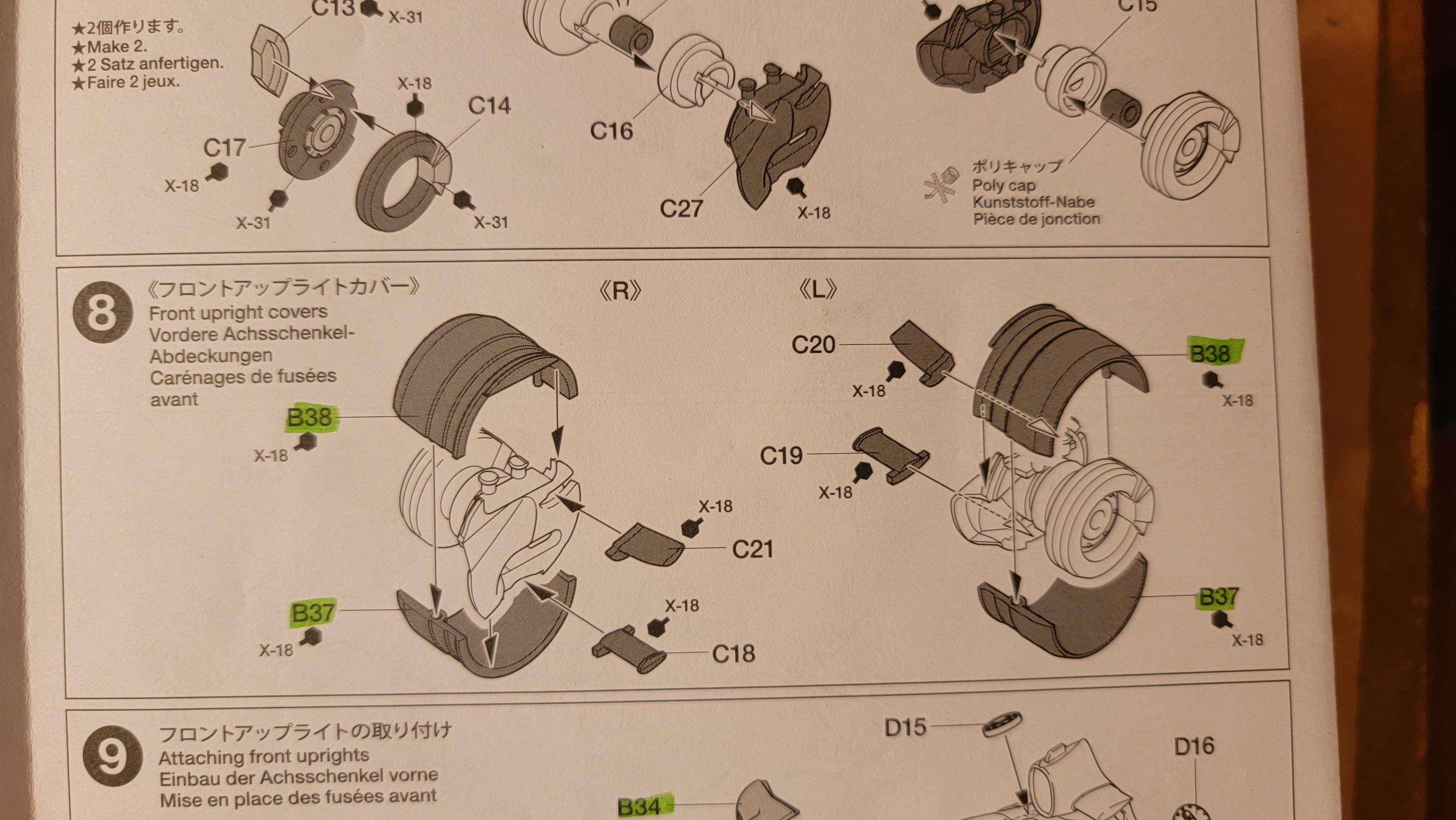

HI - I've got another question about gluing instructions for this same kit.  I'm getting ready to clue B37 to B38.  When I test fit with the front uprights in between the front uprights are loose - they aren't squeezed tight between B37 and B38.  Does anyone know if that is by design?  Or should I also glue the front uprights to the covers?  Yes, I know my progress is very slow, but I've had some hand and shoulder issues the last few months that has slowed this kind of stuff down.)  Thanks!! Jeff
