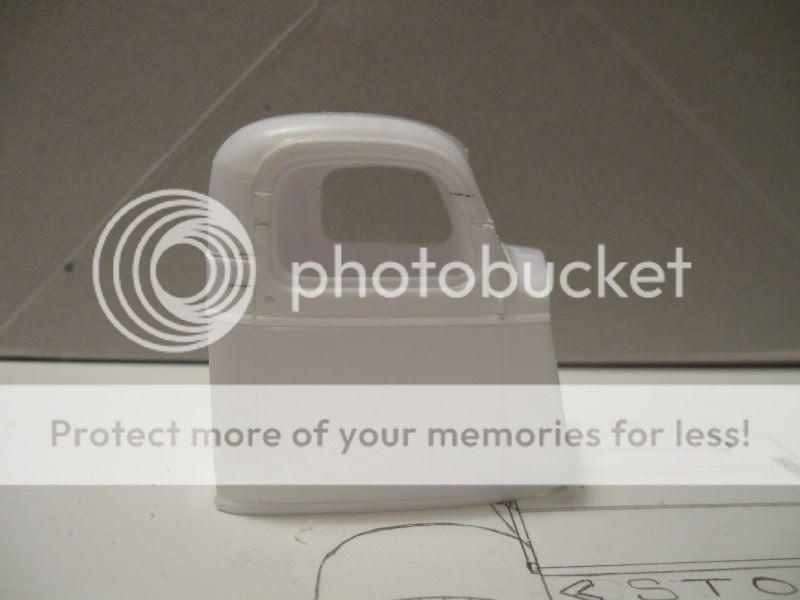

See how nice that body looks with a top chop? The cab roof is just TOO tall even in stock form. Makes for an UGLY truck. I HAD to chop mine, or I'da never built it! But, that's just my opinion. :D That was NOT one of G.M's better lookin trucks! Wonder who even picked it, or WHY, to make a model of it??? :blink:

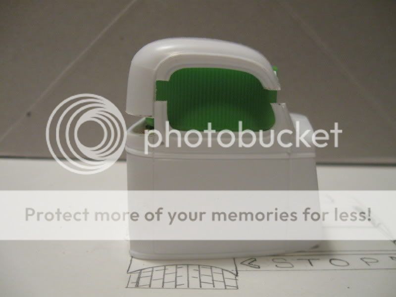

OK. I dont feel I acomplished what I wanted, but we'll se after paint. I think I liked the truck a little better before , but you don't know till you try. I wanted to share how I did the chop and why for the people who havent started doing body mods yet.

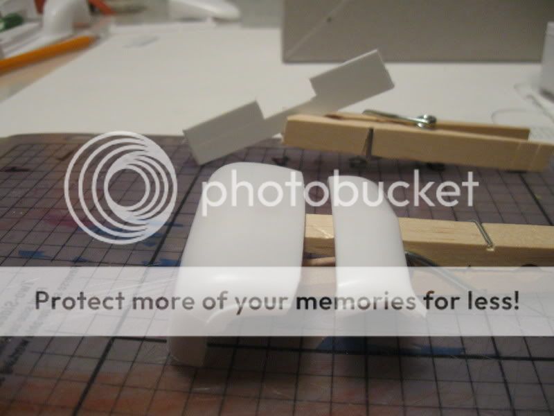

I found that measuring and drawing full lever lines helps with the cut and the placement after the cut. I'v been using a clear plastic ruler for a while , but just got a caliper and would recomend it.
The reason I cut the top the way I did is to keep all the factory curves in the doors and to also save myself from a 2inch back window, I knew the doors were going to open so bladed the jam between the cuts for easy access but kept the rest of the door in tact for strenght and line up perposes later.
I made the cut on the top at an angel for two reasons. strengh and it makes line up alot more noticable with the body lines.
I actualy use a piece of rectangel plastic to extend the top and after glut dries cut away excess with the roto tool.( that is for strengh also) I could never get sheet plastic to stay straight between the cut.
I mounted the back half first for a referance point for the front. reason I used the back for this is due to the vertical and horizontal cuts made it east to line up level.( didn't want the top to sag in the middle). this is where I let the pieces set up over night. Befor gluing the front on I went ahead and trimed the spacer down while I could get access to the insie of the roof and side angels to trim out the bodylines.

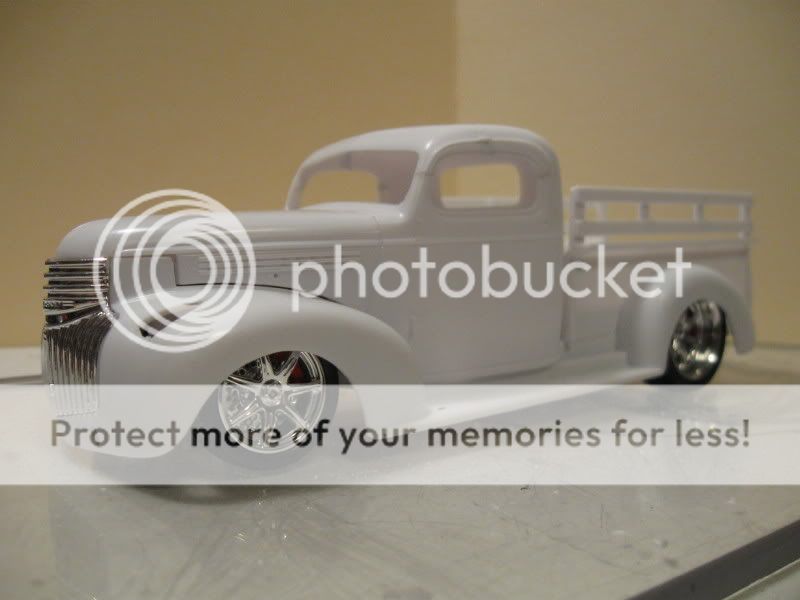

TADA there it is!

I'd have to say brother that chop IS THE TICKET, it looks fantastic with the way the truck sits, and it looks to blend it all together, keeping with the flow of the lines of the truck, not to aggressive, but just enough that you would have to take a double look, I myself have been thinking of a chop on the Huall'n C-3500, nothing to drastic but enought to fit the stance, anyway keep it going brother, I like you am keeping a close eye on the build, GREAT WORK.
And by the way, thanks for sharing the chop, I for one now know of another way to chop, and keep my rear window :mellow:

glad you like the top . I'v been looking at it and I'm gona leave the rails off the back. worked with the stock top but to tall I think now. you got to be carefull with chop tops, doing it on a long ride or a tall body can make it look like it got steped on.

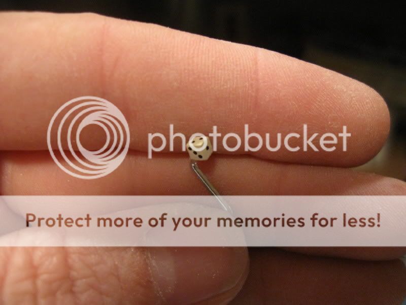

I've been looking for cool shift lever knobs in 1/25. Where did that tiny dice cube come from?
Thanx for the detail pics on the chop, a good reminder to always look for the details you want to survive before you put knife to plastic! The lines and stance of this build are great. Should be a terrific fat fendered '41 when you're done.
cut the end from a stick of squair plastic and drilled a small hole and stuck it on a shifter I found from the parts box.
Can't take credit for the idea though, saw a shifter in a friends build, wasen't painted like a dice, but had a squair on top,
so there might be a kit out there with this shifter, but its super easy to make. :lol:

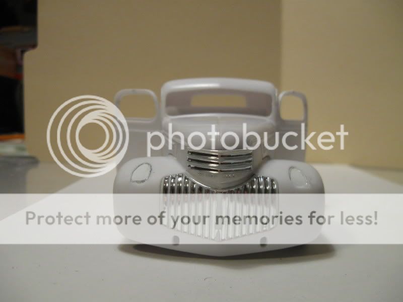

mock up is almost there. :D got the doors opened and need to hinge them, started on shaving the headlights, that will get putty soon. also flipped the bench seat and put a speaker box in there. :lol: still in the air with the hood, pancake was the first though, but the motor is way down in there that way. thinking about a double hinge and flipping it forward with the skirts.
gona open the grill and paint it body color and stash the headlights behind, just coulden't come up with a headlight stile I liked on the fenders. I'll post more pics when it all hinged and in primmer. ;)
