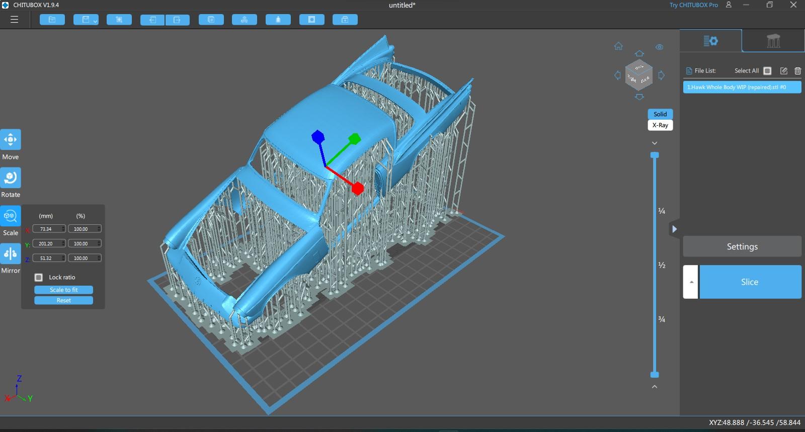

1958 Packard Hawk also from EDM. That I'll run sometime tomorrow, and this was VERY tricky to get the wall thickness dialed in due to those tailfins. I did a tiny 1/43 test run last week, which showed up some trouble spots. I got those sorted out and this should print without much issue.

Jim, sorry it's taken a bit to get back to you. Just got over recently an eight day stay in the hospital, and was pretty much out of it health wise since the beginning of the month.
I print at an angle because you want as less mass lying horizontal against the surface of the vat as possible. More mass = more issues with suction forces creating a distortion where it's not wanted ie: roof, fenders, flatter panels, etc.
Of course, the higher the angle, the longer the print will take as that's adding to the number of layers. Sometimes, printing at an angle is a necessity due to the size of the model. The Opel didn't need as much tilt as say a 1970 Buick Riviera I printed months ago. Still, you want to tilt your model on both axes, to reduce the suction forces.
