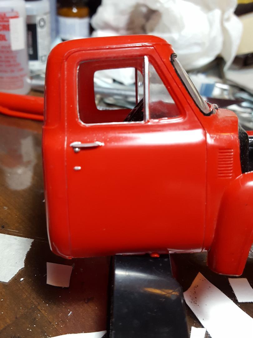

MarkJ Posted December 11, 2022 Author Posted December 11, 2022 I found an old truck body that I had sprayed with testors enamel probably 40 years ago. I polished it with 4000 to 12000 polishing pads and then mixed up a small amount of microscale satin finish which I thinned 1:1 to make it flow out better with a brush. I painted it on the door and really liked the results. It brushed on smooth with no brush marks just like future does but it gave me the satin finish I was looking for when it dried, instead of a glossy finish like future gives you. I think this will be the only thing I need to coat my finished body with to seal the decals and also provide a satin finish to the whole model. I transferred some of the microscale satin to a dropper bottle so I could mix it with distilled water. below is the product and the finished door of the truck.

MarkJ Posted December 14, 2022 Author Posted December 14, 2022 7 hours ago, Pierre Rivard said: Just got a bottle of Micro Satin and one of Micro Gloss. Sanding down and preparing 2 hoods for testing. Curious to see how decals will look with a satin seal coat and risk for some silvering. I hope you have better luck than I had. It did not turn out well on the model and I had to end up using future after all. I thought the test with the red truck body was good but not so much. It was more of a flat finish than a satin one.
