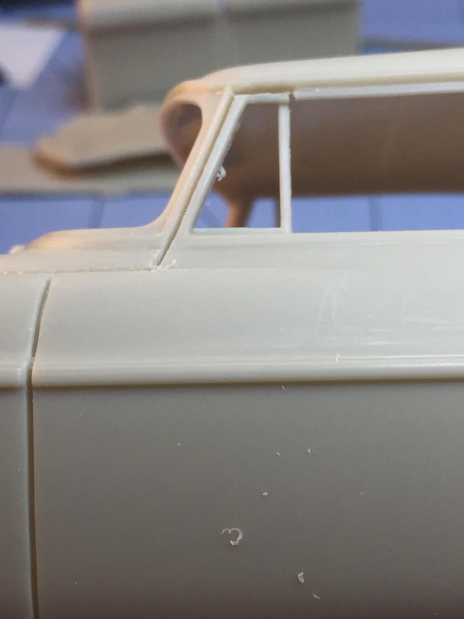

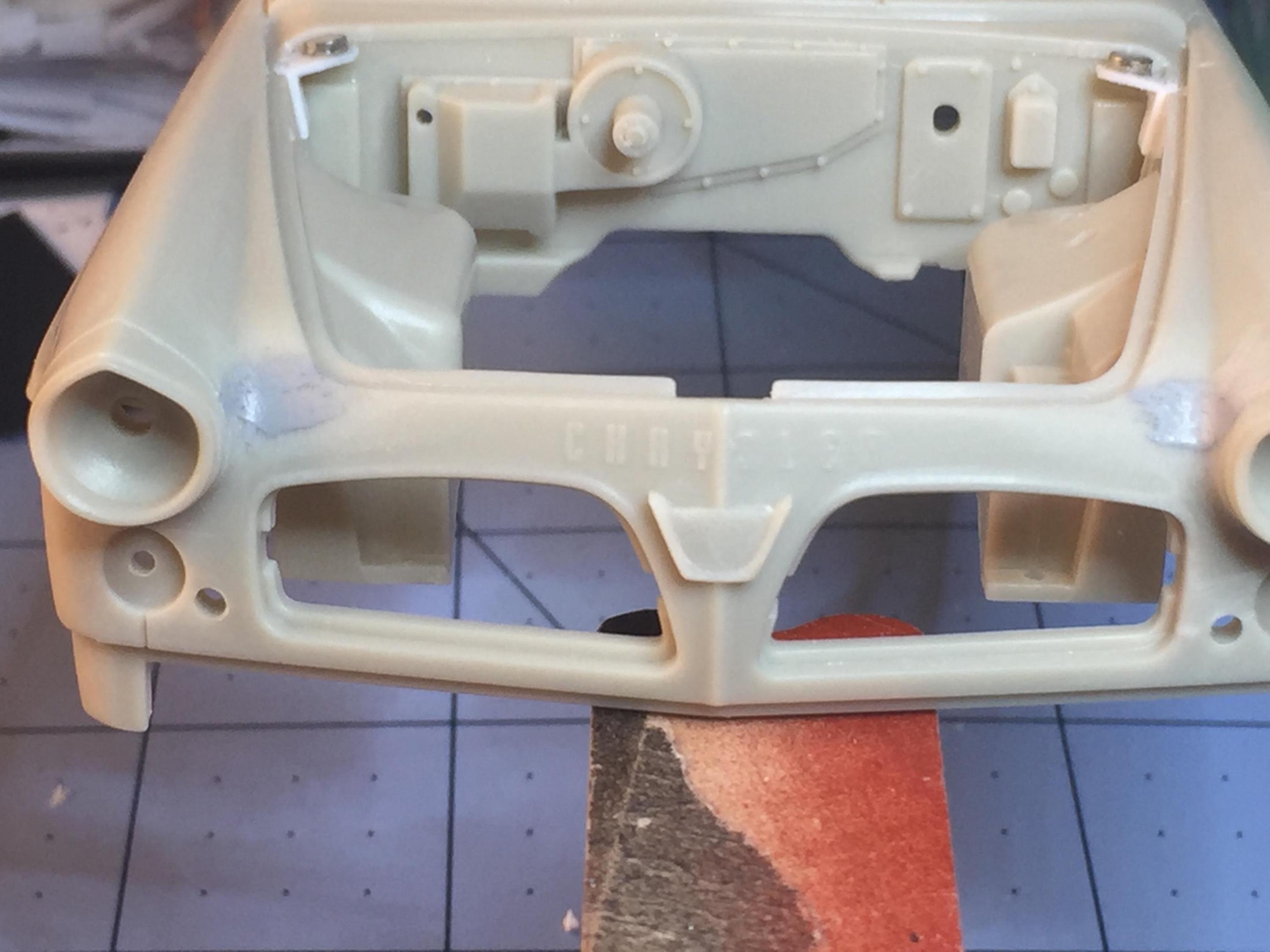

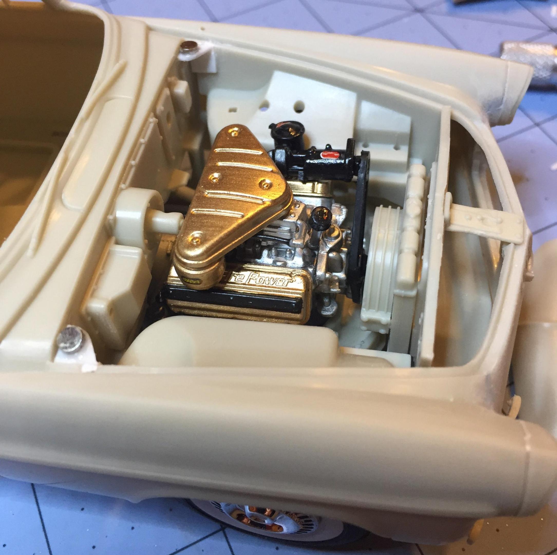

I haven't had an opportunity to paint the assemblies that are ready but have done a few things by hand. Everybody likes a mock-up so this is what I have so far. Pay attention to the front seat. This sort of thing makes no sense. They molded the rocker arms which, in most cases, will be covered but the back of the front seat looks like they thought no one would see it ?. I thought about opening the doors but between the seat and the lackluster interior of the 1:1, it doesn't seem worth it.  The dash will get attention  but the engine will not get spark plug wires, just paint detailing and the provided decals. The interior will get foil and Molotow detailing. The body has, at this point, been cleared of parting lines and the low relief scripts on the rear quarters have been shaved as well as the outside door locks. The decal sheet has the scripts and other interrior and exterior details. They do not, however,  provide decals for the center of the full wheel covers.

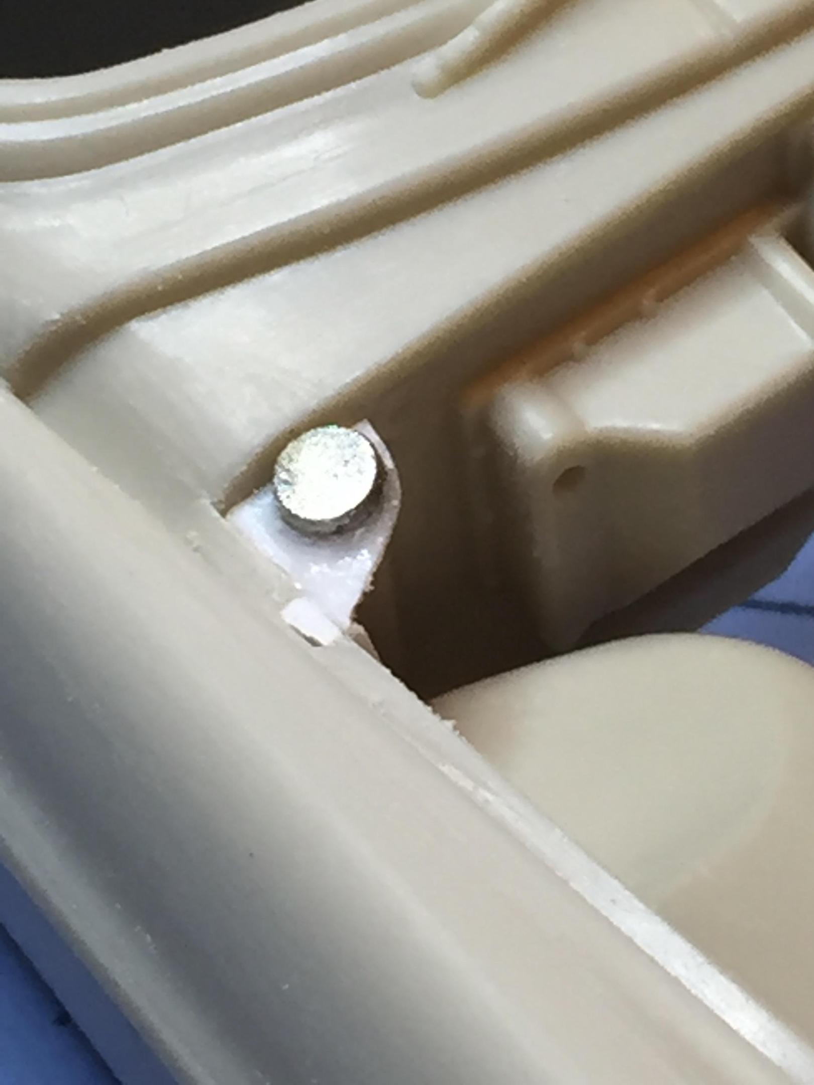

I like to use those little strontium magnets to keep hoods in place and sometimes they can be hidden but not this time. The service they provide outweighs the ugly (for me, anyway.) The bottom of the fan shroud has been cut away to facilitate assembly on my terms. The instructions spell out the sequence of assembly but instructions never seem to acknowledge the painting situation. I know, they are just suggestions ?.

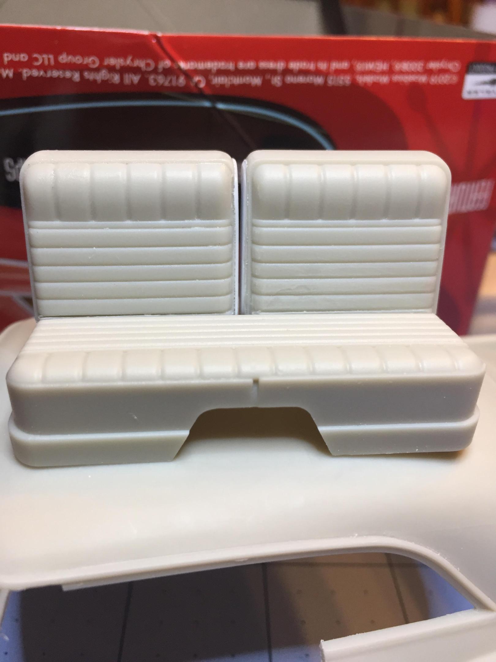

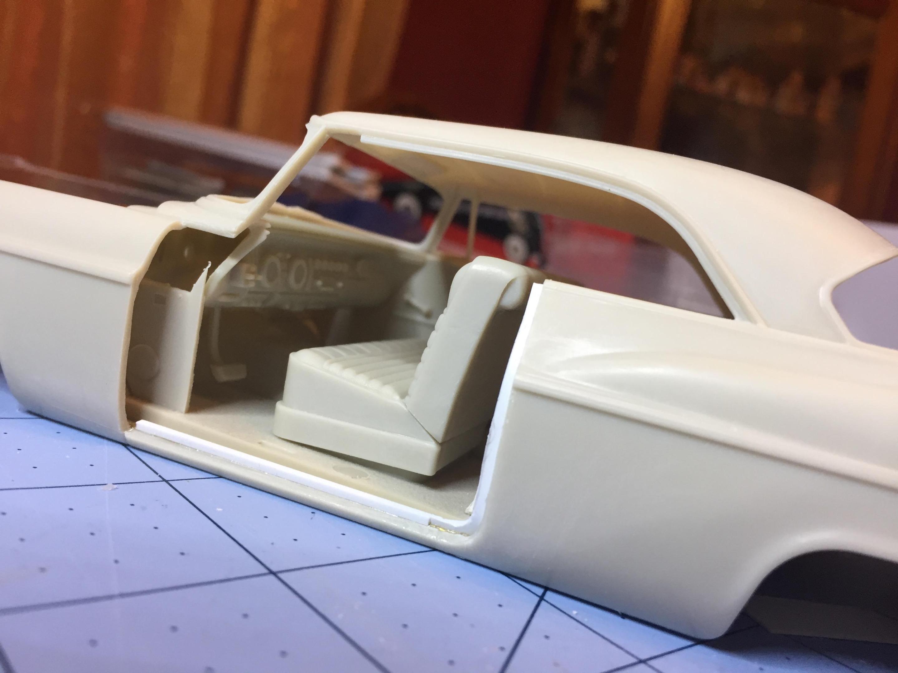

After much deliberation,  I decided to go ahead with this thing the way I originally intended. I fixed the front seat first and was happy with it so it seemed OK to maybe open one door?. I glued some 1/16" brass rod to reinforce the minimal rocker panel (why do they call it that? ). Then I attacked it with my #11. It was exhilarating ?. That's as far as I got today. I also scraped away the molded area on the nose and trunk medallions where the decals will go. I will also be opening the trunk unless someone tries to stop me, at which point I will knuckle under very quickly.  Lots of chores are not getting done until the hinges work perfectly.

Oh, and then there's this other Ithing with the front seat. Gotta figure out how to fix THAT. At least they left me with a nice flat foundation to build on.

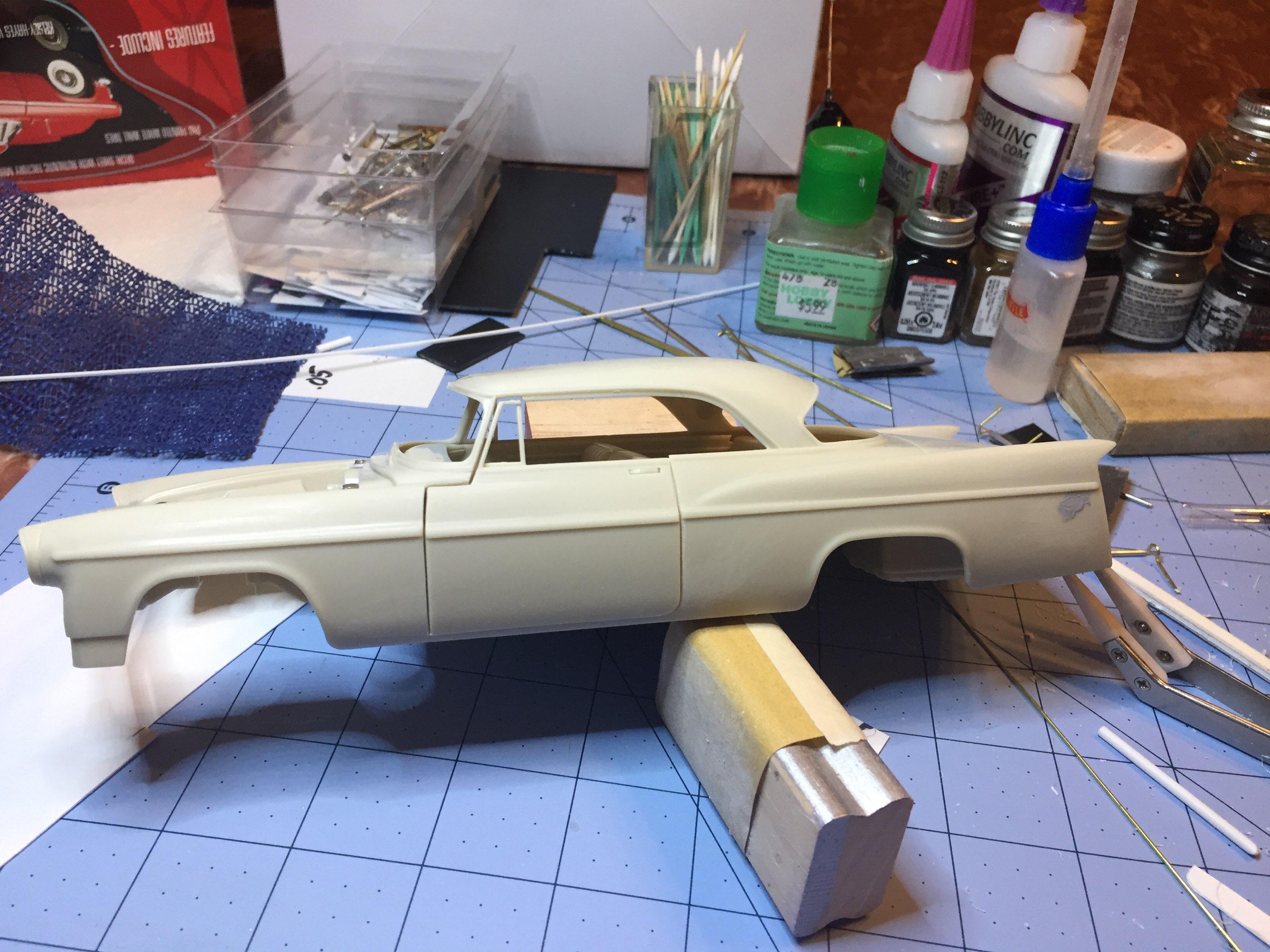

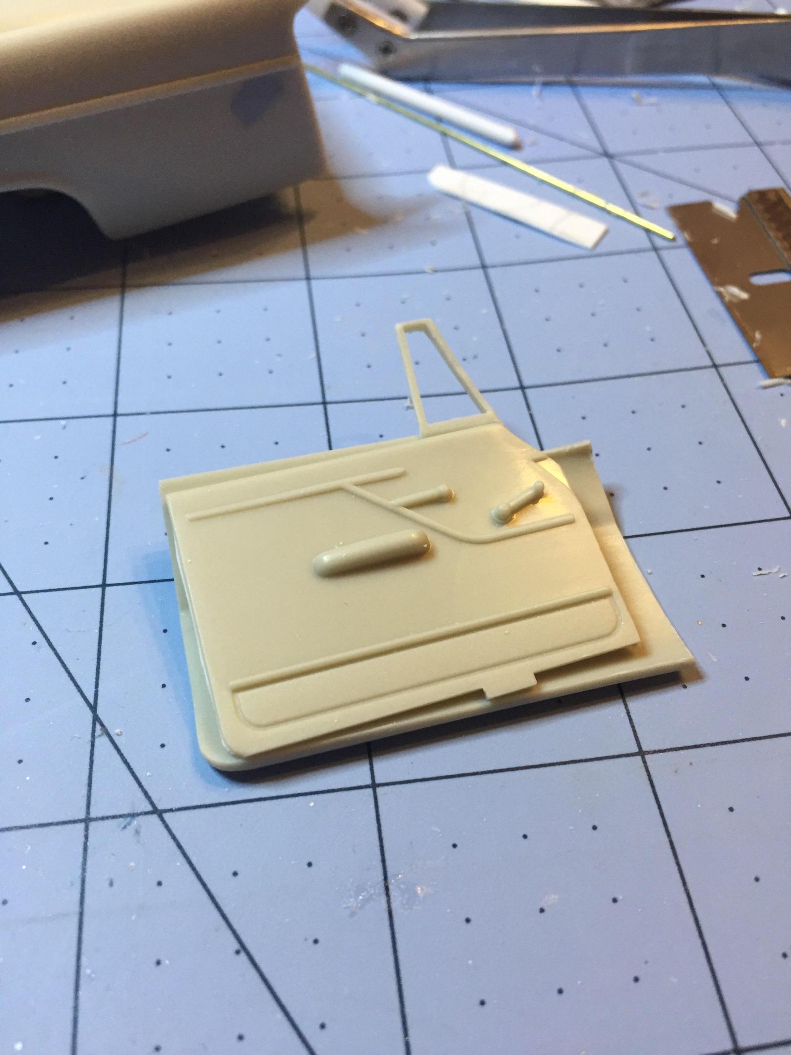

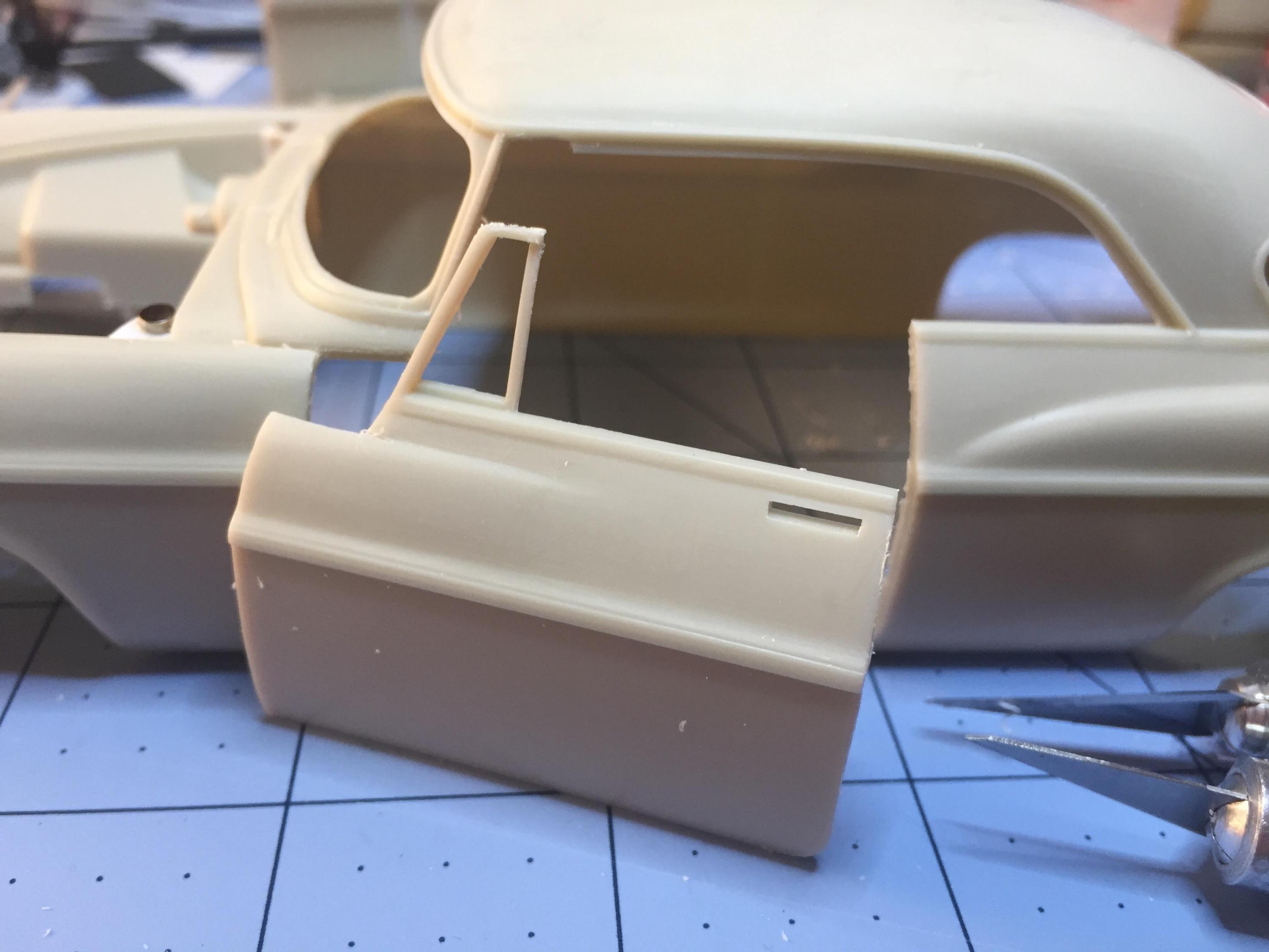

I did a little more tonight. It's getting a little scary.  I had to "tack" the interior parts together so I could figure out the hinge positioning and other door panel issues. A tiny dab of CA does the job.?

Good looking project Mike.  I like the magnet idea for the hood.  Cutting open the doors?  Yikes!....I glue mine closed because of all the alignment issues.  Have you decided on a body color yet?

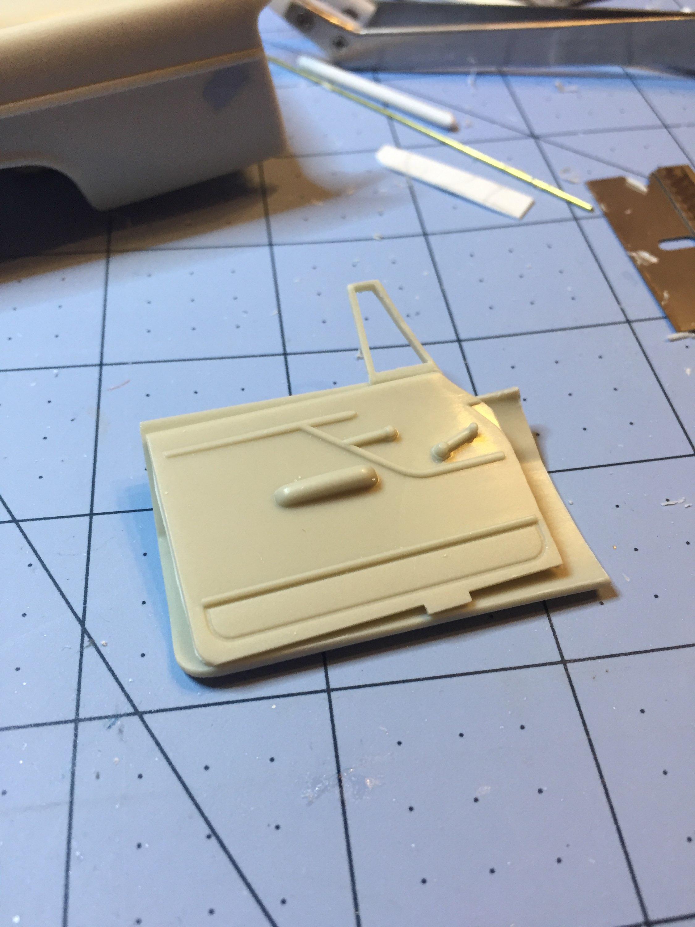

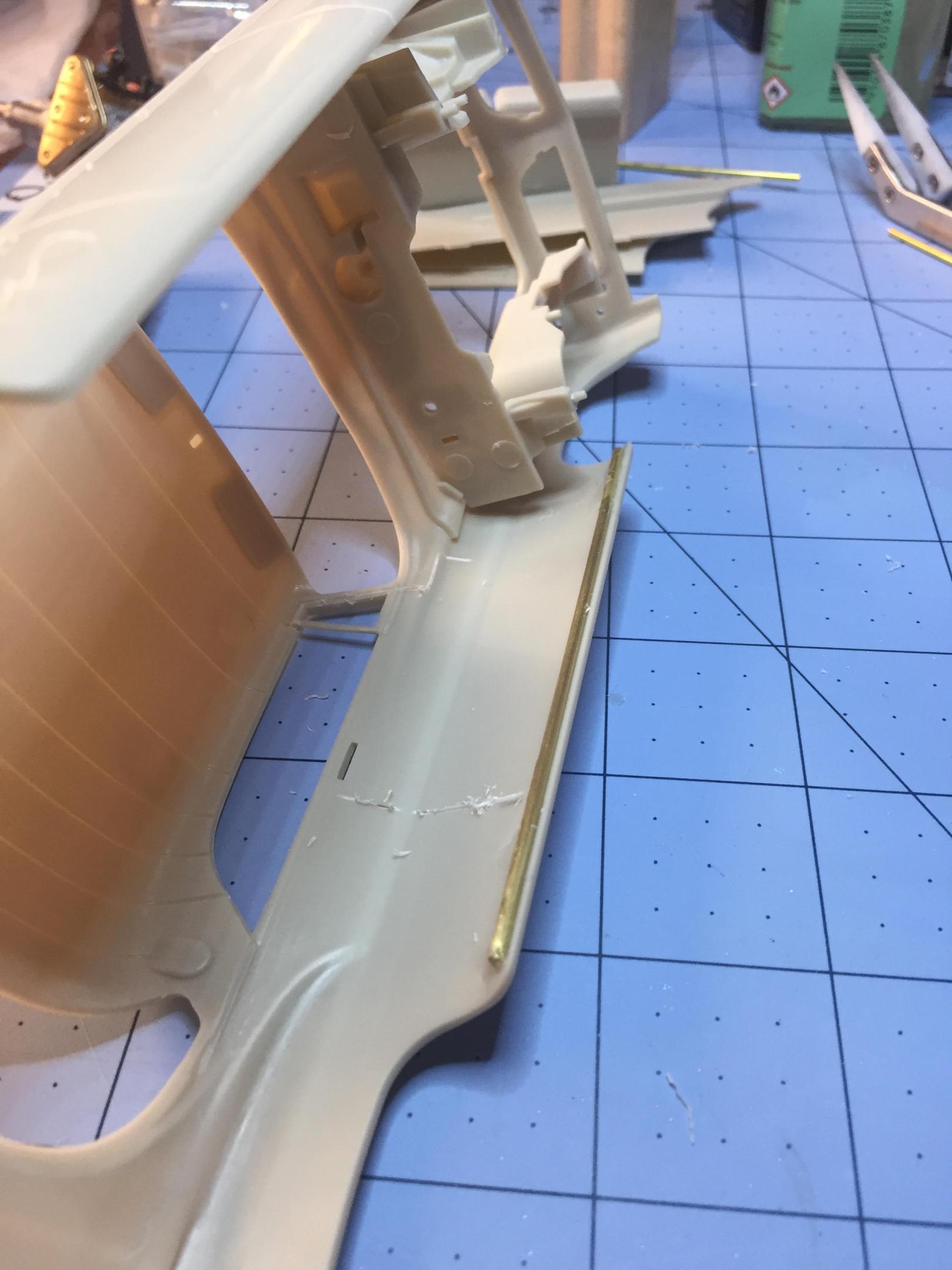

After a few attempts, I got the hinge made. I don't do a lot of this so it was a tad frustrating. I had to go back and watch the videos on YouTube. Sometimes a refresher helps. I haven't decided to open the other door ?.  Yet. I dunno.  I got the chassis and the floor pan painted in basic black. I can now assemble it and paint some details . ? Still a lot of work ahead on the door jamb,etc. Back to youtube....
Thank you Joe, I do the same thing on kits with opening doors, especially the Revell '31 Sedan. The hinges on that kit are so tiny.....I don't have the patience. The type of hinge I am using is pretty standard now. It swings the door open in a natural way and the panels remain removable because you don't glue the wires to the tubing. This also allows the panel to slide back into adjustment. You can add resistance by pinching the tube where needed and when you add rare earth magnets in the jambs the doors can self-align themselves well as staying closed. It's a system! I used it years ago on the AMT '69 GTX convertible kit and it worked beautifully.  As far as color goes, I want to stay with one of the very few colors that were available for this somewhat limited model.  There were no two-tones for the 300B. It was black, white or red. Period. It's going to be a while before I'm ready to paint but I have a can of Tamiya white pearl I've been saving that just may find purpose.
