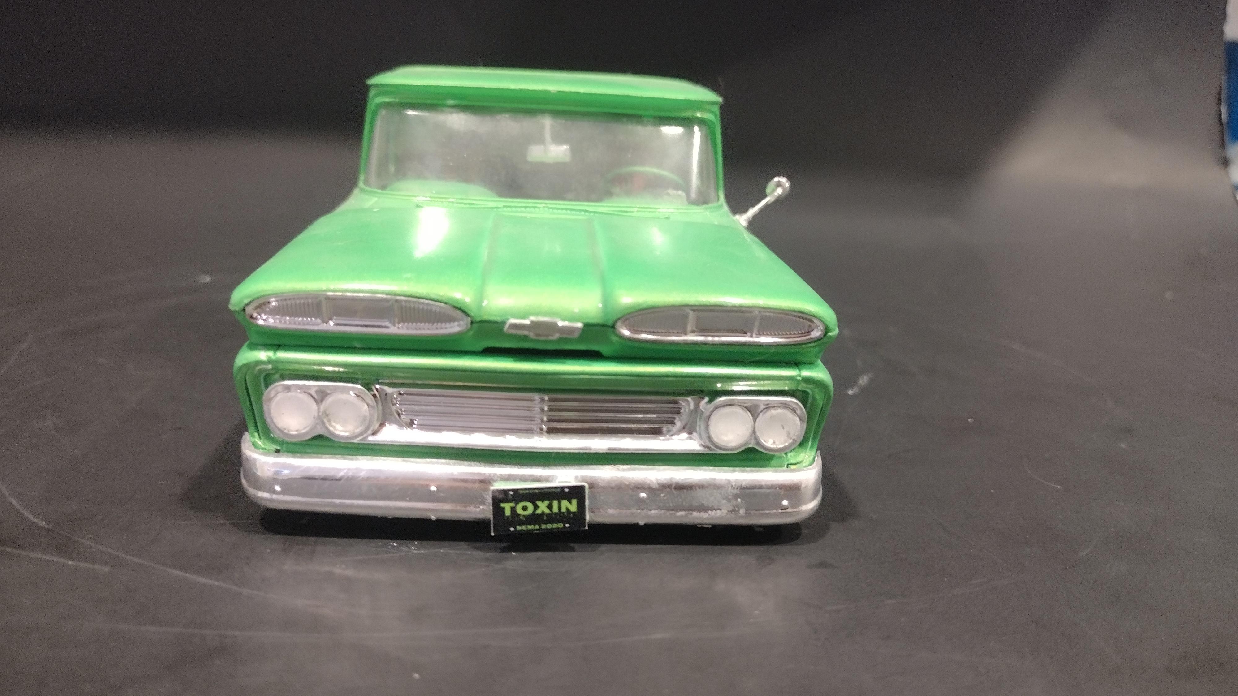

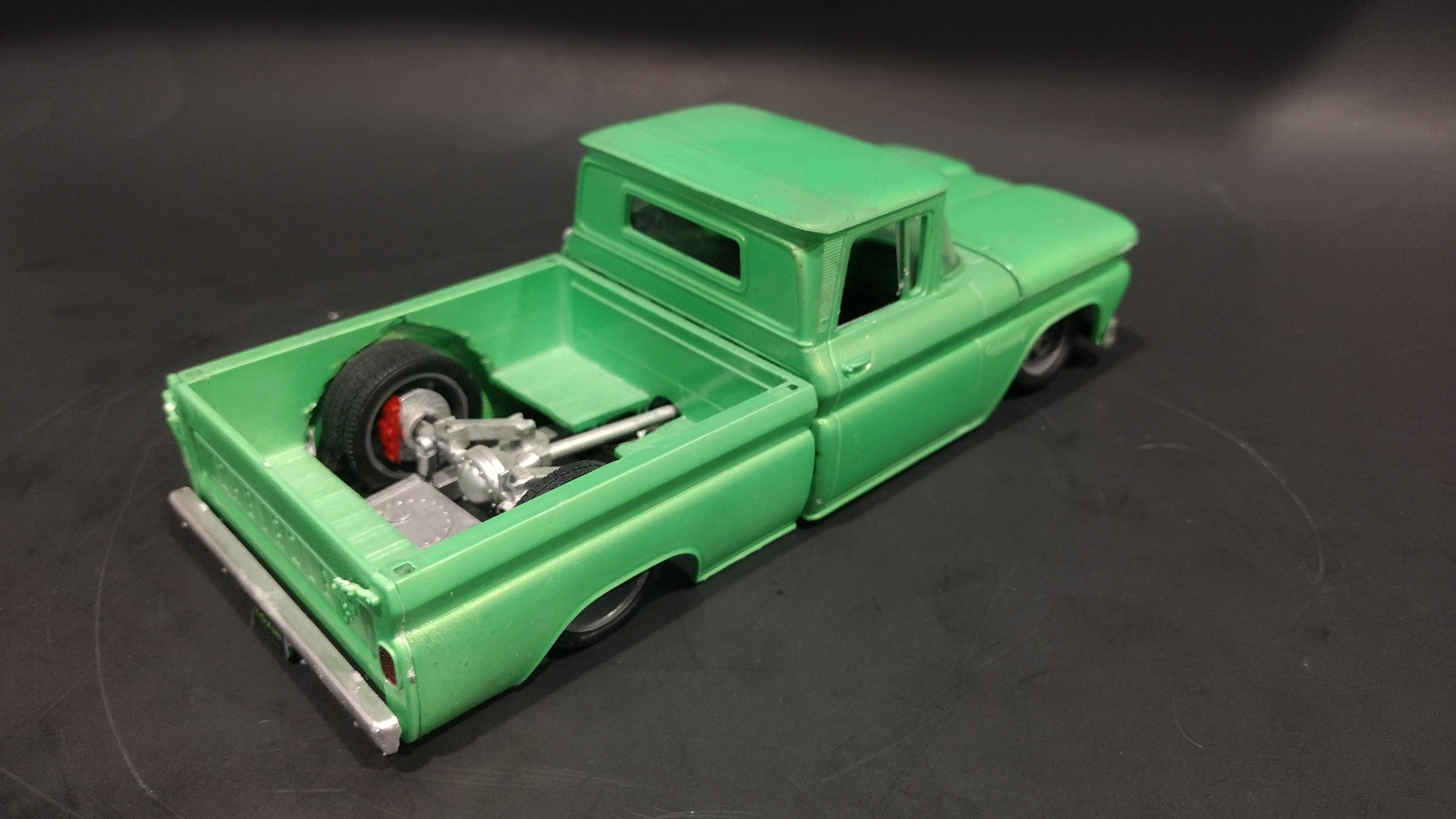

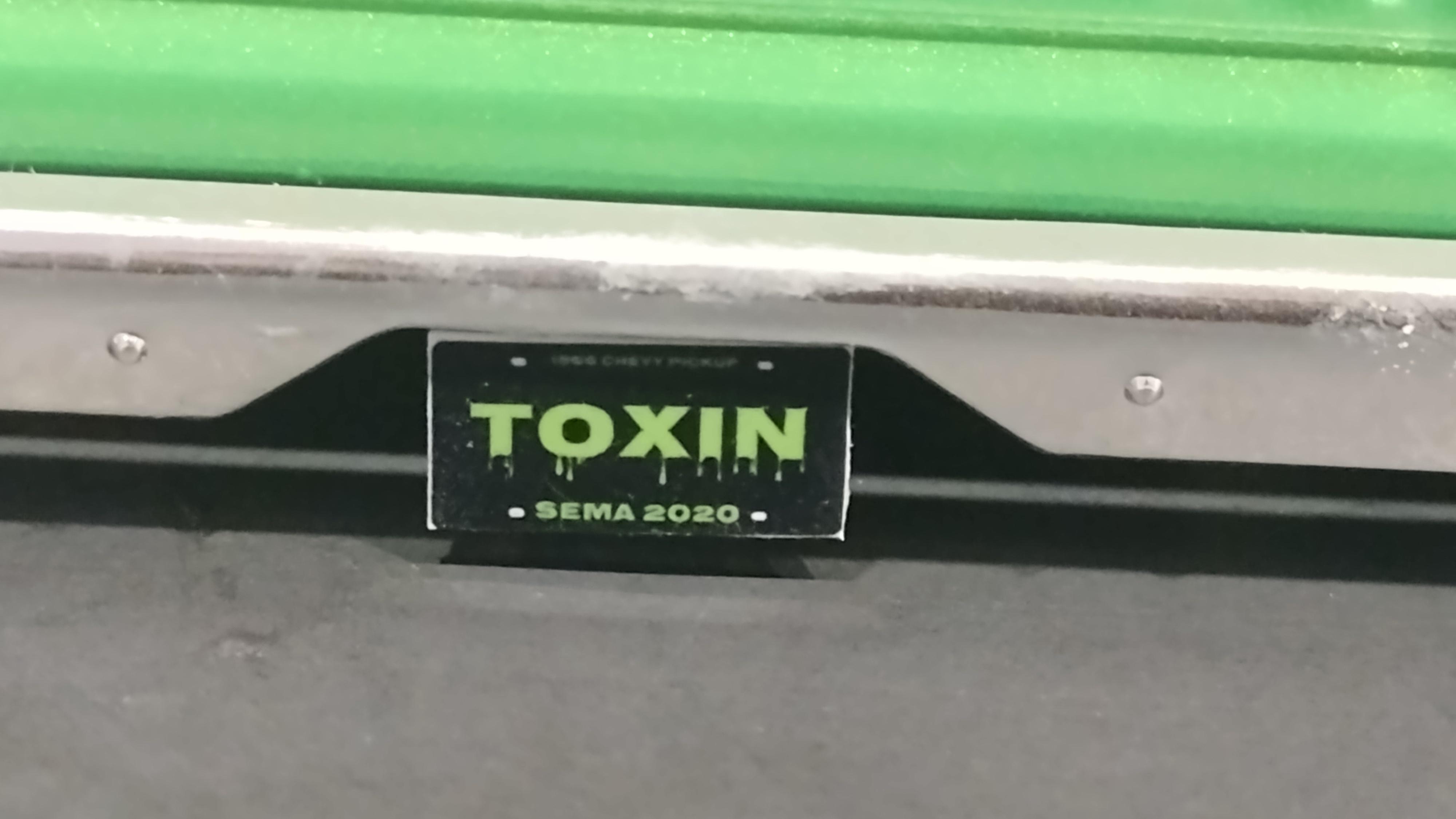

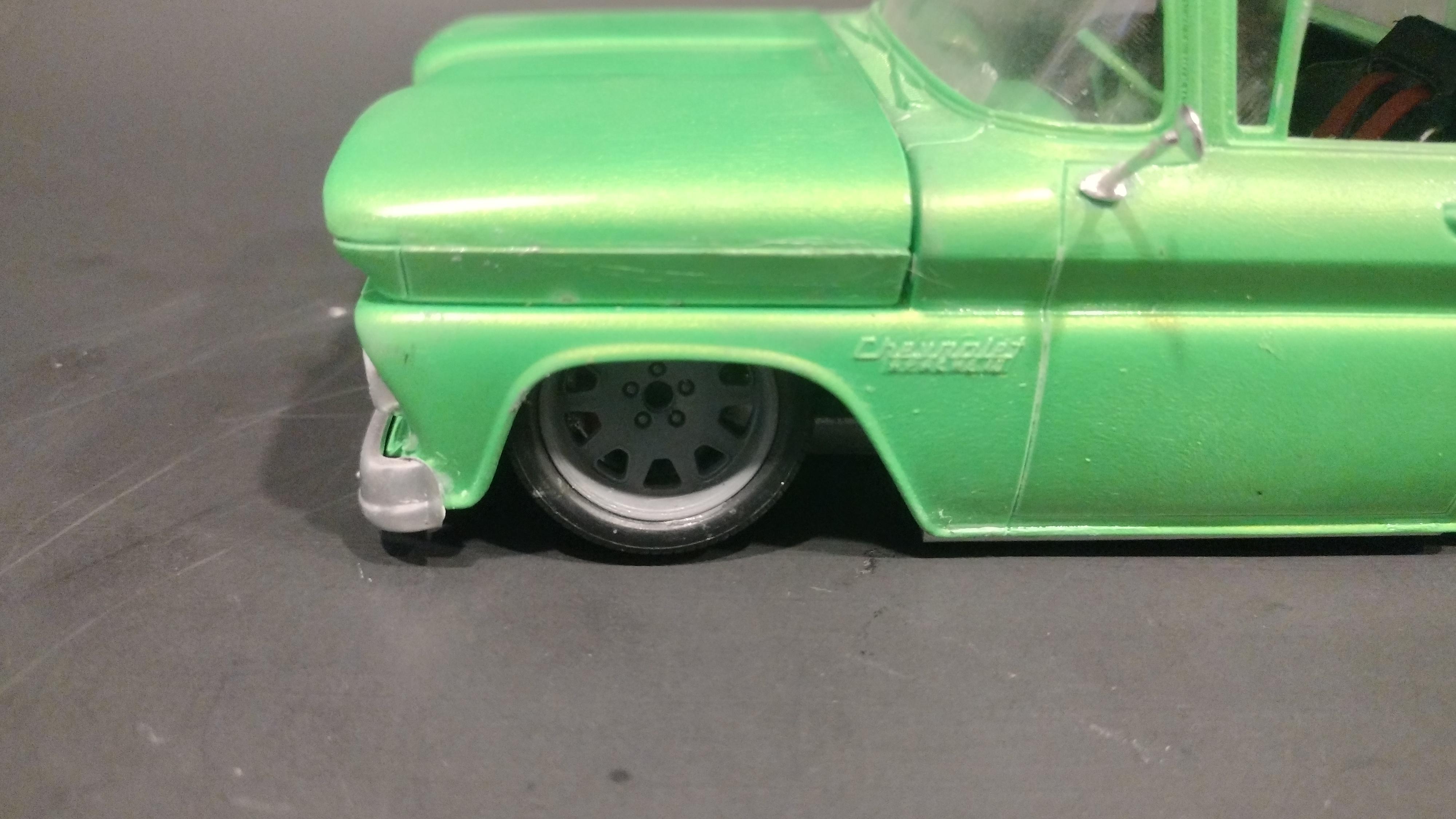

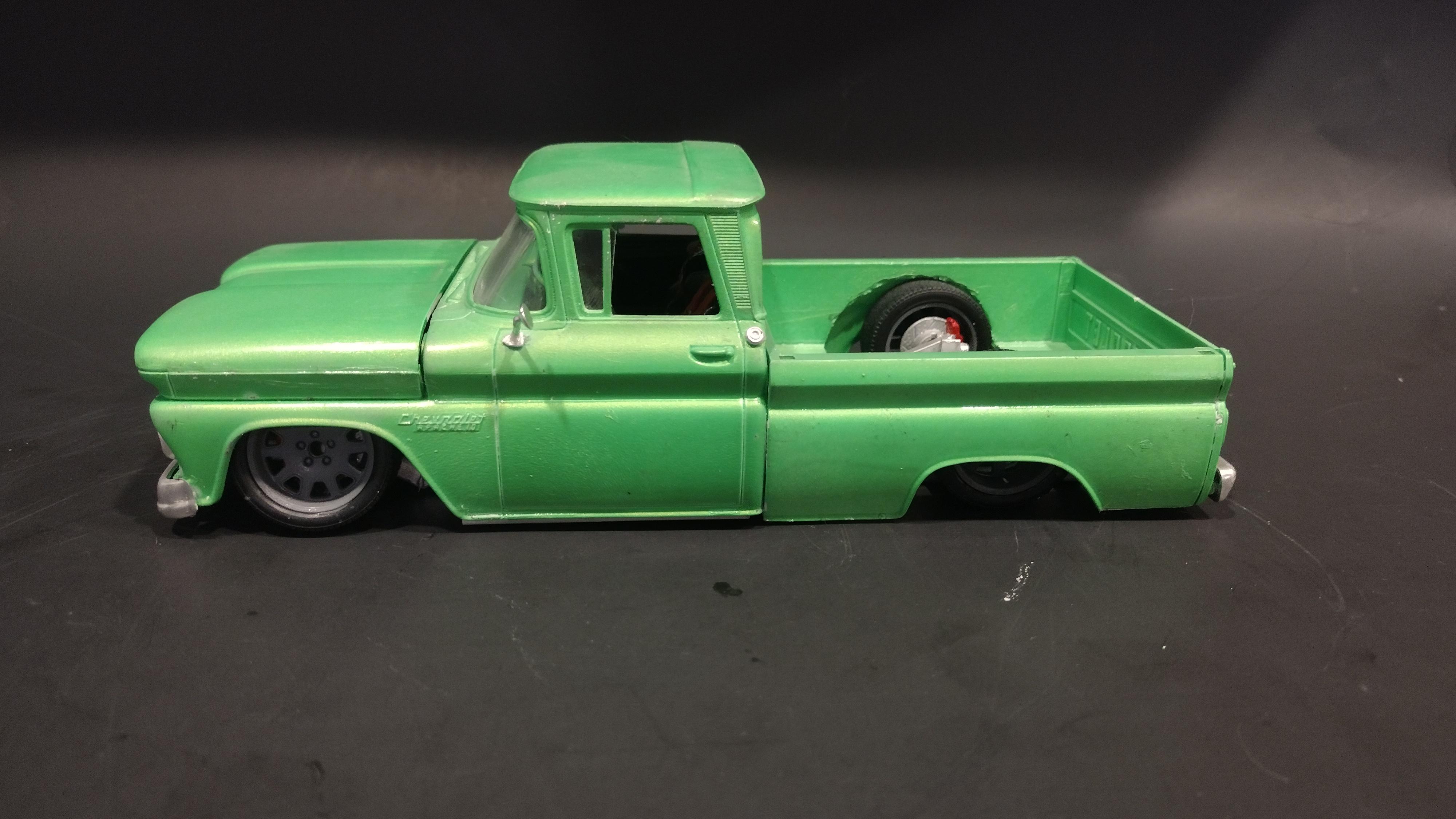

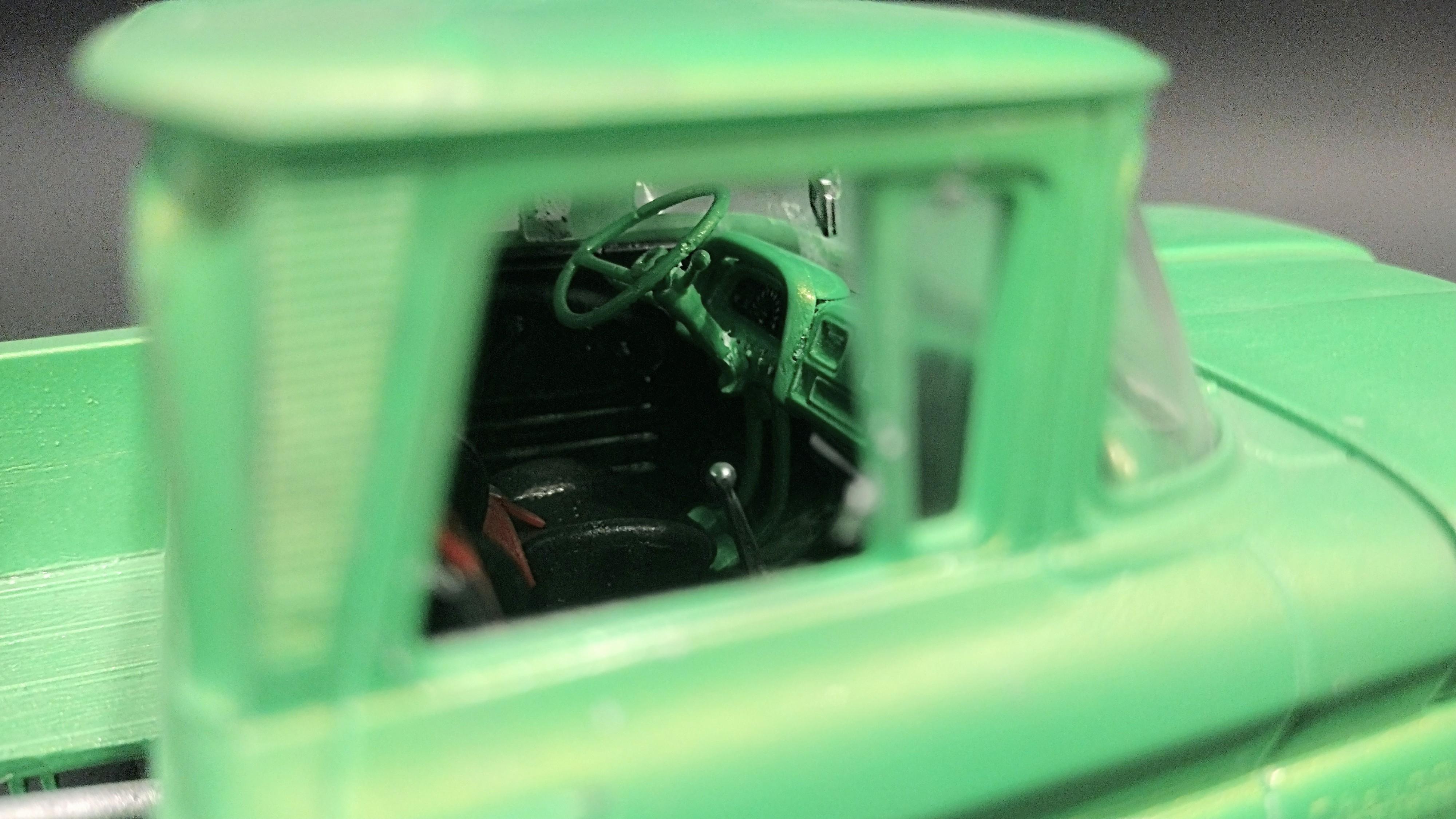

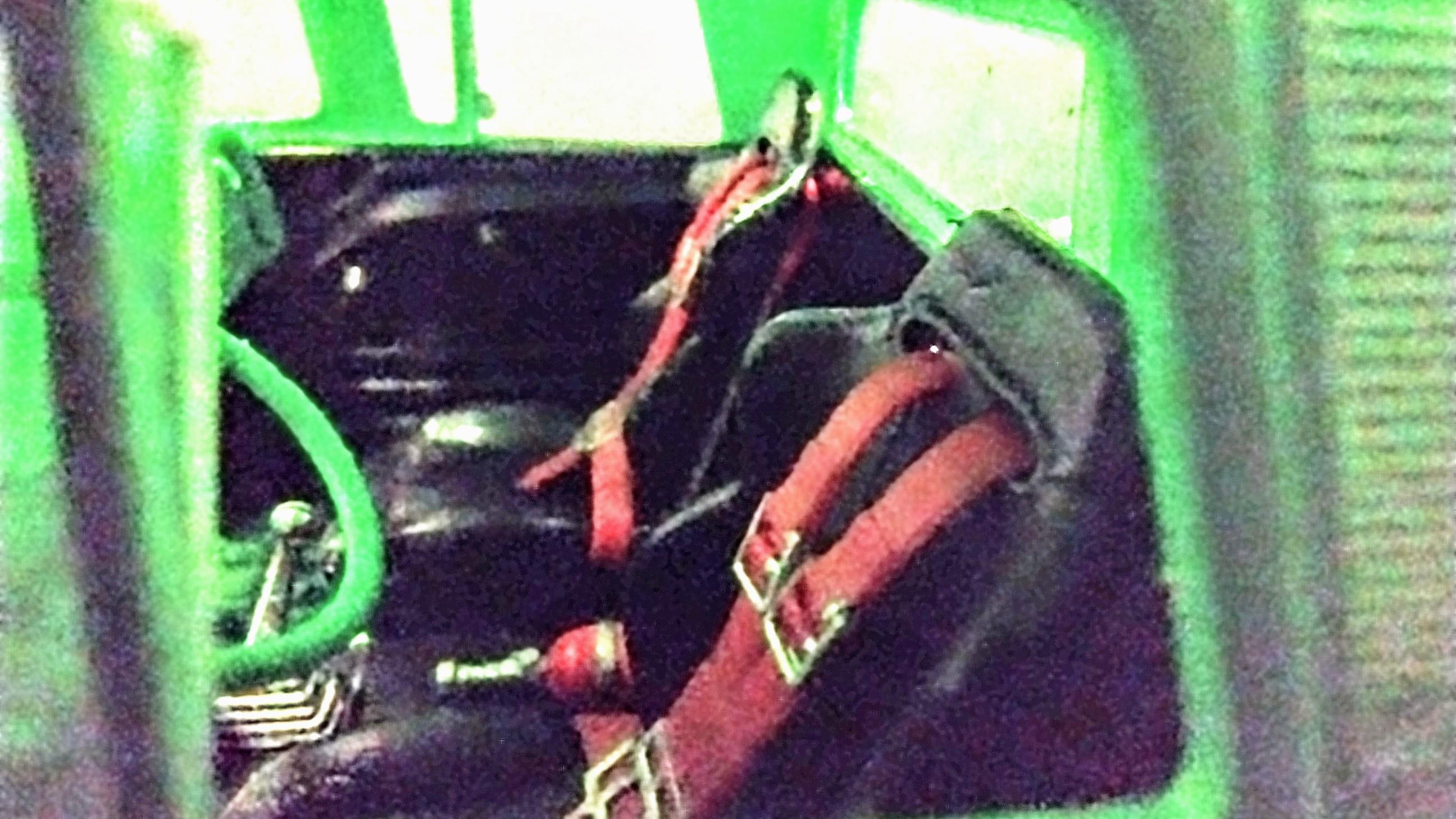

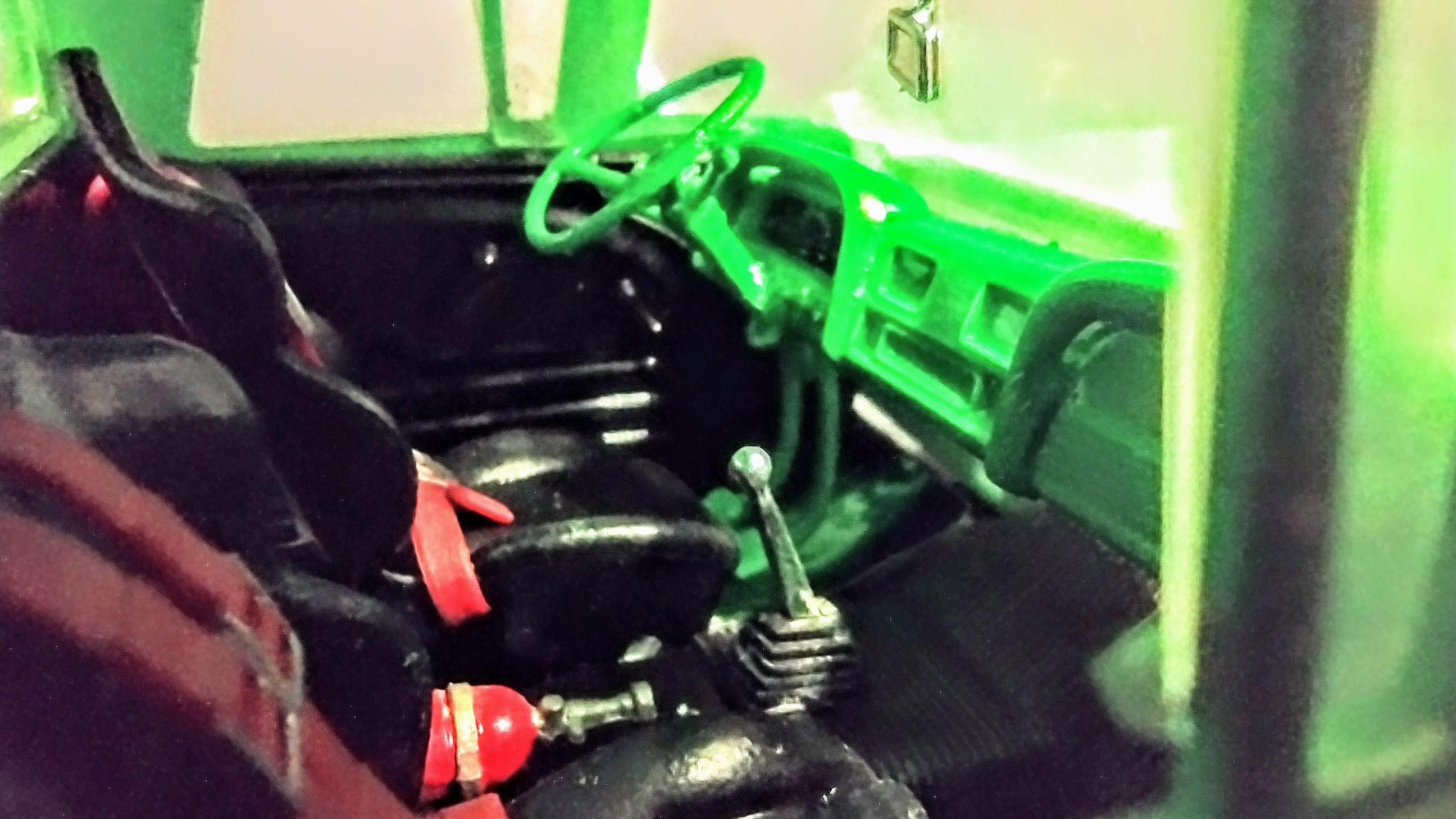

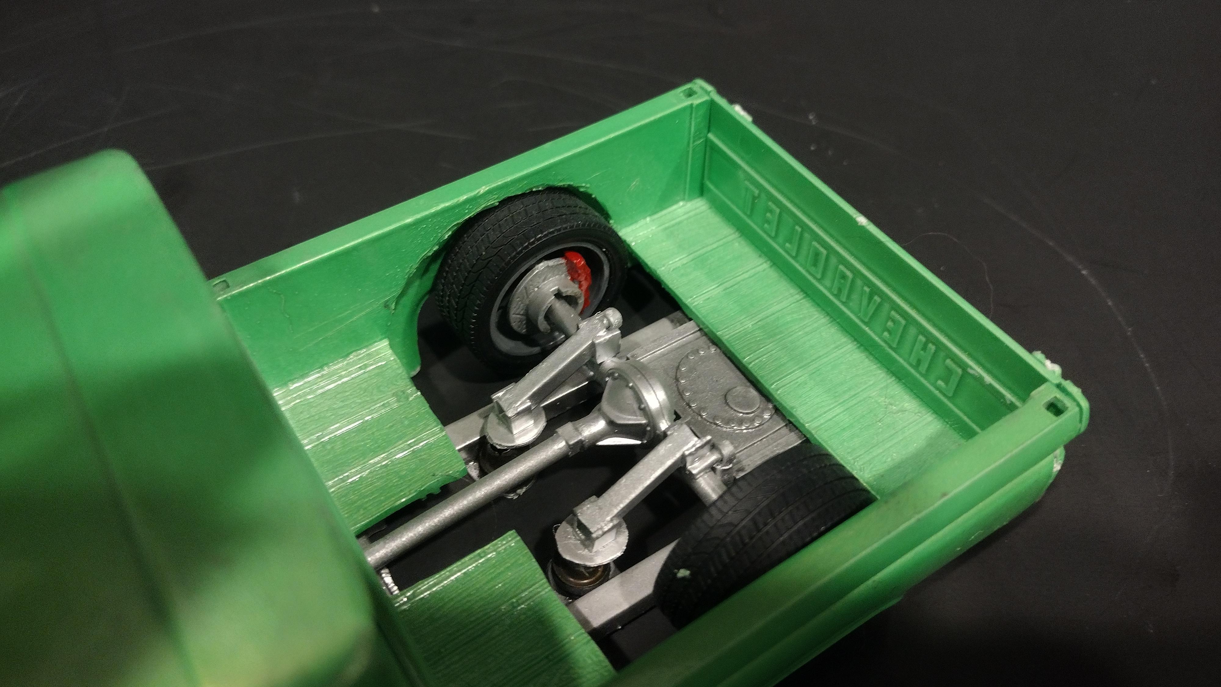

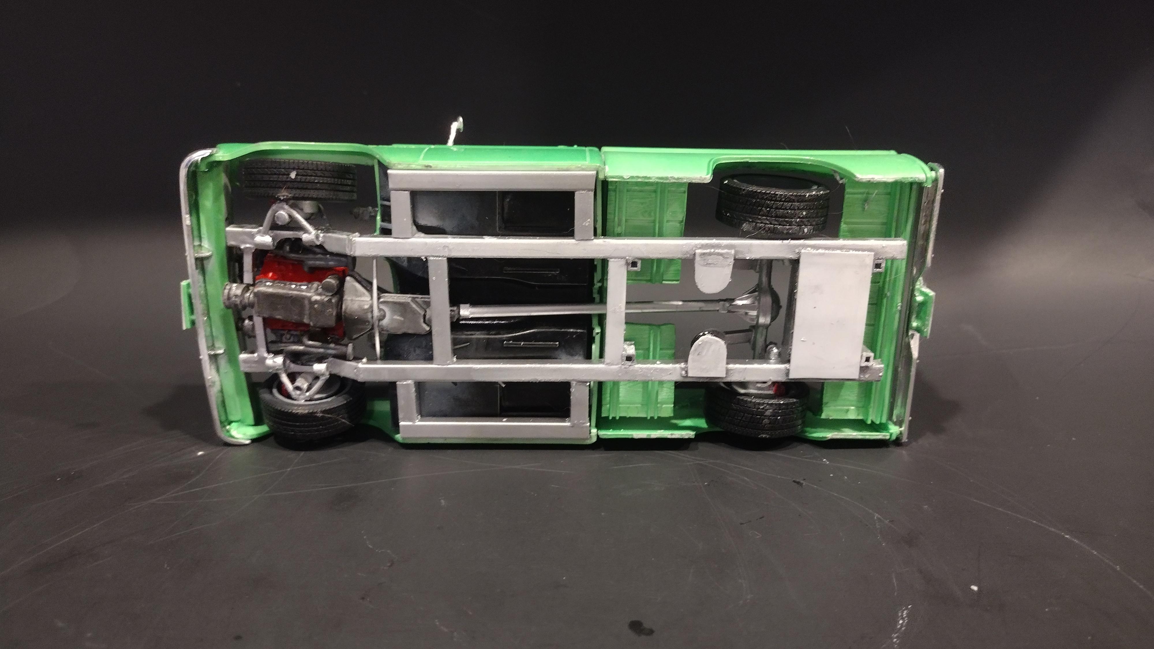

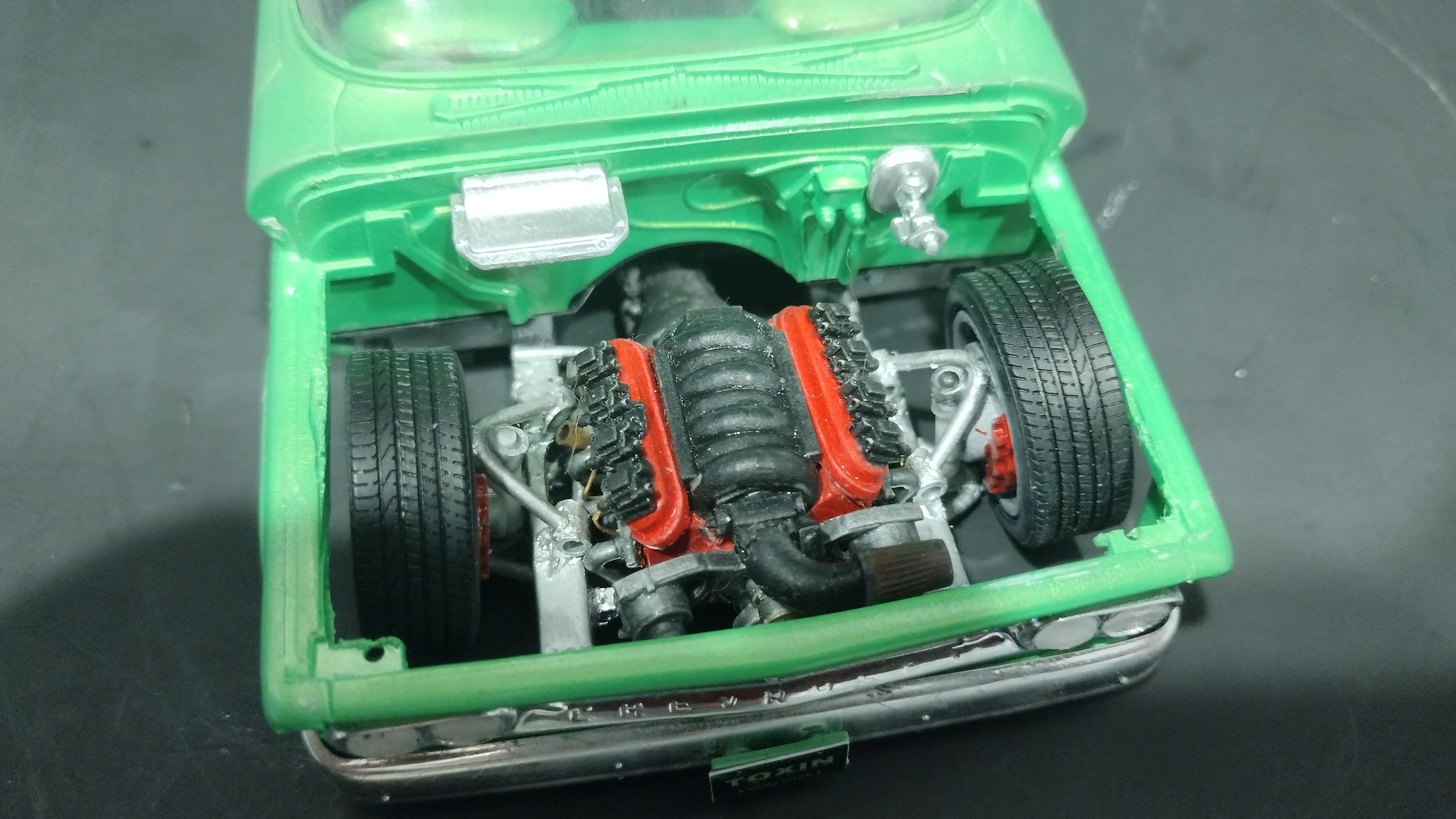

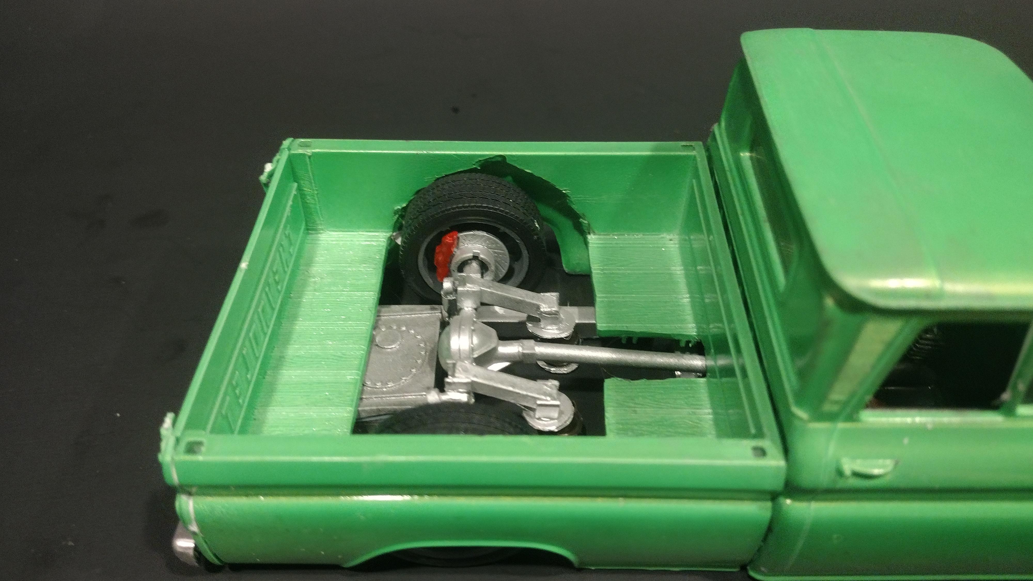

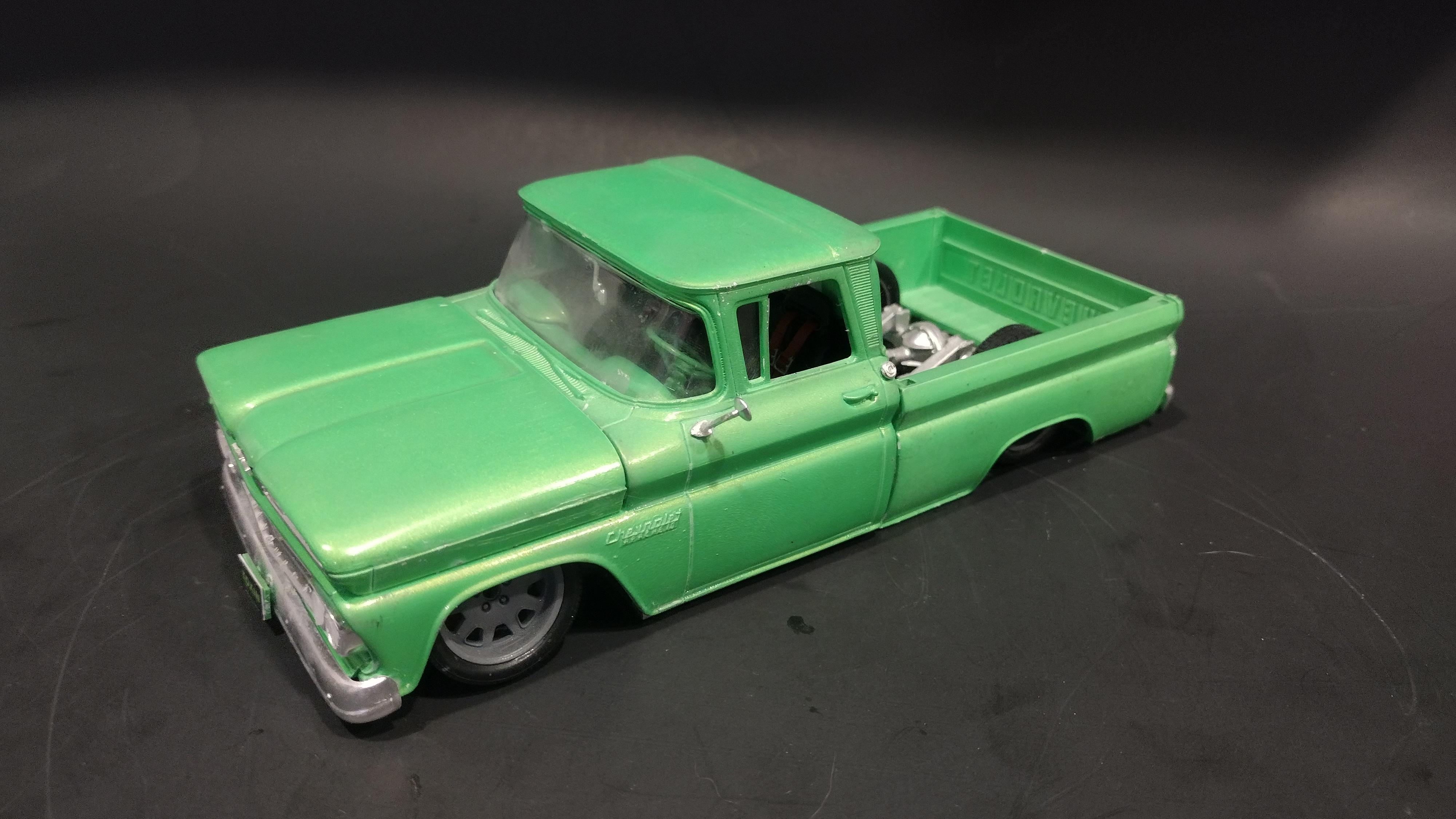

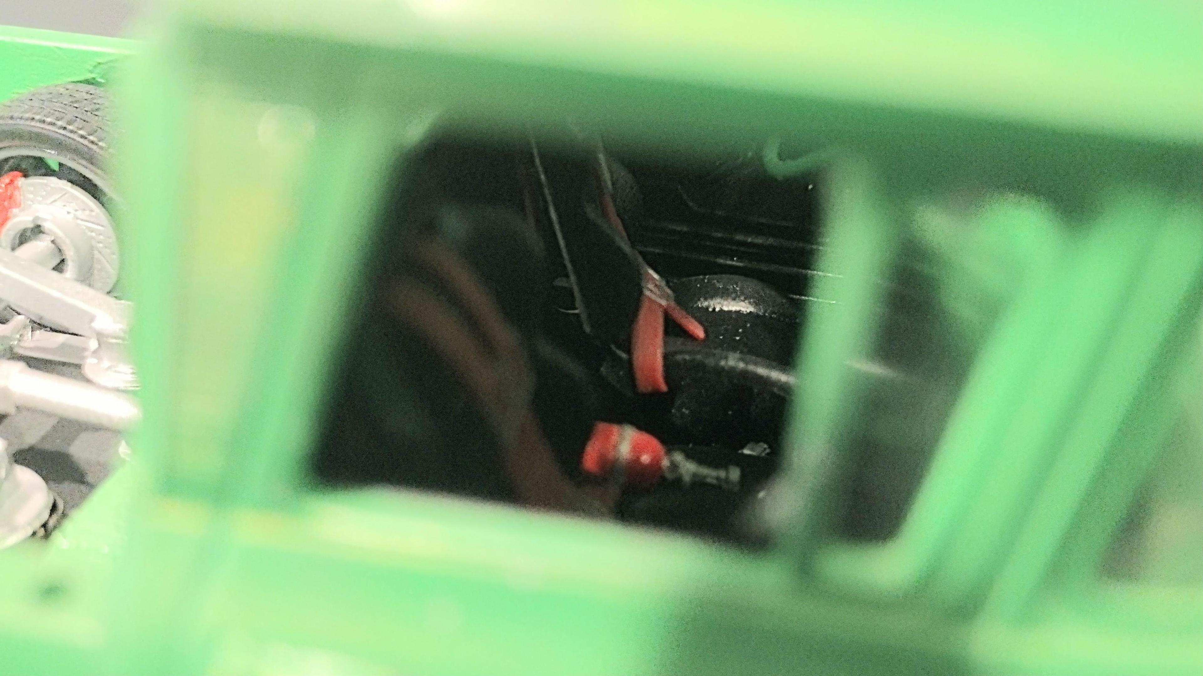

I call it TOXIN. It's painted with a Kustom Canz Base Pearlz Sugar Apple. The wheels are from the Fast and Furious Plymouth GTX kit and paint with a Dark Grey primer with a Satin clear coat over the top. The frame is made from scratch. The custom airbag suspension is also completely scratch built. The airbags on the suspension are made out of two rubber o-rings I got at my local hardware store and two Eyelets I found at Hobby Lobby. The fuel cell is 3D printed. I had to cut out the rear wheel tubs and certain spots in the bed in order to get it to sit low. The frame and suspension is painted with a Rust-Oleum Aluminum color. The engine is a 3D printed Iceman Collections modern LS Corvette engine. The engine wiring is done using bead wire I got at one of my local craft stores. I even added a dip stick tube made from a piece of brass tubing. The drive belt is a rubber hair band I got at Walmart. The racing seats and the fire extinguisher came from a diecast 2010 Chevy Camaro kit. The seats are painted with a Matte Black color. The floor mats I designed myself. The shifter was just a part I had laying around. The license plate is one I custom designed for this specific build. I built this for a SEMA themed build off on Instagram in 2020.
