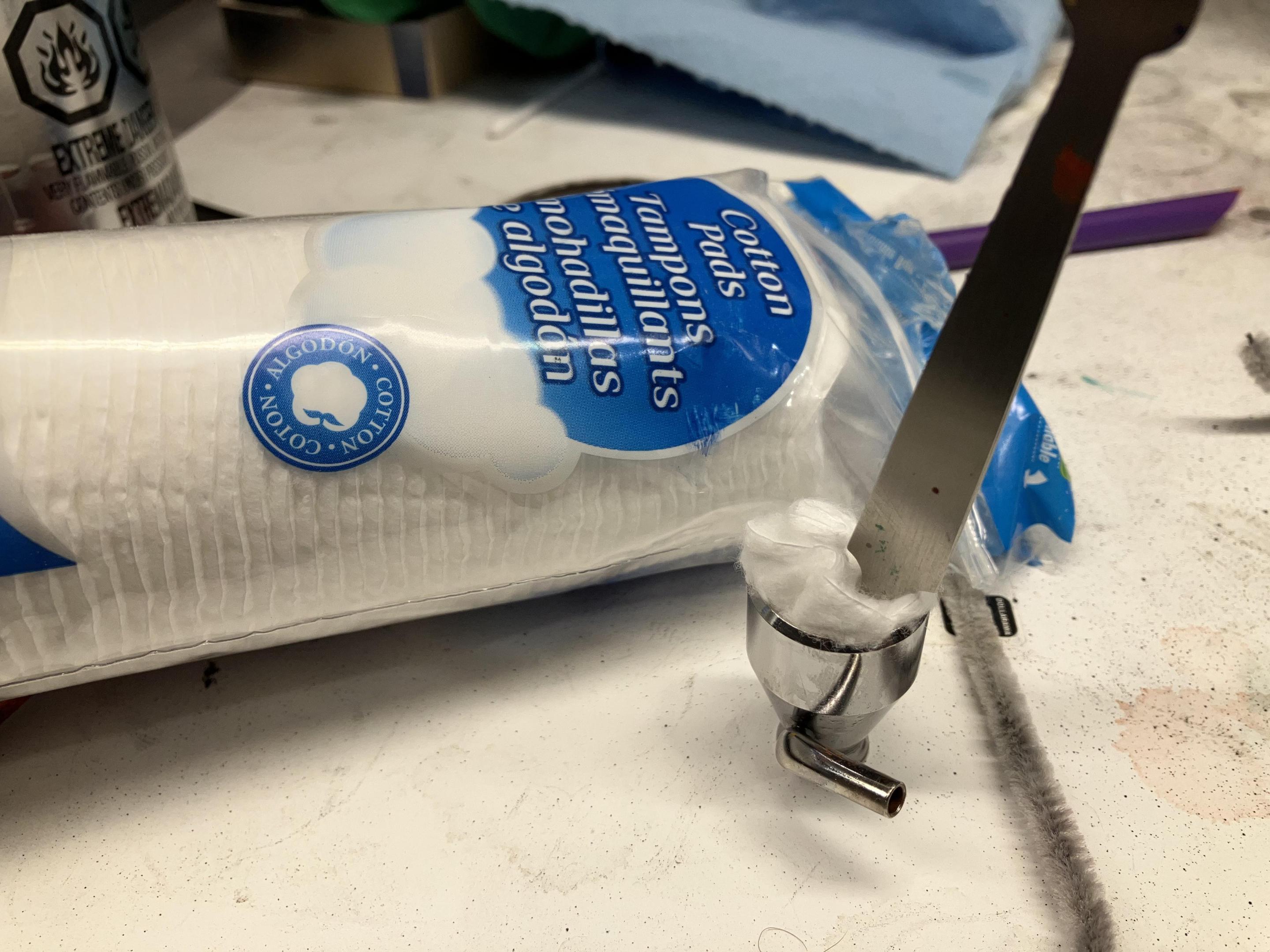

NOBLNG Posted January 29, 2023 Posted January 29, 2023 These little round makeup remover pads are great for wiping out the paint cup. I got this big bag at Dollarama for $1.25.? 1
Dpate Posted January 29, 2023 Posted January 29, 2023 I use a iwata washing brush, and back flushing, and spraying multiple times, and than a thin micro fiber towel for cleaning between colors. I use to use a shop towel, but that was causing lint to get inside. Your idea is great for color cups that can be removed.
