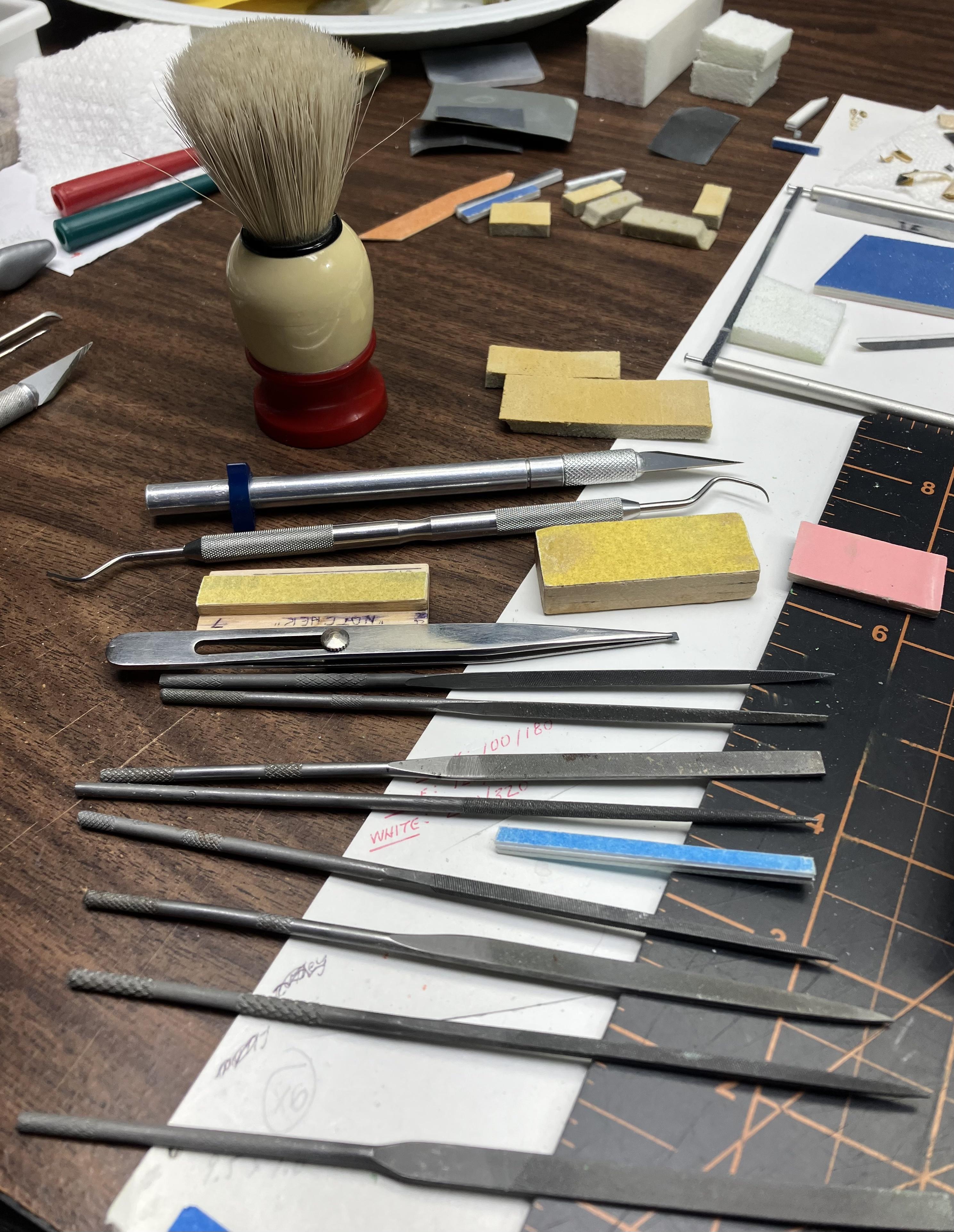

Sanding and cleaning model parts of excess flash and whatever else needs attention is something most all modelers attend to.  Here are some of the items I use while addressing the various model items in a kit.

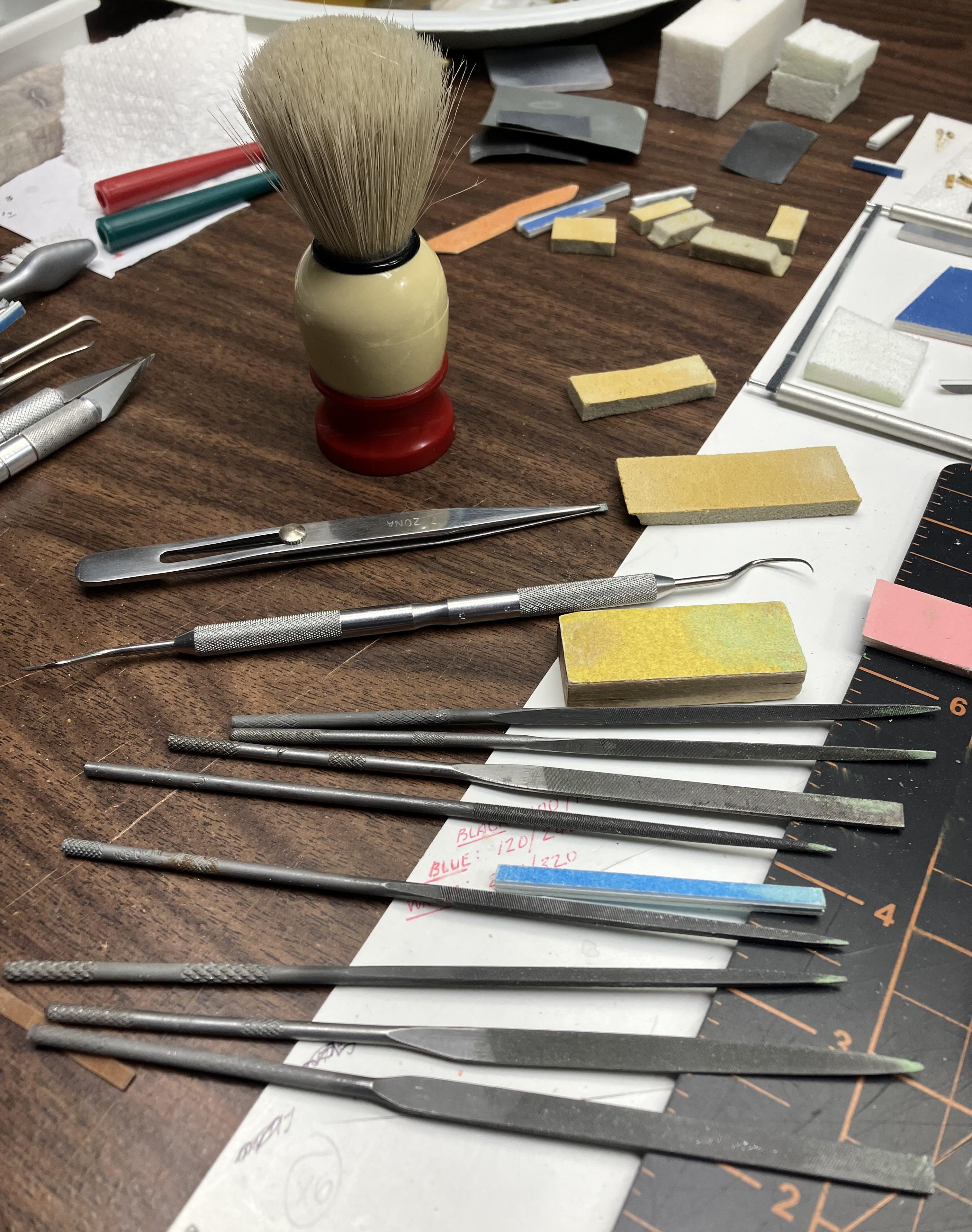

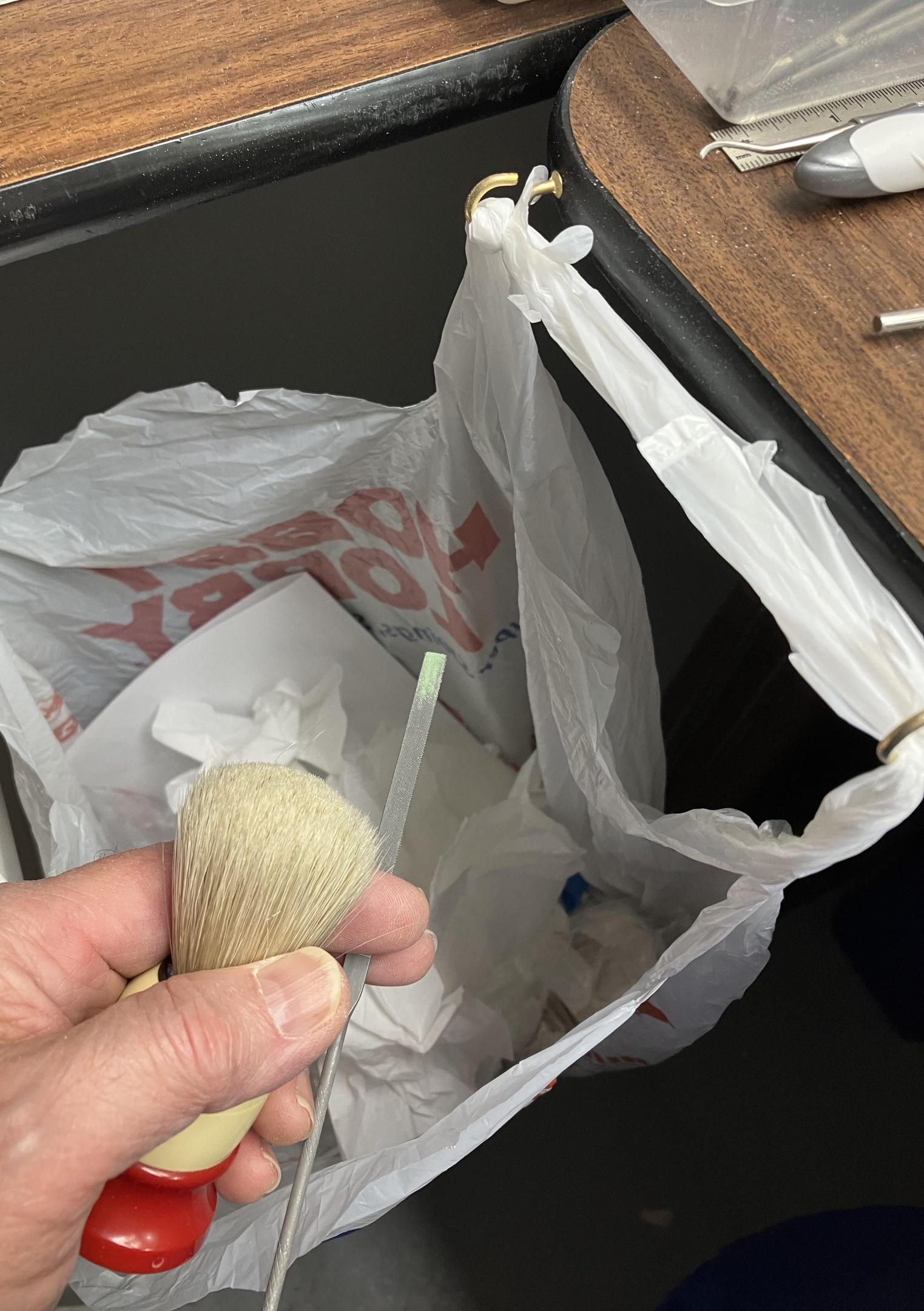

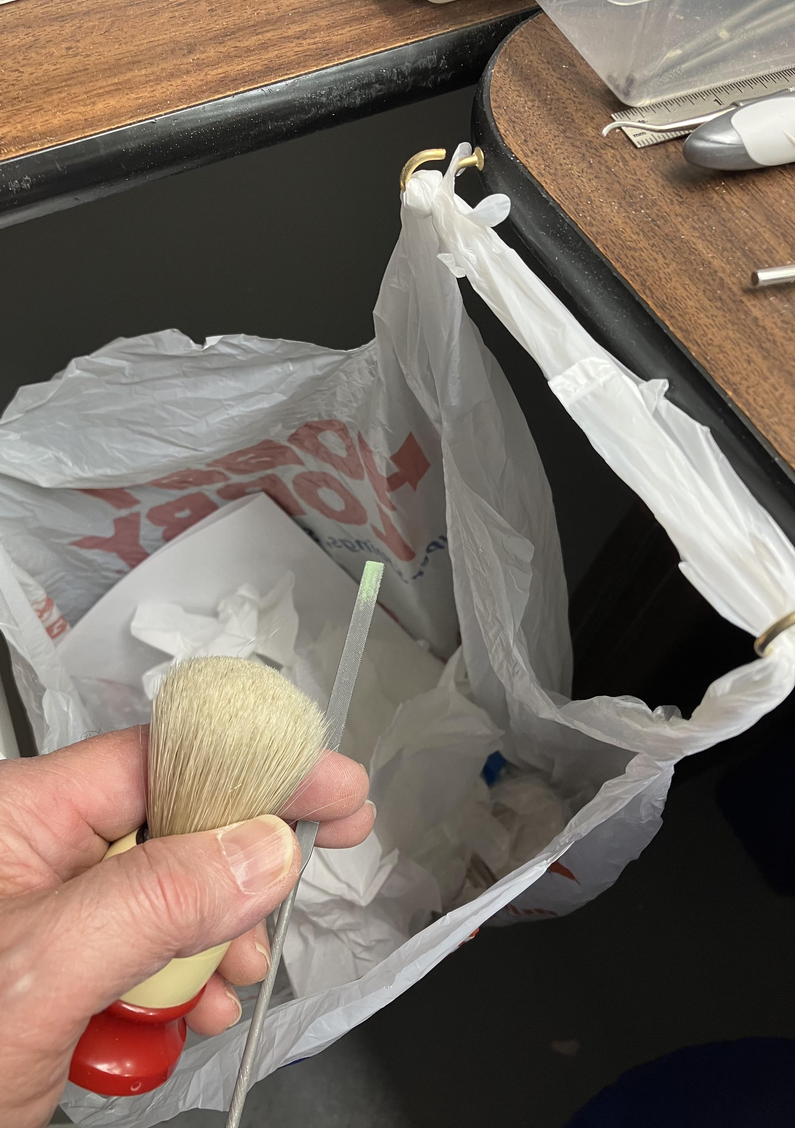

1).  Files and sanding devices, like sandpaper, can clog up quickly when used for plastic model work.  I use an old fashion shaving cream brush as my “go to” for quickly removing the plastic residue from the sanding/cleanup items, and, to brush the sanding dust off the part itself. I have a small plastic bag next to the bench and brush off everything requiring attention over the open bag. Keeps things somewhat tidy.

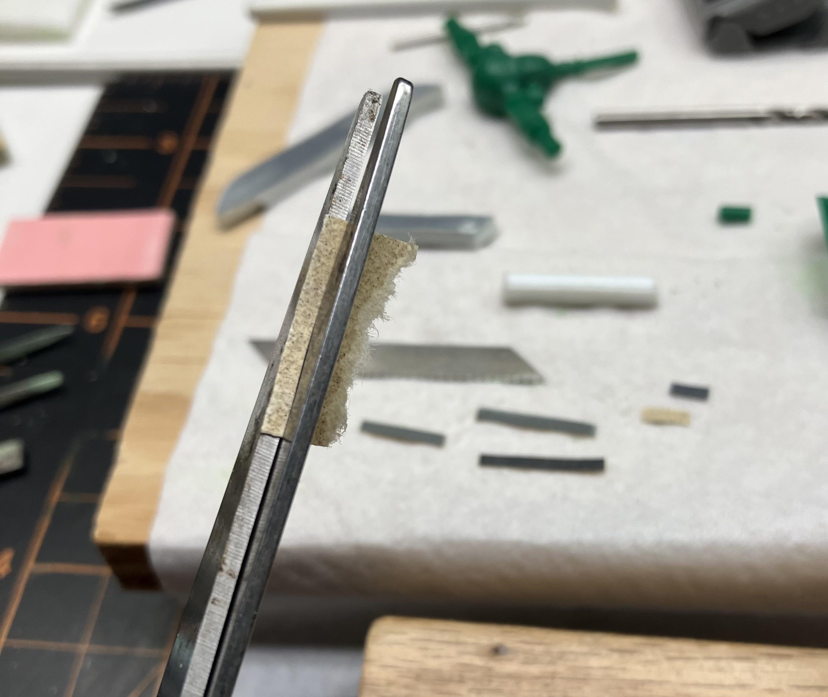

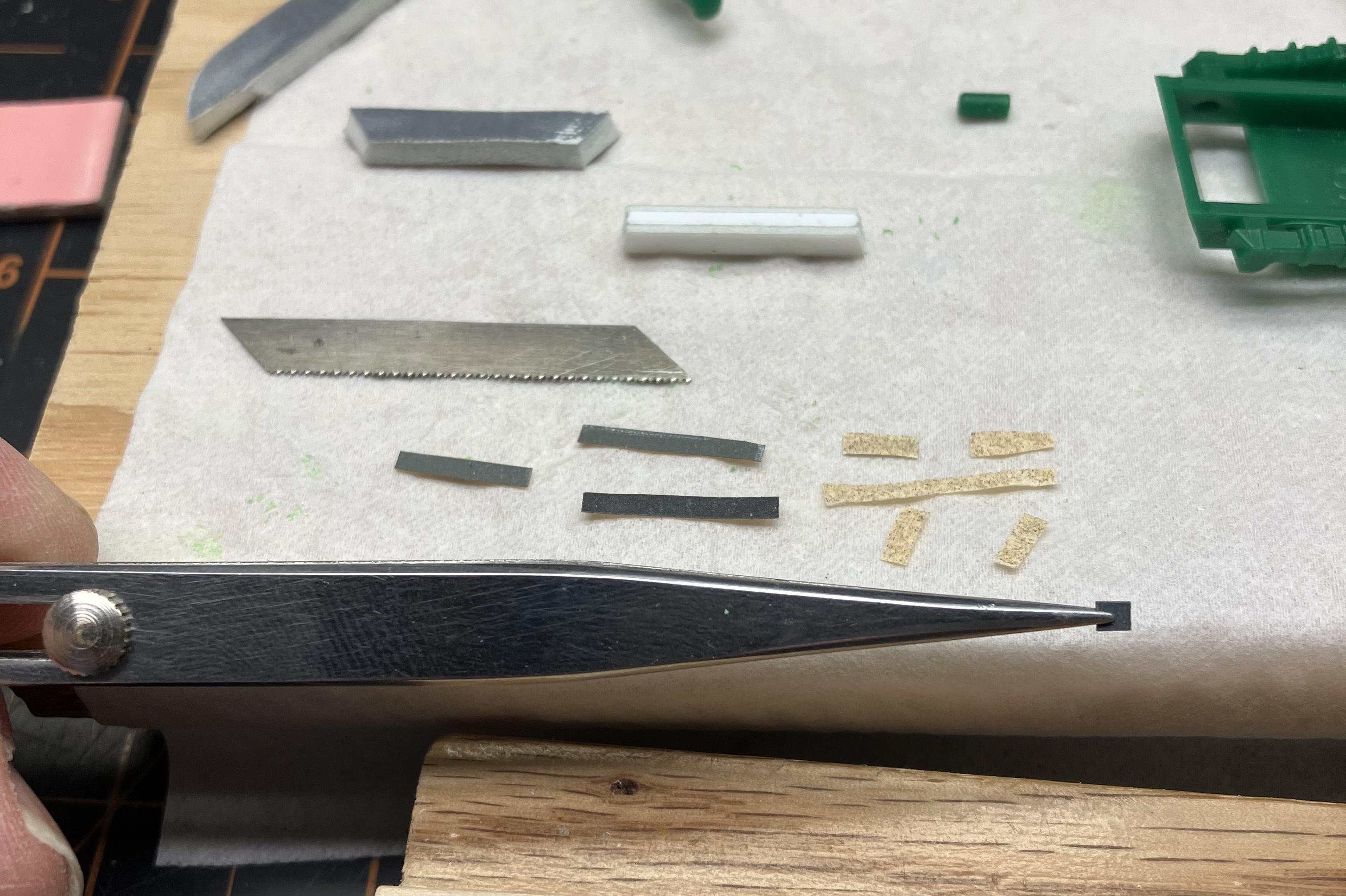

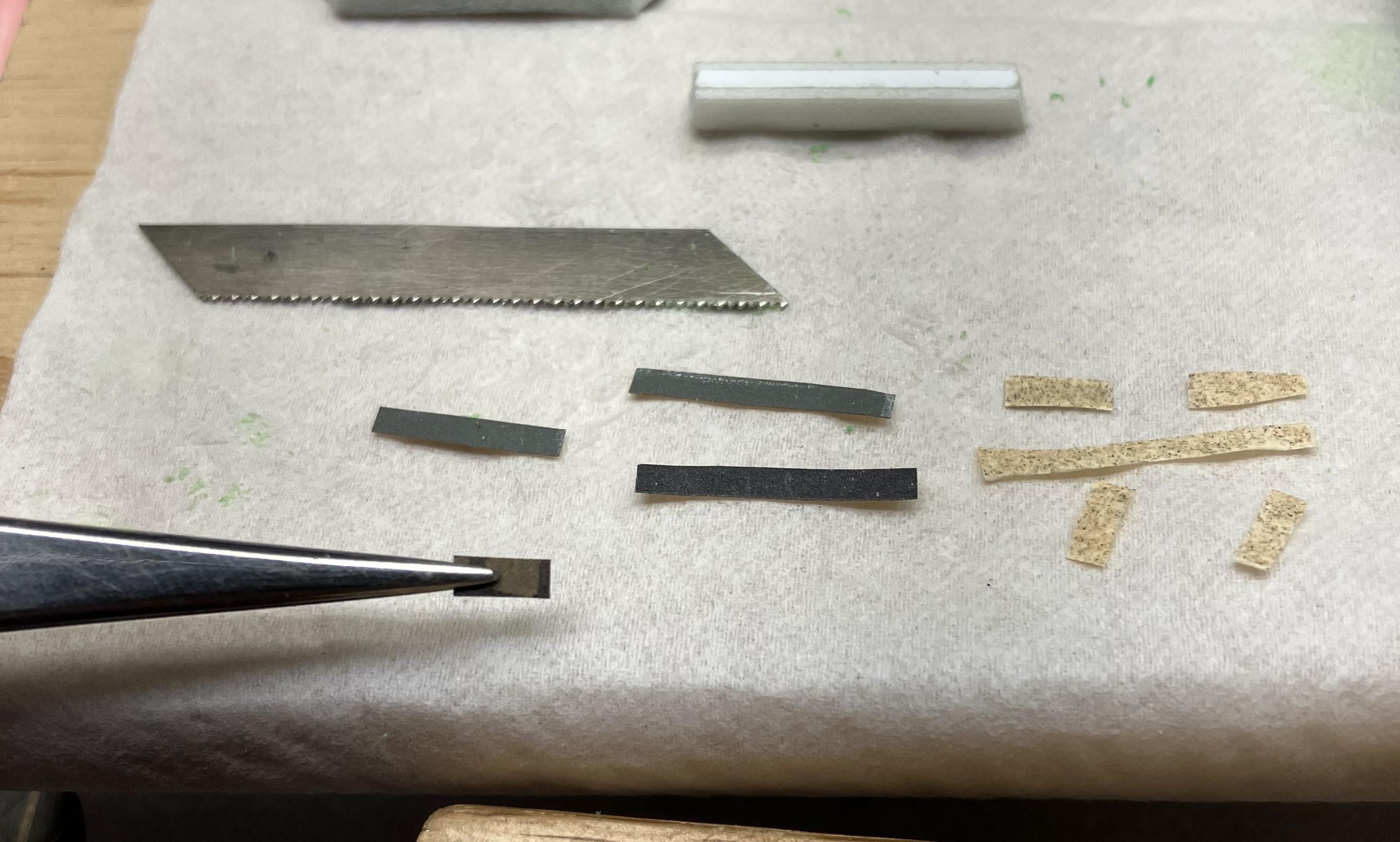

2).  Often, there are areas on model parts that require sanding/cleaning and it can be a chore to get into a tight and/or close part molding.  I found that using small strips of various grit sandpaper, folded back on itself, and held with locking tweezers, can really help during the cleaning of parts. Just be sure to fold those small sandpaper strips so that you keep the tweezer points away from the plastic. I can quickly change sandpaper grits as required and can use both sides of a given strip and all the strip edges to get into and around the part as needed.

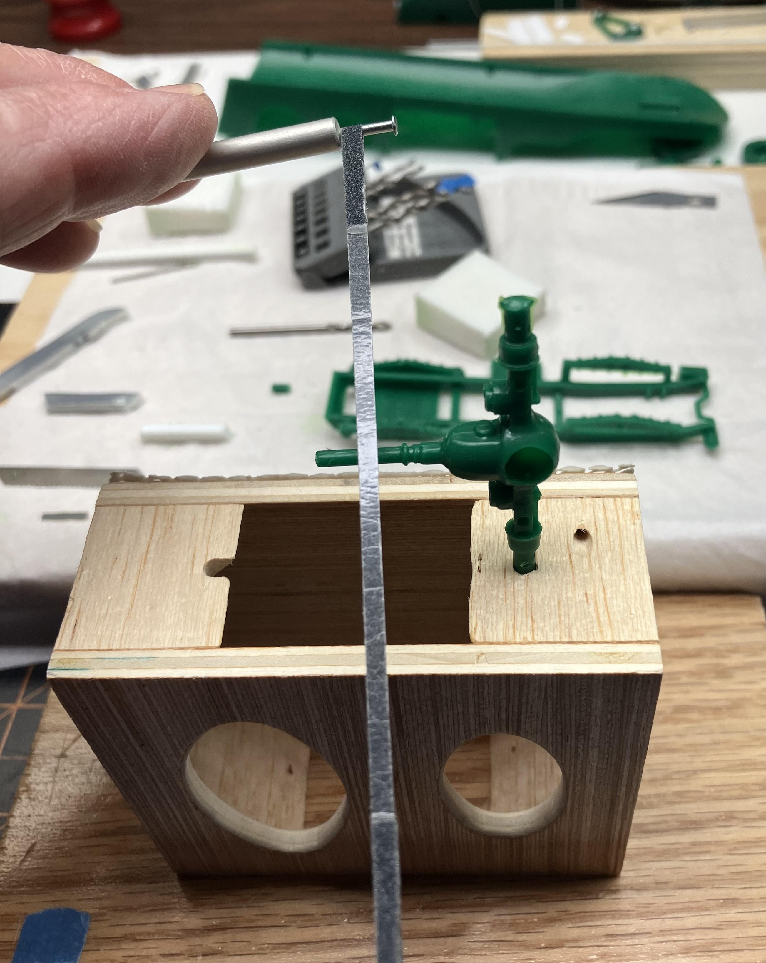

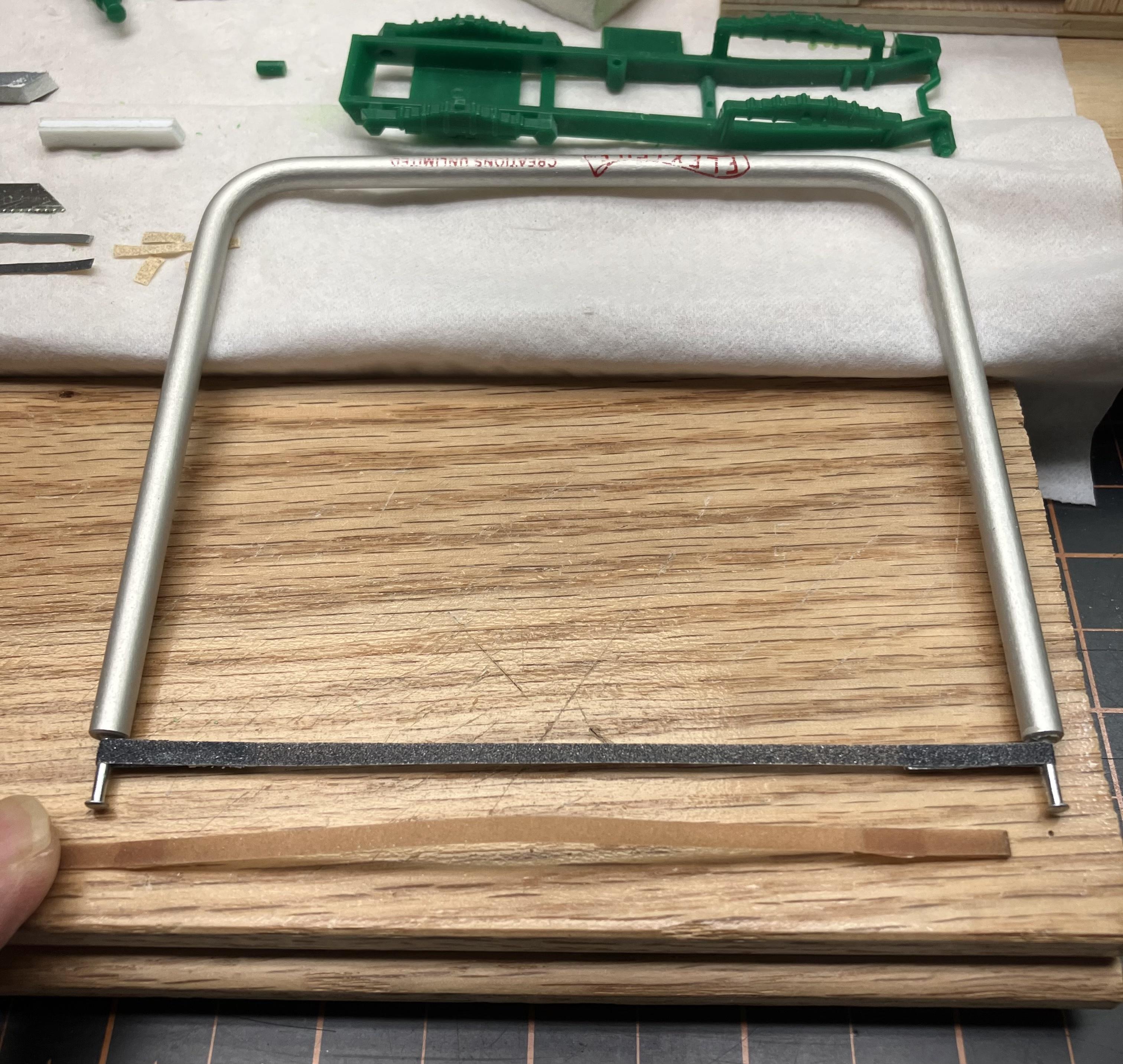

3).  Sanding cylindrical shapes, like exhaust piping, axles, steering columns as a few examples, can easily lead to flat areas on a plastic surface. A tool that I used while building RC model aircraft when sanding cylindrical/round items is called a Flexfile. It uses narrow strips of various grit sanding paper, held on a bow shaped tool. I find that this is yet another welcome tool for use on plastic model parts. Very easy to use and can go a long way to help me get a plastic model item looking nice.
