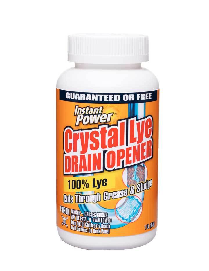

Dale361 Posted February 23, 2023 Author Posted February 23, 2023 Well, as usual, I'm proved that there are more ways to skin a chrome plated cat. All because of the awesome knowledge here at The Forum. Dusty, I looked for the product you use but seems hard to get. Jeff, pricey, but thanks. Peter and Jason, 35 years of firefighting my nostrils are not thrilled with harsh fumes. I found a product called Crystal Lye drain opener. Available at Home Depot. Hope a mask is not needed! Gonna head out tomorrow to pick some up. I'm hoping it works like Dusty, Peter and Jason said Lye works. Thanks guys. Your knowledge and this forum has advanced my building incredibly!!!! I'll let you know how it goes.
Dpate Posted February 23, 2023 Posted February 23, 2023 (edited) On 2/23/2023 at 4:35 AM, Dale361 said: Well, as usual, I'm proved that there are more ways to skin a chrome plated cat. All because of the awesome knowledge here at The Forum. Dusty, I looked for the product you use but seems hard to get. Jeff, pricey, but thanks. Peter and Jason, 35 years of firefighting my nostrils are not thrilled with harsh fumes. I found a product called Crystal Lye drain opener. Available at Home Depot. Hope a mask is not needed! Gonna head out tomorrow to pick some up. I'm hoping it works like Dusty, Peter and Jason said Lye works. Thanks guys. Your knowledge and this forum has advanced my building incredibly!!!! I'll let you know how it goes. Expand This stuff right? If so yes that will work 100% removing the chrome better and faster than all other products and it's cheaper. You'll know when it loses it strength when it's slow at removing the chrome. That's when you just make fresh new water or just add little more lye to water already made. Remember to add it to the water not the other way around. This prevents a dust cloud - just take a plastic spoon or measuring spoon and scoop some up and sprinkle it in the water. You can slowly mix it or let dissolve on its own if you want. Add chrome and watch it vanish like magic lol. New kits chrome vanishes in seconds, and older kits can take 30secs to a min. That's better than hours or days of waiting lol. My routine is basically after the chrome is off i use tweezers to grab the parts give a good swish around and put on shop towel or whatever and give them a good wash and scrub. This stuff will not remove the varnish though I've tried by leaving parts in for days, and doesn't touch the varnish. Might need scalecoat for that or try 91%-99% alchohol. That other product i listed is hard to get cause it's all ways out of stock for some reason but man does it work, and the only down side to it is the smell. It's strong even stronger than lacquer thinner, but it doesn't hurt plastic at all unless it's left for days. The max is 13 hours with that stuff, but I've never had to leave anything that long. Edited February 23, 2023 by Dpate 1

peteski Posted February 23, 2023 Posted February 23, 2023 Just be very careful with lye as it is very caustic. Remember, in some old crime drama movies it was used to dissolve dead bodies. Not sure how true that is, but it will attack your skin. Also pay attention to the instructions on the container regarding how to mix it with water. And don't use metal containers to hold the solution. Just for fun, drop a apiece of aluminum foil in the lye solution to see what happens, and as I mentioned, the kit's "chrome" is actually a very thin layer of aluminum (much much thinner than aluminum foil). 1
Dale361 Posted February 23, 2023 Author Posted February 23, 2023 OK. Peter. Help me out. I found a crystal drain cleaner that claims 100% lye. Filled a plastic container, about 4X6 with about an inch of water. Added about a tablespoon of the crystals. Swirled it around then added some chrome tree cuttings. It started working right away. I did not realize how hot it would get. My first container was one that fresh mushrooms are packaged in. Thin Plastic. It began to collapse. Poured everything into a container of thicker plastic. The chrome was coming off but then it stopped working. Repeated the steps only this time doubled the amount of crystals. It got hot enough that it was not possible to hold the container at the bottom. It did remove the chrome, but it took two try's, an hour and the yellow coating was still there. Where am I going wrong?

Dpate Posted February 23, 2023 Posted February 23, 2023 On 2/23/2023 at 6:22 PM, Dale361 said: OK. Peter. Help me out. I found a crystal drain cleaner that claims 100% lye. Filled a plastic container, about 4X6 with about an inch of water. Added about a tablespoon of the crystals. Swirled it around then added some chrome tree cuttings. It started working right away. I did not realize how hot it would get. My first container was one that fresh mushrooms are packaged in. Thin Plastic. It began to collapse. Poured everything into a container of thicker plastic. The chrome was coming off but then it stopped working. Repeated the steps only this time doubled the amount of crystals. It got hot enough that it was not possible to hold the container at the bottom. It did remove the chrome, but it took two try's, an hour and the yellow coating was still there. Where am I going wrong? Expand lol Don't use any kind of plastic use PET, and shouldn't have an issue. Don't use full chrome tree's just the parts itself. If it seems like it's losing it's power i.e chrome taking awhile to come off just make fresh batch of water & lye. I also mentioned in previous post lye will not remove the yellow coating at all as I've tested that's why i do a 2 stage process. i only use the lye to remove chrome that's it.

Dale361 Posted February 24, 2023 Author Posted February 24, 2023 On 2/23/2023 at 10:02 PM, Dpate said: lol Don't use any kind of plastic use PET, and shouldn't have an issue. Don't use full chrome tree's just the parts itself. If it seems like it's losing it's power i.e chrome taking awhile to come off just make fresh batch of water & lye. I also mentioned in previous post lye will not remove the yellow coating at all as I've tested that's why i do a 2 stage process. i only use the lye to remove chrome that's it. Expand Thanks Dusty! The tree parts were my testing items. I had to look up what PET was and now it makes sense. As for the lye not removing the under coat, I got mixed up. Peter, PETESKI, made mention that the lye would remove it. Maybe his is a different brand. Anyway, I want to thank everyone for the info!

Dpate Posted February 24, 2023 Posted February 24, 2023 On 2/24/2023 at 12:07 AM, Dale361 said: Thanks Dusty! The tree parts were my testing items. I had to look up what PET was and now it makes sense. As for the lye not removing the under coat, I got mixed up. Peter, PETESKI, made mention that the lye would remove it. Maybe his is a different brand. Anyway, I want to thank everyone for the info! Expand No i doubt the lye is removing the varnish. Some other chemical in those products that contain lye is probably removing it, but it's not the lye. Think most of those products contain like 5% lye, and that's what removes the chrome, but not the varnish. Isn't much more proof needed when 100% lye can't remove it lol. I use to use superclean when i first started, and it would remove both chrome and varnish because of lye and other stuff that's in it. I quit using it though because when it failed to remove the varnish it would stain it purple. Maybe lye being mixed with other chemicals helps remove the varnish? Not sure, but when i tested it i left parts in 100% lye for days, and it didn't touch the varnish at all just made it cleaner lol. That paint remover product i showed earlier only has like 4-5 chemicals in it, and if i remember correctly one of them is acetone, but not like the acetone you get out of lowes etc. Stuff bout smells like nail polish remover, but stronger. Crazy thing is it will NOT remove chrome though simply cause it doesn't contain lye in it, but it will remove varnish and any kind of paint like no ones business. There is another product i got that i haven't tried yet, and it's this stuff in the picture. I'll eventually be testing it out on removing varnish from chrome parts.
Dale361 Posted February 24, 2023 Author Posted February 24, 2023 On 2/24/2023 at 1:06 AM, Dpate said: No i doubt the lye is removing the varnish. Some other chemical in those products that contain lye is probably removing it, but it's not the lye. Think most of those products contain like 5% lye, and that's what removes the chrome, but not the varnish. Isn't much more proof needed when 100% lye can't remove it lol. I use to use superclean when i first started, and it would remove both chrome and varnish because of lye and other stuff that's in it. I quit using it though because when it failed to remove the varnish it would stain it purple. Maybe lye being mixed with other chemicals helps remove the varnish? Not sure, but when i tested it i left parts in 100% lye for days, and it didn't touch the varnish at all just made it cleaner lol. That paint remover product i showed earlier only has like 4-5 chemicals in it, and if i remember correctly one of them is acetone, but not like the acetone you get out of lowes etc. Stuff bout smells like nail polish remover, but stronger. Crazy thing is it will NOT remove chrome though simply cause it doesn't contain lye in it, but it will remove varnish and any kind of paint like no ones business. There is another product i got that i haven't tried yet, and it's this stuff in the picture. I'll eventually be testing it out on removing varnish from chrome parts. Expand On 2/24/2023 at 1:06 AM, Dpate said: No i doubt the lye is removing the varnish. Some other chemical in those products that contain lye is probably removing it, but it's not the lye. Think most of those products contain like 5% lye, and that's what removes the chrome, but not the varnish. Isn't much more proof needed when 100% lye can't remove it lol. I use to use superclean when i first started, and it would remove both chrome and varnish because of lye and other stuff that's in it. I quit using it though because when it failed to remove the varnish it would stain it purple. Maybe lye being mixed with other chemicals helps remove the varnish? Not sure, but when i tested it i left parts in 100% lye for days, and it didn't touch the varnish at all just made it cleaner lol. That paint remover product i showed earlier only has like 4-5 chemicals in it, and if i remember correctly one of them is acetone, but not like the acetone you get out of lowes etc. Stuff bout smells like nail polish remover, but stronger. Crazy thing is it will NOT remove chrome though simply cause it doesn't contain lye in it, but it will remove varnish and any kind of paint like no ones business. There is another product i got that i haven't tried yet, and it's this stuff in the picture. I'll eventually be testing it out on removing varnish from chrome parts. Expand Awesome! Please let us know how it works. Thanks again.
