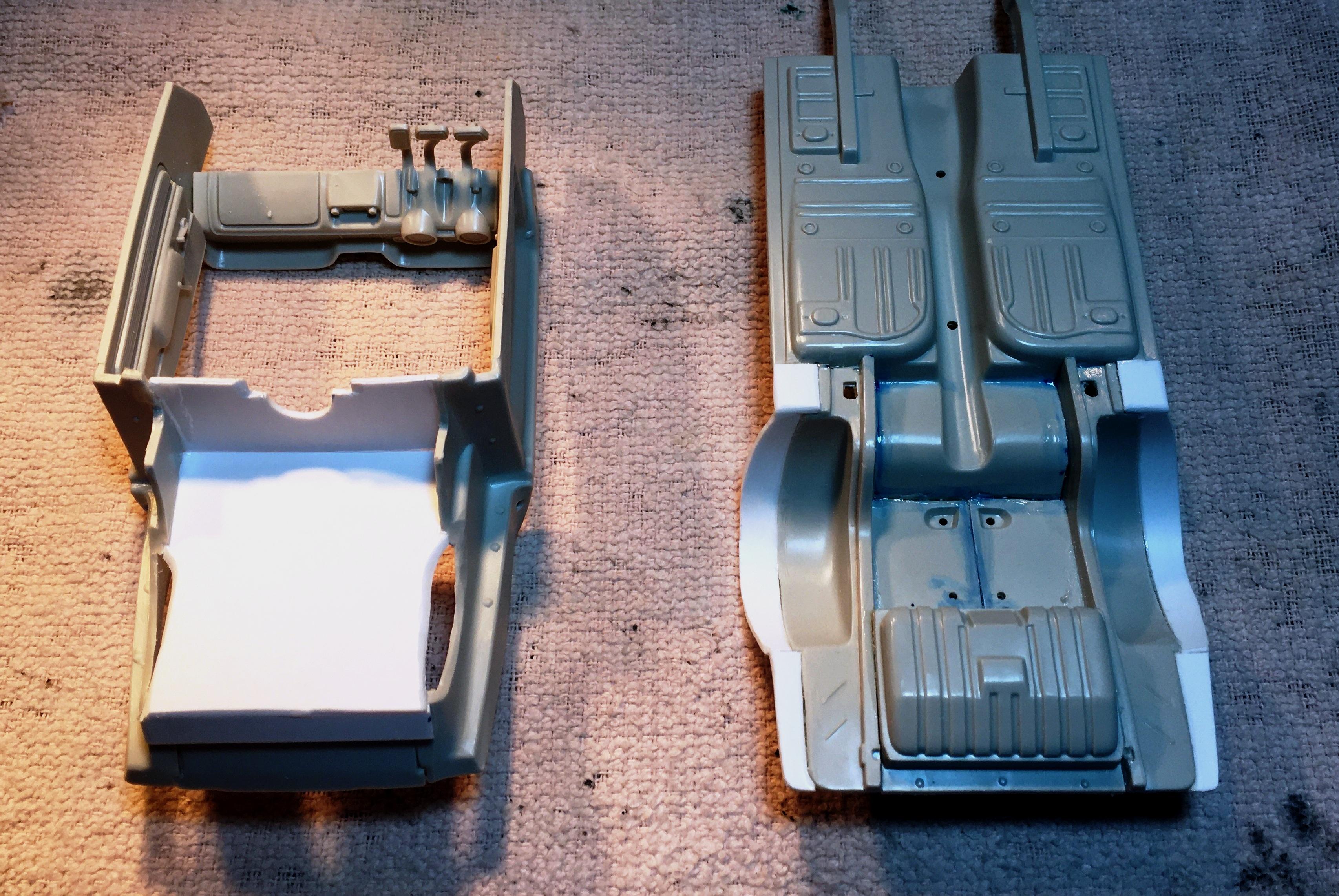

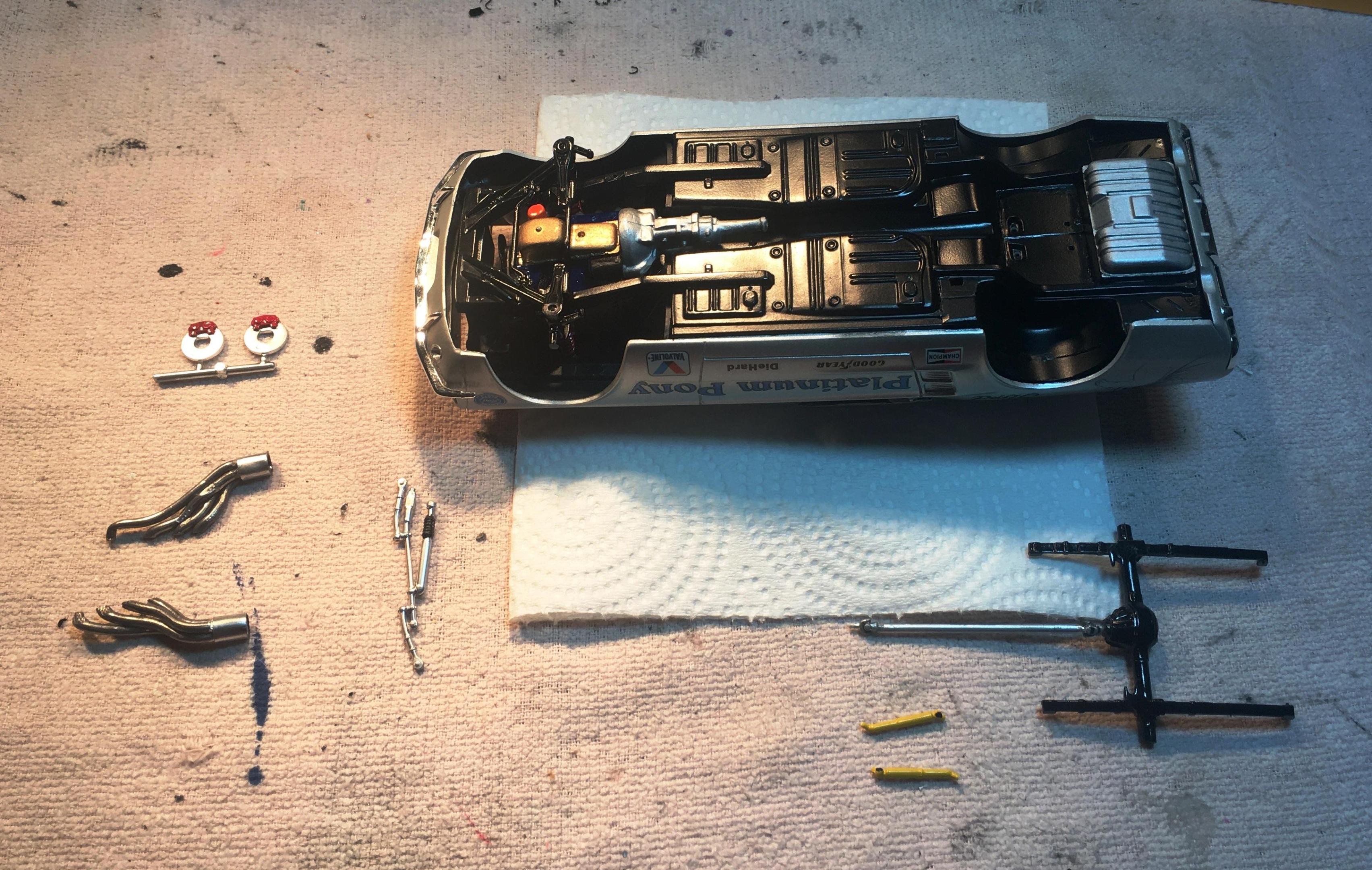

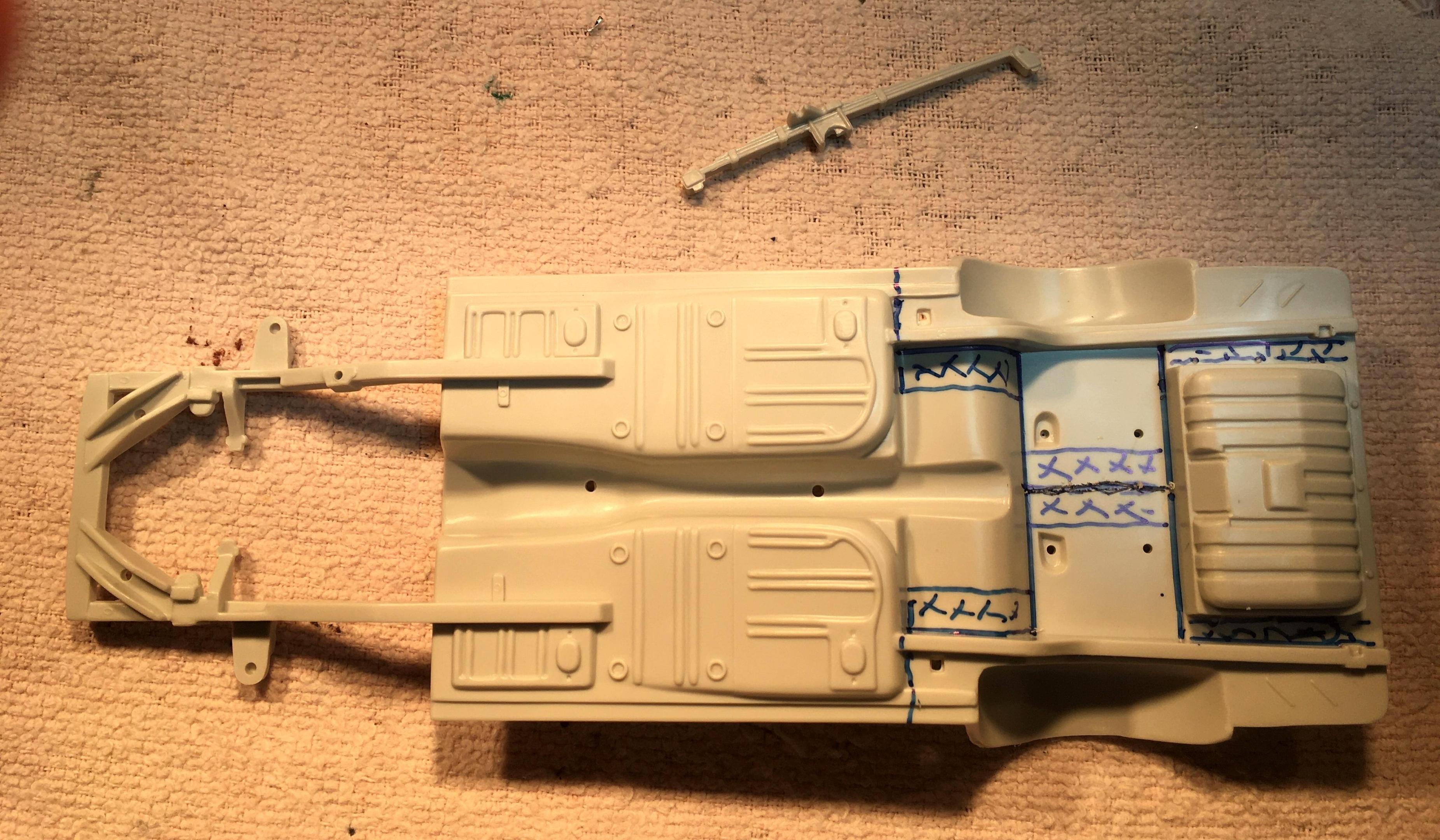

Nice progress. You build reminds me of my little 67 Mustang GT build. Solder headers were a tight fit because a 427 Ford Cammer is big in a Mustang engine bay. I did the mini tub by cutting strips inboard and adding material outboard,

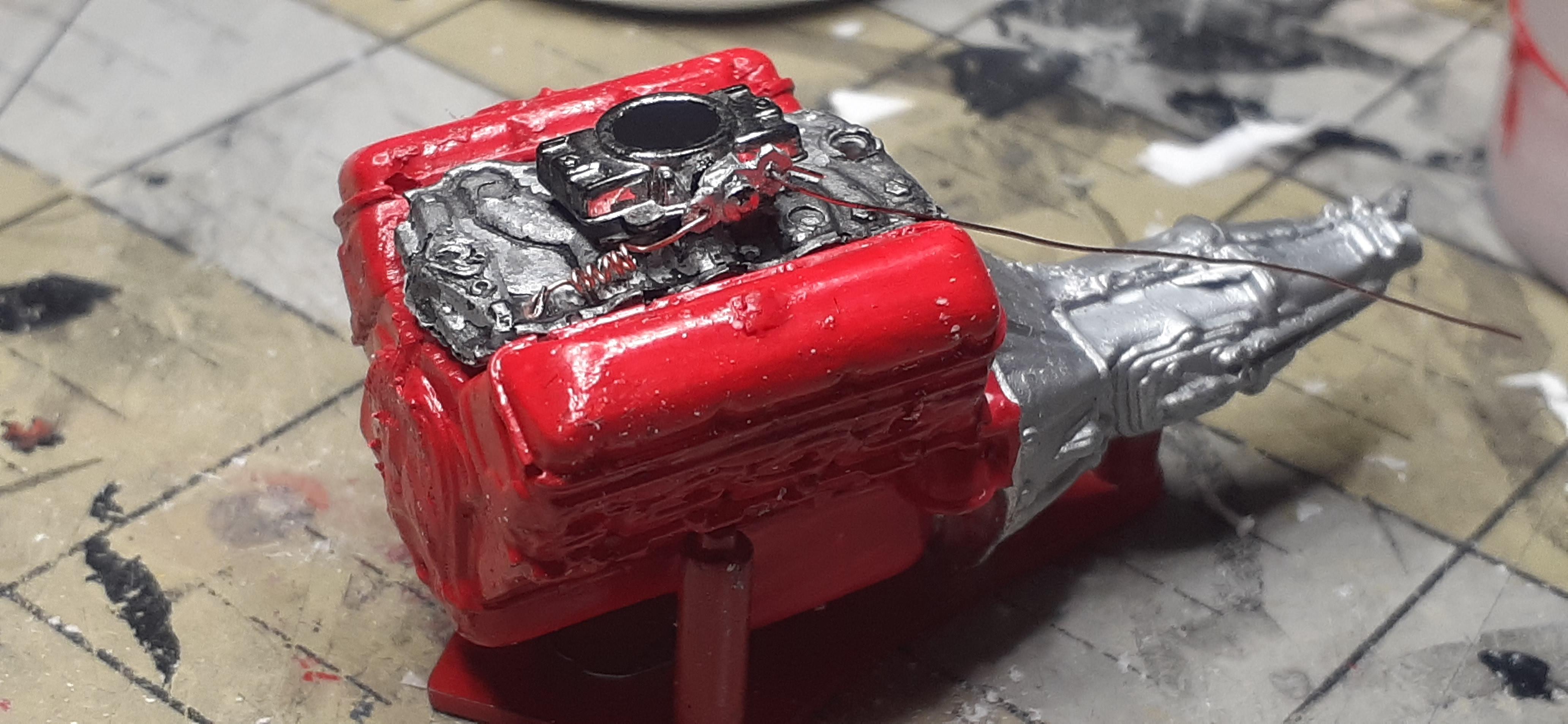

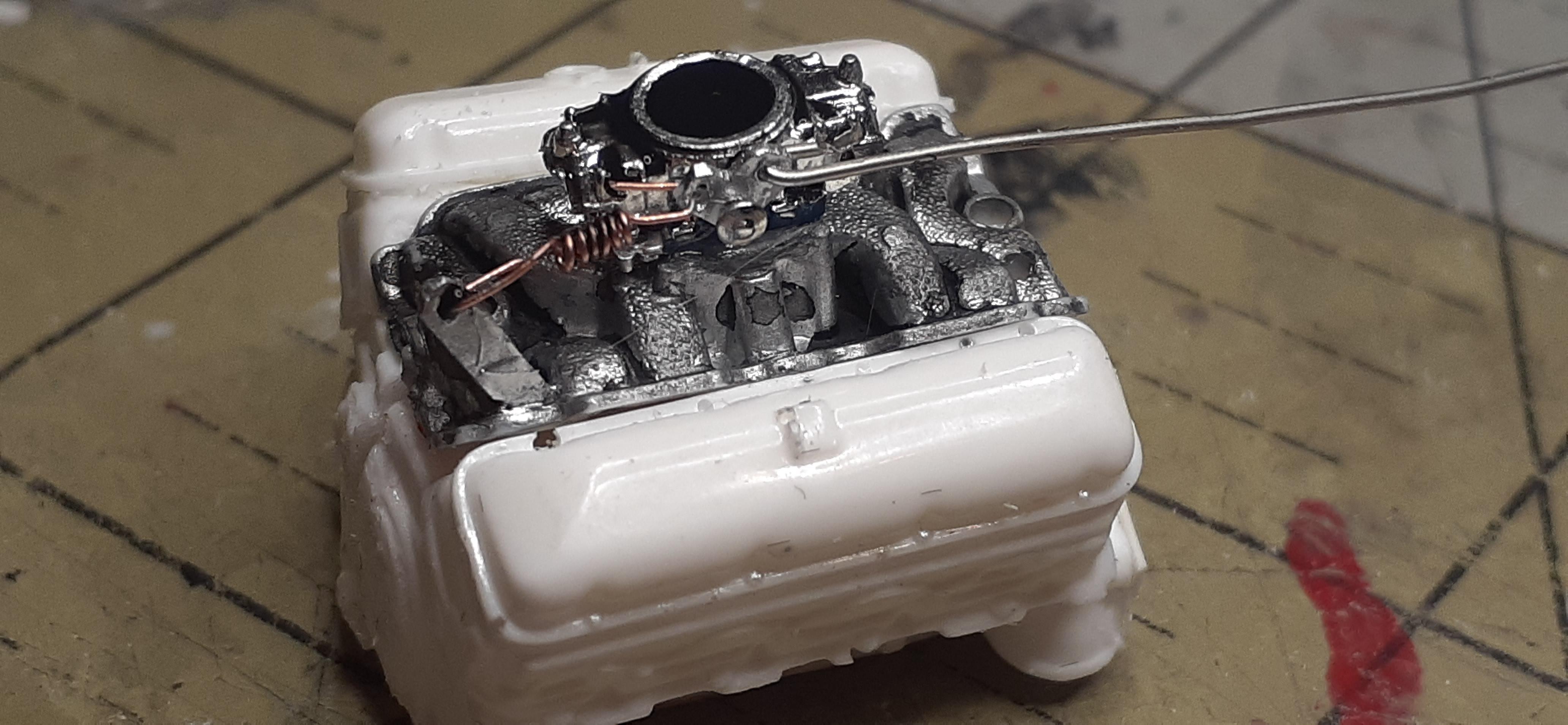

Side tracked again. Playing around with some wire, styrene and stick pins. I drilled a small hole in the side of a carburetor and cut a small piece of styrene and added 3 holes. I used earbud wires for the return spring and throttle cable. I then attached the styrene to the carburetor with a stick pin and some CA then painted everything up. I'll use these on future builds. Maybe I'll add a mini R/C motor...

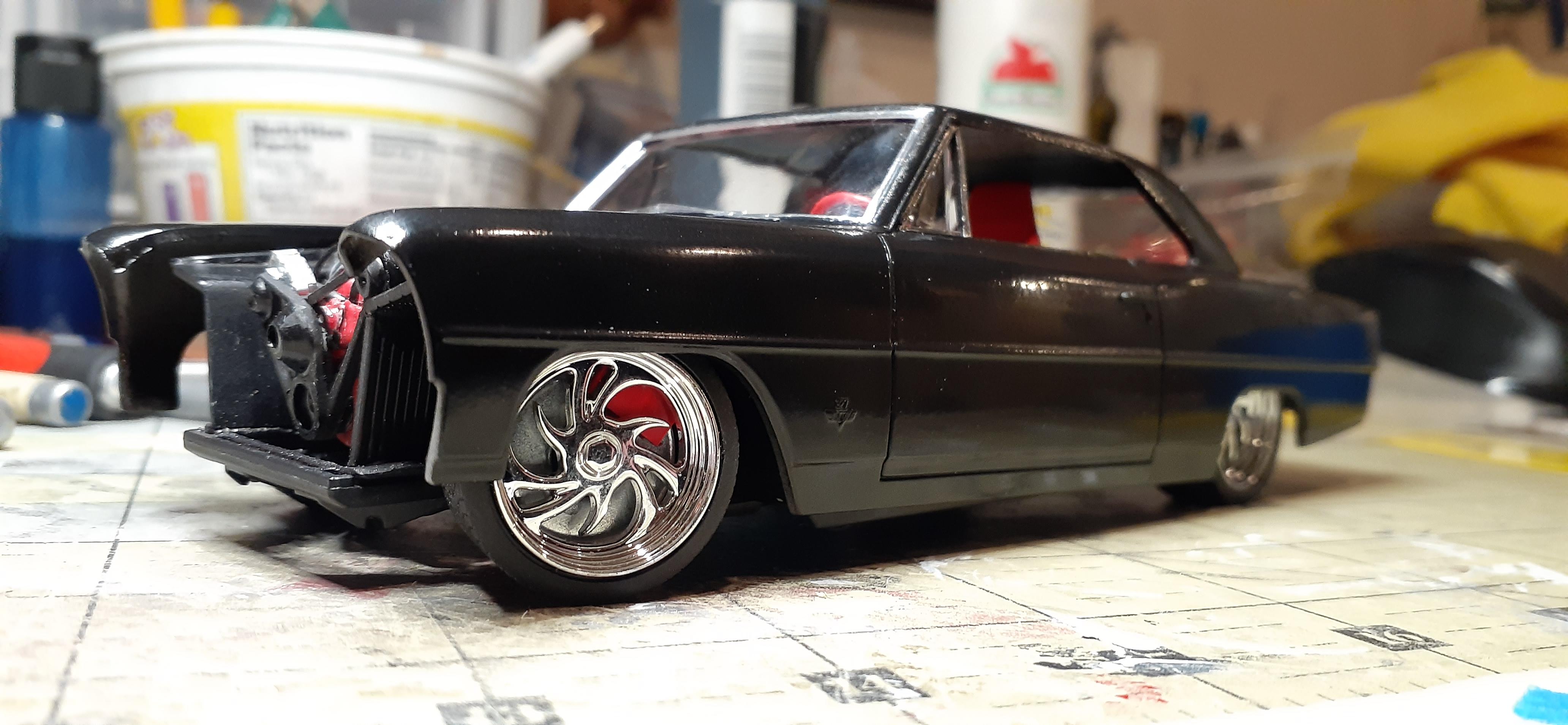

impressive ideas Steve, and good crafting! You go that extra mile to make wheels spin AND turn. For my last few models I was tired of wobbly wheels and now I glue them put. But your build makes me think it over again. Waiting to see what comes next! ??

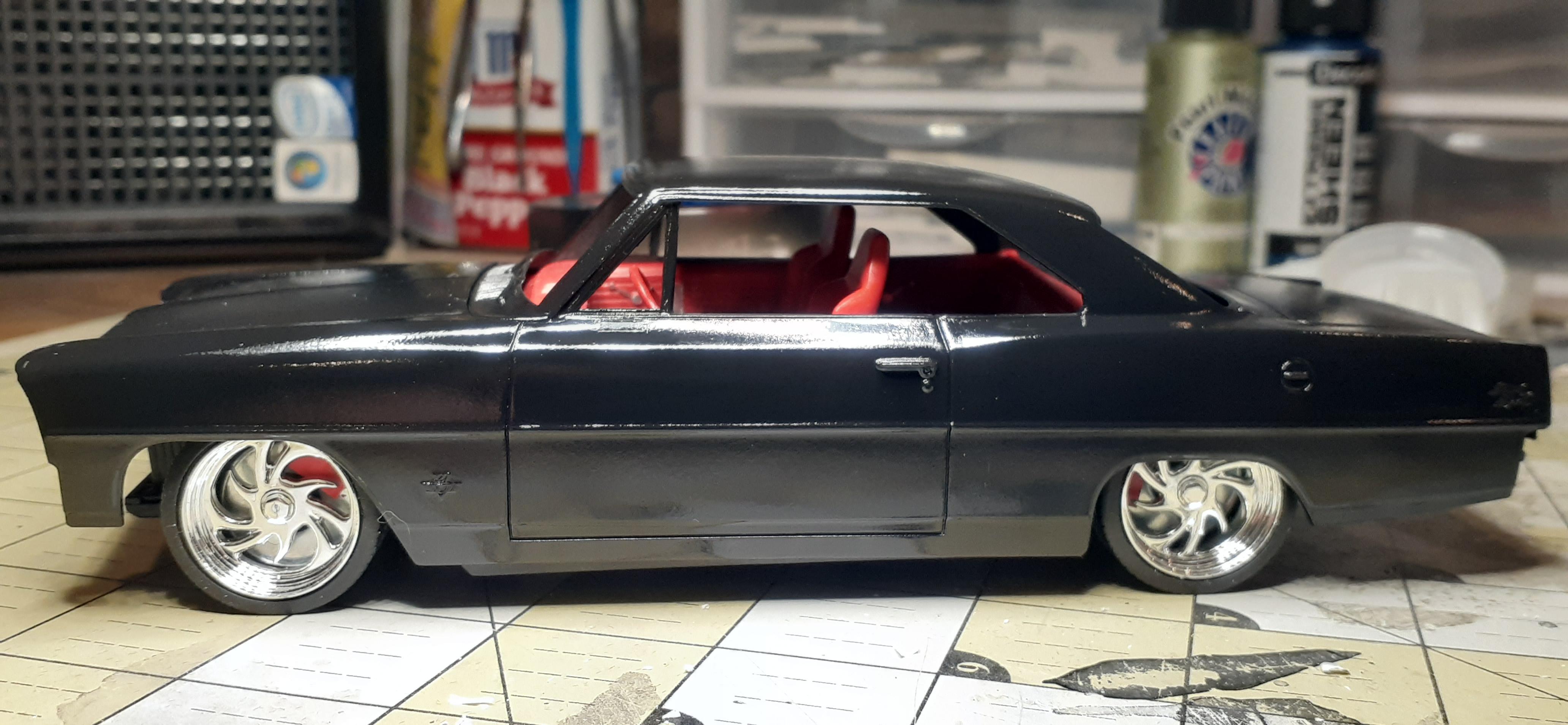

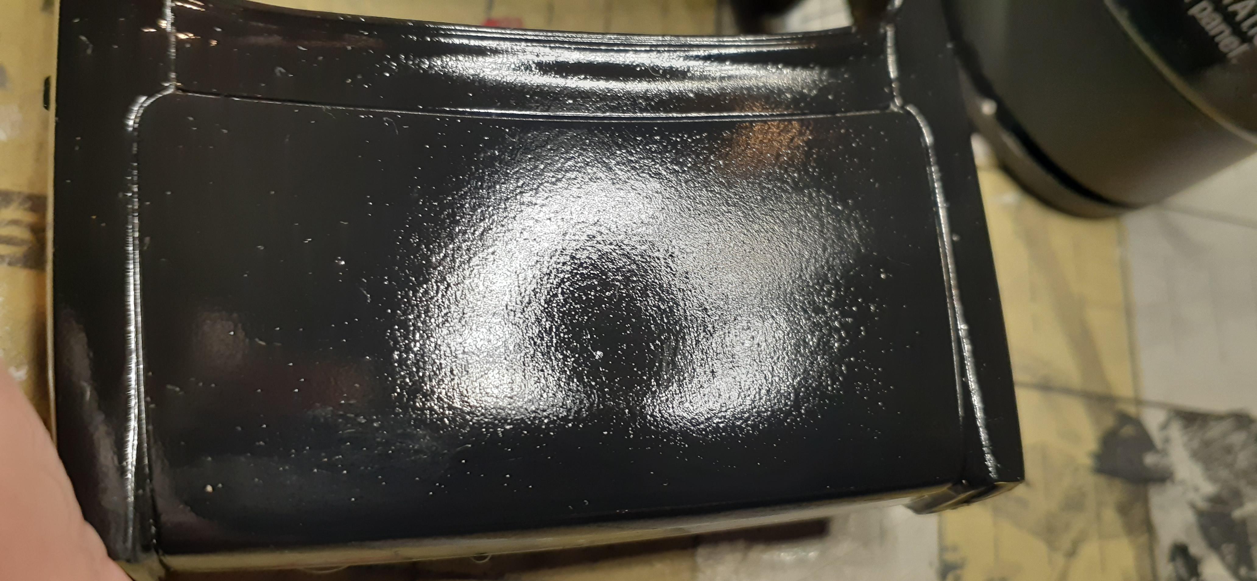

Got some color over the weekend and a clear coat yesterday. I'm nervous about sanding thru the clear but it really needs it. Tons of orange peel
  • Like 1
The entire car pretty much looks like this...

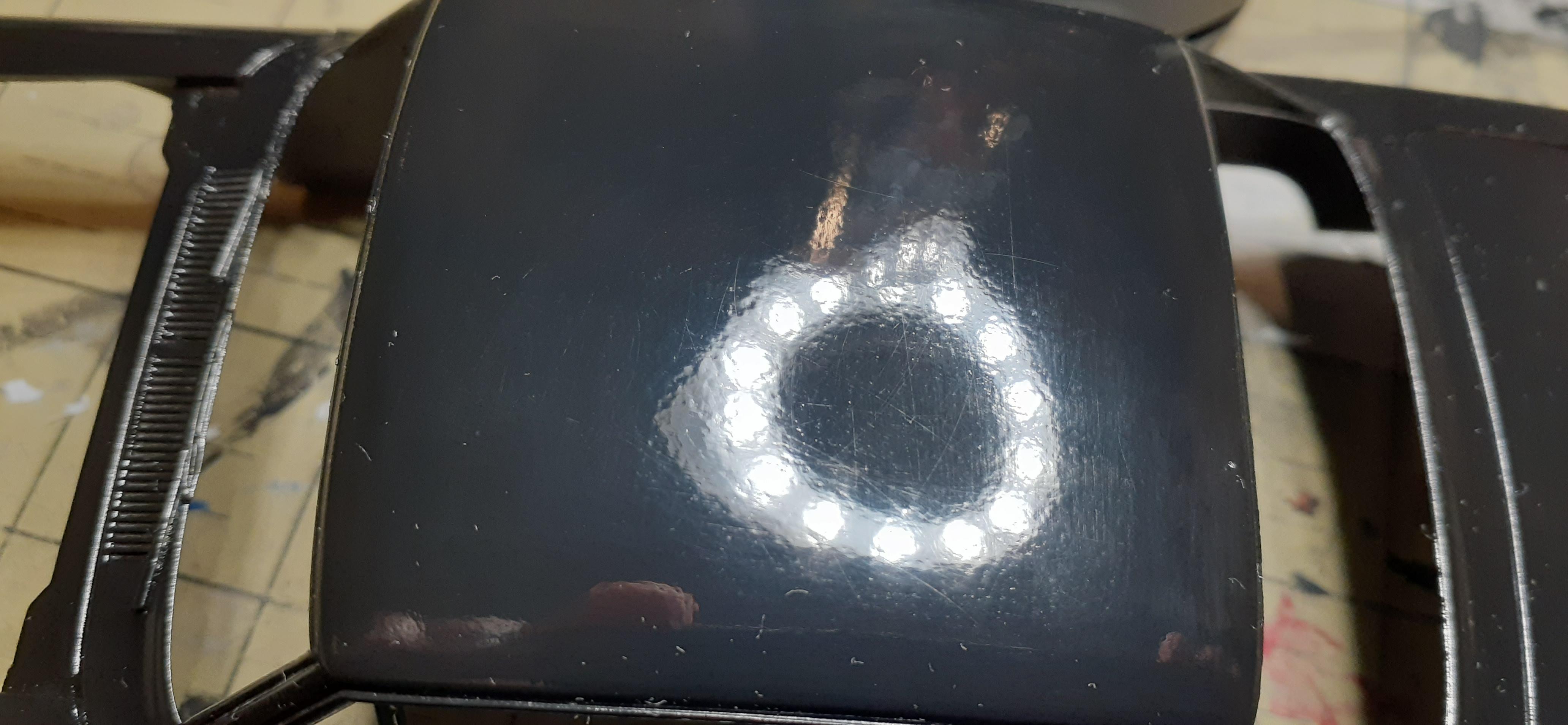

So I wet sanded with 3000 grit and lightly went after the roof. Then used Meguires Scratch X 2.0, follow up with Novus 2. Result...
not quite happy, again with a wet 3000
then just Novus 2 this time. Sorry folks I know there are other products available but I went with what I had on hand.
I can live with this

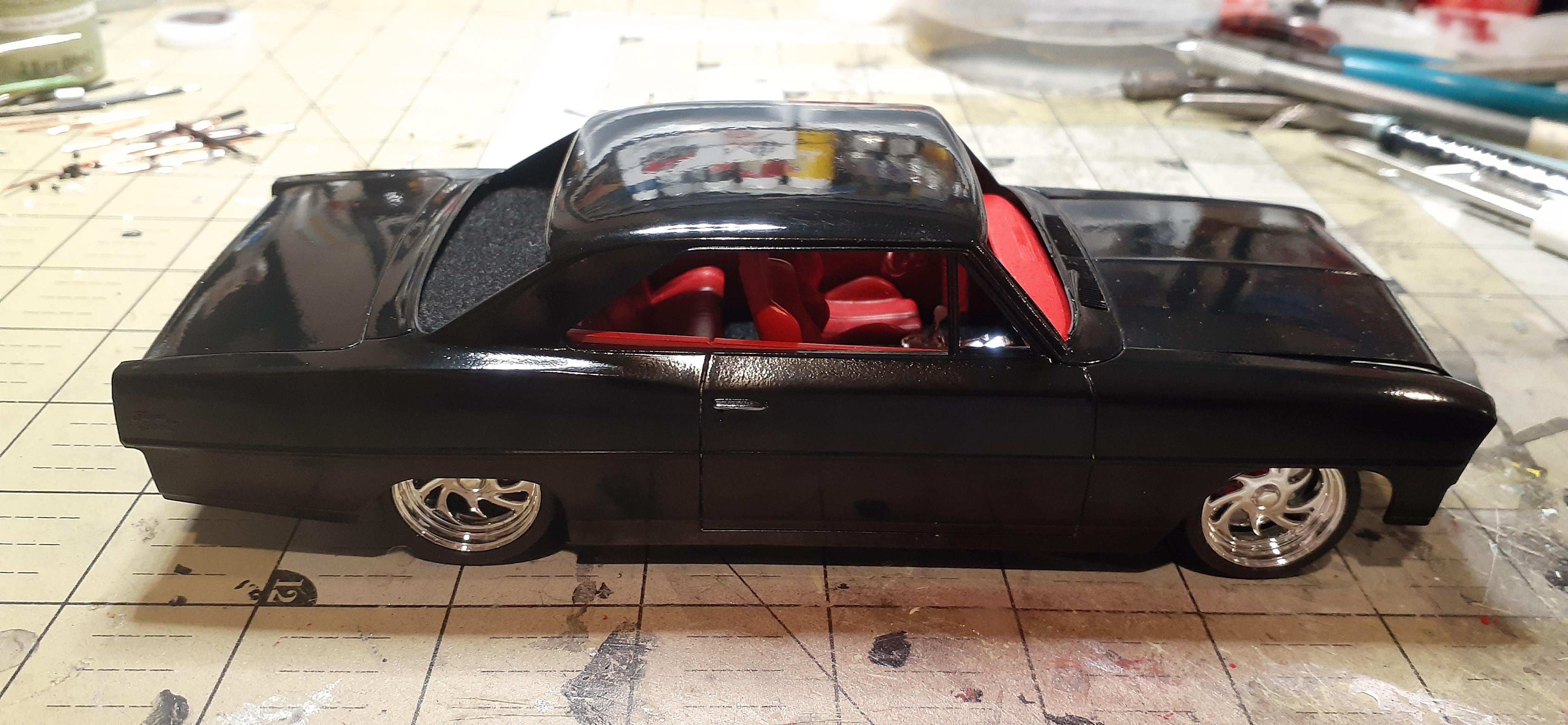

The whole body got the once over again. This will be the last time. Wet 1500, wet 3000 and a healthy dab of Novus 2. Afterwards I rubbed in some Pledge.

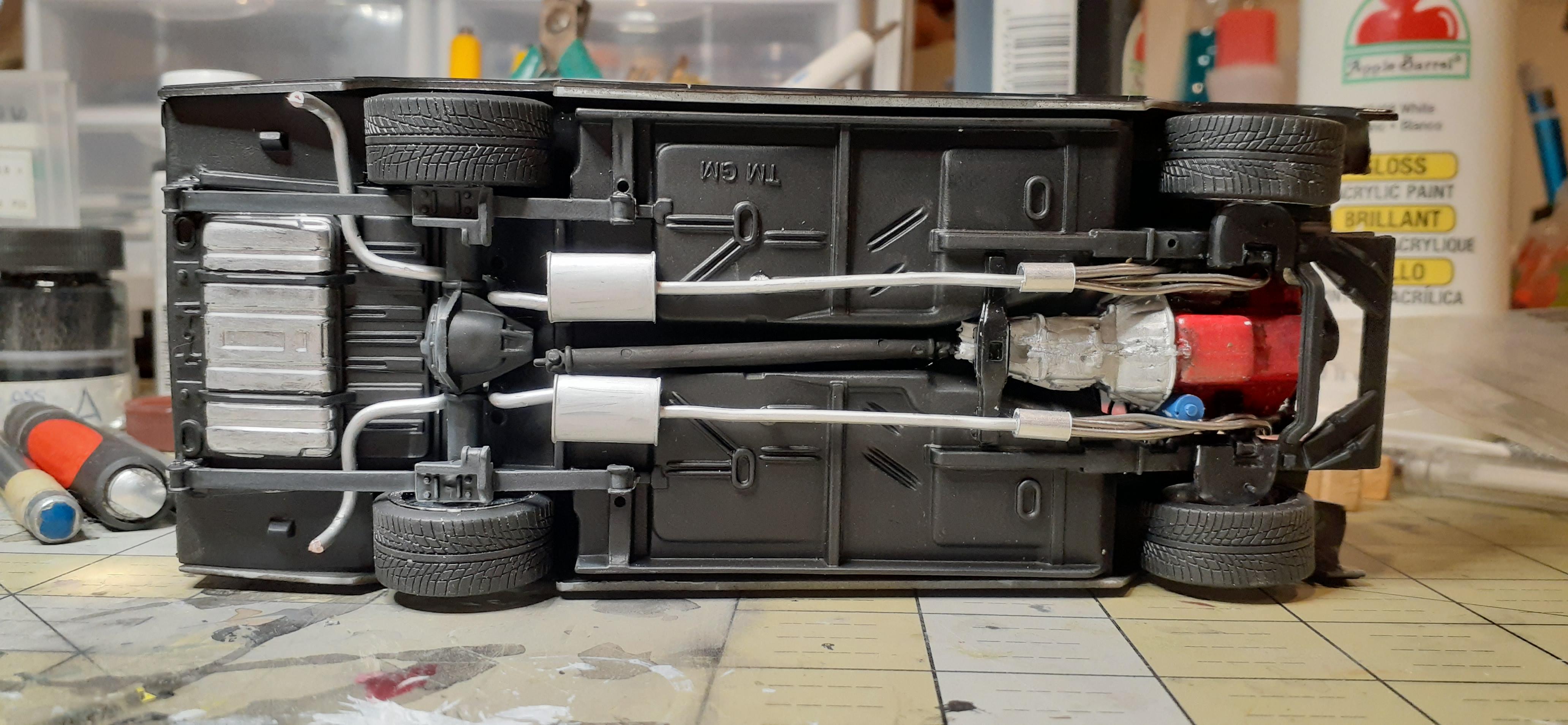

another step closer. Foil and Interior is done as well as the exhaust. It was kind of a hodge podge since the headers were a home brew. I used the pipes and mufflers that came with the kit and bent up the rest from 12 AWG wire. I covered the pipes, mufflers and wire with a silver sharpie. A couple more days and she will be in the display case.
