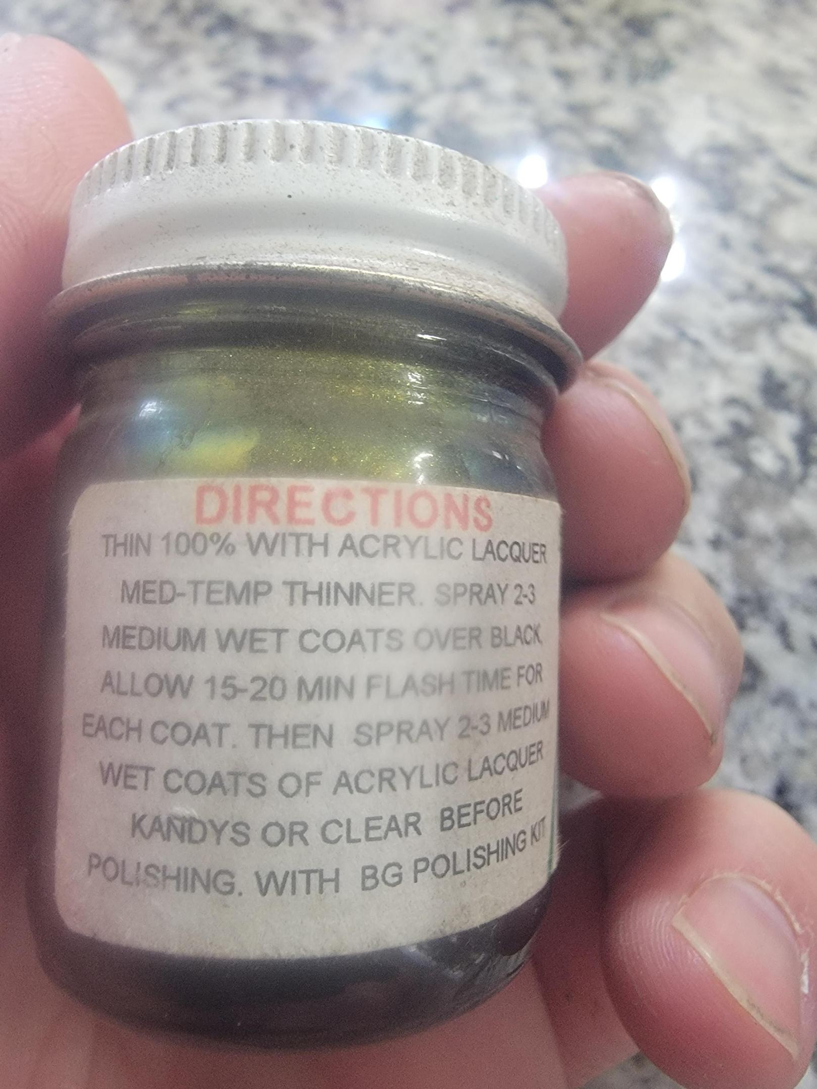

Does anyone know of a paint mixing ratio chart that they could post?
I've never been really good at math and am trying to figure out mixing (thinning) ratios for HOK paints. Some say to thin the paint 100% and some say 200% (for the clear). I'm guessing mixing 100% would mean 1 part paint and 2 parts thinner? 200% would be 1 part clear and 4 parts thinner?
I can find charts that mention 2:1 ratios etc but looking for info as to percentages.

7 minutes ago, vintagerpm said:
No.
100% is 1 part paint, 1 part thinner.
200% is 1 part paint, 2 parts thinner.
Thank you. As I read your response, for some reason, that made absolute sense to me and I can't figure how I could not have seen that. Thanks again.
