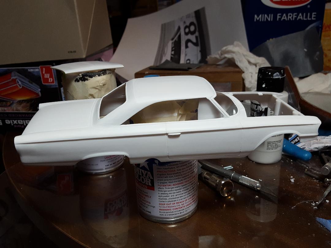

MarkJ Posted April 26, 2023 Author Posted April 26, 2023 I Put the half holes in the body for the exhaust and added a third coat of primer. I'm pretty sure I can go on to the paint now. 1

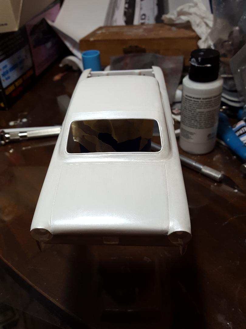

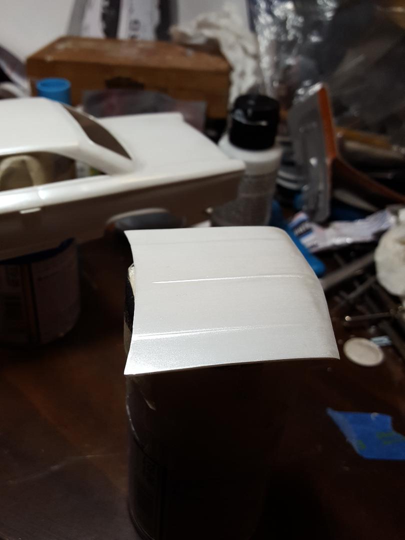

MarkJ Posted April 27, 2023 Author Posted April 27, 2023 I got the pearl white on and it actually looks like a very light gray with tiny sparkles in it which is what it is supposed to look like. I will need to re do the front of the hood where I thought I removed the ford letters. After I put on the paint they ghosted back through. I will need to re sand them re prime and re paint that part of the hood. I will then wait a couple of days to clear it so I can polish the clear. Eventually I will future it after the decals are installed. 1

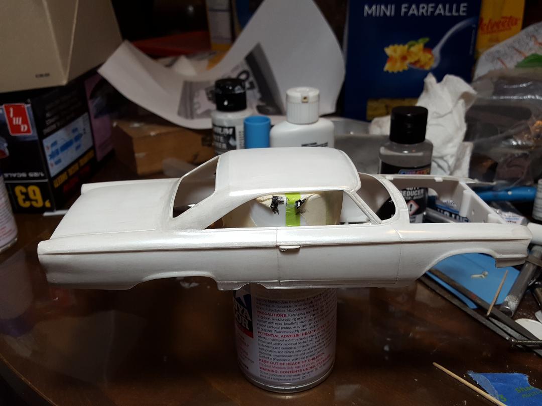

MarkJ Posted April 27, 2023 Author Posted April 27, 2023 Under brighter lighting, my model should look something like this when finished.

Pierre Rivard Posted April 27, 2023 Posted April 27, 2023 This looks very good Mark. Photo of the hood shows the pearl finish quite well and it appears to have brushed on quite successfully. I'm still looking for a silver that will work, so I should see what Createx has.
MarkJ Posted April 27, 2023 Author Posted April 27, 2023 3 minutes ago, Pierre Rivard said: This looks very good Mark. Photo of the hood shows the pearl finish quite well and it appears to have brushed on quite successfully. I'm still looking for a silver that will work, so I should see what Createx has. Thanks, Pierre. I used your formula of 60/40 percent thinner to paint for the pearl and it went on pretty well. The createx does seem to dry a bit slower and I did not have their thinner so I used distilled water. That mixture allowed me to move the paint around with the brush to remove any ridges or heavy spots before it would start to dry helping to remove any brush indentations. from my research on this paint it seems to be more developed to be used on fabric than hard plastic.
TooOld Posted April 28, 2023 Posted April 28, 2023 That pearl looks very good Mark ! It's not easy to get it right when spraying but the fact you brushed it on with that result is saying something , well done !
MarkJ Posted April 28, 2023 Author Posted April 28, 2023 8 hours ago, TooOld said: That pearl looks very good Mark ! It's not easy to get it right when spraying but the fact you brushed it on with that result is saying something , well done ! Thanks, Bob. This paint is supposed to be airbrushed but I never quite mastered that craft. I would have either had a runny mess or an orange peel special if I had try to use one on this model. Luckily Pierre has come up with a process of brush painting that makes even a clutz like me come up with half acceptable results. It's all in the thinning and the moving the paint around till it looks just right and then to know when to stop working and let it dry. One thing for sure with this method you will never get orange peel and you should not ever get a run.
redscampi Posted April 28, 2023 Posted April 28, 2023 On 4/27/2023 at 6:46 AM, MarkJ said: I will need to re do the front of the hood where I thought I removed the ford letters. After I put on the paint they ghosted back through. I will need to re sand them re prime and re paint that part of the hood. I read somewhere back in the 1980's that the only was to be sure to get rid of the ghosting is to grind the logo off and fill. I don't know, I've never tried it.
jjsipes Posted April 29, 2023 Posted April 29, 2023 Another method that has worked for me to prevent ghosting is the sand down the lettering, brush over it with liquid glue and then sand again. Have heard that the plastic has memory and the liquid glue helps to change its memory
MarkJ Posted April 29, 2023 Author Posted April 29, 2023 Thanks guys. I think I will try Jason's idea because it seems a lot easier, and I really don't like putty. It's weird because the emblems on the front fender did not ghost at all.

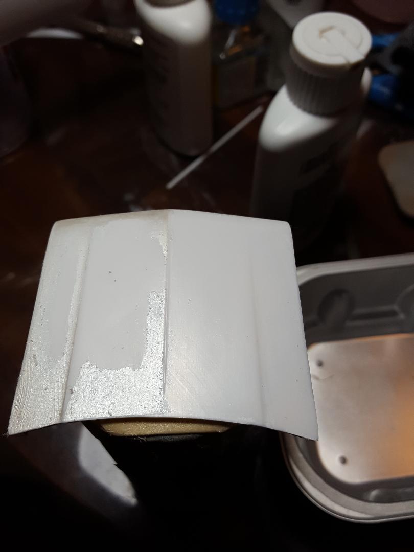

MarkJ Posted May 6, 2023 Author Posted May 6, 2023 Haven't worked on the build in a while. Been helping my wife with a project she has that needs 19 pictures, some from 50 years ago, edited and made into 4x6's. Went back to the build which I had messed the hood up, by using thinner instead of distilled water to put another coat of pearl white on. Learned a lesson on that one. Createx paint does not like its own thinner when brush painting with it. Need to remember to just stick with distilled water. It does like its own clear top coat but I used distilled water with it and won't even bother to use the thinner, which they call reducer. 1

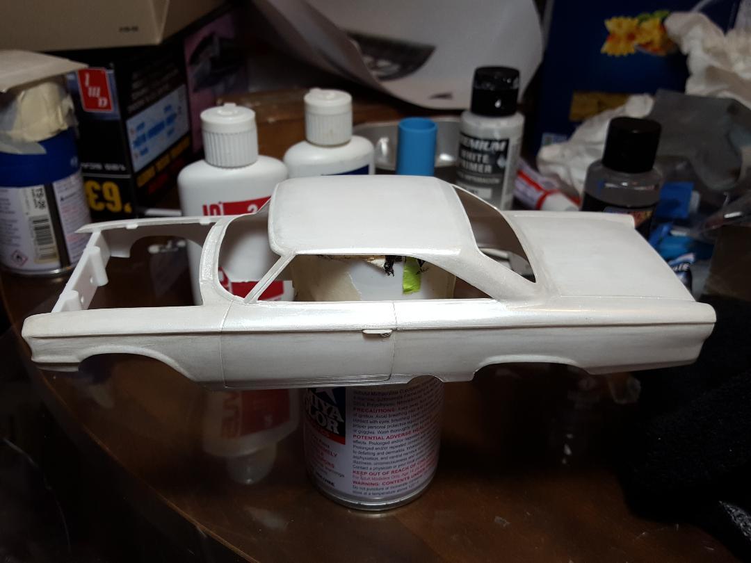

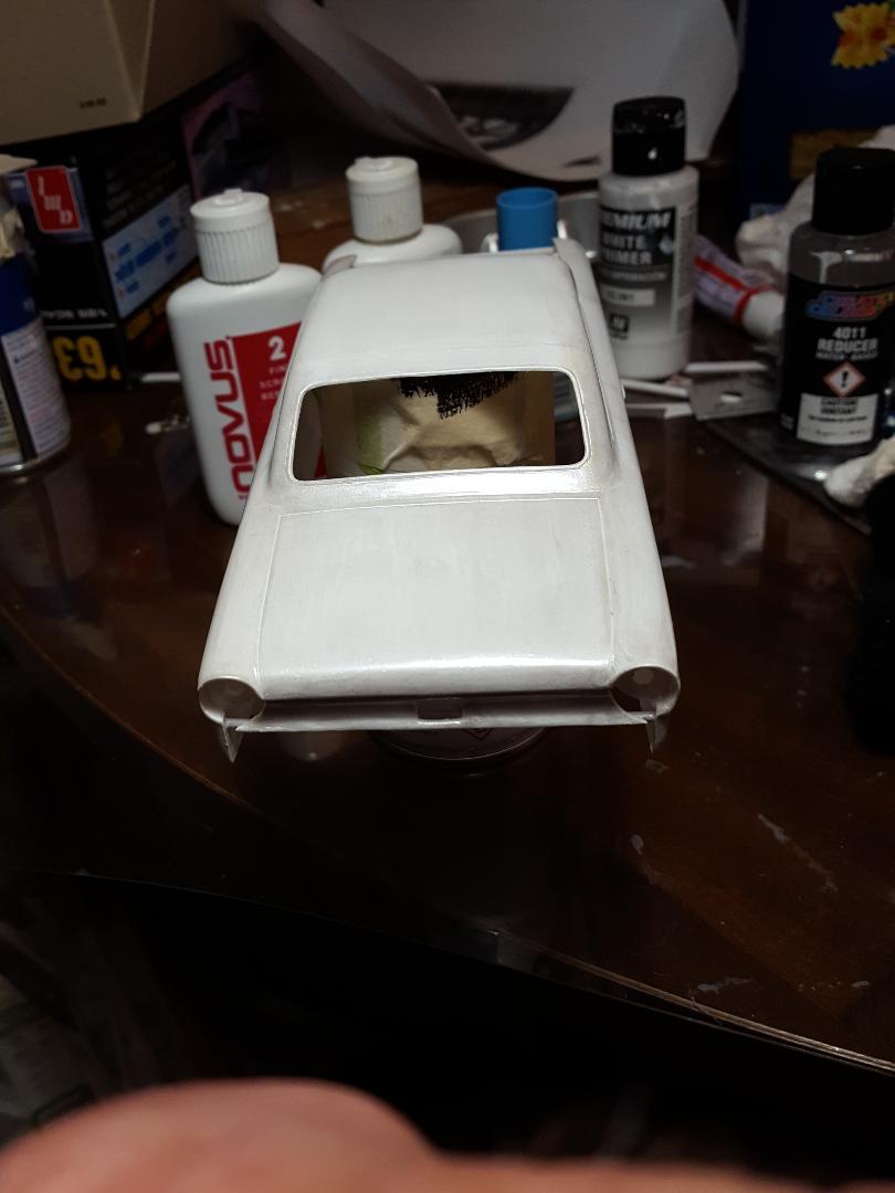

MarkJ Posted May 8, 2023 Author Posted May 8, 2023 Put that last coat of clear on the body. Will wait a couple of days to polish it with Novus2. I hope to start on the interior tomorrow. 1
TooOld Posted May 10, 2023 Posted May 10, 2023 Nice ! I learned that lesson about using thinner instead of water too , even when brushing small parts the thinner makes a mess .
MarkJ Posted May 10, 2023 Author Posted May 10, 2023 30 minutes ago, TooOld said: Nice ! I learned that lesson about using thinner instead of water too , even when brushing small parts the thinner makes a mess . Yes, I have also found that createx paint, which is what I have to use on the body because Vallejo doesn't make a pearlized white, is much thinner paint than Vallejo, so the 60/40 ratio does not work. It actually makes the paint to thin. I'm using a 20/80 thinner to paint ratio with the createx, and using distilled water.
MarkJ Posted May 11, 2023 Author Posted May 11, 2023 Got two coats of clear on and polished with novus 1&2. Still trying to fix the hood that the thinner messed up. I really want to put the body aside so I can get on the interior.
MarkJ Posted May 15, 2023 Author Posted May 15, 2023 I've come to the realization that I am going to have to strip the hood. There is no fixing it in the condition it's in now.
Pierre Rivard Posted May 15, 2023 Posted May 15, 2023 That's too bad. I understand the feeling. Making it through paint is the hardest part of the build (for me)
MarkJ Posted May 15, 2023 Author Posted May 15, 2023 5 hours ago, Pierre Rivard said: That's too bad. I understand the feeling. Making it through paint is the hardest part of the build (for me) Yes, me too. I'm using nail polish remover, the less caustic type. Came off in about 30 minutes using a toothbrush.
