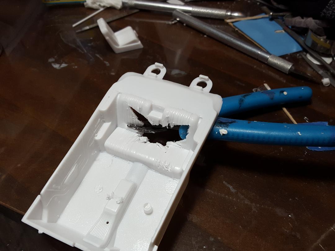

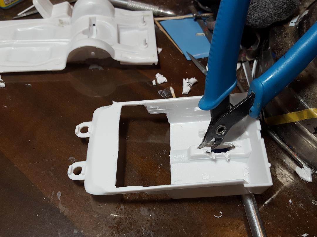

MarkJ Posted May 21, 2023 Author Posted May 21, 2023 I put the second and final coat of clear on the body and will just let it sit for a while before I polish it with novus 2 and 3. I'm really going to try hard not to go through the clear into the paint. I started on the interior and decided to use the sprue cutter instead of an exacto knife to remove the back seat and the console. It went a lot quicker on the back seat doing this. I will clean it up with exacto and sanding sticks before I reform the tub with styrene sheets. 1

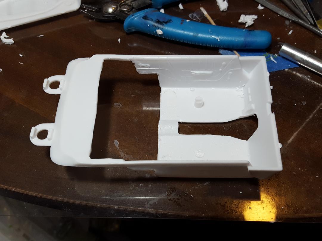

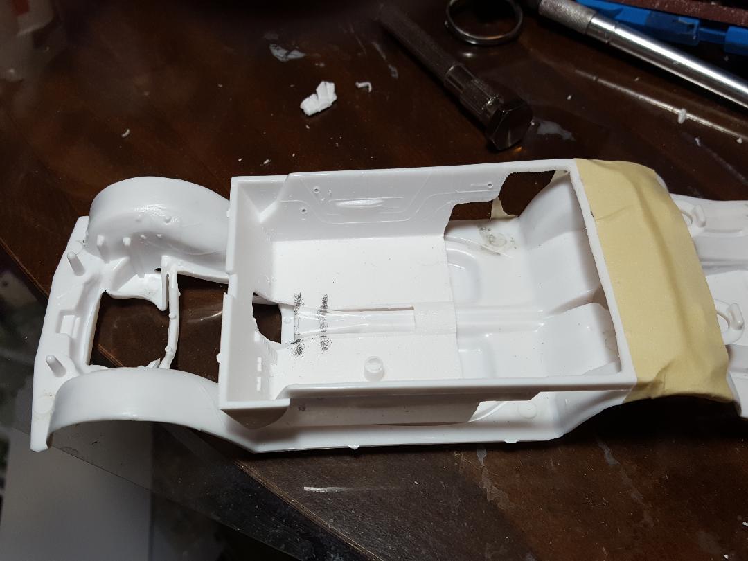

MarkJ Posted May 23, 2023 Author Posted May 23, 2023 Removed the console and that portion of the drive shaft tunnel. Will rebuild the tub with styrene sheet and tube material for the tunnel. the demo went a lot faster using the sprue cutter. 1
Johnny Canuck Posted May 24, 2023 Posted May 24, 2023 Them sprue cutter pics giving me flashbacks to the house demolition scene with Will Smith - and the cat - in the movie I, Robot. :-{]
TooOld Posted May 24, 2023 Posted May 24, 2023 Your paint looks good to me and some great progress with the interior ! I use sprue cutters the same way , saves me a trip to the garage to use a Dremel and it sure speeds things up ! When the job is finished nobody will ever know .

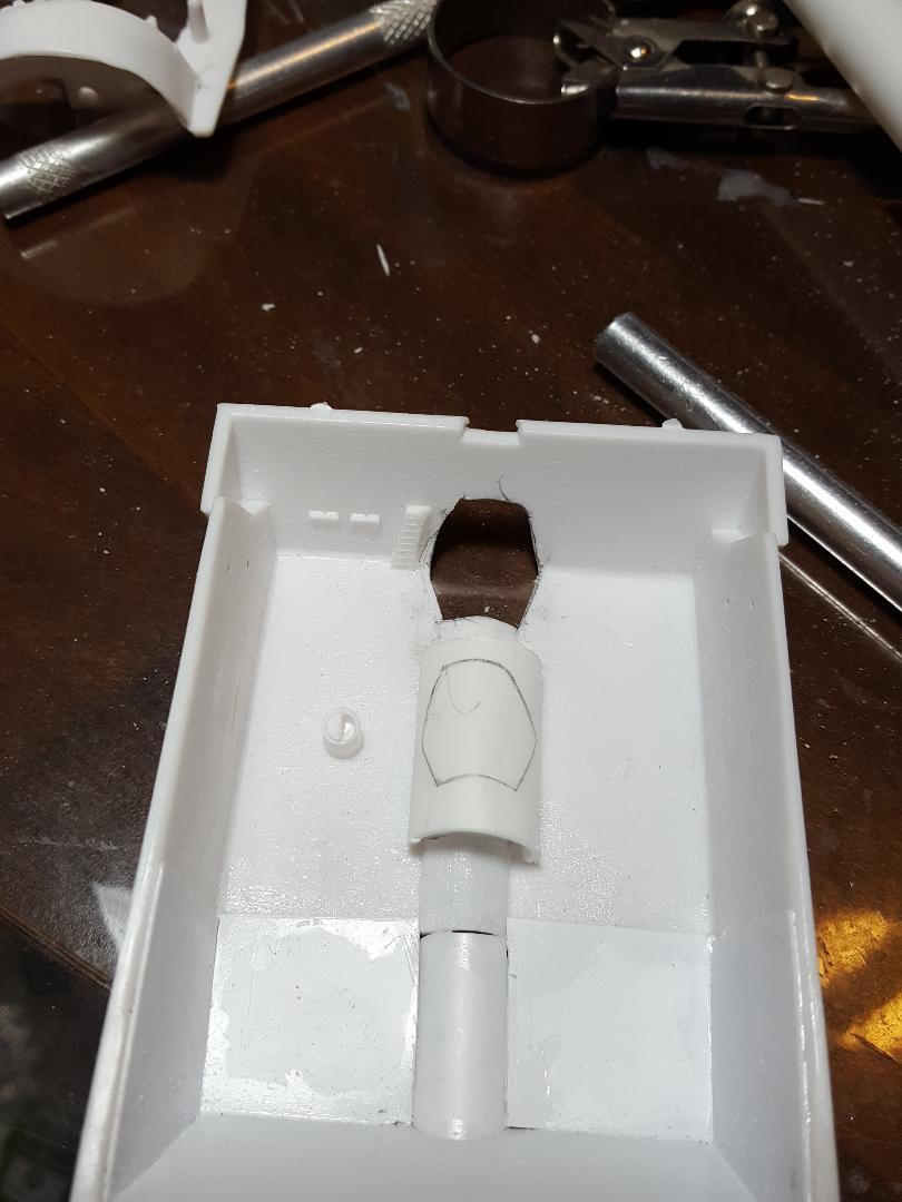

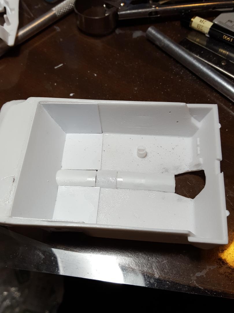

MarkJ Posted May 24, 2023 Author Posted May 24, 2023 Moving right along. Almost have the tunnel completed. 2
presnell Posted May 25, 2023 Posted May 25, 2023 You're doing a great job! Would'nt it be nice if the mfgs would make a blank interior tub1
MarkJ Posted May 25, 2023 Author Posted May 25, 2023 3 hours ago, presnell said: You're doing a great job! Would'nt it be nice if the mfgs would make a blank interior tub1 Thanks, Jim. Yes, it would. I guess some kits come with the rear seat separate and you can choose to leave it off, but usually its the way this one is. And sometimes you can choose to install a console or leave it off.

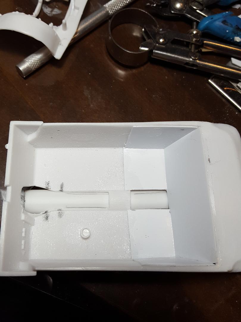

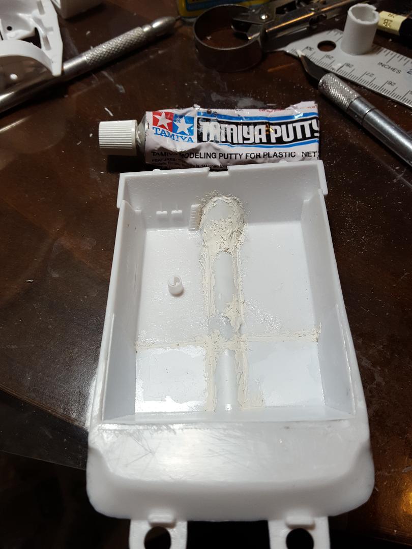

MarkJ Posted May 26, 2023 Author Posted May 26, 2023 Finished the tunnel and added some putty. Next will be the cage and dash. Eventually the shifter and fire extinguisher and seat after it has the harnesses and bolster attached. 3

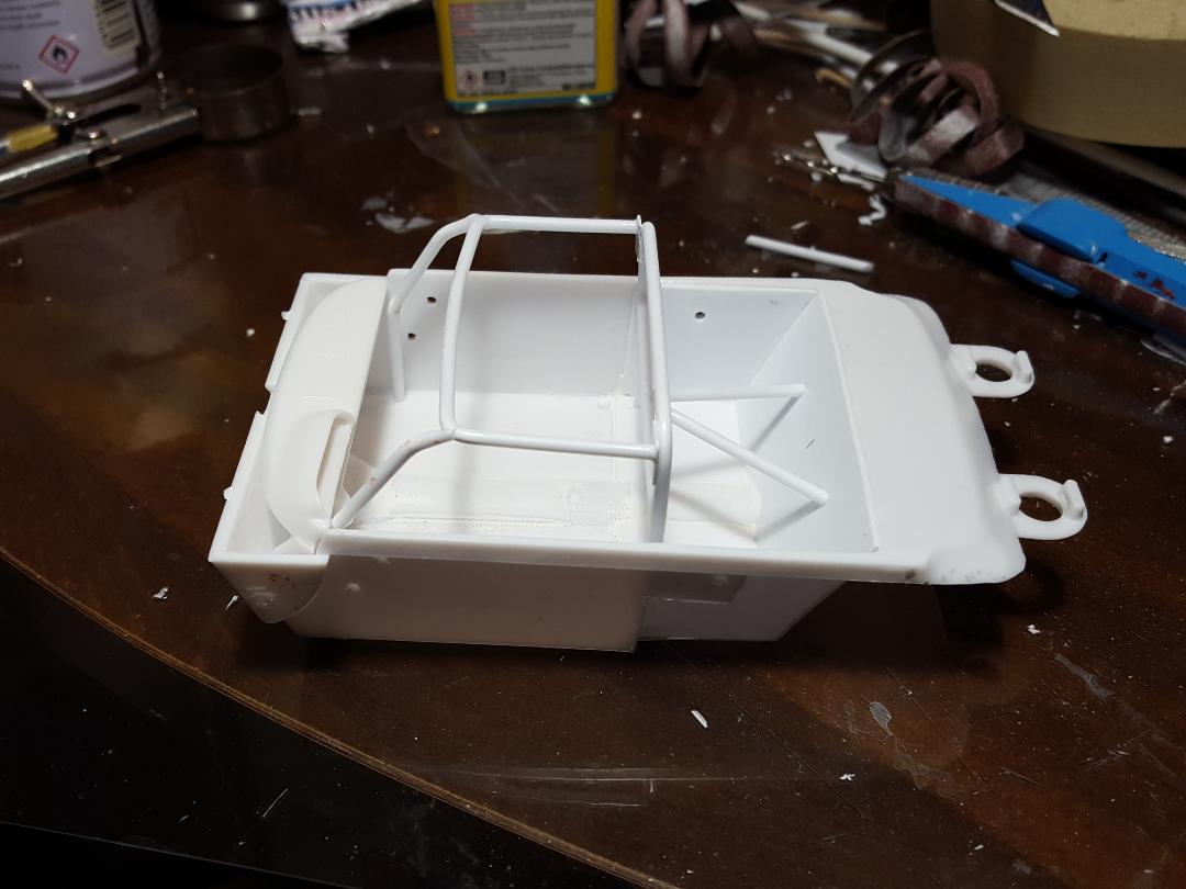

MarkJ Posted May 31, 2023 Author Posted May 31, 2023 Got started on the cage. I'm using .080 rod this time because I feel it's closer to scale then the 7/32 tube, I was using. 2

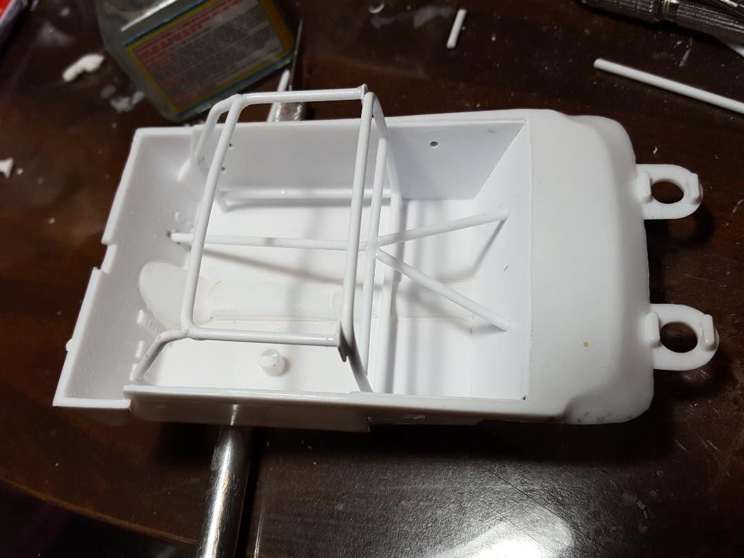

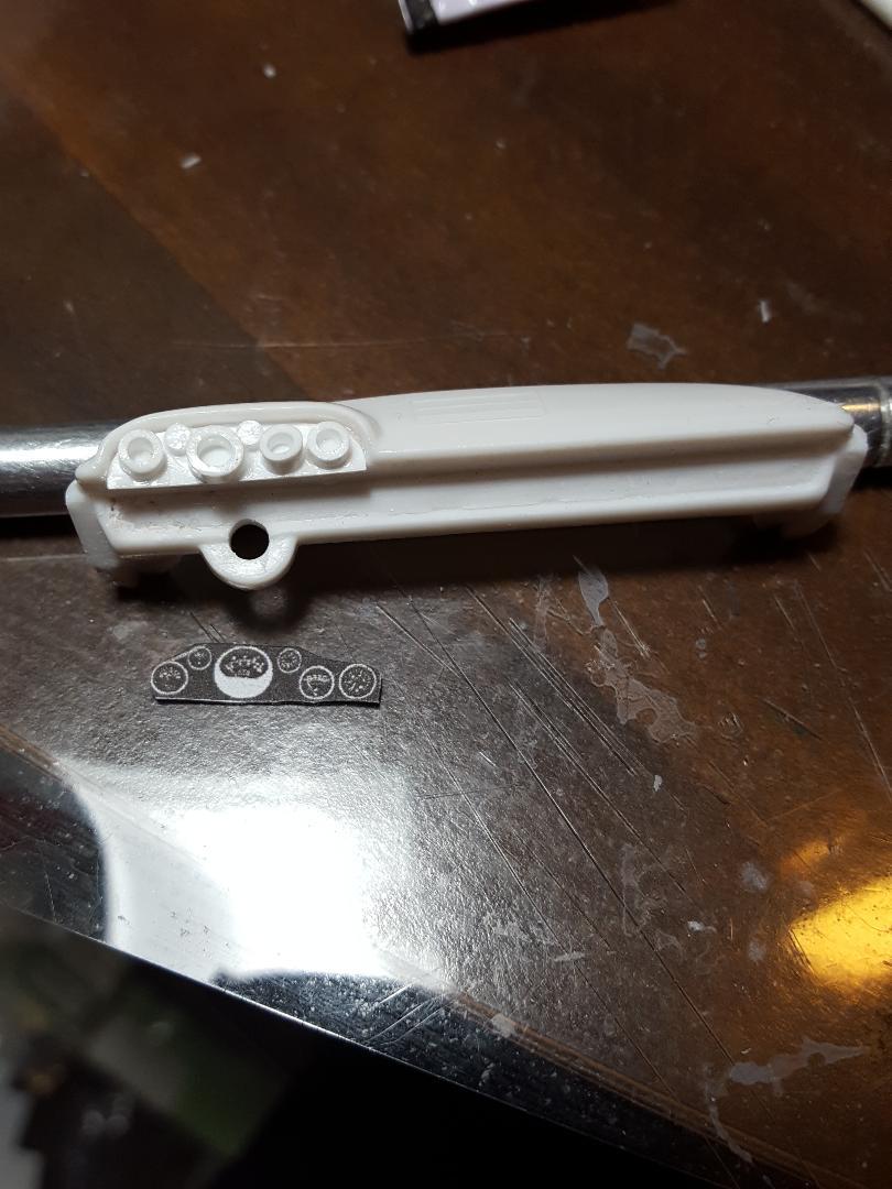

MarkJ Posted June 2, 2023 Author Posted June 2, 2023 Got most of the cage done. Just a couple of more bars. I also started on the dash removing all the switches and opening up the area where the guages will go. There will be no handles on the door panels because all the side glass was removed from this car. 3
