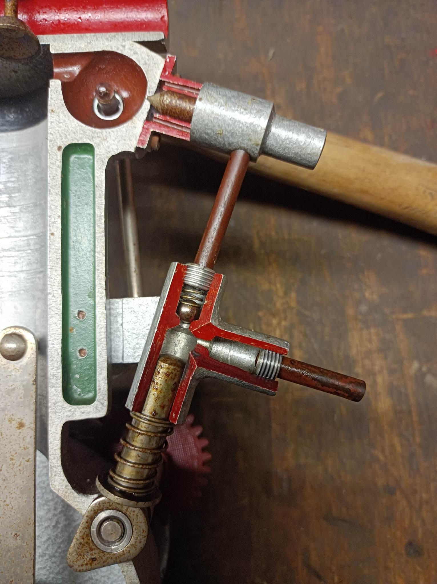

But some things on the right side of the engine display do I not understand.
346098283_933732431081180_9168357411754647646_n.jpg.2e6ada0c771e61f58794e9ae13ba5dba.jpg
Clearly, the little light on top, in the circle shaped chamber, figures the ignition of the fuel.
But is that a spark plug right from it ? Or should it represent an injection, what means it is a diesel engine ?
And what is the function of the little cam shaft right below. It's on the same axle that moves the outlet valve.
Someone who can explain the system in the T-shaped tube on the right ???
Thanks anyway !
I'd guess its a petrol engine. a diesel would have no need for the spark plug as the glowplugs are only used for starting. The light would represent the spark plug in a petrol engine and would flash depending where the crank is. it should flash at the same time as the fuel hammer moves. does this have a hand crank on it? Thats a cool thing to find, my tech teacher only had a lego technik thing thats similar to that. Yours is much cooler than his was.

This represents the fuel system. Since it would be a lot of effort to fit a liquid system for display, instead they used this. each time the hammer gets hit by the crank the light should flash. the hammer represents your fuel system in a much more visual way for teaching and also makes the display easier to manufacture. The part coming off the side would represent the fuel lines coming from the tank and the part at the crank would represent the throttle/engine speed.
I't represents a diesel engine with a pre-combustion chamber and timed mechanical fuel injection.
The cam drives the fuel injection pump so it squirts at the right time relative to piston position.
The little light bulb simply represents when ignition starts in the pre-chamber, from rising compression.

Clearly, the little light on top, in the circle shaped chamber, figures the ignition of the fuel.    YES.
But is that a spark plug right from it ? Or should it represent an injection, what means it is a diesel engine ? IT IS THE INJECTION NOZZLE.
And what is the function of the little cam shaft right below. It's on the same axle that moves the outlet valve.  THE LITTLE CAM MOVES THE FUEL INJECTION PUMP PISTON
Someone who can explain the system in the T-shaped tube on the right ???  FUEL COMES IN THE LINE TO THE RIGHT. THE BOTTOM LEG OF THE T IS THE INJECTOR PISTON, ACTUATED BY THE LITTLE CAM. FUEL PUSHED UP BY THE PISTON HAS TO OVERCOME THE PRESSURE OF THE SPRING HOLDING THE CHECK-BALL CLOSED. FUEL GOES UP THE TUBE, SQUIRTS INTO THE PRE-COMBUSTION CHAMBER.

Thank you all for the reactions.
I already thought it should be a diesel engine. And these have a quiet complicated fuel system.
I can move on with that.
The light bulb is most likely supposed to represent a glow plug used to help ignite the diesel fumes in pre combustion diesel engines when the engine is cold.
