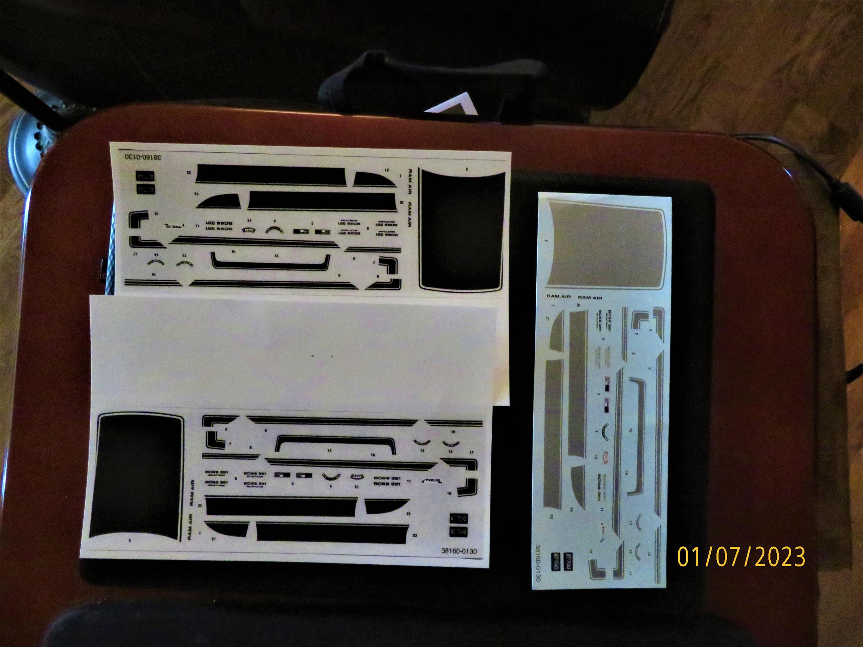

Mike 1017 Posted July 1, 2023 Posted July 1, 2023 I needed a set of Black 1971 Boss 351 decals. The one the box is silver. My home printer would not cooperate with printing out black decals. I took the decal sheet my own decal paper to the UPSStore. I got 2 sets for 36 cents.
