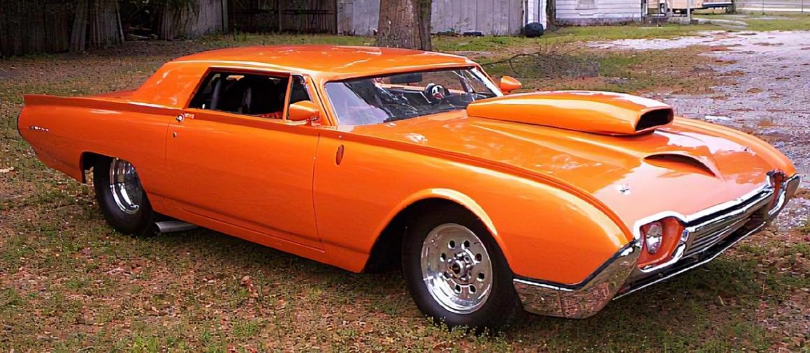

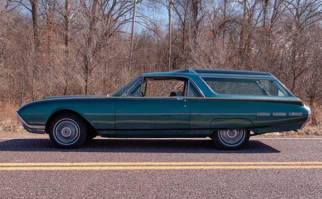

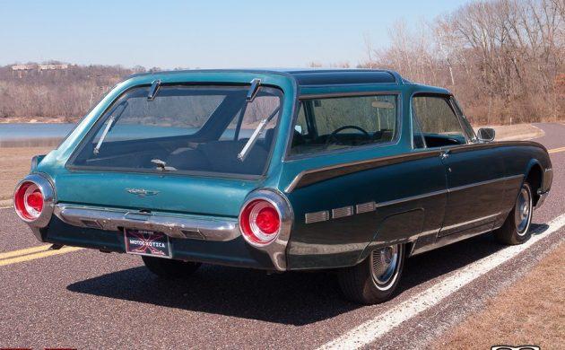

I've got an interesting "what if" for ya........pretty cool, huh?
Now, that's a really cool car! Would be an excellent direction for this..........

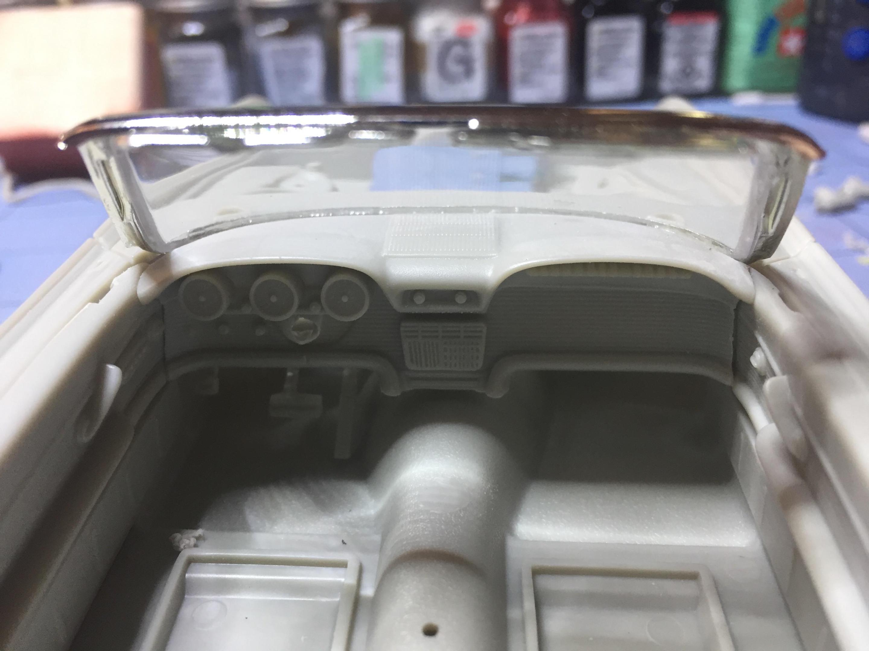

I was lucky enough to get a heads-up about the clearance issue involving the dash width so I spent some time with that today.  Thank you, TJ, you saved me from a whole bunch of very loud vulgar language. I had to shave the ends of the dash and that seemed to take care of it.  But then I wondered about the glass thickness so I installed the glass into the frame and tried it again.  ? Nope....in order to get it all to fit I had to remove material, a little at a time, from the front edge of the dash and from the bottom edge of the glass. This is where a Dremel comes in handy.

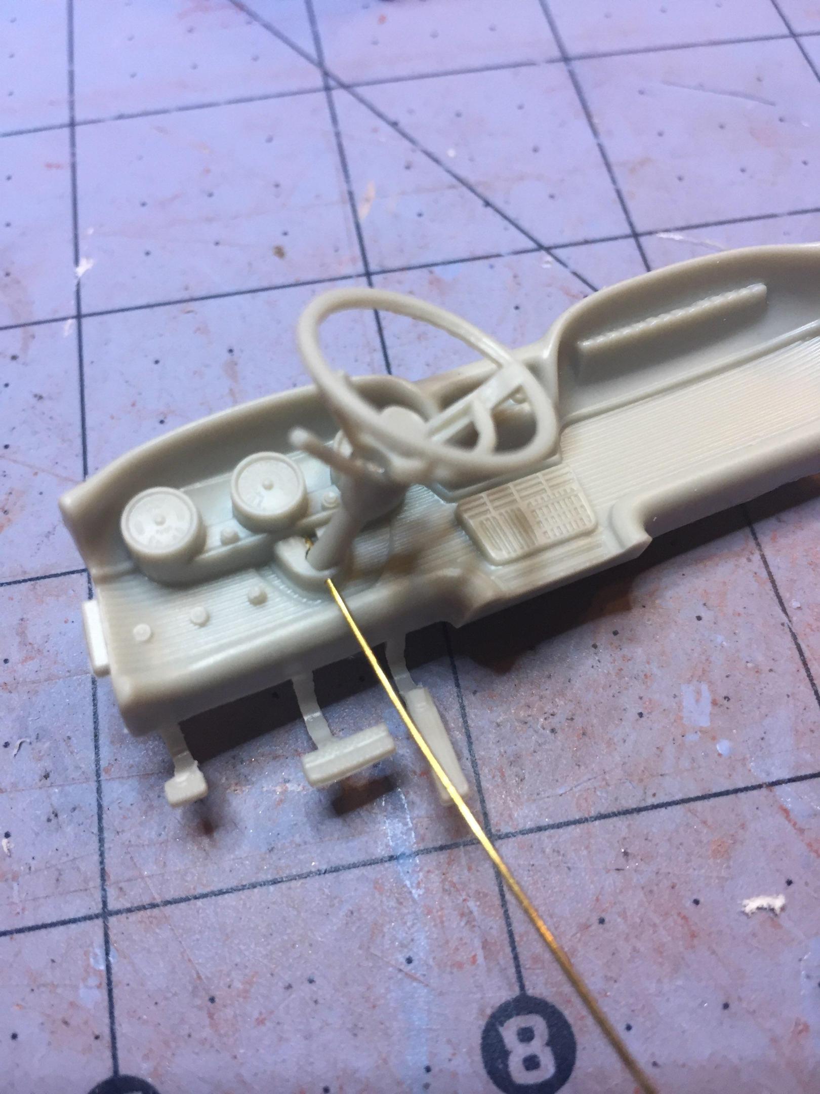

Got my grille and wheels washed and...... I entertained the "swing-away steering wheel" idea. ?

...just asking for trouble...?

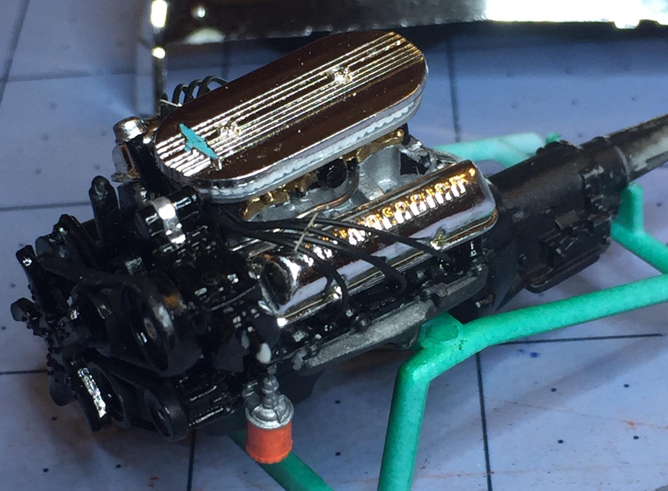

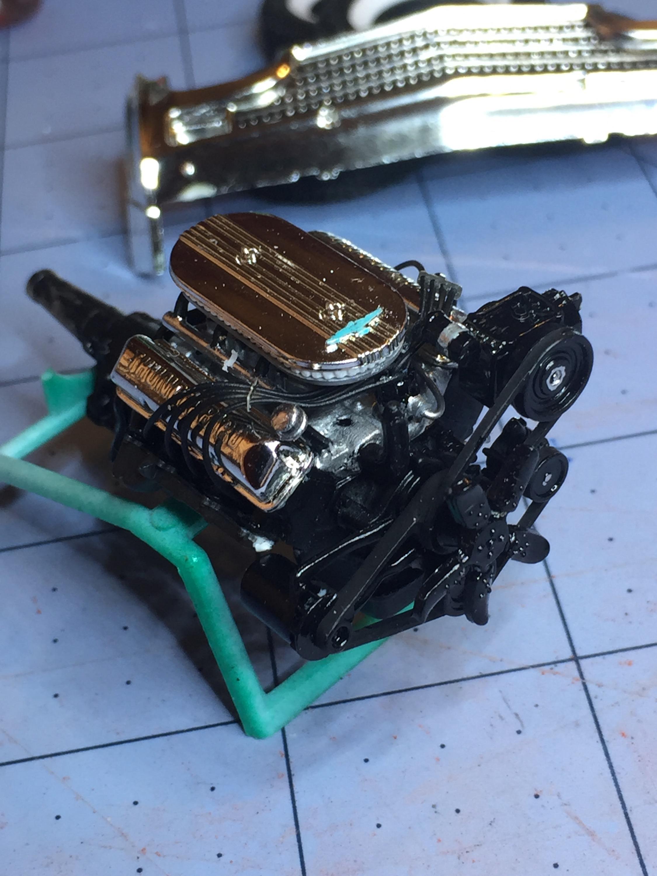

Progress ?.  Got the bottom pan with front and rear end assembled and painted. Further assembled engine and exhaust system
Just a heads-up for those of you who have expressed a desire to get your paint-stained, CA encrusted digits on a copy of this wondrous AMT/ERTL kit (you know who you are, Michael.)   These are not complaints, mind you, just pointing out some things....... that if you were not checking for them, you'll wish you had when it's too late.
Earlier (somewhere above), I mentioned the dash width adjustment. There was quite a lot of fitting involved and you gotta go slow ...and the glass needs to be in place.
On a lighter note...the engine mounting can be worrisome. By the way; if you have not read the reviews of this kit on the Hobbylinc.com site, it's a good idea.  Also watch the assembly sequence of the chassis. The exhaust is 3 pieces. A connected pair of exhaust pipes and a L & R  tail pipes, all of which have really cool connections molded in (I've never seen one like this) This allows you to assemble the rear end to the chassis and then paint, should you want to play that way. Another way to play is to assemble the entire exhaust system first, then you can make the connection vanish. ?.  Drop it in and then drop in the rear end. Maybe they had something completely different in mind ? I dunno, I just look at the uh....pictures. Think about it .... but I digress....you may need to clean up the connections a little - see photo.  If you apply glue and then find out they're too tight....?
While contemplating the engine install, I discovered I was able to glue the trans mount first, then I installed the engine with a tiny bit of extreme care and, since my rear end is already in,........well, don't forget the driveshaft!  I did it this way so I had a place for the exhaust pipes to land, rather than trying to deal with pipes while installing the big engine on a somewhat difficult mounting.   Thanks for your attention.

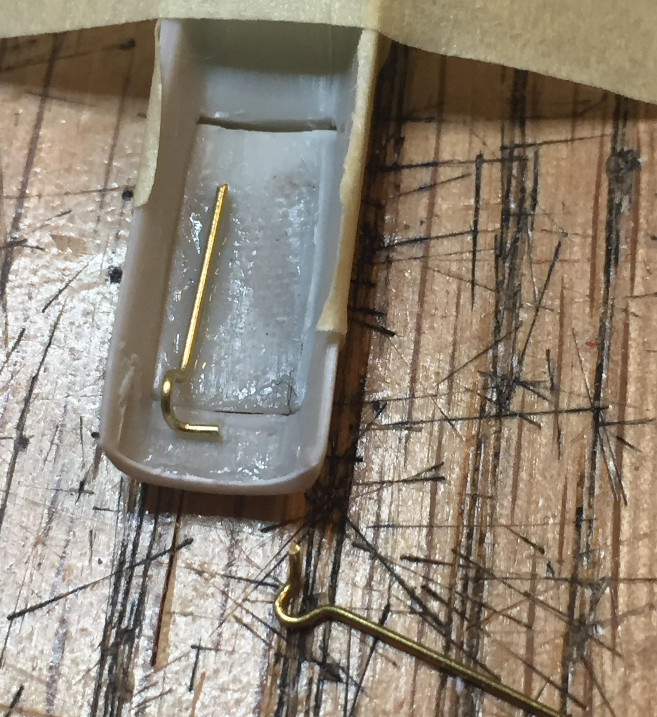

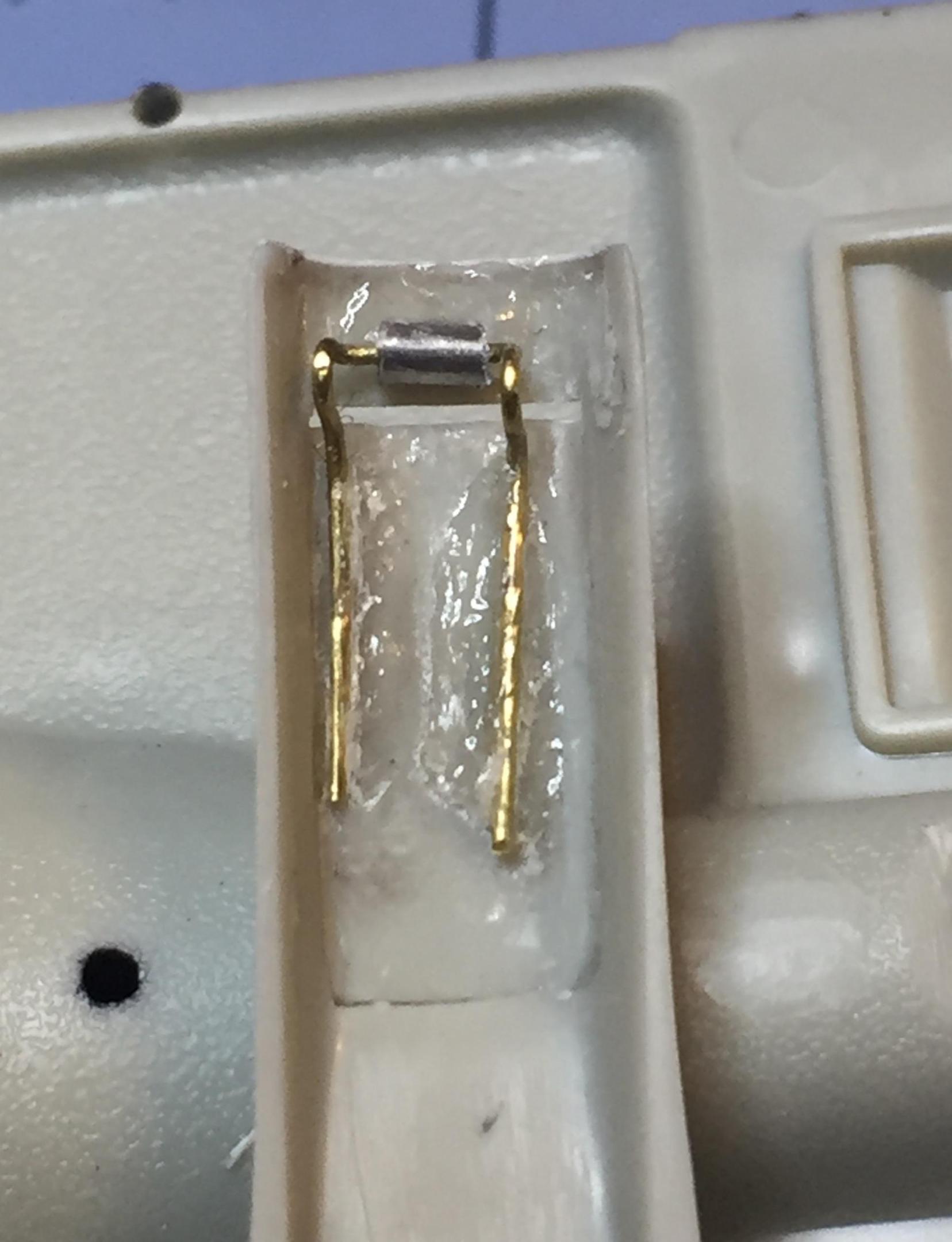

More crazy time ?....It looked easy.  I figured I could do it. It ain't pretty but I got it. Tried some different things and this is where it ended up. Enjoy!

Great idea Jim! Excellent execution
It's getting kinda tricky playing with stuff that small. I went through a whole length of brass wire to get there ?. 3 or 4 hinge attempts, one time using fabric,  one time using that thick foil from my Trelegy packs.  Coulda saved a lot of time if I just resigned myself to cutting the trans tunnel from the beginning. It's been a strange day. Thanks, Steve.

I had a real 62 t bird and I have this kit in the pile.  The interior looks accurate except for the three instrument pods.  I haven't started this one, but now I'm getting an idea how to tackle that problem.  The gauge faces are sunk in about an inch and a half on the real thing.  I'm thinking about adding a scale inch to the front of the pod and cutting the whole gauge out and setting in back a scale inch.  Just thinking out loud looking at this.

I'm glad you brought this to me, LM. I had no idea. I just looked at my dash -what about drilling the guage faces out and attaching a piece of sheet on the back side and using photo reduced guage faces from Best? In fact, I'm going to order some right now! Thanks for the tip!

That would be a good solution.  In reality the gauge is 3D in that the numerals are on the lens and the lines are behind the needles which are behind the lens.  This looks really cool especially when lit up.  To most people it probably doesn't matter, but the only reason I'm finicky about it is I made a bedroom clock out of one from a parts car and look at it every night!
