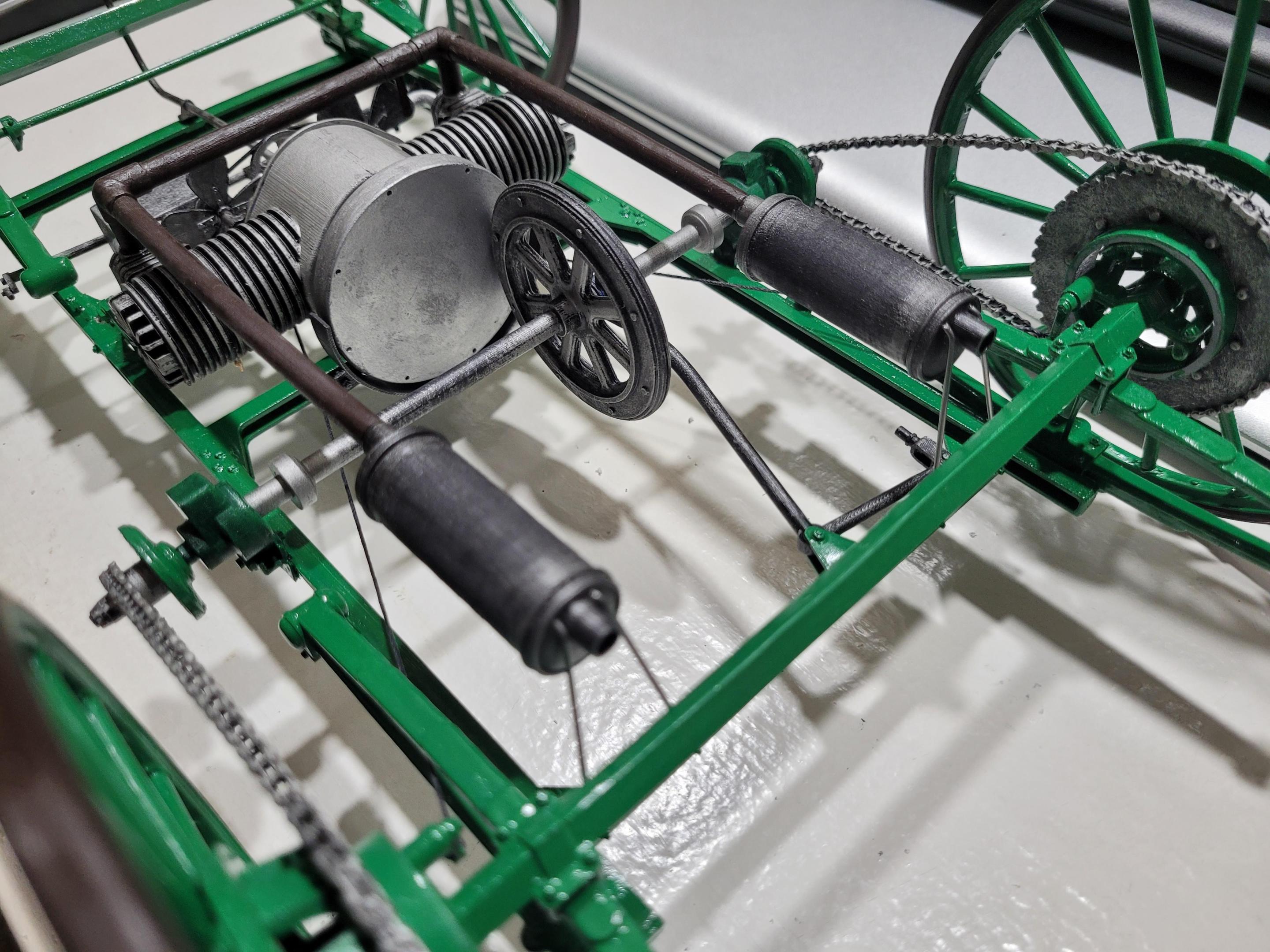

Thanks Ken, you confirmed my thoughts about the speed control and reverse action.  If the center of the flywheel were dished a little you could achieve a true neutral with no additional wear on the friction wheel.  Very cool, thanks again for taking us through this project.
The friction wheel can be moved away from the flywheel with one of the hand levers.  I will show the detail on that in the coming days.

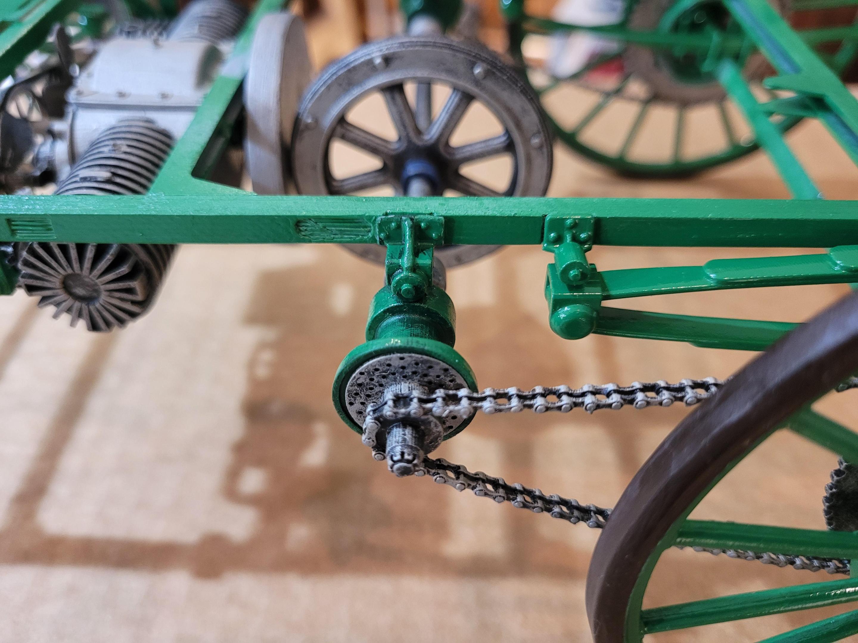

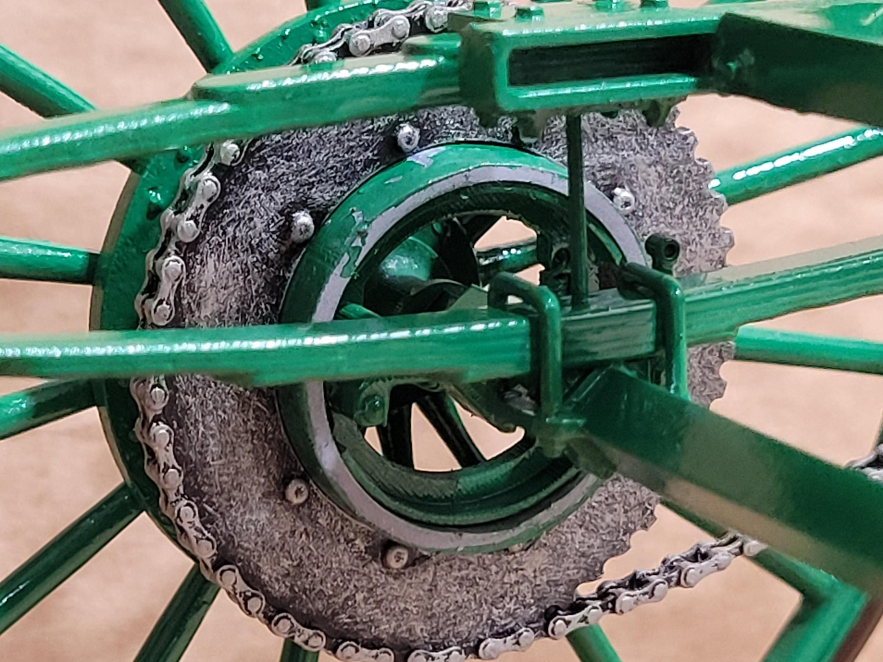

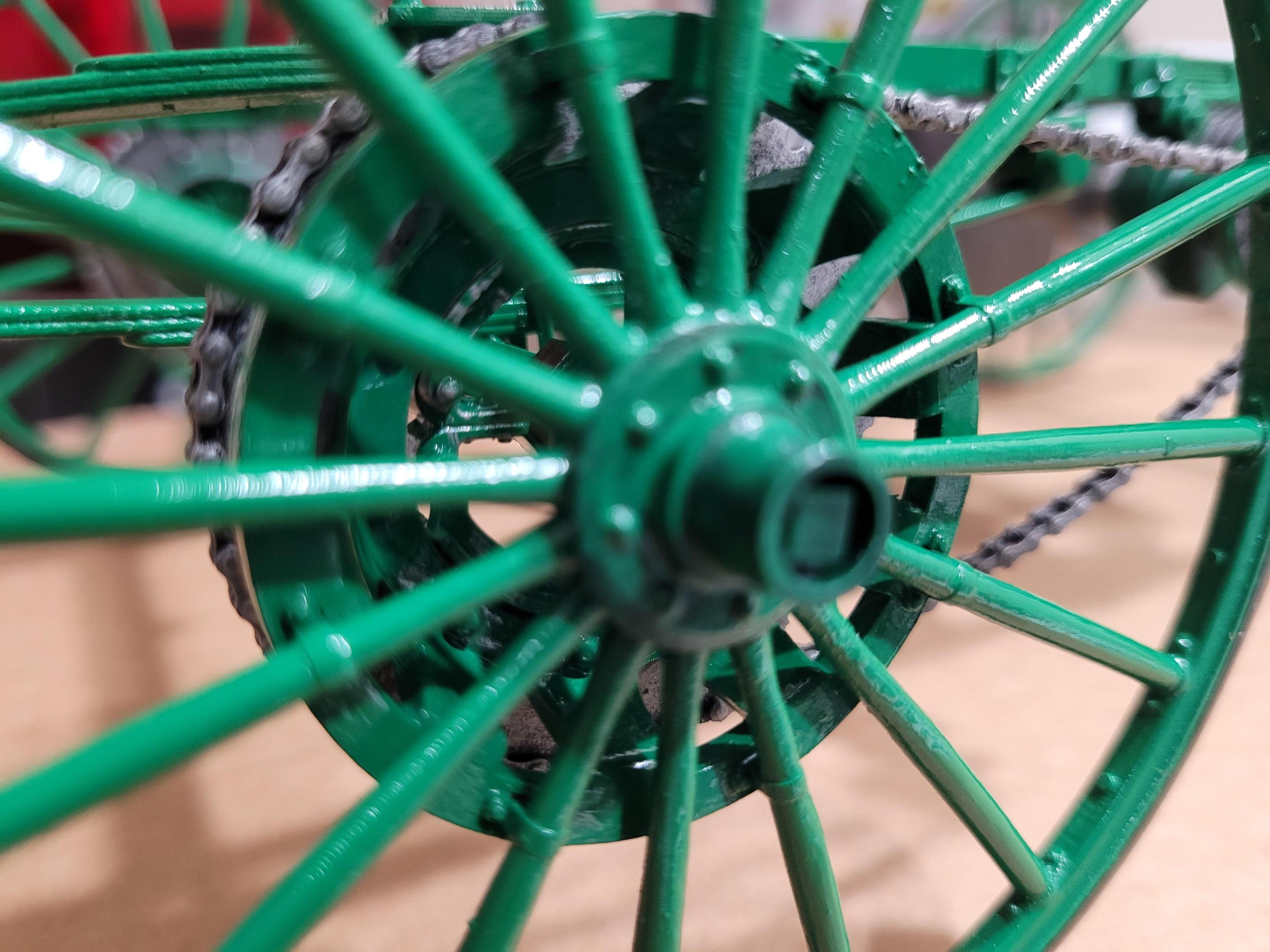

Here is a picture of the LH side differential housing.  The housing dangles from a frame-mounted bracket, and swivels fore/aft, allowing the friction wheel to engage/disengage from the flywheel.  Also note the castle nut at the end of the shaft.

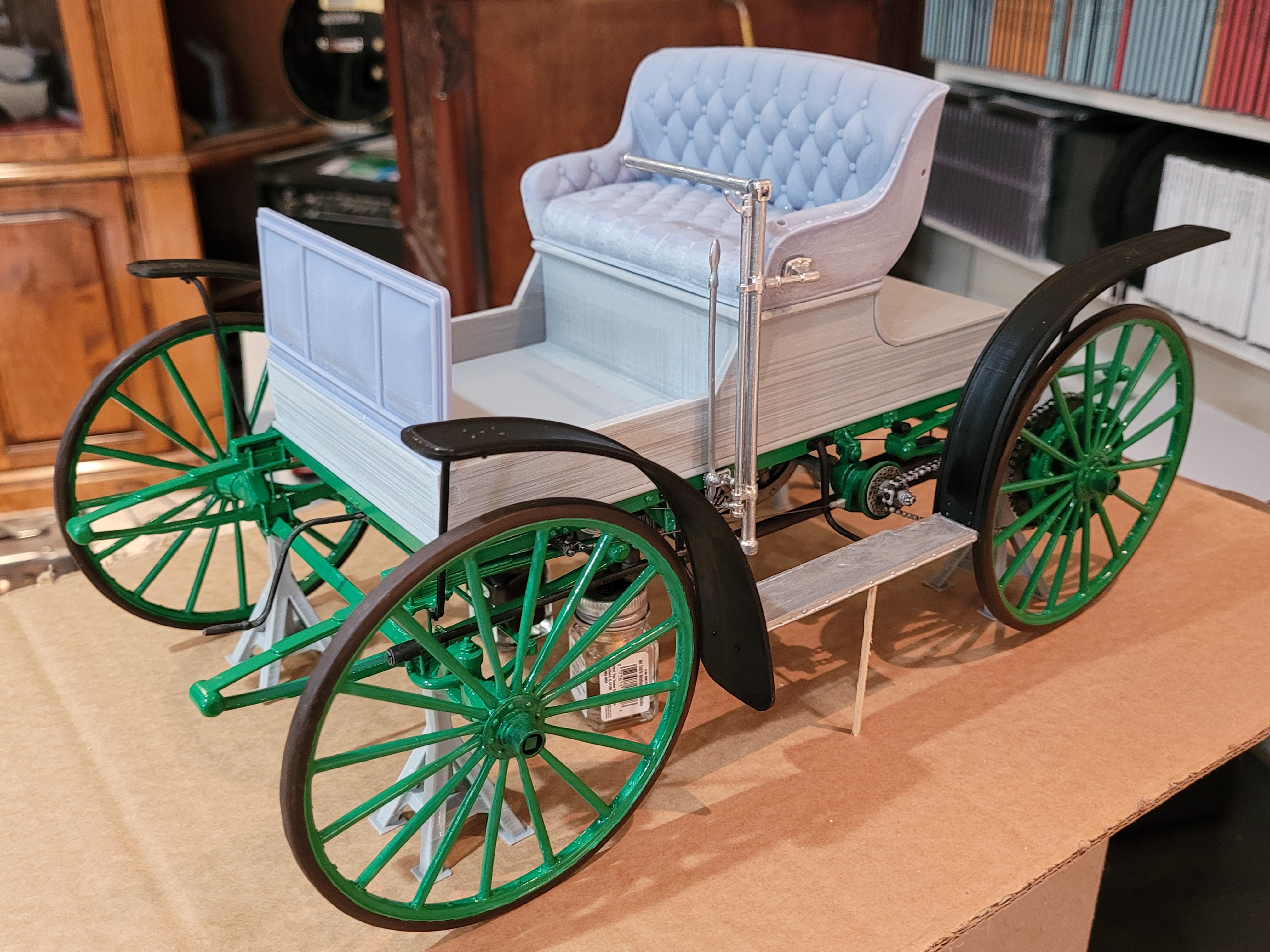

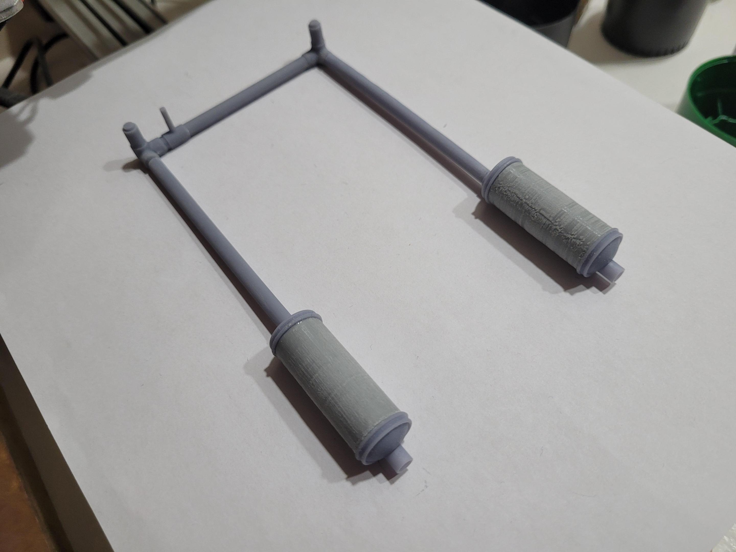

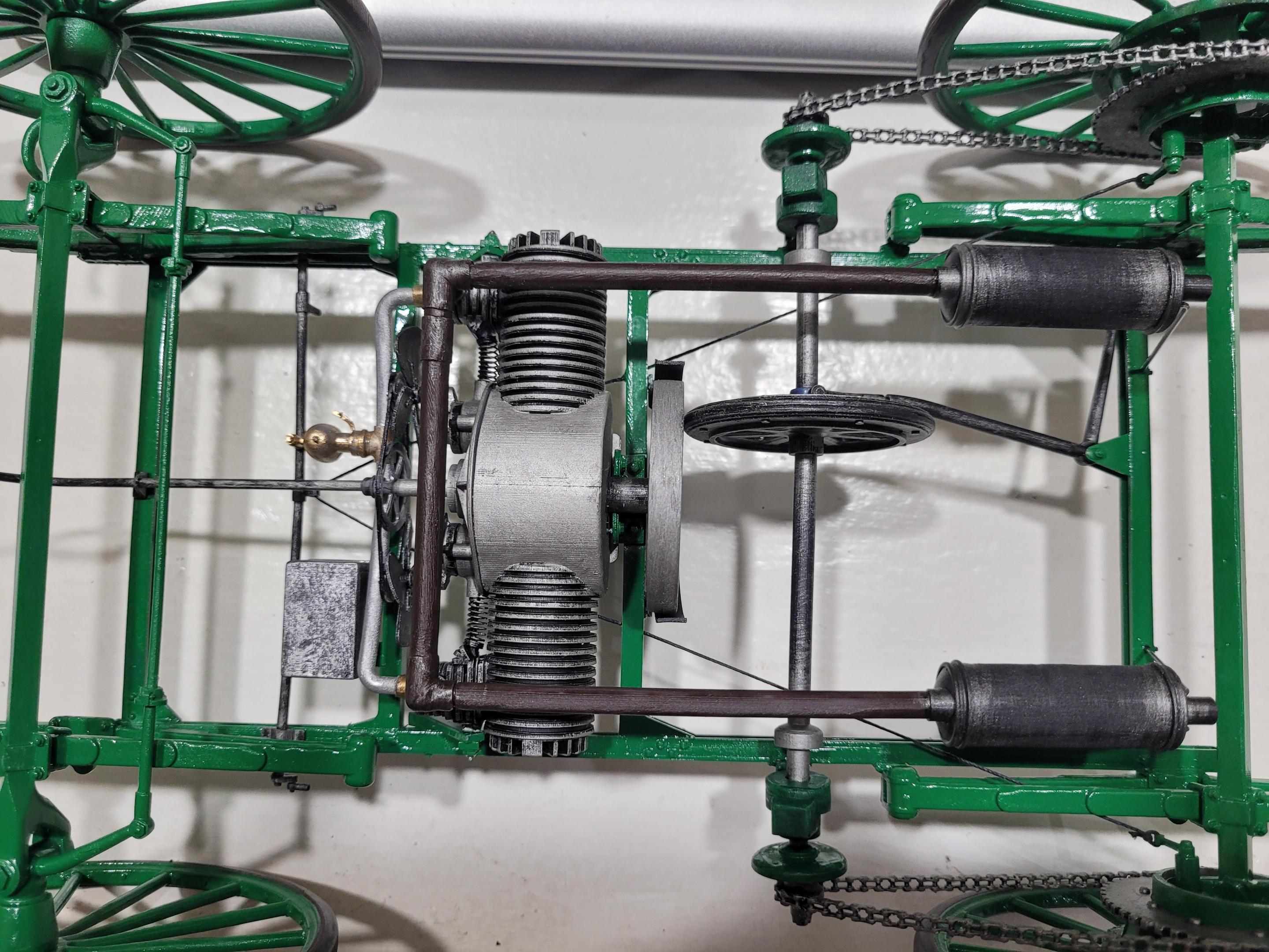

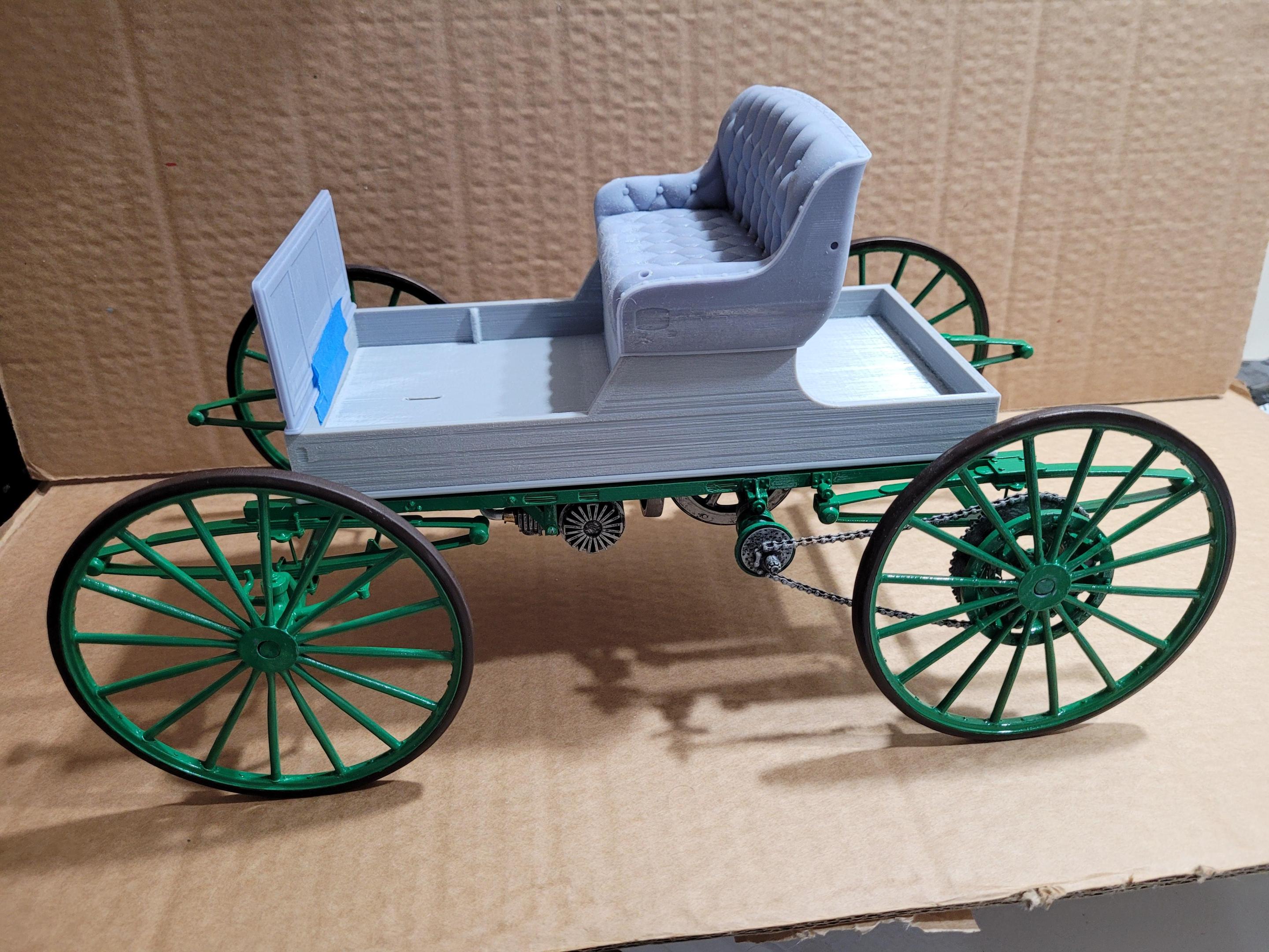

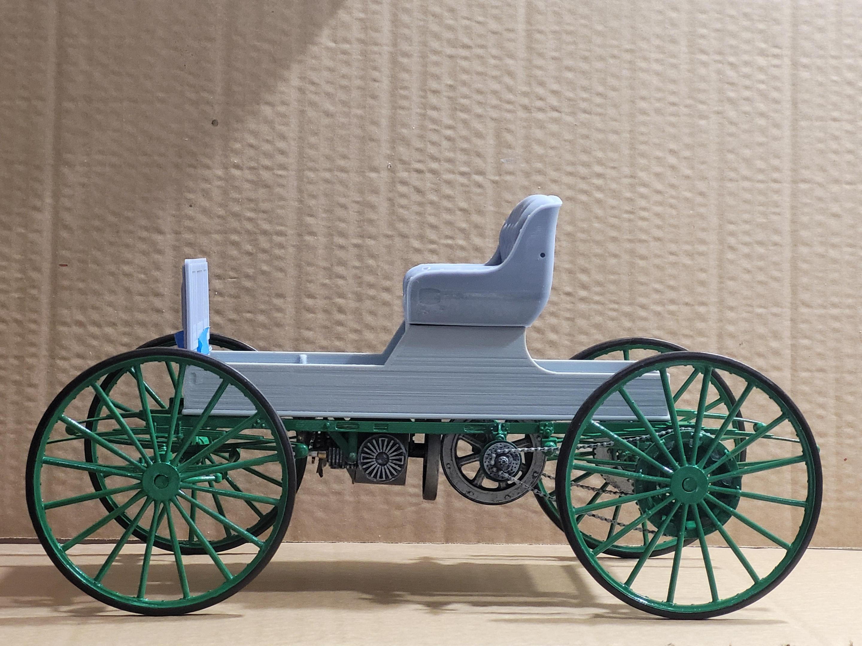

The exhaust system is assembled in 1 piece.

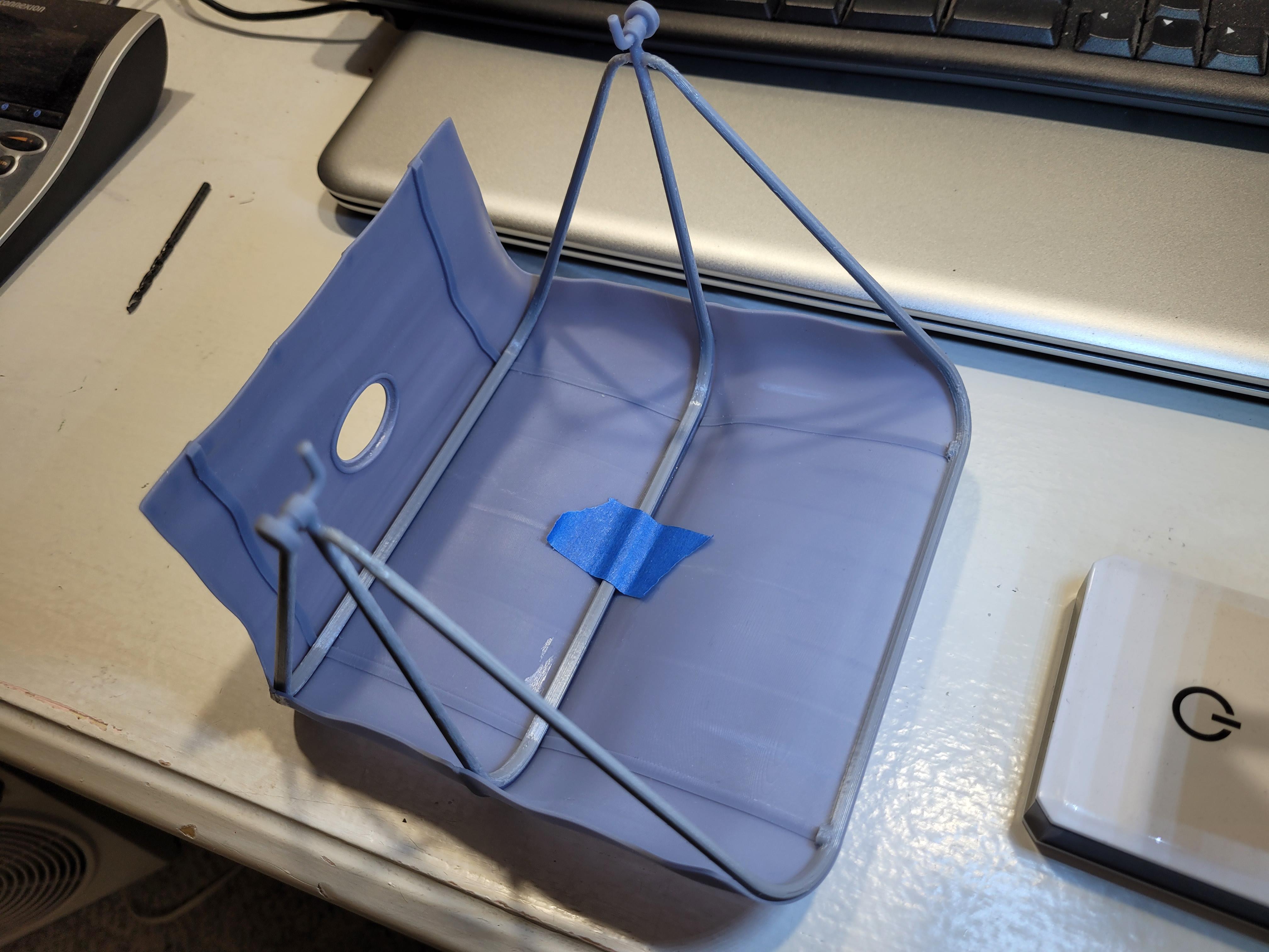

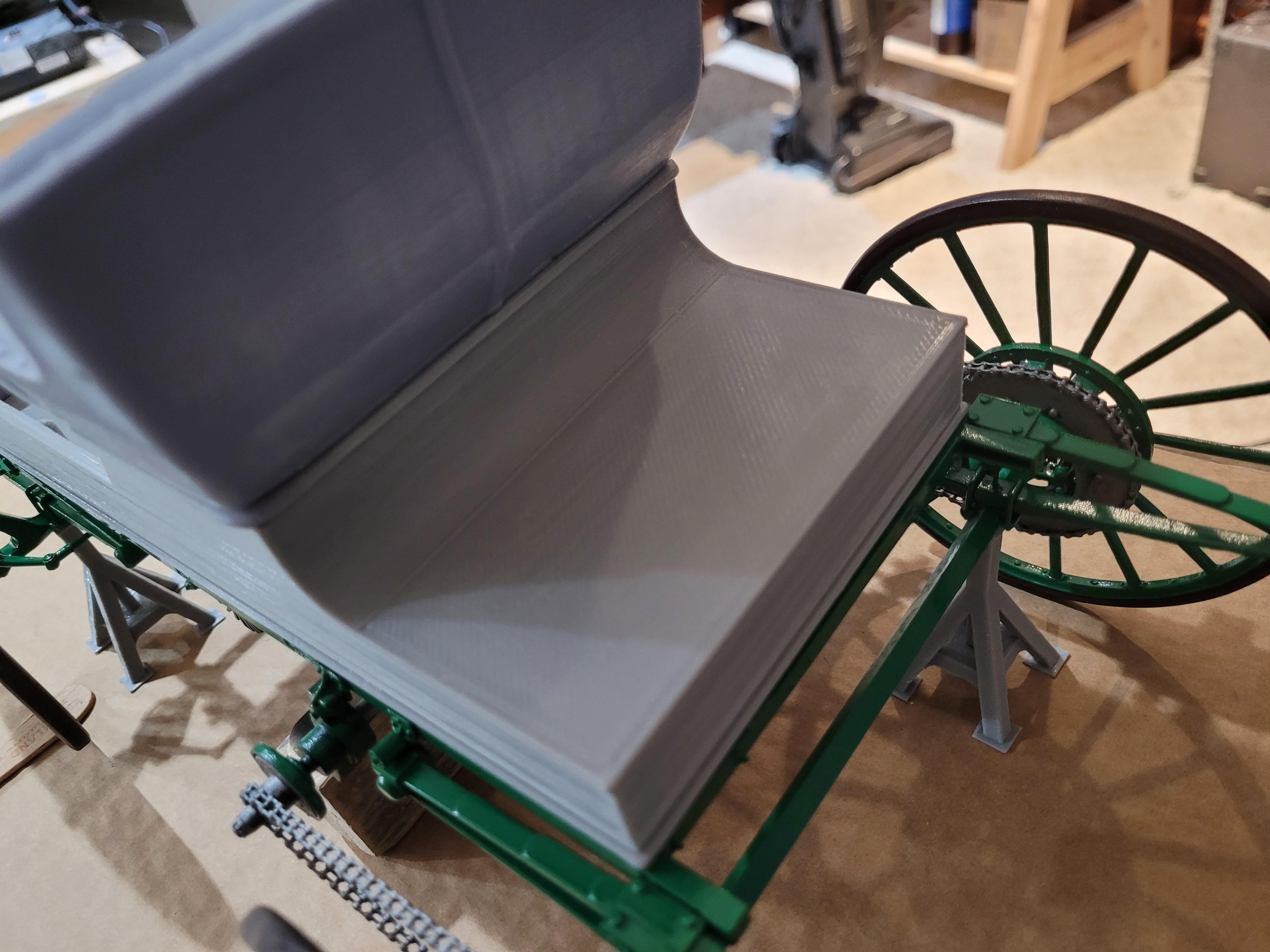

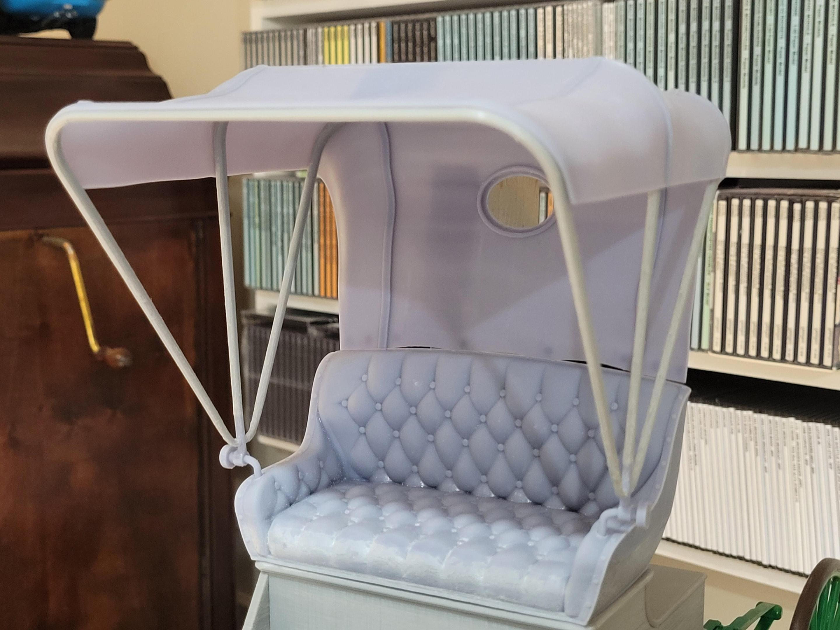

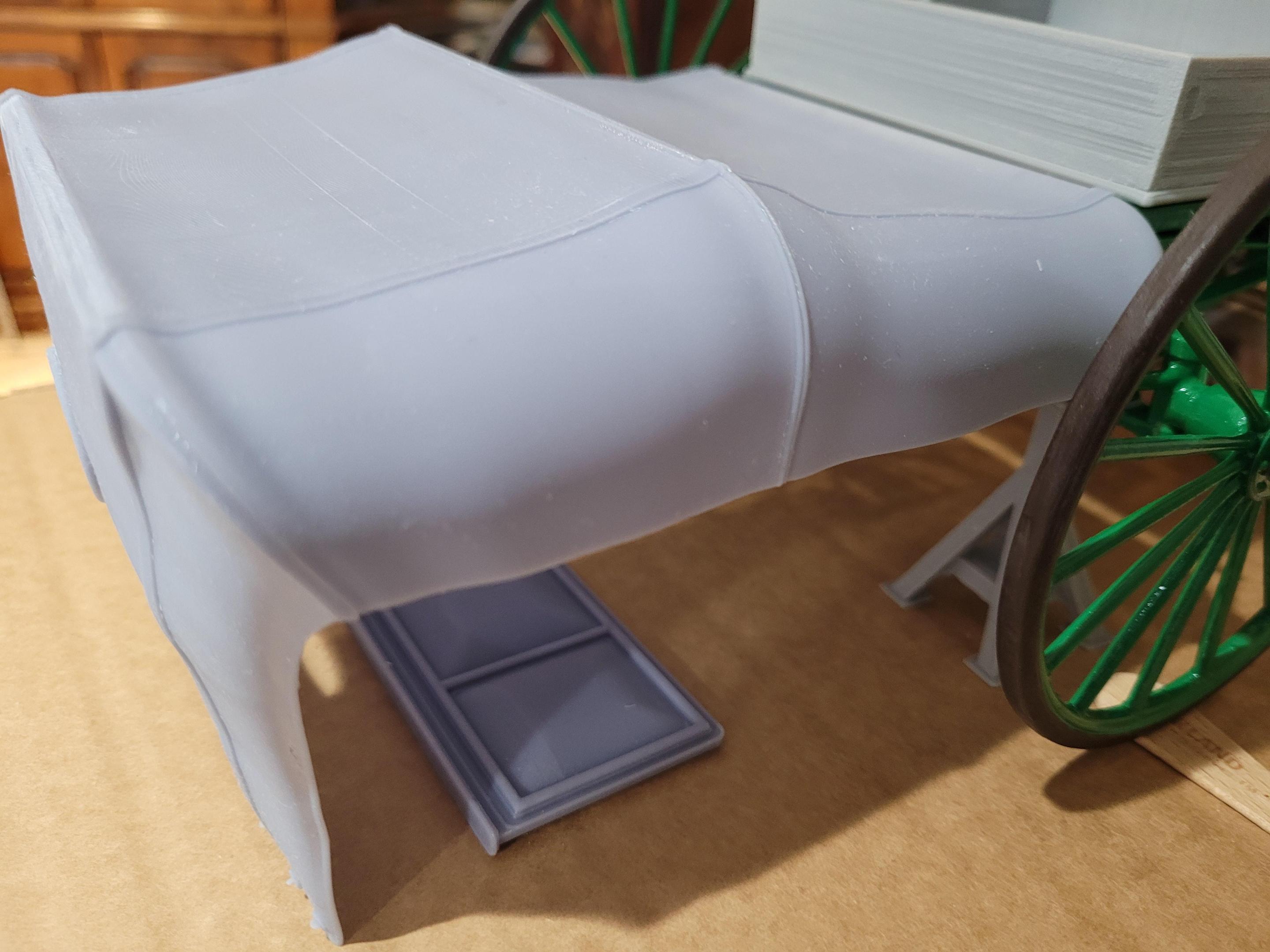

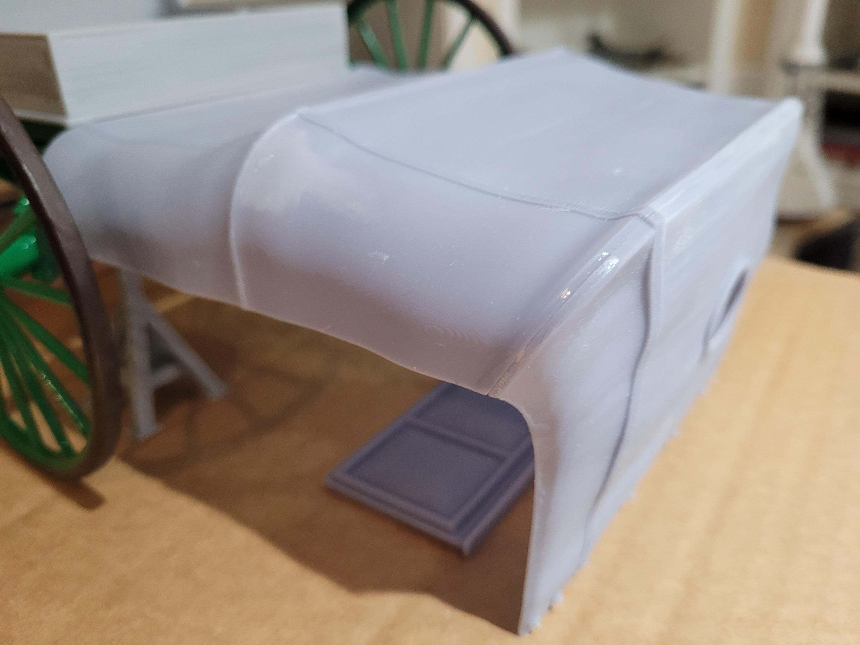

A picture showing the rear deck lid in place.  Also note that the seat rests on a thin wooden platform.

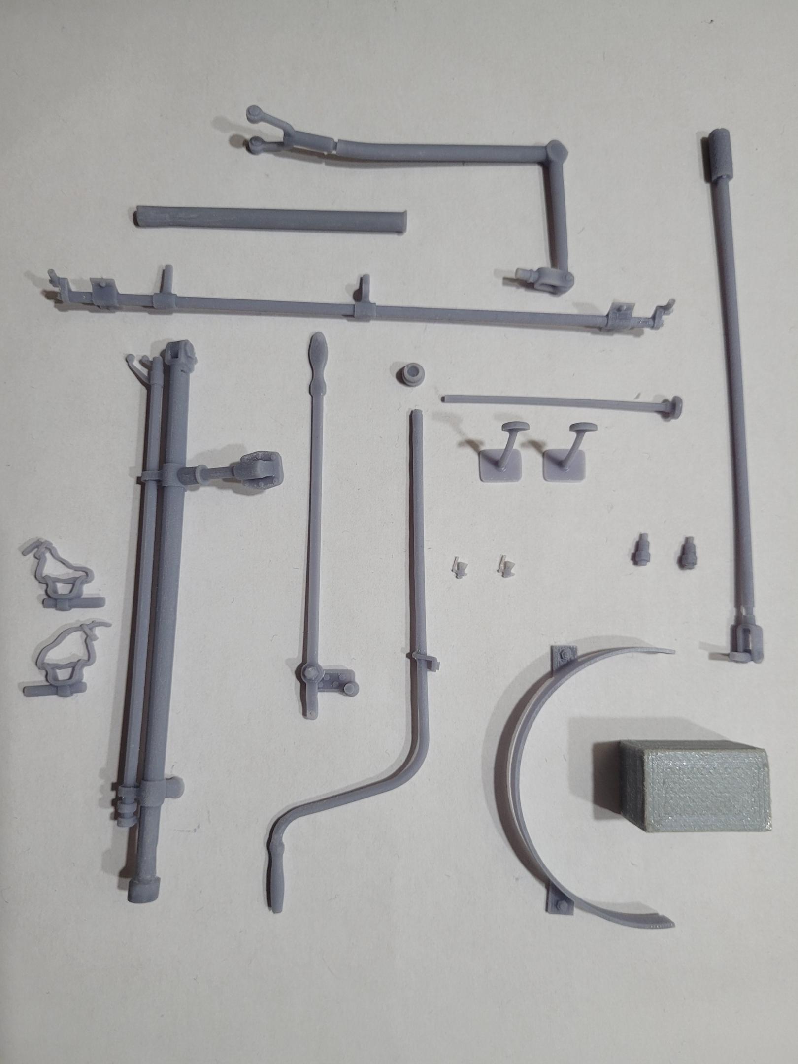

Parts to be finished and installed next; listed from top down:
Speed control lever
Tiller handle
Pedal assembly
Tiller column, throttle and ignition timing levers

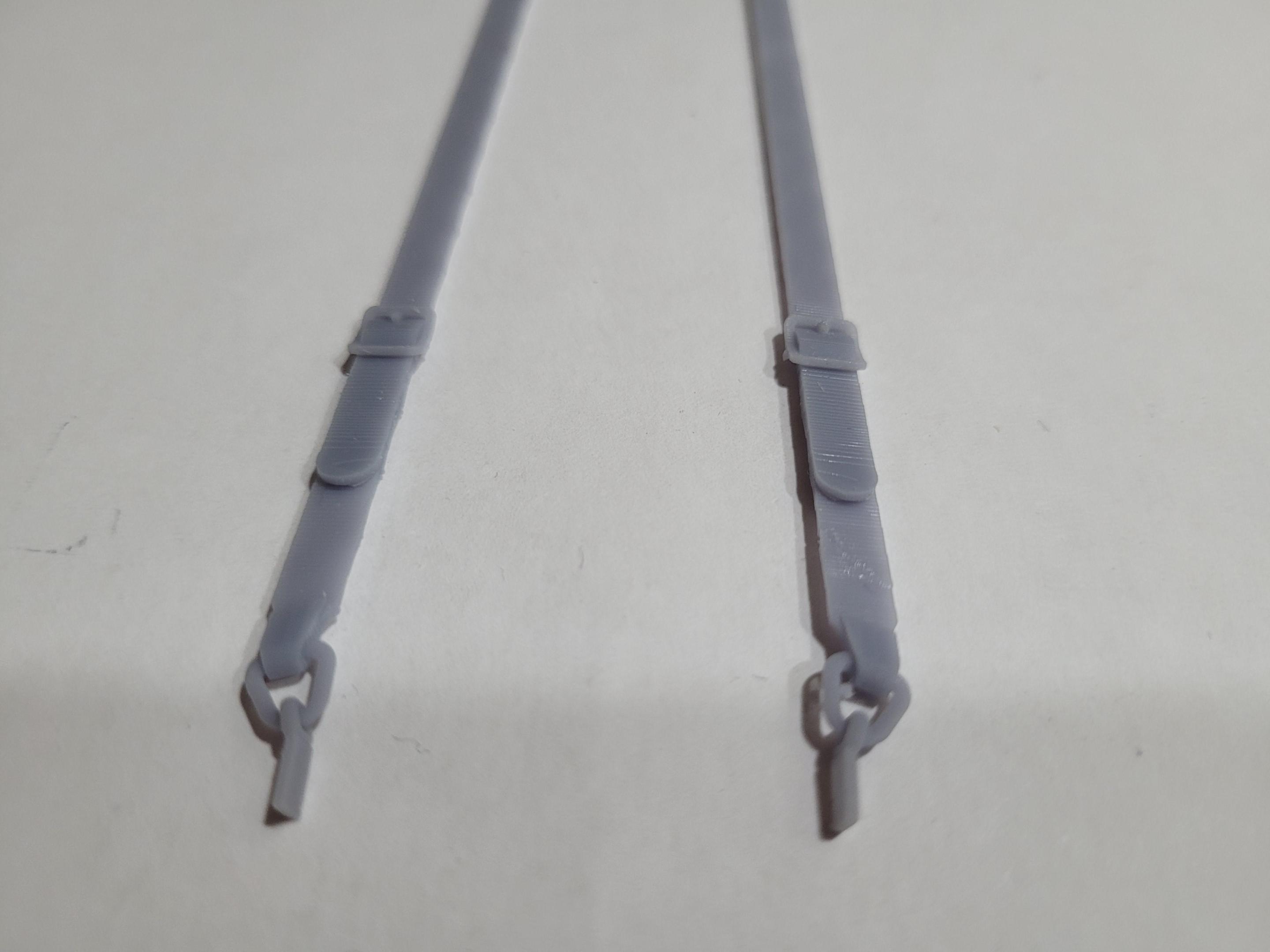

Umbrella hold down straps
Clutch lever
Starter crank handle
Pedals
Oil cups and spark plugs
Steering rod
Flywheel guard
Ignition box

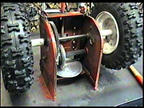

Absolutely amazing amount of detail you are putting into this piece Ken! I sure wish I had your CAD skills.? That drive system is still very popular today in snowblowers. The friction wheel crossing over the center line of the drive disc reverses the direction of travel. Super nice work you are doing!?

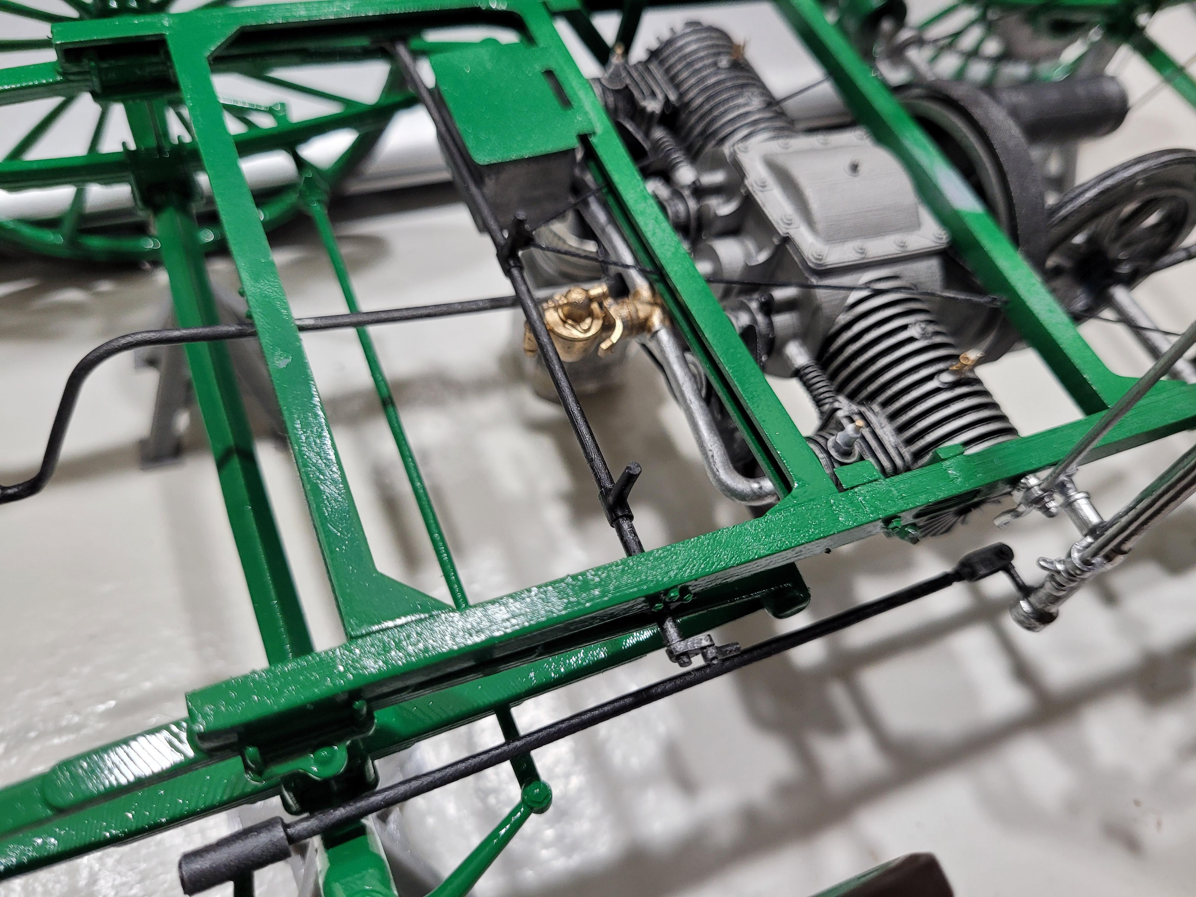

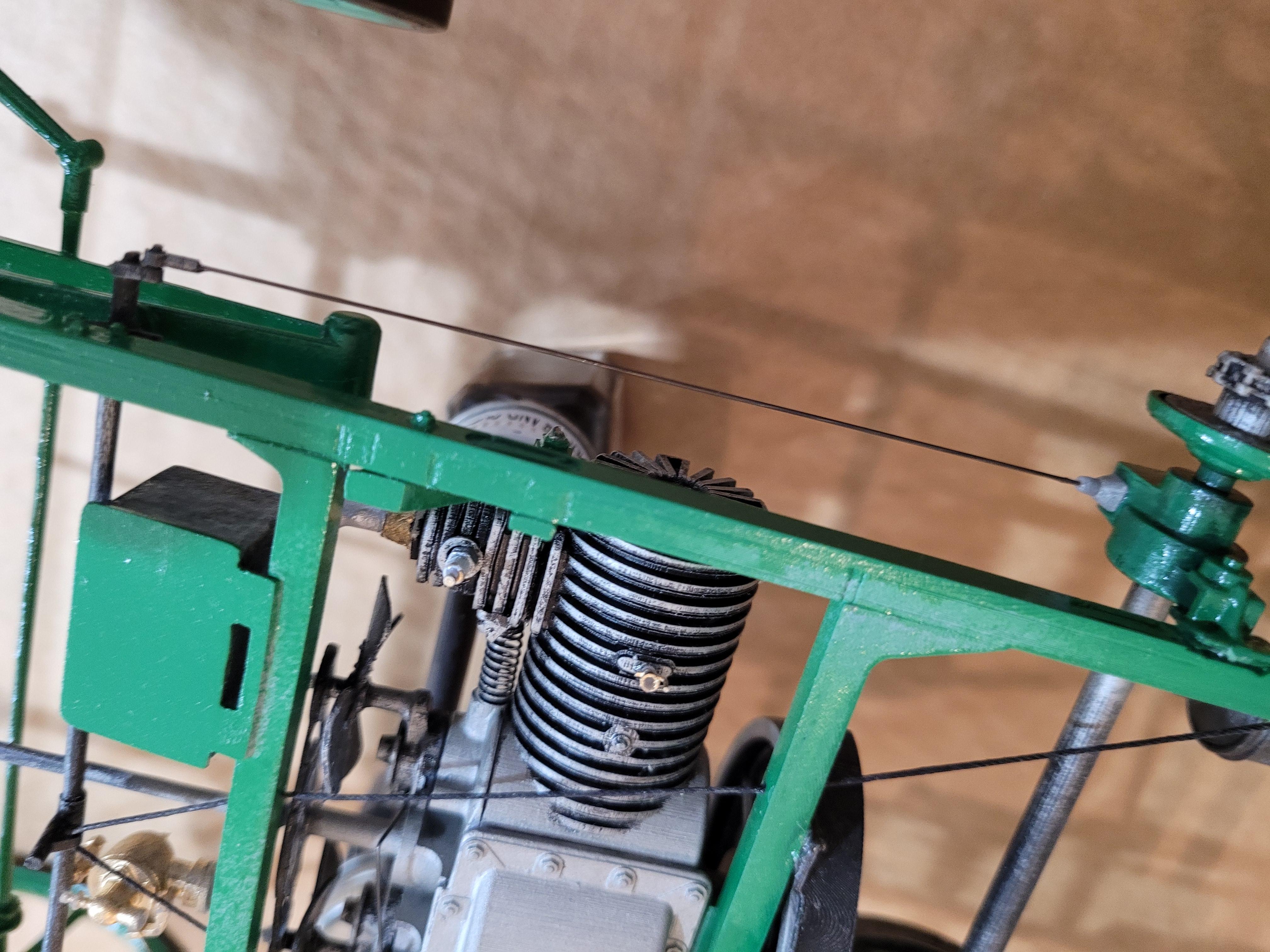

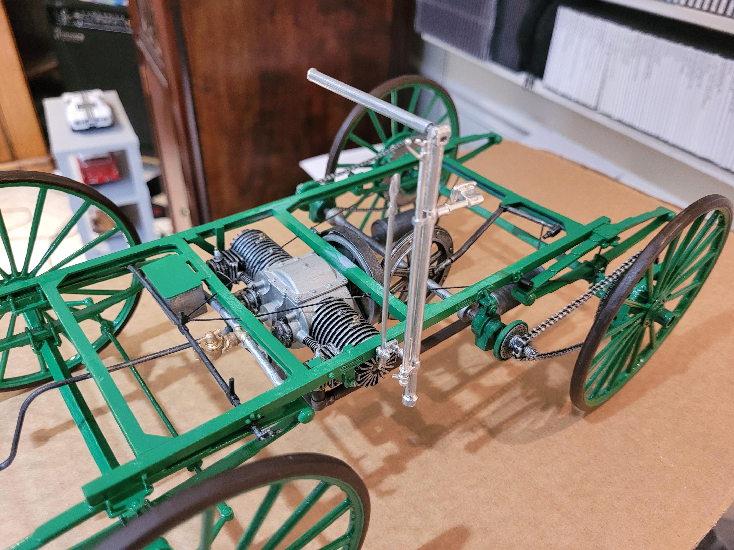

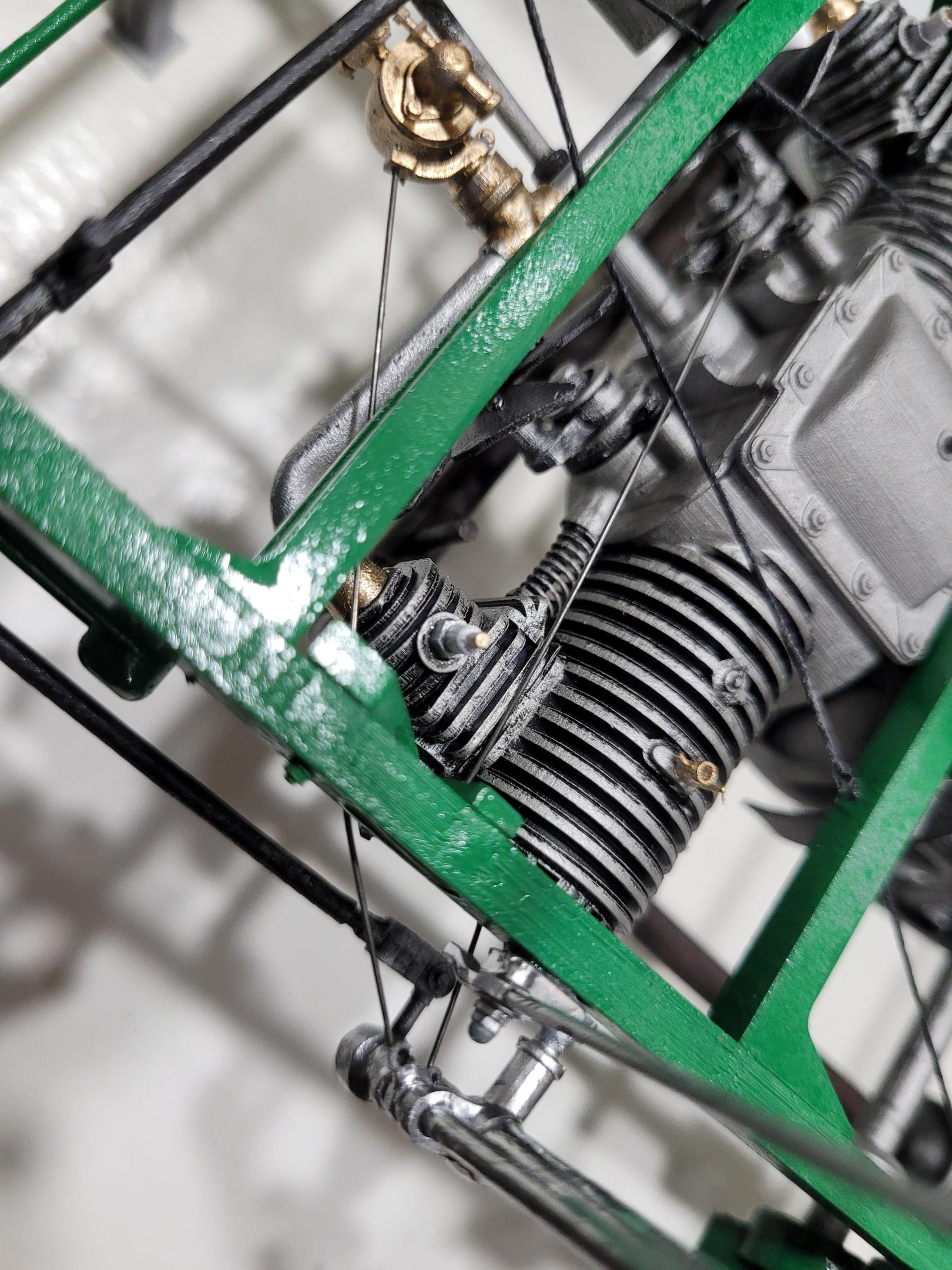

May be hard to see, but the timing and throttle rods are in place.  Please ignore the bad paint on top of the frame.. that will be covered by the body.
  • Like 2

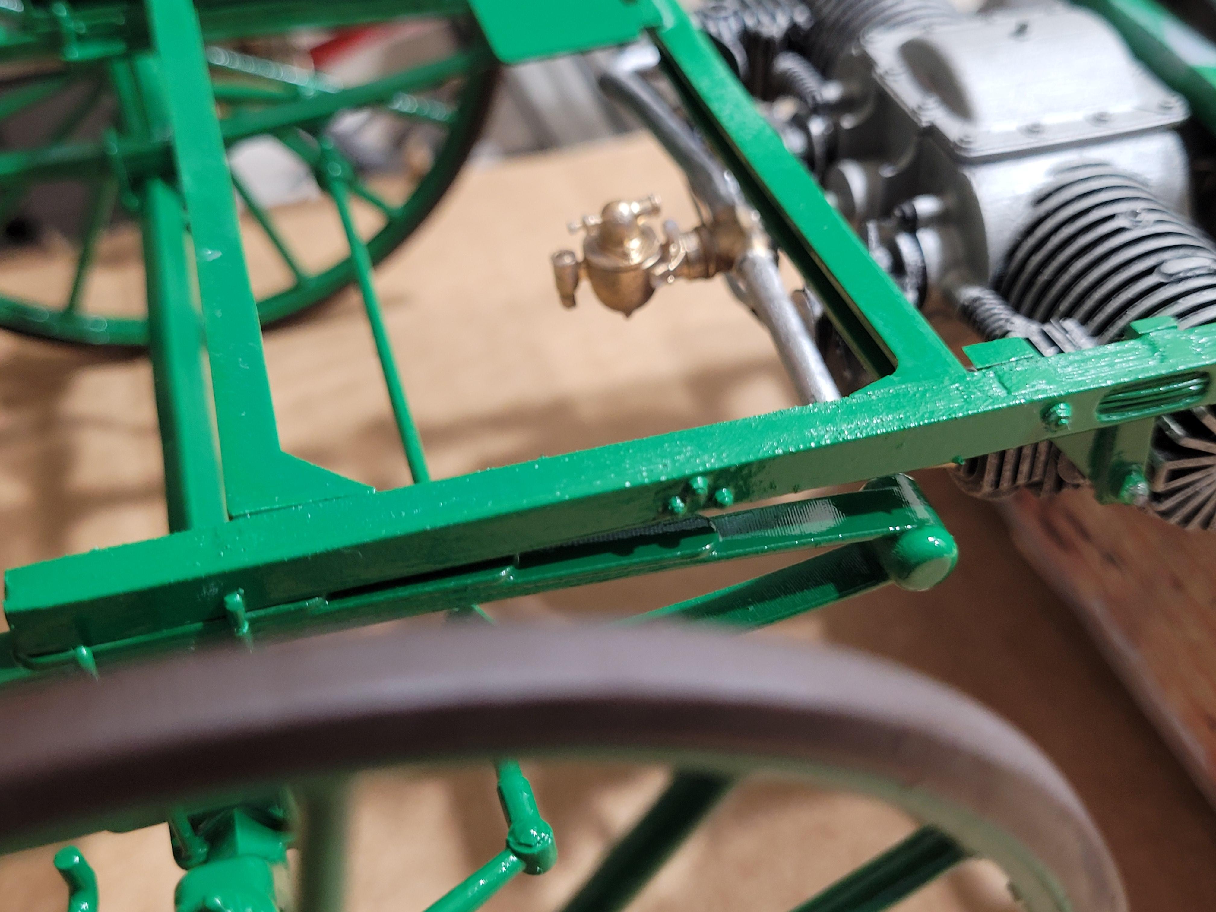

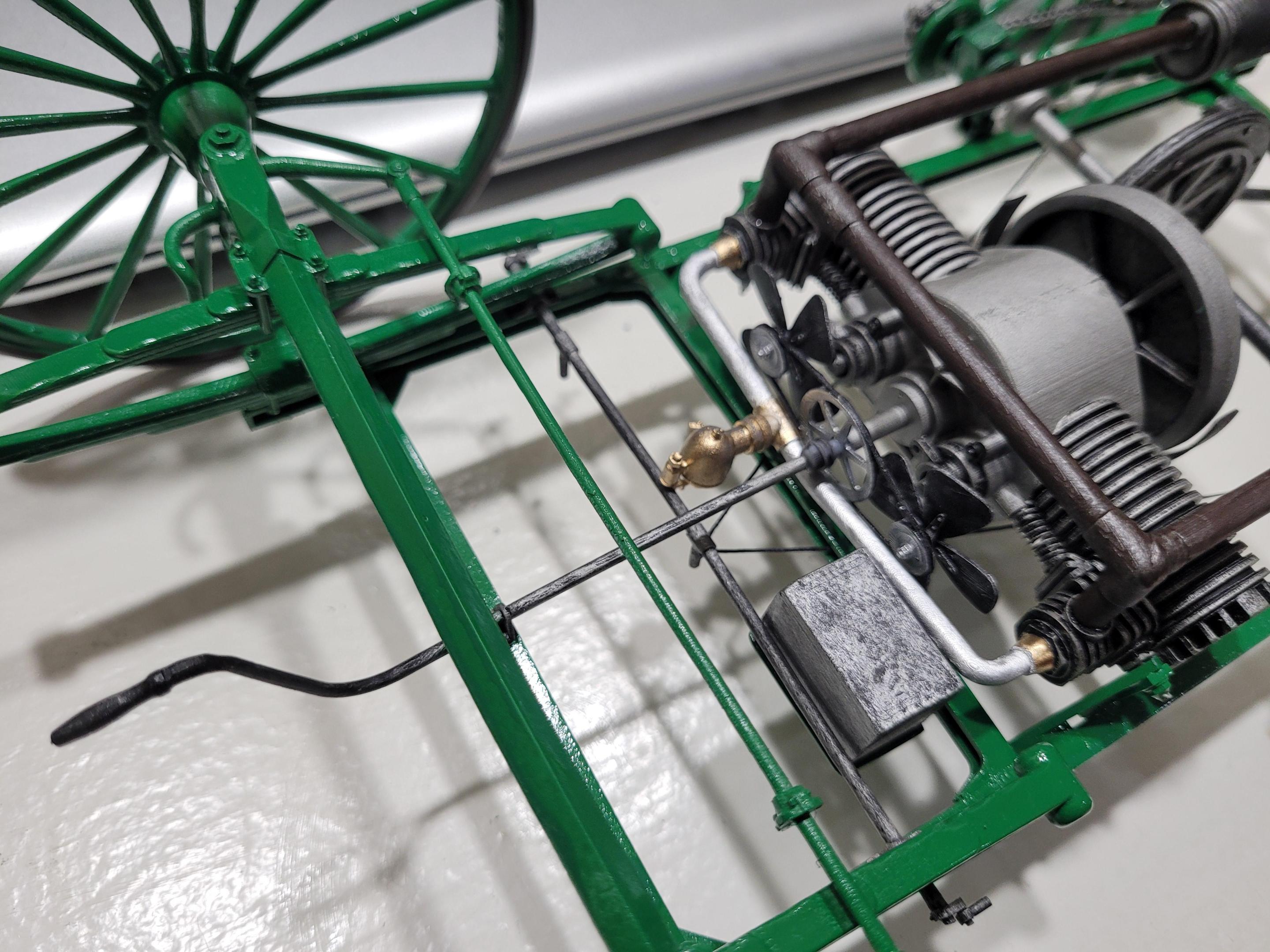

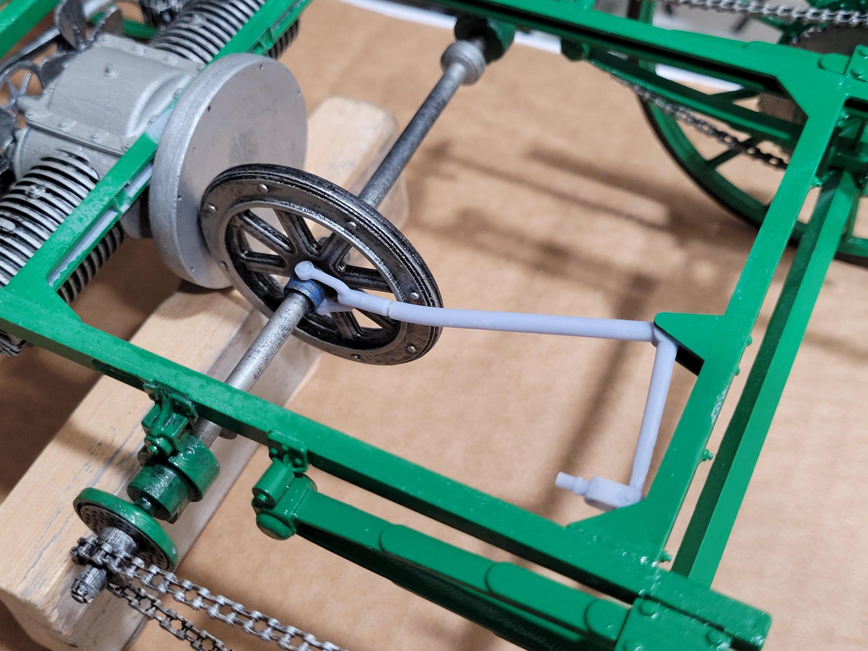

The speed control wheel disengagement rods are in place.  These rods are pushed rearward by depressing the left pedal on the floorboard, thereby pushing the speed control wheel away from the flywheel (cutting power to the rear wheels).
  • Like 1
