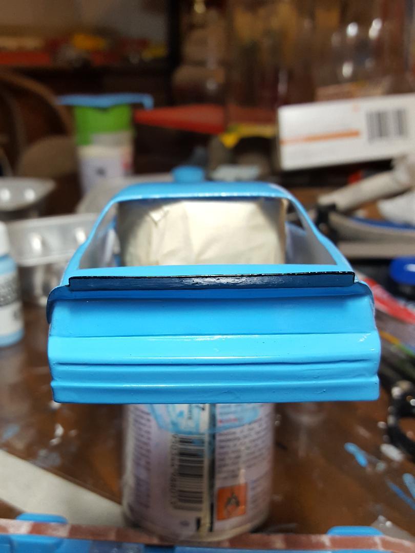

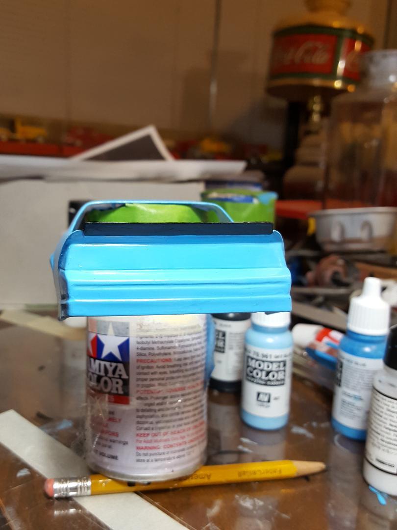

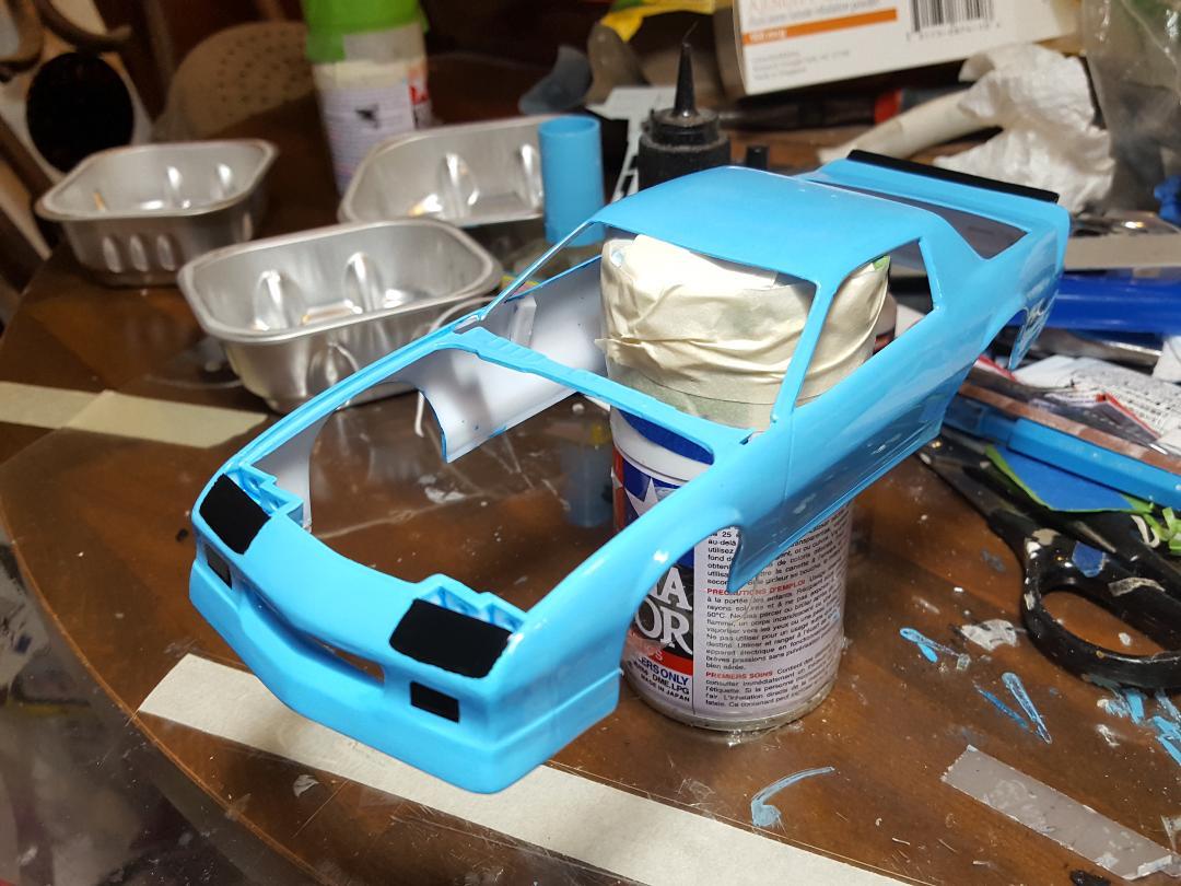

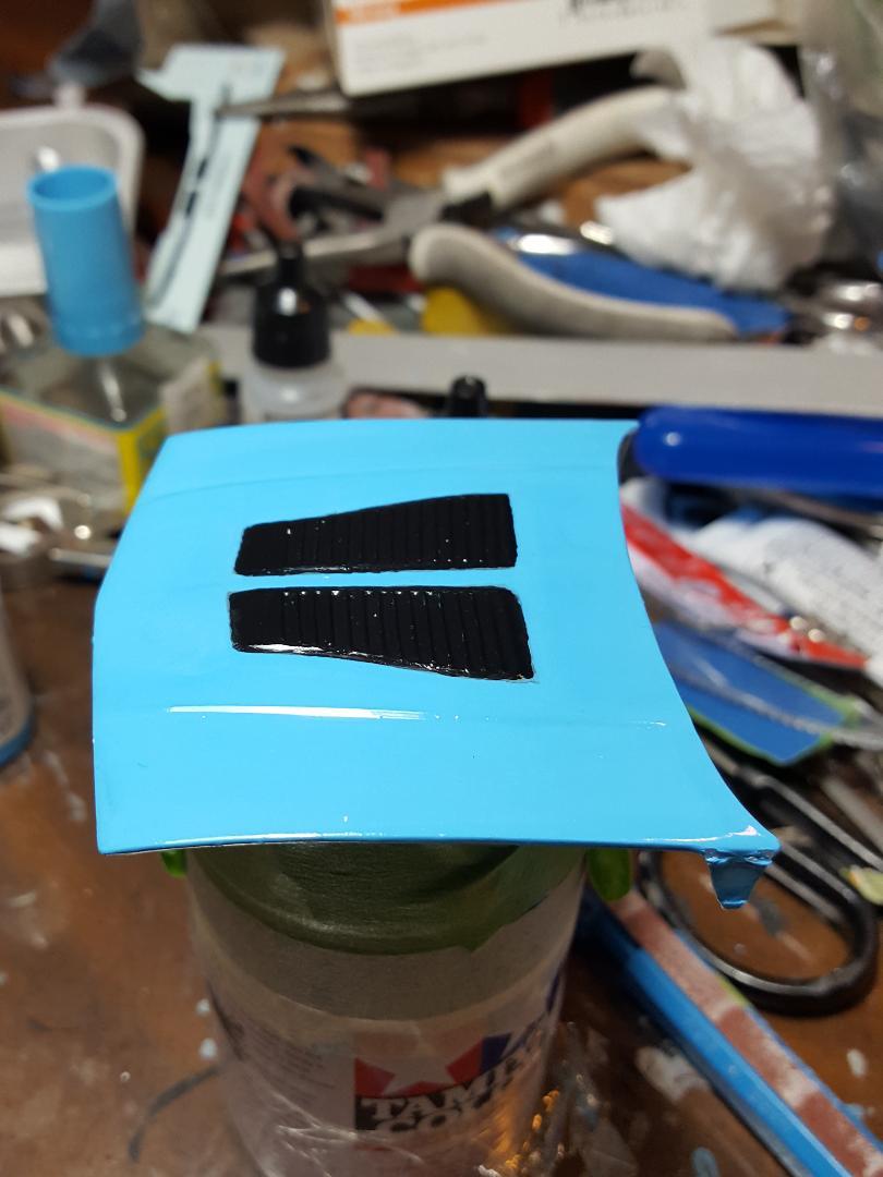

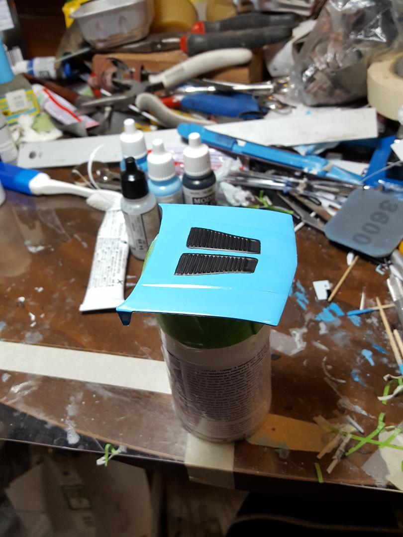

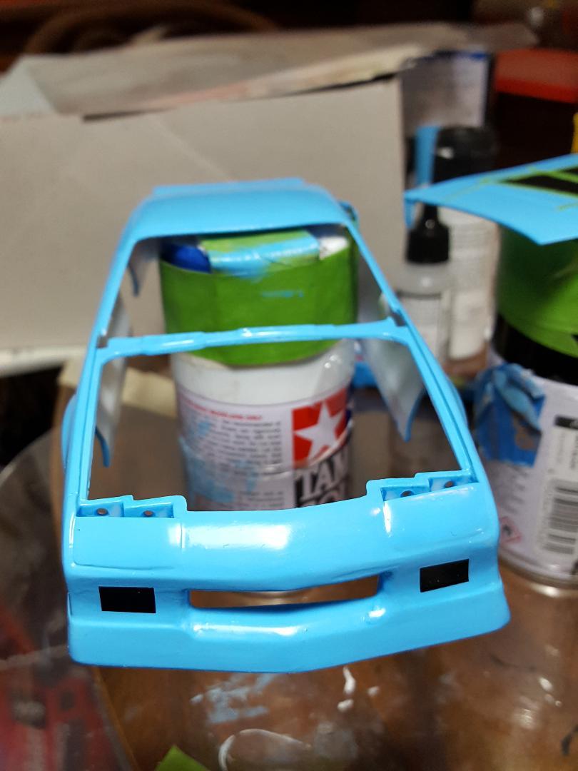

MarkJ Posted November 6, 2023 Author Share Posted November 6, 2023 I'm through with the blue part of the body. Just need to mask and paint the hood louvers, headlamp covers, park light covers, and the top part of the rear spoiler black. then I can clear the body and polish it and move on to the chassis. The paint in the photos my phone camera took are a little lighter than it actually is in real life. It really is a pretty close match for Petty blue. Hopefully the final photos will bear this out. Quote Link to comment Share on other sites More sharing options...

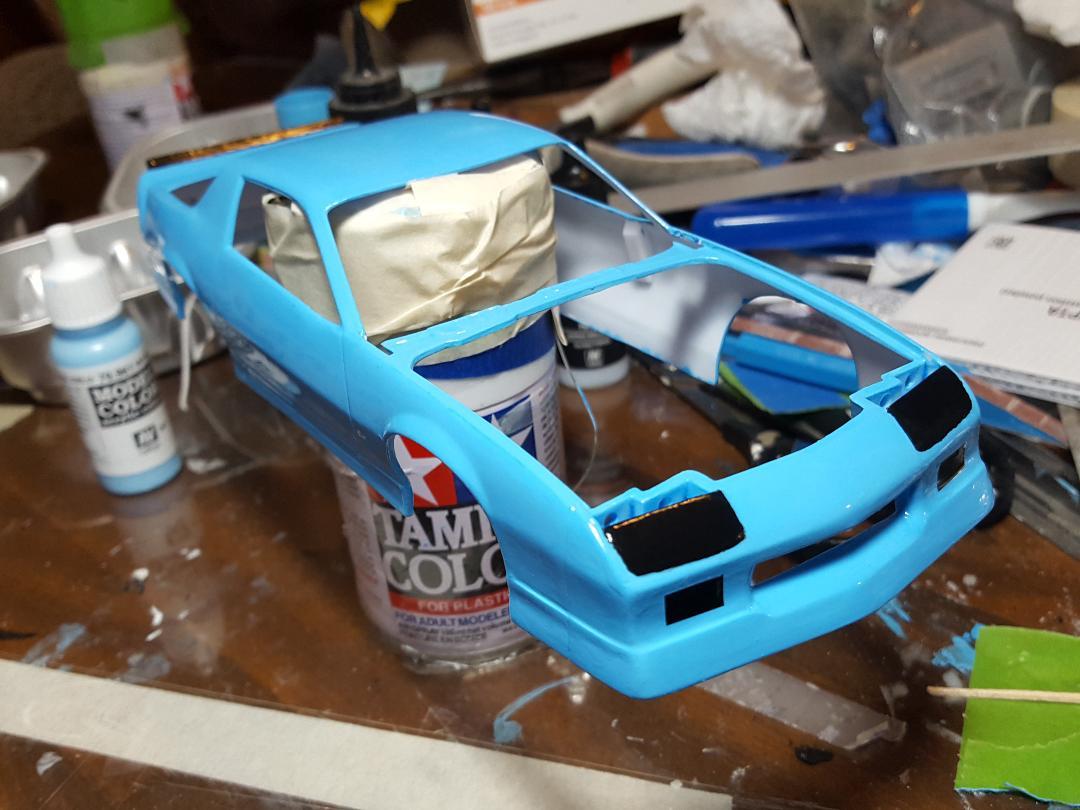

MarkJ Posted November 8, 2023 Author Share Posted November 8, 2023 Started the black items. Quote Link to comment Share on other sites More sharing options...

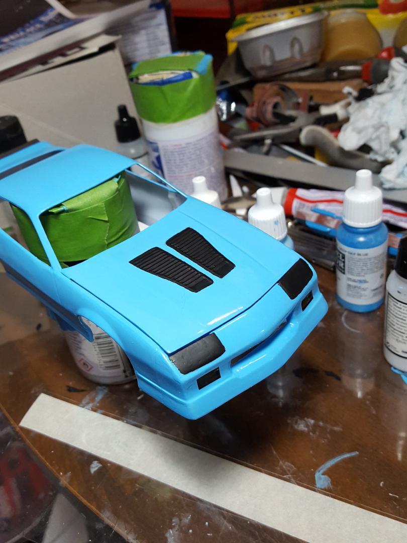

MarkJ Posted November 12, 2023 Author Share Posted November 12, 2023 Quote Link to comment Share on other sites More sharing options...
Rattlecan Dan Posted November 12, 2023 Share Posted November 12, 2023 Came out nice. All the attention to little things adds up to nice build. Nice color as well. Quote Link to comment Share on other sites More sharing options...

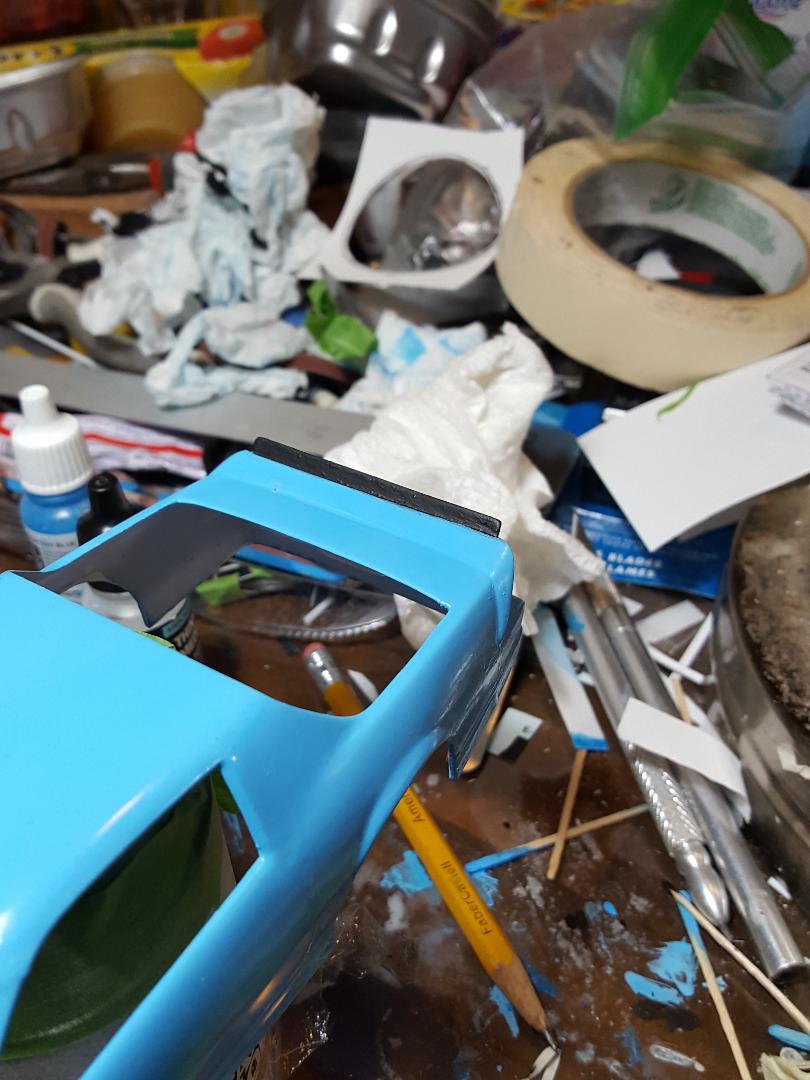

MarkJ Posted November 12, 2023 Author Share Posted November 12, 2023 1 hour ago, Rattlecan Dan said: Came out nice. All the attention to little things adds up to nice build. Nice color as well. Thanks Donato. I'm having more trouble with the headlight covers and rear spoiler but hopefully they will work out Okay. I'm itching to get started on the chassis. Quote Link to comment Share on other sites More sharing options...

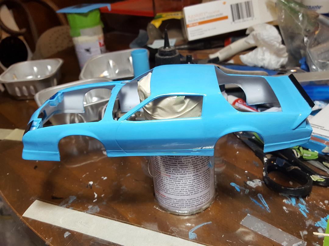

MarkJ Posted November 14, 2023 Author Share Posted November 14, 2023 just a light sanding with 6000 grit pad, Then I will brush on some clear to polish out with some Novus polish. Then I can finally move on to the chassis. Nothing accurate here because of the lack of ref pictures. But should still be an interesting shelfer. 2 Quote Link to comment Share on other sites More sharing options...

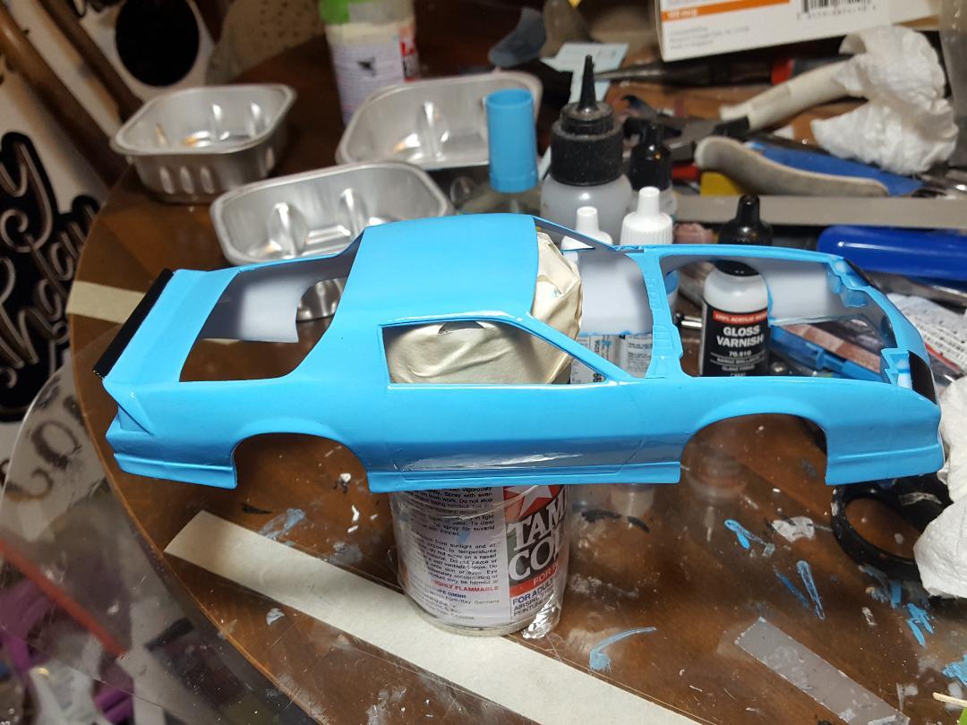

MarkJ Posted November 19, 2023 Author Share Posted November 19, 2023 Using Vallejo gloss varnish as my clear this time. I really liked the way it went on and flowed out sort of like the way future does. I thinned it 100% with distilled water. no brush strokes and it should give a harder finish for polishing. Quote Link to comment Share on other sites More sharing options...
