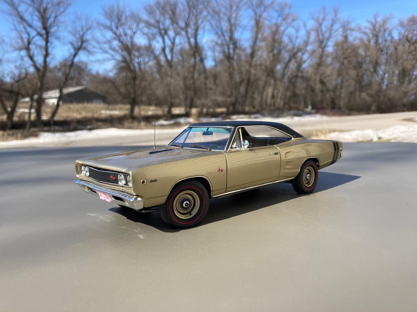

StevenGuthmiller Posted September 26, 2023 Posted September 26, 2023 56 minutes ago, NOBLNG said: You might be able to foil it first then wipe the paint off of the foil similar to the method used on script. http://www.modelcarsmag.com/forums/topic/152097-bare-metal-foil-small-writing/ That’s the technique I used on my ‘68 Dodge. Steve

StevenGuthmiller Posted September 27, 2023 Posted September 27, 2023 1 hour ago, Kit Basher said: Thanks, Steve, I was hoping you'd chime in. Did you paint the body first, or the roof? The roof was the last thing. The body was completely painted and polished first. Then the foil, followed by the vinyl top. I will confess that I masked off some of the window trim prior to painting the top and foiling and then foiled it afterwards, but much of it, such as the drip rails, were foiled prior to paint and cleaned off afterwards. Sometimes there are no set rules. You just have to assess the situation and use whatever technique appears to have the best chance of success for a particular situation. I’ll use every tool that is at my disposal to achieve the best results possible. Steve
