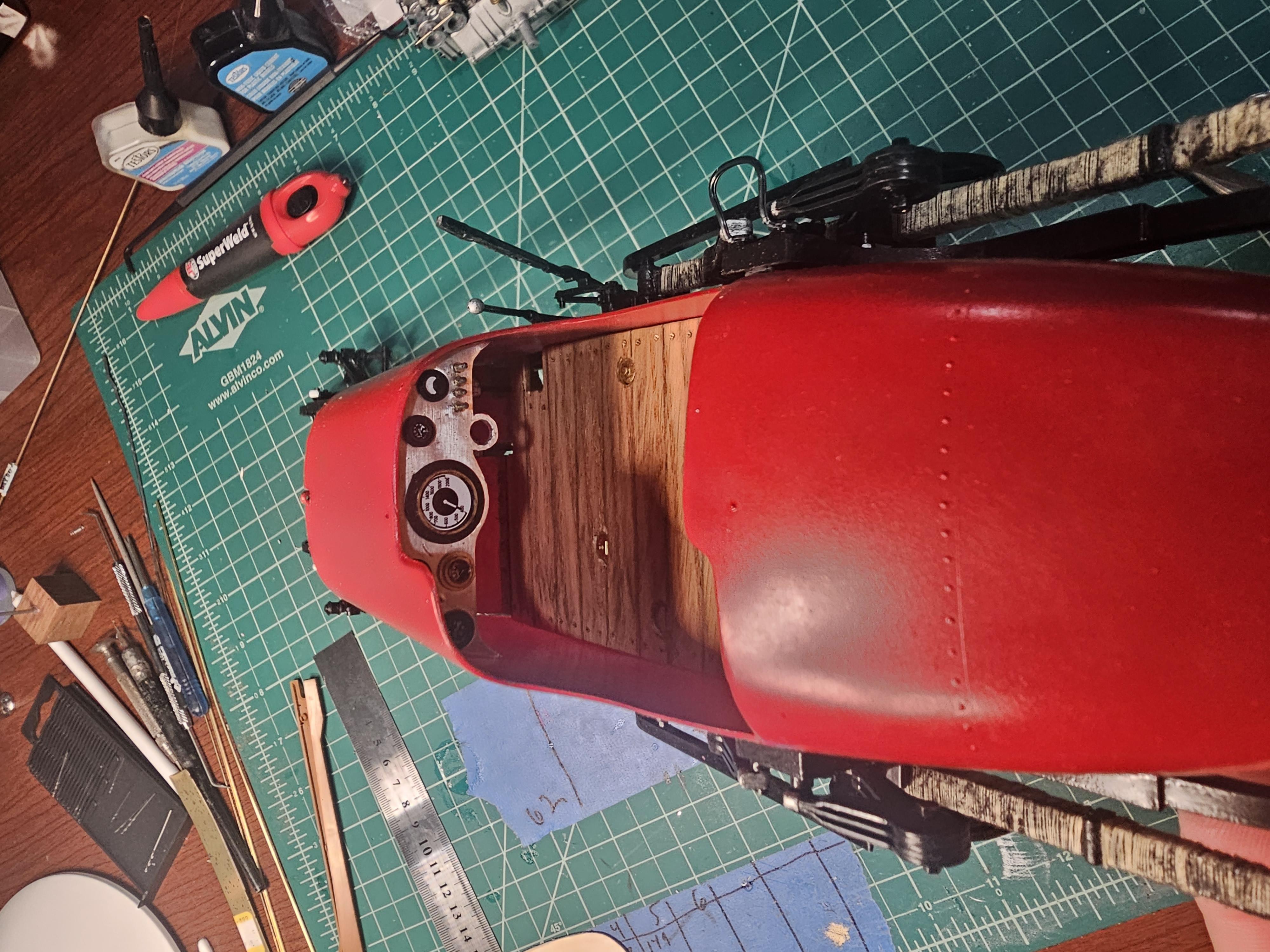

Started the build again after over a year off. Going between the motor and the body now. Currently making the floor,and firewall. Using wood veneers over the plastic and brass tube for the nails?...slow going but I have more time now.20231107_124118.thumb.jpg.37ba9ab5aedb6735e1dac8c5dda1ab98.jpg20231107_124113.thumb.jpg.a3e6055104d44cbdea50d0a74f7b9960.jpg

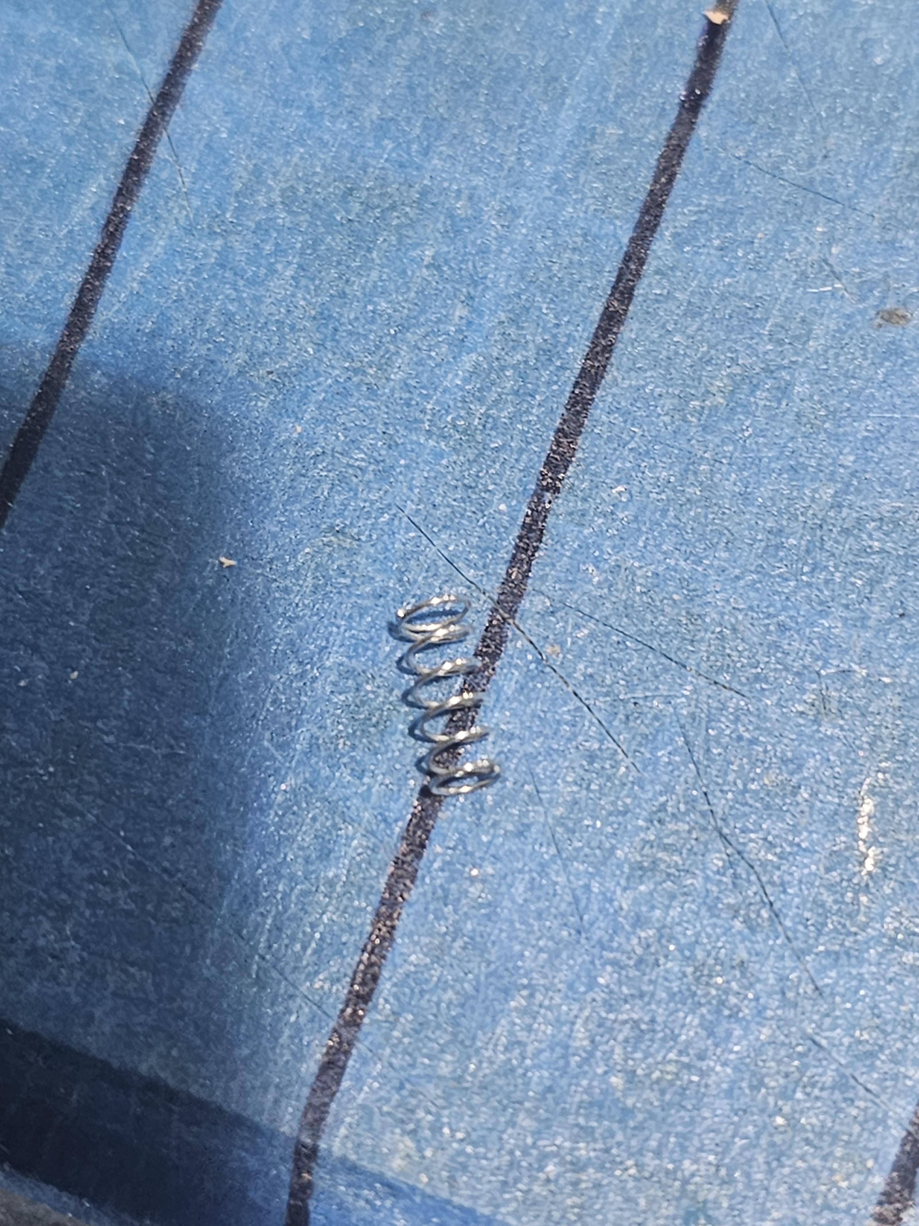

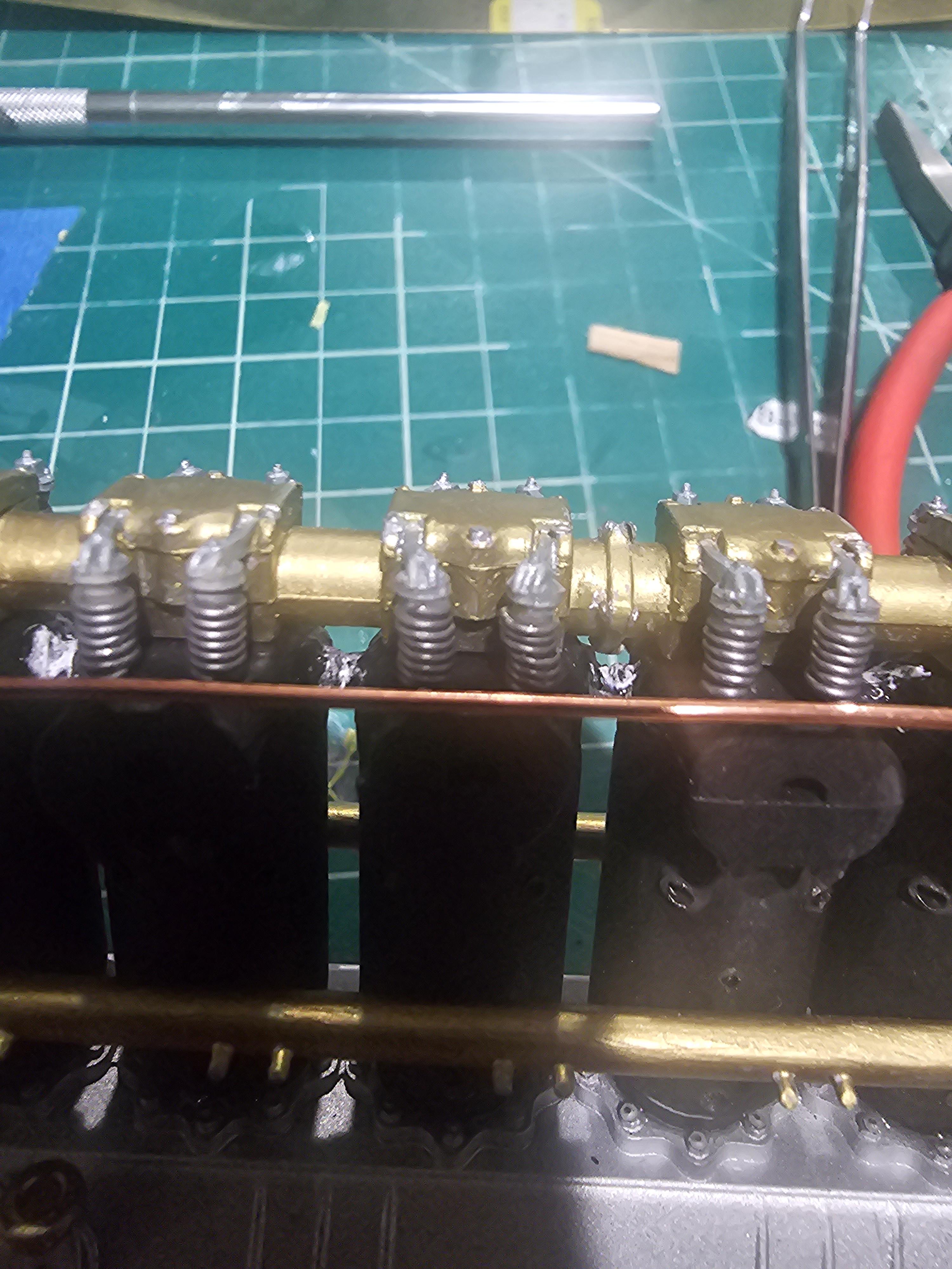

Finished the springs...used lead wire...nightmare to fit them .The ones that come with it are terrible16993978331428716044806847664921.thumb.jpg.d45fa693aa0bc11eb53ad5d67860112a.jpg16993979059344466481983342700584.thumb.jpg.0b86c21fab010b3cd6a611d5403e9884.jpg
Need some weathering on them now
  • Like 2
Getting there with the firewall. The plastic one is wrong..the boards run up and down on the real one. After several tries with different wood I got it with bass wood for the engine side and oak veneer inside. Had to sandwich the plastic part as it has the bung that the bonnets pivot on.

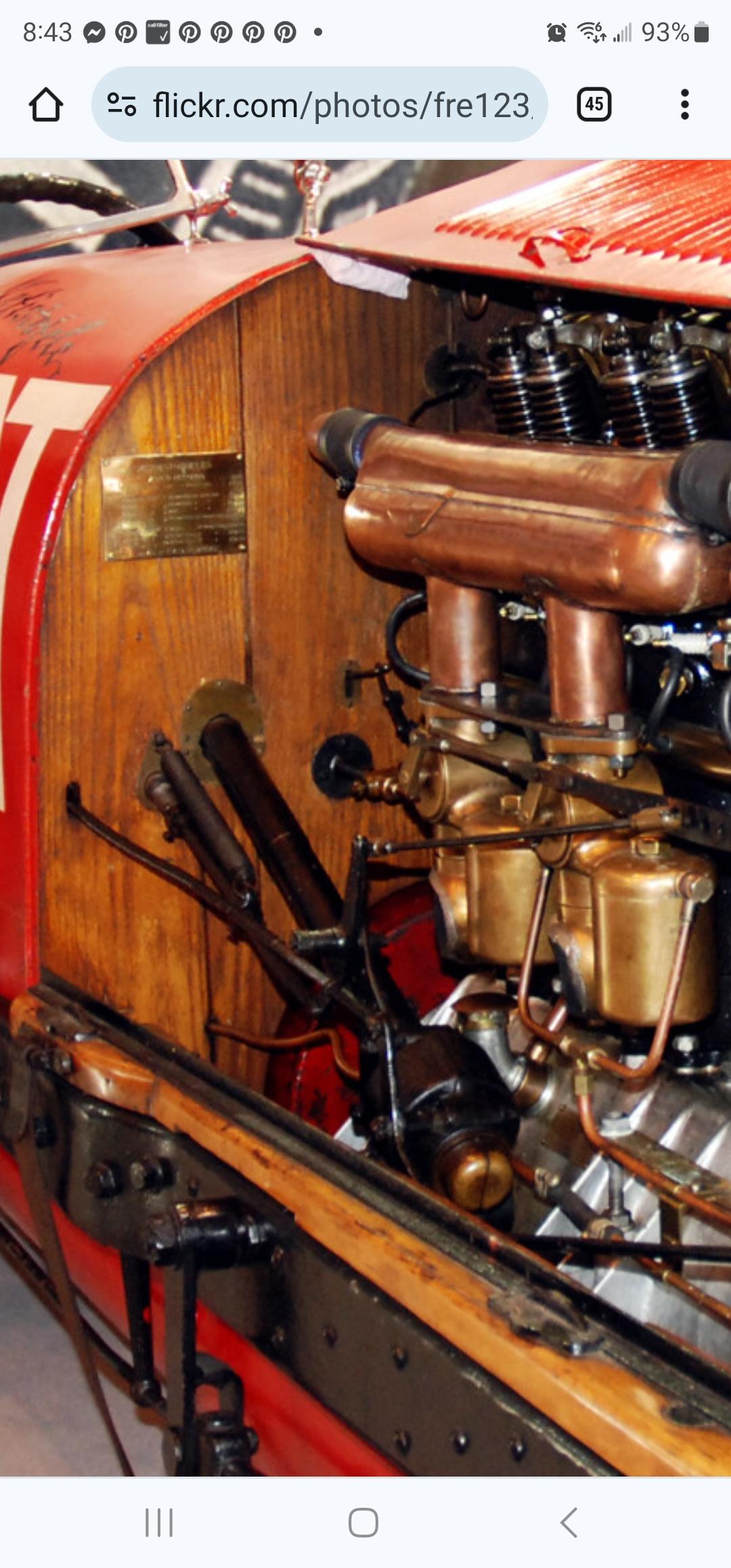

This is the real one. Now have to stain and weather them..then run the 2 cross pieces on the footwell side. 20231108_144623.thumb.jpg.285236b5440eaa1f89ccddcadf0ee54a.jpg20231108_150210.thumb.jpg.8ee43ccc5e319280b88ce483efc790b0.jpg20231108_155322.thumb.jpg.eb59bf9250bf199c0040b49745ac5827.jpg20231108_155326.thumb.jpg.cc91b7cb0303ecbb722d9046887a8e1e.jpg20210924_073250.thumb.jpg.be7f6131a0a44973a2152e11123556f3.jpg

The real one I'm trying for.Screenshot_20231118_084515_Chrome.thumb.jpg.940e03cfb74ff60b9779d0f864990941.jpgScreenshot_20231118_084346_Chrome.thumb.jpg.44ebe5d7aaf06e51b9aeb4d5b655bed3.jpg20231203_105809.thumb.jpg.3caccc4715f83f2fd23055638deed705.jpg20231203_105928.thumb.jpg.3c3a501be40a10627a0429cd8a2c1fc7.jpg20231202_124718.thumb.jpg.03ed70aba2d297c87ac3d84e43026f1b.jpg20231203_141703.thumb.jpg.af30f8ae664dee24c5ba3dc2870349a1.jpg
