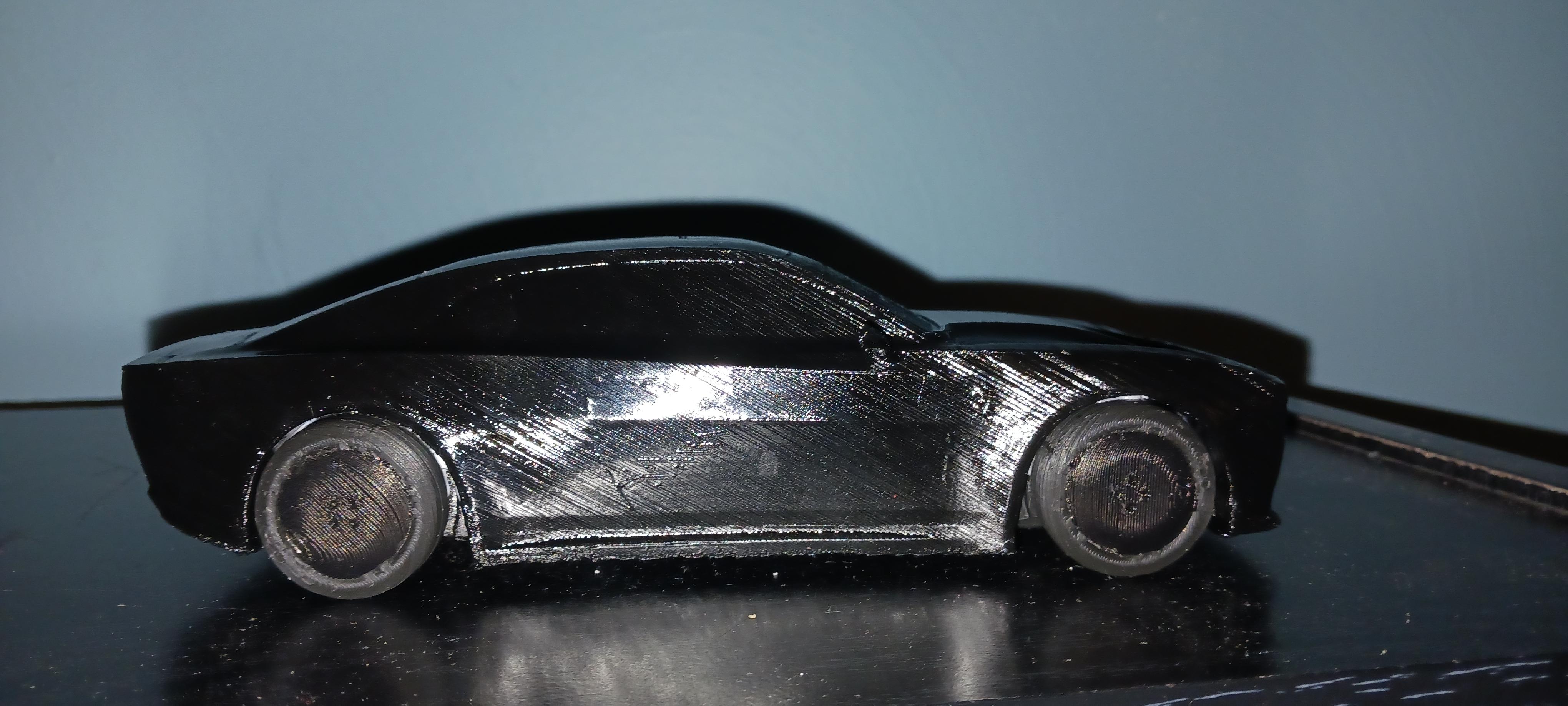

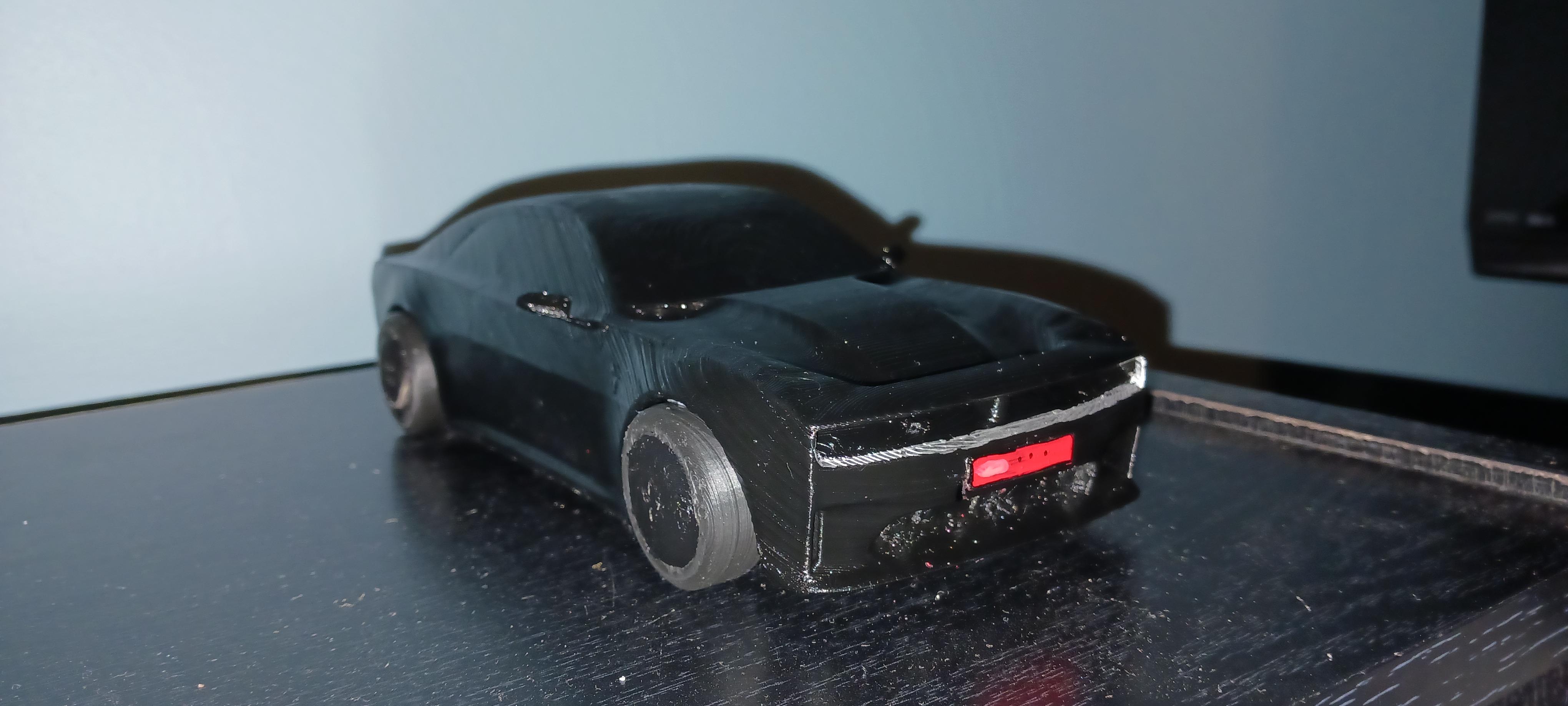

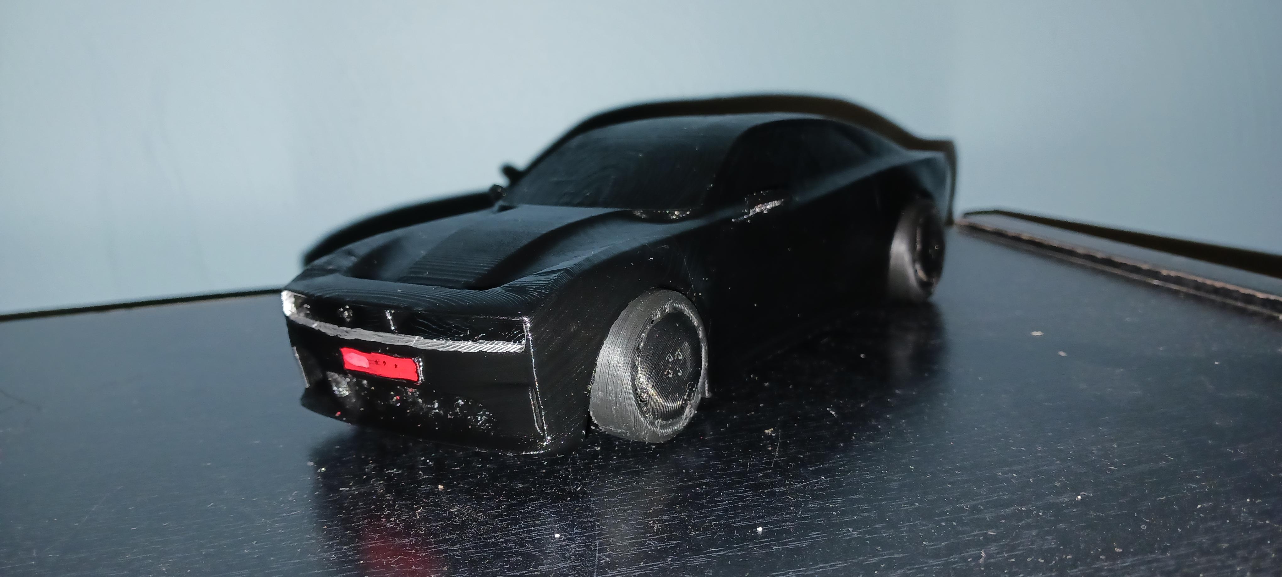

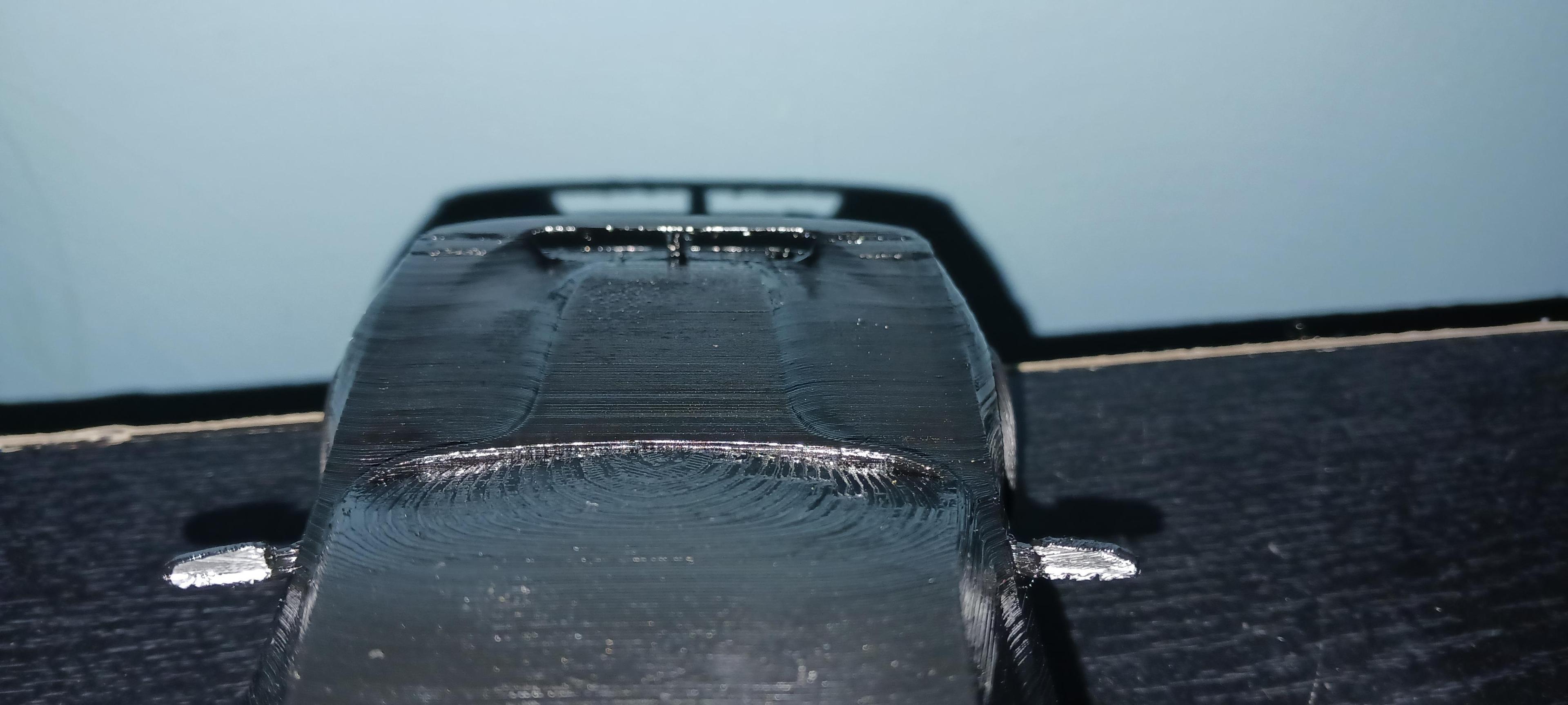

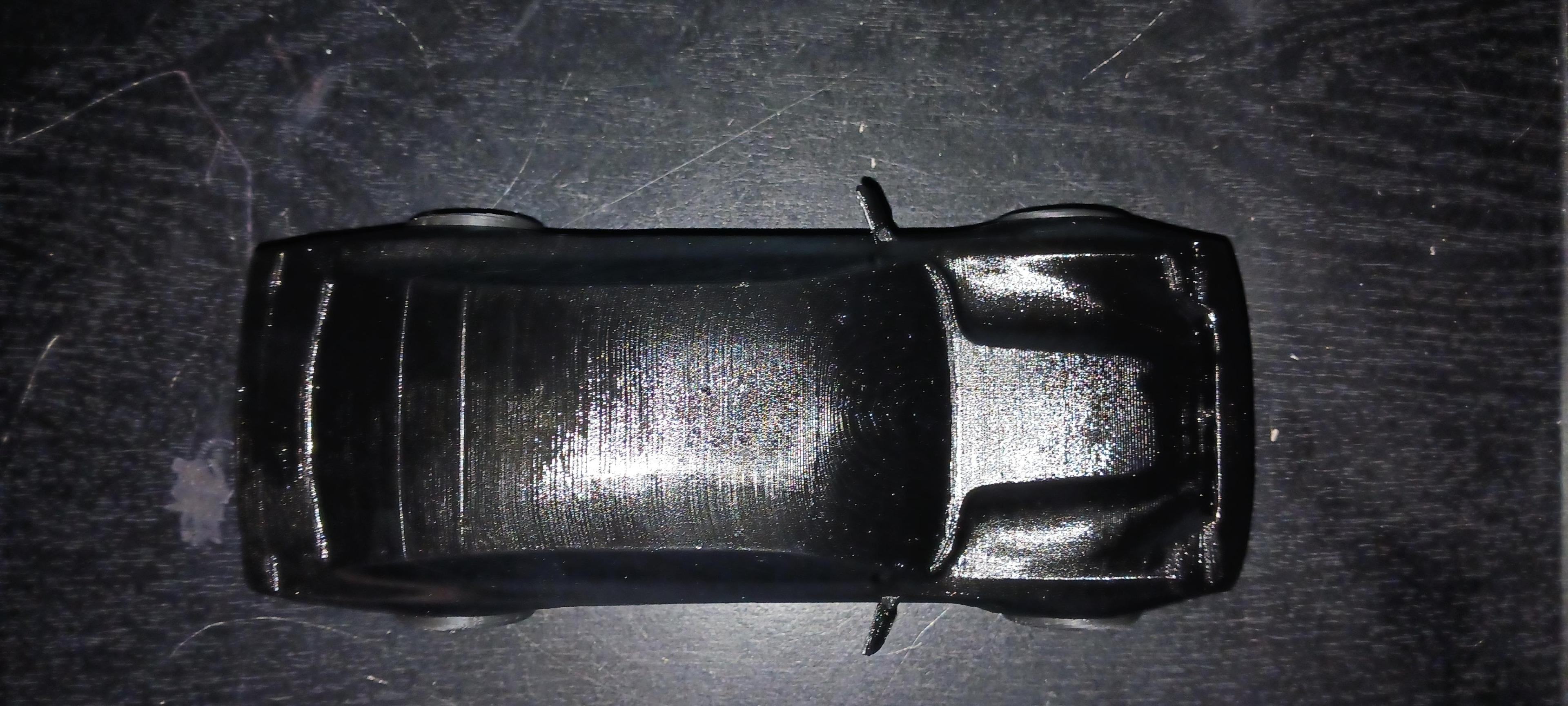

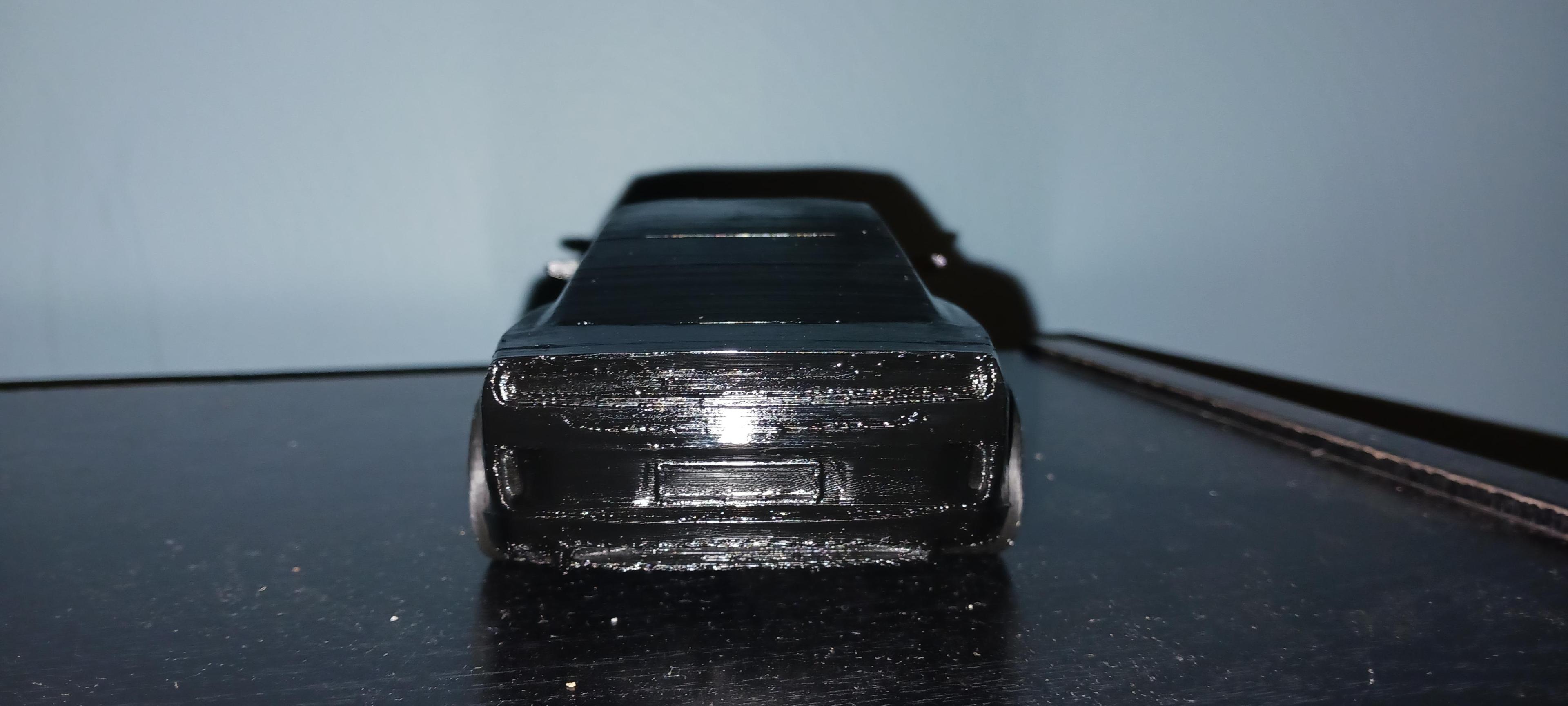

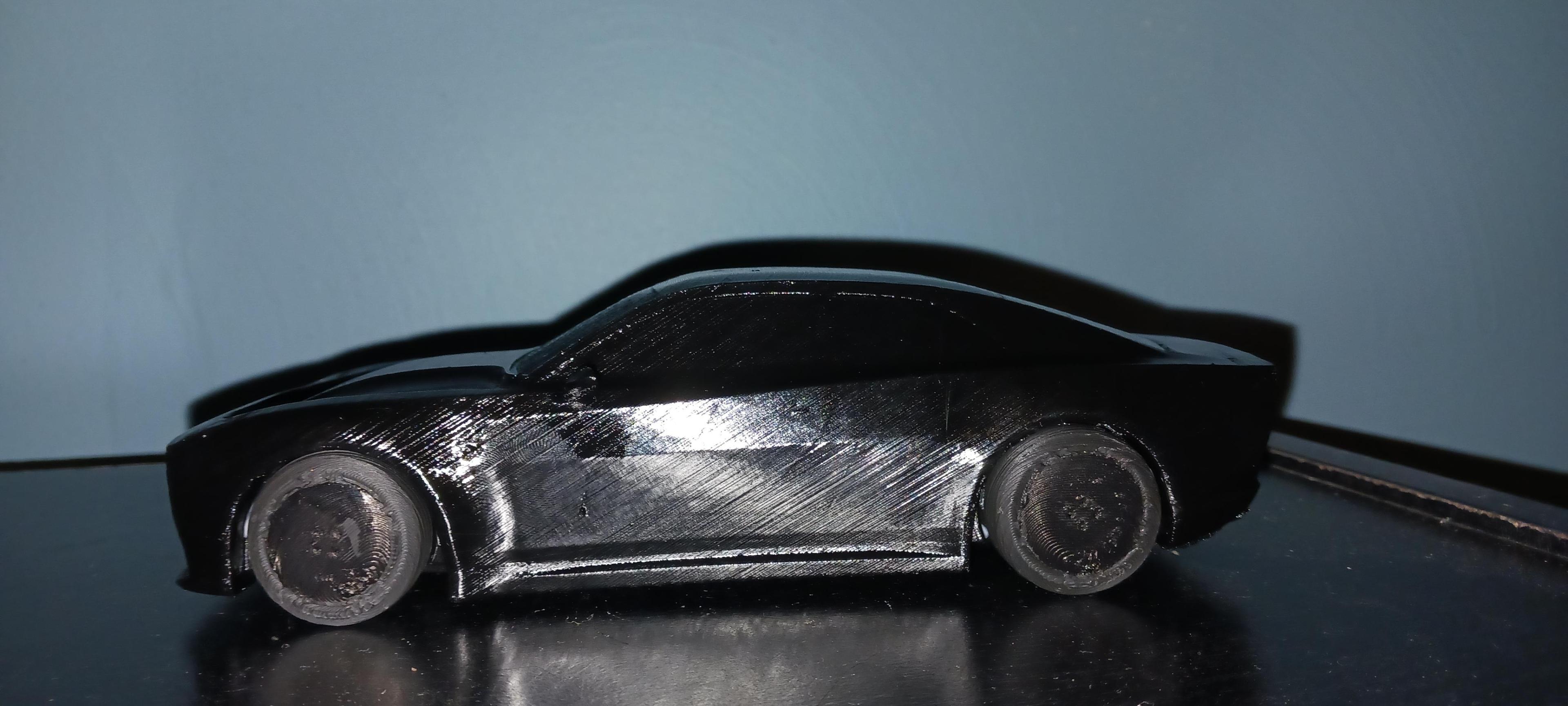

michelle Posted November 28, 2023 Posted November 28, 2023 this is a 3d printed 1/24 scale 2024 dodge charger Daytona srt banshee ev that I made into another modern KITT from Knight Rider I did not use the wheels for this model but a extra set of the 3d printed wheels for the modernized KITT model I painted the body rust-oleum 2x gloss black and hand painted the scanner and rims and tires I used a silver sharpie to do the mirrors and the led head light bar 3

Matt87 Posted November 29, 2023 Posted November 29, 2023 Using the buttons for the hubcaps/rims is a neat idea and resembles the Knight rider wheels perfectly
michelle Posted November 29, 2023 Author Posted November 29, 2023 45 minutes ago, Matt87 said: Using the buttons for the hubcaps/rims is a neat idea and resembles the Knight rider wheels perfectly well each of those wheels are all one piece and 3d printed
Matt87 Posted November 29, 2023 Posted November 29, 2023 Oh okay. I guess i could not tell. 3d printing has really changed things with model building. I have bought after market 3d printed carburetors and the detail is amazing.
michelle Posted November 29, 2023 Author Posted November 29, 2023 (edited) 3 hours ago, Matt87 said: Oh okay. I guess i could not tell. 3d printing has really changed things with model building. I have bought after market 3d printed carburetors and the detail is amazing. Most people who sell 3D printed conversion parts use uv cure liquid resin 3D printers but all the 3D printed models I got recently were printed on filament feed 3D printers so they are a lot more rough and harder to clean and smooth cause of the pla filament is like impact resistant plastic it is harder and thicker then other plastics it has to be heated up close to the melting point to even start to make it easy to clean of all the supports and little hairs and stubble that can be all over the parts with snippers and then use dremal burnishing tools to finish cleaning as best as can and normal sanding is out of the question you have to use either a small electric belt sander or dremal with sanding drum to smooth out the rest without looking any surface and then there are the cracks and gaps that may or may not be present between the retraction lines of the print layers which will need to be filled in with putty Edited November 29, 2023 by michelle
Matt87 Posted November 29, 2023 Posted November 29, 2023 Much more prep work. Sort of like resin parts but more so.
Matt87 Posted November 29, 2023 Posted November 29, 2023 I know with resin body ive dealt with before and resin aftermarket parts i was able to sand them down with regular paper
michelle Posted November 29, 2023 Author Posted November 29, 2023 (edited) 3 hours ago, Matt87 said: I know with resin body ive dealt with before and resin aftermarket parts i was able to sand them down with regular paper Yeah that is cause the resin is smoother finish that does not have as pronounced retraction lines on the layers and the resin does not bead up and does not loose a lot of detail which happens with the filament printers and the way the two types of printers prints are different also the resin ones lowere the metal print plate into the vat of resin that sits above the print screen while the filament ones use a horizontal sliding print head above a heated print plate and as each layer is made the horizontal arm the print head slide back and forth on raises higher on the gantry Edited November 29, 2023 by michelle
michelle Posted November 29, 2023 Author Posted November 29, 2023 (edited) 3 hours ago, Matt87 said: Much more prep work. Sort of like resin parts but more so. this model was a part of 3 orders I made months ago in April and may and June and it took my friend this long to print 4 large Star Trek ship kits and 3 1/1 scale Star Trek prop replica kits and 14 1/24 scale car models and he forgot to print 4 of the cars and forgot to print a section of one of the 4 large Star Trek ships from my order and forgot to make and print the decals for the cars and the Star Trek ships the reason it took him so long was all 2 of his filament printers kept breaking down in various ways as he printed models of my order and it took him 2 months to get just one fully fixed and took 3 months to get the other 2 as they kept breaking down and he had to keep ordering parts for them Edited November 29, 2023 by michelle
