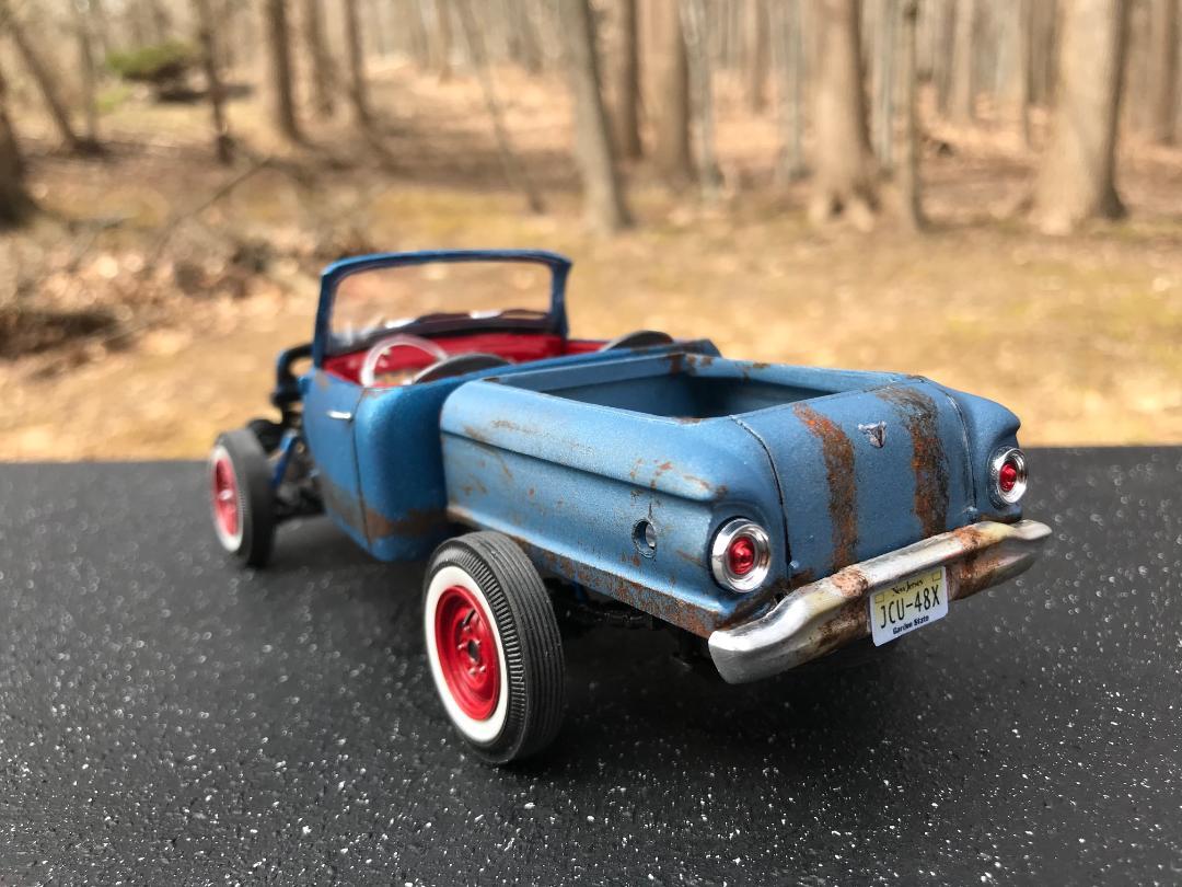

If you have a couple Rancheros, dig right in!   They're only plastic.
Same issue you have...
Sacrificed a Ranchero body to the model gods...
End result was worth it.  I saved an old original survivor!
And nothing ever goes to waste!
  • Like 1

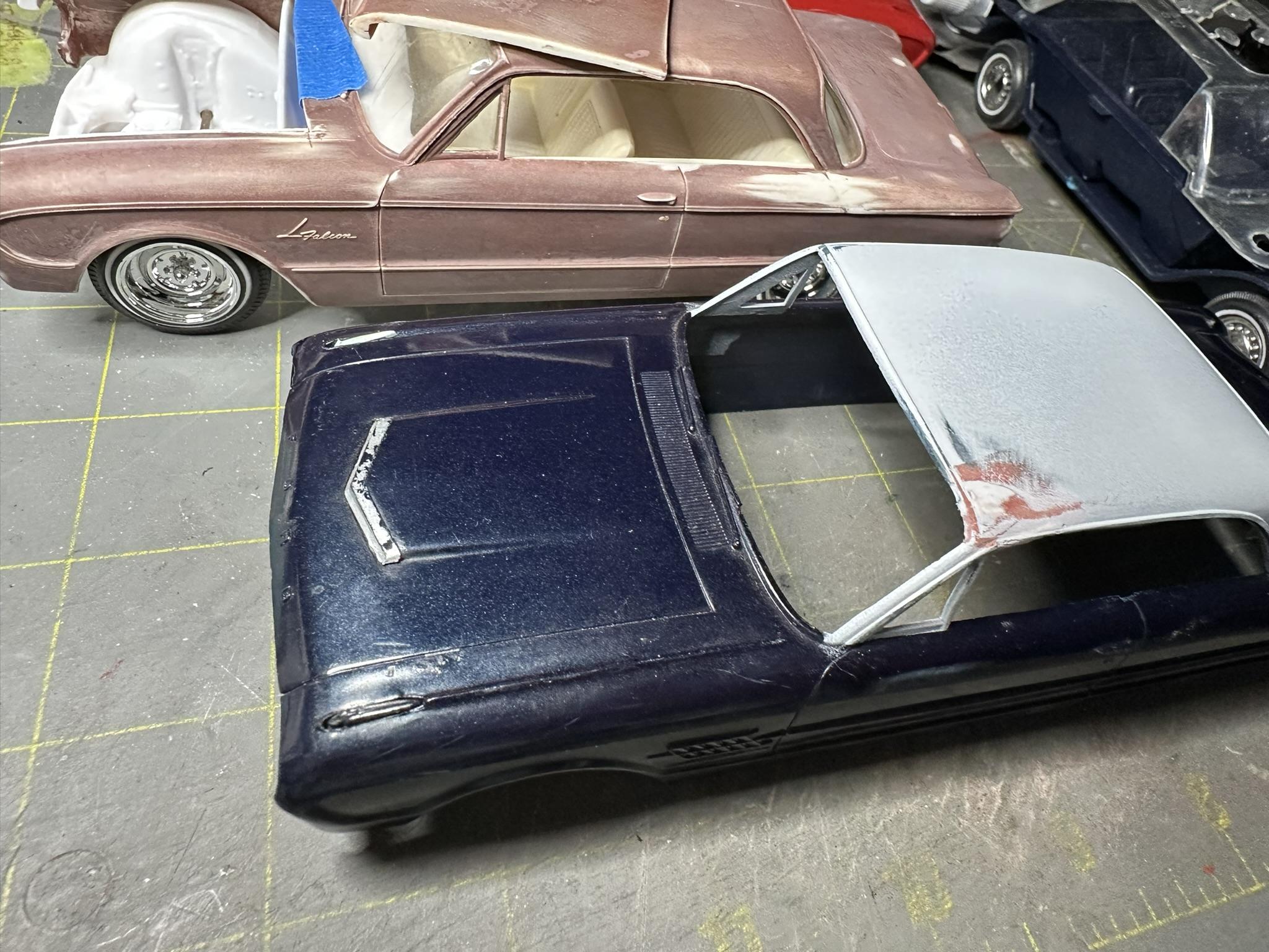

Anyhow, here is my repair so far. I used thin sheets of styrene and built it up to a little over the thickness I needed. Sanded and filed on it for a bit to shape it. I'm not totally mad at it. Needs some finesse which I'm not sure I'm capable of. I shot some primer to see where I was working better. Comments and suggestions welcome.
Nicely done, Tom! In retrospect, this might have been cleaner, at least for me. I love the use of the bed to build that rat rod. The great thing about plastic is that...it's plastic!

Let the glue and primer dry for a solid day, then take another look at it. To get a contour right, try gluing a guide block over it (using tacky glue or double stick tape) over the area and working it with a file or sanding stick. Remove the guide later.
Looks really good. Trust me: if you have the skill to get it that far, you can certainly get it the rest of the way.  :D
Can you explain this a little further for my weak brain? It sounds like you might be suggesting a contour template?
You could put a protective cover over the glass and insert it to give you some backing when sanding. If really brave cut the corner piece of the glass that is in that area and glue it in place. Looks good so far. Wish I knew of your dilemma years ago as I built a sprint car using the rear end of a Falcon, I had a full roof.

I actually clamped the glass in place to help maintain the contour. I found it difficult to keep the post aligned and the roof square without it. Since its full of stress cracks I won't be using it except for potentially a junkyard diorama.
Exactly. Something with a radius that you can follow.
