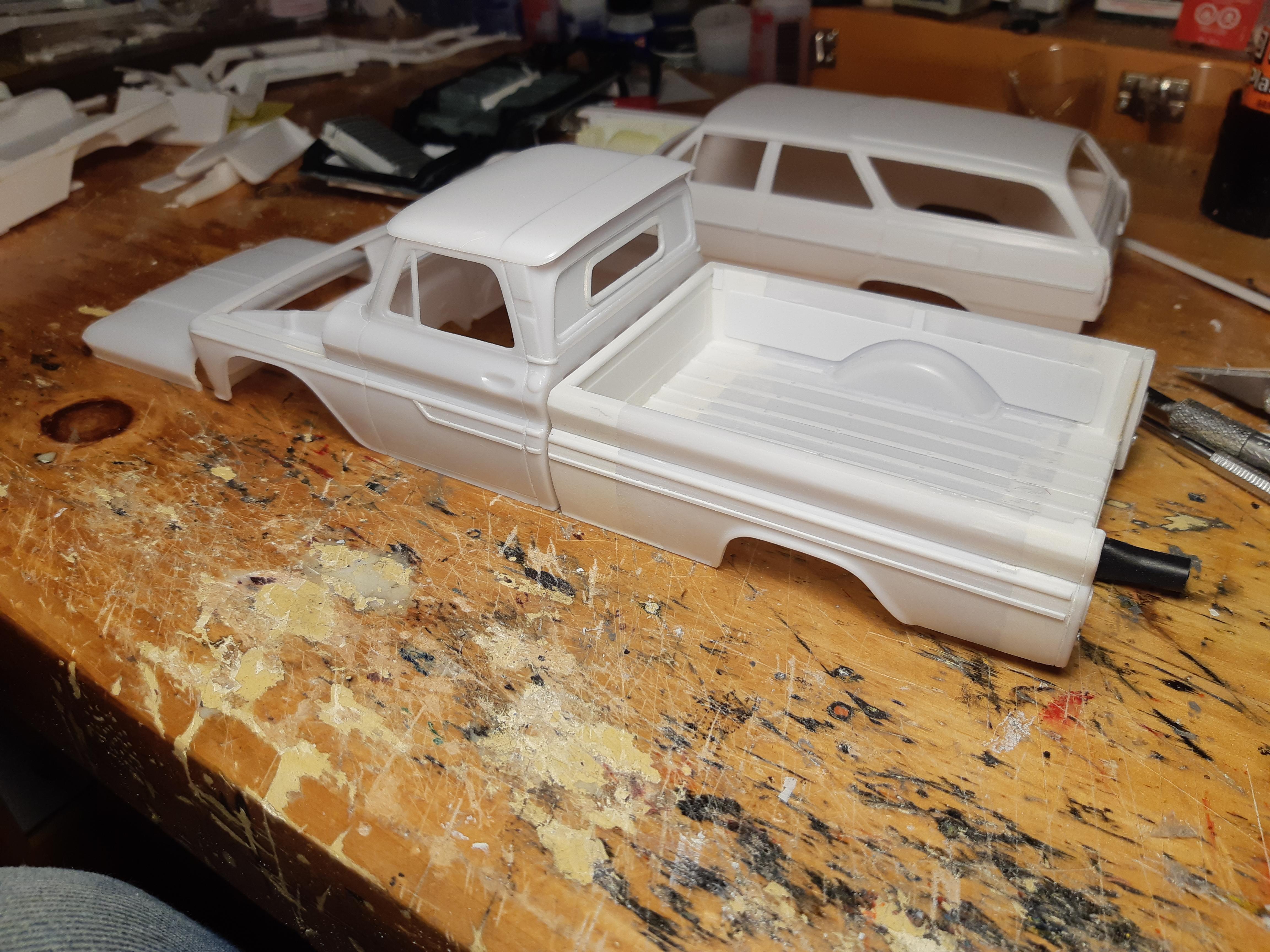

TheBEAUMONTGURU Posted December 30, 2023 Author Posted December 30, 2023 here is the hard part. taking 2 SHORTIES and making an 8 footer...............seamlessly. what a pain! the revell taillights suck so i used the back facias from the AMT 60. It will have a stock appearing wood box floor that will all be painted body color like they did at the factory. My real truck still had the green paint on the wood and the strips, so i dont have to get too fussy with wood graining and painting details. 1

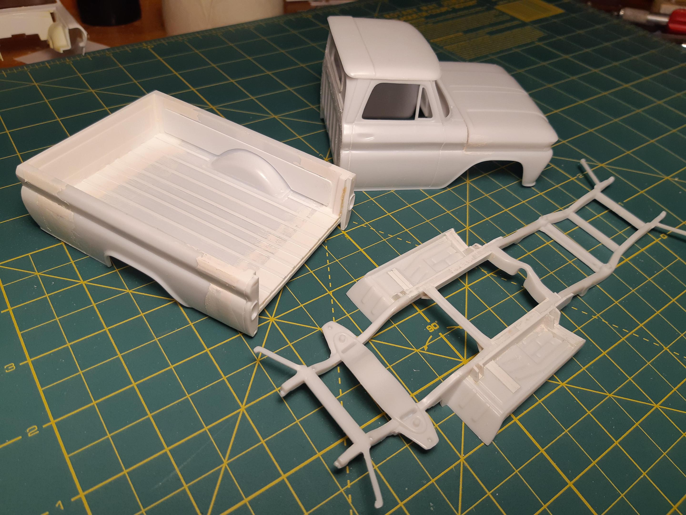

TheBEAUMONTGURU Posted December 30, 2023 Author Posted December 30, 2023 I lengthend the chassis under the cab beween the body mounts(this is the correct place that was different between a LONG and a SHORT. will have to add a slight amount to the rear bumper area, but that wont be too hard or noticeable. Main concern was getting the wheel base to match the frame and the box. 1

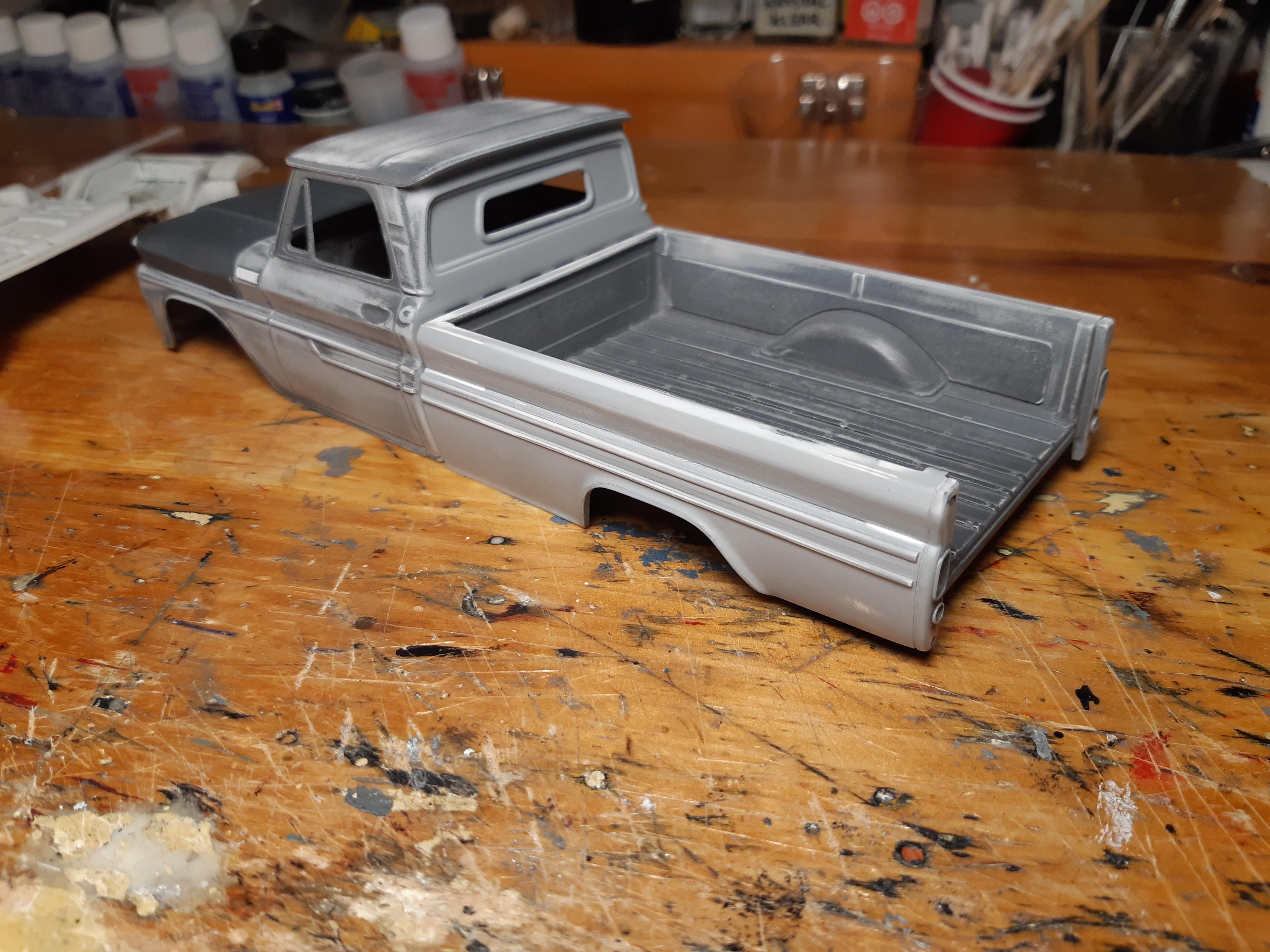

TheBEAUMONTGURU Posted December 30, 2023 Author Posted December 30, 2023 this pic was another day of work yesterday. Making all the side moldings from evergreen. I converted the cab to a small back window using sheet styrene and 1/2 round rod. and made the rear pillar mouldings About 2 hours just in re-scribing panel lines and body lines. Almost ready for a heavy coat of primer-then it can sit and shrink for a couple months. I also made box floor strips and drilled what seemed like 2 million small depressions to replicate carriage bolts(its all getting painted green so no need for super details 5

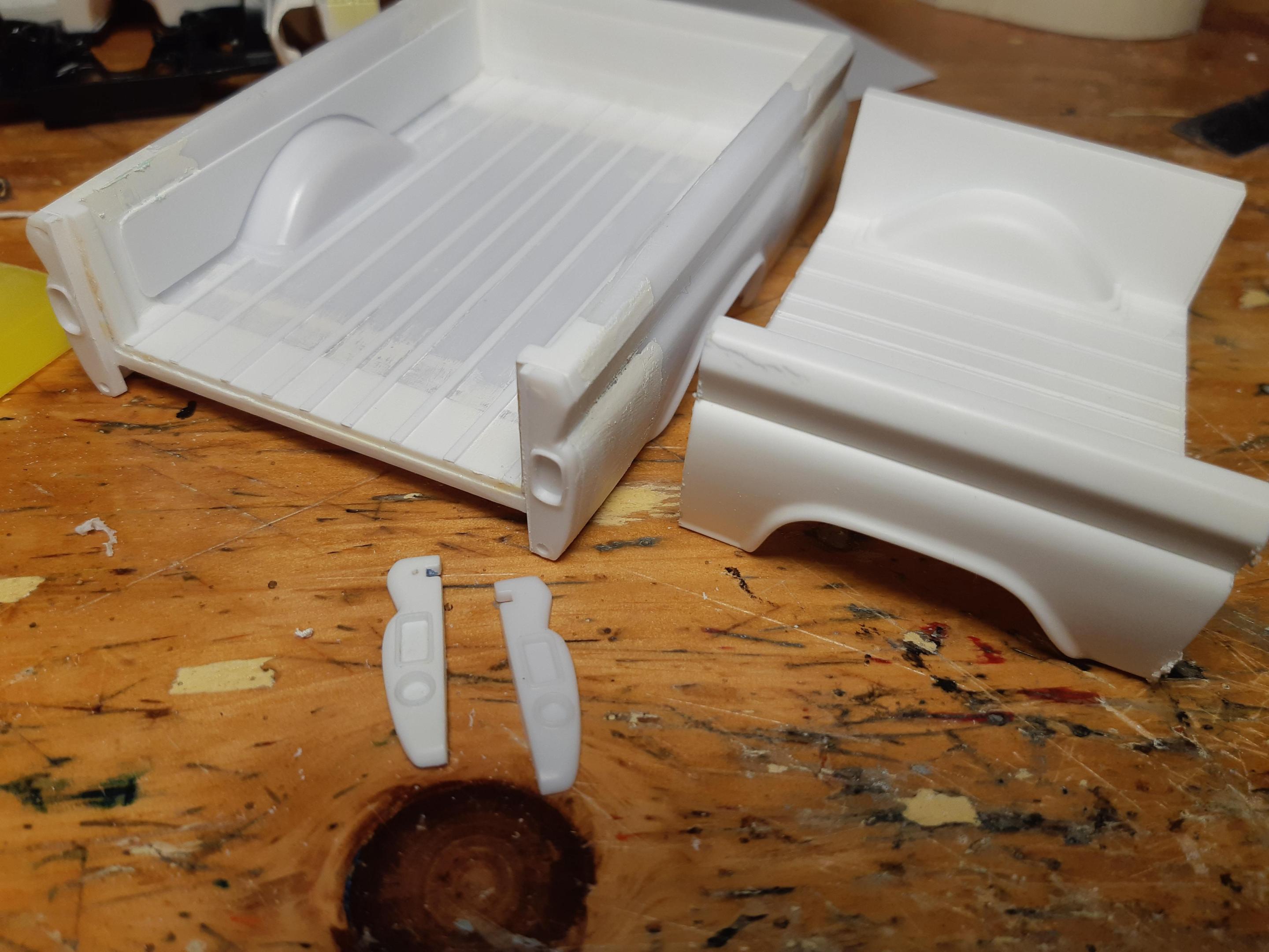

gautreau Posted January 3, 2024 Posted January 3, 2024 On 12/30/2023 at 2:24 PM, TheBEAUMONTGURU said: here is the hard part. taking 2 SHORTIES and making an 8 footer...............seamlessly. what a pain! the revell taillights suck so i used the back facias from the AMT 60. It will have a stock appearing wood box floor that will all be painted body color like they did at the factory. My real truck still had the green paint on the wood and the strips, so i dont have to get too fussy with wood graining and painting details. Do you happen to have measurements at all where you cut the 2 beds at all?
TheBEAUMONTGURU Posted January 3, 2024 Author Posted January 3, 2024 I cant really remember what my measurements were. i was using a 1/24th scale ruler! it was about 12/32nds of an inch in the back and about 3/4 inch in the front. I used this picture one of the other forum members posted showing a original SMP longbox, so i just made sure that my cutting would yeild these results. Sorry i cant remember who provided this pic, but thanks to whoever it was!!
dodgefever Posted January 3, 2024 Posted January 3, 2024 The long beds had a 127" WB; short beds 115", so you have to add a scale 12" in front of the wheels i.e. 0.48". Then 0.24" behind the wheels to make it up to a 96" bed. Also, note that the long bed was shared by the C20, so had slightly larger wheel openings than the short fleetside, which was only available as a C10.

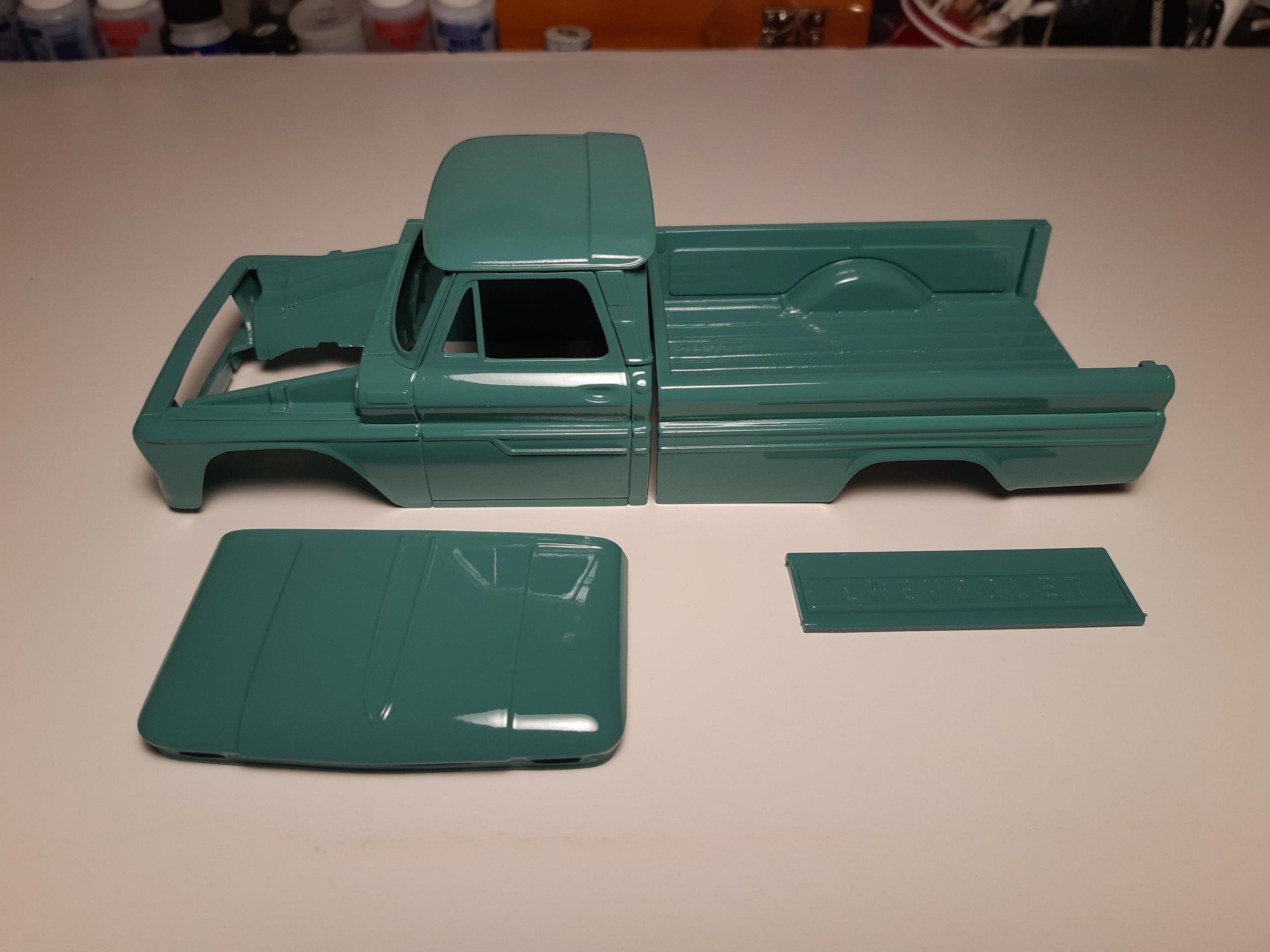

TheBEAUMONTGURU Posted January 20, 2024 Author Posted January 20, 2024 got the bodywork done and primered(a couple of times). lots of block sanding. Pretty sure it would have been easier to block out a real truck! Getting all the spliced panels to look invisible is a daunting task! 1

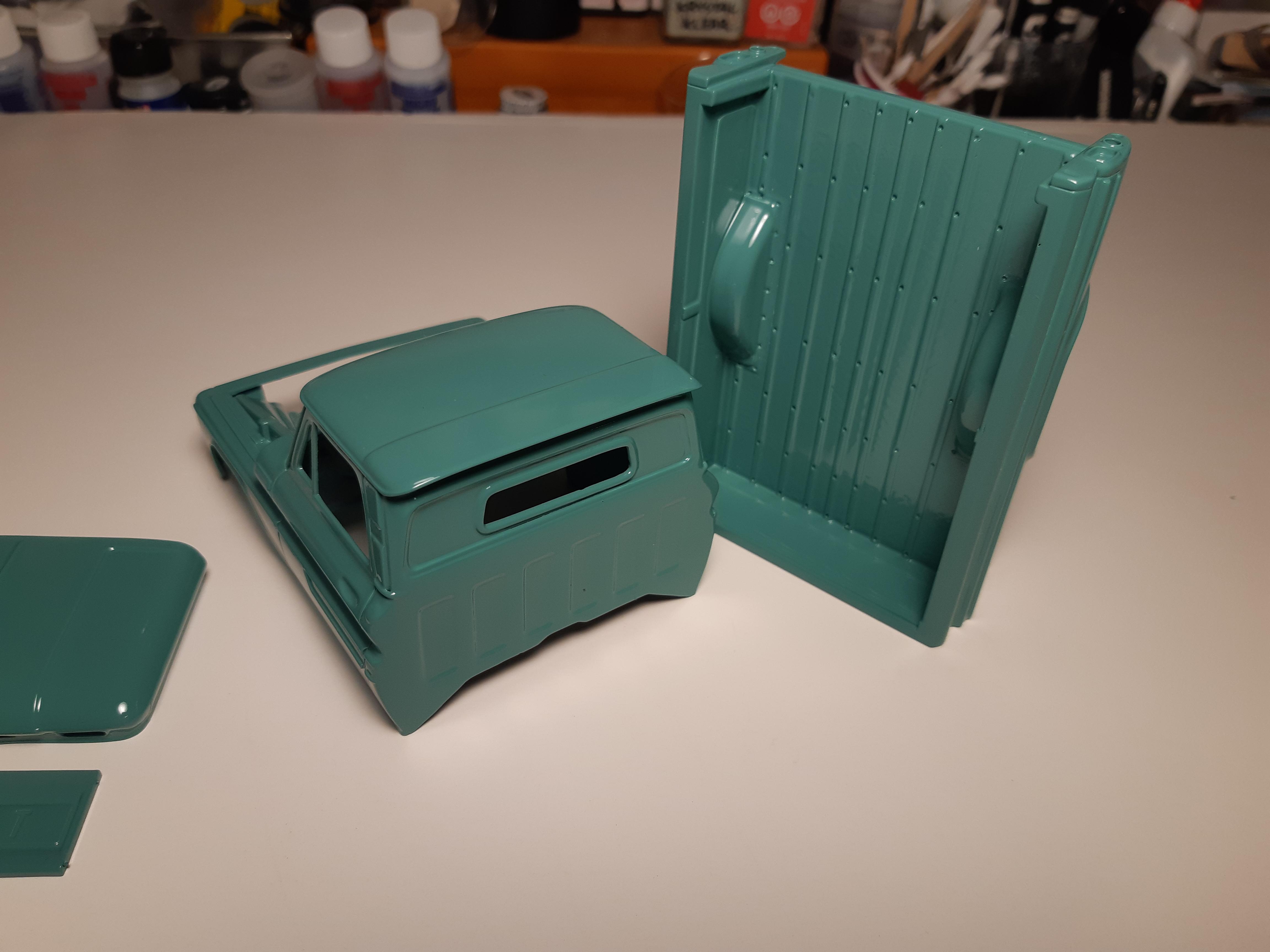

TheBEAUMONTGURU Posted January 20, 2024 Author Posted January 20, 2024 Shot some paint on it yesterday. I used 20 year old Dupont Centari from my real truck. GM paint code 503 Light Green. I really like spraying centari. its not available anymore, but i shot lots of real cars with it and got very good results. Im very happy with how it went on the model. Im going to maybe cut down a few dust spots, but otherwise its super flat. Ive never used an airbrush. this is a cheap automotive touch up gun with a 0.8mm tip. its all i've ever used. 6
