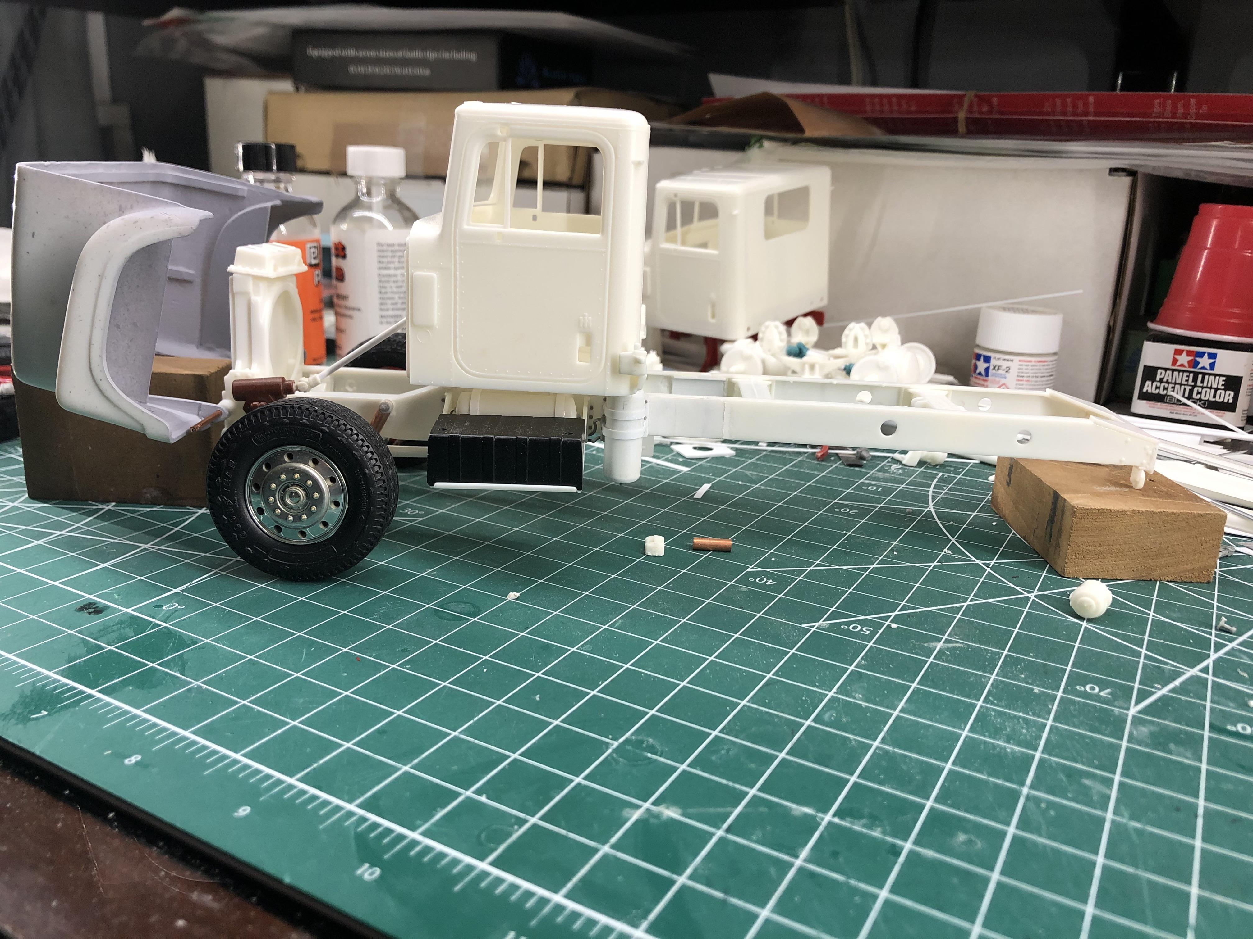

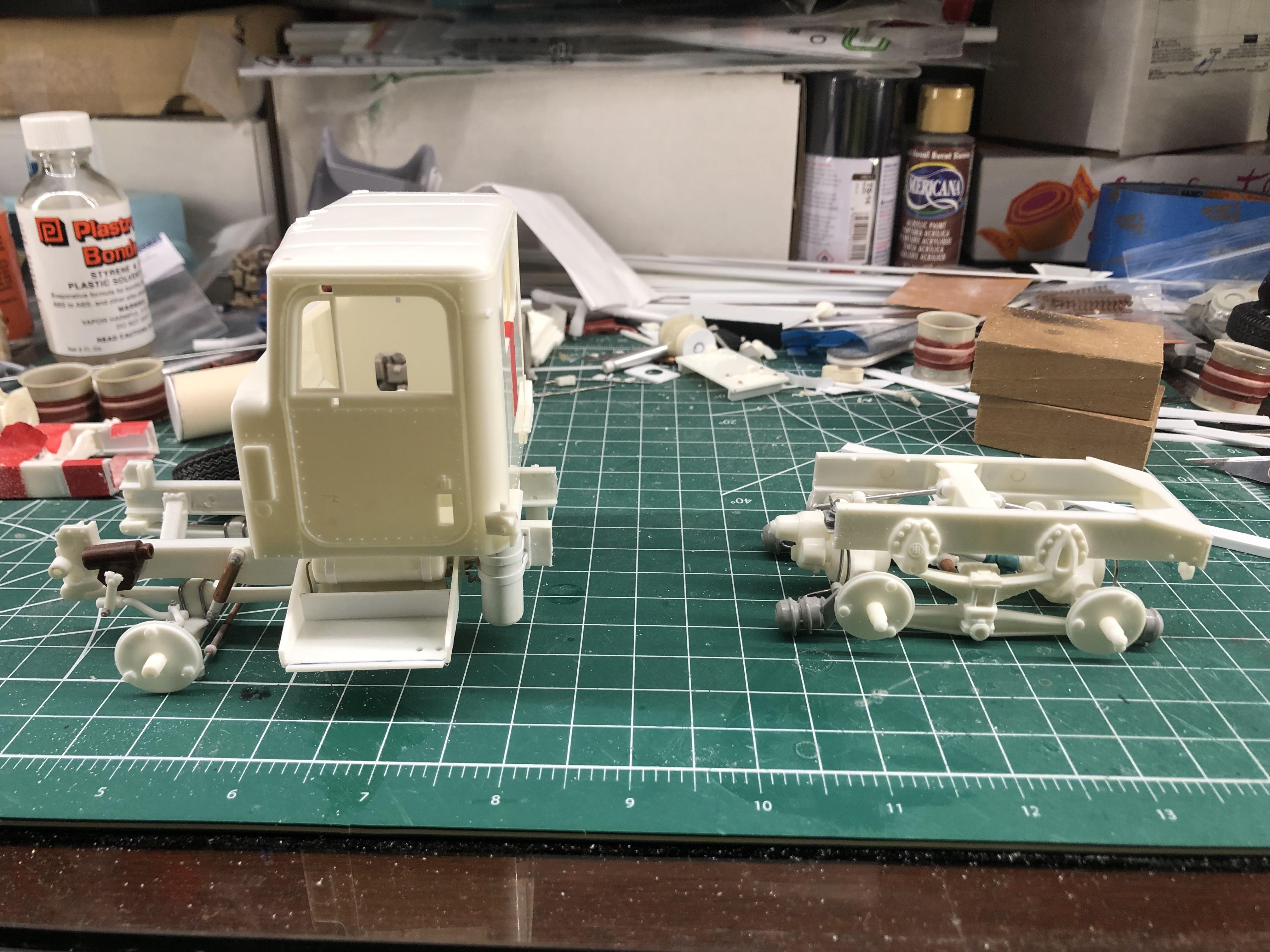

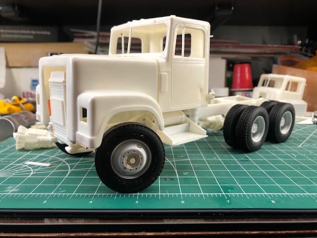

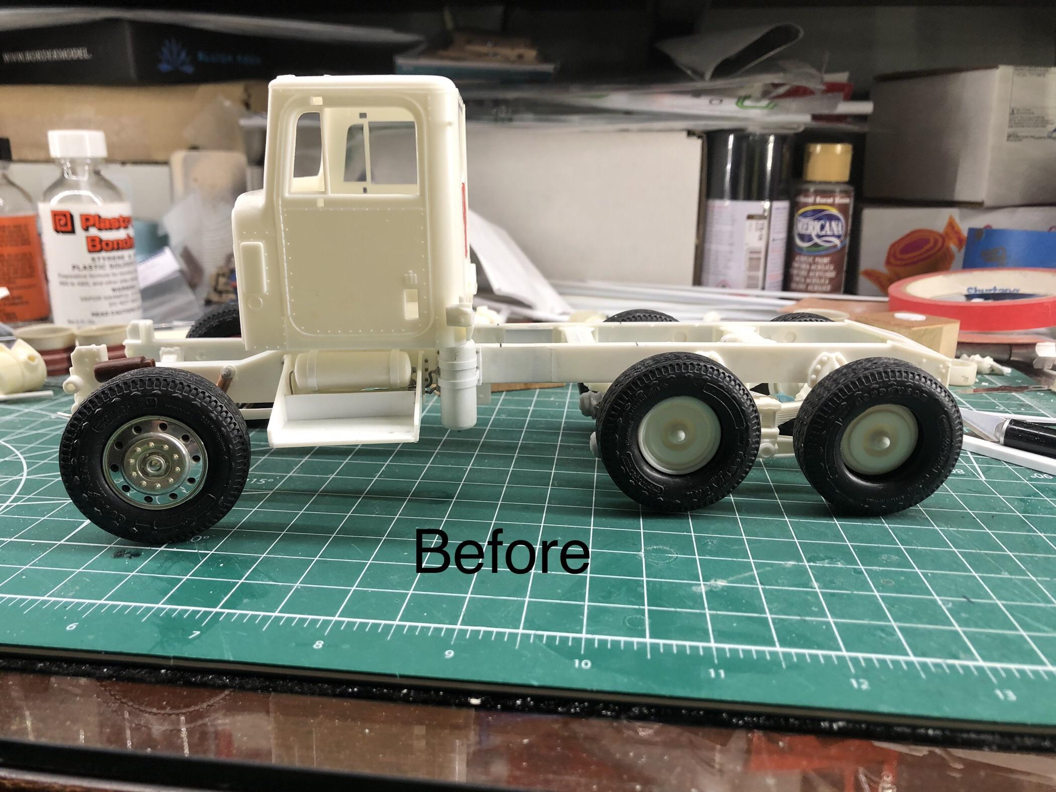

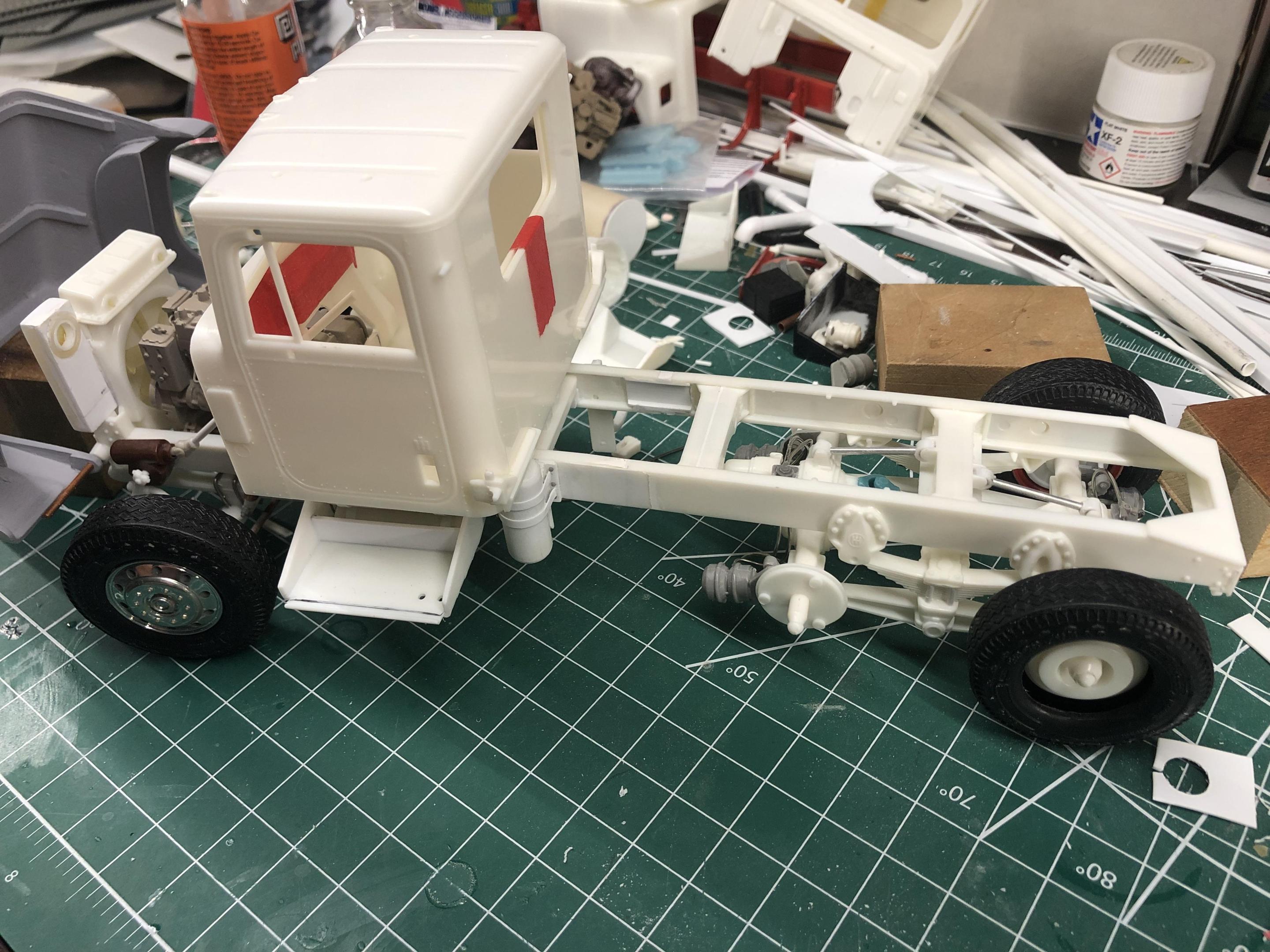

I recently bought a cheap 4300 kit at the local flea market it was a complete kit , the frame had been started but was broken and badly bent  I fixed the frame by making it shorter , the 4300 hood and cab on the shorter frame just didn't look right , so I decided to cut the hood down to make it a 4200. I got the engine built ,painted and plumed .
I know the front axle is too wide ,so I used the axle from the C0-4070A as a reference to cut the axle down ,also replaced the kits plastic tie rod with brass tubing .
Added some detail to the air tanks and battery box , I'm going to use 2 hole Bud wheels and tires from Sense Unlimited.
Thanks for looking .

Gary: actually the hood lines up fine off the frame , with the frame twisted Ill have to shim the cab to make it fit correctly.

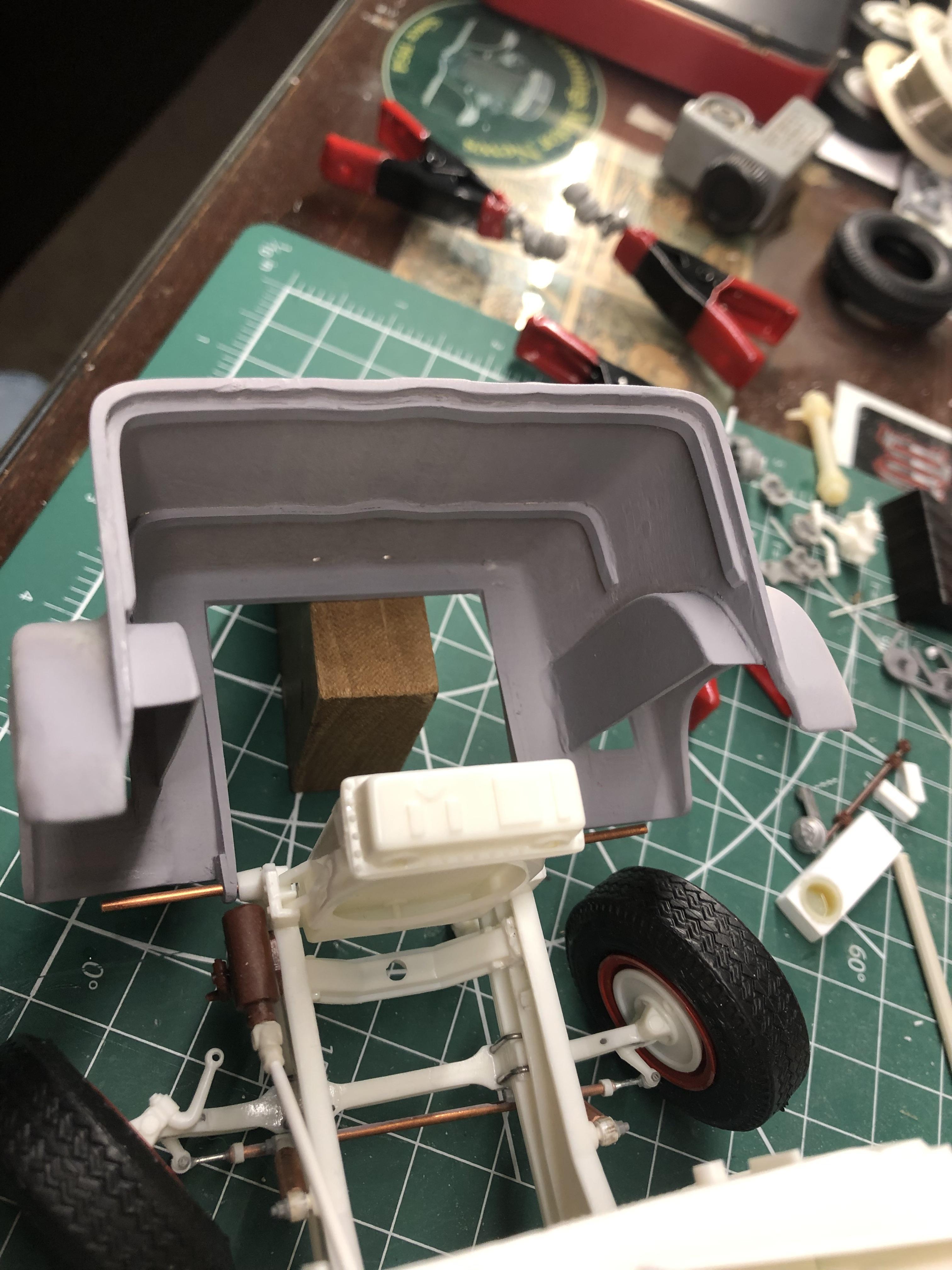

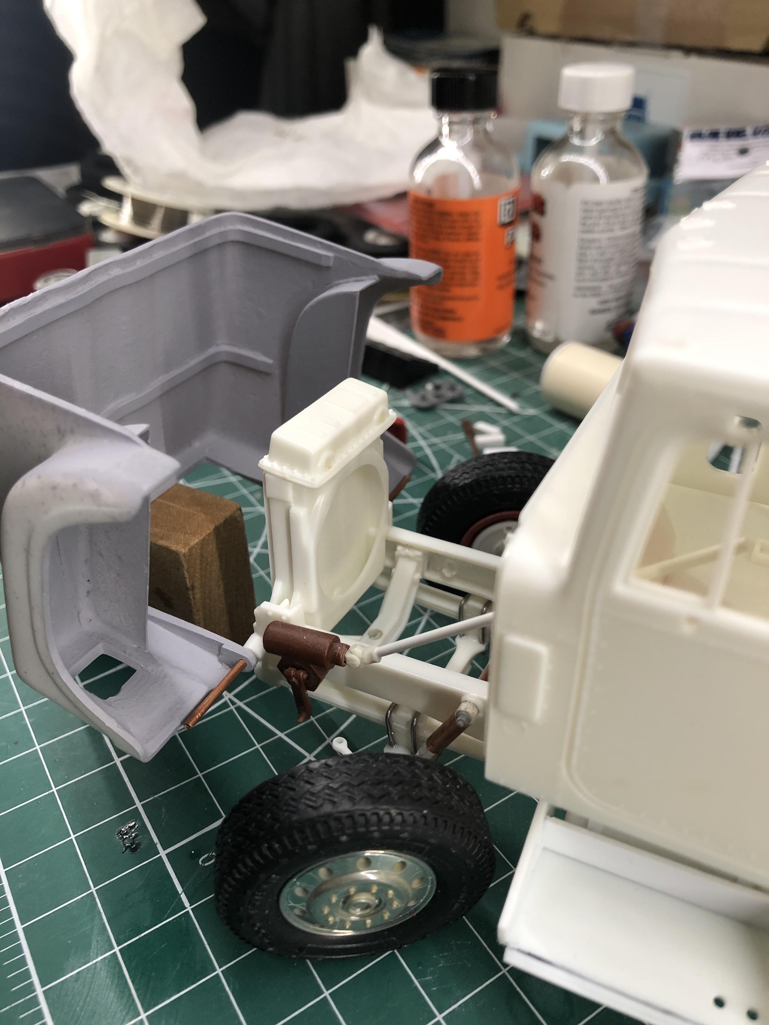

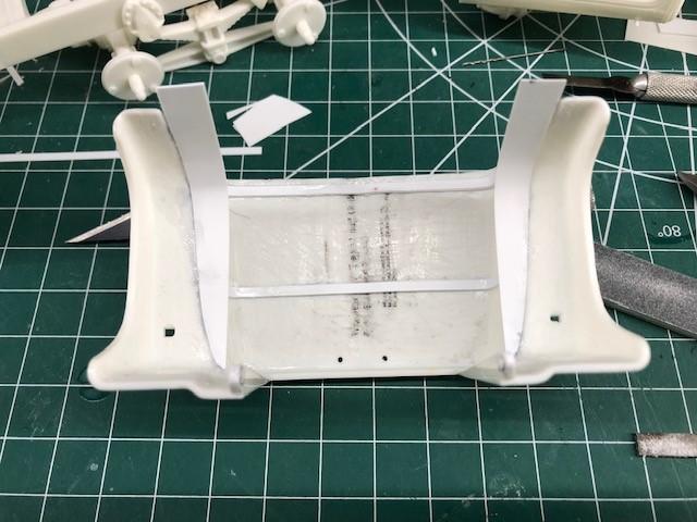

Started some under hood detail, I added 2 stiffening ribs and trying to make some generic inner fender wells . Also reworked the hood hinges I added some styrene to the original hood hinge so I could drill holes to use brass rod, the hinge mounts on the frame were drill all the way through.
Thanks for for looking .

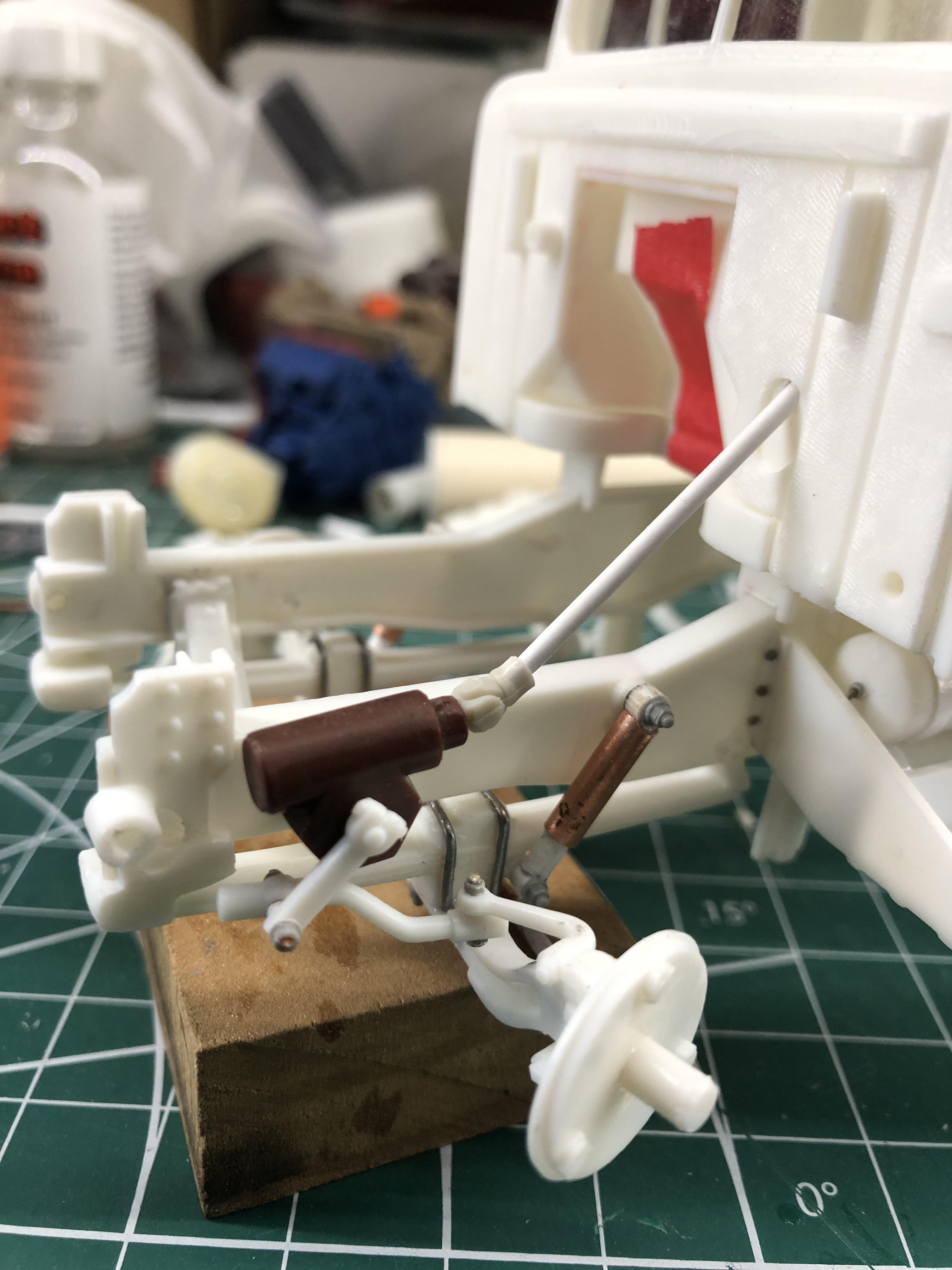

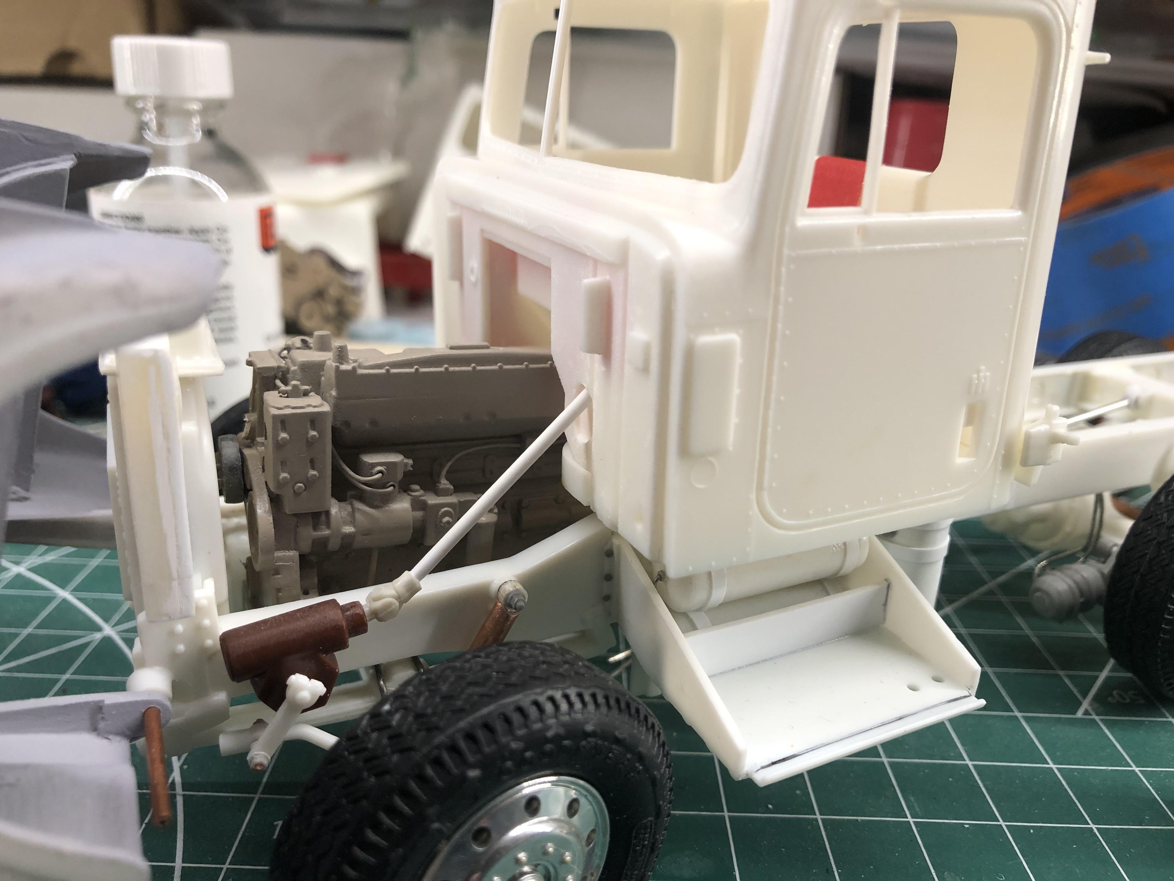

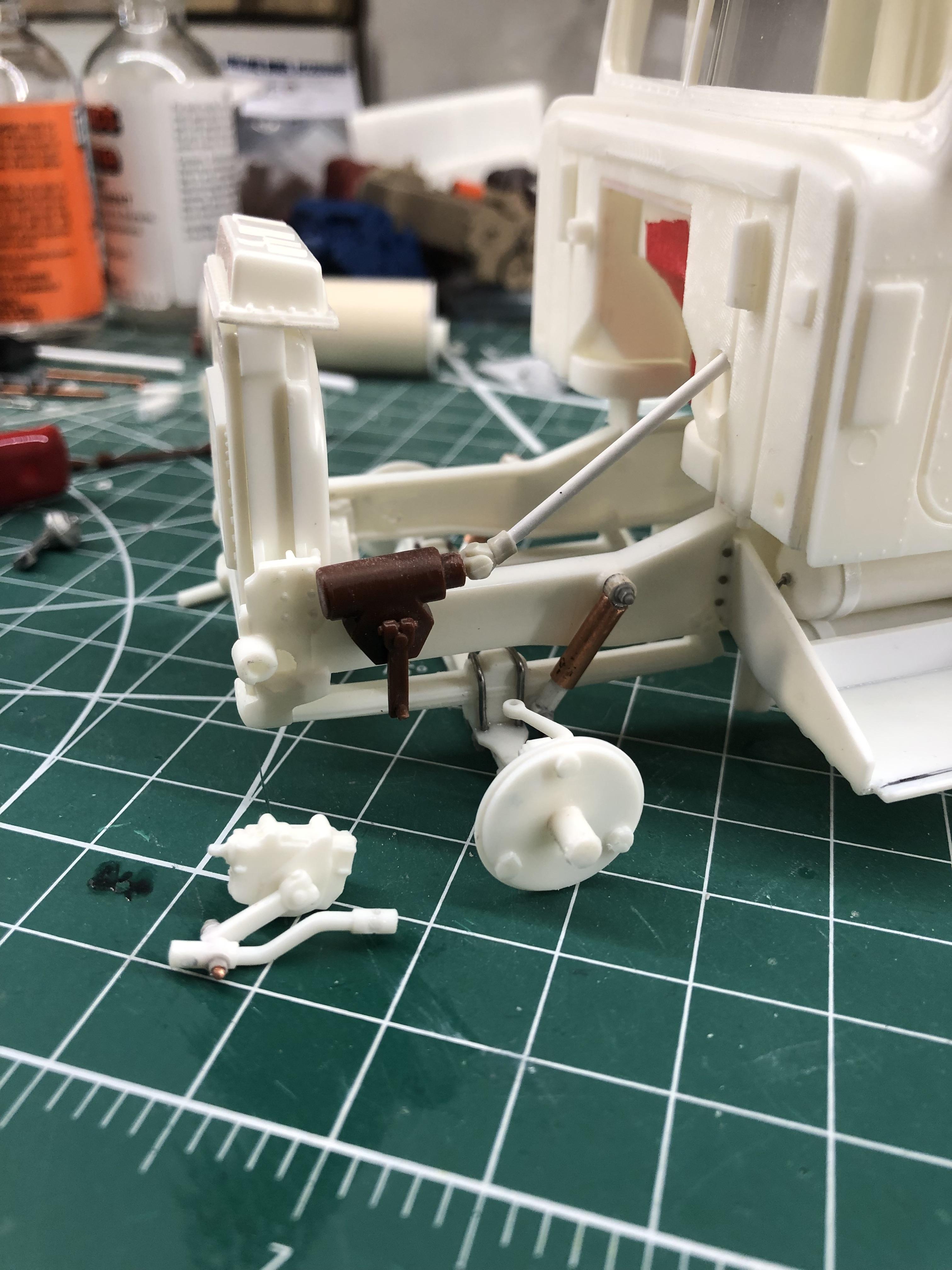

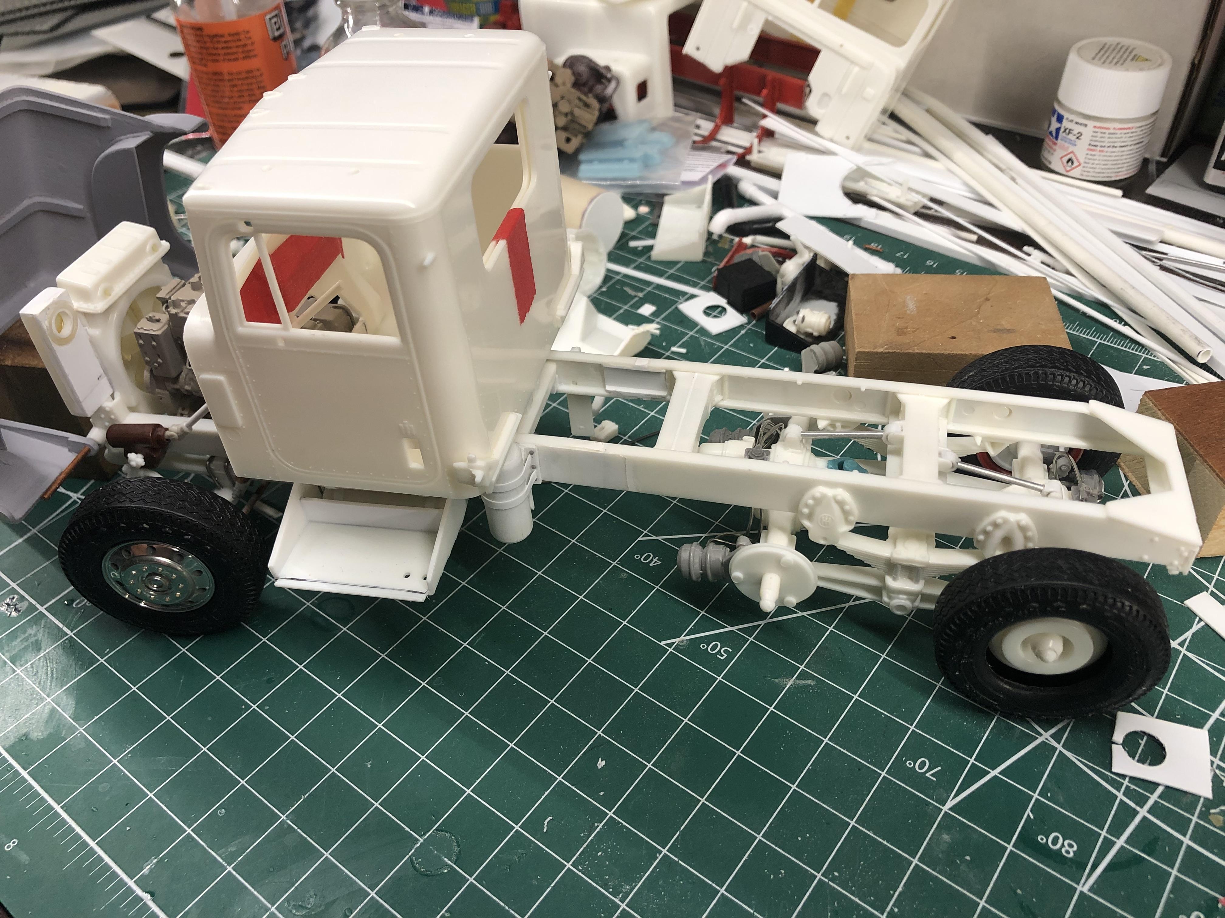

I got front axle mounted added U bolts & nuts , made new shocks , and mocked up the steering box and shaft , all the pictures I’ve seen online has this type of steering box not like the one in the kit, I have an old S- series in the parts bin I took steering box off that just to see if it would fit , I think it will work . The U joint is from a Moebius Ford pickup kit .
The under side of the hood is finished it didn’t turn out too bad.
The last picture reminds me of seeing Glider trucks setting in the lots when Intentional Harvester was still in Ft. Wayne .

Quick update I got the steering all connected it fell right into place with no modifications.
  • Like 6

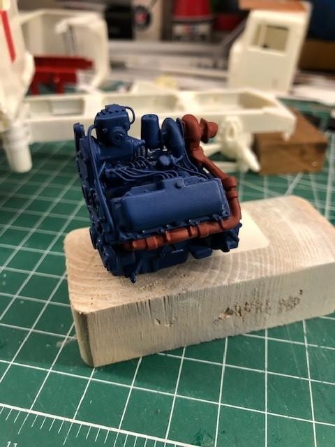

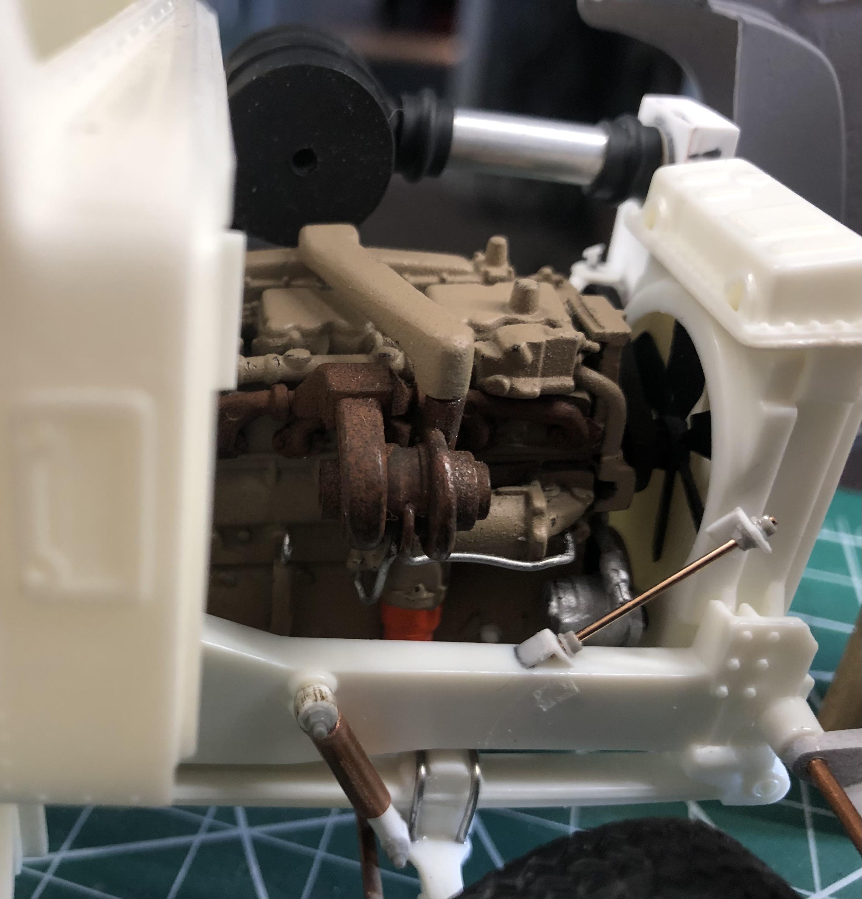

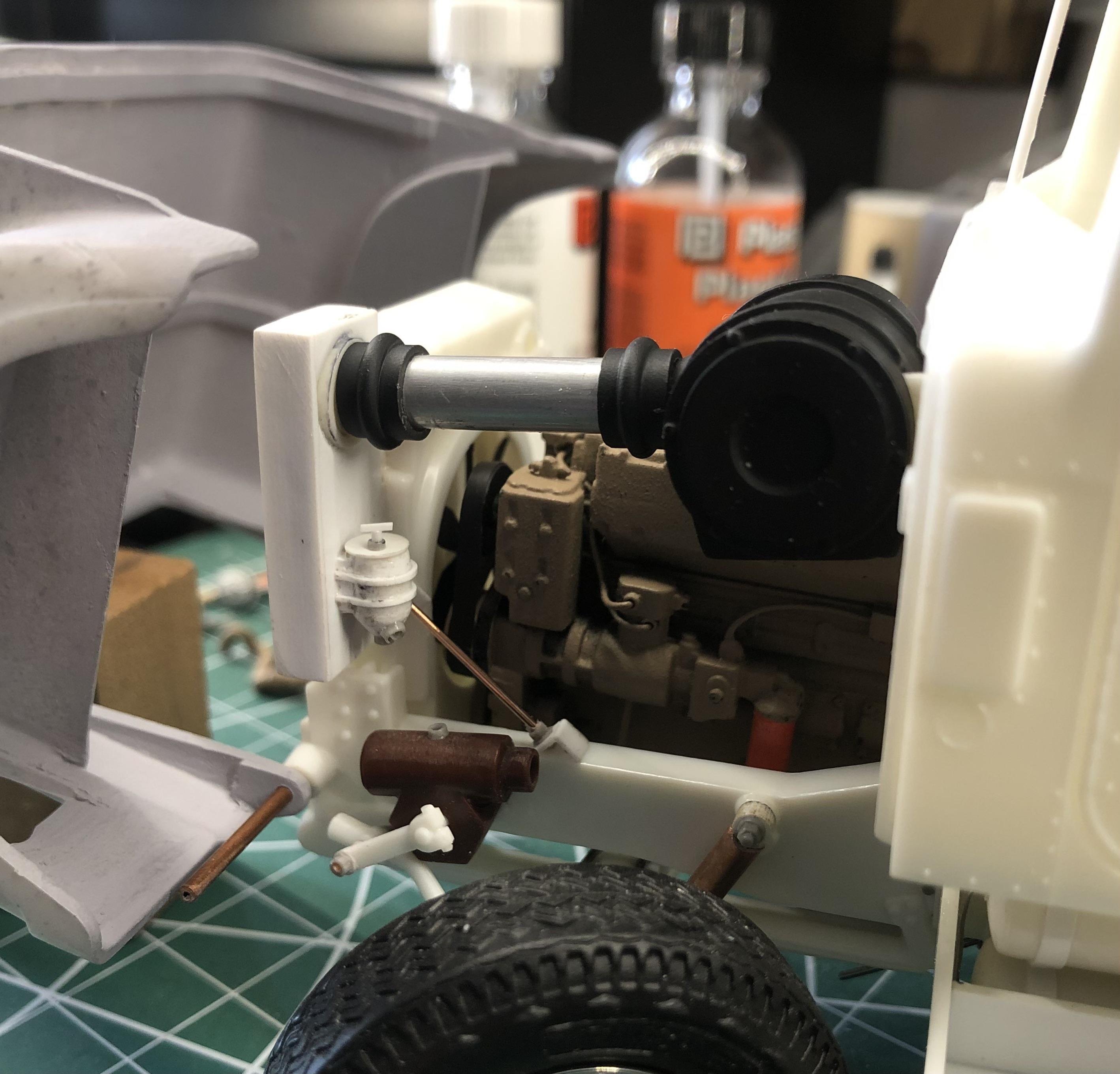

I decided to swap out the IH Engine for Cummins it’s a tight fit but with some modifying of the fire wall it fits in well . Also got the rear suspension mounted and some air lines plumed in .

Nice detail on the engine,PT pump,air compressor and A/C compressor bracket look good! ....where did you get the brake chambers,,they look a lot better than the Auslowe ones I use

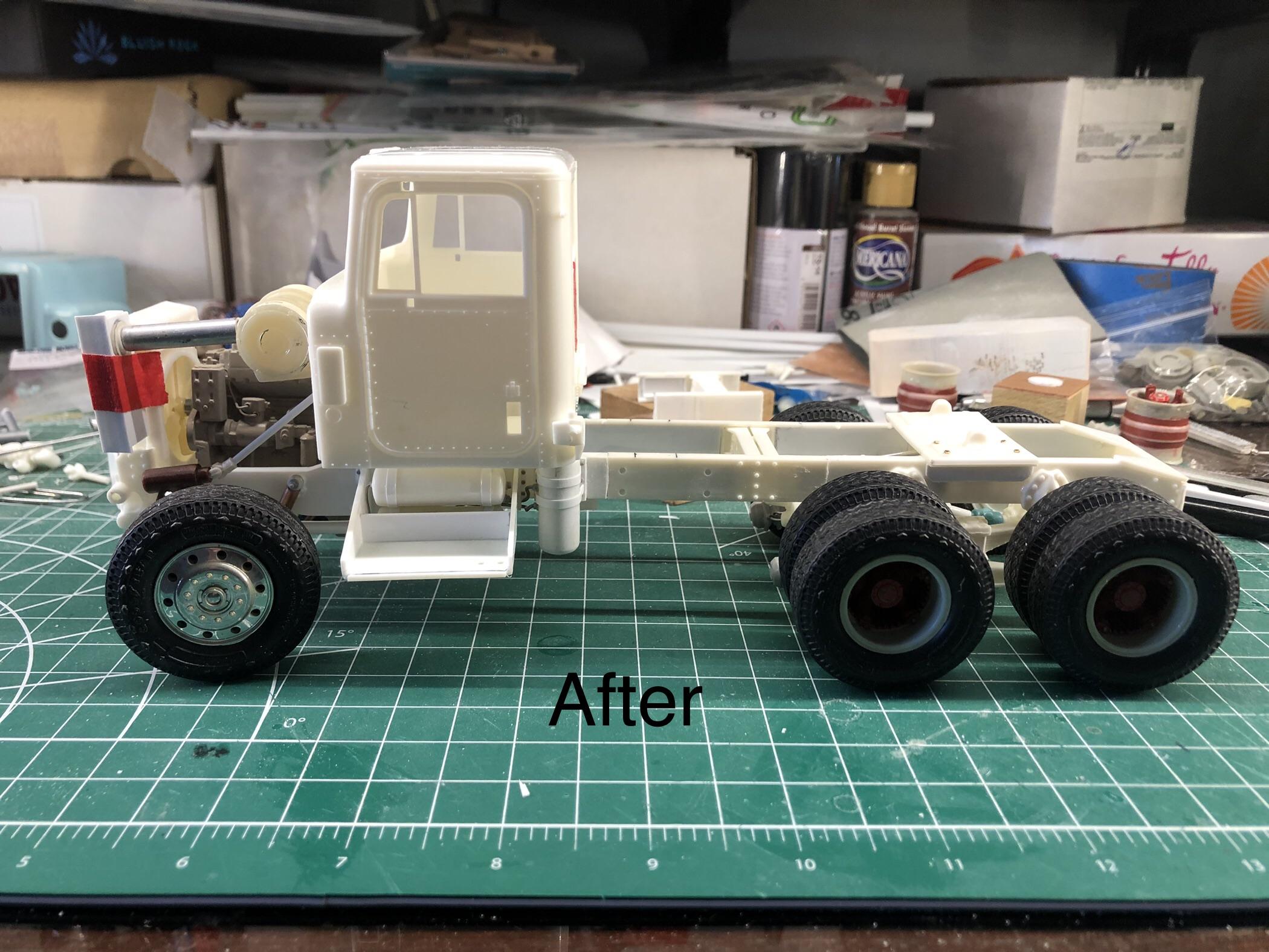

It’s been a while sense I’ve been able to work the Transtar , I decided that frame was a little too short and I didn’t like the look of the cobbled mess of the old spliced area , so carefully cut the frame and added about 3/4 of an inch of frame , also reworked the fire wall area around the motor to make room for the Cummins , and reworked the air intake and filter box .
Steve : thanks for the comment the brake Chambers are from a Revell Peterbilt 359 .

It’s been a while since I’ve been able to get some bench time . Did some little things added radiator supports , made oil reservoir , and finished the air intake pipe , rubber connectors to the air filter box .

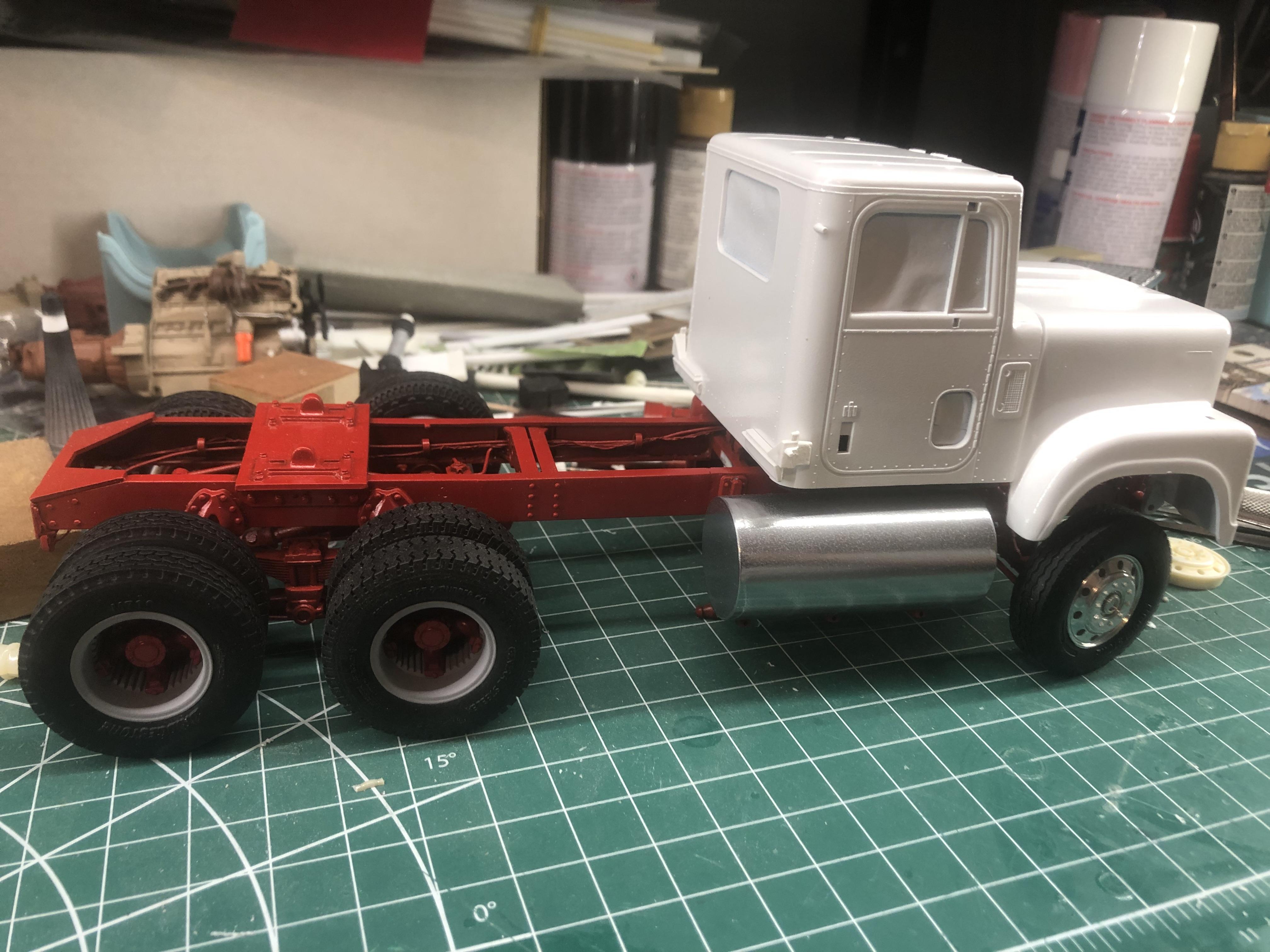

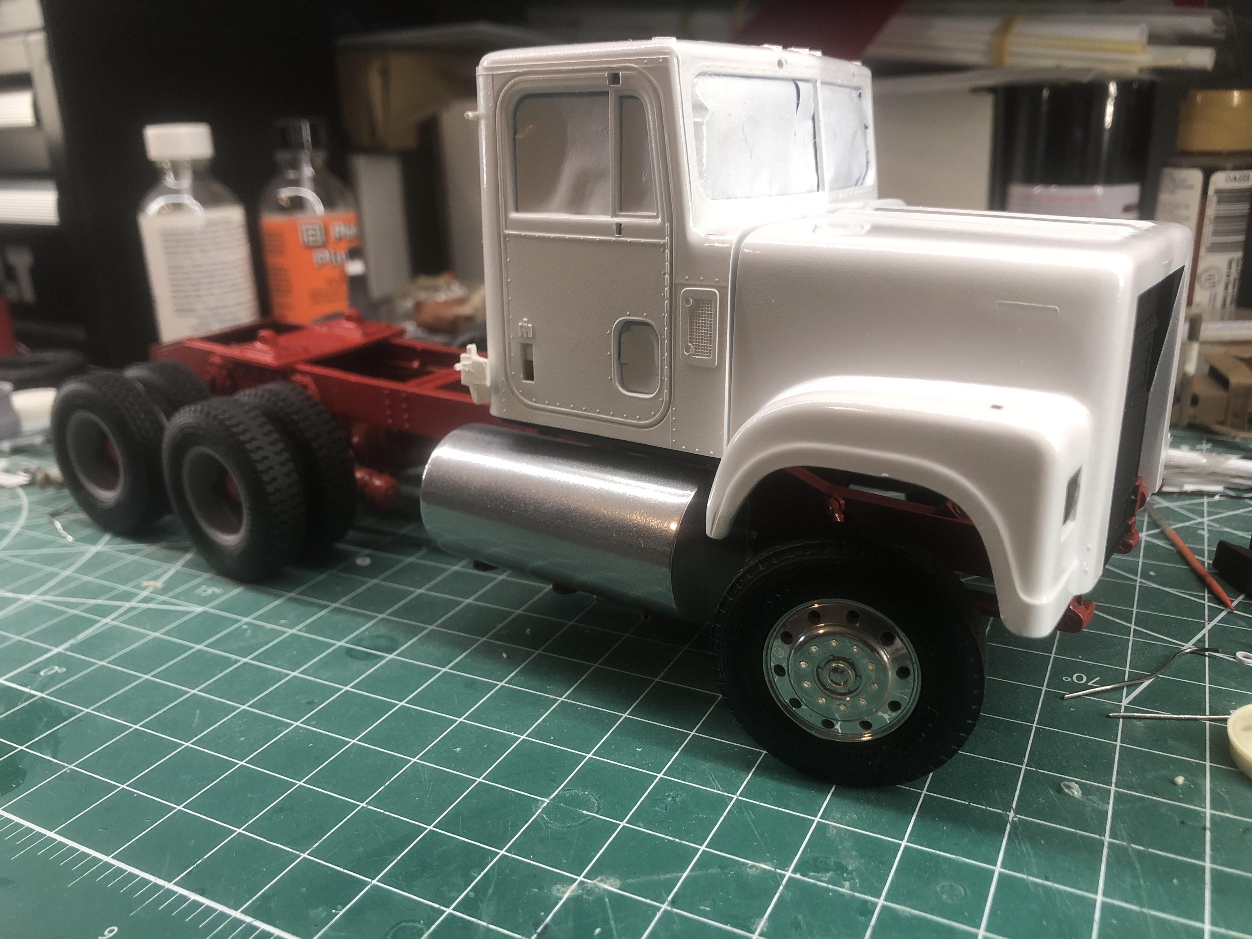

Thanks for all the comments , It’s been a while sense I’ve posted anything . I painted the frame , rear wheels and the fuel tank a couple weeks ago , today I painted the cab and hood ,had to do a quick mock up . Hoping to get the engine and transmission set in place tonight .
