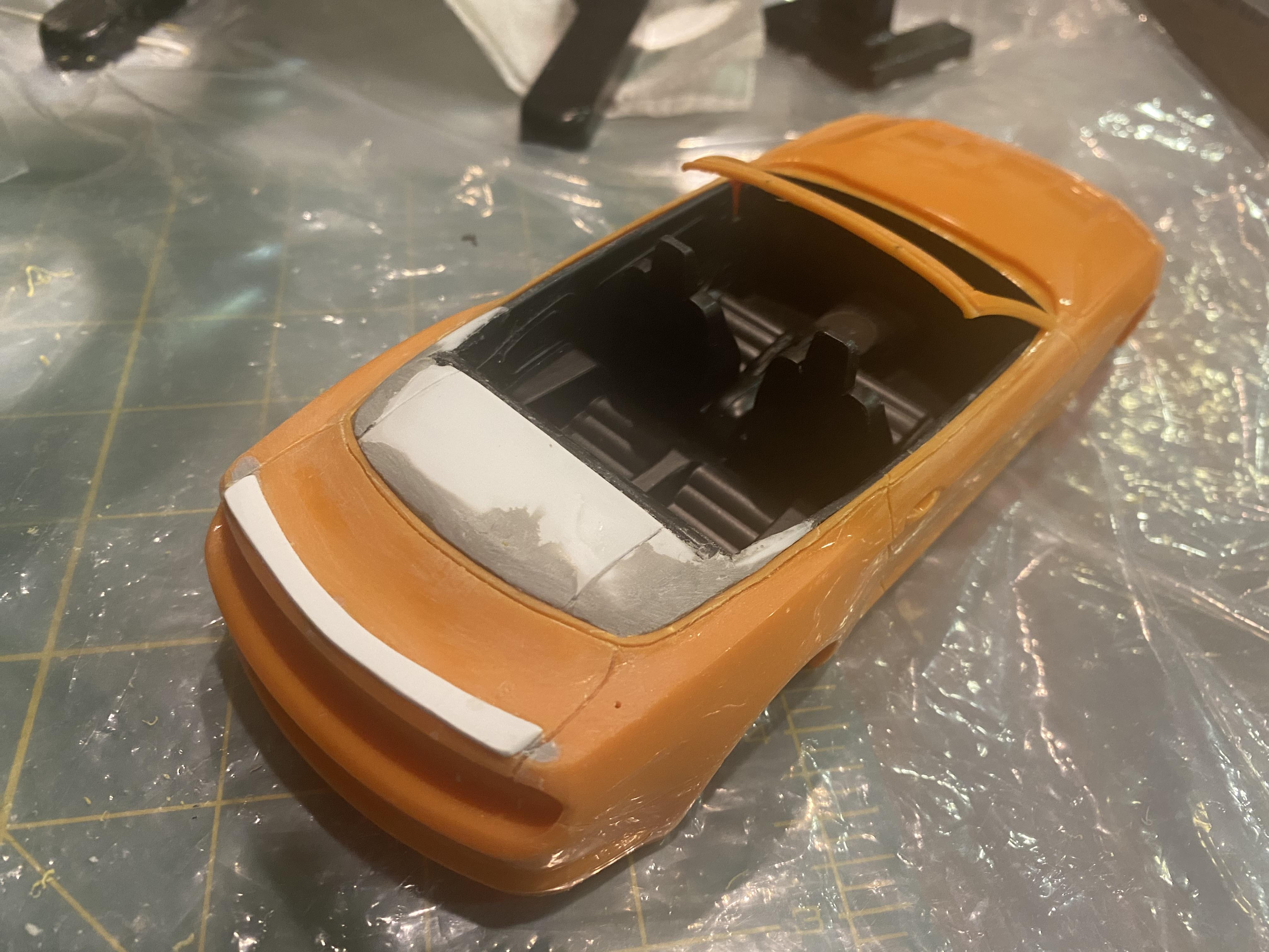

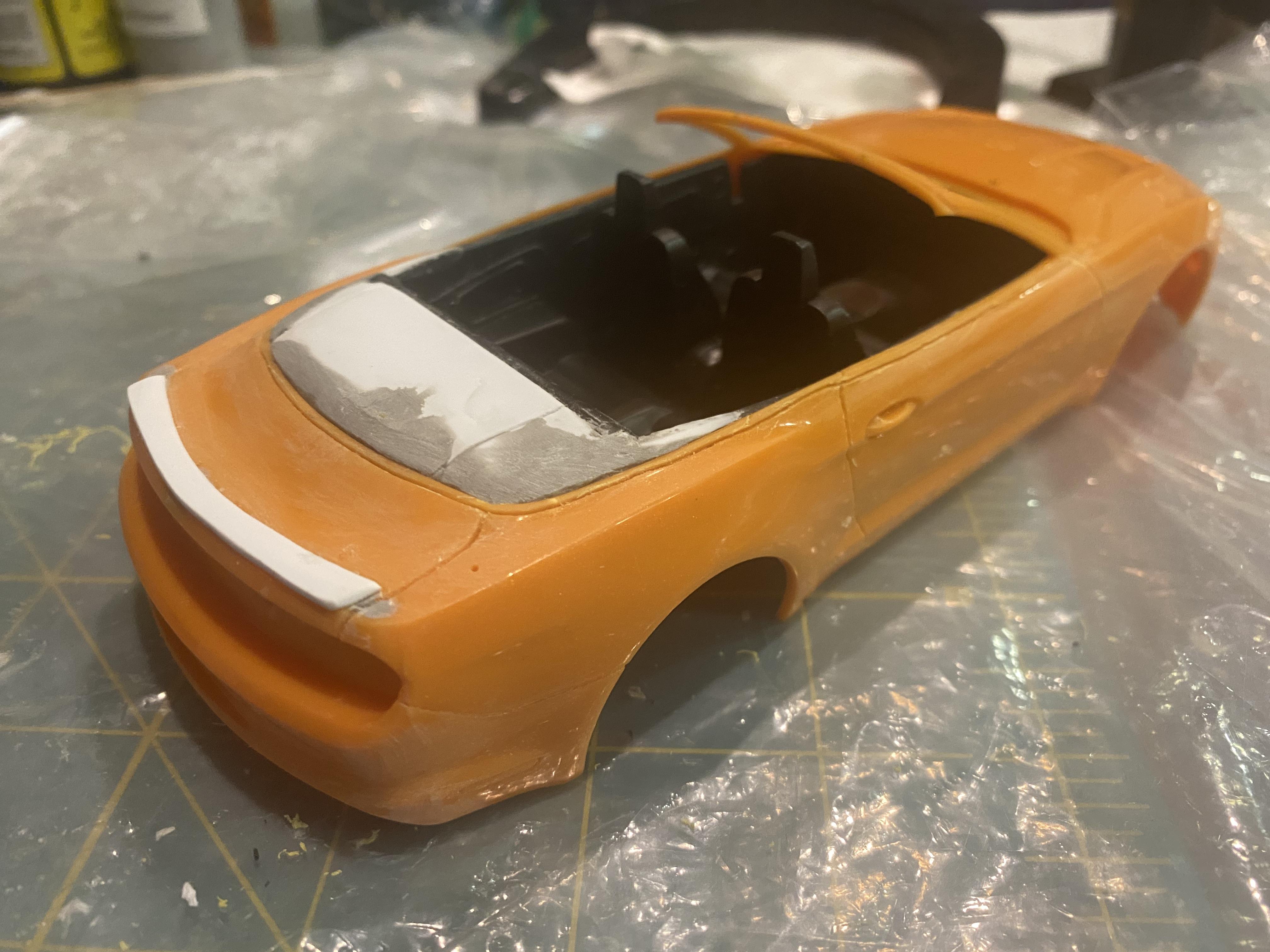

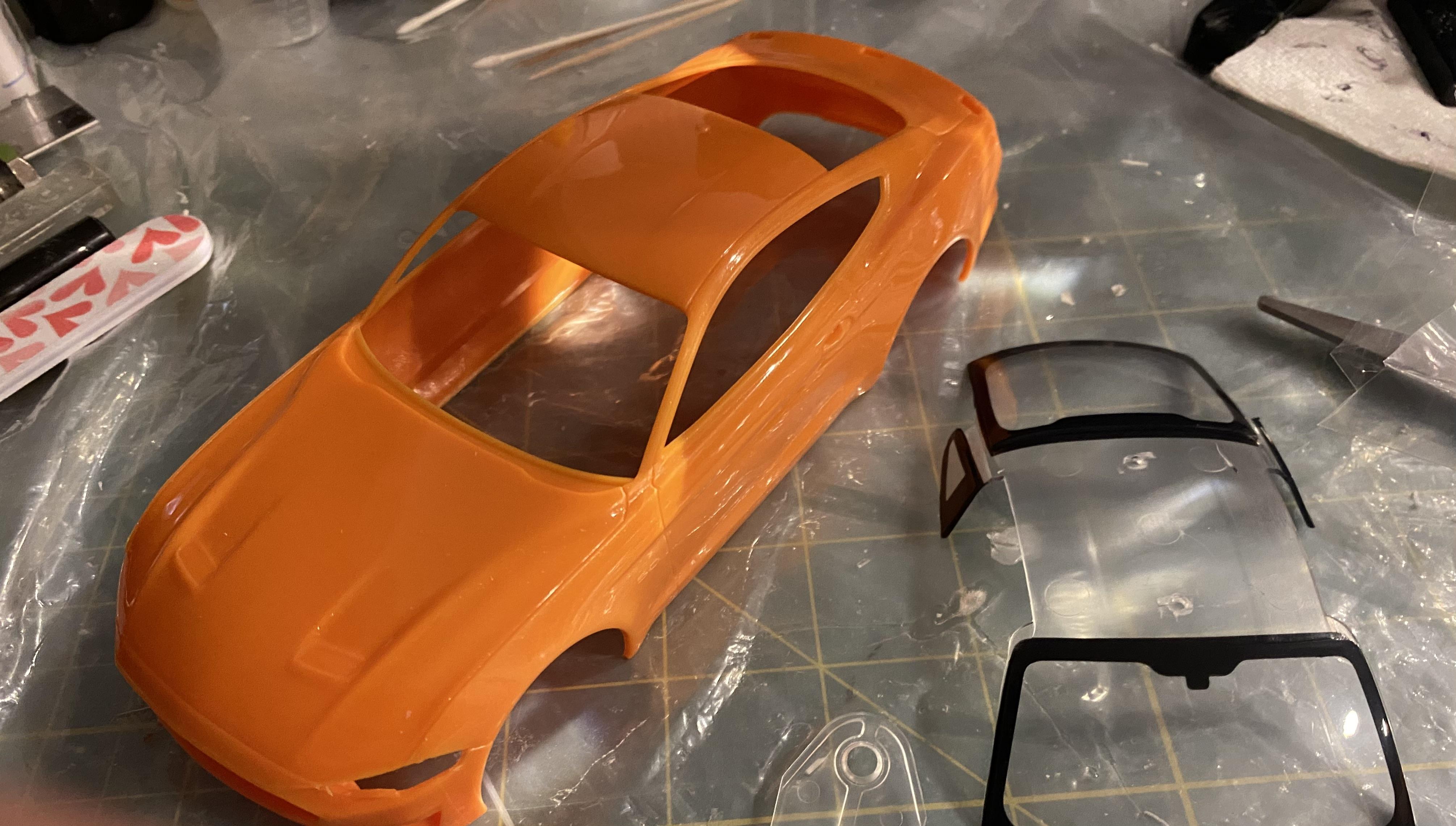

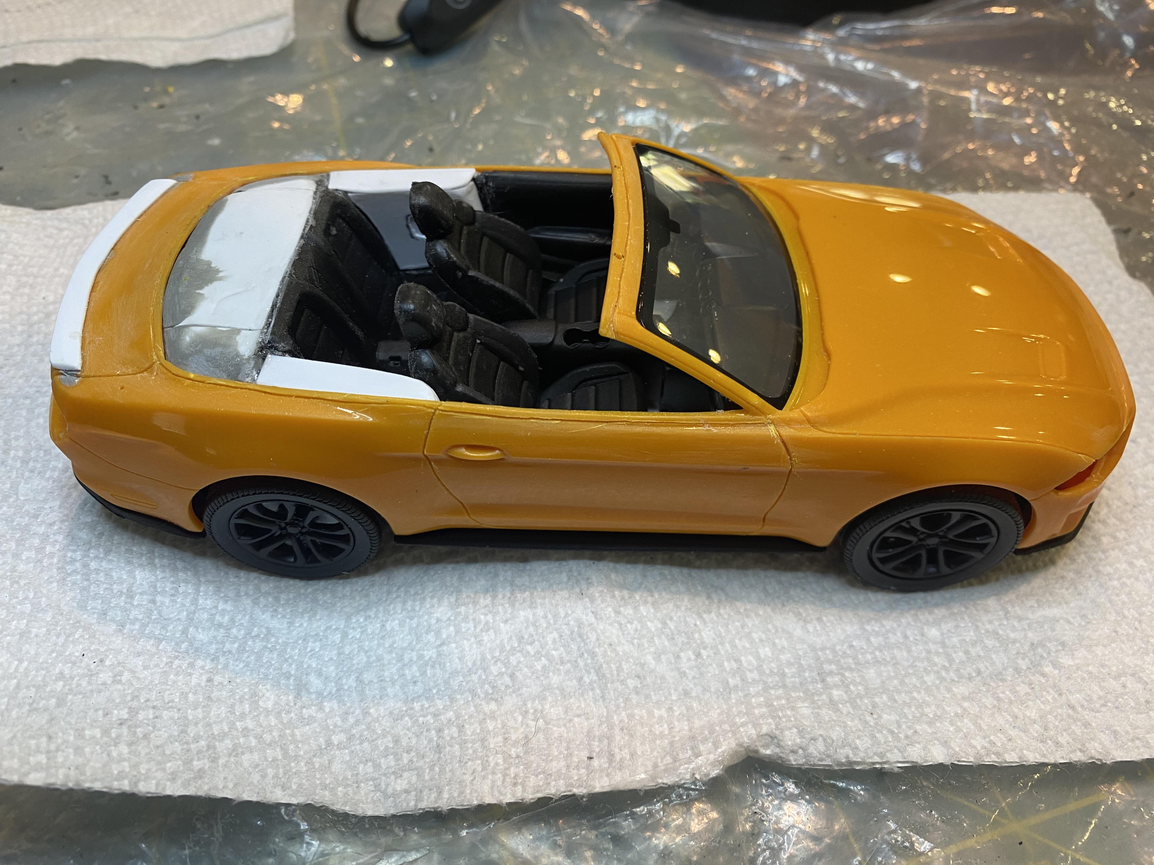

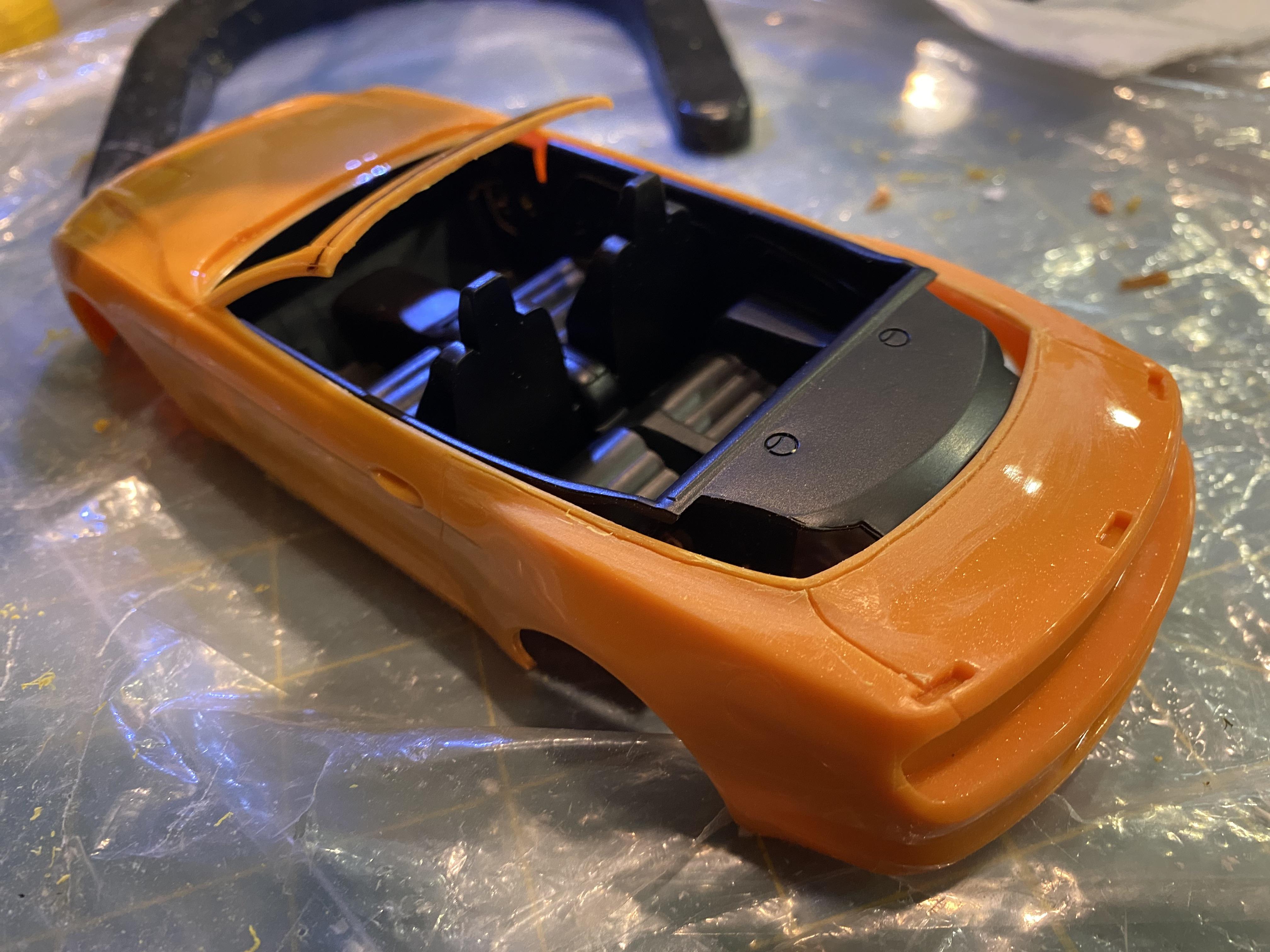

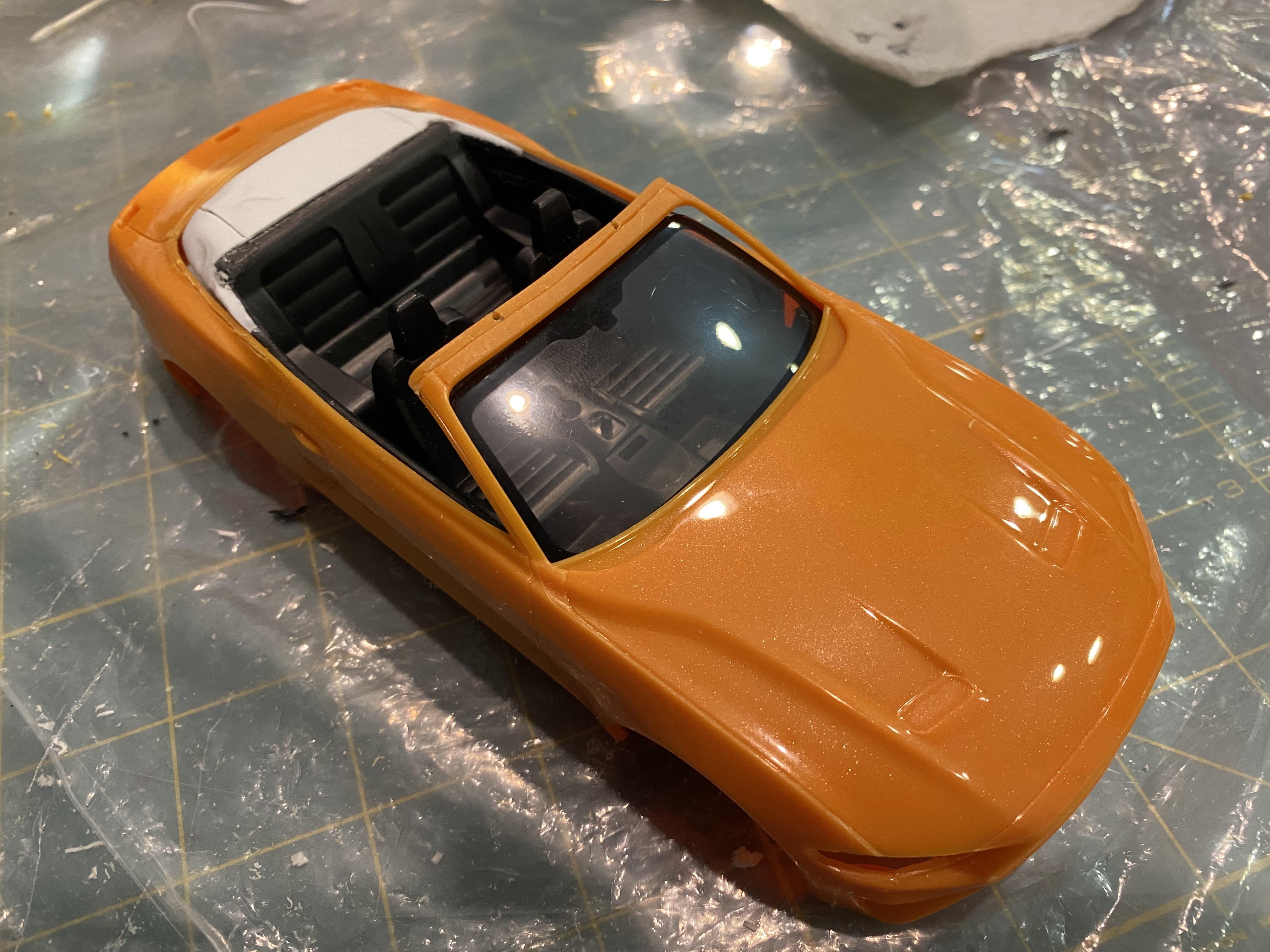

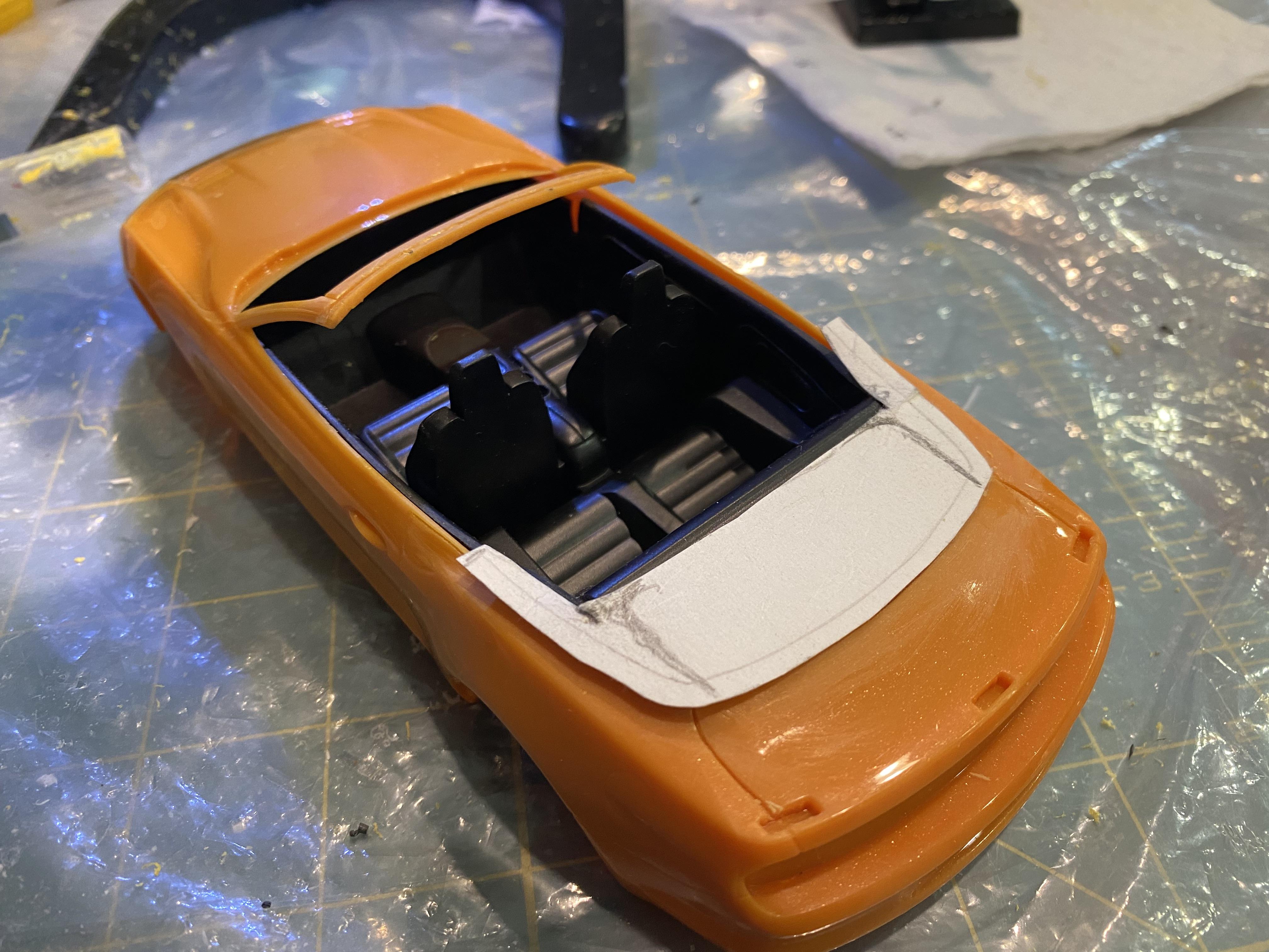

While I am semi-patiently waiting on paint and supplies for my 1966 Mustang Coupe build I decided to dig out my Revell 2018 Mustang Snap kit to attempt to make it into a respectable copy of our 2018 Mustang Convertible. I also purchased a die-cast model to get some detail parts that are missing from the snap kit, like missing rear view mirrors and bad headlights. This will be build 5/5 of our currently owned Mustang. I cut the top and made it into a convertible, but now to continue I would need to order supplies and paint for this kit as well.

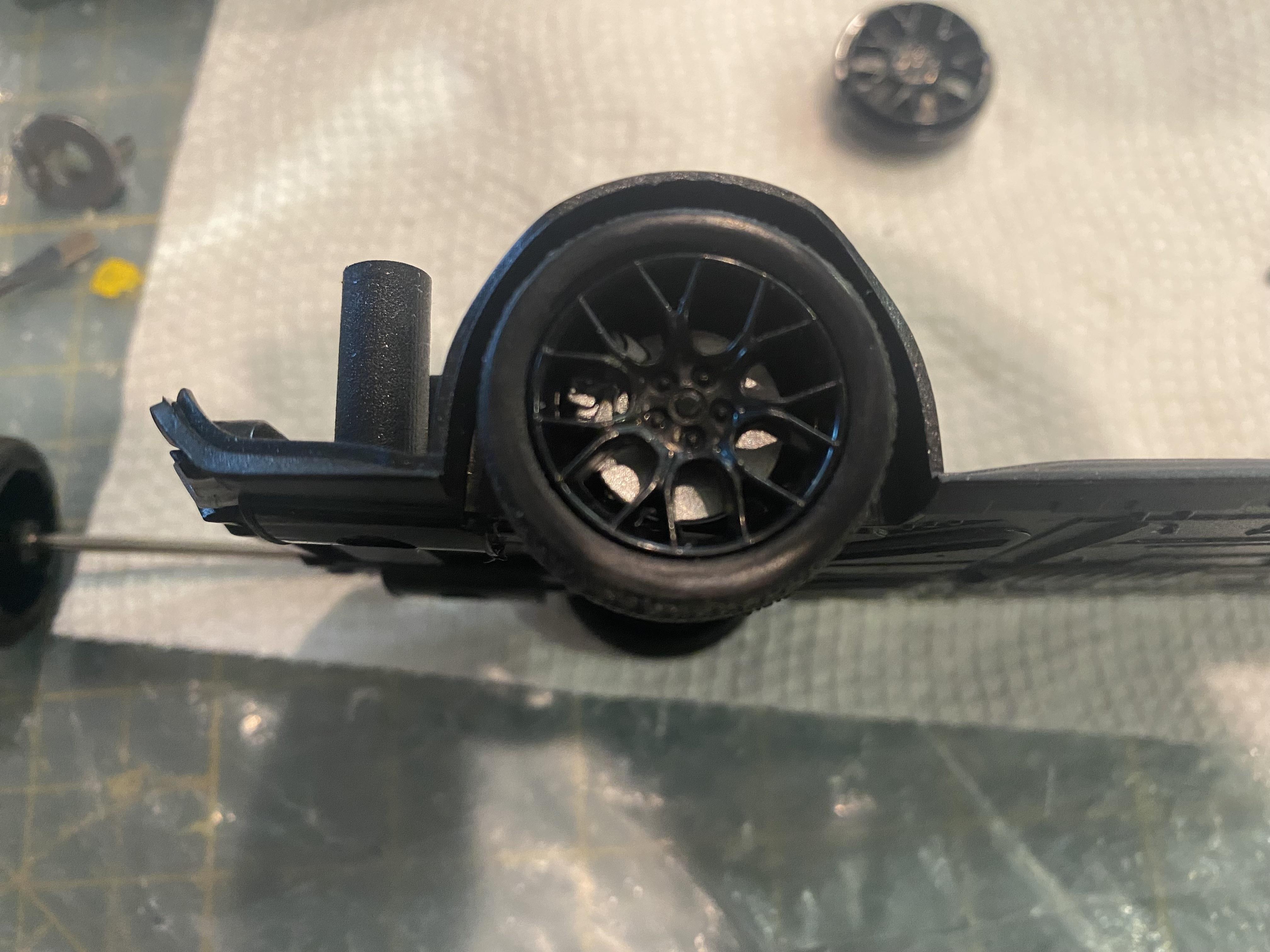

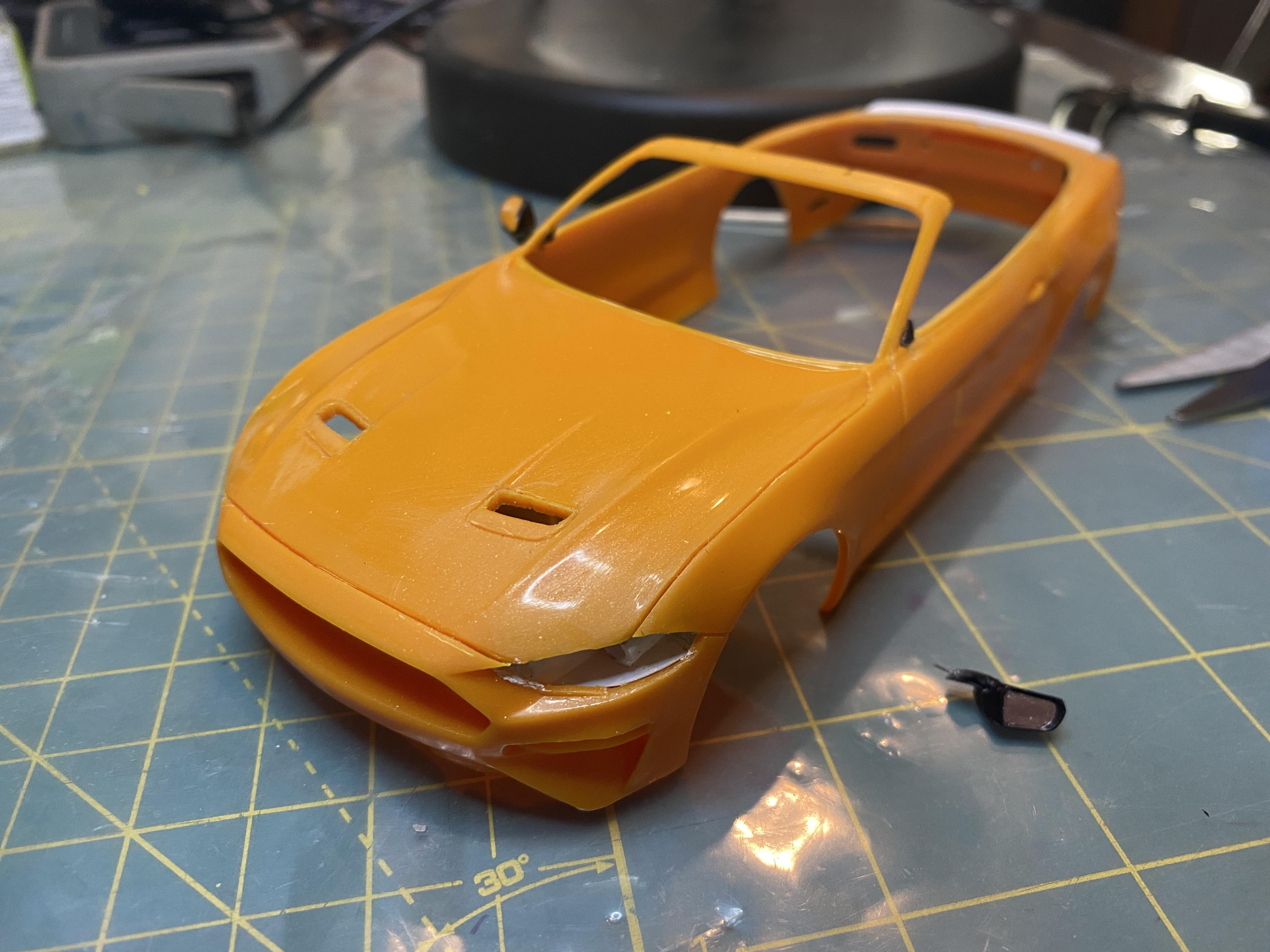

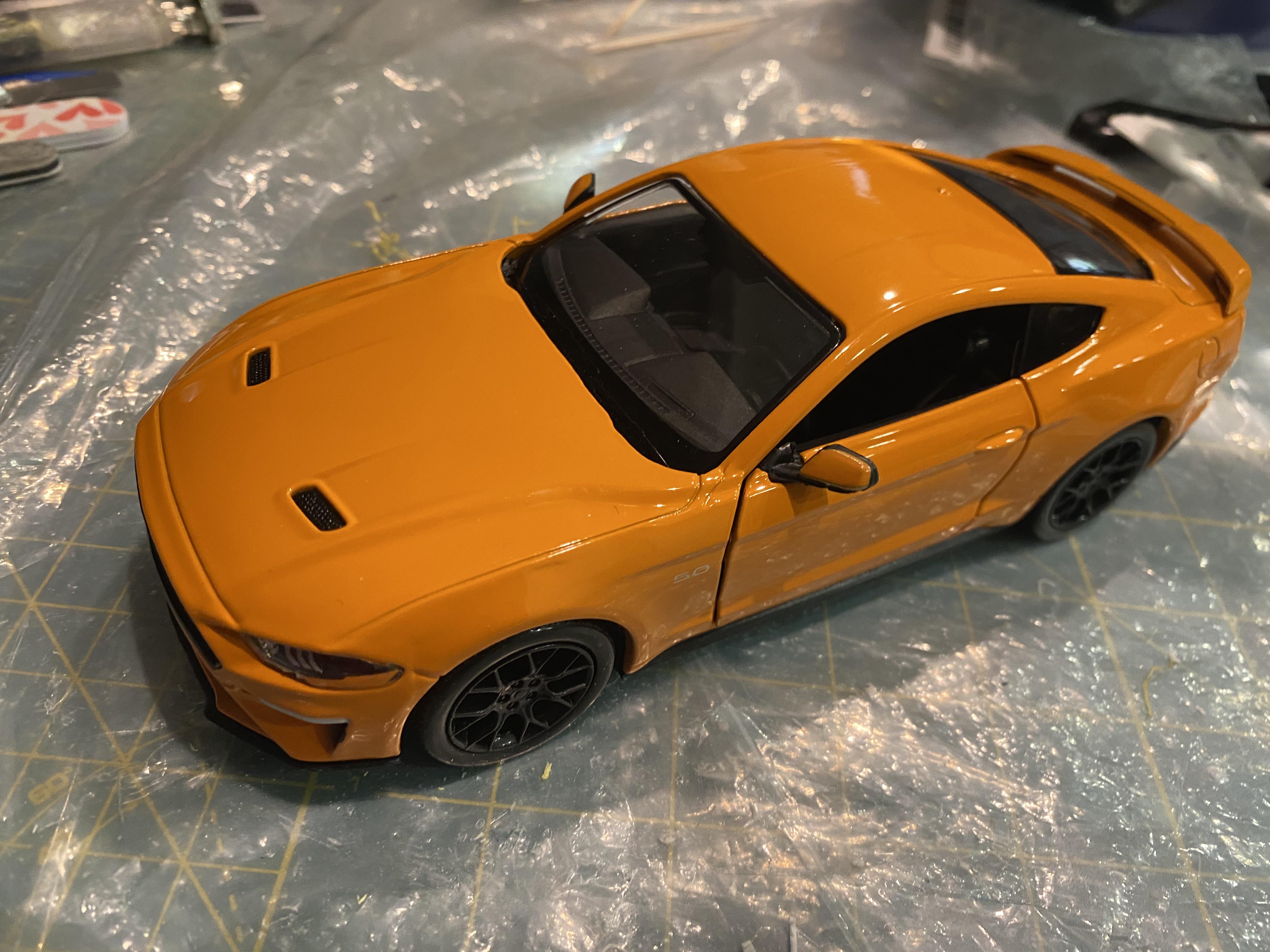

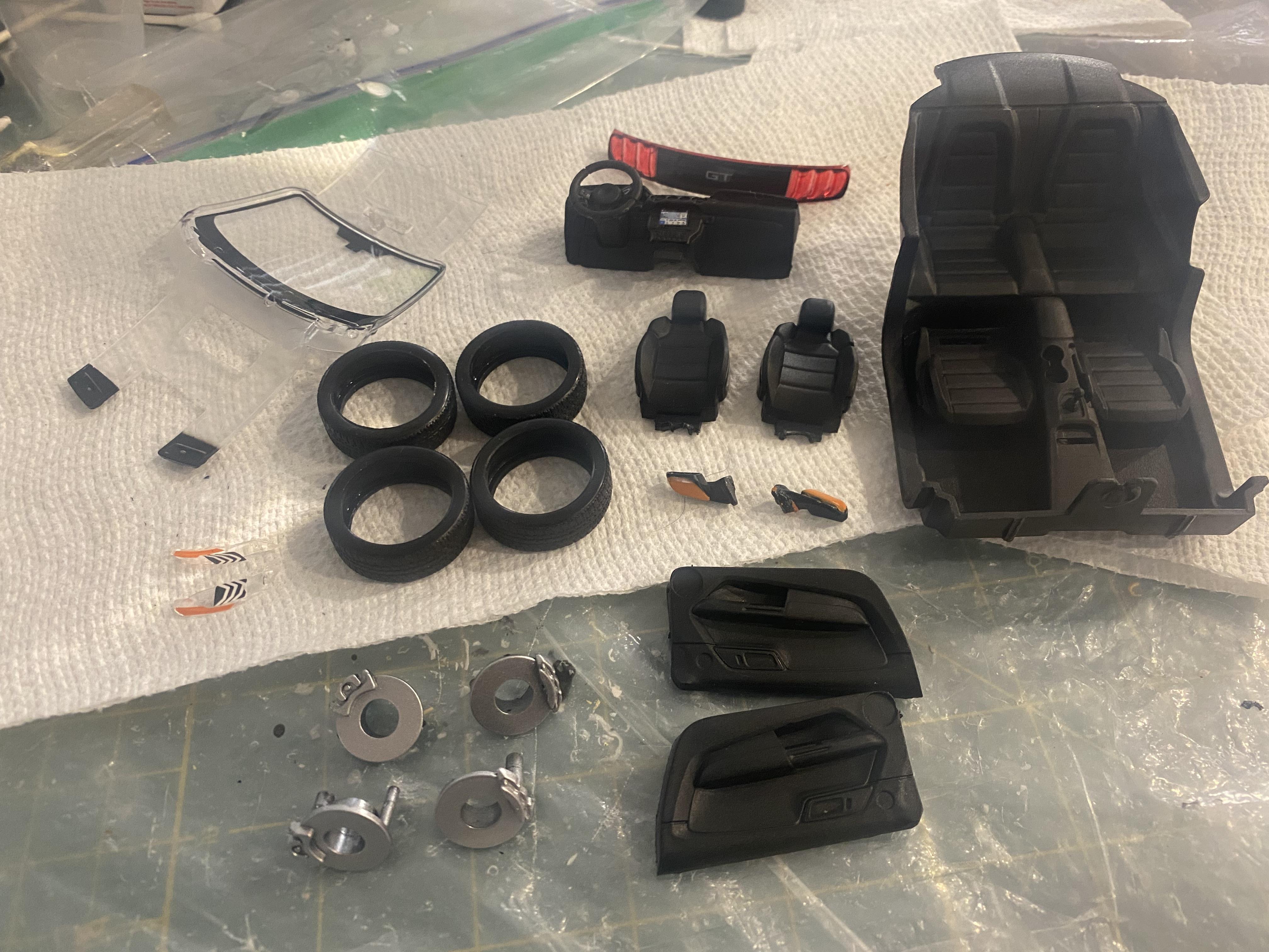

Finally finished the 1966 Mustang Coupe build so getting back to the 2018 Mustang Convertible. I disassembled the Motor Max die-cast for parts. Sadly it had to give its life so the convertible could live it’s best life.
This is all that is left of the diecast car for parts.

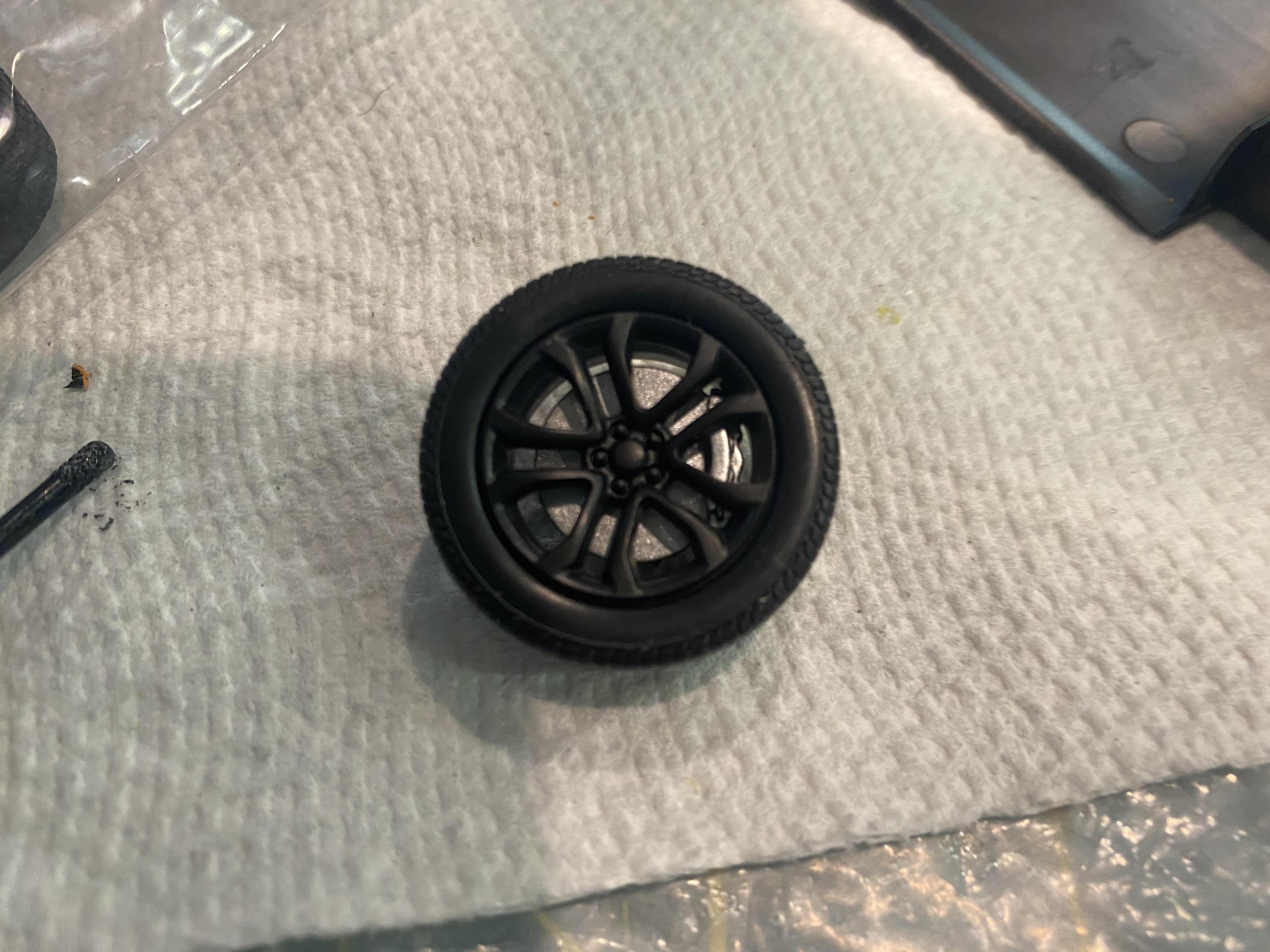

the disk brakes from the diecast fit very nicely behind the kits wheels.
IMG_3760.thumb.jpeg.e46e35fa4b53a79b7e9f9dbcf3fd5939.jpegIMG_3790.thumb.jpeg.d116f2a15590e23c649515bb2777a65d.jpeg

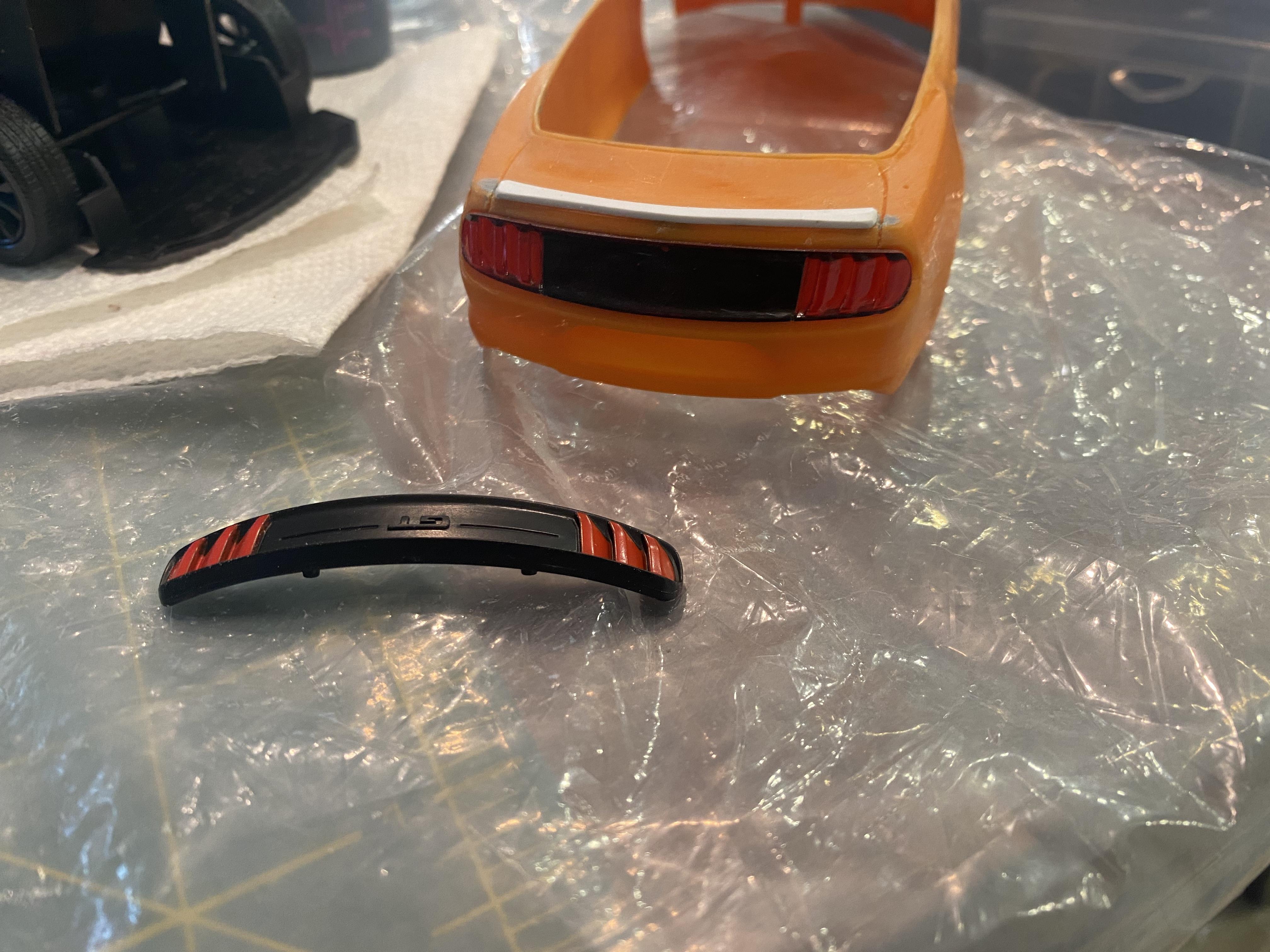

the clear red taillight lens panel from the diecast needed a bit of work but looks so much better than the one from the snap kit.
the clear lenses fit nicely and are such an improvement over the silver ones from the kit. The rear view mirror just needed a bit of work to fit well. White glue fitted. I will have to scratch build the insides of the headlights. With the diecast taillight and headlight lenses I should be able to run LEDs. I will be cutting open the hood vents and using the inserts from the diecast.

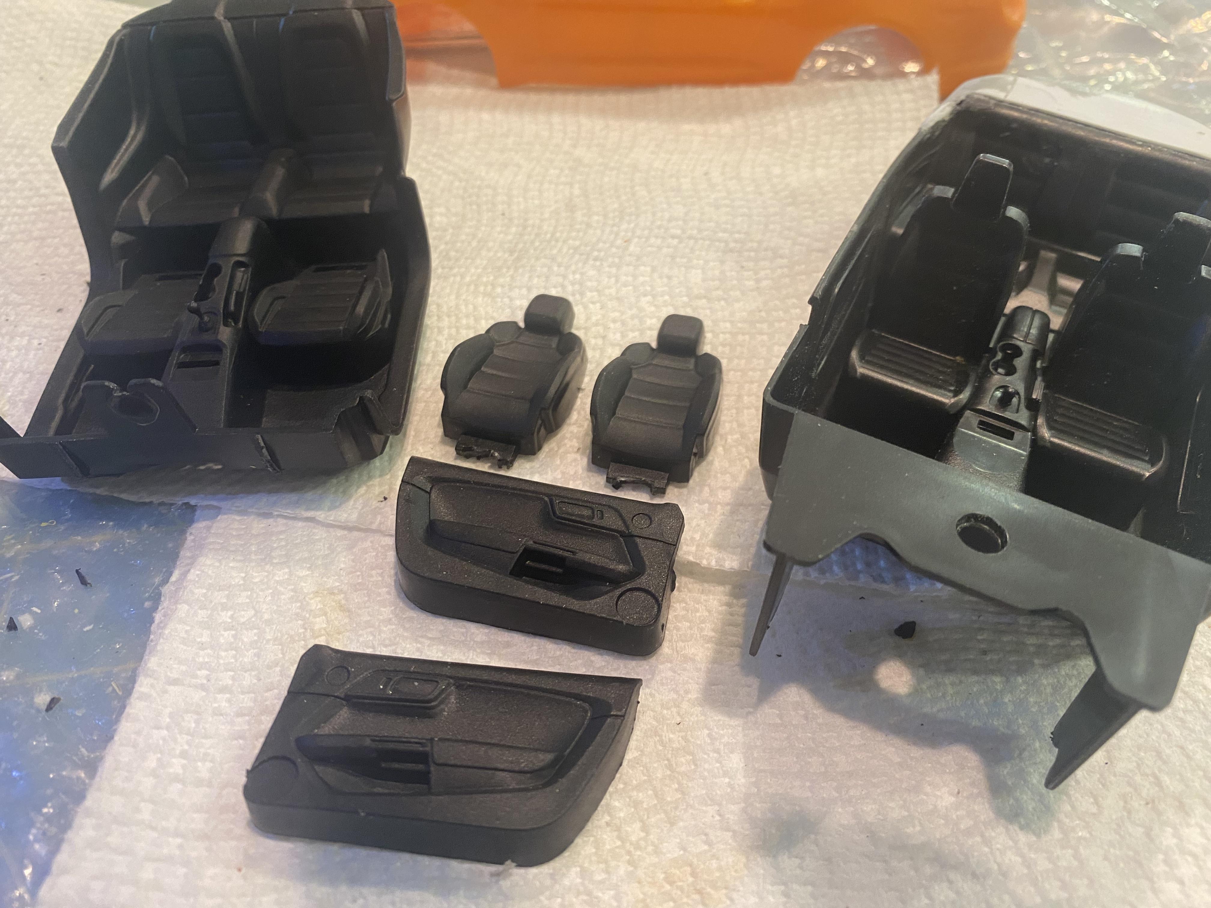

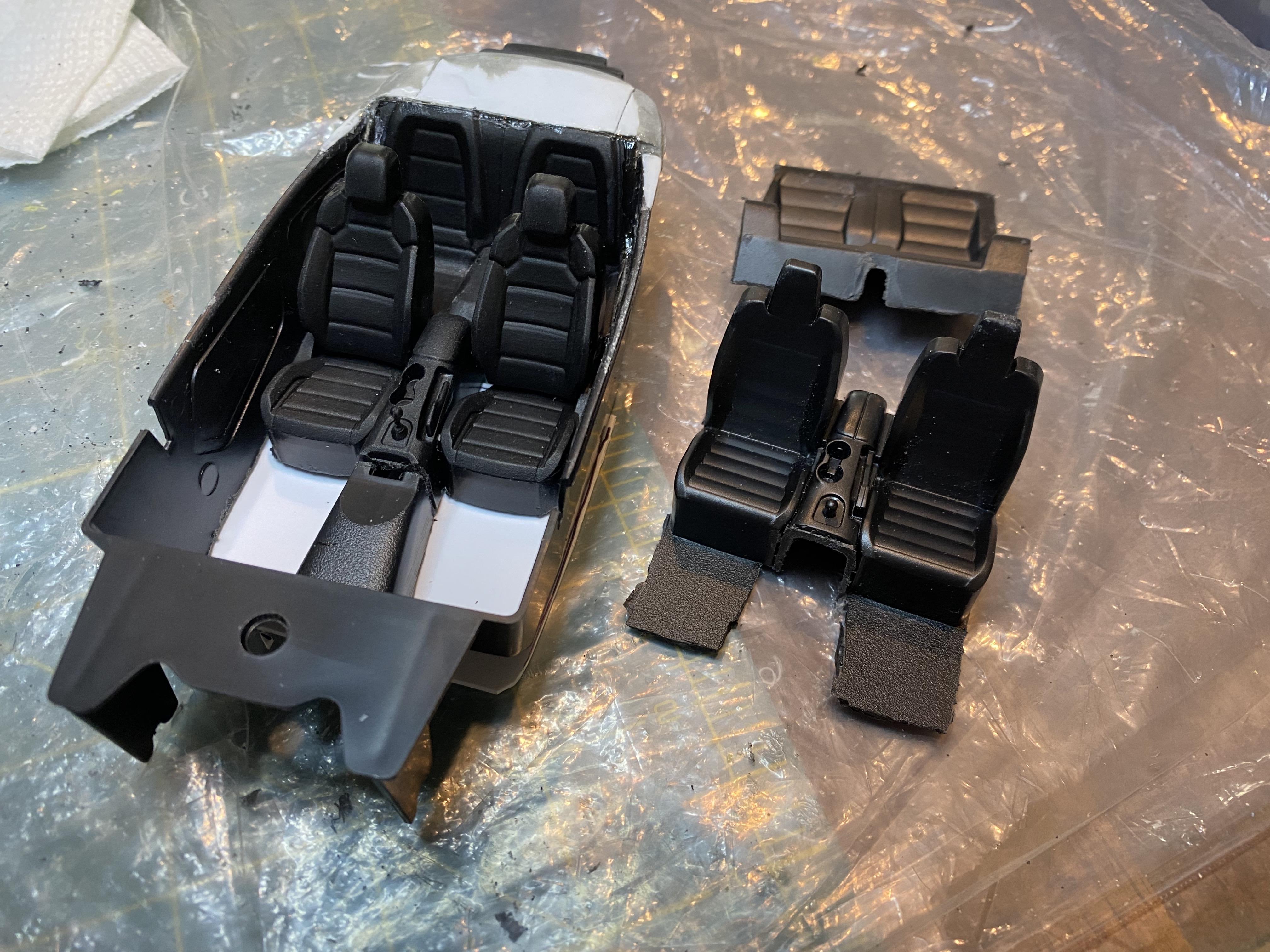

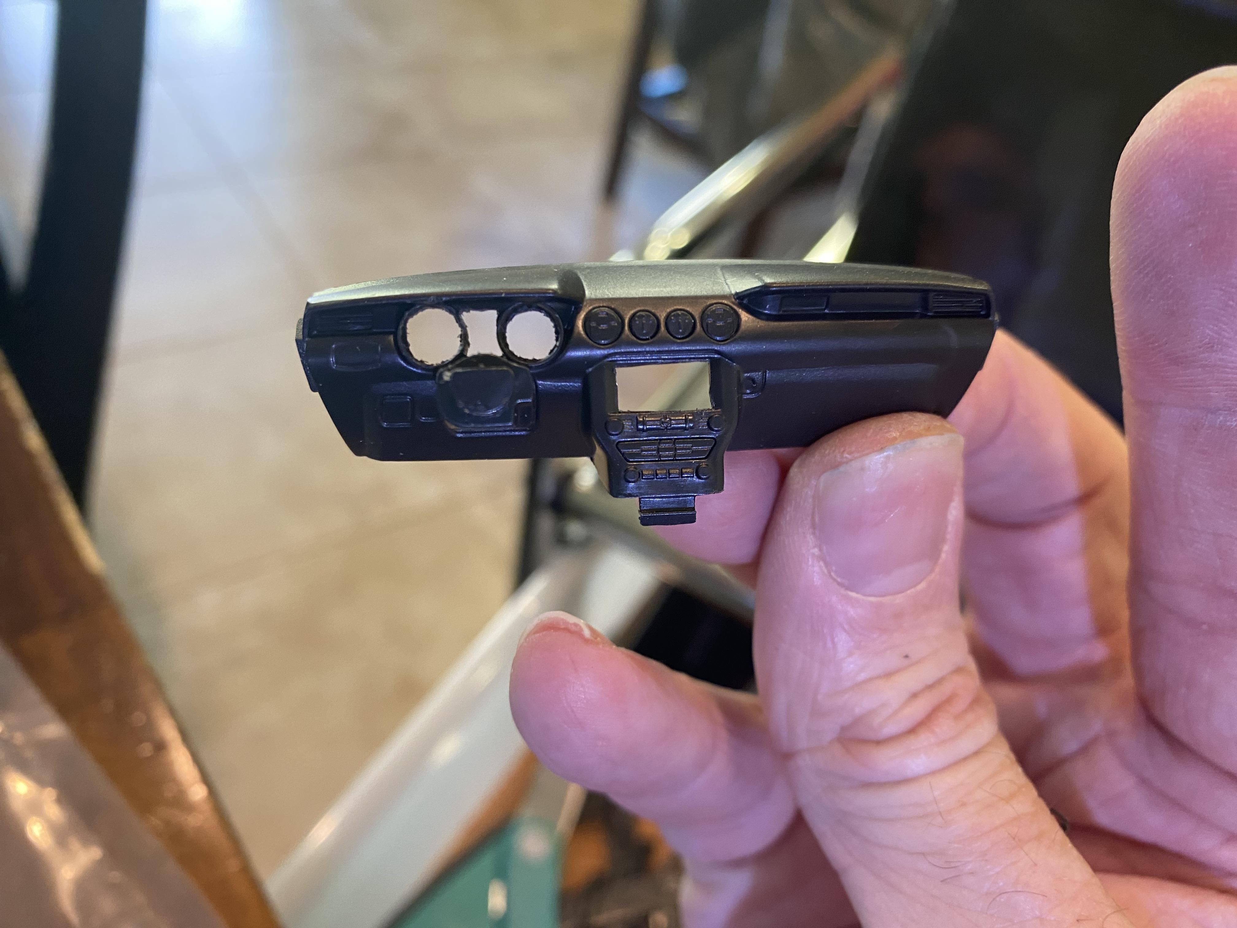

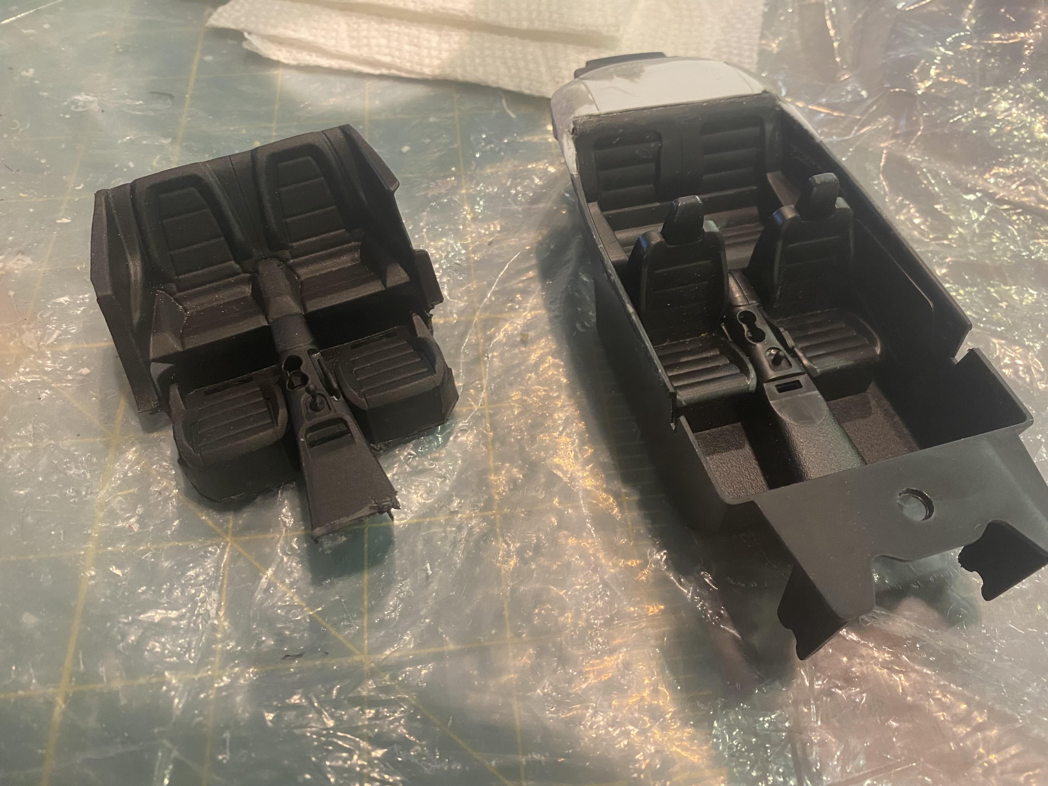

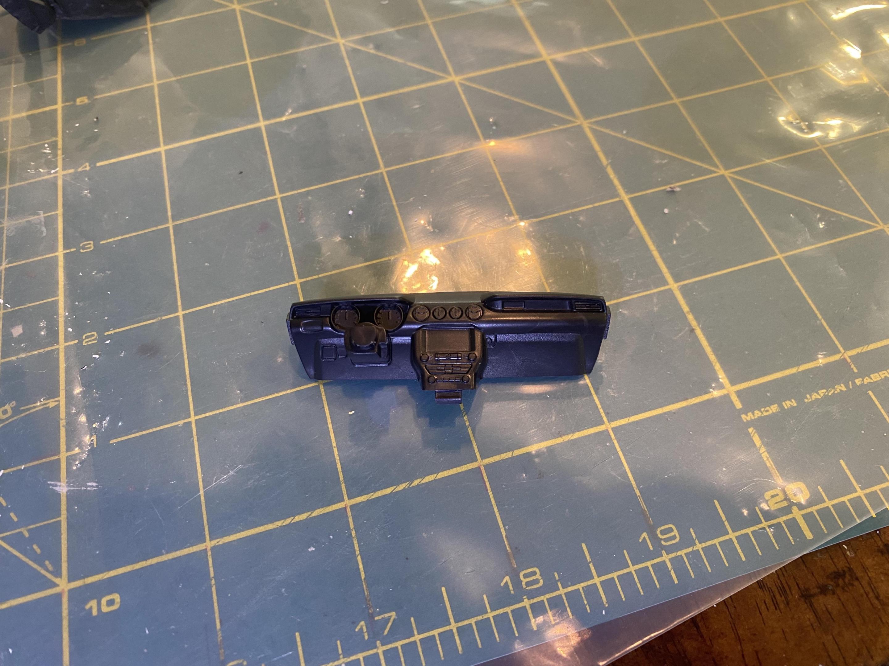

oddly the kit dash looked best, but the seats of the diecast are much nicer. Going to cut up both tubs to make a decent interior to work with. This is going to end up a curbside with no engine or chassis detail but I am hoping to get a thr interior and body looking as nice as possible.

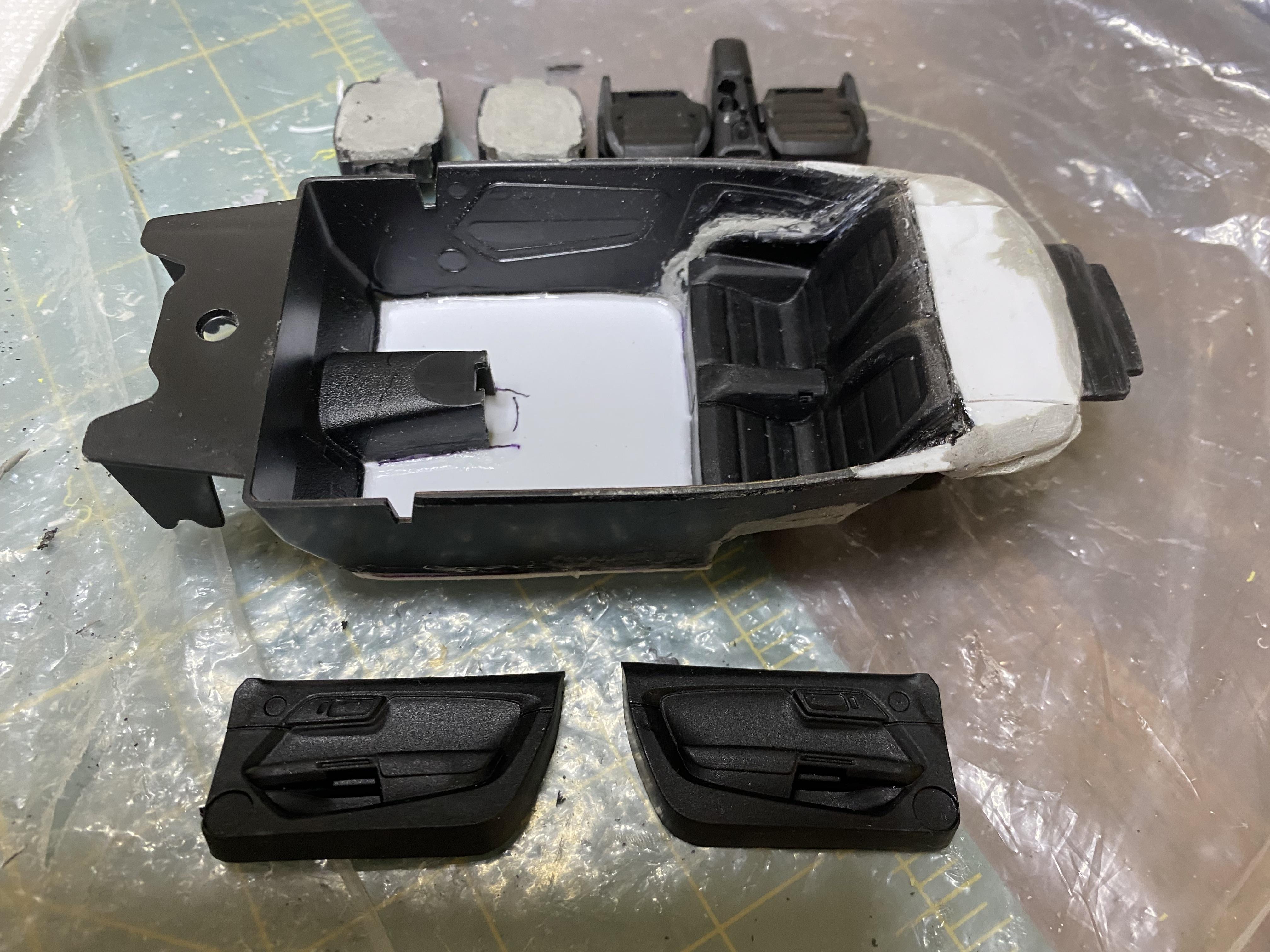

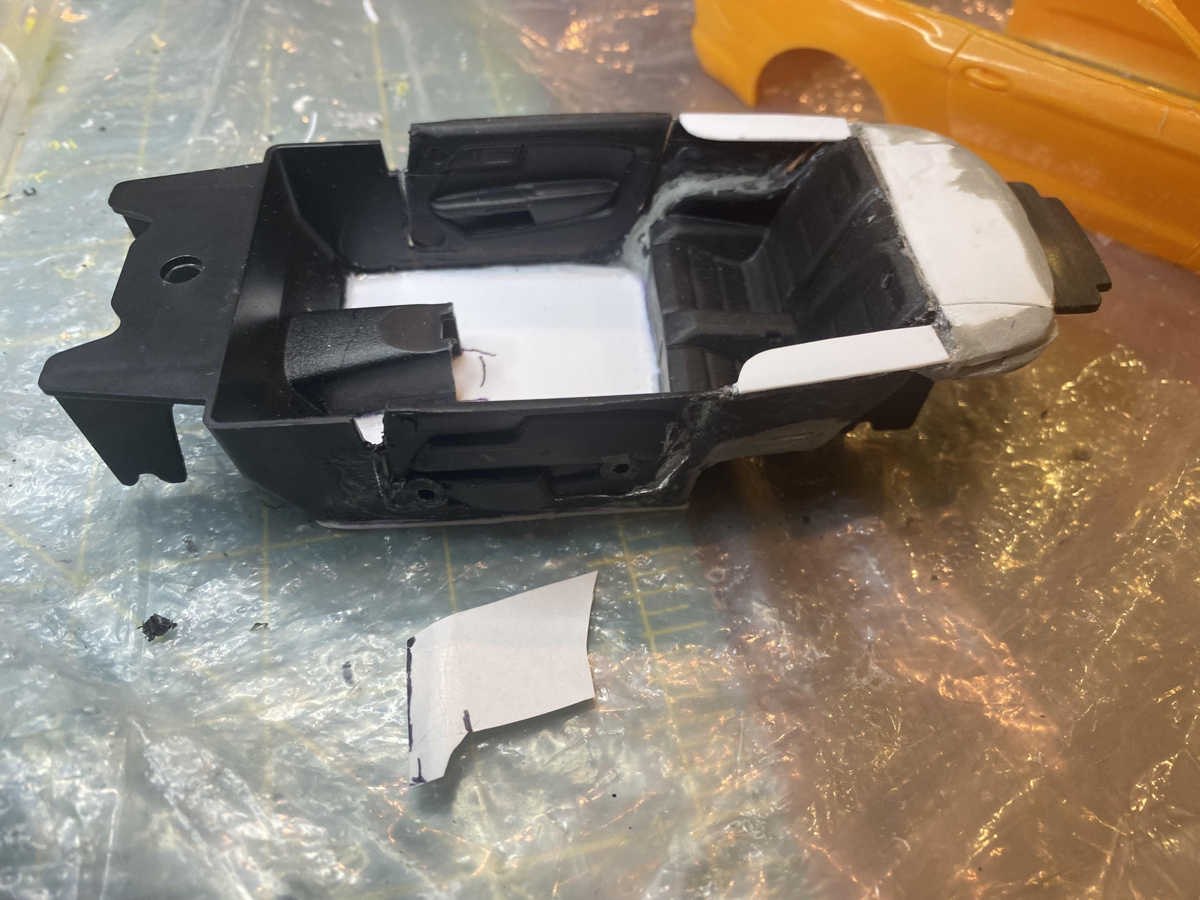

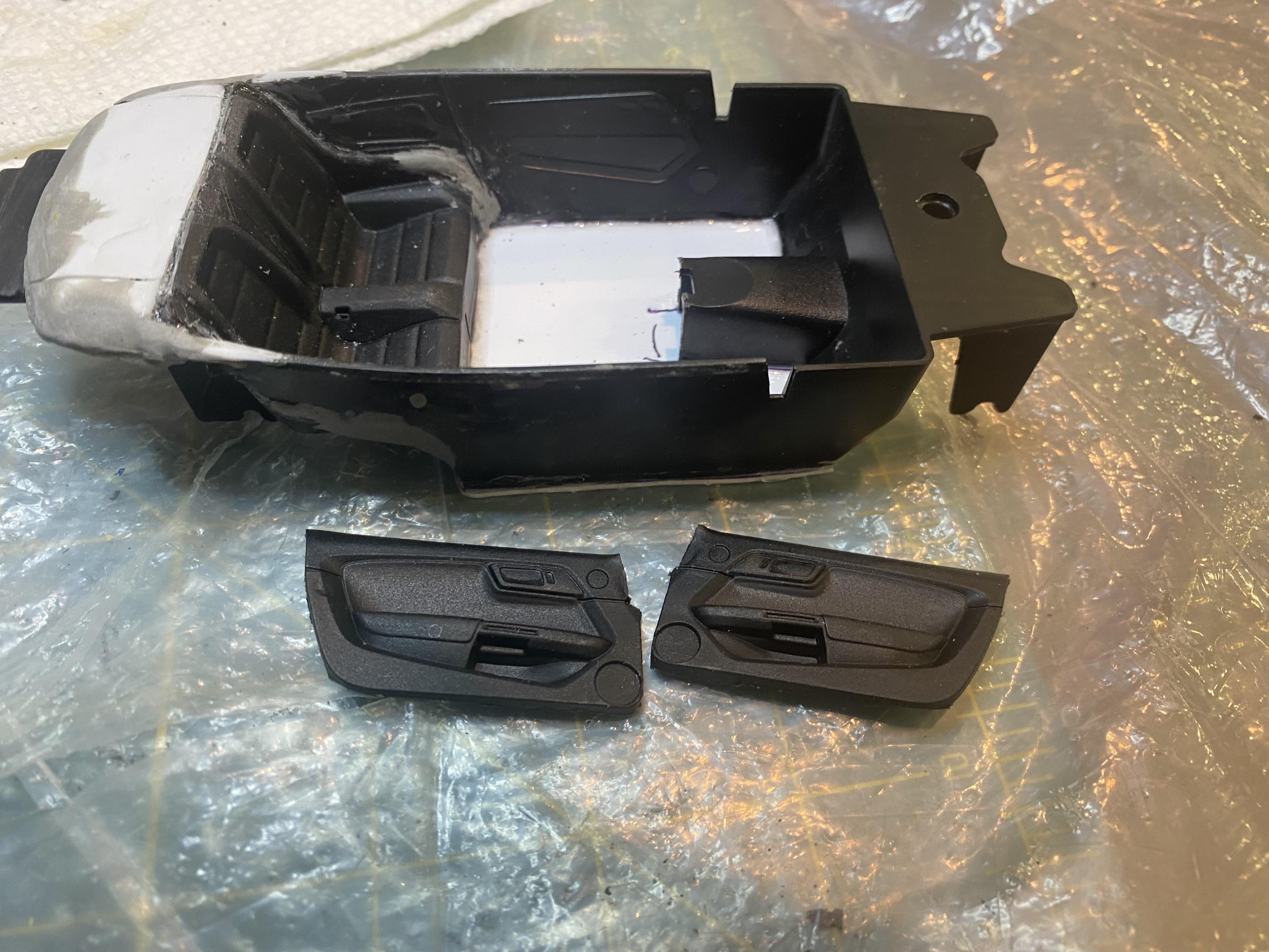

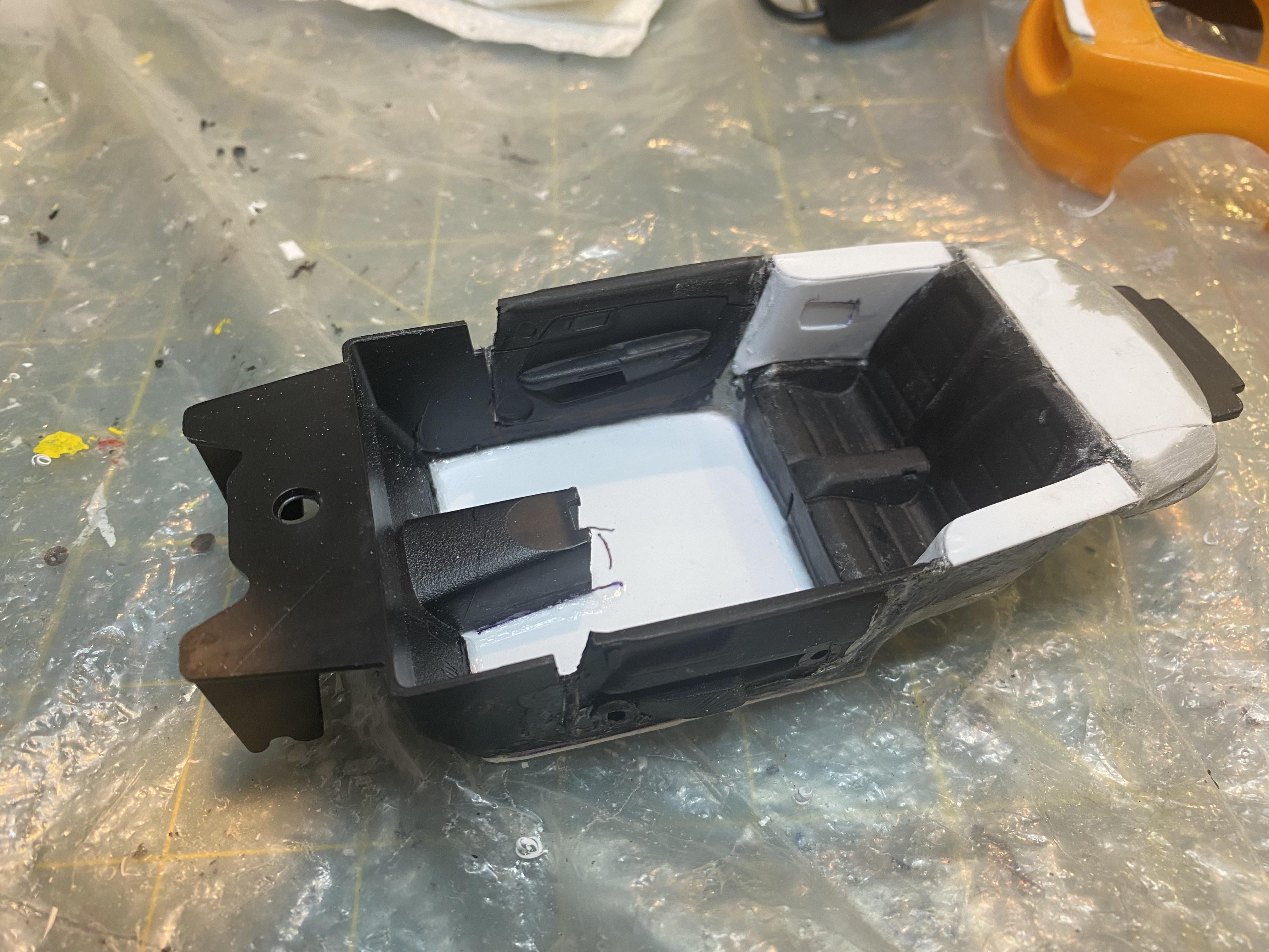

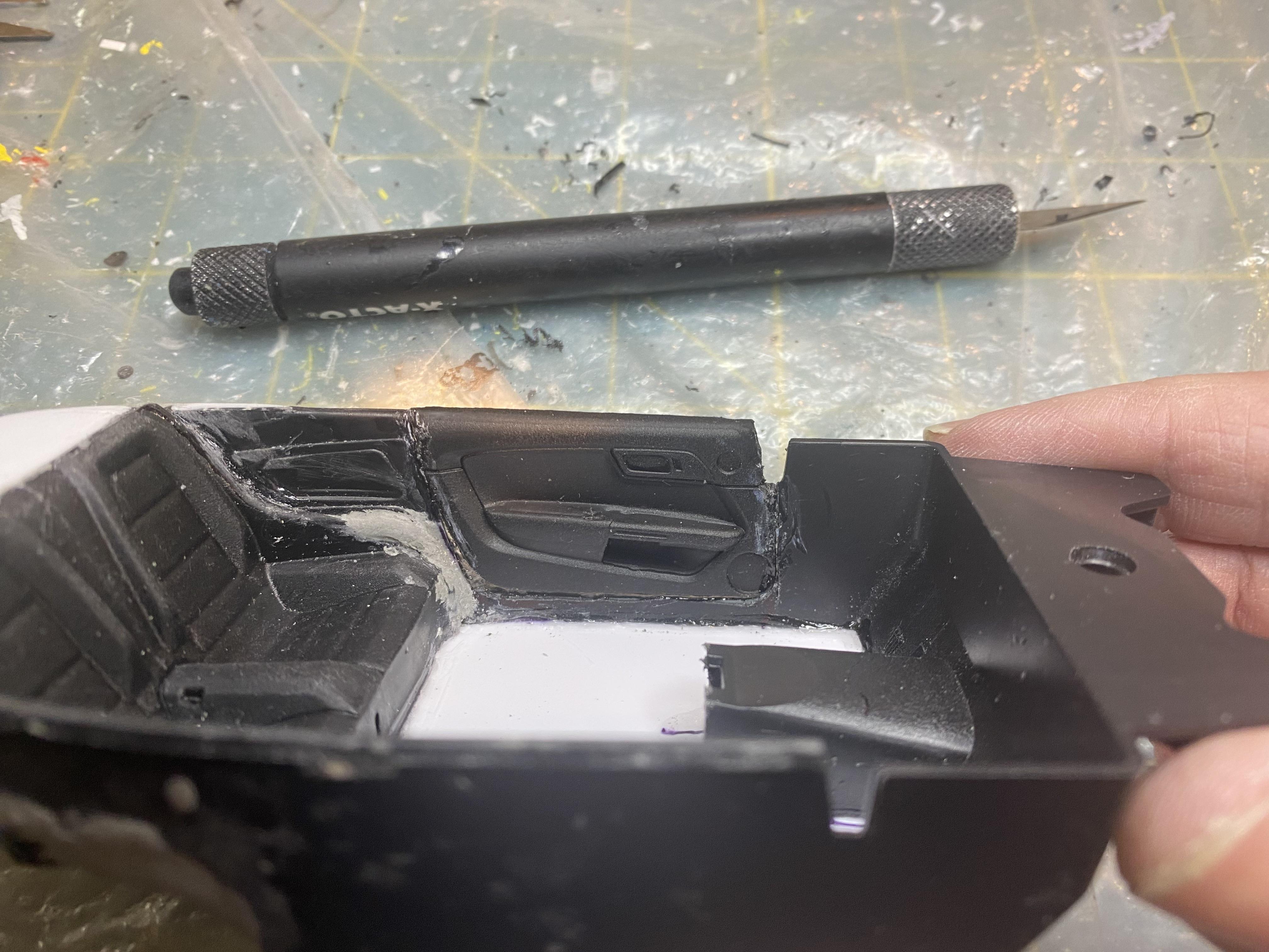

Cut out the seats and floor from the kit interior. Bonded in the rear seat from the diecast car and created a floor from styrene. Now more of a proper model kit tub with decent seat detail.Cleaned up the diecast lower seats to fit. Now they work more like a nice seat component I can fit into the tub after the carpet flocking. Still need to figure out fitting the diecast door panels into the tub. The snap kit has almost no door panel detail.

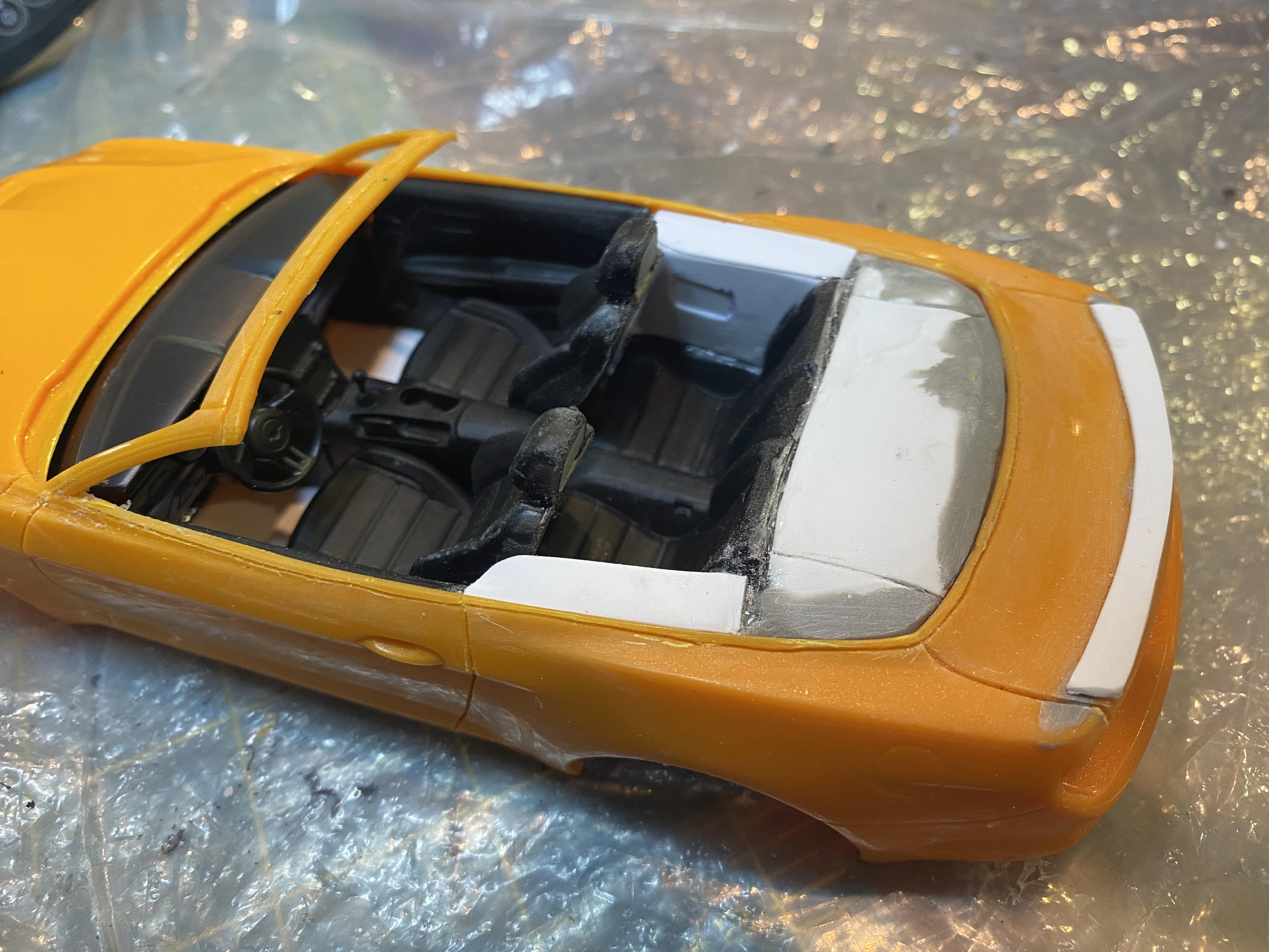

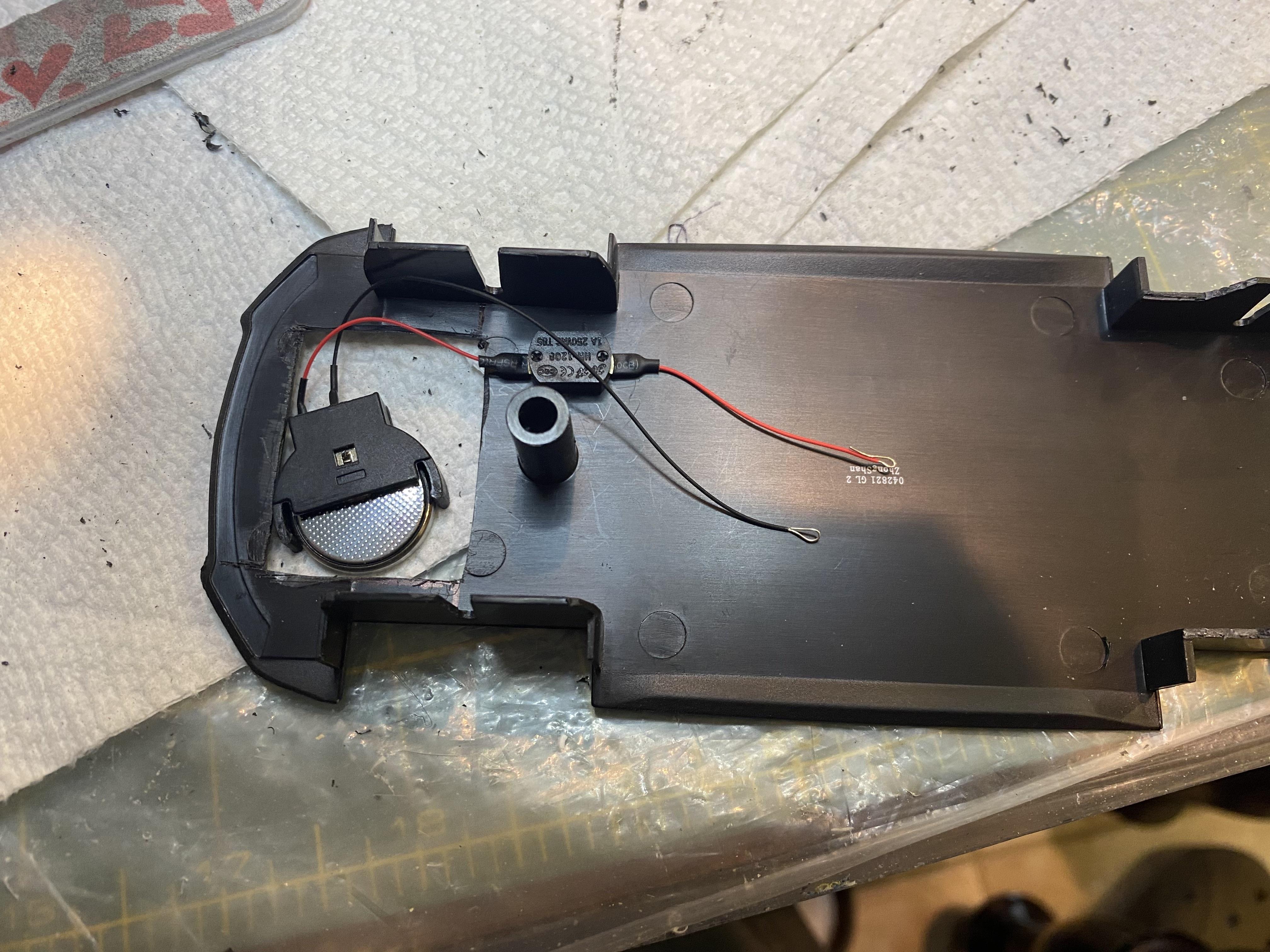

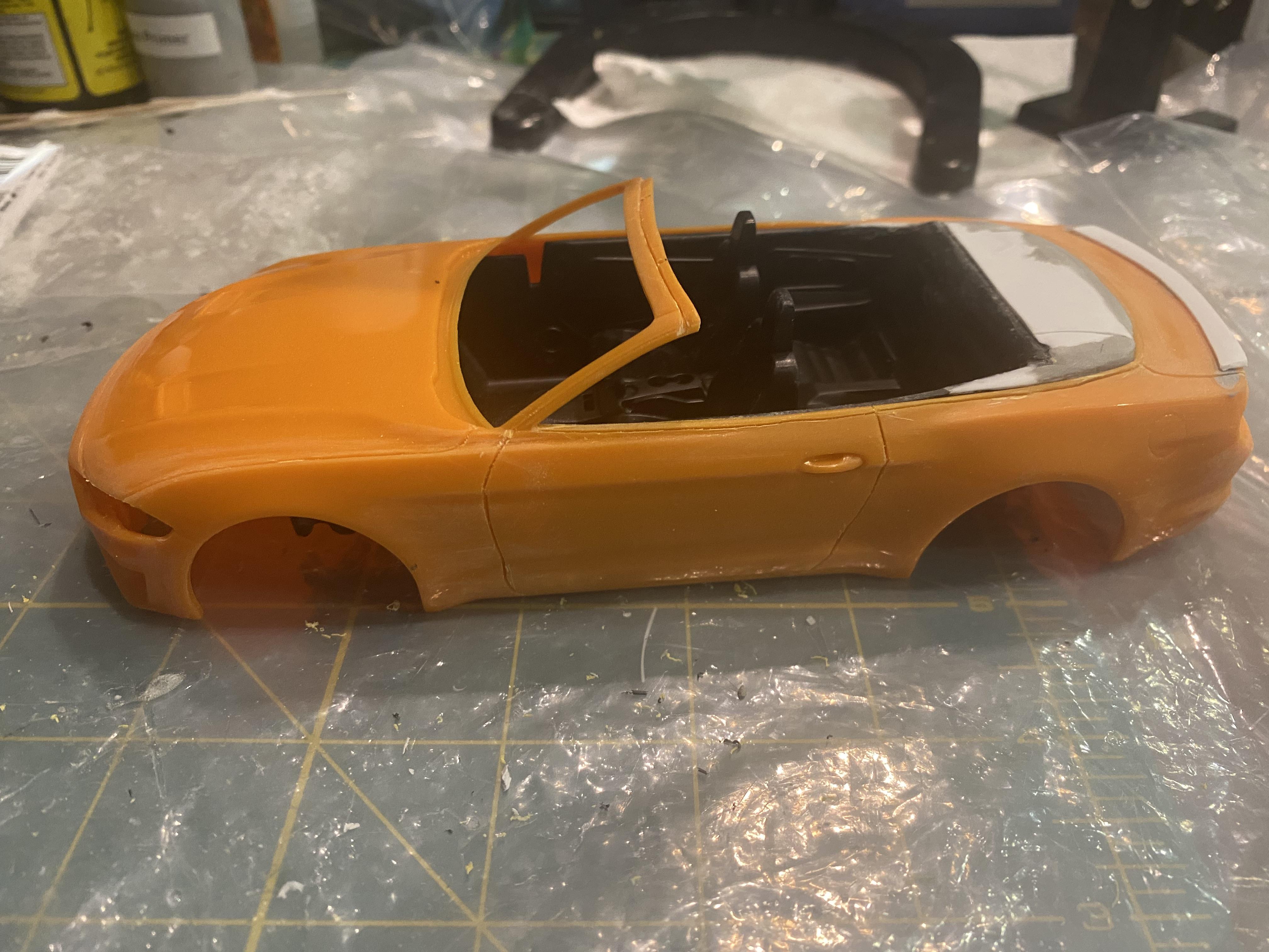

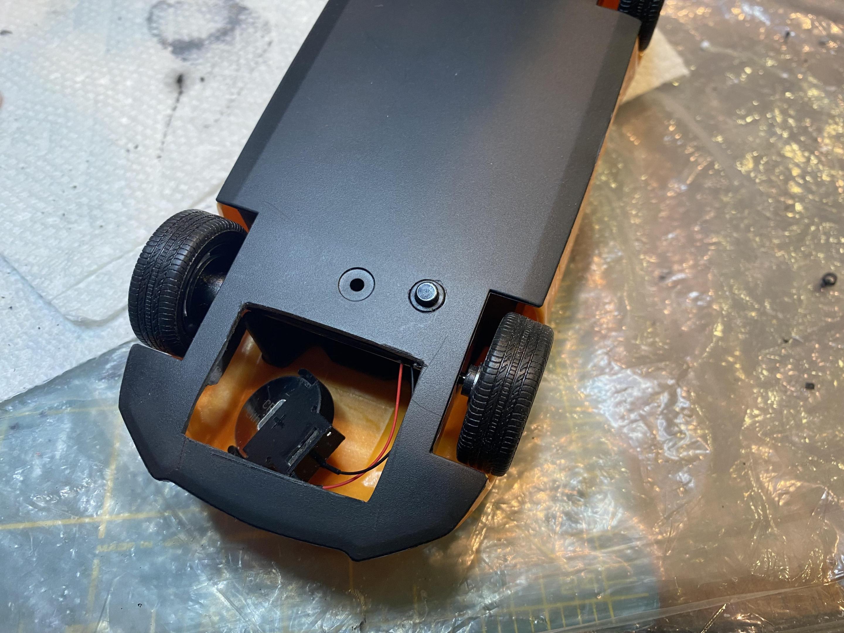

Pretty close to finishing up the interior fabrication and modifications. Stiched in the door panels and created the convertible specific rear panels. Cut open the chassis for the LED battery and drilled for the switch.
IMG_3804.thumb.jpeg.27a3a5f9d0fdc4d8b6241f261c00706c.jpegIMG_3805.thumb.jpeg.cea05fa03c466cc129145e8260dd957d.jpeg
rear convertible side panels.
IMG_3806.thumb.jpeg.8c9309dc51dca21c2e270b914a92a9a4.jpegIMG_3808.thumb.jpeg.bce6460edec7159479f2075f11360a09.jpegIMG_3809.thumb.jpeg.67ef8e381f951f8605d6790cfd476536.jpegIMG_3813.thumb.jpeg.7d5d76335f2bea2a0d222d9d07a8d083.jpeg

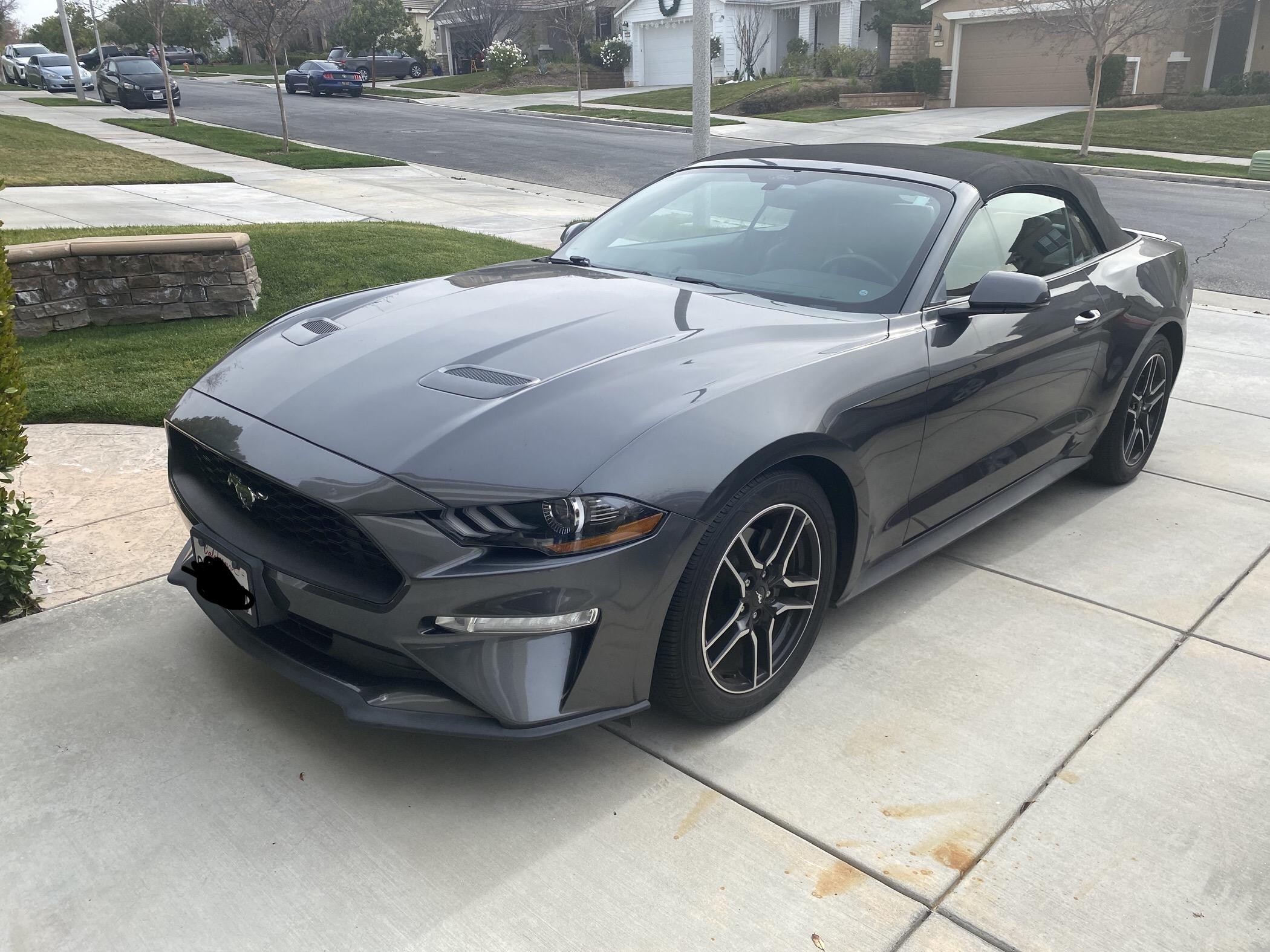

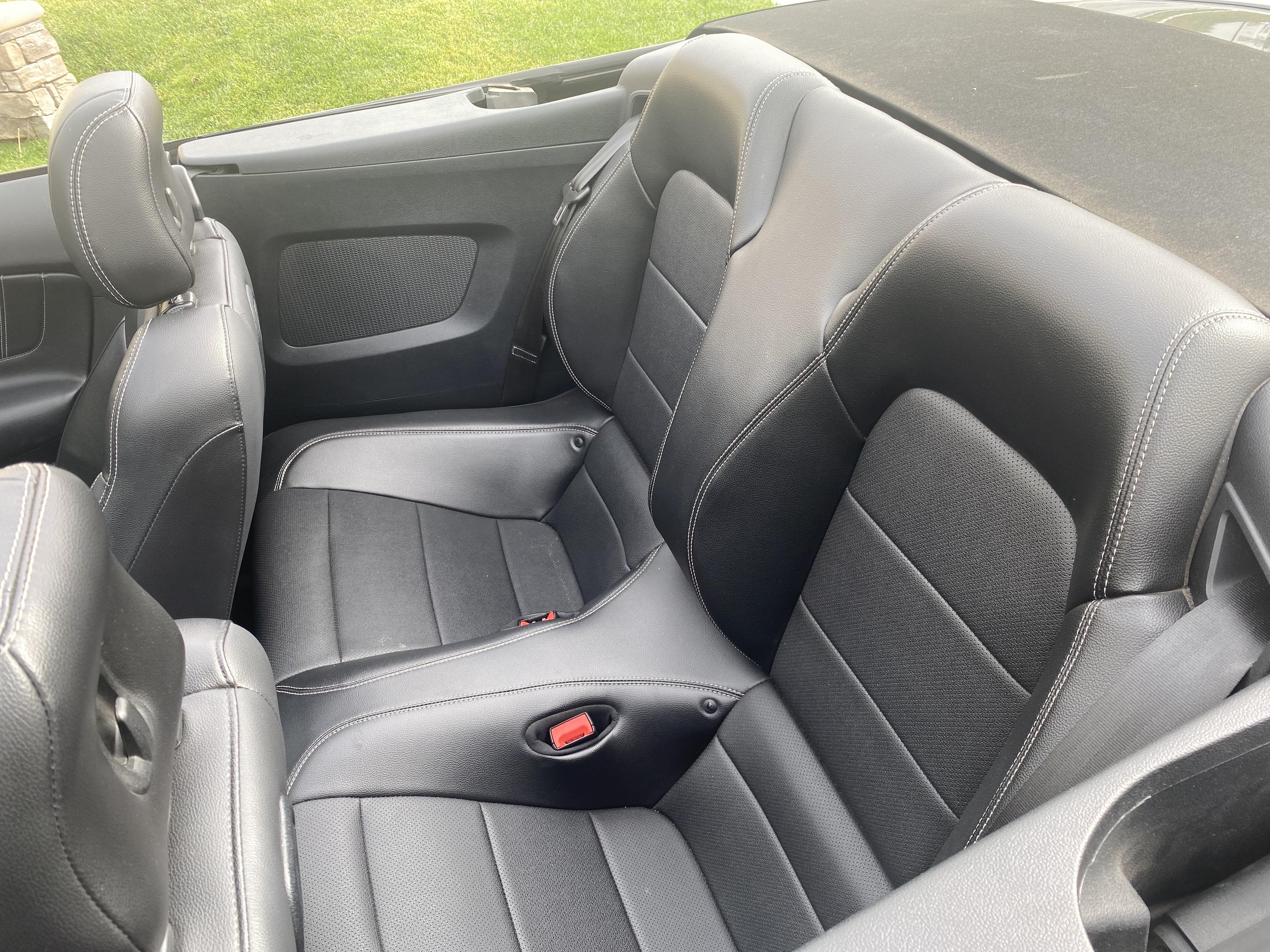

Image of rear panels from my real car.
Still need to make the remainder of the LED battery enclosure

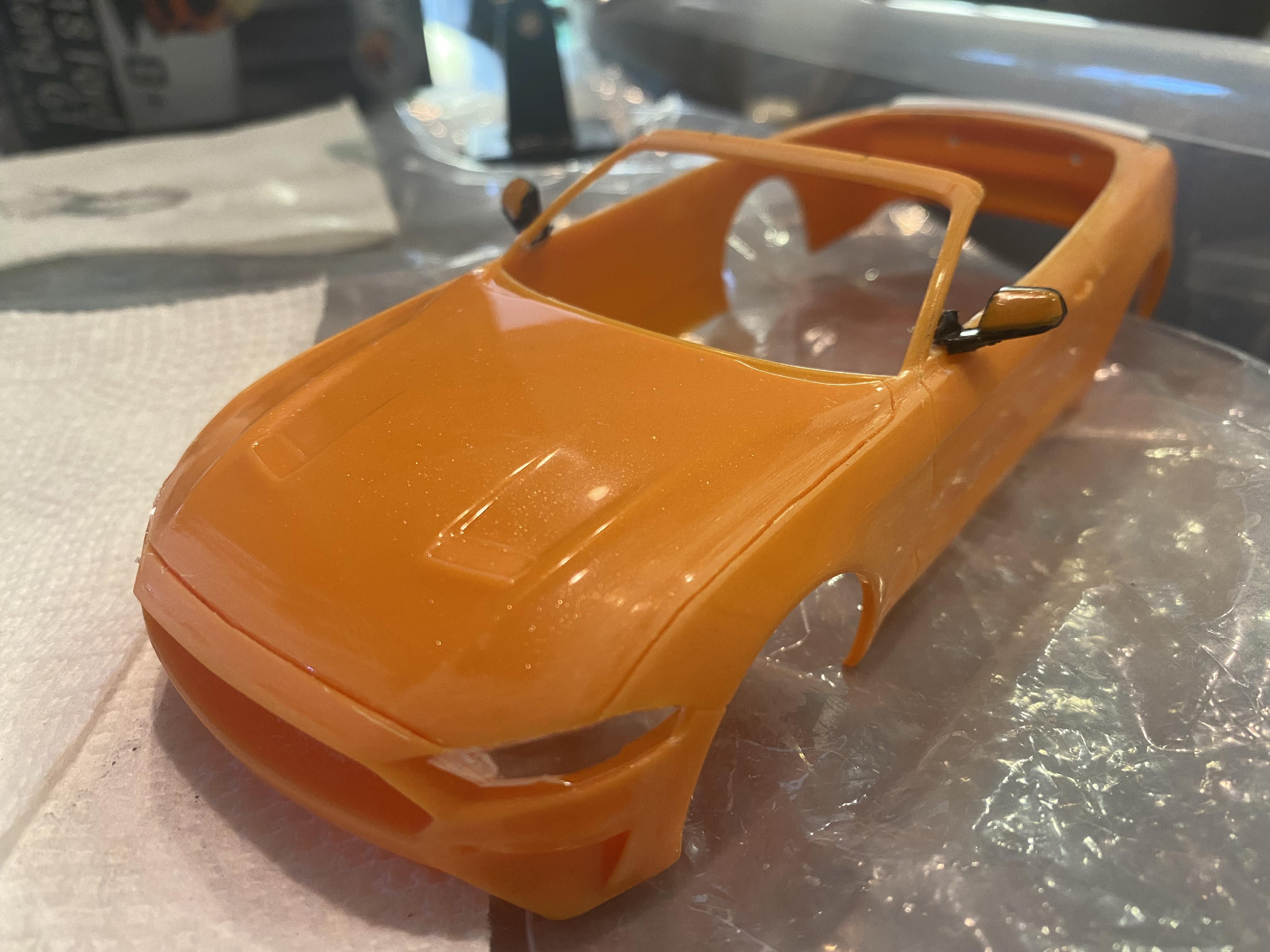

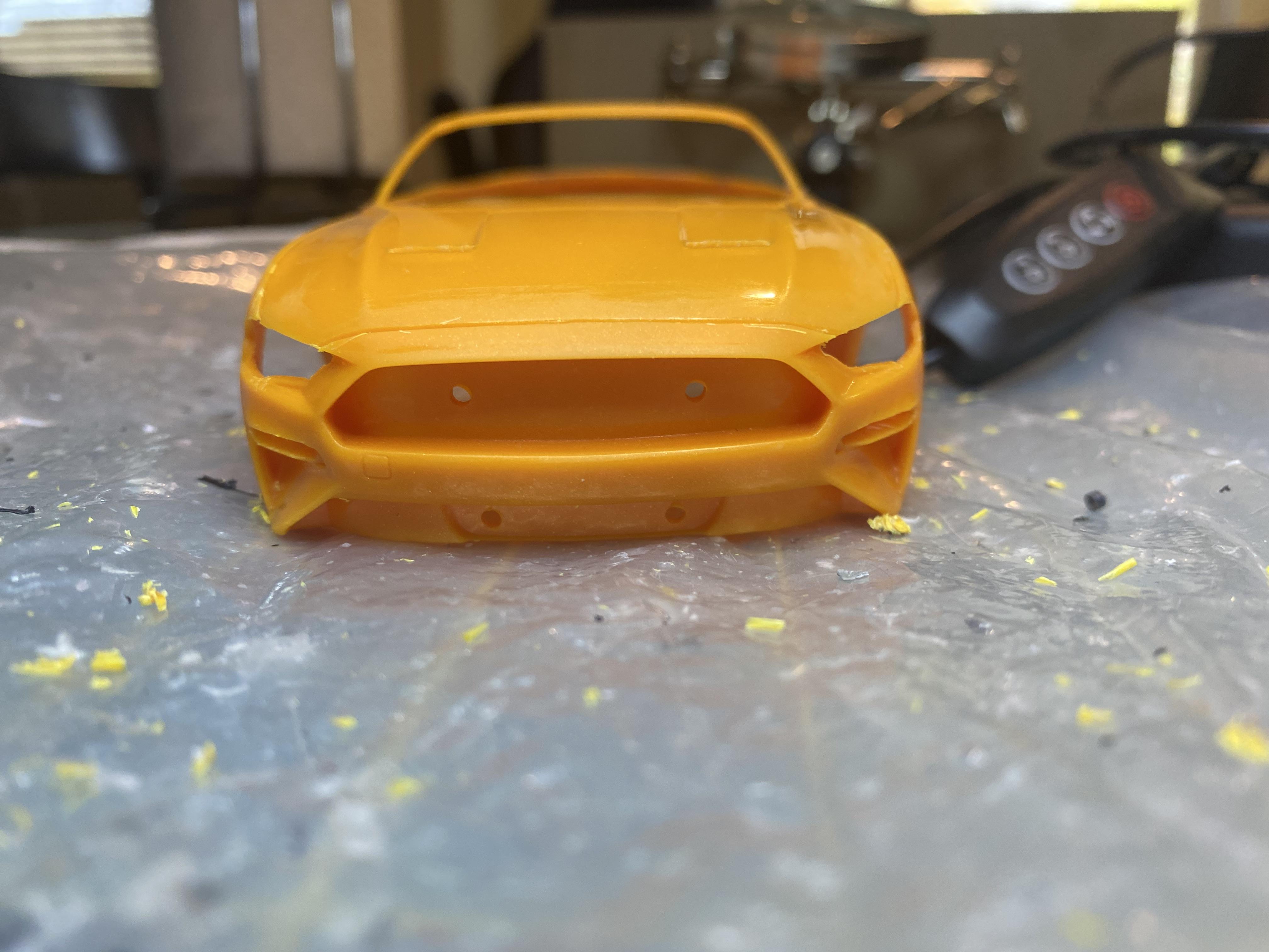

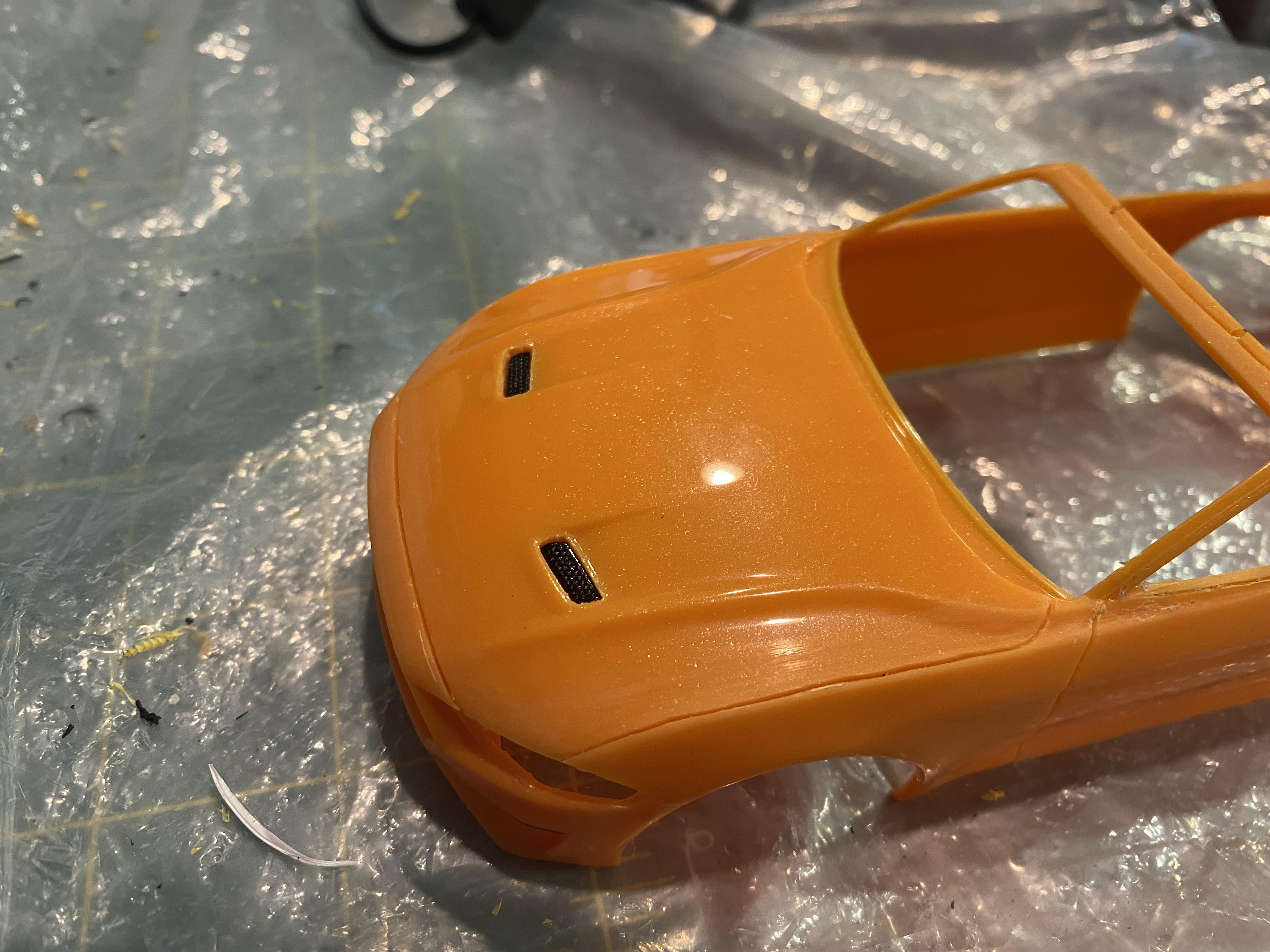

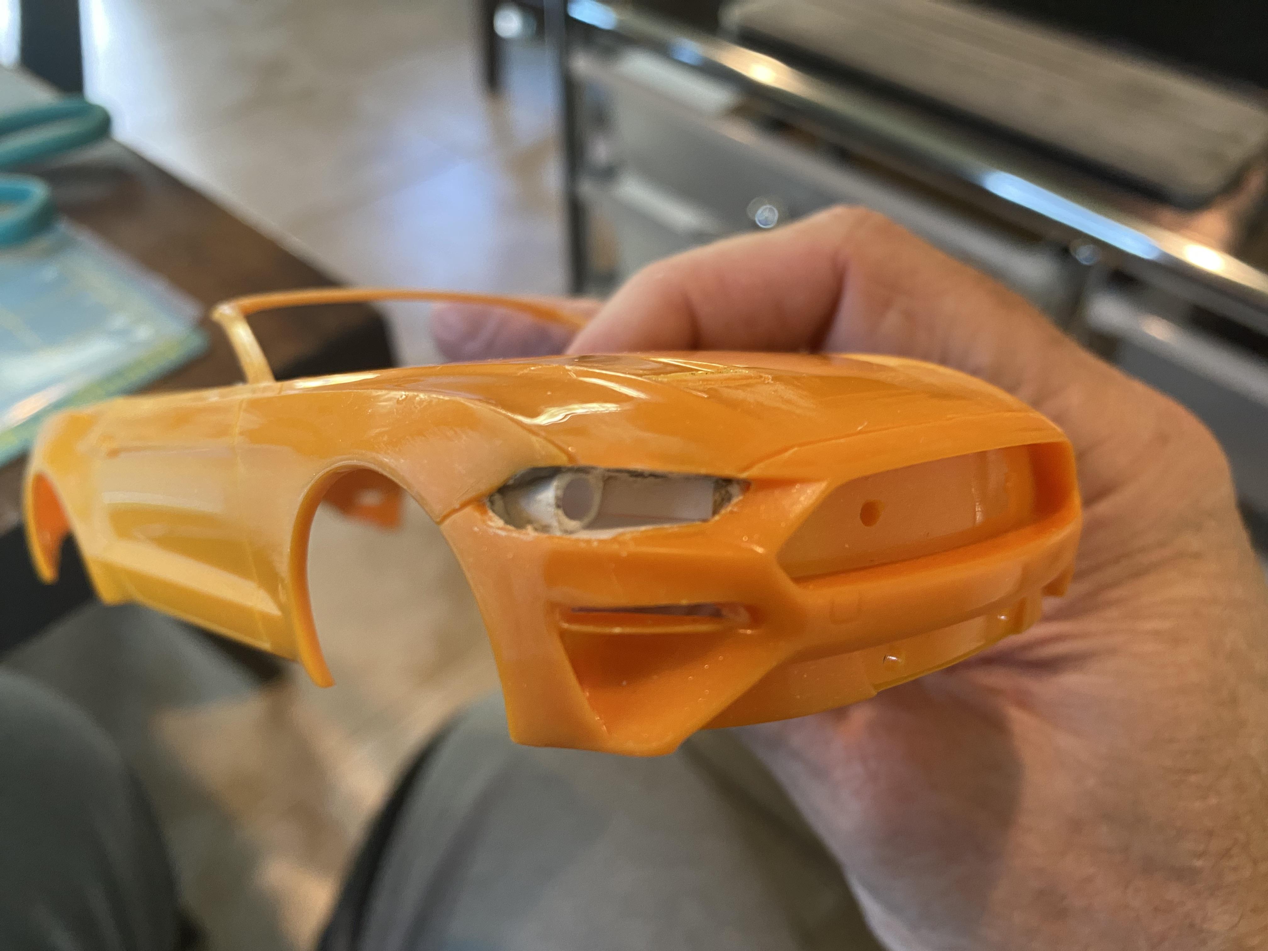

interior Fab is close to done, body has a lot of work still needed. I did cut in the hood vents and fit the vents from the diecast. Also cut the front parking light openings for fiber optics. Moving a bit slow at the moment.

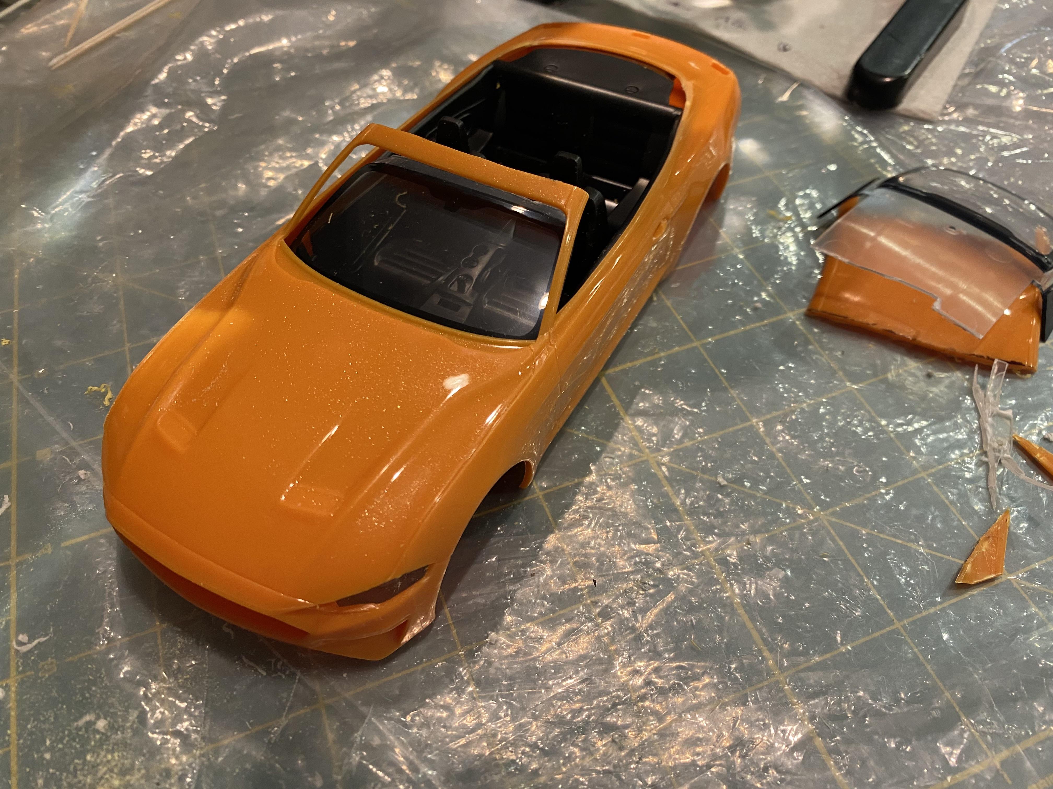

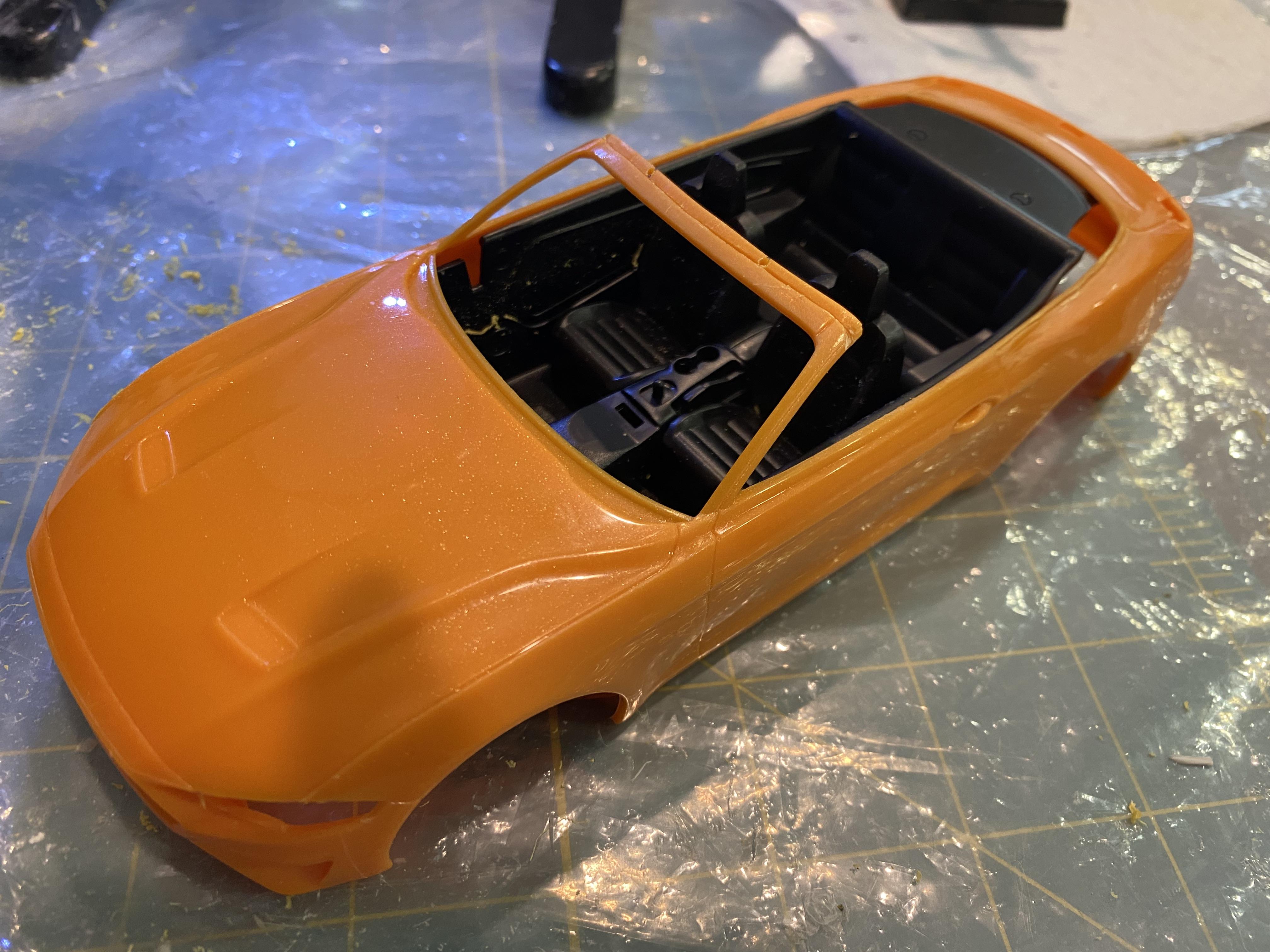

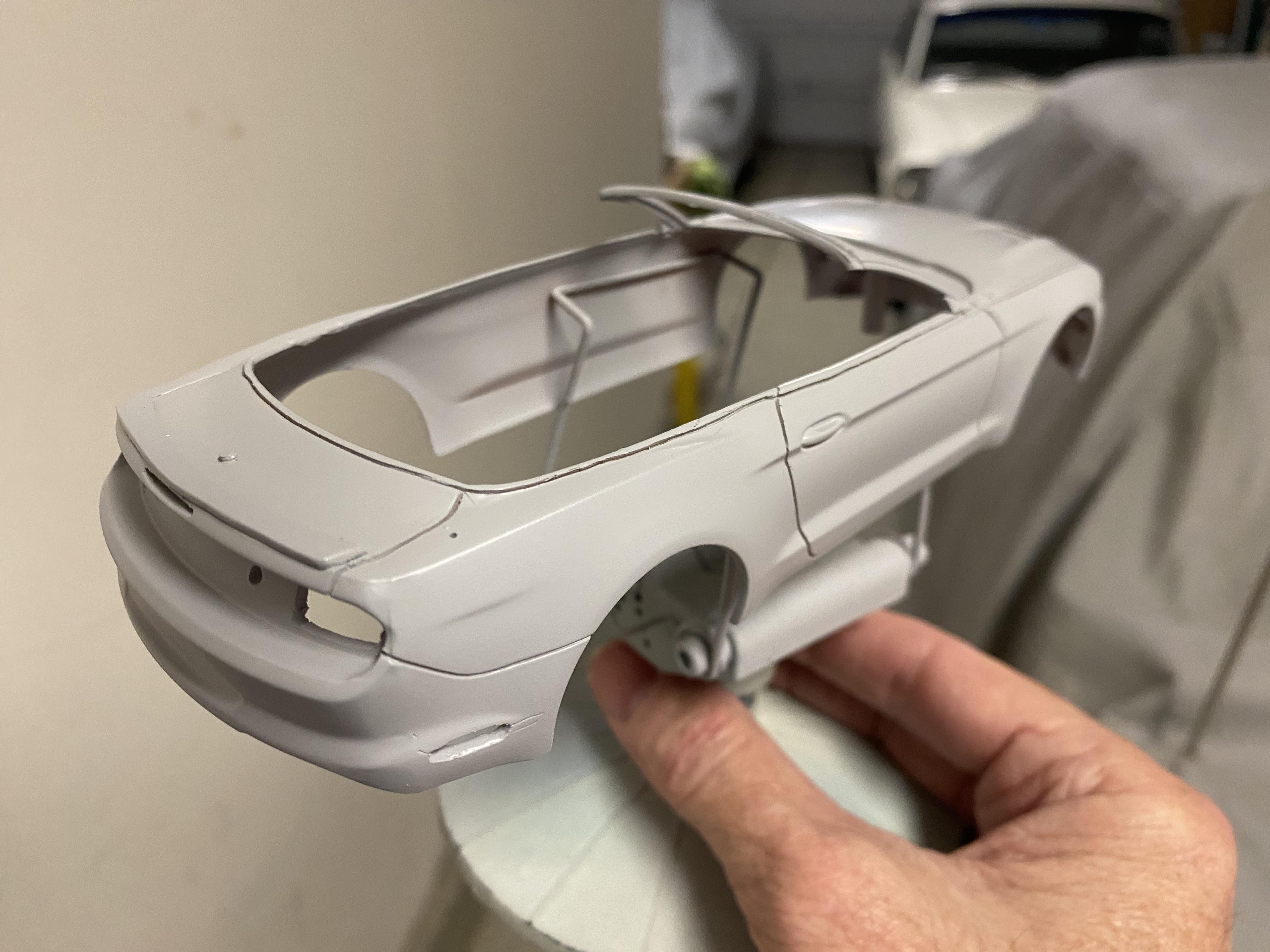

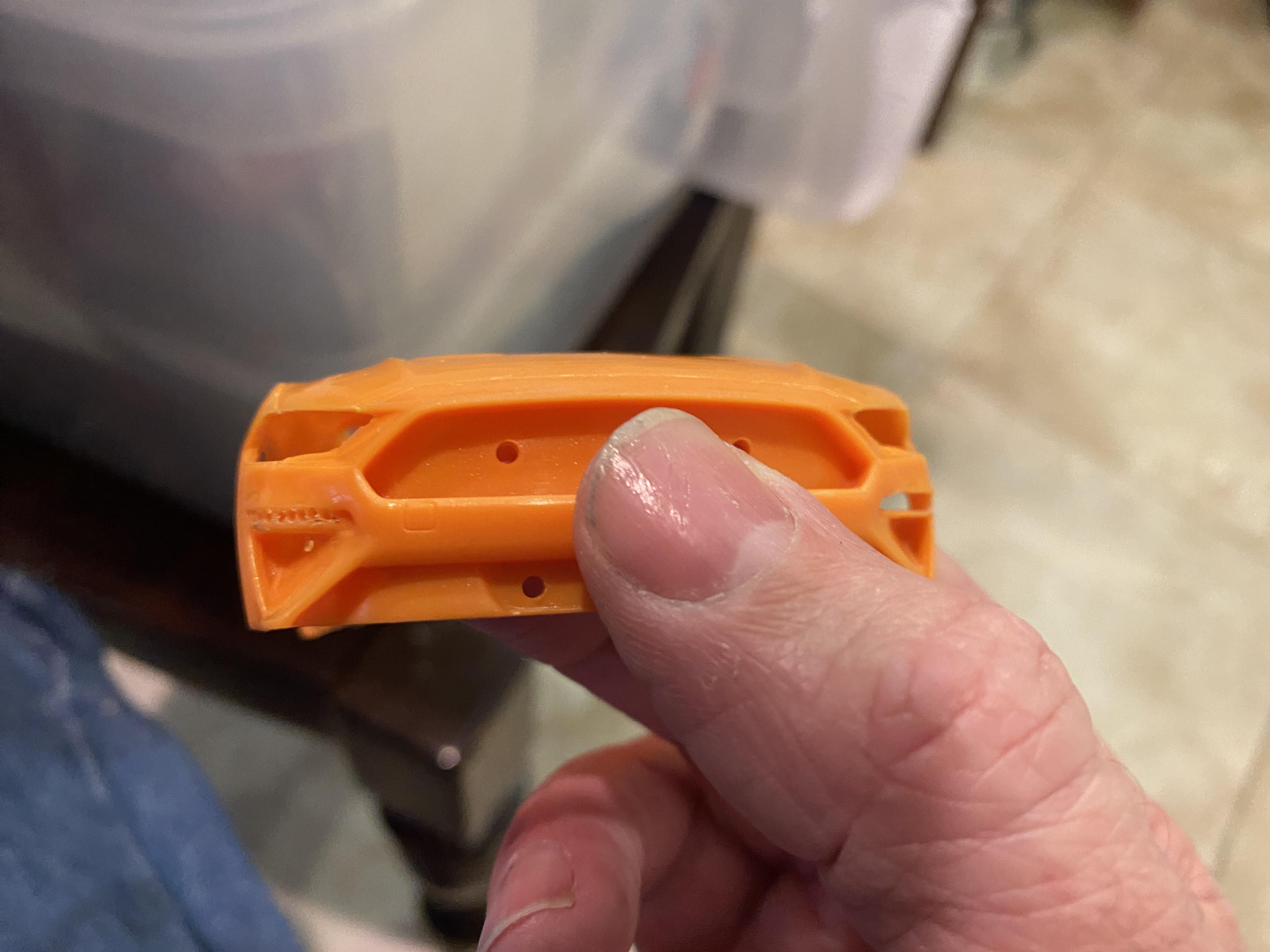

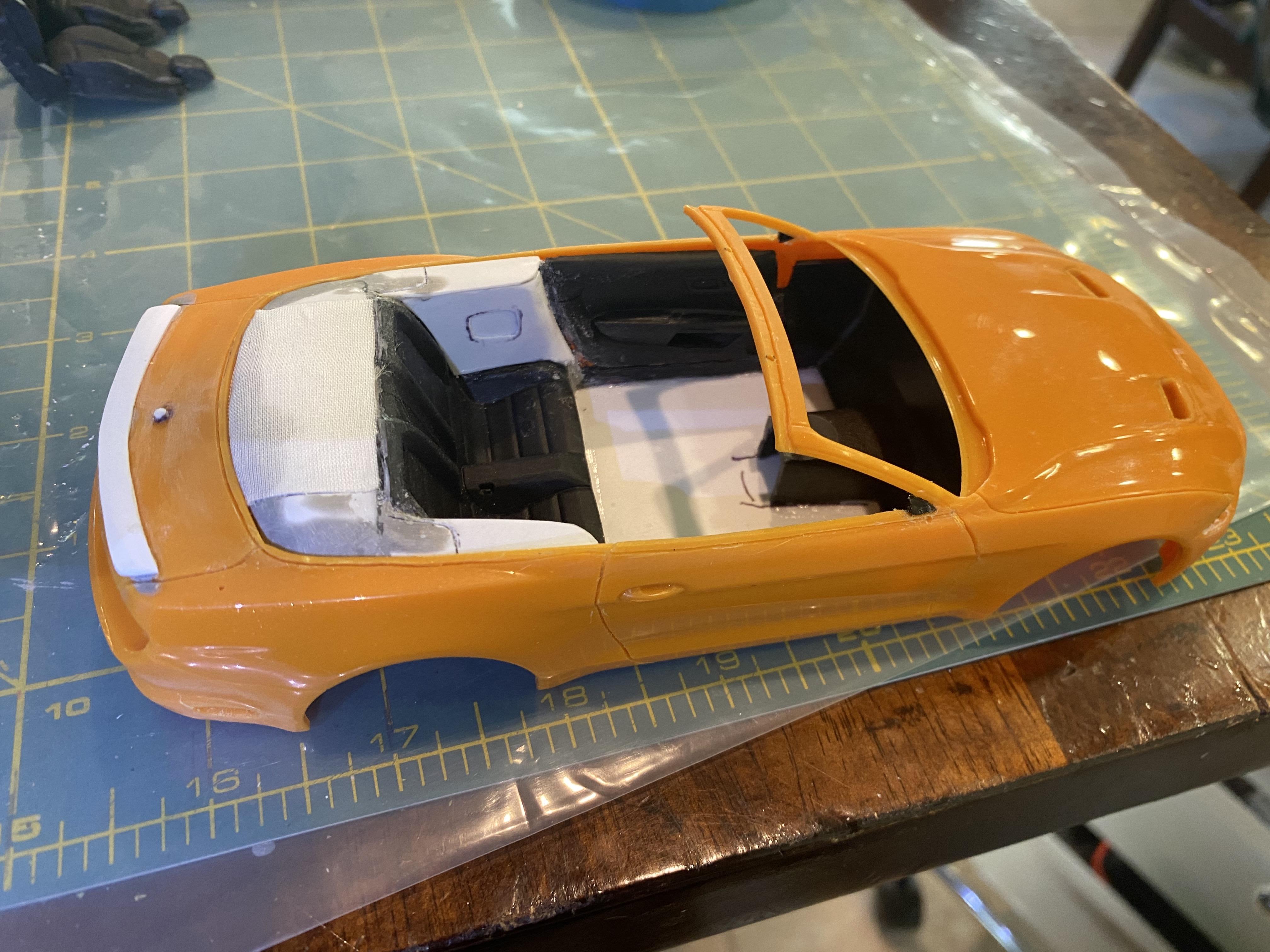

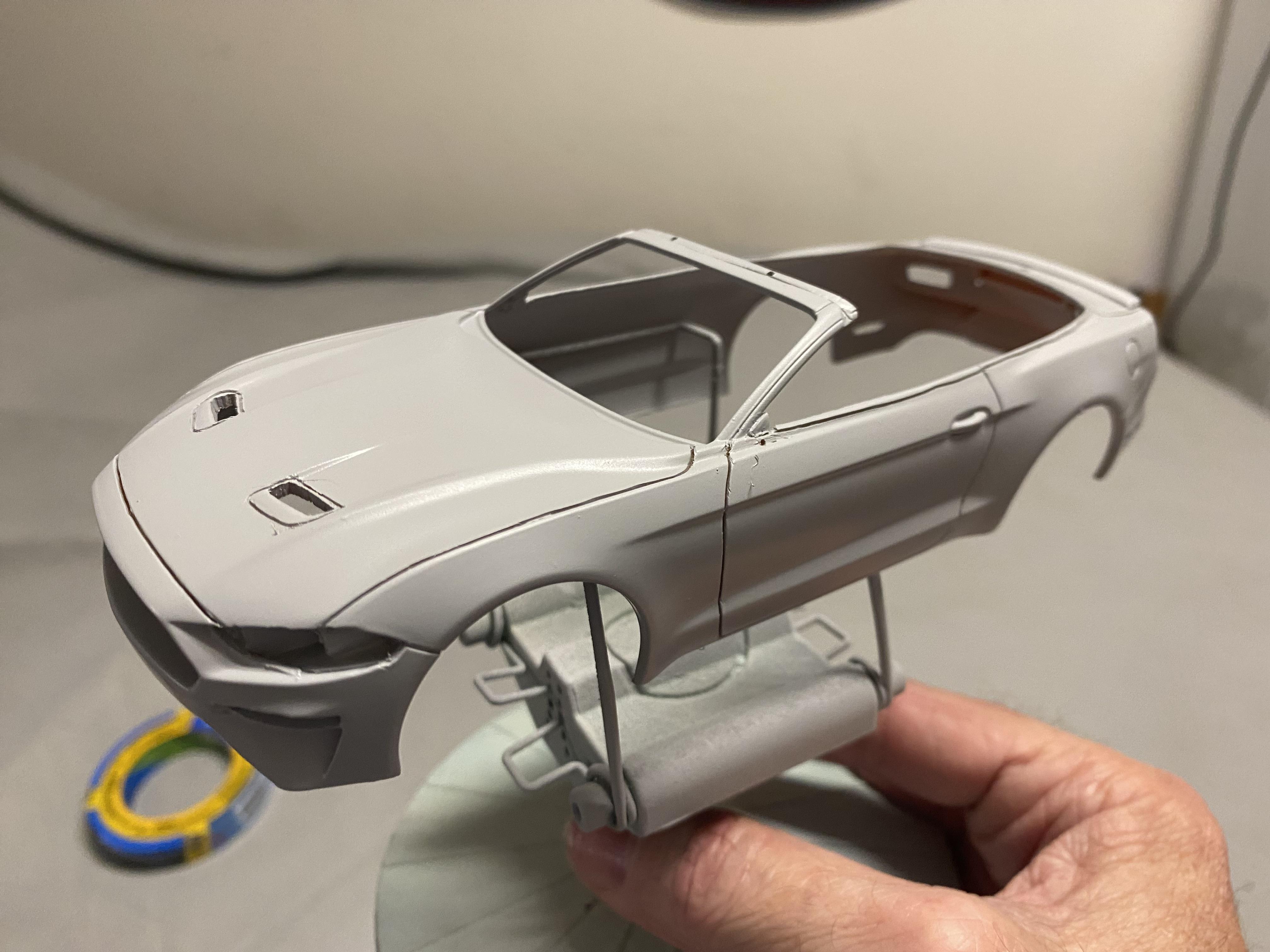

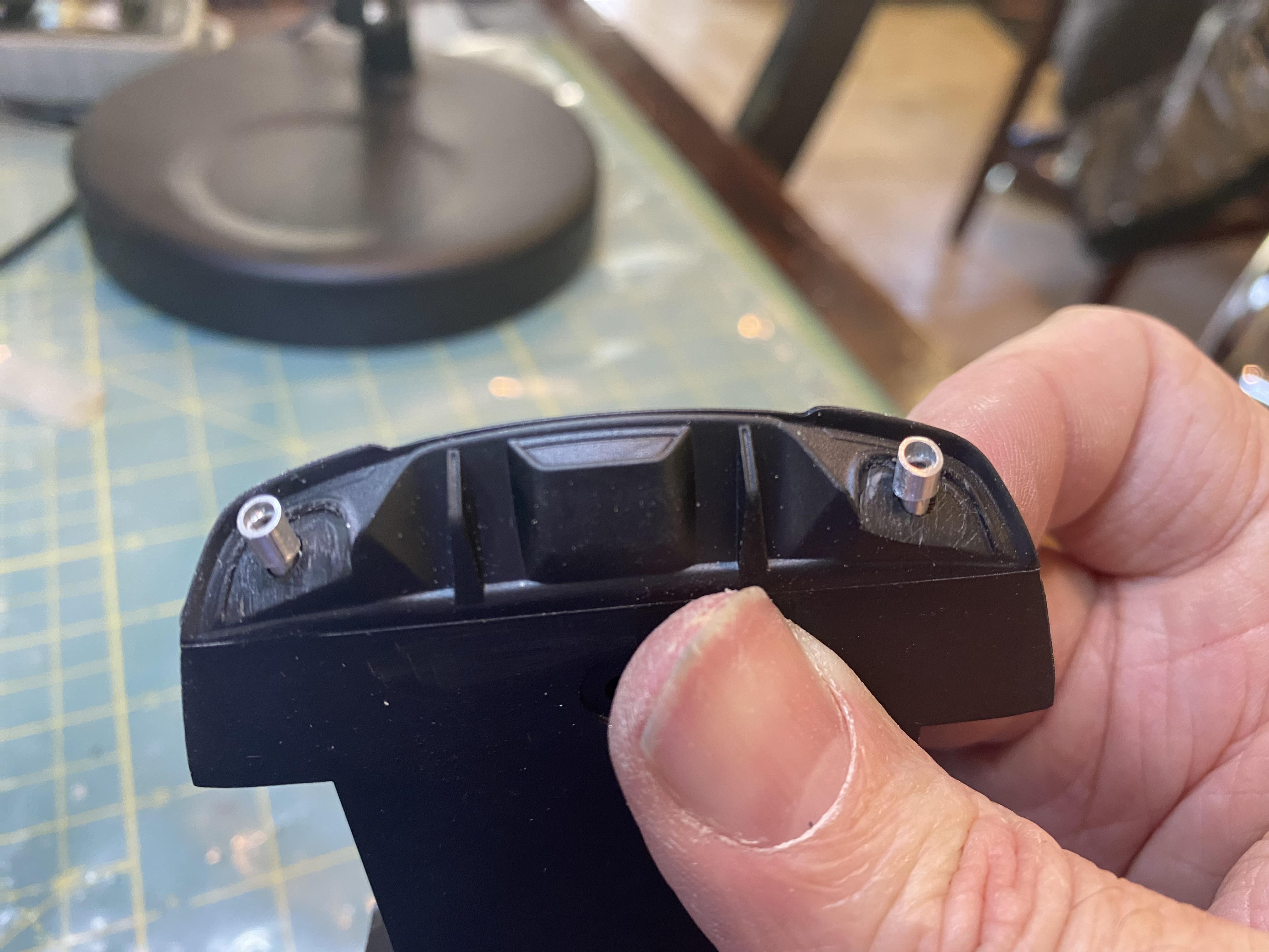

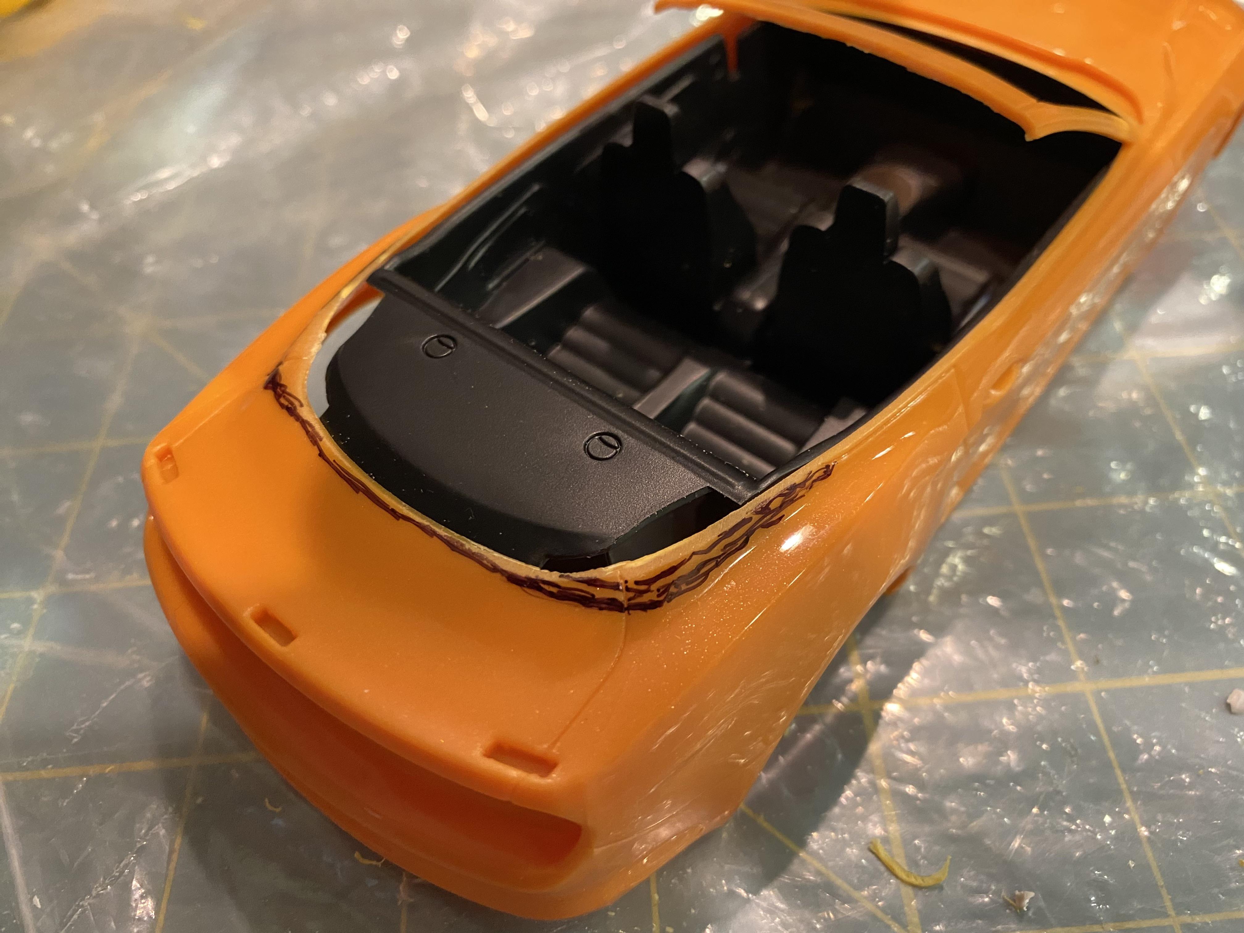

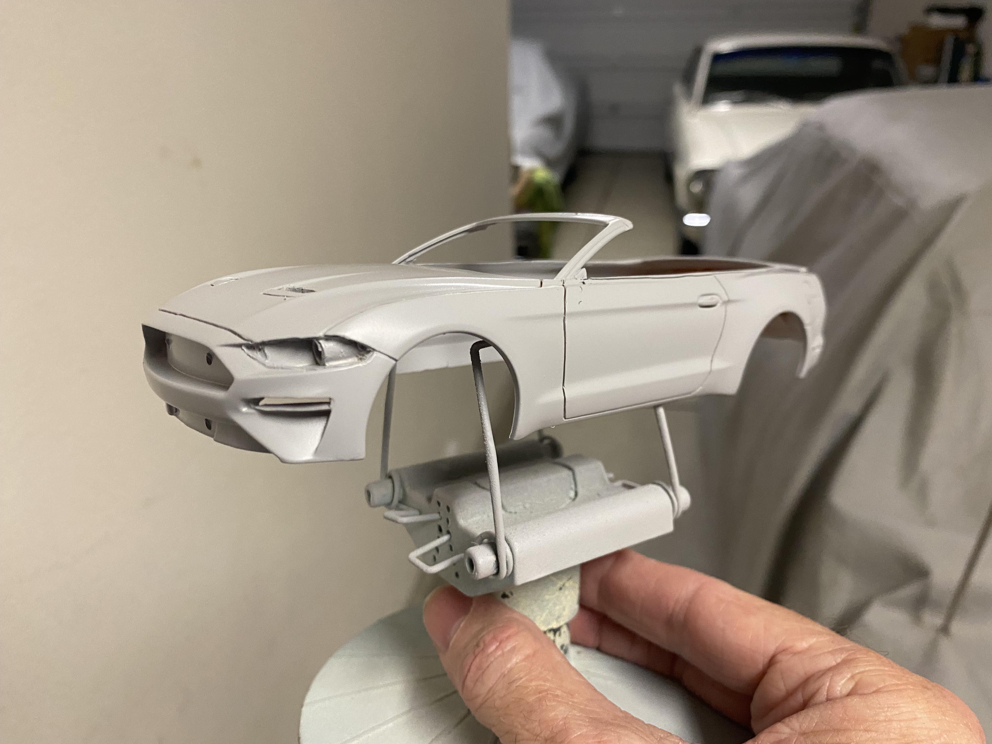

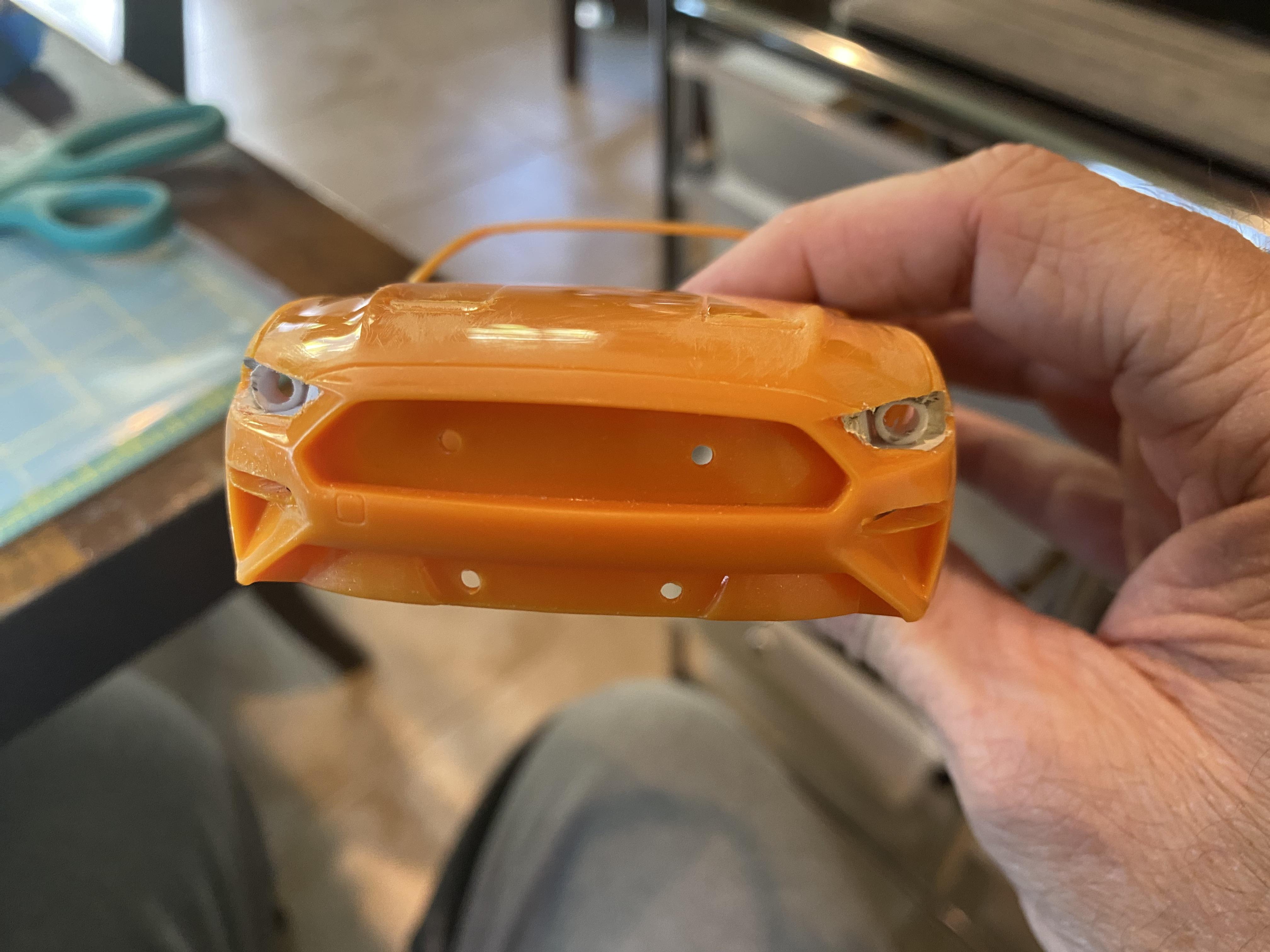

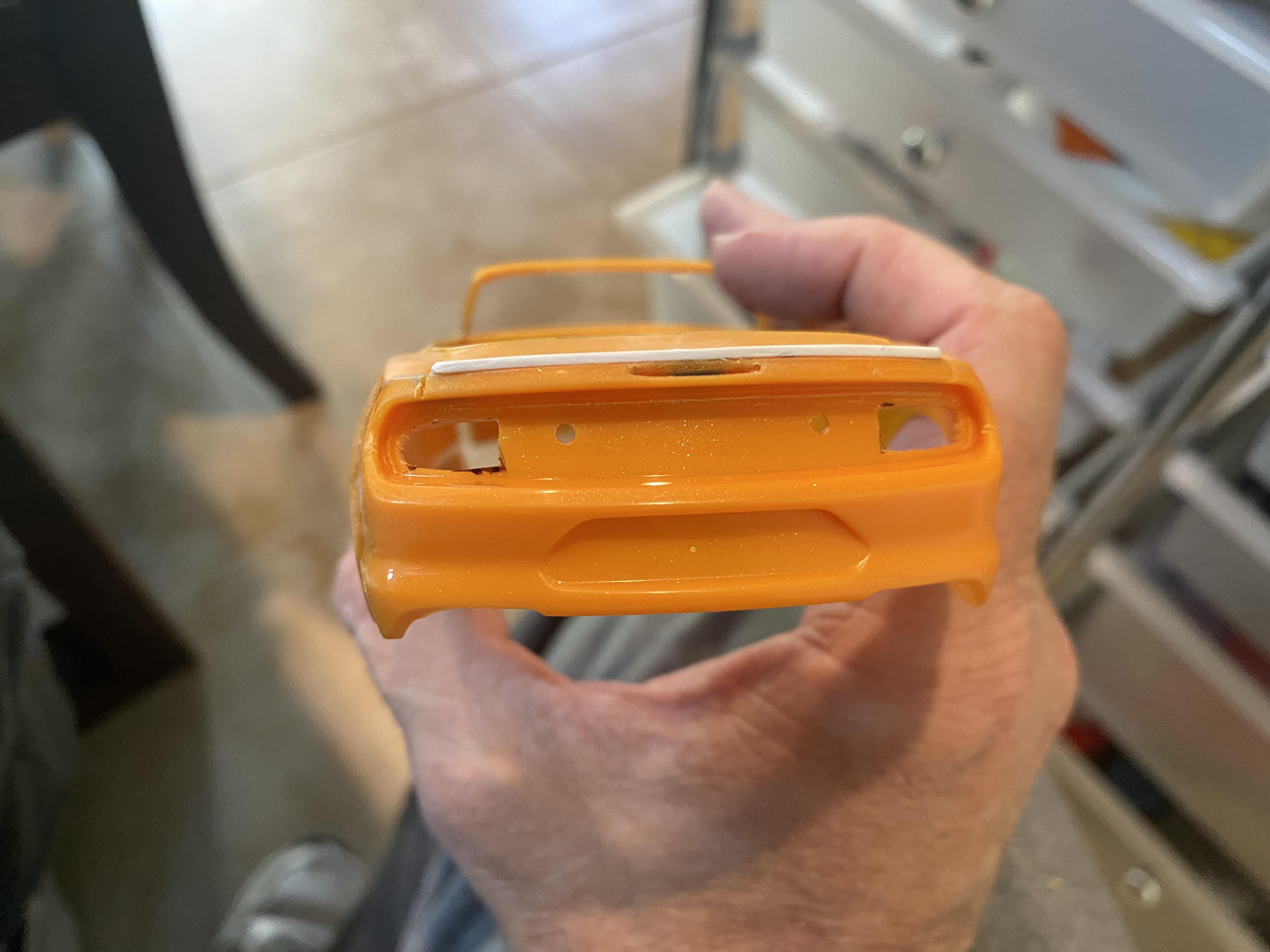

It had been a couple of weeks since I was able to do any work on this model, but finally got some time in today. Finished up the fabrication and mods for the body. Created the inner headlights. Cut out the taillights, marker lights and dash gauges and display in preparation for LEDs. IMG_3855.thumb.jpeg.53dca4b9ae46d3959c1c3709a3151291.jpegIMG_3856.thumb.jpeg.e9a89797431b40dd56662056f63bbf53.jpegIMG_3857.thumb.jpeg.c1459a21a3eae5dcae4e4208c764faa2.jpegIMG_3861.thumb.jpeg.4a856463837591fe7b50a682f579500c.jpegIMG_3863.thumb.jpeg.98f34da630c47806be2b7c4113397ac2.jpegIMG_3864.thumb.jpeg.d17593f66de8b34fcd5f6685333e3e49.jpeg
created the exhaust tips from aluminum tubing.
using surgical tape to give the exposed convertible a good representation of the top texture.
I couldn’t stand the toy like metallic orange molded plastic anymore so glad to have gotten a coat of primer on the body ready for sanding a filling blemishes. Can’t wait to see it in J7 Magnetic Metallic. I picked up a bottle of touch up paint for airbrushing to get a correct match for my real car.
IMG_3867.thumb.jpeg.5af275356a7da36a05e79f2f13d7d723.jpegIMG_3868.thumb.jpeg.bb0e676abd030b9429a615fe600c5bfc.jpegIMG_3870.thumb.jpeg.80b8c51b4b491fc11da807db3b45f0fd.jpeg
