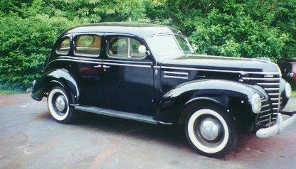

LennyB Posted February 15 Author Share Posted February 15 Maybe I was right the first time I built this kit by turning it into a 1939 P8 Quote Link to comment Share on other sites More sharing options...
customline Posted February 15 Share Posted February 15 1 hour ago, LennyB said: Maybe I was right the first time I built this kit by turning it into a 1939 P8 Lenny, you gotta show me the '39. Please. (I have an unnatural thing for the '39) Quote Link to comment Share on other sites More sharing options...
LennyB Posted February 15 Author Share Posted February 15 20 hours ago, customline said: Lenny, you gotta show me the '39. Please. (I have an unnatural thing for the '39) OK, I'll have to see where my father has it. I don't remember the last time I saw it and I'm sure it's not too accurate. In the meantime here's the real one I restored. 1 Quote Link to comment Share on other sites More sharing options...
customline Posted February 15 Share Posted February 15 37 minutes ago, LennyB said: OK, I'll have to see where my father has it. I don't remember the last time I saw it and I'm sure it's not too accurate. In the meantime here's the real one I restored. Oh that's a beauty, Len. When was the restoration done? Quote Link to comment Share on other sites More sharing options...
LennyB Posted February 16 Author Share Posted February 16 1 hour ago, customline said: Oh that's a beauty, Len. When was the restoration done? Back in 1999 for my parents 40th wedding anniversary. Quote Link to comment Share on other sites More sharing options...
