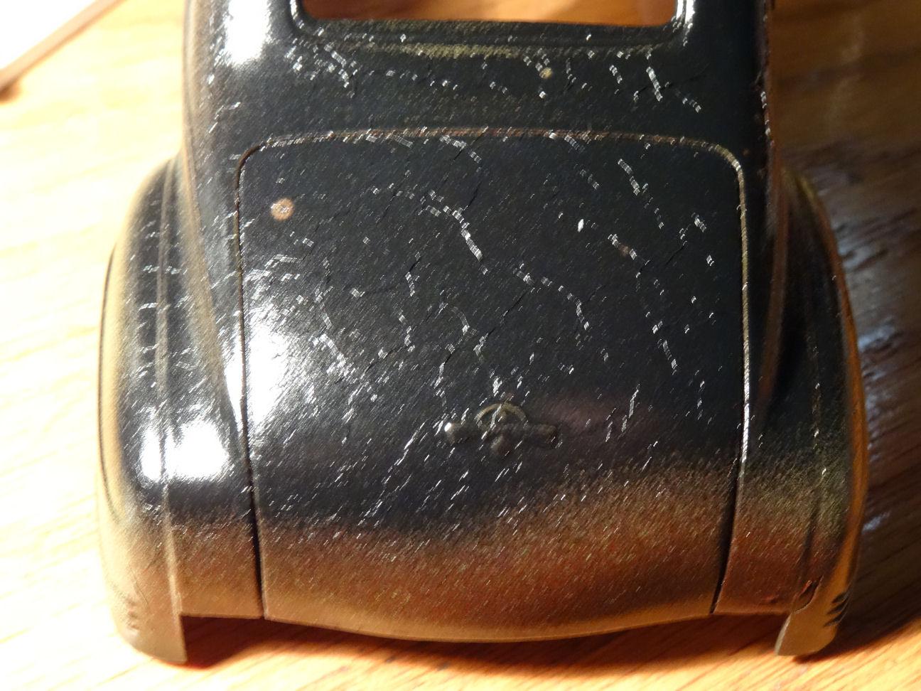

LennyB Posted May 10, 2024 Author Posted May 10, 2024 Think I need to have a little talk with the people at Createx....they say you can put any clear over their Wicked paints. Well this is what happens when you use Tamiya TS-13 clear. Didn't effect the primer at the lower rear, just the Wicked black. And it's been dry for over a week. Not exactly the results I was looking for. Fortunately this is just a test subject so no real harm done. Anyone else ever have this issue with these paints???? Comments greatly appreciated. I previously used some Testors Gloss Clear and it went on without a problem. Just found it laid on too heavy direct from the can. Thinking of decanting it and using an airbrush. But what I really want to do is use a 2K. 1
customline Posted May 10, 2024 Posted May 10, 2024 Paint....the final frontier......?.....there's gotta be an explanation.....right? ?
NOBLNG Posted May 10, 2024 Posted May 10, 2024 33 minutes ago, LennyB said: Think I need to have a little talk with the people at Createx....they say you can put any clear over their Wicked paints. Well this is what happens when you use Tamiya TS-13 clear. Didn't effect the primer at the lower rear, just the Wicked black. And it's been dry for over a week. Anyone else ever have this issue with these paints???? Comments greatly appreciated. I previously used some Testors Gloss Clear and it went on without a problem. Just found it laid on too heavy direct from the can. FWIW, I have found Tamiya spray clears to be quite Hot! They will craze paint that Mr. hobby or Testors doesn’t.
bobss396 Posted May 10, 2024 Posted May 10, 2024 I tend to use TS-13 or TS-65 with strictly Tamiya sprays. I have used it over Duplicolor and it was fine.
LennyB Posted May 10, 2024 Author Posted May 10, 2024 3 hours ago, bobss396 said: I tend to use TS-13 or TS-65 with strictly Tamiya sprays. I have used it over Duplicolor and it was fine. Thanks for the info. I thought about trying the Duplicolor clear. But right now it's 99% humidity and not expected to change for a few days. So clearcoats are out of the question.
