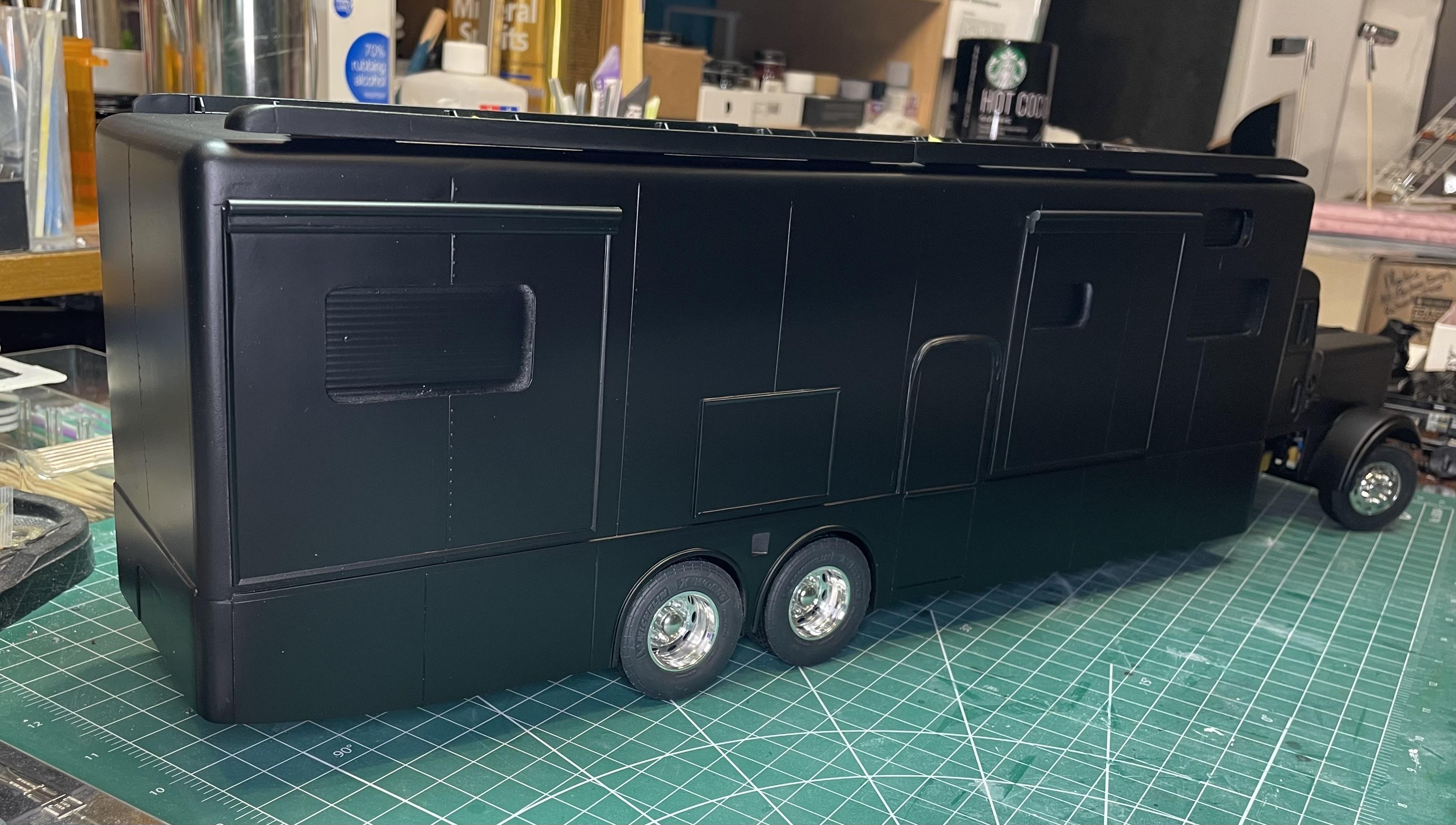

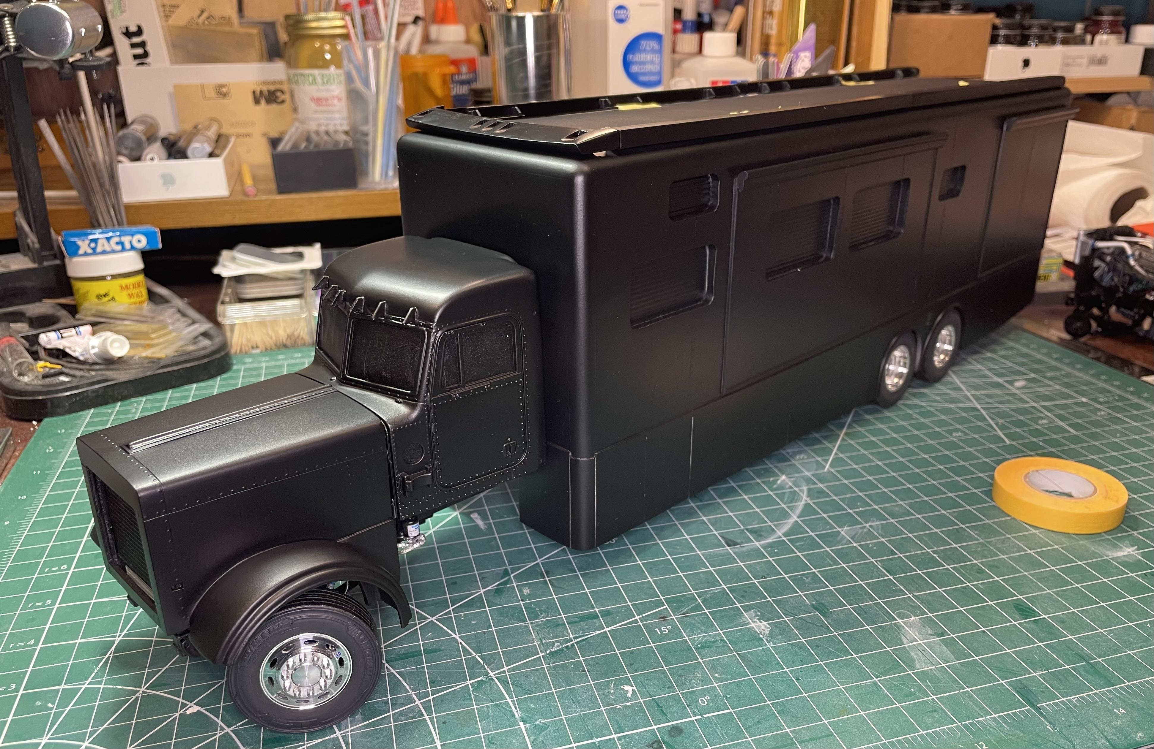

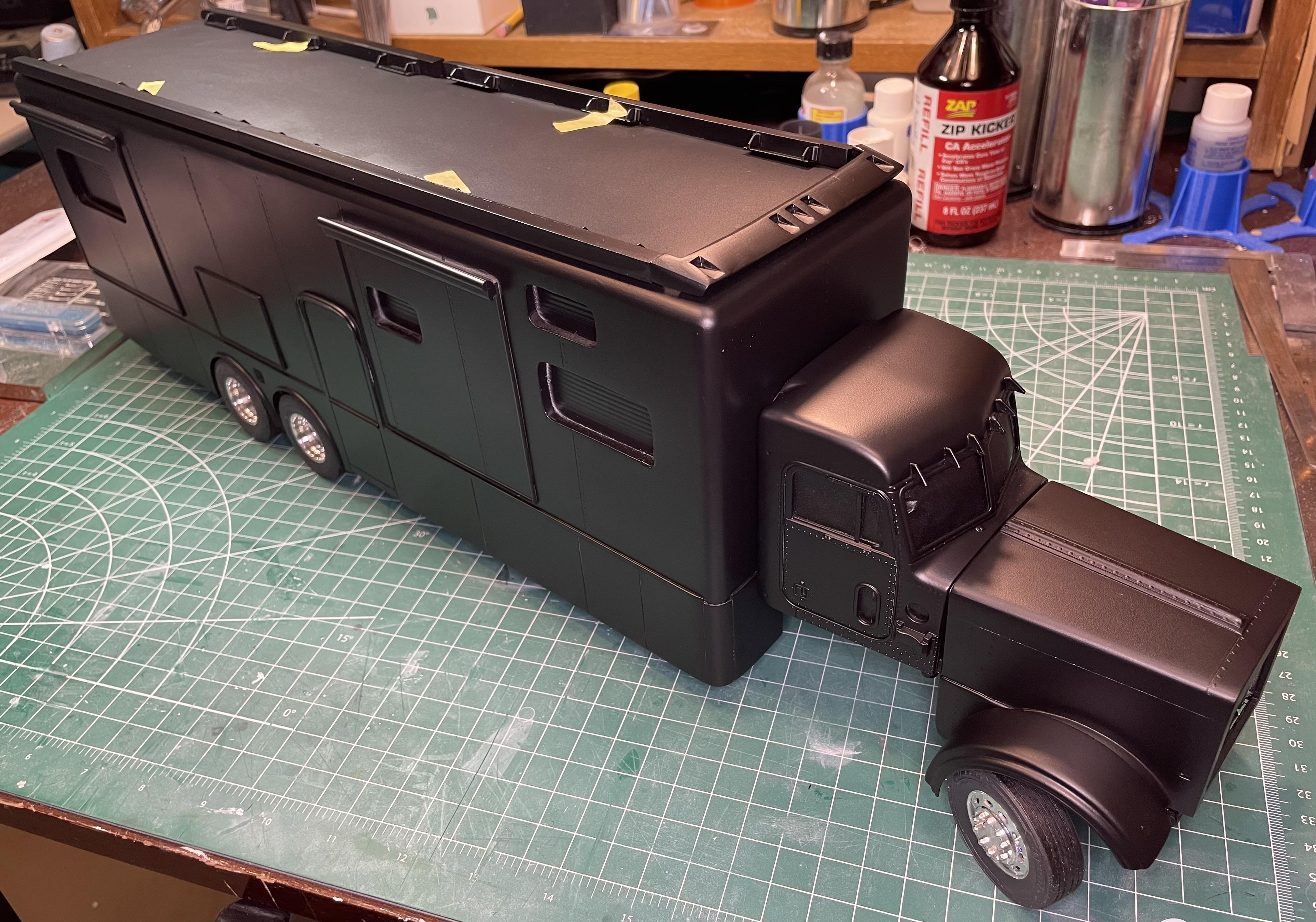

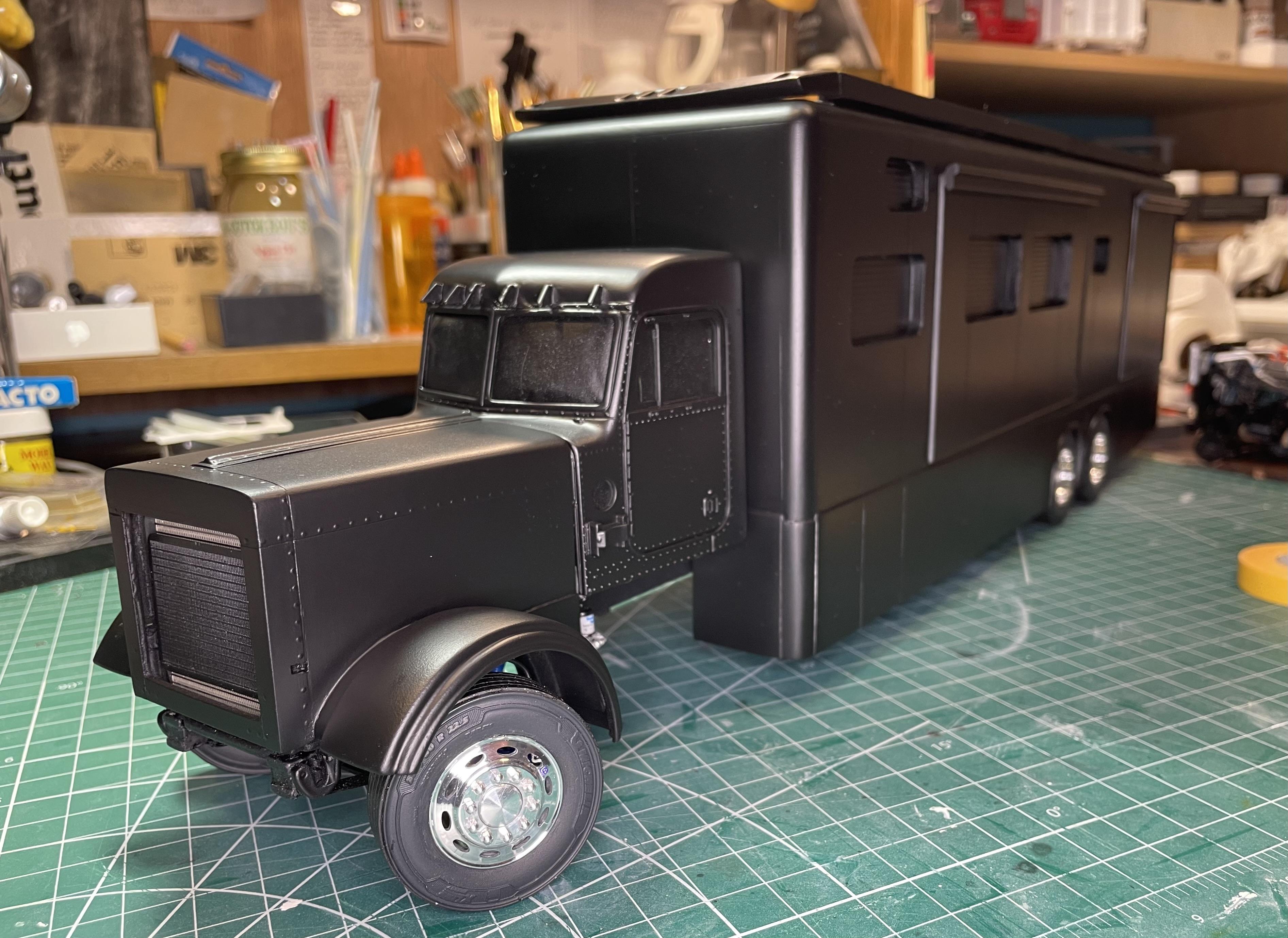

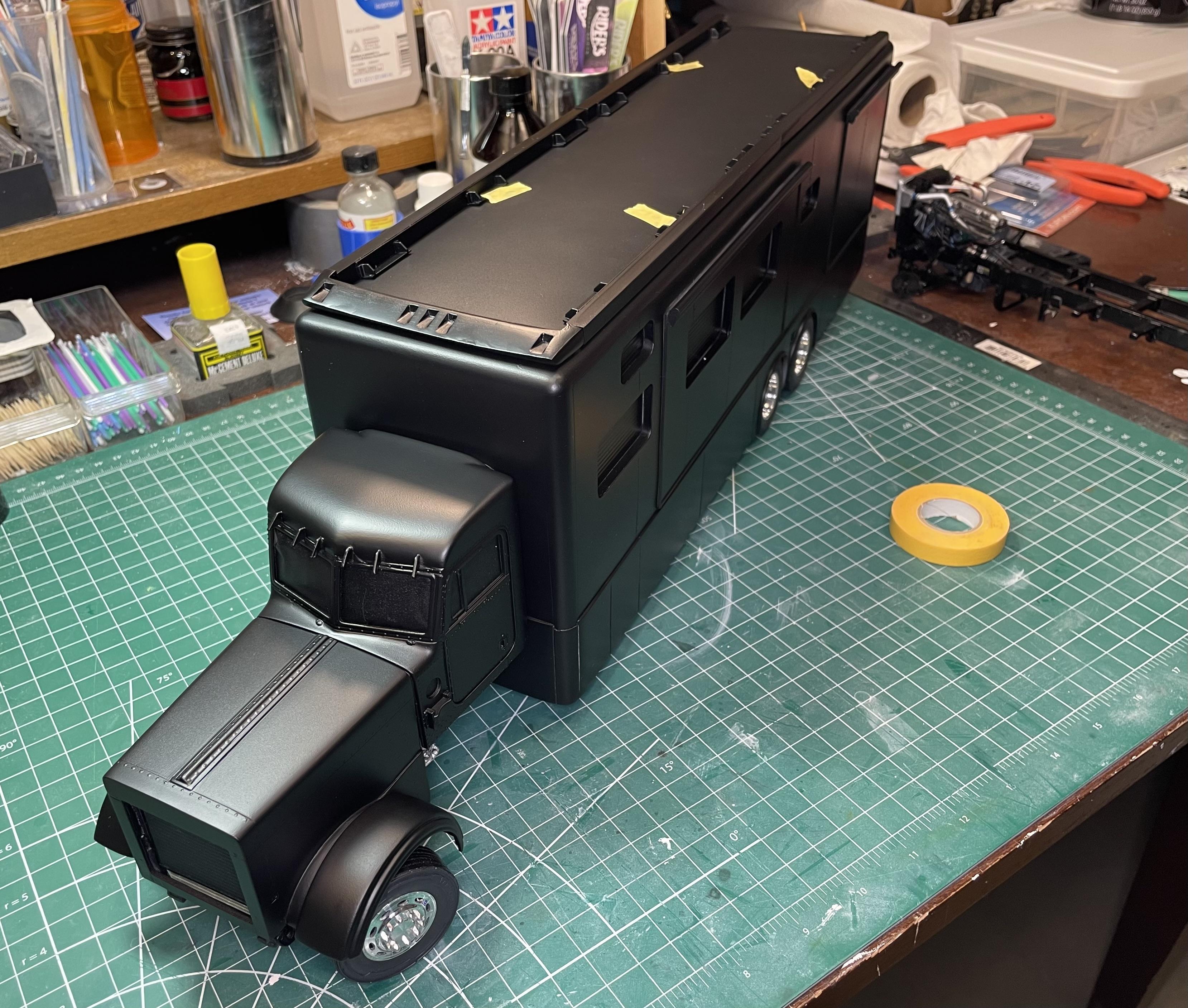

Mock up time! Primer arrived today, so I was able to put on another coat. Mr. Hobby Mr. Surfacer 1500 Black. Great stuff.
IMG_0273.jpeg.781c9609ad8cdb0fd351a68e984972c0.jpegIMG_0276.jpeg.e701883388c489a9d3288134e3f7698e.jpegIMG_0274.jpeg.a3f6246b91a3c85fd3374f937fc964e4.jpegIMG_0275.jpeg.89903d5d3f406f99cd8852656e2b5507.jpegIMG_0277.jpeg.abc9783bbb78334b487efa793cc08f0a.jpegIMG_0278.jpeg.3f6fc4009d05a0a168863c4d37bf98b2.jpegLooks pretty sinister in all satin black? (Maybe an idea for a future build?). Plenty of chrome, aluminum and stainless will be added along with a glossy black finish. Some final fitting and adjustment will be needed with the body, cab, hood, and chassis, but overall it fits together well.

Looks very special and luxurious in all black.
It could pass as a full sized RV limousine.
Great details on engines also!
  • Thanks 1

11 hours ago, BK9300 said:
Geez, Victor, the primer looks awesome - could be an expensive (very!) vinyl wrap job in real life!
True, I may use it for a finish of another build in the future. I’ve had very good luck with that primer.
5 hours ago, Rockford said:
It does look special in black, your bodywork looks straight too! Tidy piece of work.
Thanks, I appreciate that. This evening I did a little more touch up, mainly on the rooftop awning fairing in front. Never-ending body work.

Satin black looks great!
Could be Batman's RV! 😉
Just a joke! That finish is really nice. And that's "just" a primer? Awesome!
  • Haha 1
Thanks, and yes that’s primer. Apparently there’s a shortage of supply for the Mr Hobby 1500 Black primer, according to my local hobby shop. They haven’t received any since July. I was able to order some online.

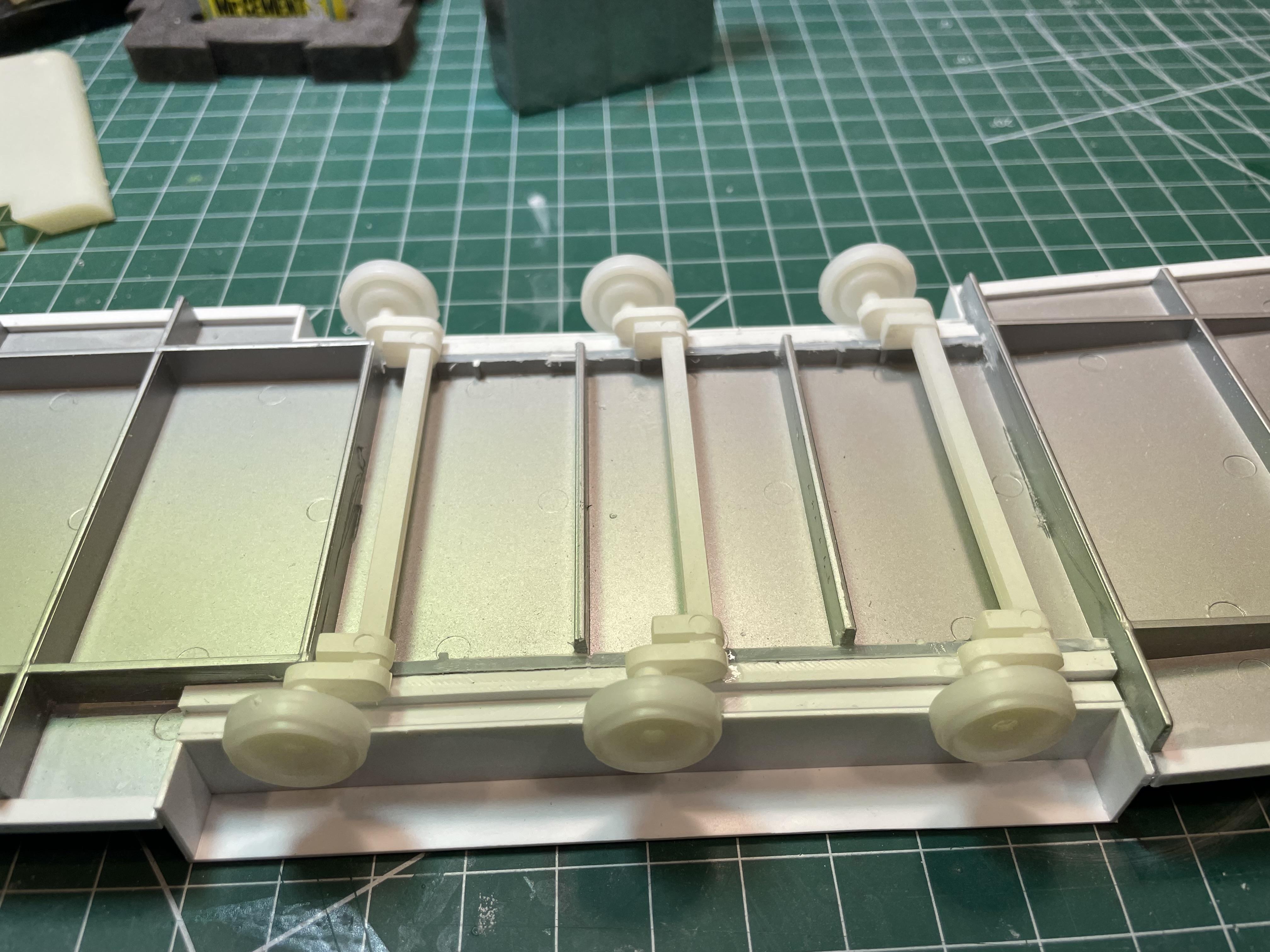

I’m beginning work on the stacker trailer, with the plan to paint the coach body and trailer at the same time.
IMG_0378.jpeg.fbc608f4ddd9d61f6a289f9ca6bb4ded.jpegThe trailer will be loosely based on 24’ triple-axle models from Intech and T&E trailers, typical of what’s being custom-built today for use behind toterhomes and diesel pushers. It’ll match the 379 RV - all black with stainless lower sides. I plan to have a fully-detailed interior with cabinets and a 14’ lift.
IMG_0424.jpeg.04fb84f1bcbea3891ac4127f444fe2b3.jpegFor the frame and floor, I’ve sourced parts from a partially-built Galaxie Limited 5th wheel enclosed trailer kit. I modified the length to match a scale 24’, added the bumper pull tongue from another kit and lengthened the tongue to a scale 5’ (extended tongues make it less likely to hit the coach body in sharp turns).
IMG_0425.jpeg.c6ec304c6662a287b7105a1e40944443.jpegIMG_0426.jpeg.7913ea1c06b557208079e55f85c2d723.jpegOut of the box, the floor width is too narrow, so it was widened 1/8” on each side with styrene strip for an overall width of 102” (with the sidewalls in place) in 1/24 scale. I cut out the kit’s inner fenders and replaced them with taller and longer ones made from styrene sheet. The wheels and tires will be 19.5”, and the axles will have a 42” spacing, more typical of modern stacker trailers.
IMG_0427.jpeg.42a3861f8e9c84305c77779ddb86804b.jpegIMG_0428.jpeg.02354a64b2b28801289726188d553aae.jpegIMG_0430.jpeg.06294b77d5abb98a34c7d2f7a67b38a3.jpegTo lower the ride height of the floor to the more realistic 14” ground clearance of most stackers, I modified the frame for the axles. I’m using the kit’s inner wheels as rudimentary disc brake assemblies to add width to the axles. The wheels are oval hole 19.5s from Scenes Unlimited. Tires are 19.5 Bridgestone steer/trailer tires from Moluminum. Next, I’ll be working on the sidewalls.
  • Like 2
