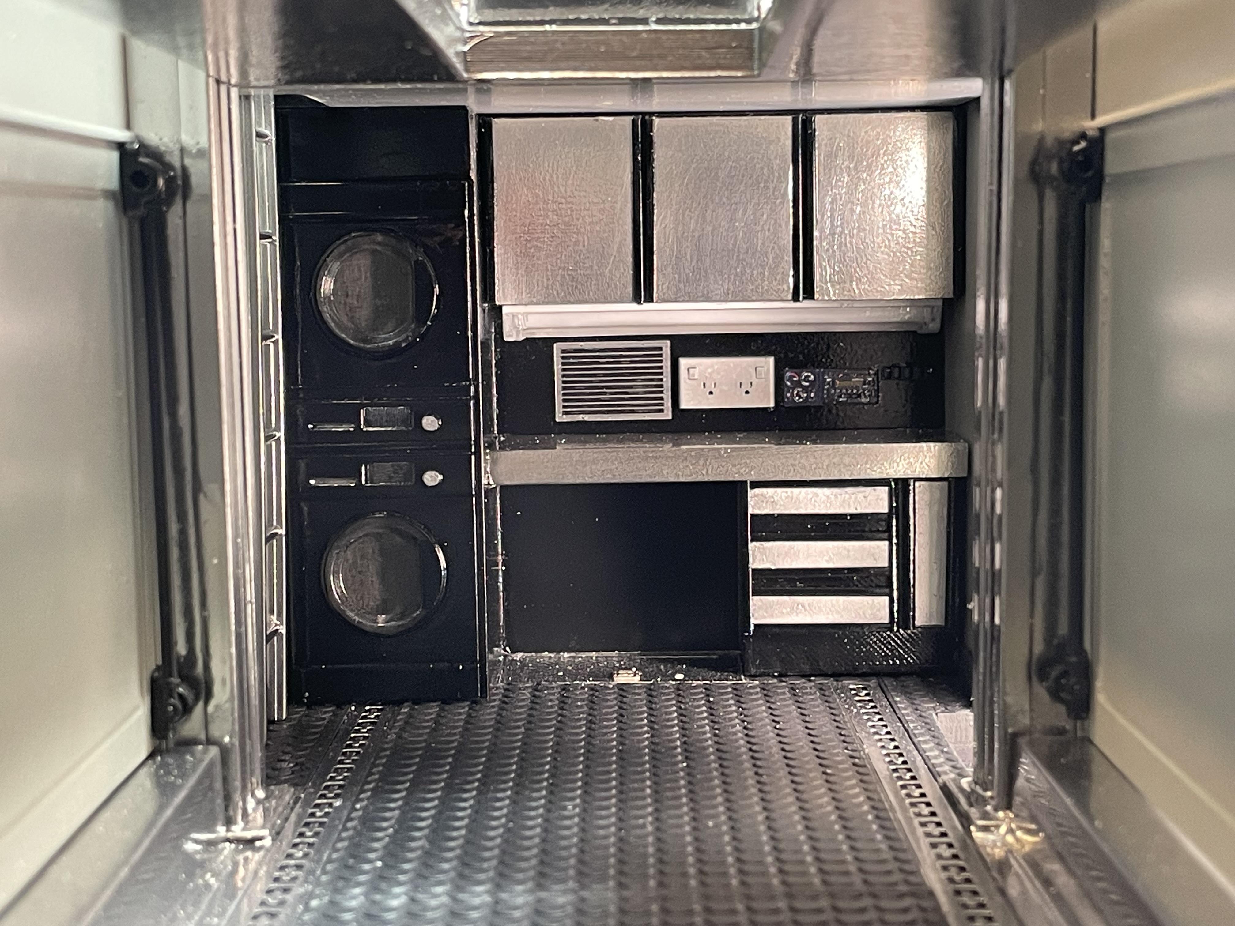

Got some more of the finish work done on the interior of the stacker. I improved the cabinets with trim and BMF (I wasn’t happy with the finish of the Revell Chrome). Made the edges more precise.
IMG_0986.jpeg.9f271fef94067fcdd7360ab444587d90.jpegI added a 120v electrical outlet panel from Iceman - I thinned the depth before mounting it to the cabinet unit. I also added under cabinet lighting and more photo etched switches from CTM’s VN interior set to finish it out.
IMG_0990.jpeg.54b172e285c69c5d740f2a8688f907fd.jpegIMG_0989.jpeg.549a37acb9ec2467fb6c50225673e328.jpegIMG_0988.jpeg.528f714f57ac3b3574f3cd0a9c450dd6.jpegI updated the attic space by adding rubber coin sheets to the walls and moving the e-track. The ladder was installed. Mounted spare tires for the trailer and for the RV were installed using modified In-Bed Tire Mounts from Iceman.
IMG_0991.jpeg.c3d876c70134d7b18a8484622f8a4de7.jpegIMG_0993.jpeg.7e5a7ffac03f80035fe9b2d7c03a7d39.jpegIMG_0994.jpeg.807b9c686ea3126e6fbabee3a3c59809.jpegIMG_0995.jpeg.1eb7f5a46520b80d3c88aab9cb54246e.jpegThe workbench stool is from Black Sheep Customs on eBay. Shortened the height a little. Goes well with the style of the build. Lots more detail work to be done inside, but first I need to turn my attention to the exterior of the trailer.

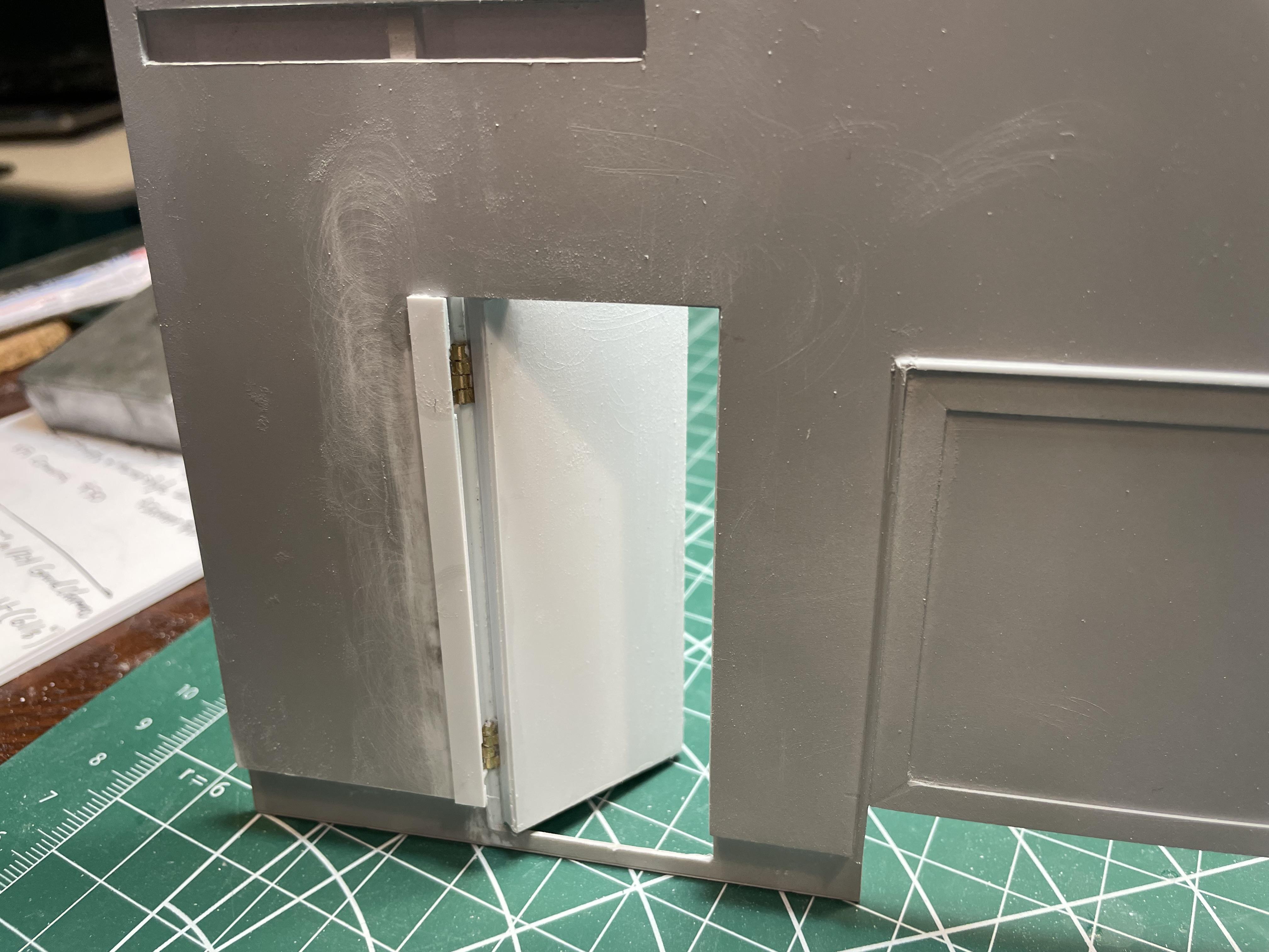

13 hours ago, nascarbob4344 said:
how did you do the hinges for your doors?
It was my first time making an operating door like this, so I experimented a bit with some scrap plastic to see if the hinges would work. I originally thought I’d try piano hinges, but I started with small brass dollhouse hinges I got on eBay. I had to figure out how to orient the hinges to allow the door to fully open and close yet not have the hinges stick out  too far beyond the outside wall. I wanted as close to a scale look as possible.IMG_1001.jpeg.54beaab4bfe67c62dd89a5047363f291.jpeg
Then I used CA glue to attach them to the existing door frame and the outer door skin. I cut the door narrower than the door frame to allow a gap for the hinges. I covered the gap later.IMG_1002.jpeg.2a5e1c3fa9eb50e87259cce6f425323f.jpeg
Then I layered on the framework for the door using the same square styrene rod I used for the “studs” for the rest of the trailer walls, and some thin strips that matched the thickness of the brass hinge plate. The trailer walls are a sandwich of .040” sheet on the inside and outside of the studs. IMG_1003.jpeg.dba8102138046a3b8ecbb2f9592f7a27.jpeg
Then, the inner door skin was added. Now I just had the gap around the hinges to fill from the outside with styrene strip and cover over on the inside (like door frame casing).IMG_1004.jpeg.77db014dd098e0d3a81a928cd14dabfa.jpegIMG_1005.jpeg.793ccc1b85357308168367c4dcee5044.jpegIMG_1006.jpeg.17bd3119a4797690bdb749c5d4f43f5f.jpeg
With each step I made sure the door would still operate before any glue was applied. There was some trial and error. In the last photo below, you’ll see that the interior casing leaves a void behind it to allow the door to close. You can see a notch in the inside frame where just out of sight, is the hinge. IMG_1007.jpeg.463c658ce32256a7ecbc3b9d7819efb8.jpeg
Hope this helps. Thanks for checking it out.

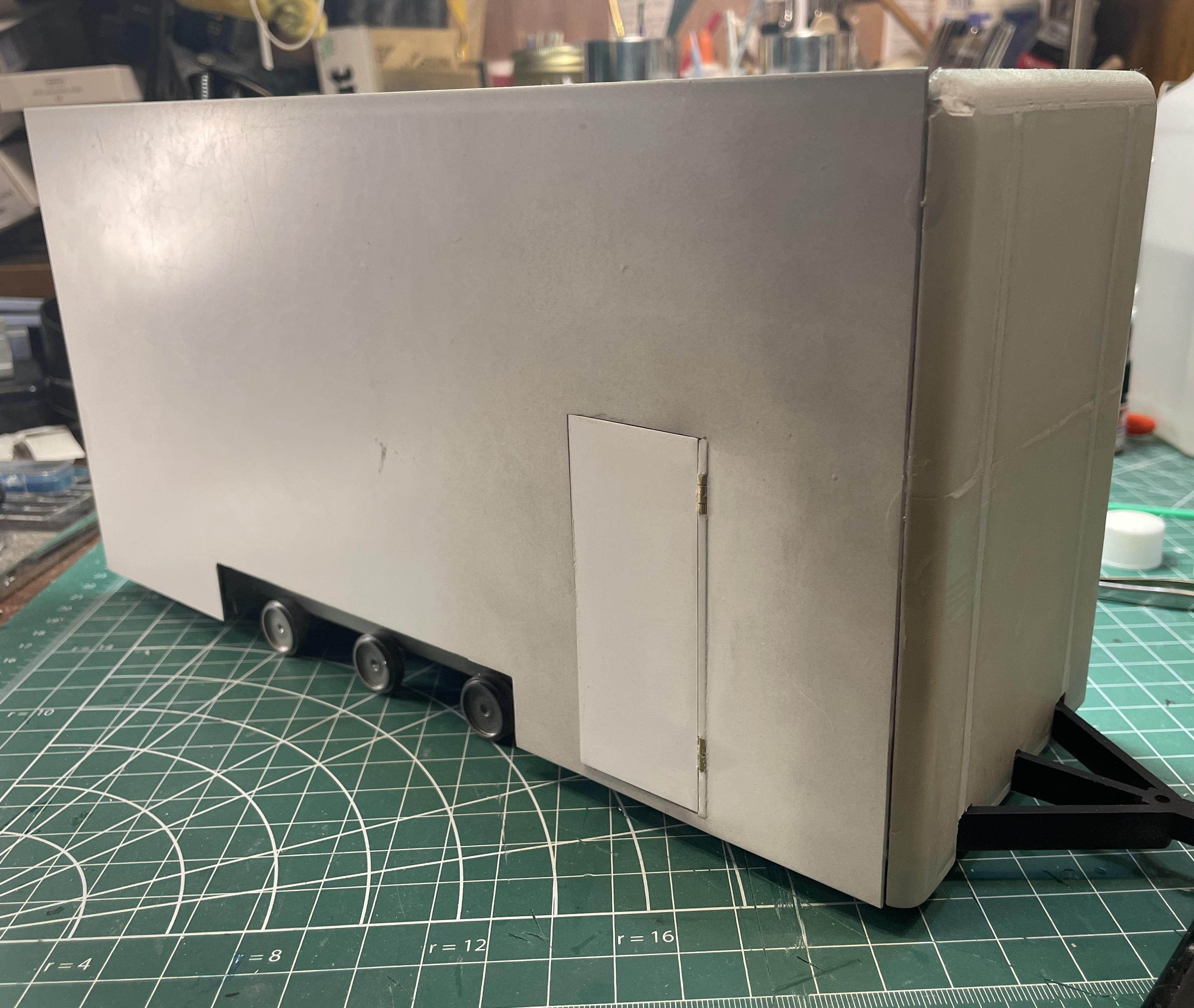

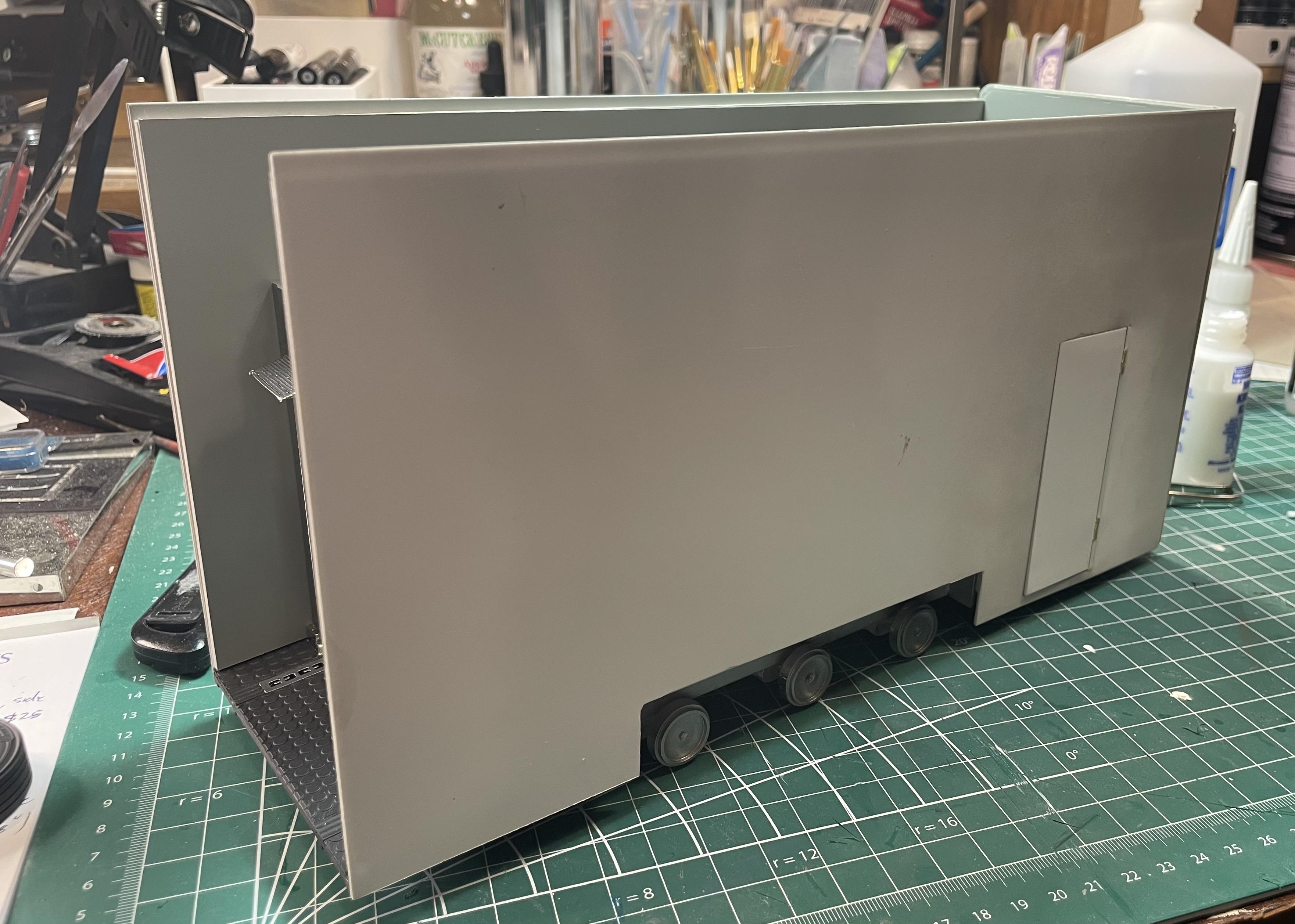

Here’s the latest update…The stacker exterior is now mostly complete, just lacking finish body work and details. More filling and sanding before the primer coats.
IMG_1027.jpeg.fcf96c741df5e0f1968ee38ee7a0a193.jpegIMG_1028.jpeg.399dcac17ef6d9f3094f87b30770b465.jpegIMG_1029.jpeg.385e17dda5ccdb667b7379112665d8a0.jpegIMG_1030.jpeg.57b4c6c51fae85e77fe301e28d264fee.jpegI made the removable roof and operating rear ramp door. I also made the tongue-mounted generator and AC/heat pump unit with access doors.
IMG_1031.jpeg.bab9db8ddd8cc478645f33e1bdbd056a.jpegIMG_1032.jpeg.9308b0adbe0be8b8c936f8793ba554da.jpegIMG_1034.jpeg.21125642fc3ec120c5f3d88da4b1d58f.jpegIMG_1035.jpeg.a4a5e58e30409c5152ee916eb10fe230.jpeg
The roof has channels that fit snug over the side panels. The door has a hinged diamond plate transition ramp that folds inward along with recessed handles.
IMG_1036.jpeg.ee968db8f4ed899ee7dca4f91b2453bf.jpegIMG_1037.jpeg.78fe1b65f23481caa9a9443ff83224c8.jpegIMG_1038.jpeg.d4d9f2e95077c51e465dfca89ef8960e.jpeg
Next update, I should have it in primer. Thanks for watching.
