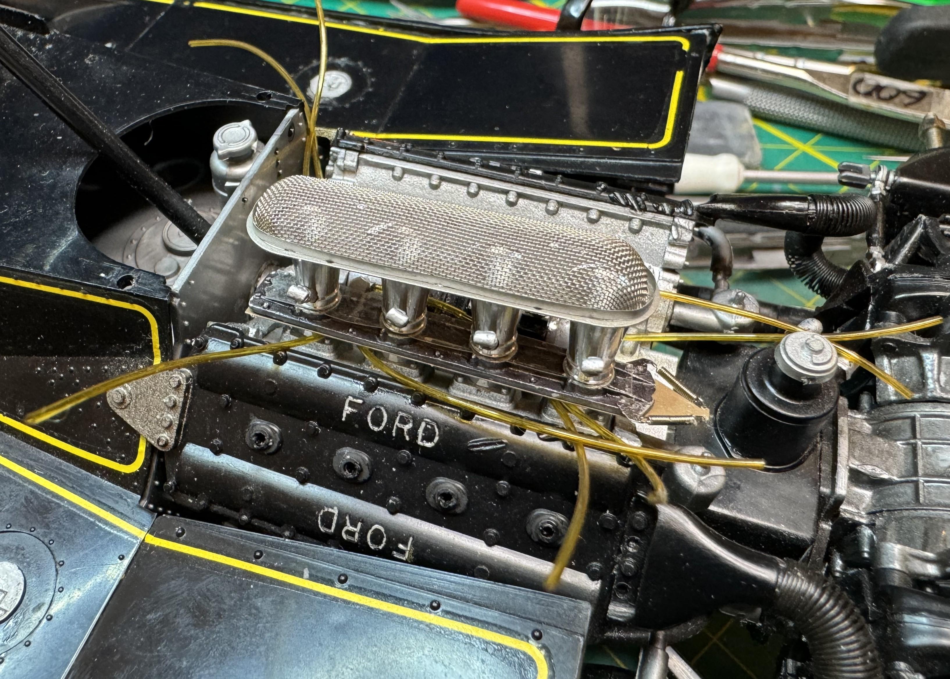

My first thought was to just do the mesh intake screens. When I was looking at the Lotus, I turned it upside down and a few parts I didn't glue into place fell in my lap. One of the so called screens also fell into my lap, and that's what got the ball rolling.

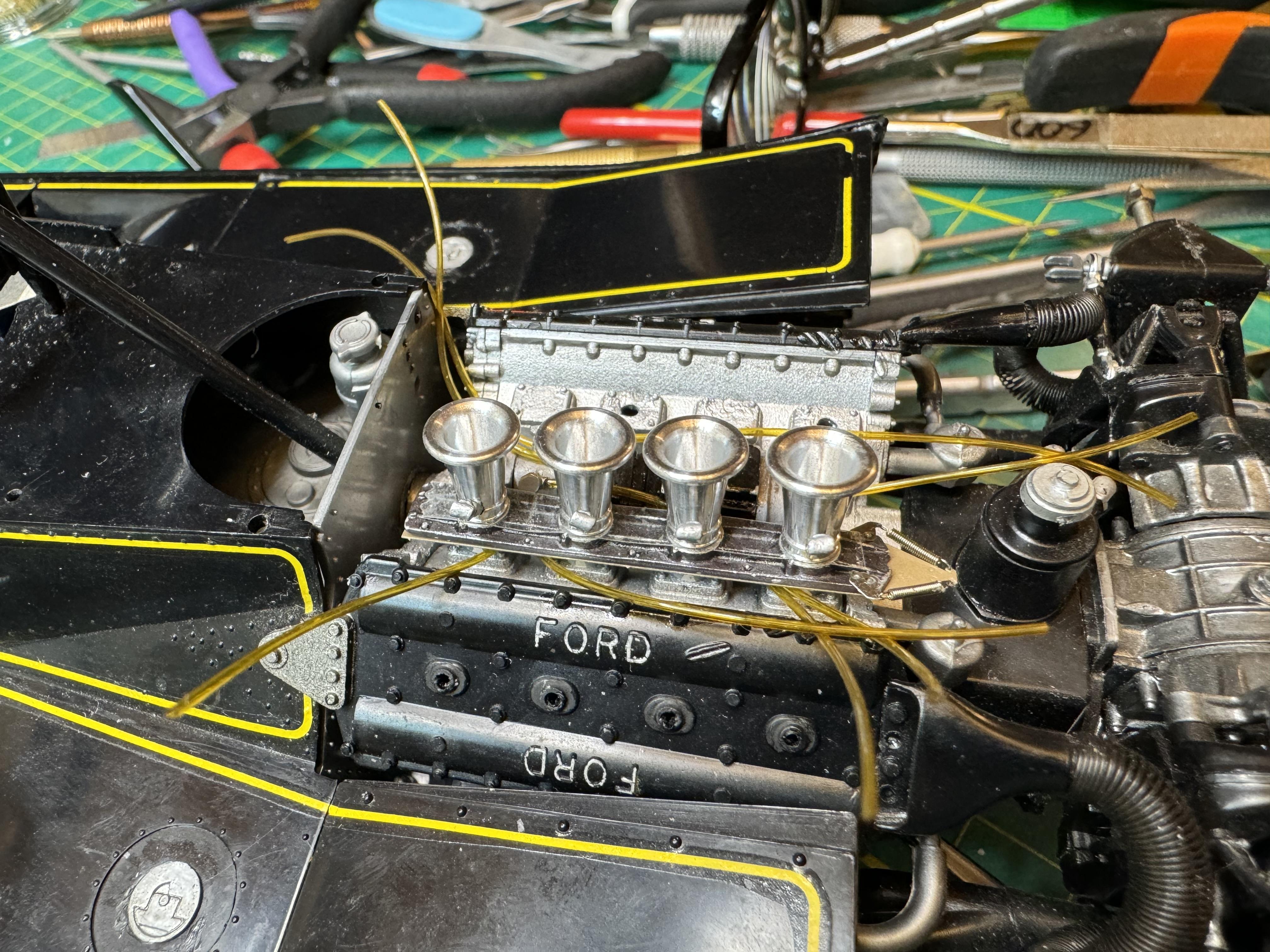

When I pulled the trumpets off, what was there looked okay. IMG_5542(1).jpeg.26a363d3a267a8bfd83e0ab982a14b4c.jpeg
But I decided to wiggle one of the rails to see if I should go further. Then I got out a tool to crow bar them off... I was going further.
But, honestly, the electrical end of things looked as good as the MFH, as far as I could tell, and it was stuck pretty good, so I decided to leave it. Maybe 15 minutes later I was wedging it off. Why? That part has caused me the most grief of all. From the chipping paint to the over-filed end plate, I'd say it's cost me three hours. But I ended up here:
And this is the graveyard. When I saw those crimped fuel lines, I was immediately taken back all those years and remembered my disgust with the material they used as I installed them. Note the black sausages they passed off onto us as funnel screens.

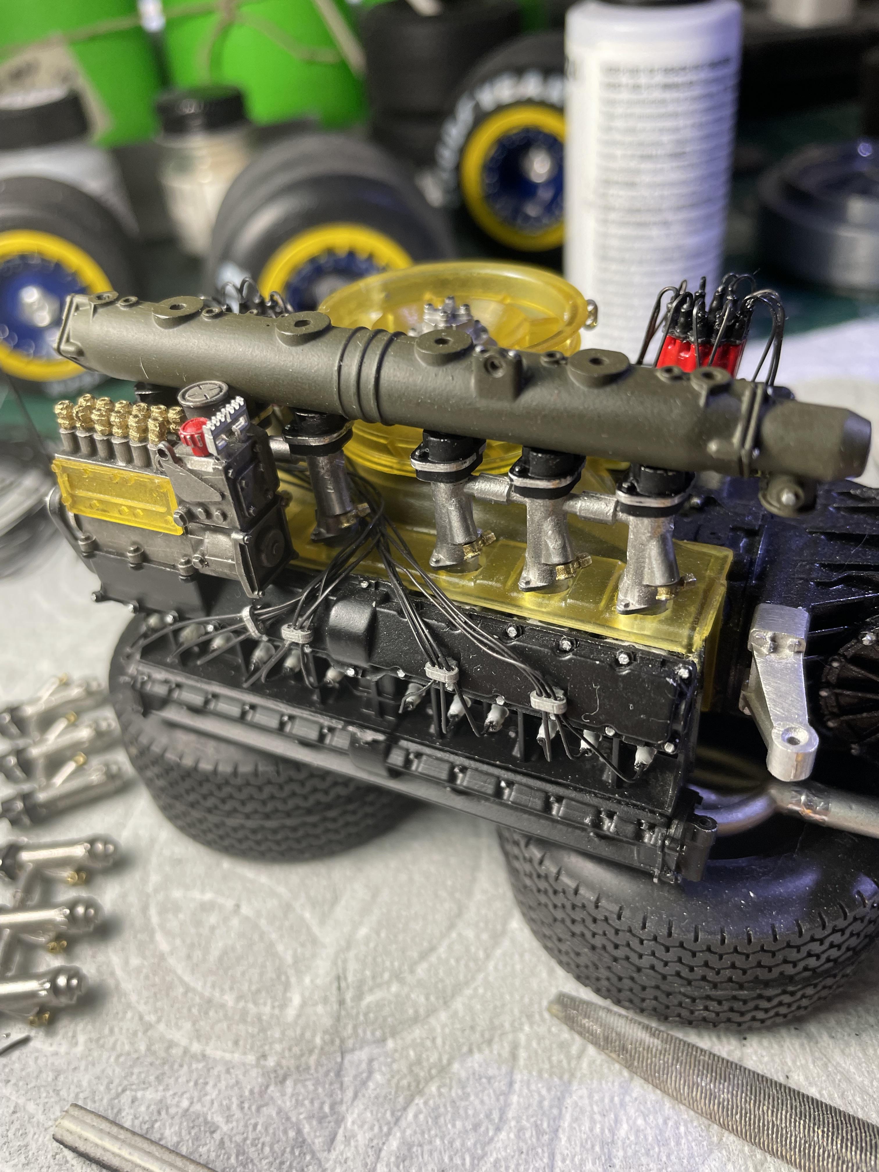

Before my updates, I need to say that the original intent was simply as the title of this thread states. Then, using the Google "site:modelcarsmag.com" approach to searching this site, I looked up a topic I've been searching on for, oh, 20 years?: What is the proper way to plumb (no, not level) the late 70's DFV? And I found this, the first fully documented answer to my question, both ends of every line clearly visible:
It's an extraordinary build by John Brolin using minimal third-party parts. It's the identical kit as the one in this thread, which is where, including that both were gifts, the similarities end. I built mine in a matter of days, his was attended to over a period of a decade. I only decaled one side for expedience, he soldered brass pipe to add authenticity. Mine is a demonstration of disinterested model building, his is a work of art and dedication.
I'm glad I have the opportunity to return to modeling and redeem myself, starting by finishing and updating two kits, this one and the B192, as a way of learning how to do things I never before did. And it's fitting that the first thorough description of the plumbing for this kit is from John, one of the people who have taken the time to help me learn. (I find it amusing that my first pic of this kit was the finished product and John never posted the final product... all but. ?‍♂️)

To avoid the mistakes I've seen in other applications of the MHV hardware, where the two plate have an uneven gap between them, I placed the lower plate over a gap in the vices. Then applied glue on either side of the attachment points, dropped the upper plate in and pressed like hell.
In this pic, you can see how ridiculous the MHV spring size is. The attached one is a TS 6 mm exhaust spring. Before gluing the tine PE bit and the lower plate, I drilled out all the holes, 0.7 mm for the alignment pin and 0.2 for the spring points.
I modified the upper spring to reduce the amount of wire between the coil and attachment points. Fail. There's just enough tension in the coil to undo do it. A half-hour lost.

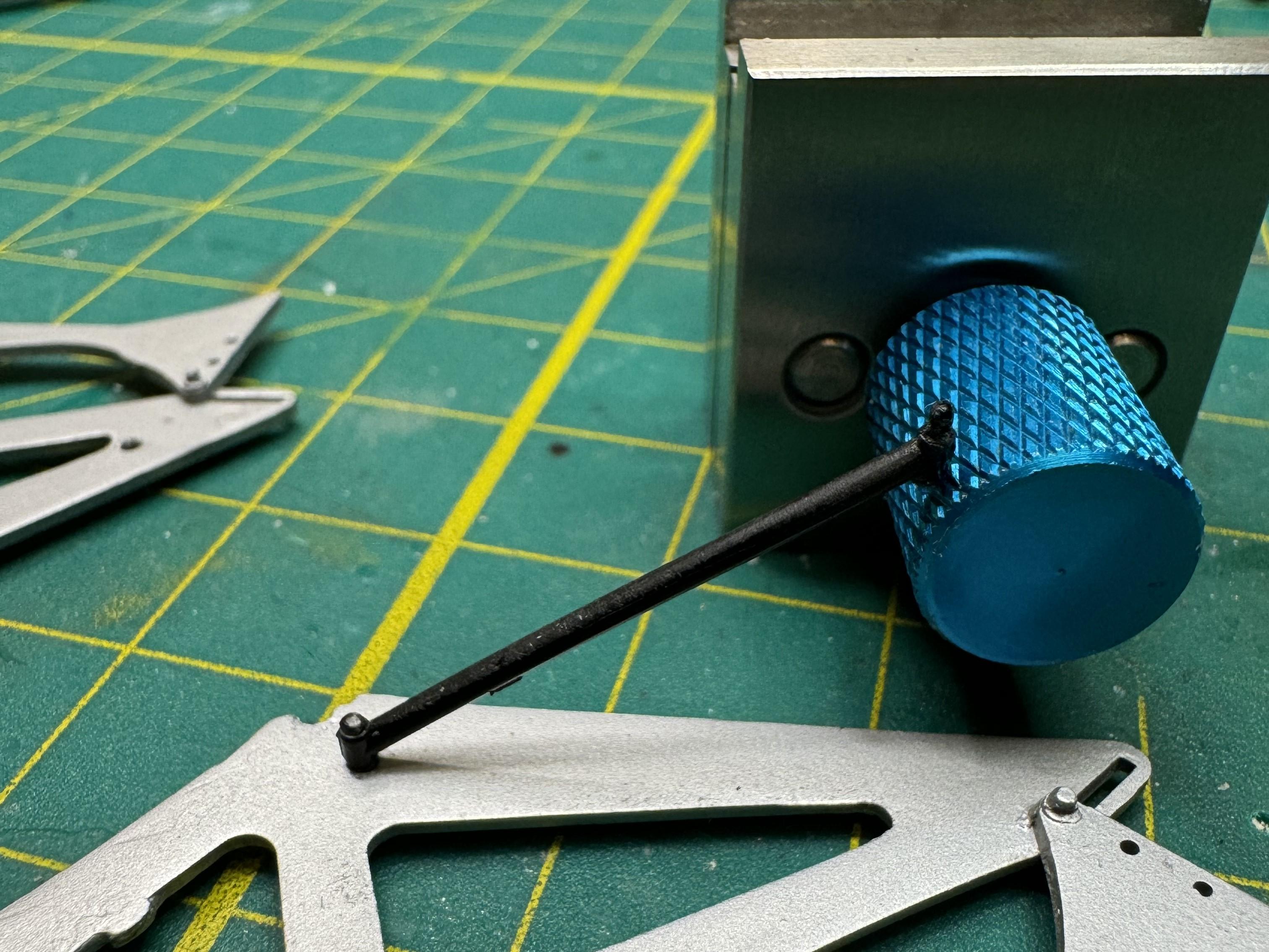

Would you accept this in your own work?
This is an honest and serious question, as I frequently wonder if I’m sweating certain details, details that are holding me back. Please do not take into consideration my limitations, and focus only on what you would do with this product.

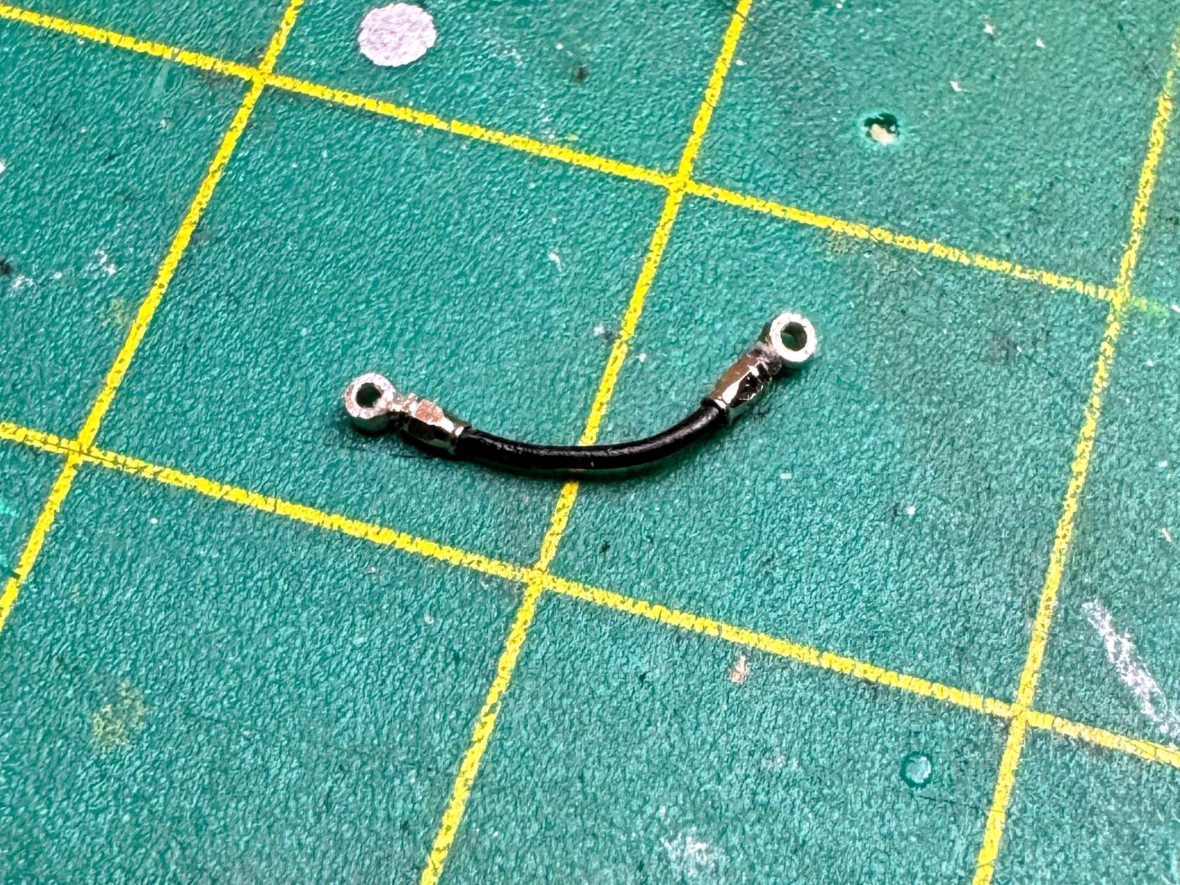

As I predicted, the ears and springs came off the one completed throttle body due to mishandling, so last night I had to attach all four springs. In addition, I added the goal: reduce/eliminate the uncoiled portion of the spring ends.
What you see what you see that bothers me is springs that are no longer straight because they were slightly too long or needed to be twisted to them hooked (once you turn one to the point that the hole is into the coil part, the spring gets wonky). On one of them, you can see that I attached it from above on one end, and from below on the other, which isn’t the greatest look, either.
Reducing the amount of uncoiled spring required first stretching them so the coiled portion was 6 mm in length. The second step was to cut off the loops and bend the coil ends so that they were in the center of the coil radially. (Think of a circle with a diameter line.) This turned out to be the most fraught part of my process.
The problem was that, because you’re bending it to a 90° angle perpendicular to the spring, it’s can’t help but end up resting against the part of the coil that is 180° from the 90° bend, if you follow me. This made it impossible to get the spring into the loop. And, incredibly frustratingly and time consuming, trying to bend that diameter line such that there is a gap between its end and the coil can only be accomplished, by me at least, with luck.
An alternate solution, and one that I would have preferred, would be to cut that diameter line such that it was shorter than the full diameter of the spring. That would’ve been the best solution if I could make that cut. But I couldn’t. None of my myriad nippers could get in there and do that.

With my new freedom, I went to work on the brakes. TS banjo fittings type B. John, now I understand why you were insisting on developing your own solution. Although the TS ones work, they are not at all accurate. For one, the banjo bolt head is way off... out there in its own orbit. I don't don't want to go down this rabbit hole... for now. Still, they're better than nothing by a mile.
Like I said, type B was the only wrong set for this car:
You can just barely see what set 'A' looks like. Very simple. Very appropriate for this project and, as an added plus, the banjo bolt head looks a lot closer to what you'd expect than for B and C. Set C, while too long, at least it's straight. But I have set B.
I snipped off all but about 2 mm. The remaining stub was much too thick to fit the wire insulation and hex fitting over it, so I filled each of them down. I put a 1 mm tapered hex fitting on the line I cut, and then simultaneously pushed the brake line and the fitting over the stub. This worked great. When I put the wire on first, after sliding the hex fitting into place there would be a tiny but noticeable bit of the insulation showing. Trimming that caused the parts to separate in one instance; not a chance I wanted to take on every one of them. Plus it's just plain a more elegant process.IMG_59771.jpg.c66cb886be011df234e03bf942d98e9a.jpg
The halves were my original attempt, which was too short. I don't know if I'll ever figure out a way to attach them to the in-facing part of the calipers, but I'm holding out hope that I'll figure something out, OR, you'll provide me with a suggestion that works for me (hint, hint). Unfortunately I painted them match the reference photo and it didn't turn out all that well. May as well have left them alone.
