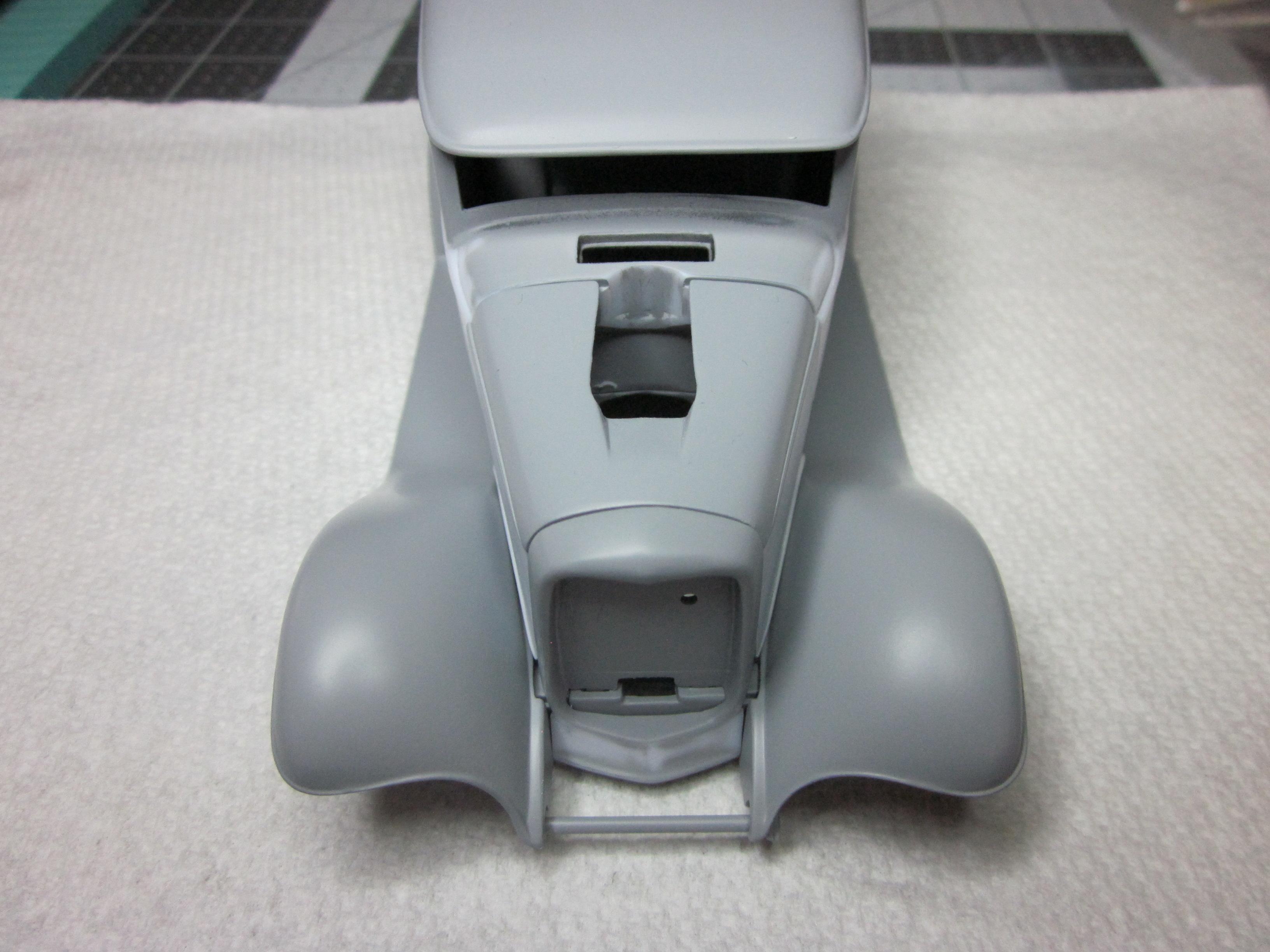

Thought I would show the results of taking a wedge cut out of the front fenders. Not sure if it was worth doing, but there is a small change. And I'm glad I'm not building new fenders.
That's it for now.
Bet the front tires fit under the pinched fenders a whole lot better! -KK

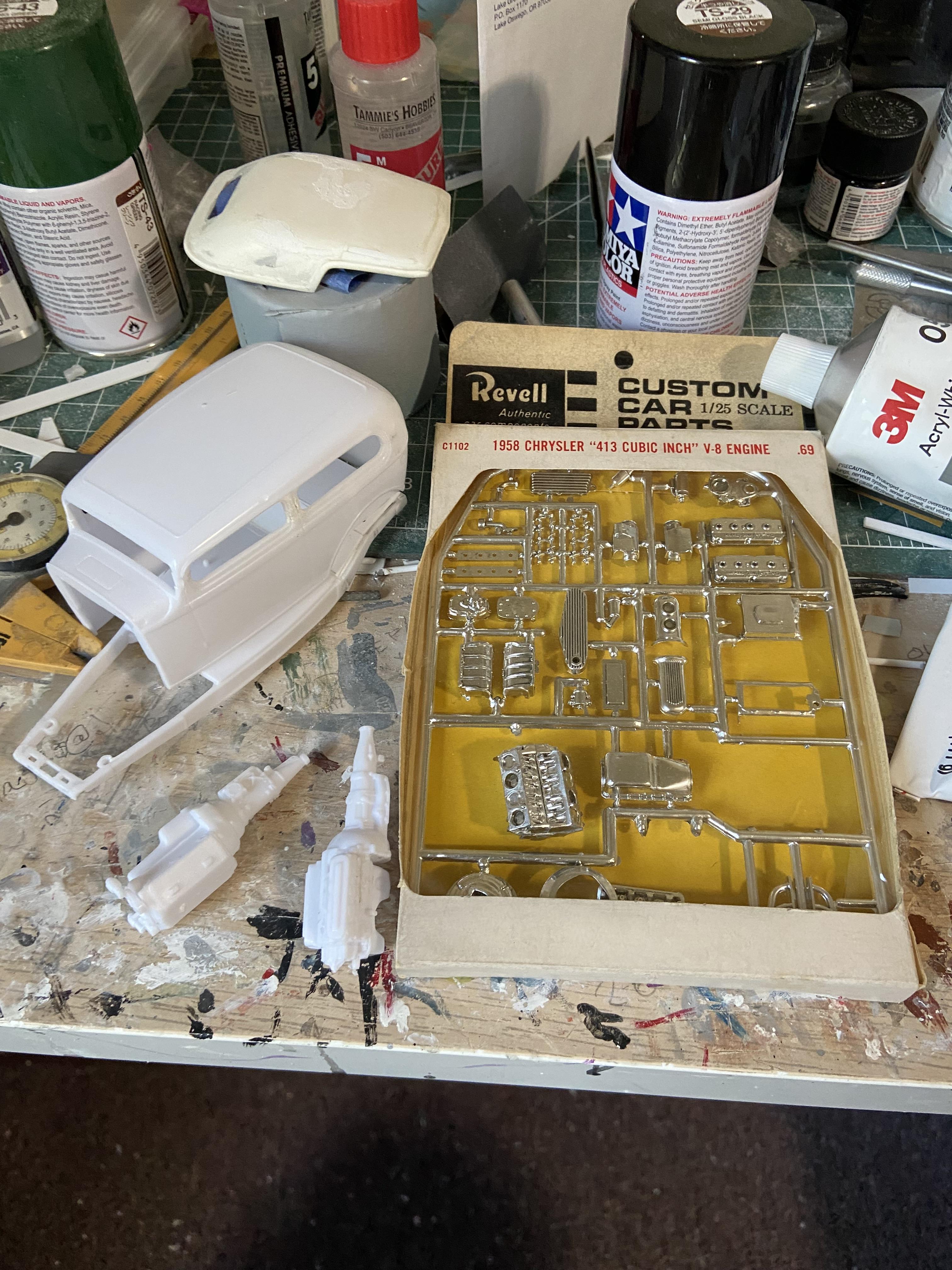

After a bit of a hiatus due to other projects, I am back onto my 32 Ford rolling bones Tudor. It has been too long.
i am considering engine options: I have everything set up to use the kit’s 32 flathead. The only problem is is that it has a C4 automatic. I also managed to find a 327 Chevrolet. It’s nicely detailed, but it too has an automatic. My last choice is the old Revell custom parts pack 58 Chrysler hemi.
Does anyone know where I can find a 241, 271 or 330 HEMI hopefully with a manual transmission ? Maybe the hemi out of the AMT 29 model a ?

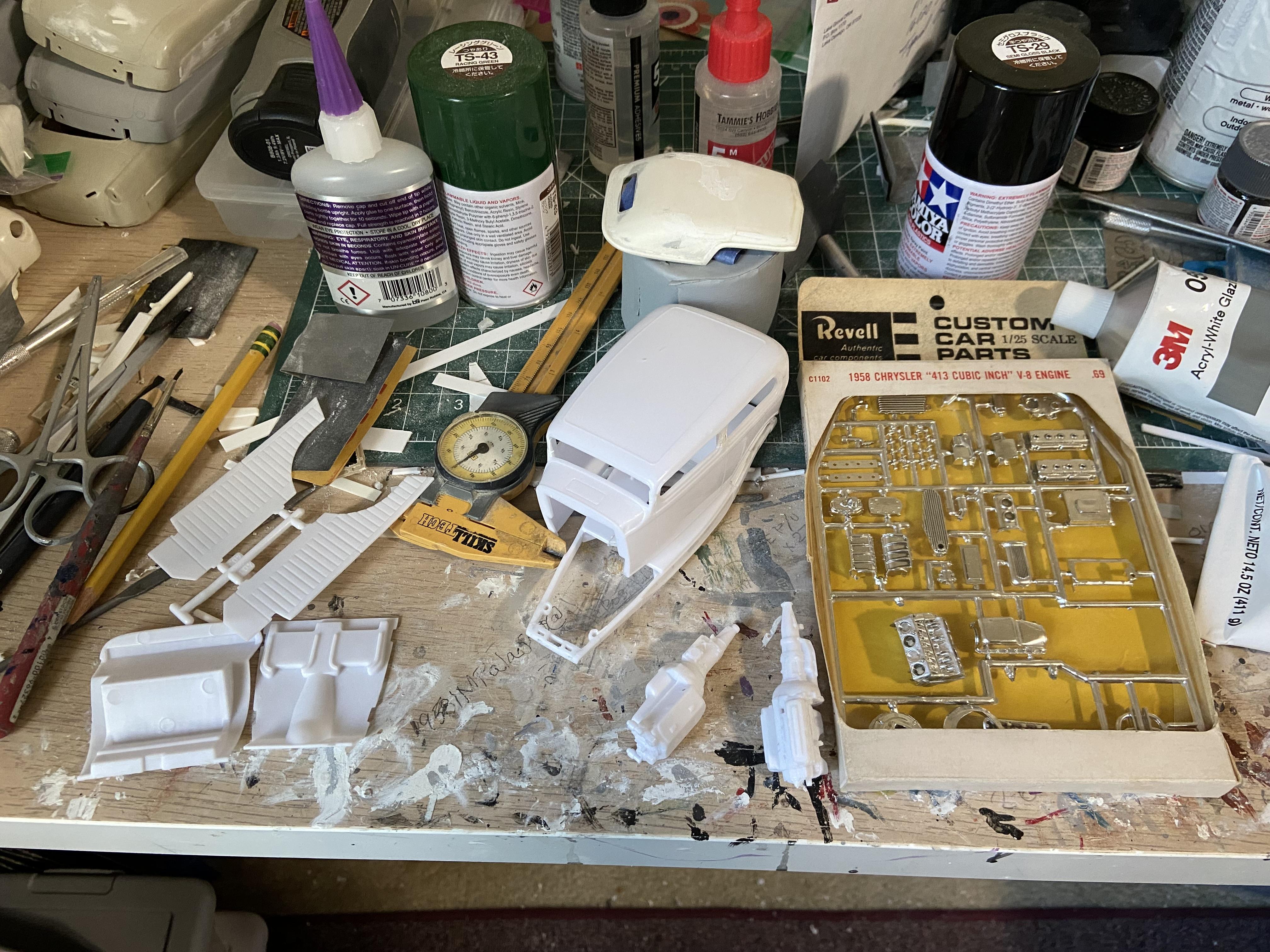

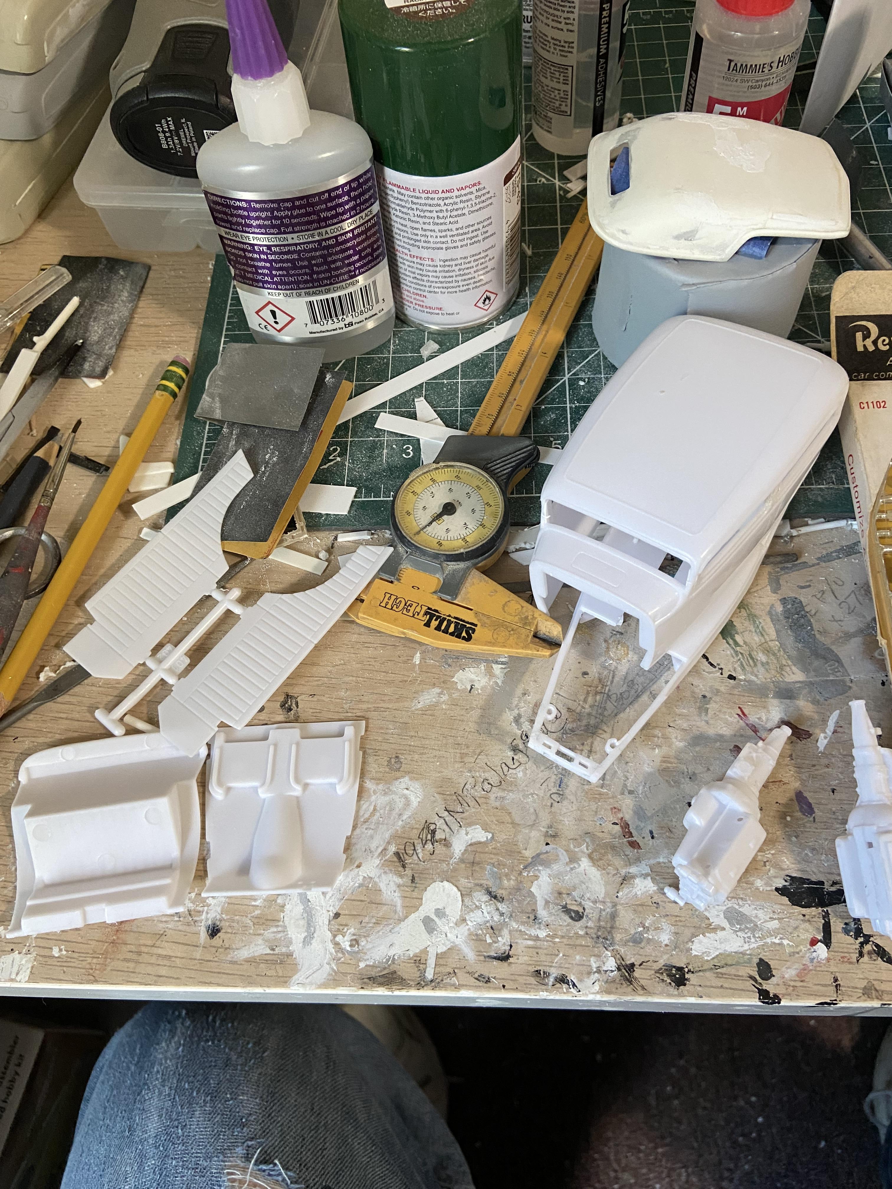

I have taken a brake from this project but I got back on it yesterday. I finished my chop, bobbed the rear, created a roll pan, and lowered it a whole lot. I think the stance is almost perfect and it now just needs bodywork, paint, and detailing. Thanks for looking20250612_100712.jpg.f7524ac590a6a5ab05a68af9ccf44ac2.jpg20250612_100956.jpg.218571b7b0578916dceaadb2cb09b6a7.jpg20250612_101018.jpg.67bdaca24386d078c7ba25a0d89c2732.jpg20250612_100819.jpg.7165227a8071cce7ad6e5a7b412d584f.jpg20250612_100824.jpg.d3a3f39c5b57c567cae9917f96473c87.jpg20250612_100838.jpg.367d3bb0a84fb244237bf259cf6aaeed.jpg

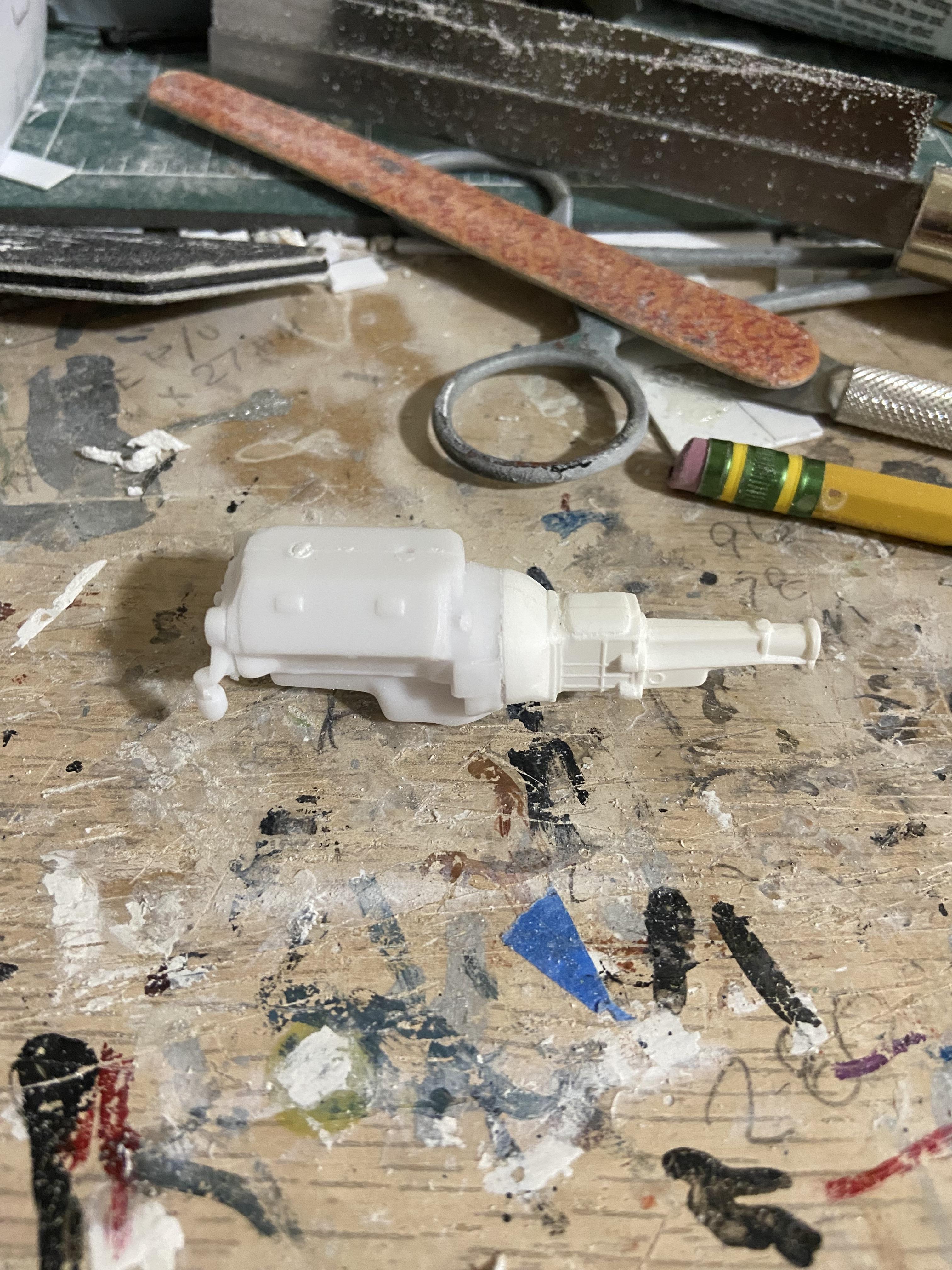

The frame and everything is set up to run the flathead so I decided I’m going to go with that. However, tonight I was scrounging through my parts box and I found an old NASCAR engine block with a molded in manual trans so I cut that off and cut off the automatic from the flathead and I glued on the manual trans from the NASCAR engine. Pretty cool, huh?
