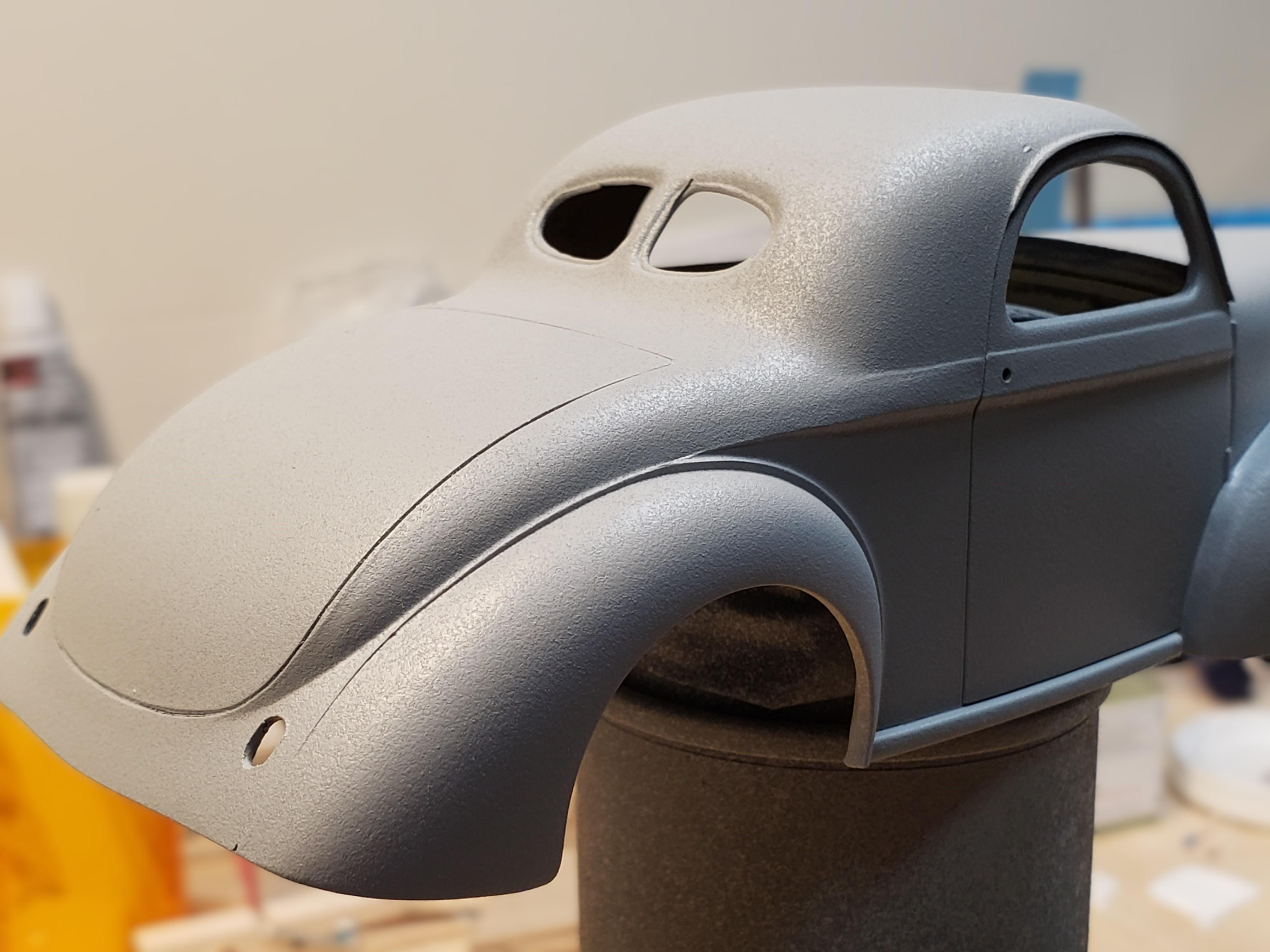

DJMar Posted August 13, 2024 Author Posted August 13, 2024 I swear this build is cursed. ? I decided to give the Willys another coat of primer today, after some sanding and touch up body work. I used a half-full can of Tamiya's FSP in light gray. Unfortunately, I was spraying with my headset on (listening to tunes) and didn't notice (hear) the can spitting until I had made a pass around the model. The can was relatively new, and I had warmed it up and shaken it for a good two minutes before spraying. The thought of having to sand this down again is making me consider taking up knitting. Or maybe I should just go for the rusty, textured look?
TransAmMike Posted August 13, 2024 Posted August 13, 2024 ? Well, looks like it needs to be dunked in the stripper again. To nice a build to give up on. 1
DJMar Posted August 14, 2024 Author Posted August 14, 2024 4 hours ago, TransAmMike said: ? Well, looks like it needs to be dunked in the stripper again. To nice a build to give up on. Thanks! But I'm not sure I can go through the stripping procedure again. I really don't want to redo all that putty work. I think I'll wait for my new batch of polishing pads to come in, and attack it with some 1500-1800 grit to see if I can smooth it out without too much trouble.
Zippi Posted August 14, 2024 Posted August 14, 2024 Oh boy...just went threw that with my 55 Ford pickup. I'm re-doing all my putty work. Good looking Willy's so keep after it. 1
LennyB Posted August 14, 2024 Posted August 14, 2024 It doesn’t look that bad, I think you can probably get away with a wet sand and then go for the top coat. 1
DJMar Posted August 14, 2024 Author Posted August 14, 2024 5 hours ago, Zippi said: Oh boy...just went threw that with my 55 Ford pickup. I'm re-doing all my putty work. Good looking Willy's so keep after it. I totally thought of you and that '55 when this happened. Misery loves company, my friend! ? 5 hours ago, LennyB said: It doesn’t look that bad, I think you can probably get away with a wet sand and then go for the top coat. I put the body in the dehydrator for a few hours and when it dried down, the texture smoothed out a bit. I agree, I think I maybe be able to spend some time with the sanding pads and get this ready for color.
espo Posted August 14, 2024 Posted August 14, 2024 Start with an 800 grit and work your way up. I have noticed that some of my Tamiya paints, regardless of color, seem to get a little unpredictable when they have set around with maybe 1/4 of the paint still present. 1
