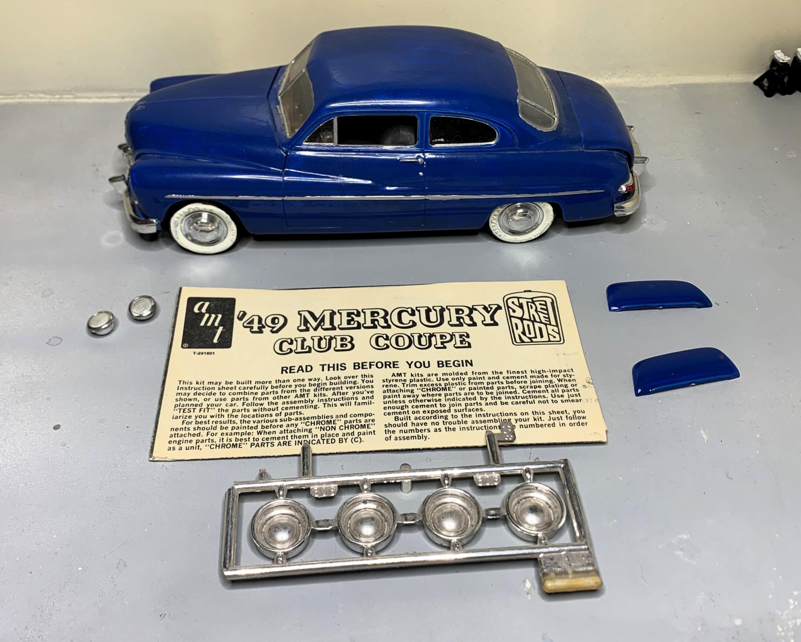

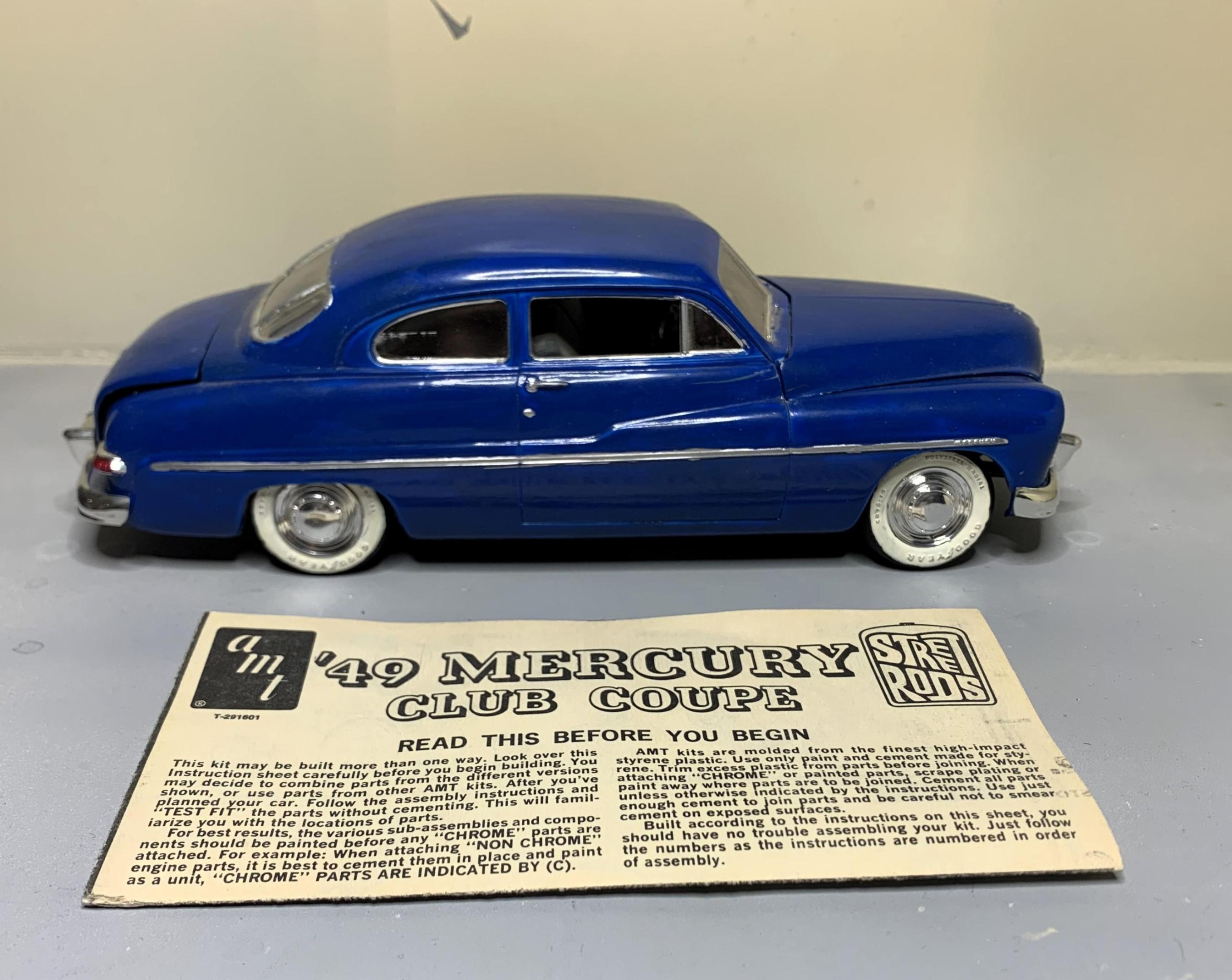

dino246gt Posted June 7, 2024 Posted June 7, 2024 I found this old glue bomb '49 Merc in my stash, so I decided to re-do it. I've been having fun saving old junkers lately so why not this one! 1

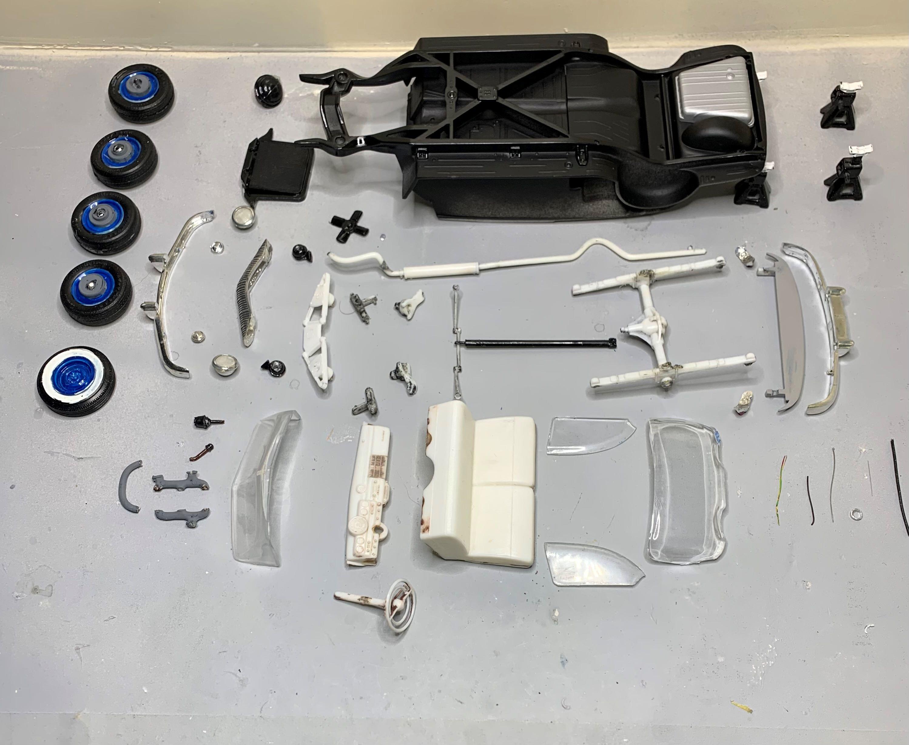

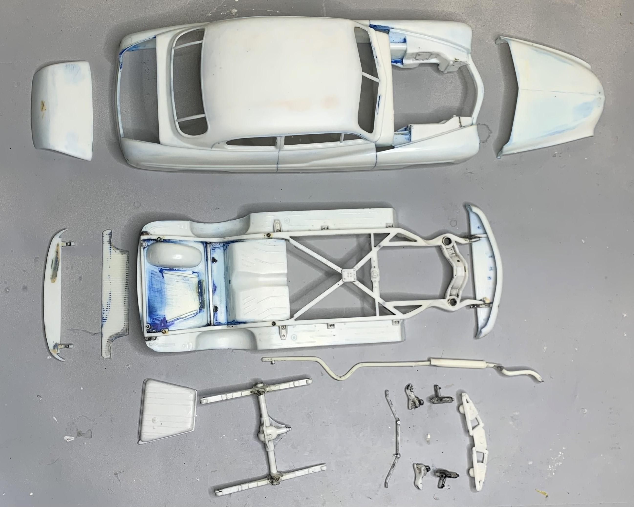

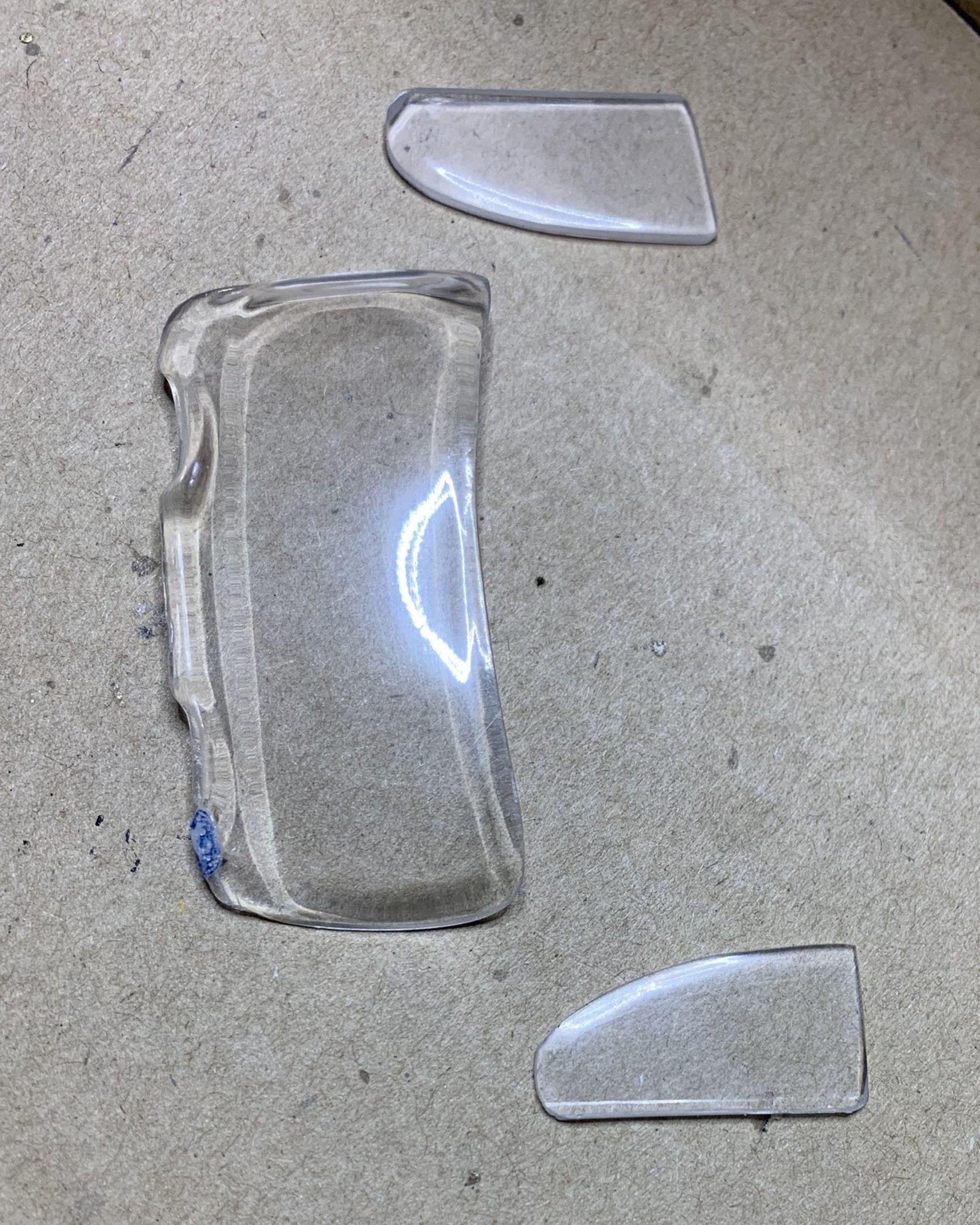

dino246gt Posted June 7, 2024 Author Posted June 7, 2024 I got it apart and mostly stripped. There was so much glue that I had to cut some pieces up. The "glass" was the worst! I cut each piece, windshield/vents, rear, each side, THEN the runners from the headliner. Those runners had to be ground off, they were not coming out no matter what I tried, they were one with the headliner! LOL 2
dino246gt Posted June 7, 2024 Author Posted June 7, 2024 I've already cleaned up the underside and primed and painted everything flat black. I had to cut the front pan from the frame. Gas tank was separate and I did that in flat aluminum. Frame is done in semi-gloss black. 1

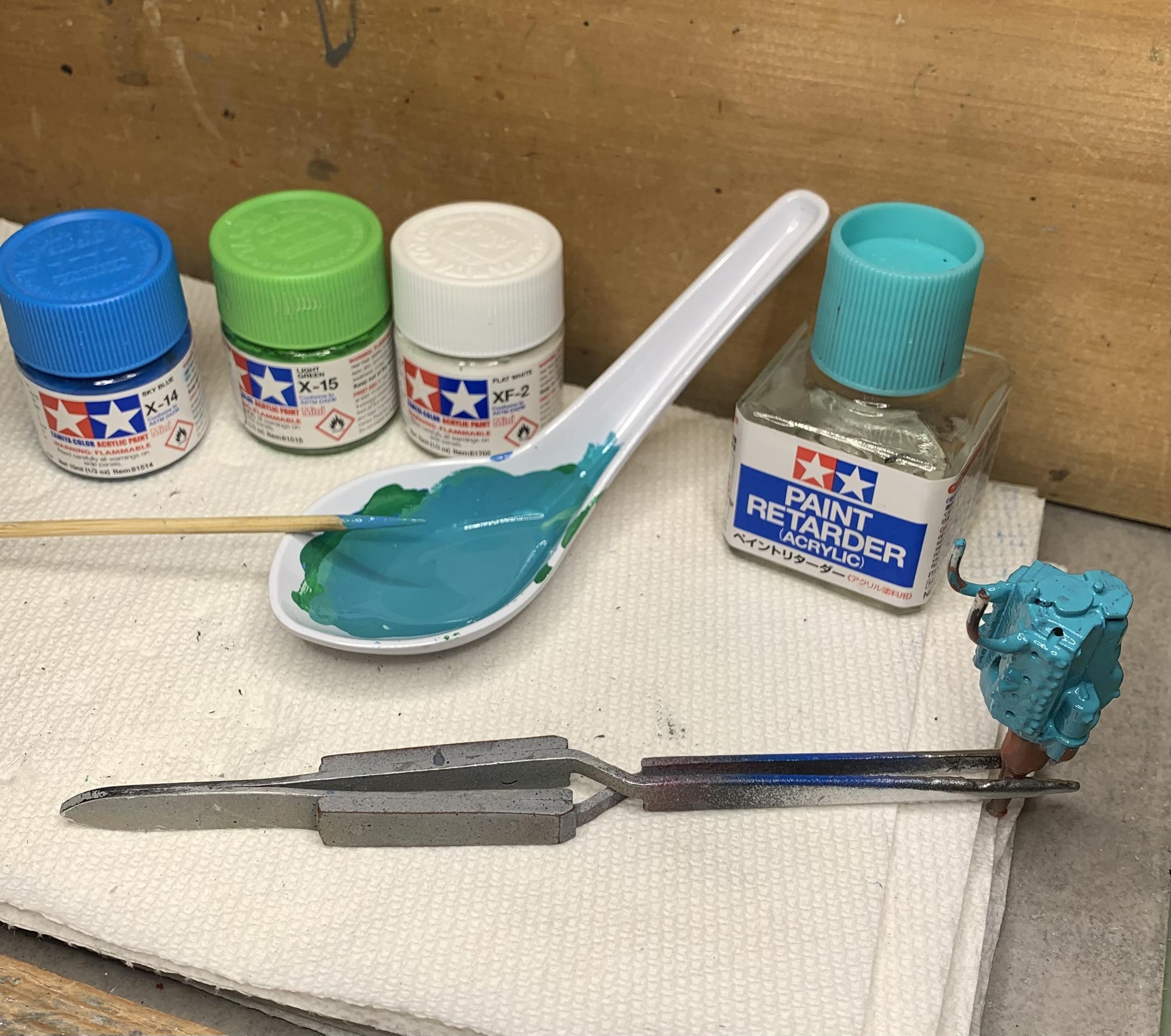

dino246gt Posted June 11, 2024 Author Posted June 11, 2024 I puttied up the bottom after sanding flush. I drilled for plug wires and tried to remove the molded on wires, it's rough but I'll hide it with new wires. I mixed up some paint and brush painted it.

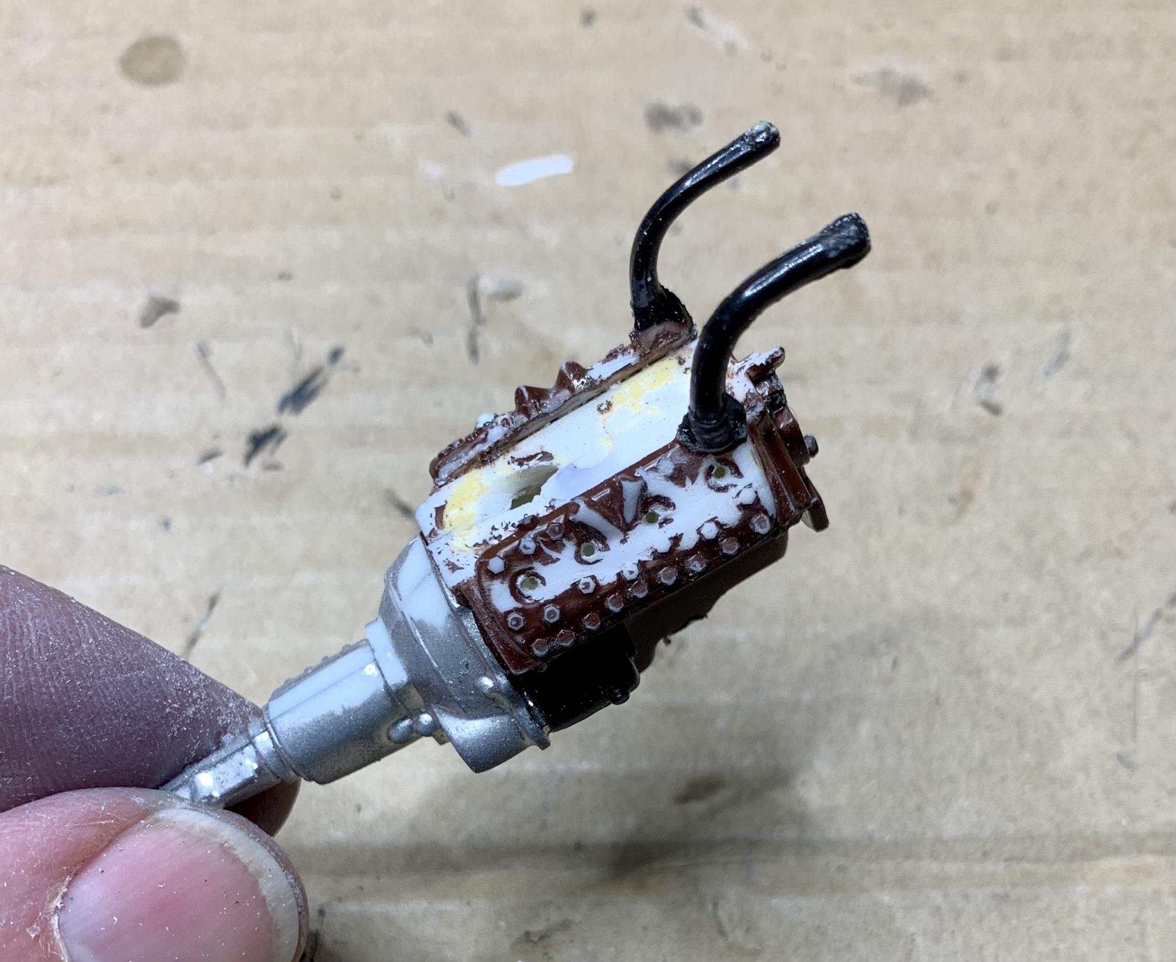

dino246gt Posted June 11, 2024 Author Posted June 11, 2024 I kept it simple but added 2 carbs, it'll look okay down in the big Merc bay. Going to try and make headers next! 2
FoMoCo66 Posted June 12, 2024 Posted June 12, 2024 Wow! That is some amazing detail on that flaty. ? 1
dino246gt Posted June 12, 2024 Author Posted June 12, 2024 I used the headers from the Revell sedan kit, so now I can glue the flattie to the frame and work backwards from there. I'll make the original exhaust system work up to a point, then use parts box pipe pieces to connect to these headers. Then the rear end and driveshaft. I have to work on those pieces but first the exhaust. Now here's my little flathead ready for install: 2

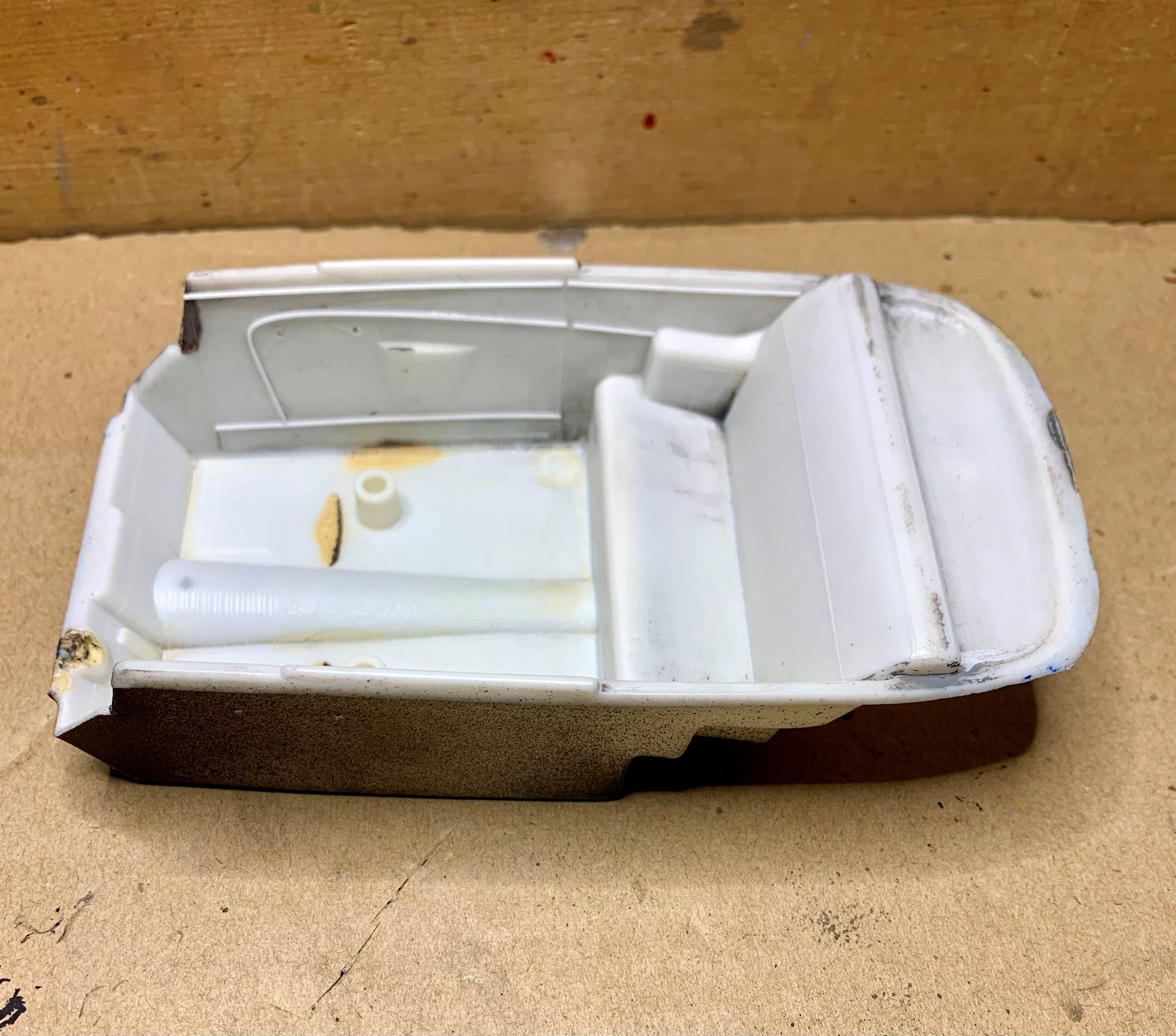

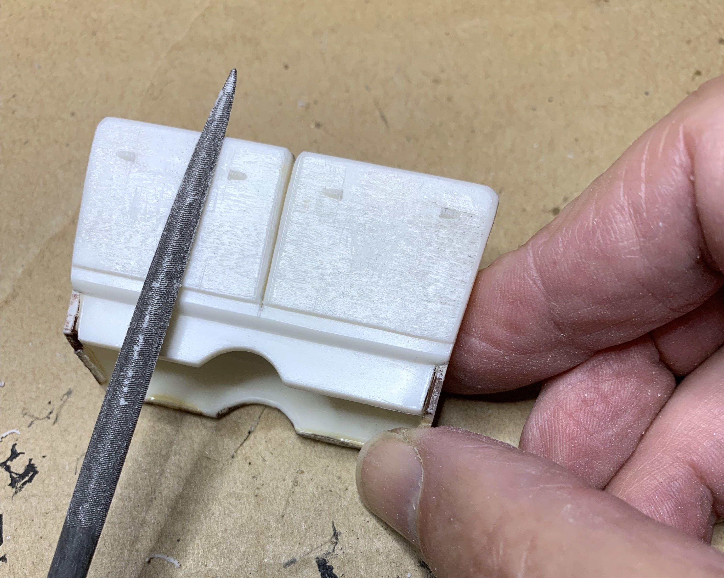

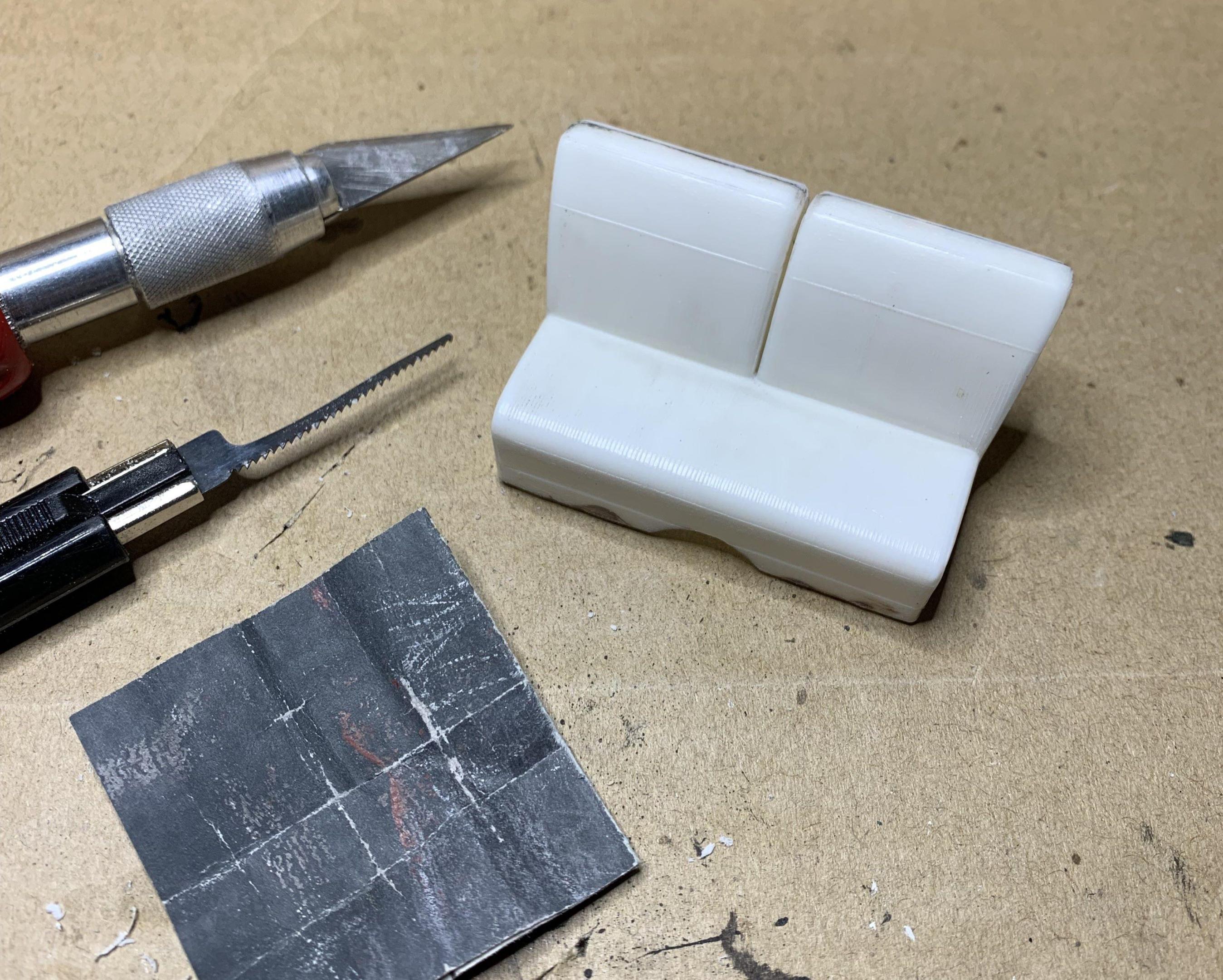

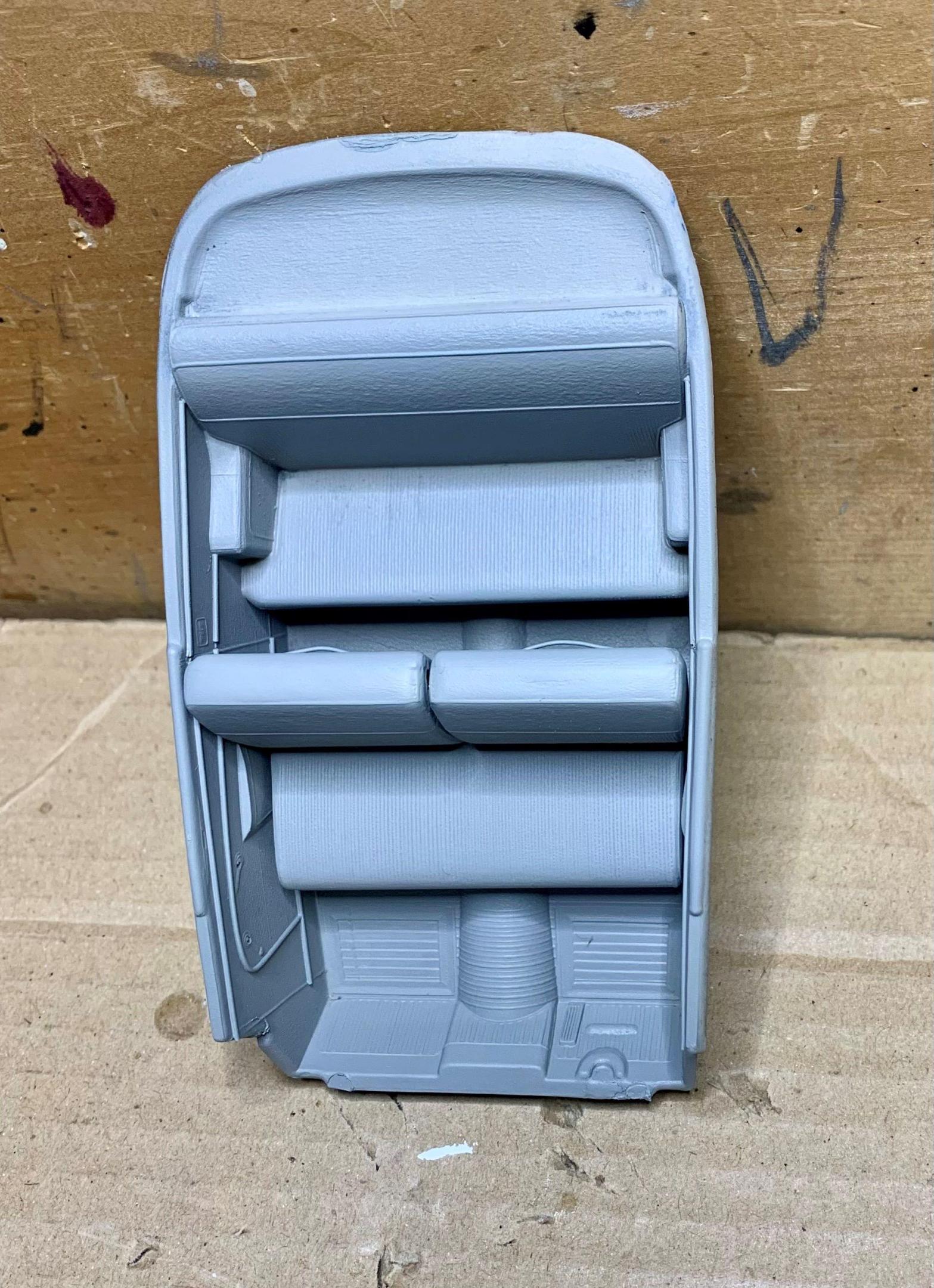

dino246gt Posted June 19, 2024 Author Posted June 19, 2024 I pried the front seat out but the seams didn't line up and the glue was heave, so I just sanded it flush. I dragged the backside of the X-acto blade up and down the middle, then cut with a thin saw, then used folded sandpaper to round the seat upper halves. I filed the "ropes" off the backs, drilled holes and inserted copper to replace them. The brass is thin enough to shape after it's installed. 1

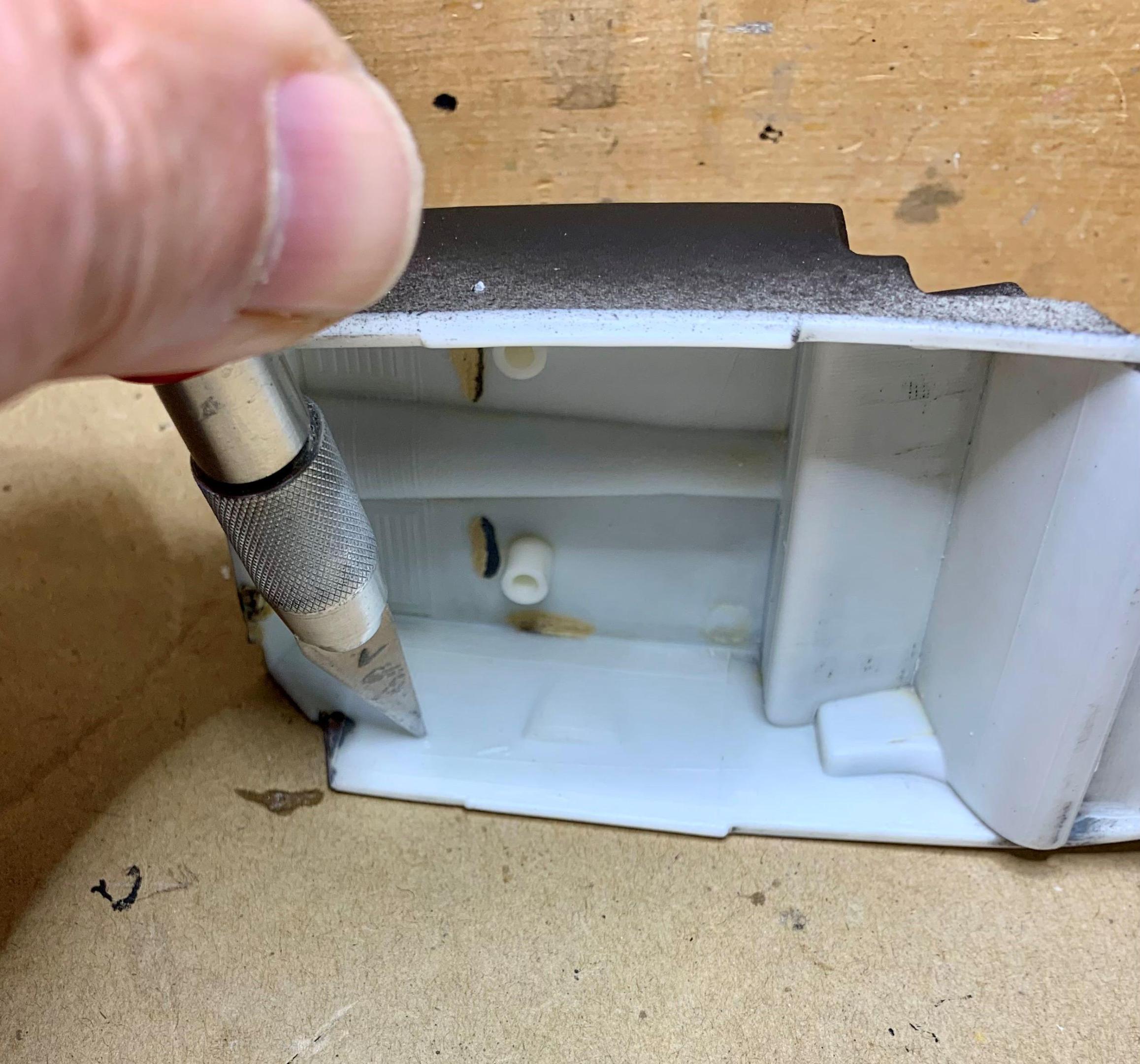

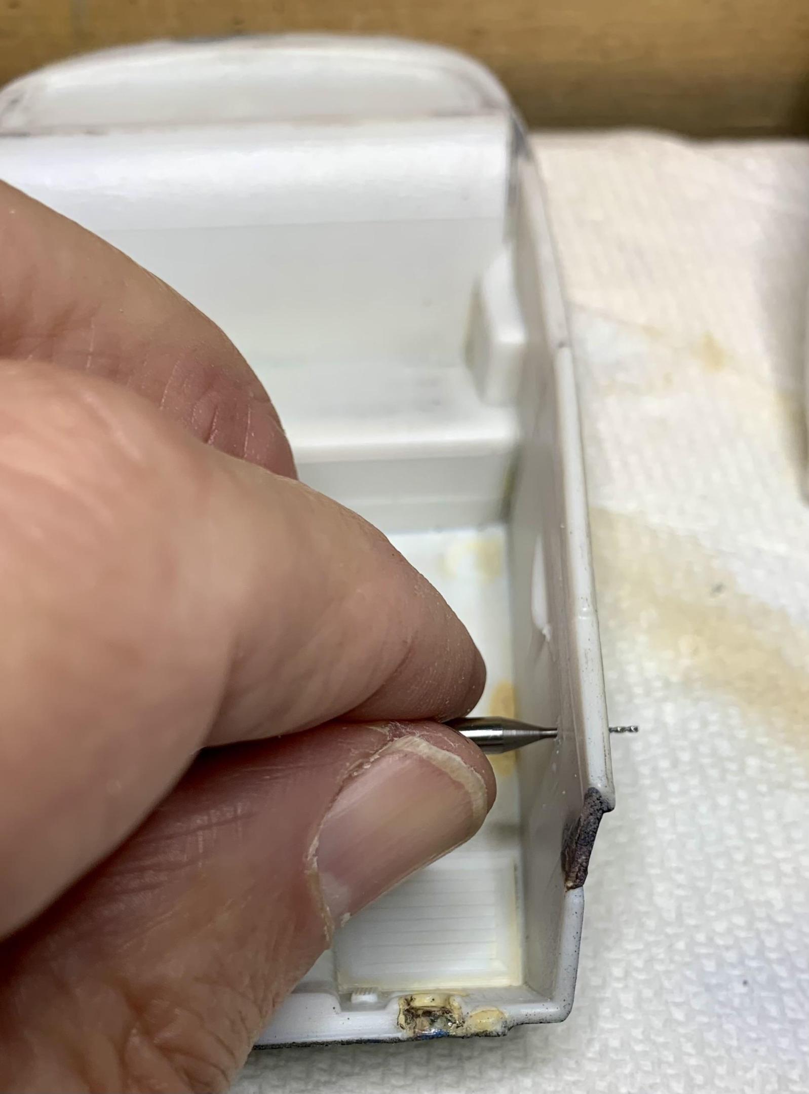

dino246gt Posted June 19, 2024 Author Posted June 19, 2024 The interior detail is so faint, but thick enough that I can't drill right over them without first using the X-acto tip. I use that to find the center so that I can drill and I use hand held drills because there's no room for a pin vise inside these old tubs. With holes all the way through I can make whatever I'm going to use for replacement cranks and pulls and put wire on the back to push through and glue from the outside. 1

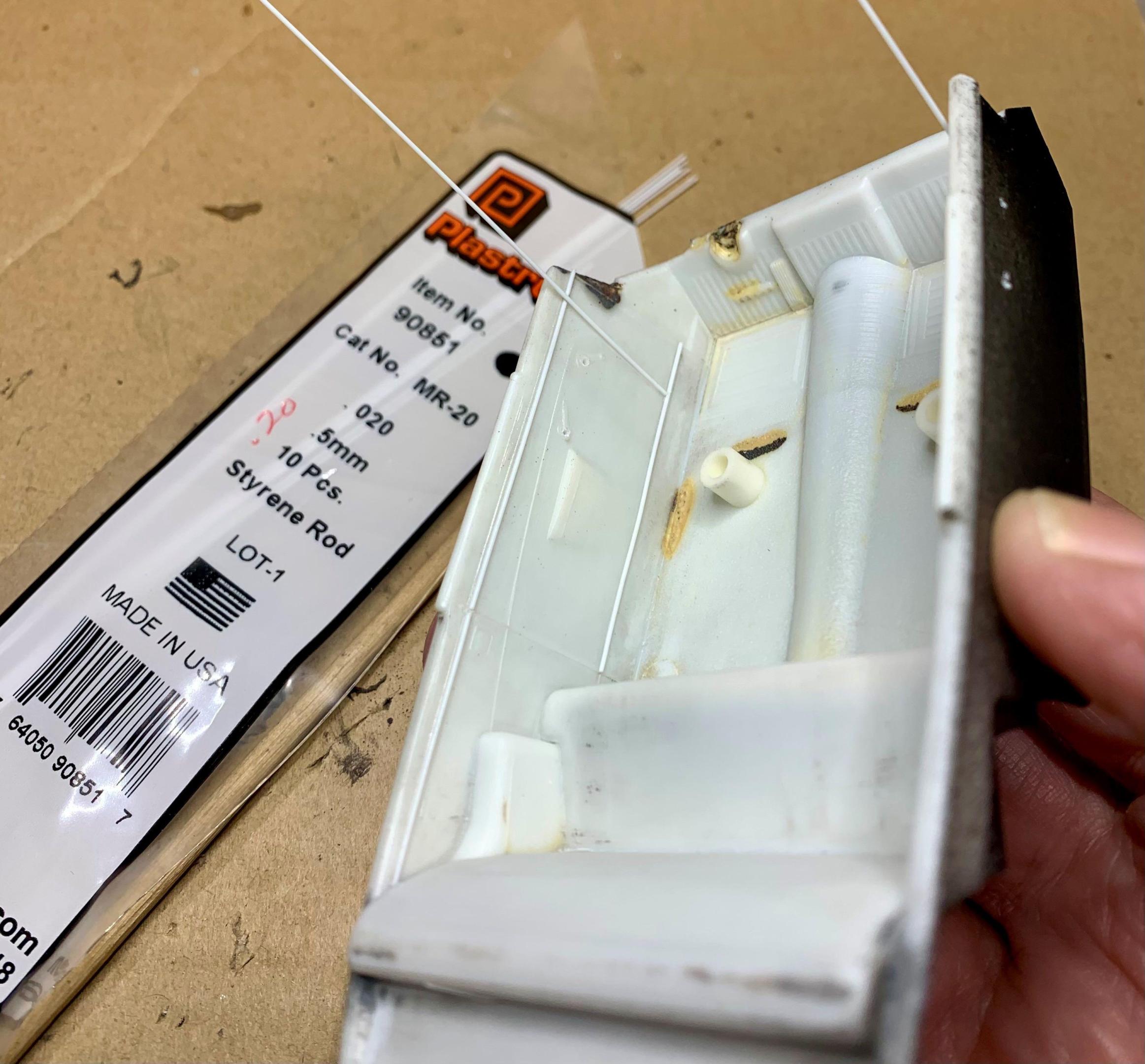

dino246gt Posted June 19, 2024 Author Posted June 19, 2024 To enhance the molded on lines, I add thin styrene right over them, here I used .020 and super glue. Now I can foil those lines for paint separation. Once that's done, I can add cranks and pulls and make some simple arm rests. 1

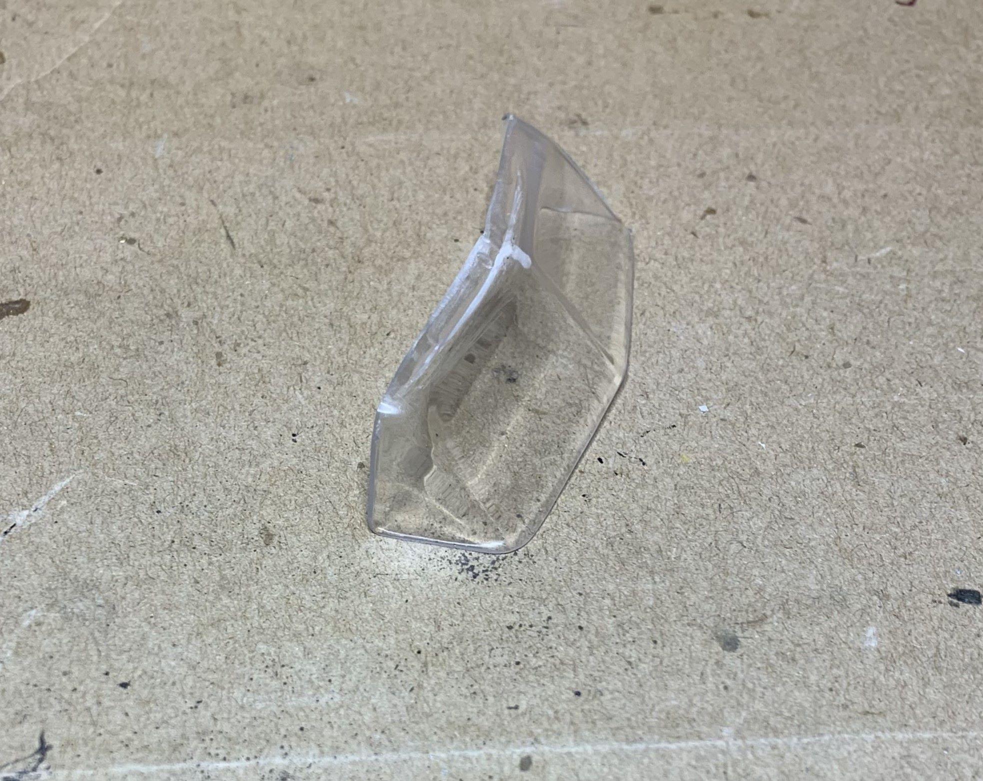

dino246gt Posted June 19, 2024 Author Posted June 19, 2024 I cut the "glass" into separate pieces, and polished them, there was paint and glue on them. 3
