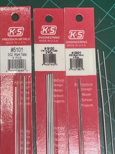

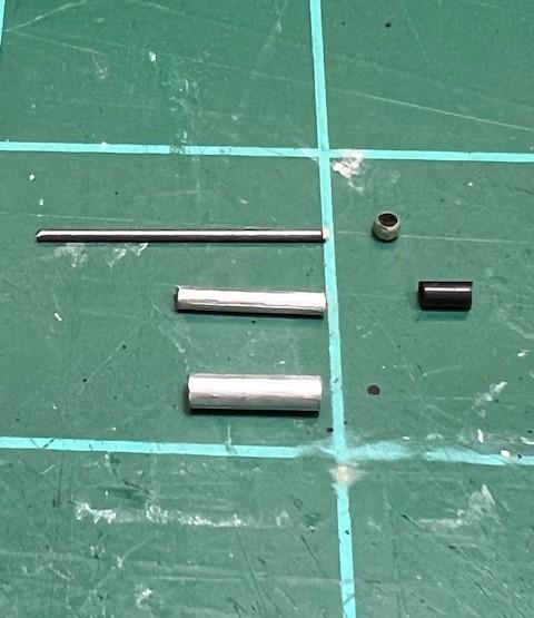

 Hey Roger, here's a quick look at how I make the shocks.
These are the tubes/wire I use.  Have had these for years.  For this build, I cut the larger tube to .35" and the smaller tube to .40".  The rod I just cut a piece as it will be trimmed after installation.  The round part at the top is from my wife's jewelery making supplies (I get a lot of stuff from her craft area, LOL).  It's called a round crimp bead, she gets them at Hobby Lobby.

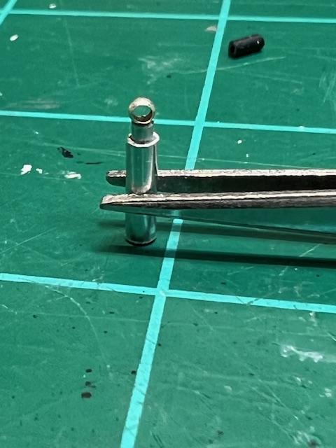

I glue the smaller tube in place then glue the crimp bead on top.  Insert the rod with a little dab of glue and add the little piece of wire insulation. That's it, pretty simple but they look good on the models.
