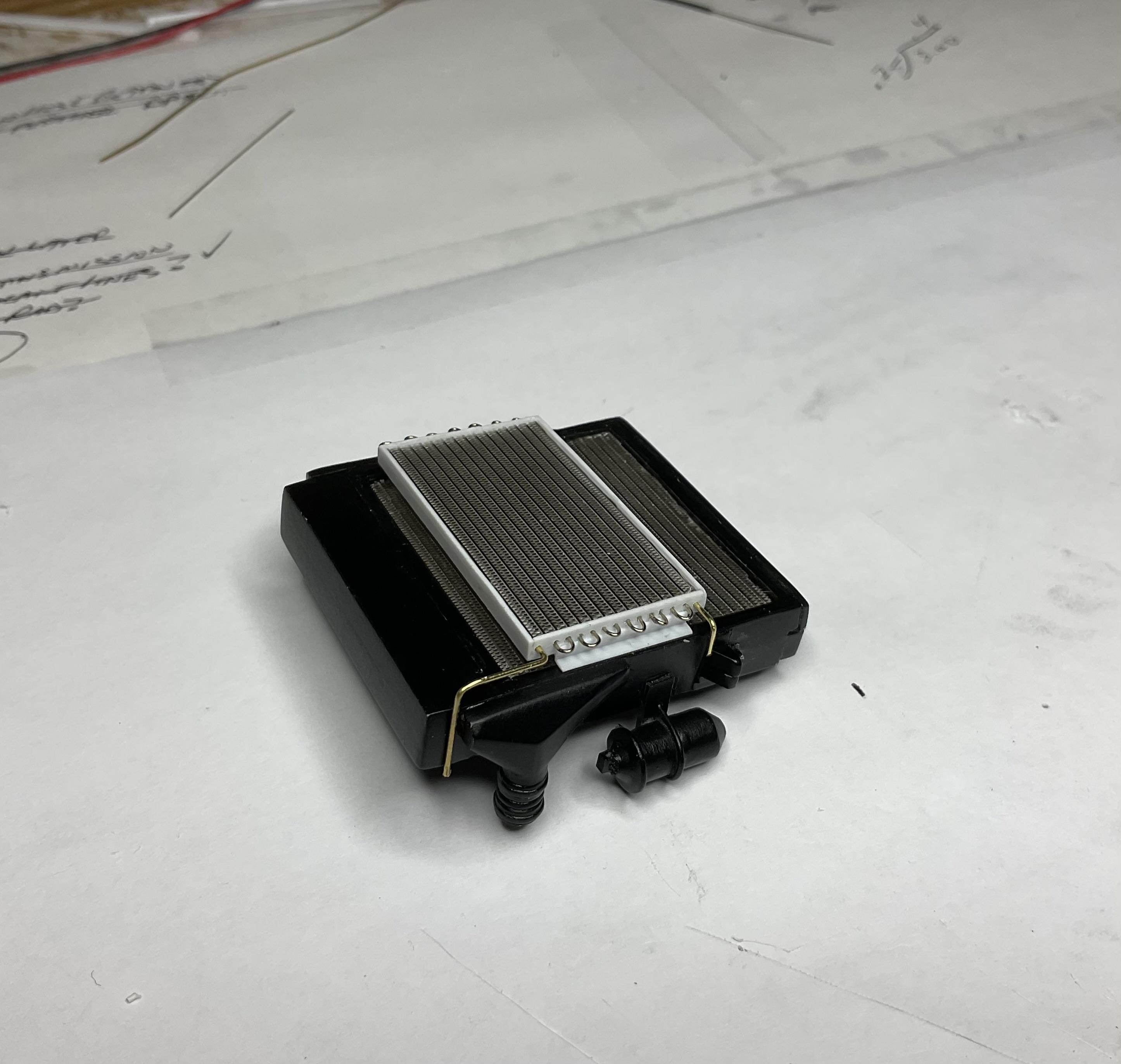

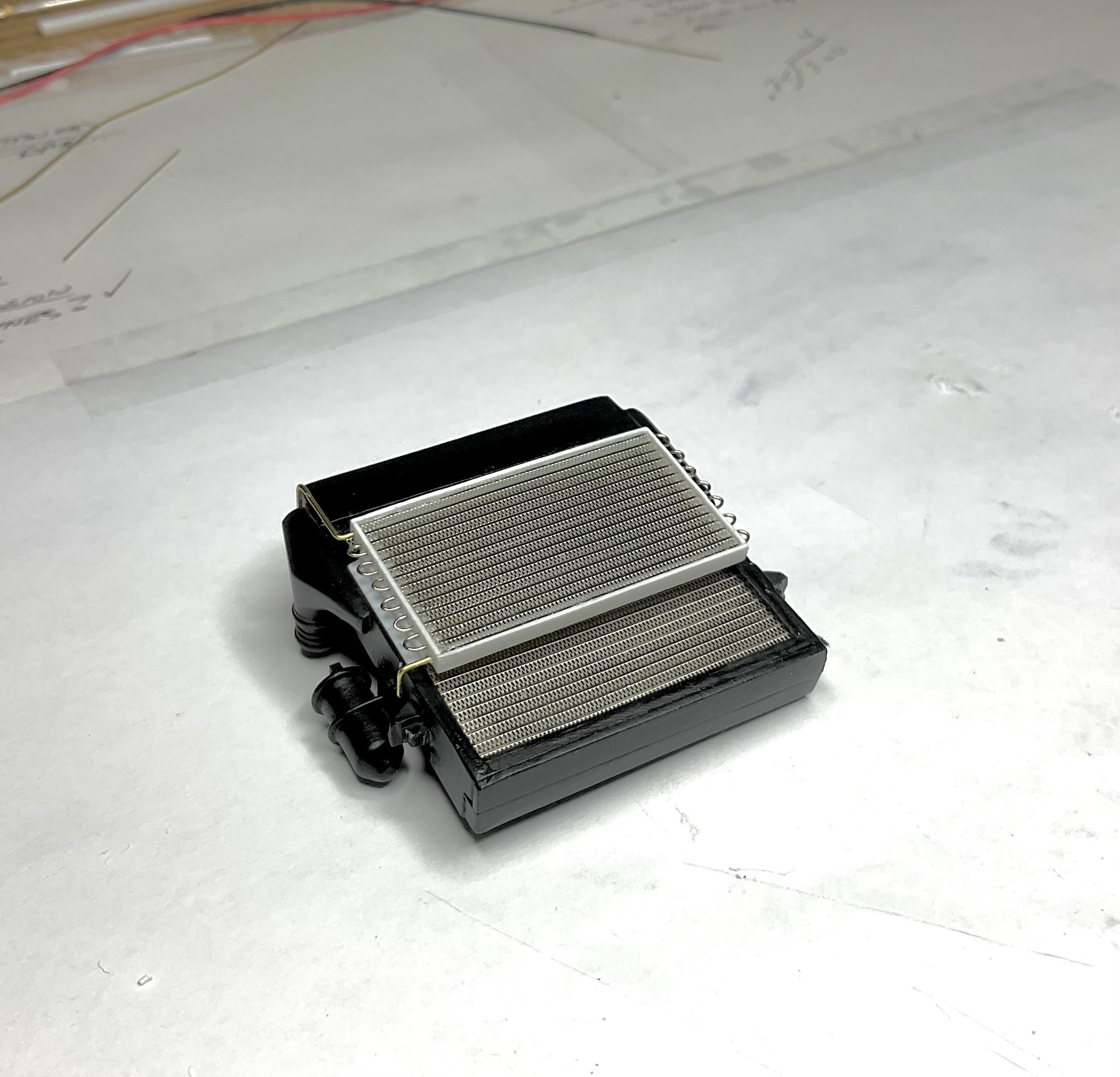

I worked on an air conditioning condenser, using the CTM radiator mesh front and back and 0.3 mm nickel wire to simulate tubes; want to build a transmission cooler to mount below the AC condenser – just haven’t figured out what to use for the thin vanes; built a drop center towing crossmember - some of our winter trucks were converted to truck and pup units for summer; started making the frame mounted supports for the rear (rear, RH side) wing plow, using the patterns I printed from my Sketchup model; made a measurement mistake and had to lengthen the rear of the frame because first attempt at the rear mount was rubbing tire – glad I made the change!

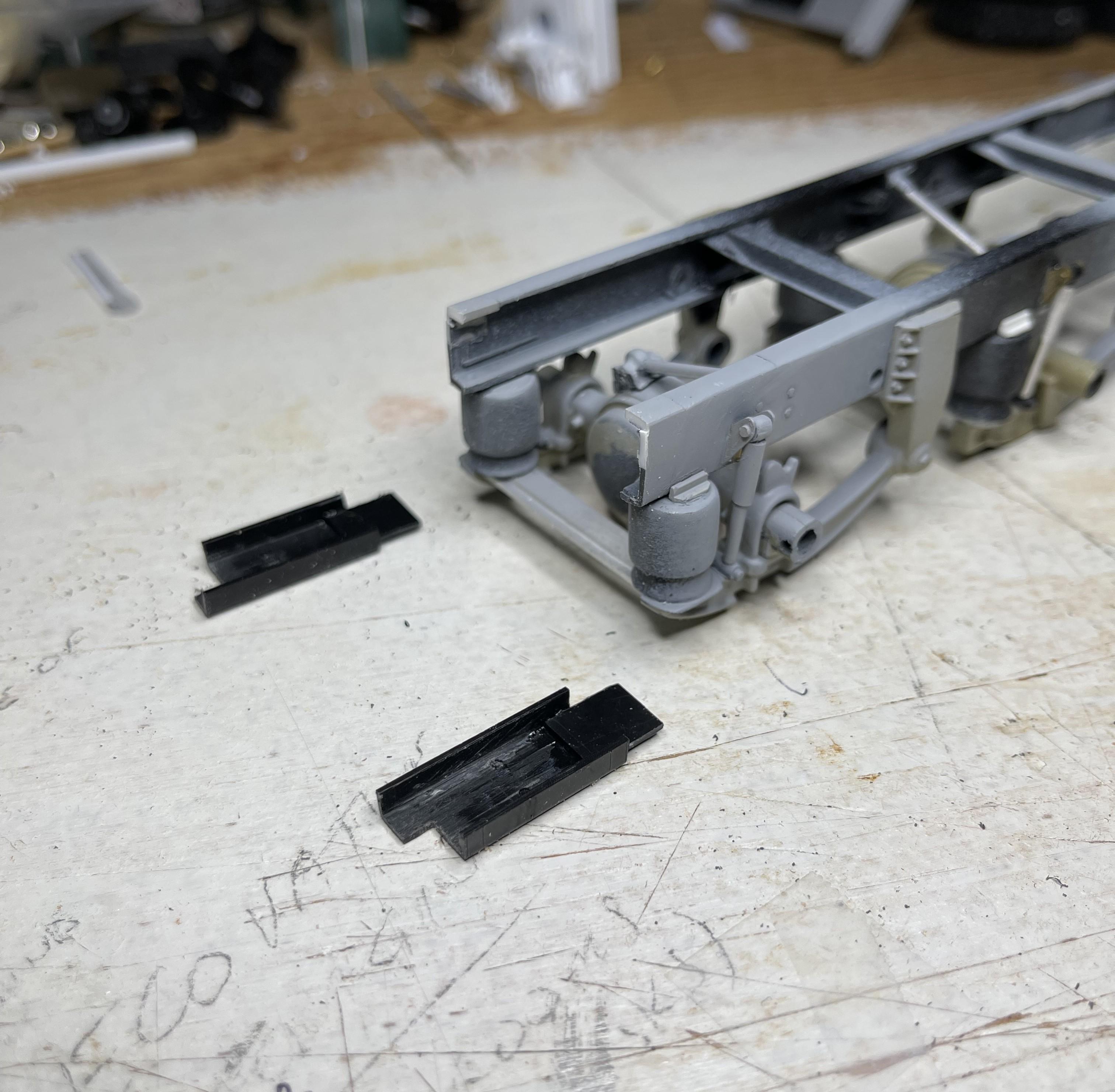

drop center towing crossmember - took lots of pics of one of our trucks under construction and used the Western Star Body Builder notices as well
work on the AC condenser
hoping to plumb in the AC brass return line and outlet to receiver/dryer later in the build - transmission cooler to mount below yet as well

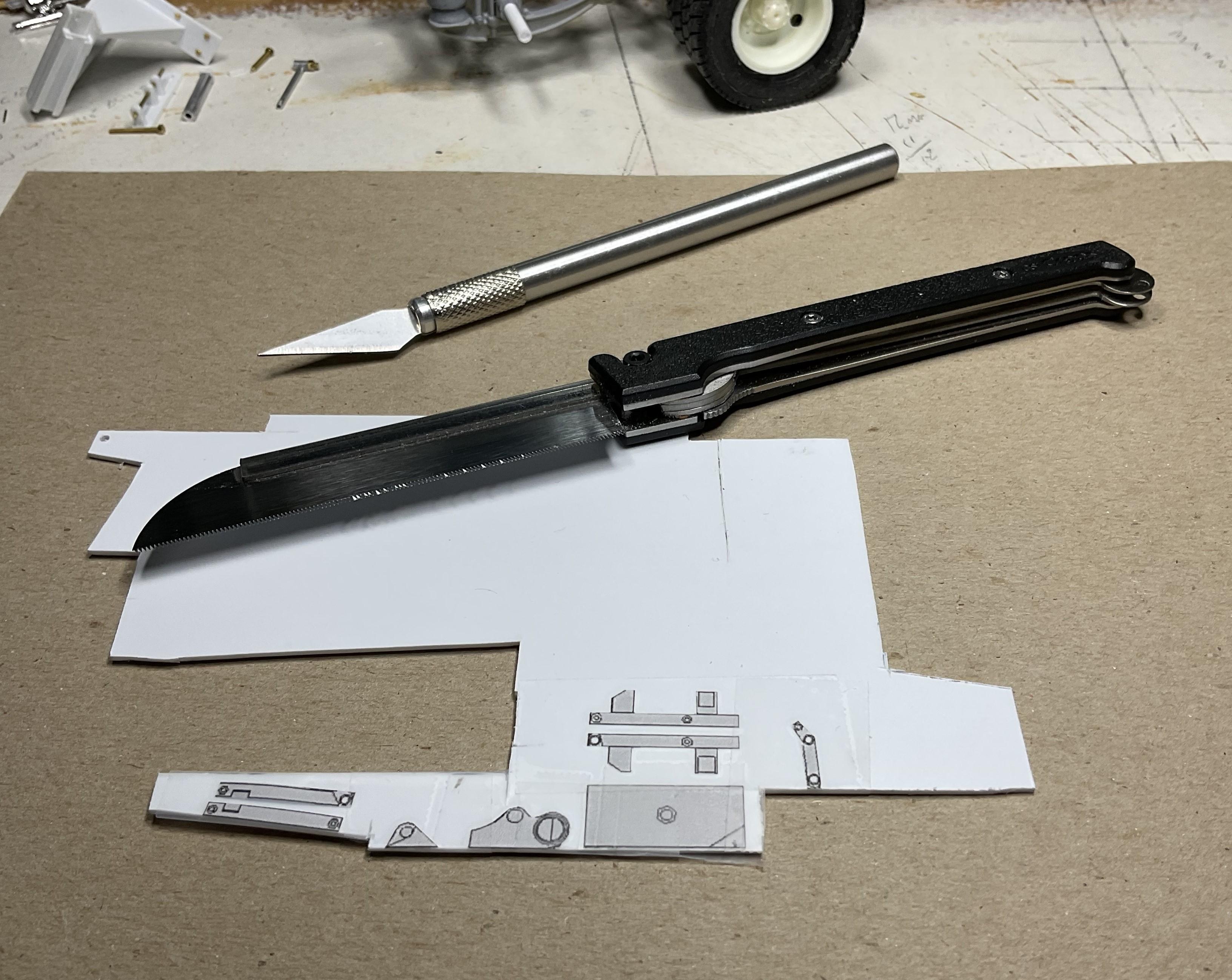

patterns were trimmed and taped to 0.5 and 1.00 mm styrene sheets and cut out using razor saw - haven't made the leap to 3D printing,  so lots of elbow grease sawing out parts!

mock up of the towing crossmember and wing plow frame mounts in place - screw up with rear mount - need to lengthen frame to clear tire - the lever assembly with the brass rod going up through the “grooved cylinder” (represents a rubber component) is an anti-kickback mechanism to dampen any impact of the lower front plow blade and uneven road surface
rear mount is correctly space now - no blowouts! (these are not the final wheels for this build). mount doesn't look vertical but will when finally set in place

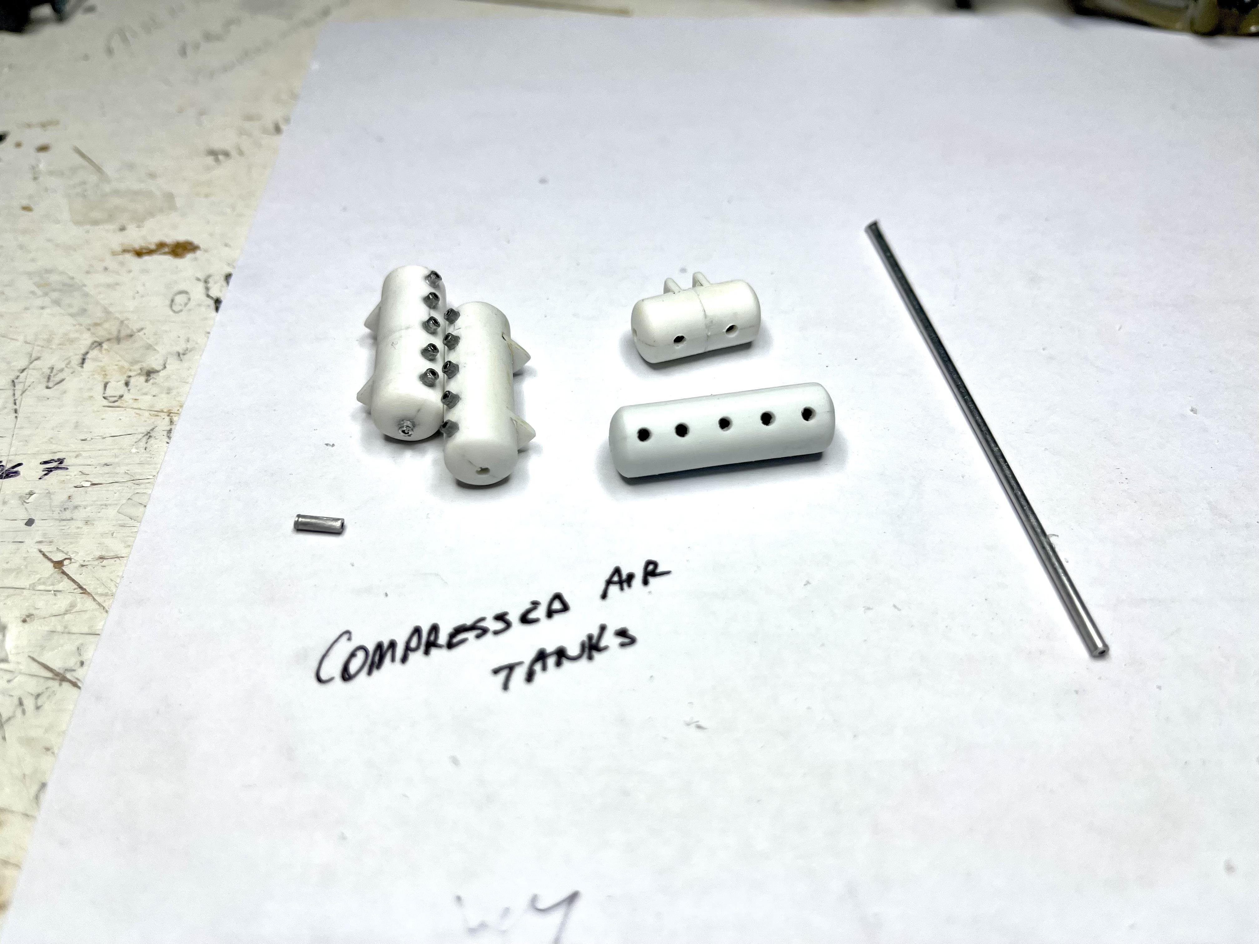

these donor tanks came from an old Kenworth kit - one shortened in keeping with real truck
frame mounts for tanks
tanks mounted in place

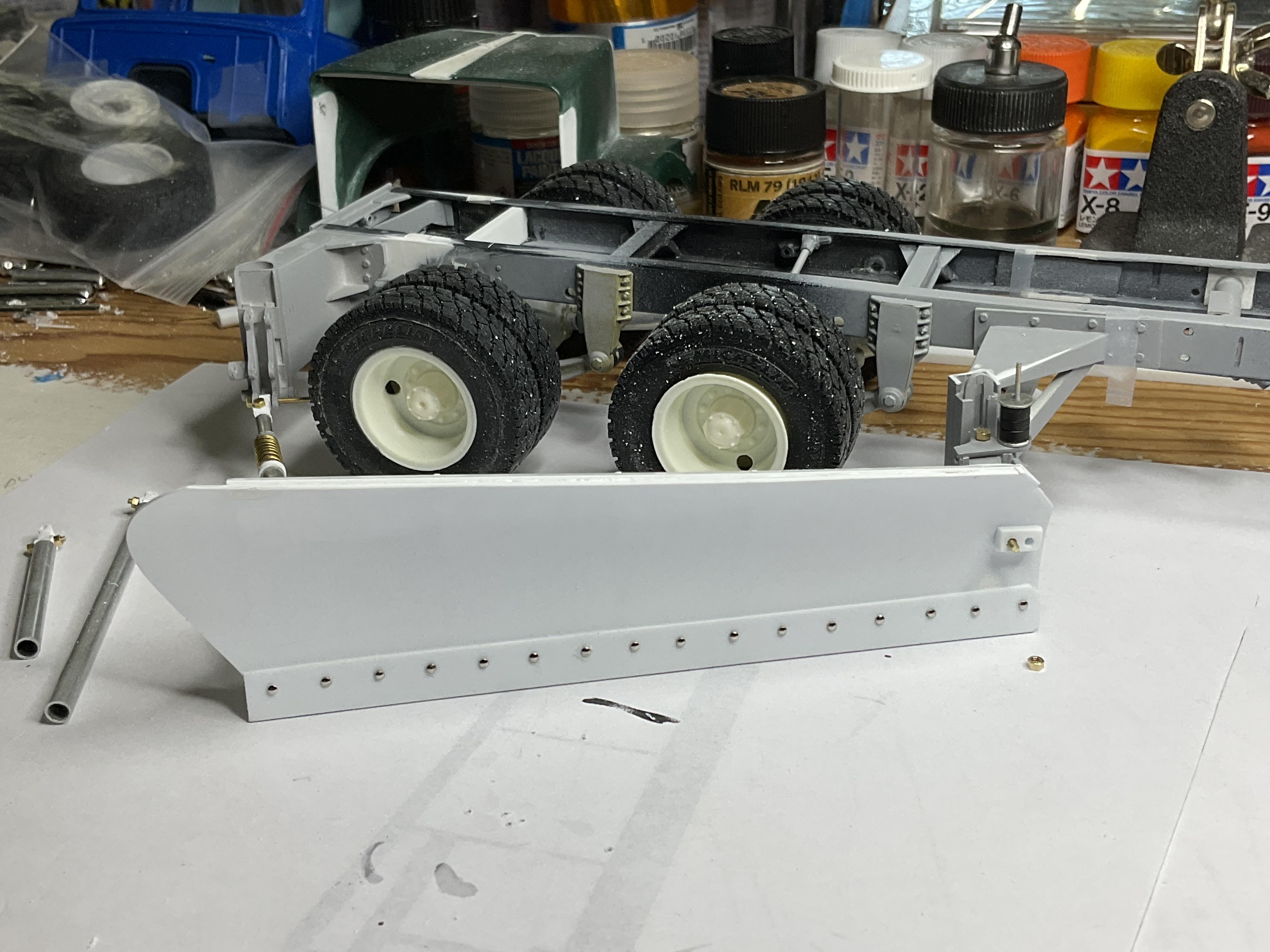

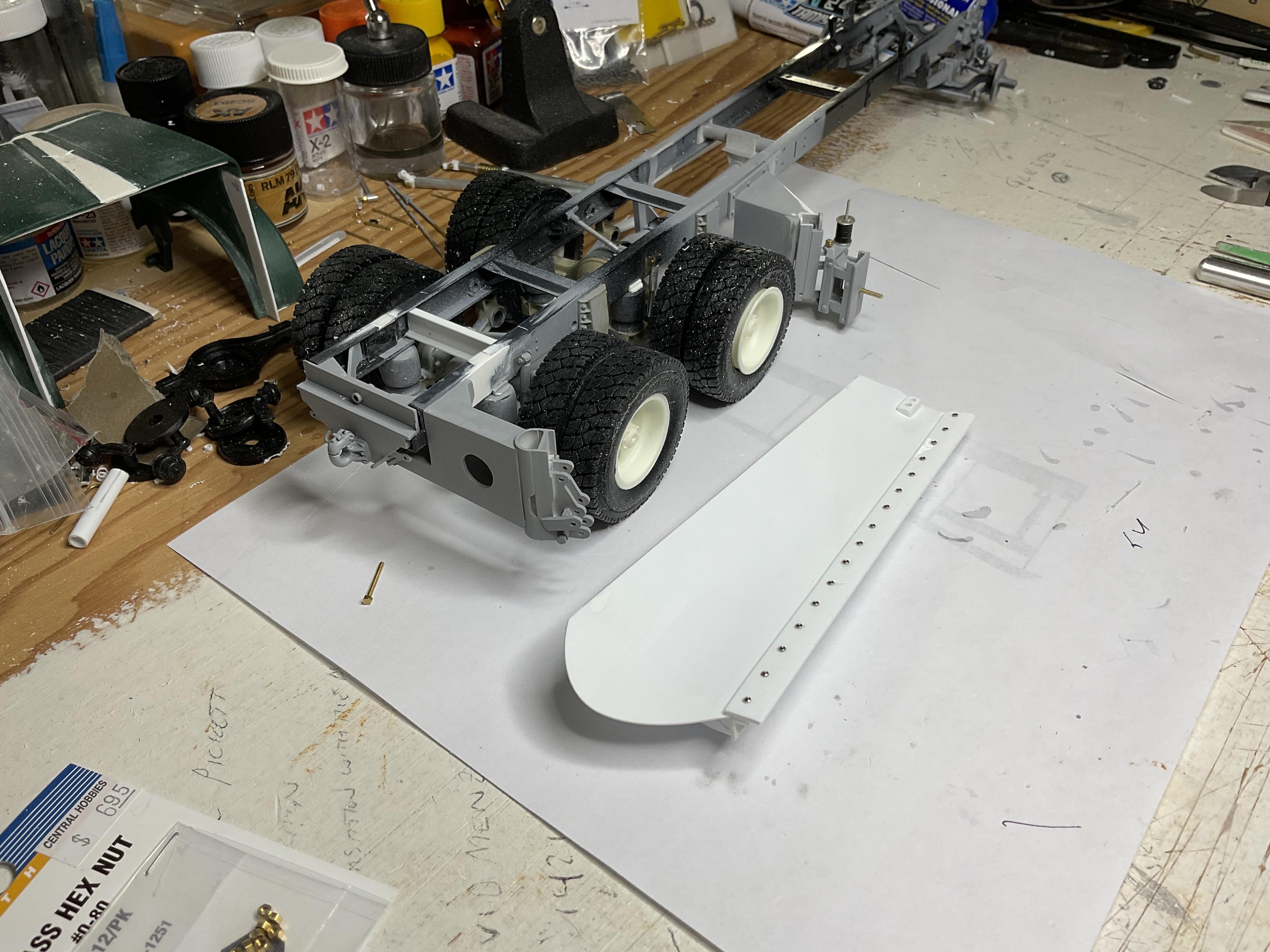

more patterns and cutting - 30 plus pieces - good thing for extra readers and magnifying desk lamp!

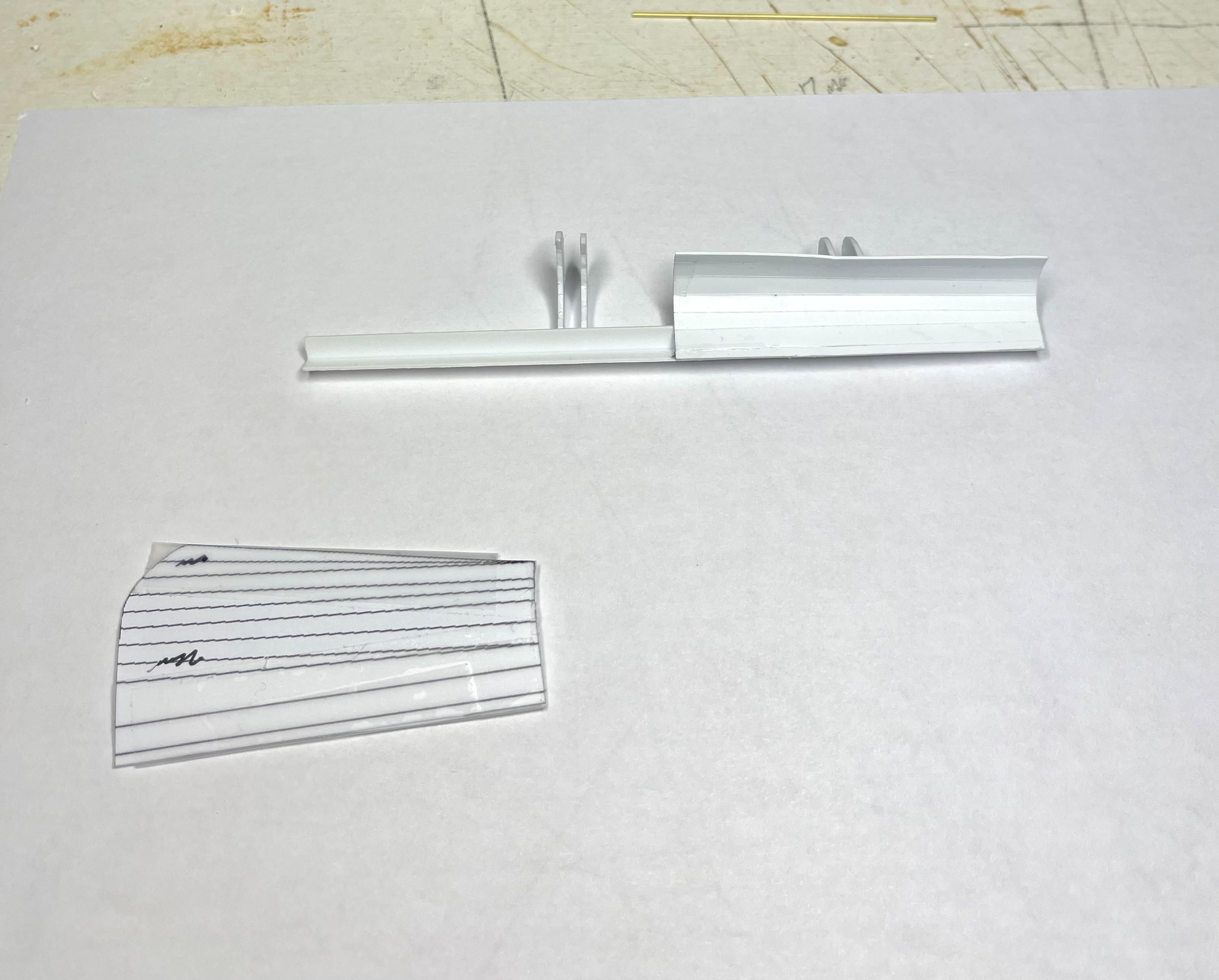

pattern for surface of plow moldboard - trying to lay out the machine brake lines
angle iron backbone of the moldboard and pivot brackets that plow raises and lowers around
intake portion of the "skin" attached
these (adjustable) brackets are the frame mounts that the plow's vertical support pins attach to
Exhaust half of "skin" formed and attached
resin nuts and washers from A & N attaching blade to moldboard

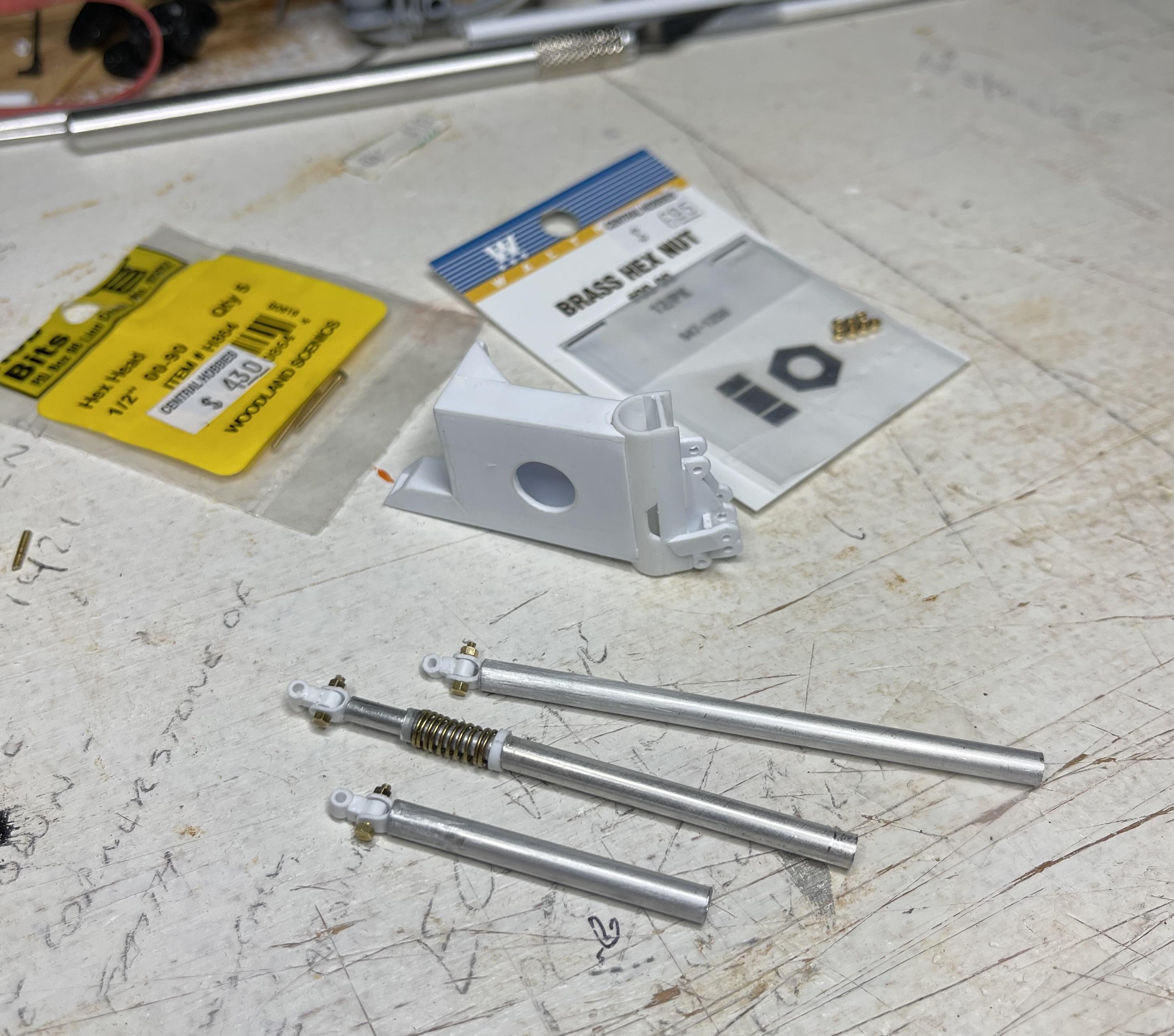

support pins on plow and frame brackets for pins - pins is probably not a good term - on real truck these are 2 1/2 inch solid steel lengths of rod
this cylinder raises and lowers the plow - end of hydraulic cylinder moves inside spring and slotted support - another anti-kickback dampener
lift cylinder attached to its frame mounting bracket on left
better view of cylinder frame mounting bracket - cylinder pivots slightly in this bracket as the plow is raised and lowered
mockup of underbody plow - intake side - raised and lowered
plow "exhaust" or outlet side - raised and lowered
(had to add front tires to see if plow height was ok)
a lot of hours can pass by doing this hobby - great therapy - more later!

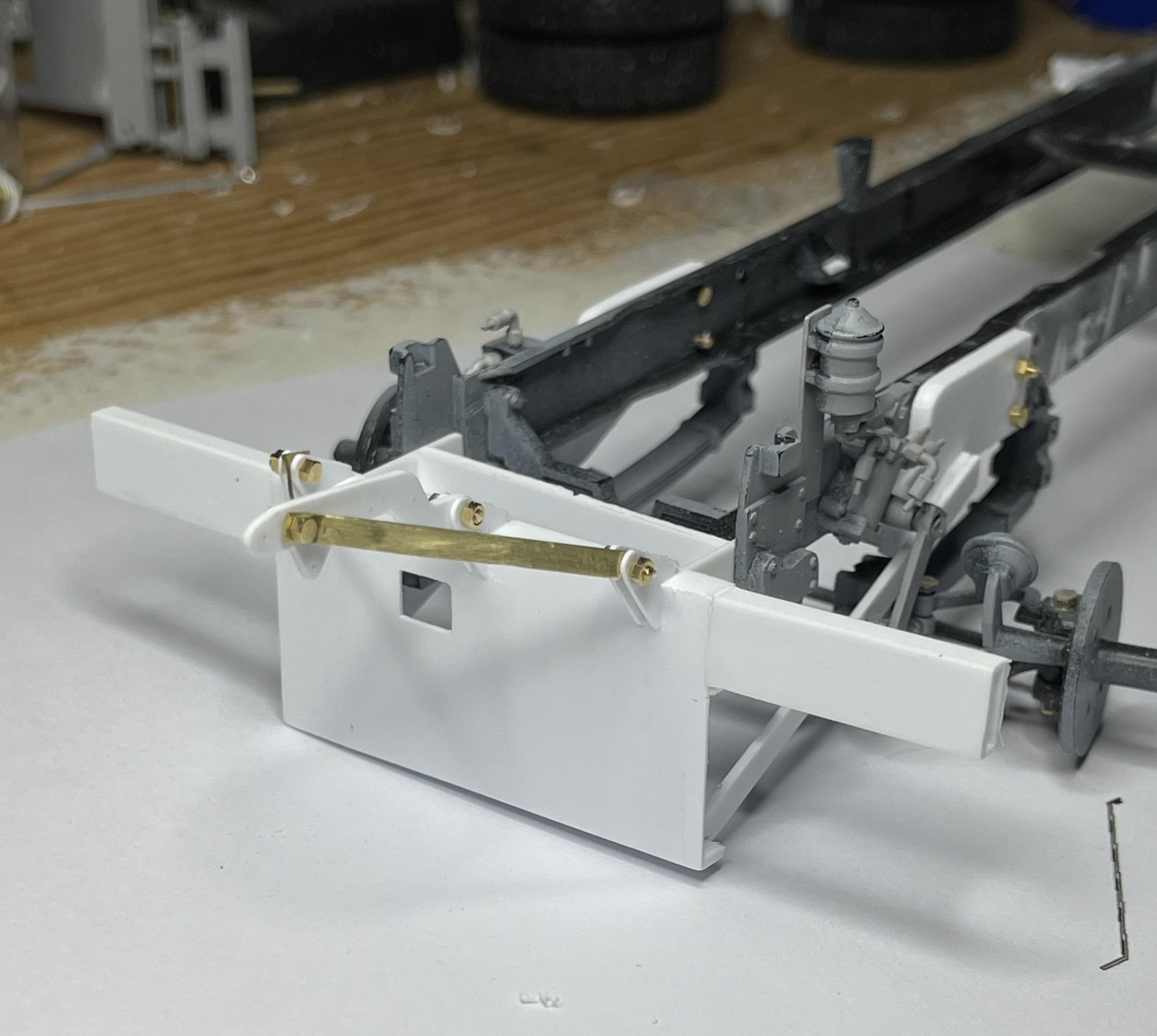

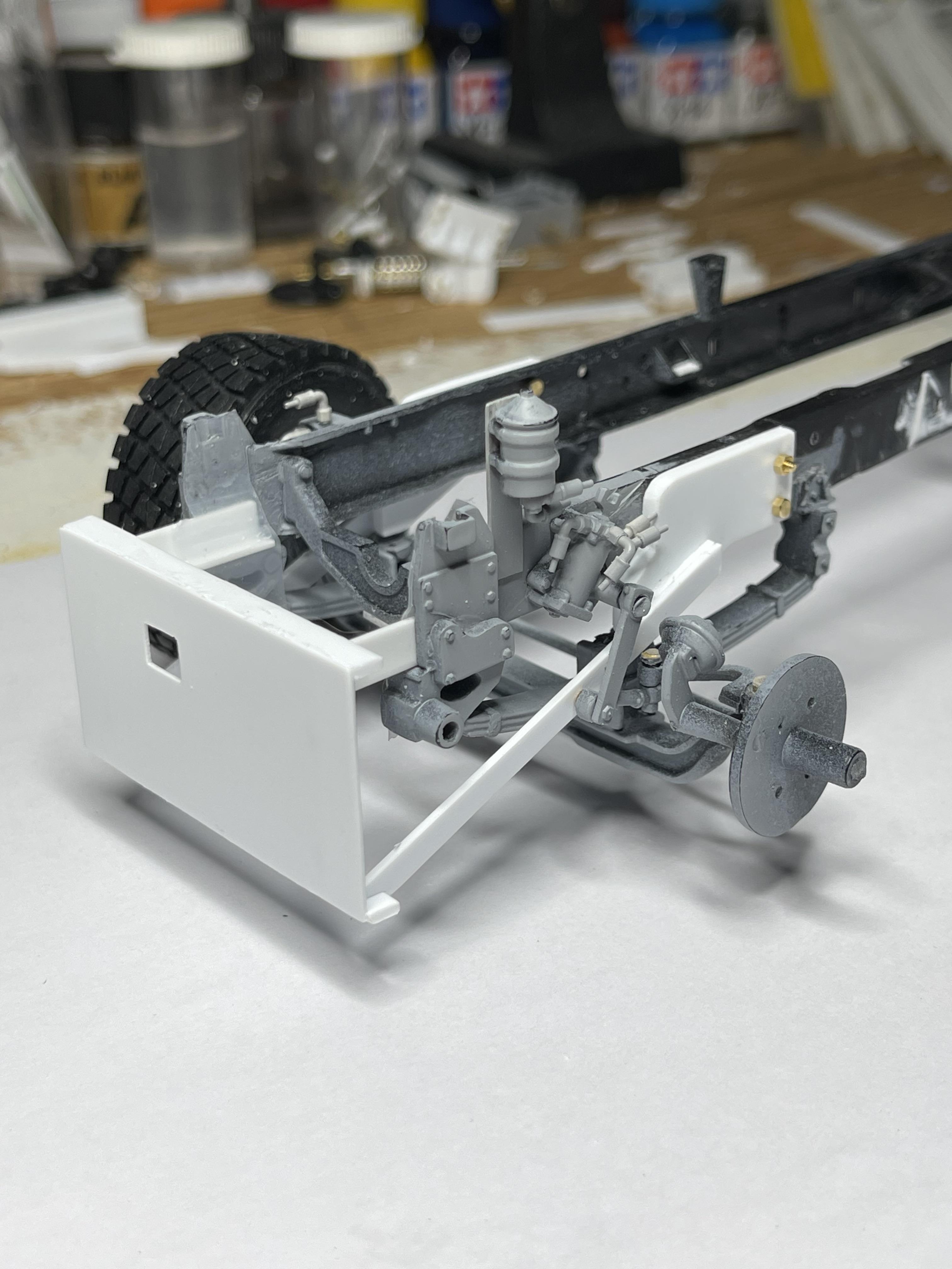

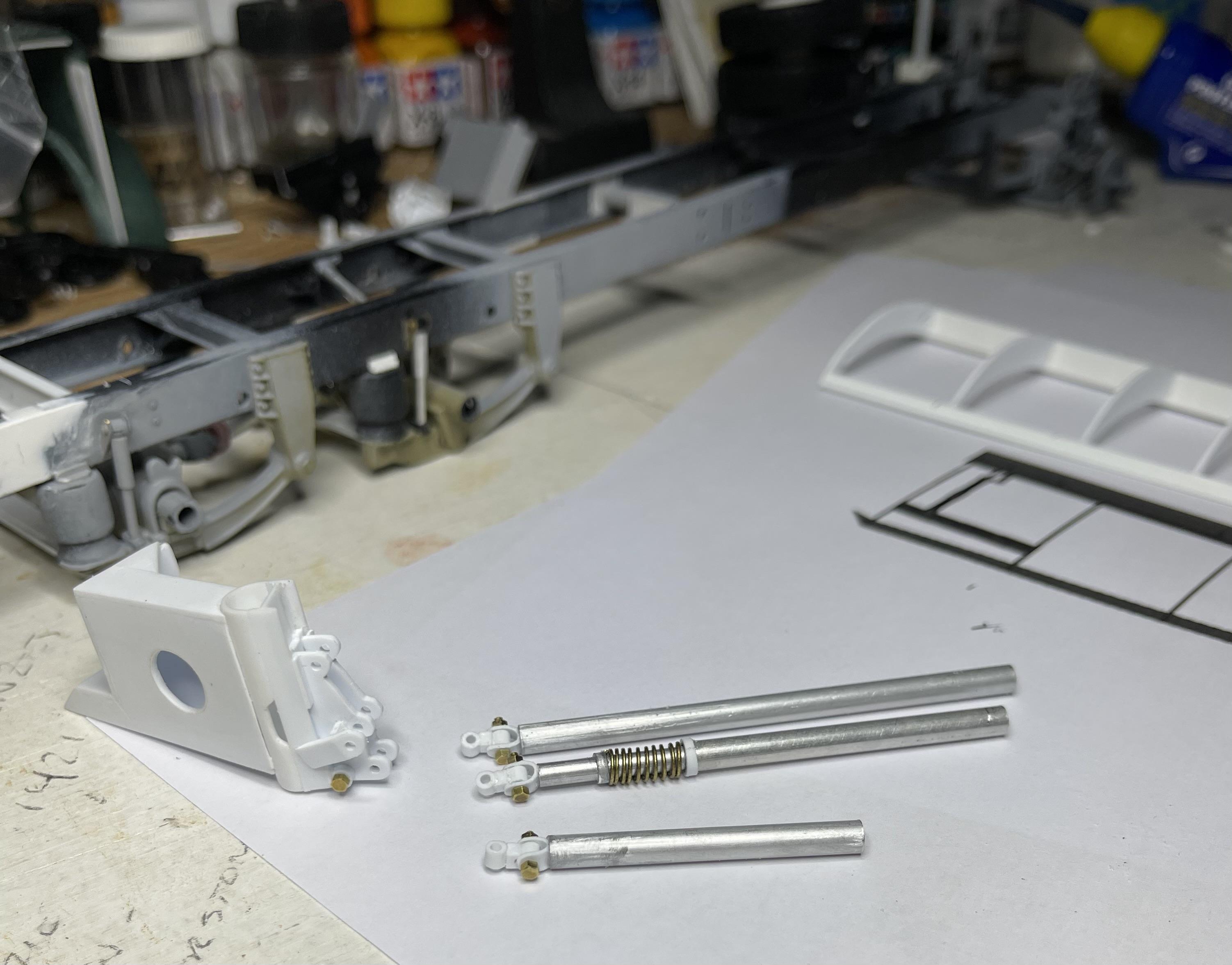

Another plow attachment underway – the front lift group is incorporated into the truck’s bumper unit; made the main mounting plate and frame braces back to strengthening gussets; lift arm and braces that lift cylinder attaches to; the plow's push frame coupling bracket and a start on the articulating, push arm framework (primer is great for seeing work that still needs to be done – so are pictures – I’ve seen a few things along the way that could use some work…)
main body of bumper/lift group, with frame braces and gussets
gussets are a little thick - may need to thin them a bit
bumper wings, lift arm and braces - hole in front panel is for hydraulic lines to lift cylinder
pieces for coupling bracket
lift cylinder in mocked up in place
push frame for front plow - will pivot on bolt in coupler and free to move up and down as well - adjustable plow shoes temporarily in place
will post the rest of the front plow tomorrow - thanks for the comments!

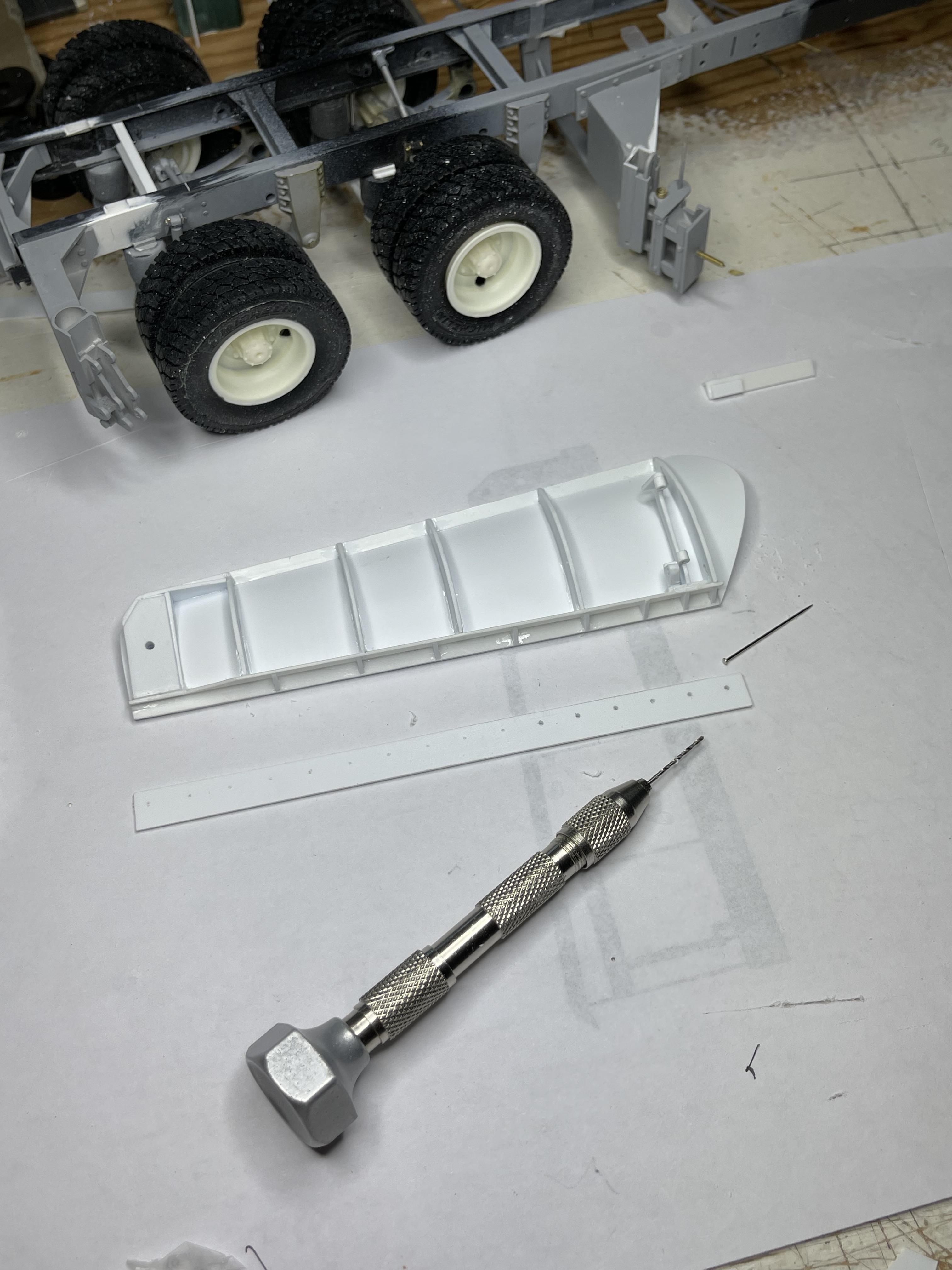

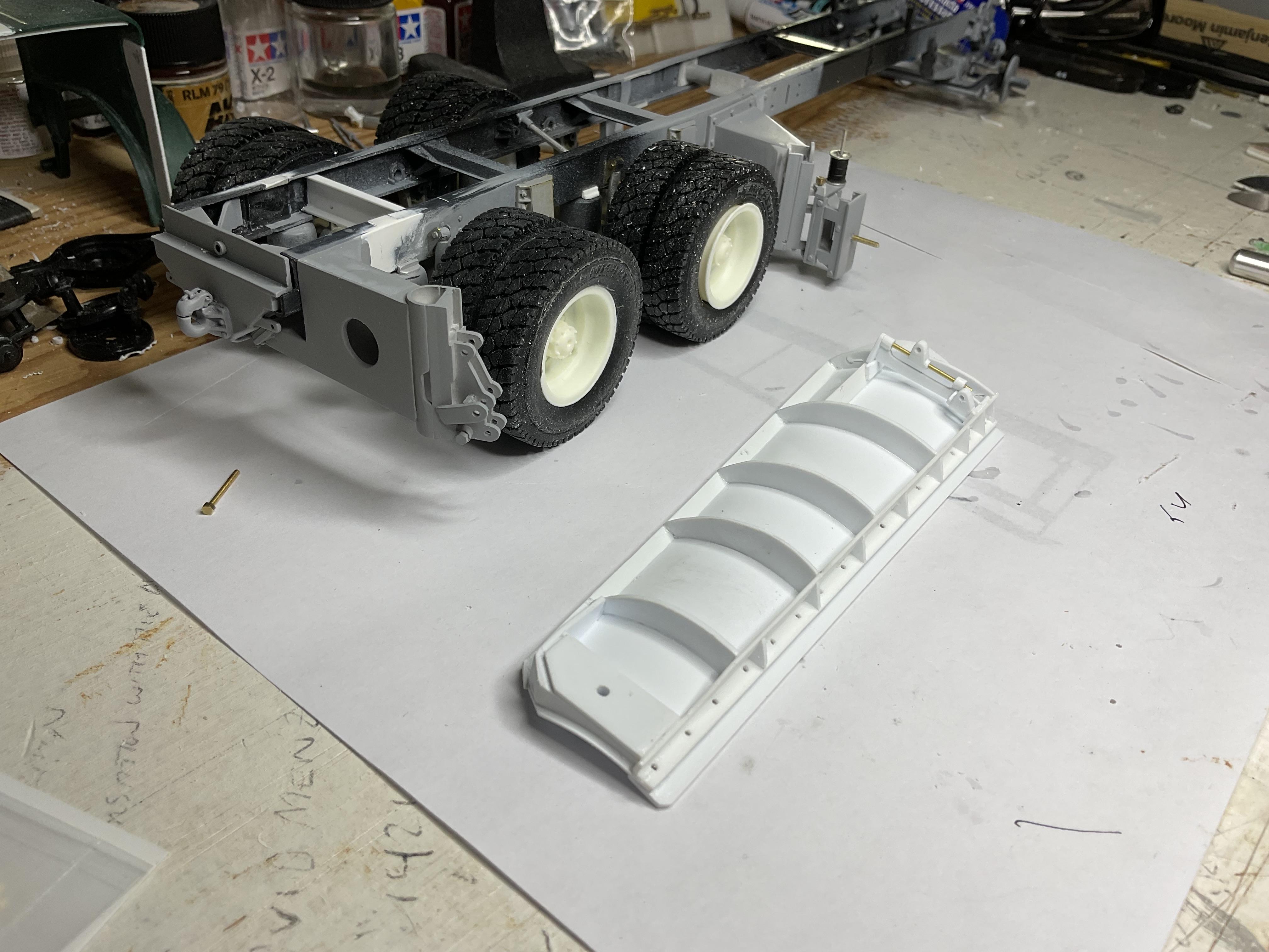

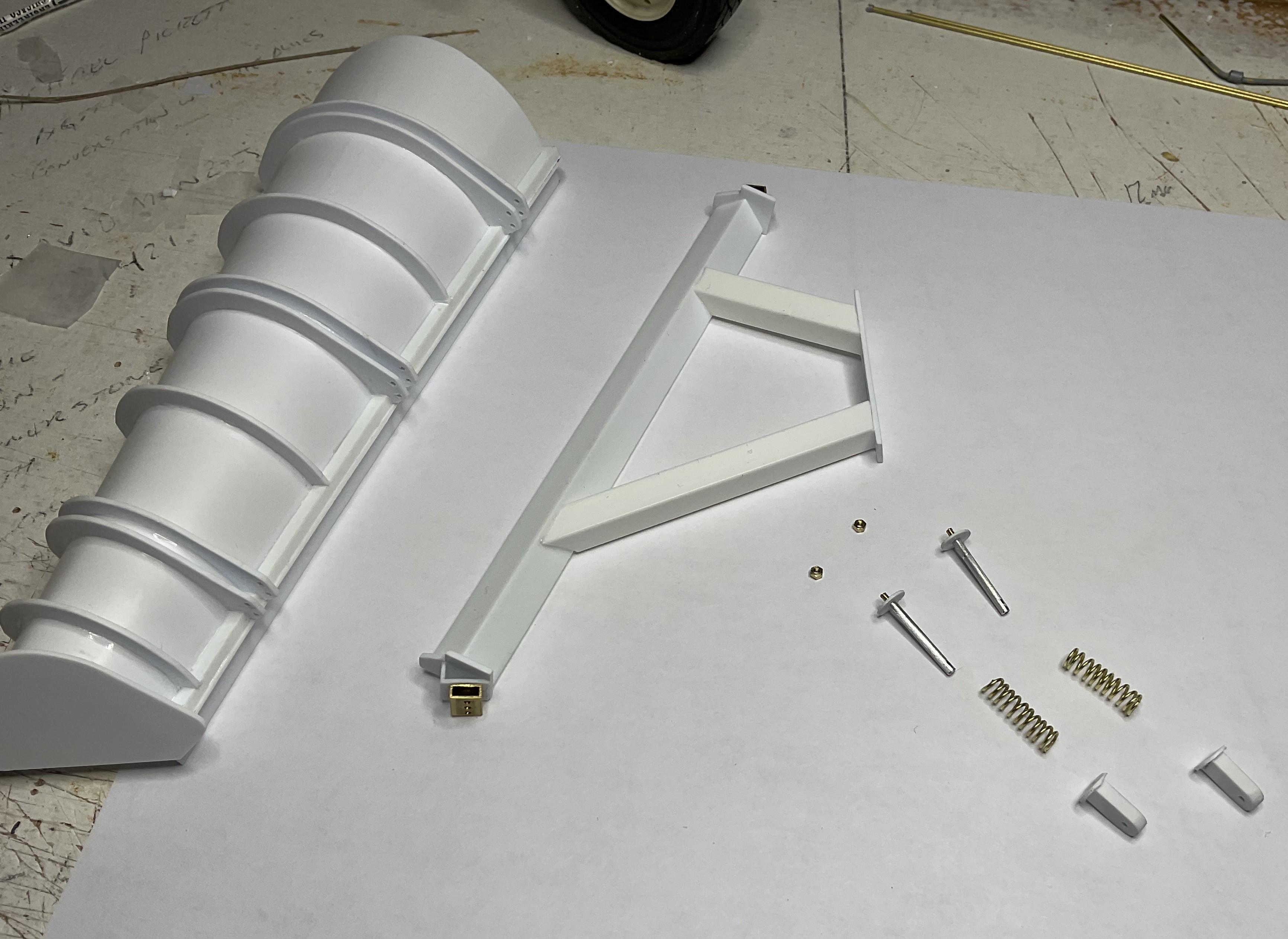

For many months last year, I’d been able to spend a lot of time working at my desk/bench (at this point in the WIP I was about three months into it).  Still had lots of enthusiasm, so the final plow was underway!
Started off with a printout of the front plow from my Sketchup model; worked on cutting out all the reinforcing ribs/arches for the moldboard frame; lined up the main ribs with brass rods, spaced per the template; attached the moldboard skin and worked on the anti-kickback spring units that mount on the push frame, and attach to the plow; made the manual, plow angle adjustment pole; test fit the plow on the bumper/lift group
Sketchup printout -
wouldn't have been able to make the arches correct without the patterns
lining up the main arch pairs, to start the moldboard frame assembly

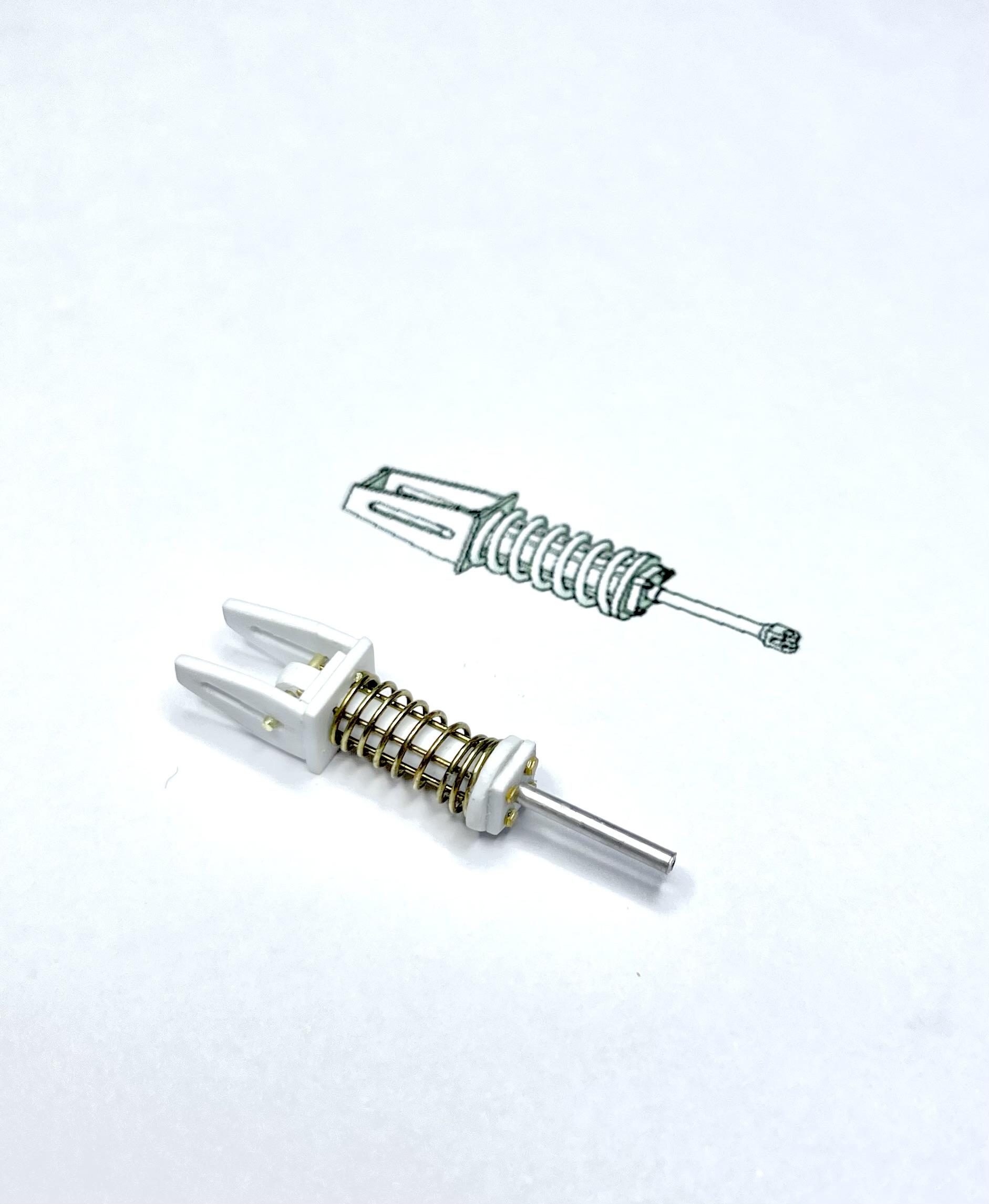

moldboard completed, plow shoe adjustable mounts added to ends of push frame, anti-kickback dampener springs ready to be assembled
aluminum tubing pole brace from push frame to center plow arches-
the plow lift arm has a hook on it at the moment - need to change that to a U shaped clevis at some point, and add lifting chains between the clevis and the ears on the push frame
some small details left to add, but basically finished (and need to trim the ends off the plow shoe mounting plates)
will get to the sander body in the next few posts
