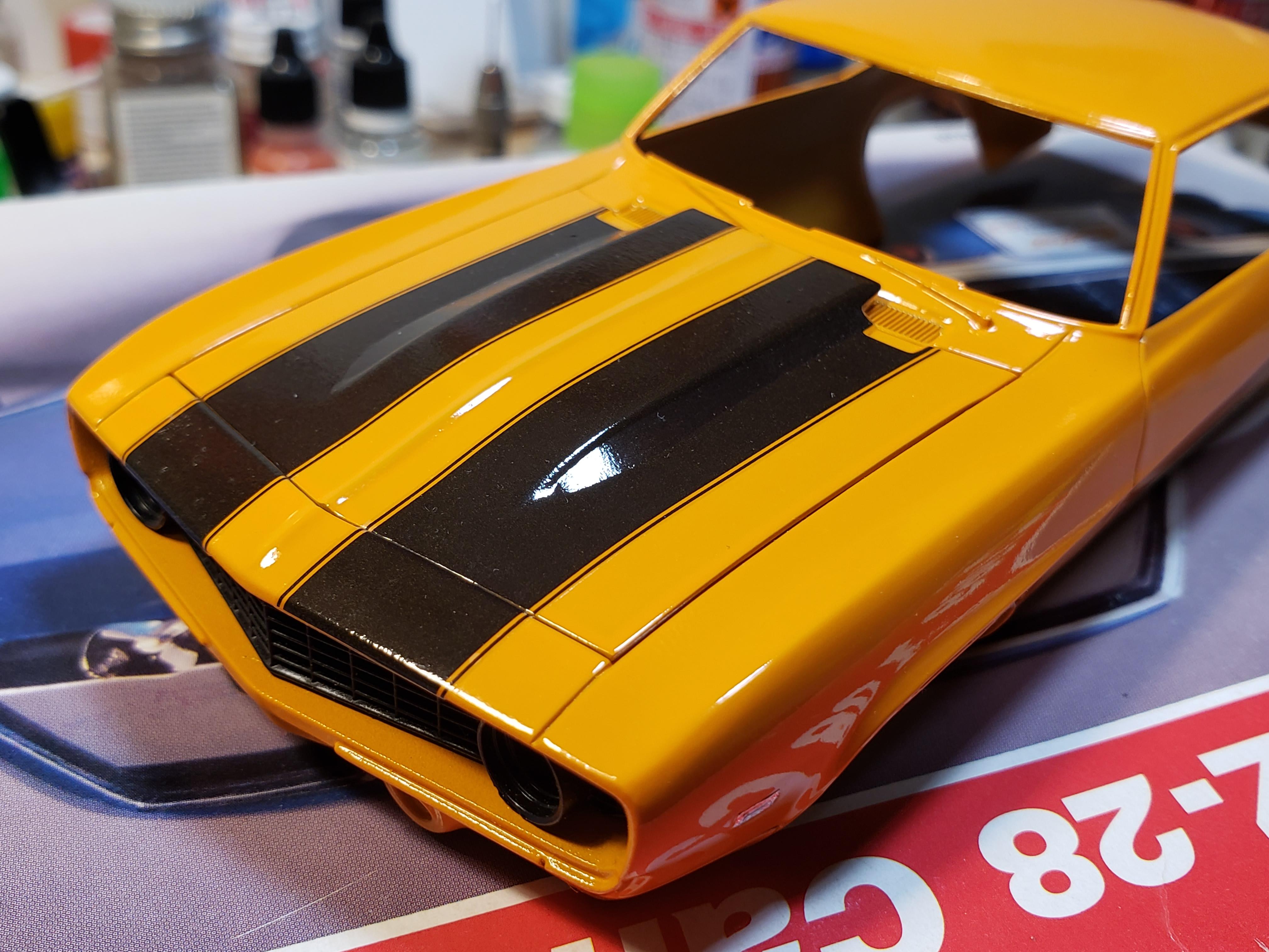

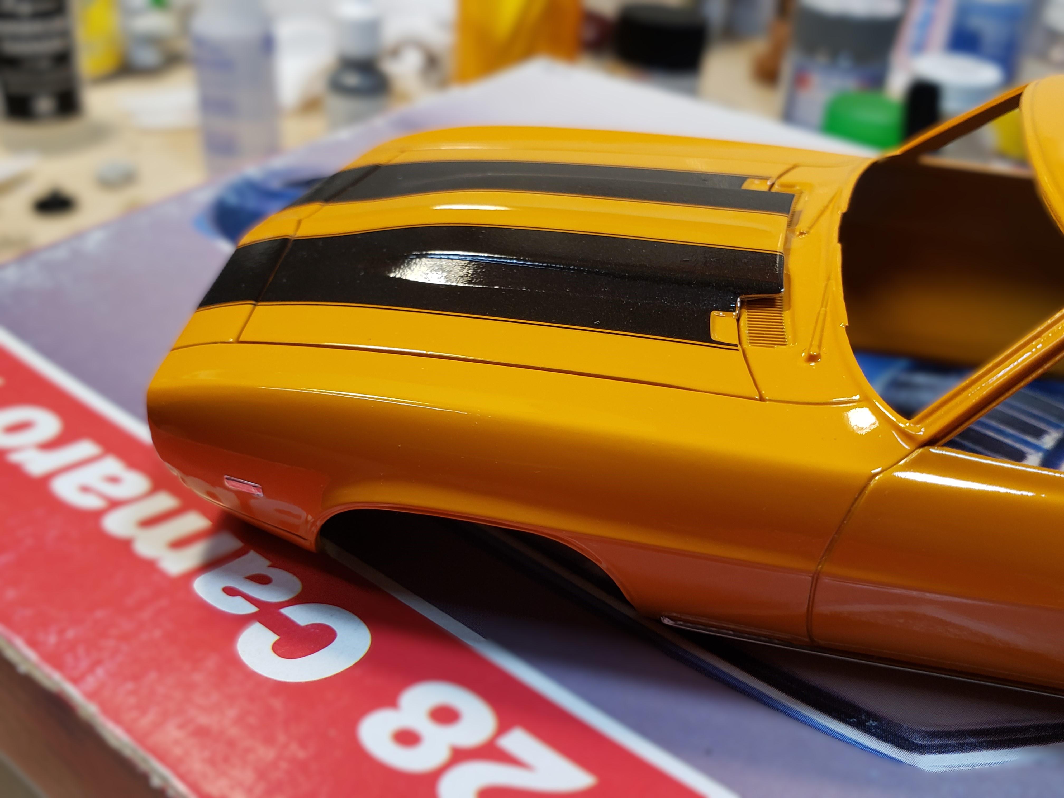

DJMar Posted August 26, 2024 Posted August 26, 2024 Stock (original 1990 issue) kit decals with a little bit of Micro Sol. They settled down pretty well. There's no clearcoat over the top, and the wiper cowl decals are not applied. My only complaint is the black looks a little lighter over the orange than they did on the decal sheet. But otherwise they worked, even over the curves. 3
