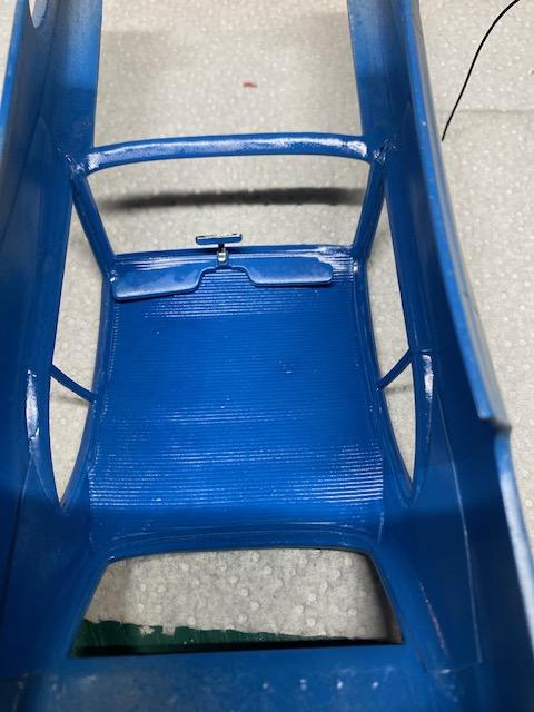

DoctorLarry Posted March 17 Author Posted March 17 Made some more progress on this one. More detailing on the firewall. I added wiring and some more engine detail. I started gluing up the interior and added seat belts. Found some red line decals for the tires. Added brake lines and detailed the front and rear brakes to work with the resin wheels. Created a headliner to match the real pattern and glued it and the sail panels in. I have to finish the e-brake cables and various belts and hoses then test fit it. I have done some body work but there is a major ridge under the hood letters I can't get out. The sun visors are from the Chevelle, they are just sitting there for now and need to be glued in. Thanks for looking! 5
